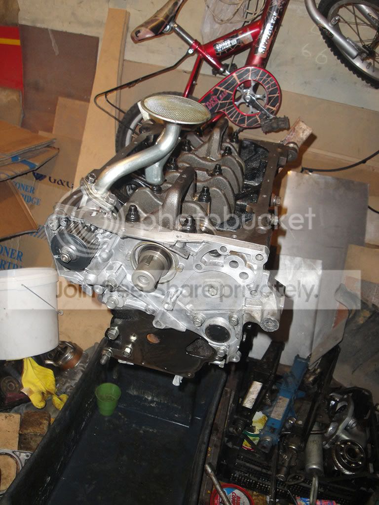

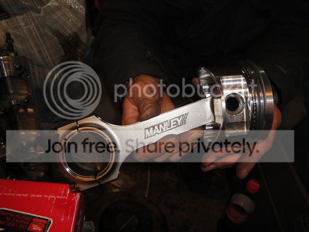

Everything torqued to specs. Rod bolts were torqued to 40 lbs, even though the manley instructions didn't have such a low value for the ARP 2000/rods combo. Well I'll trust ARP and forums more than Manley.
The only glitch that I came across is why ARP main bolts didn't have enough room for the oil pump suction tube (or whatever that is called in english).
Meanwhile...
