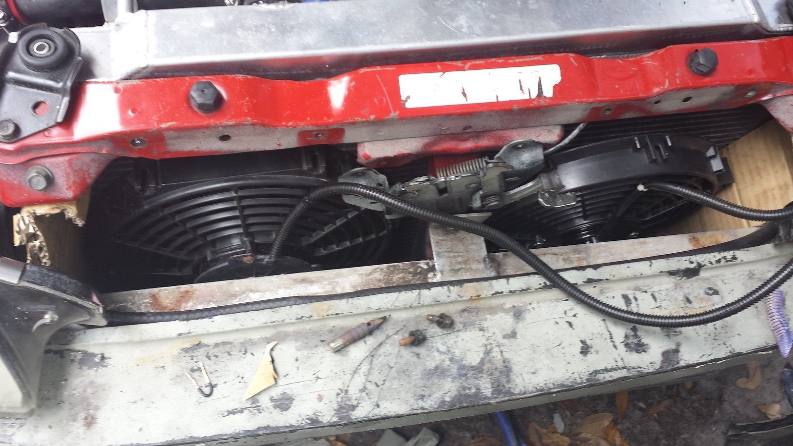

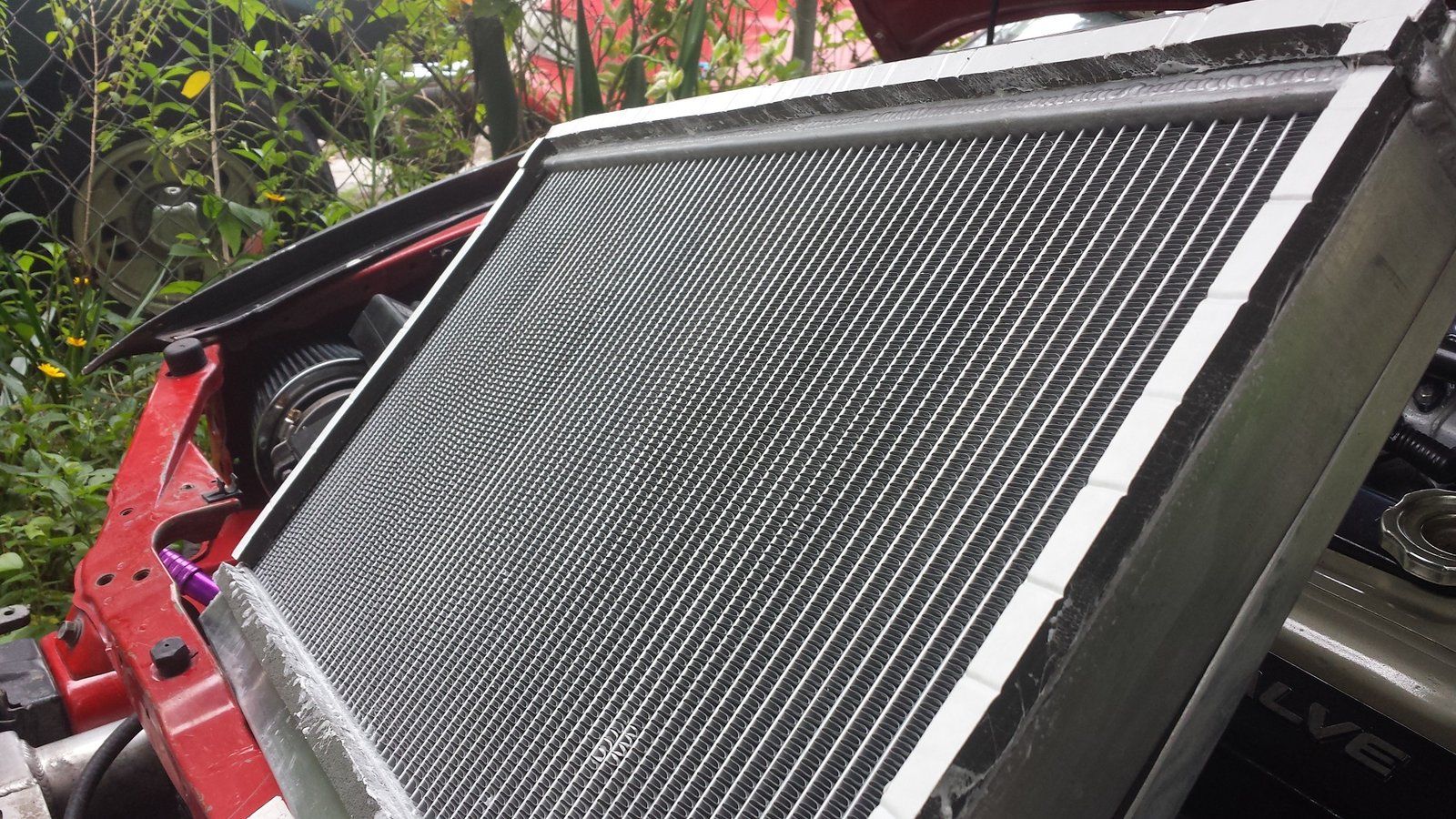

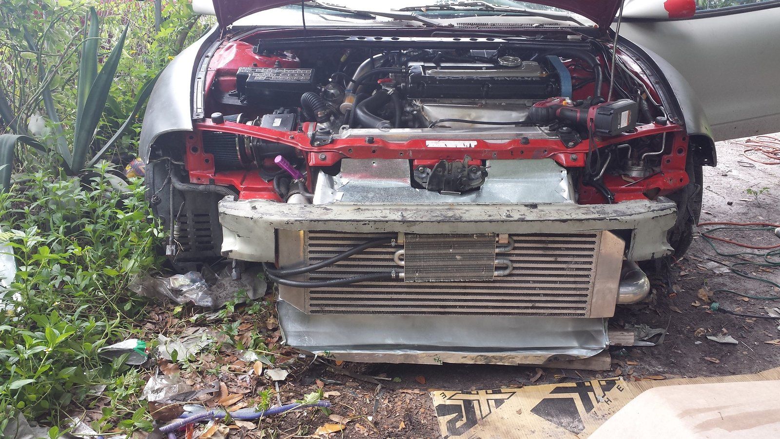

So, FL heat is very un friendly to any DSM especially a 2g, idk why. I add 2x pushers the right way. Sealed the radiator and created some ducting to force air into the fans+condenser+radiator, it worked very well, i still get hot with A/C on but that is something that will be addressed later in the build.

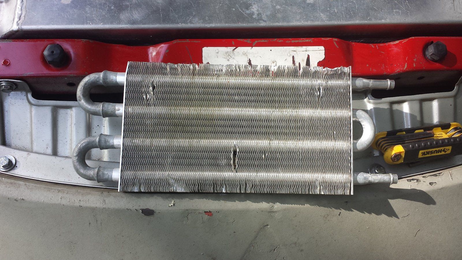

Oh i also used a oil cooler to aid in water temps.

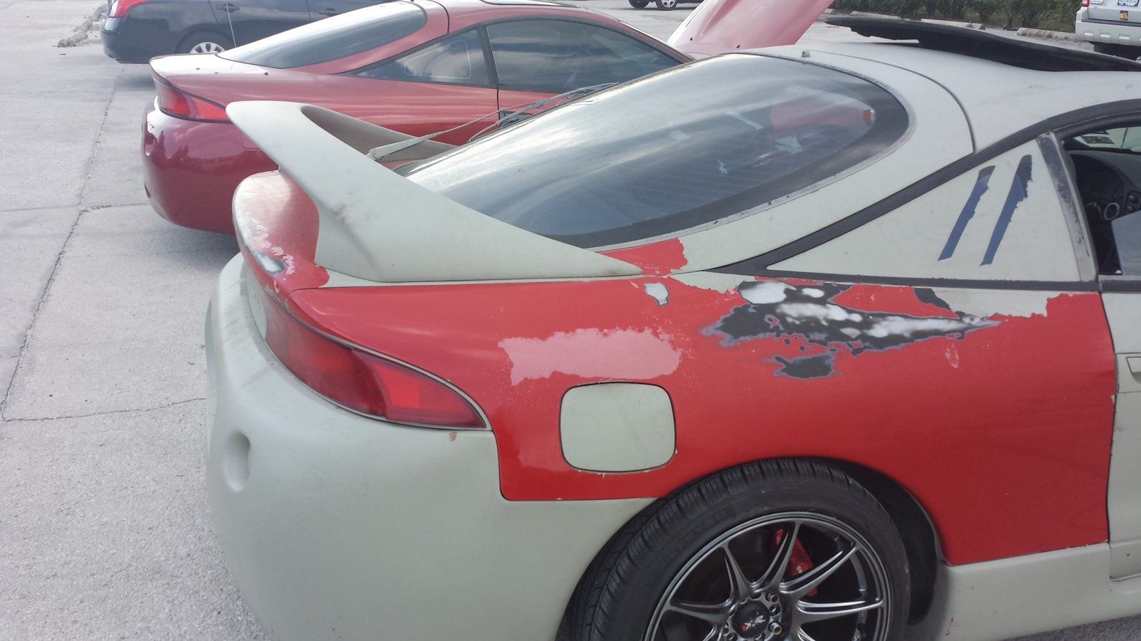

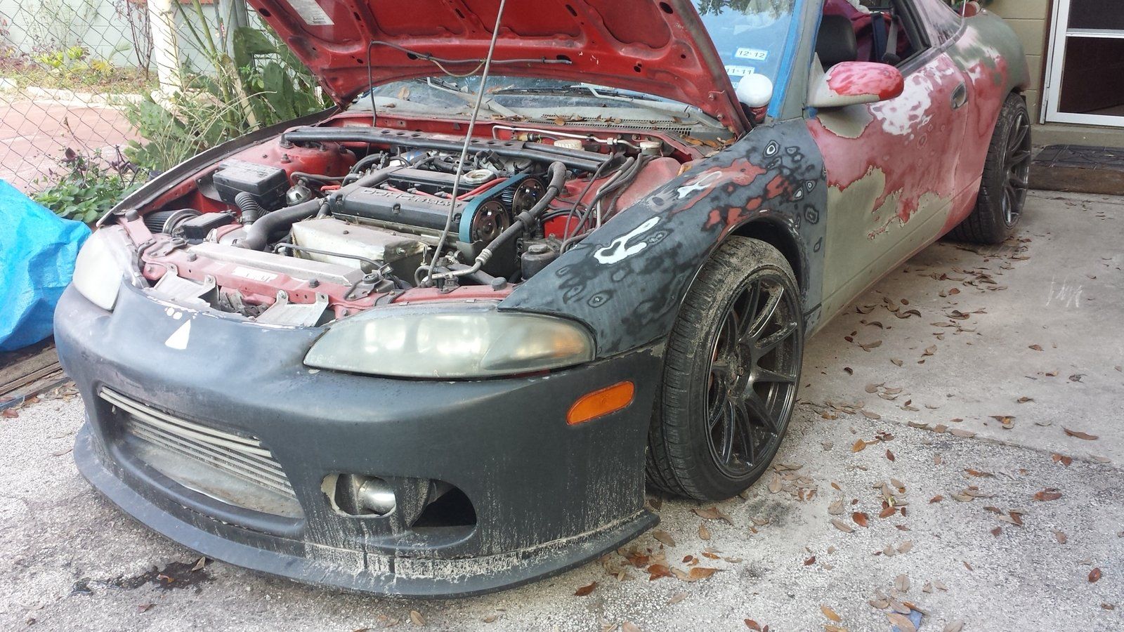

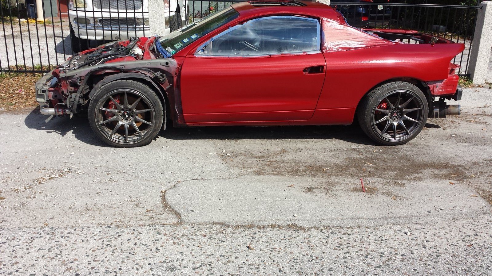

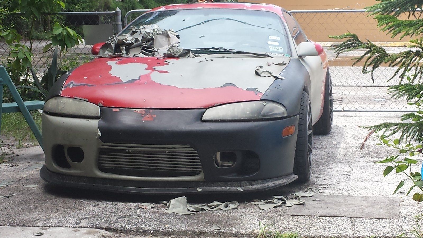

Now i begun to remove the cancer.
also meet up with a local at a junk yard that doesn't TAX the crap out of Dsm's

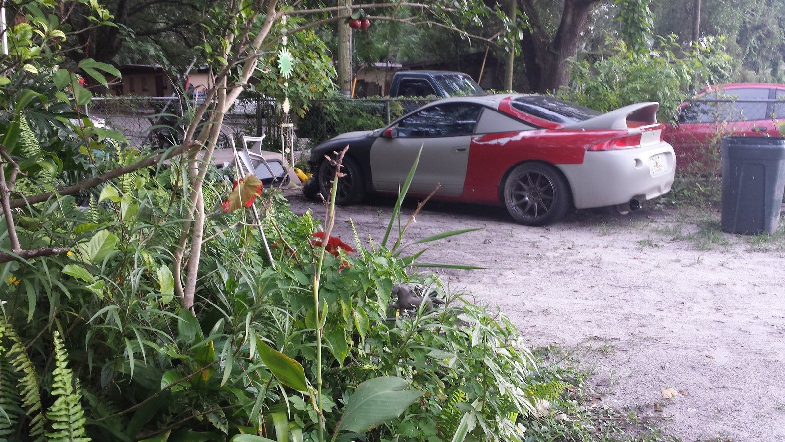

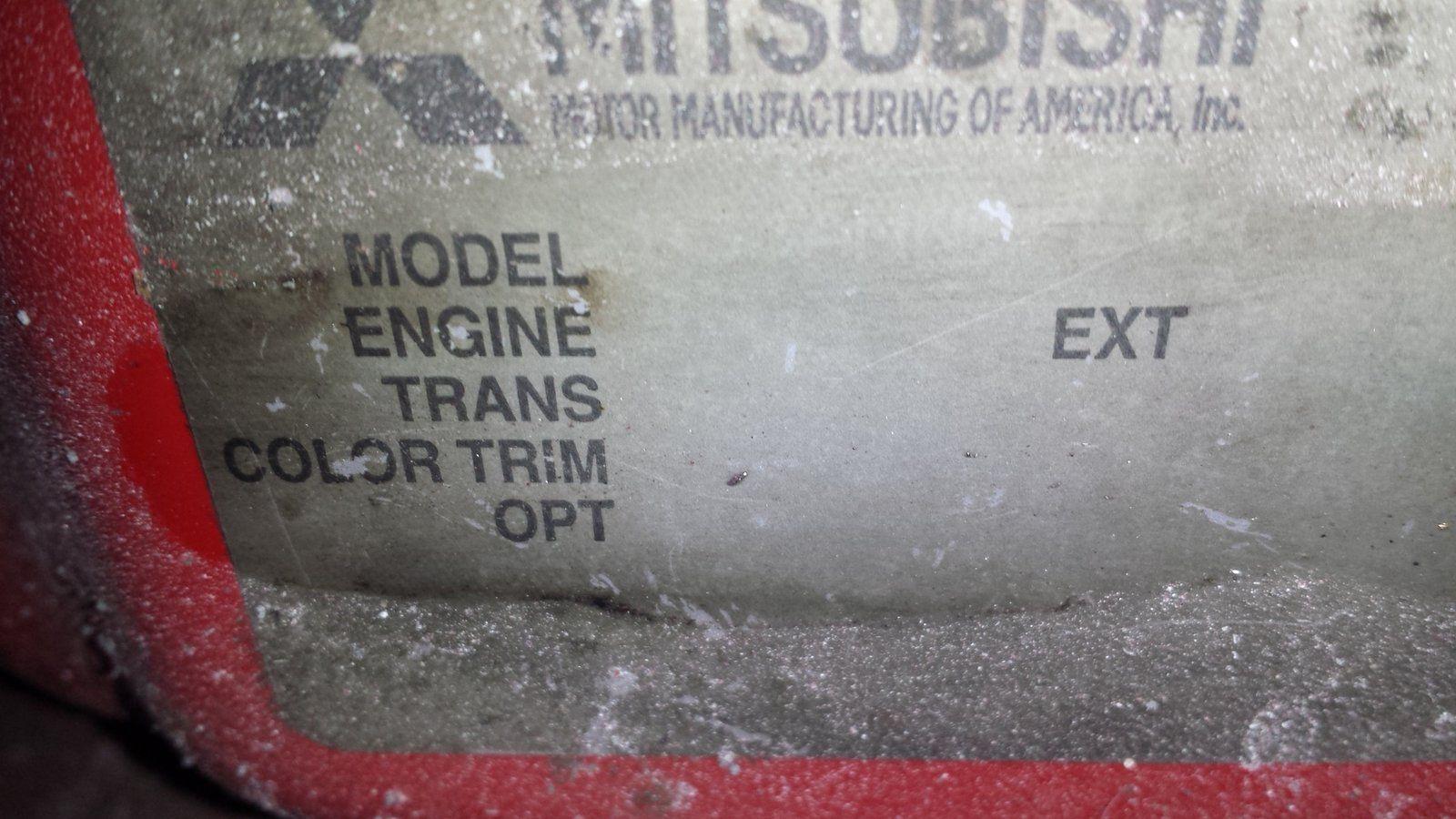

So science has proven men have a harder time distinguishing shades of red, and since i couldn't read the faded code on my wall i picked p88, which was the wrong shade of red. This has to be the best mistake i've made so far as you will all see soon.

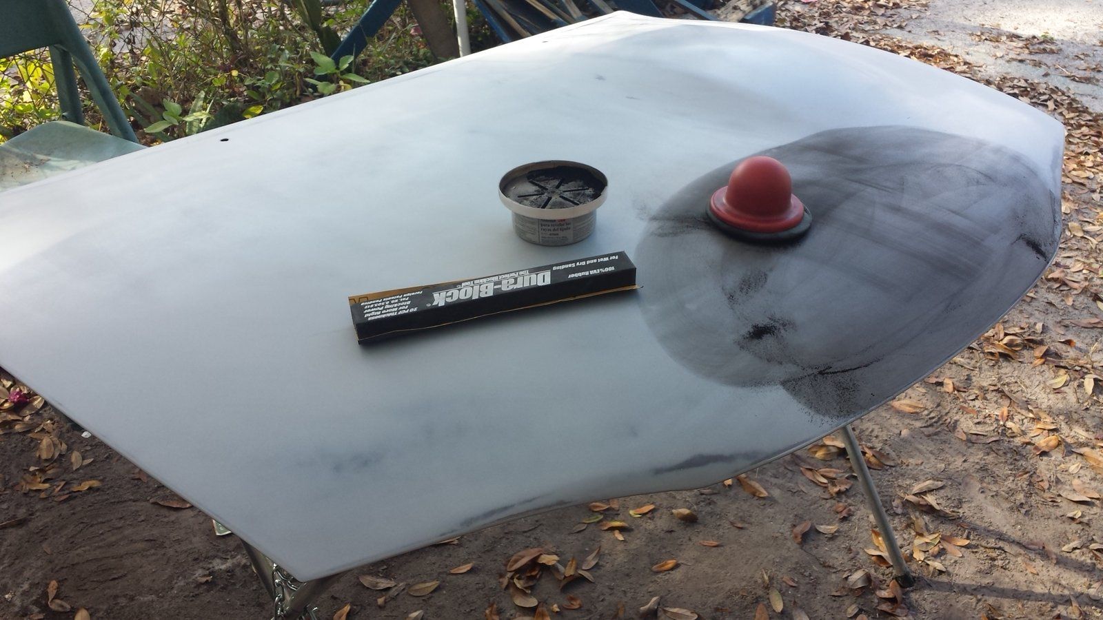

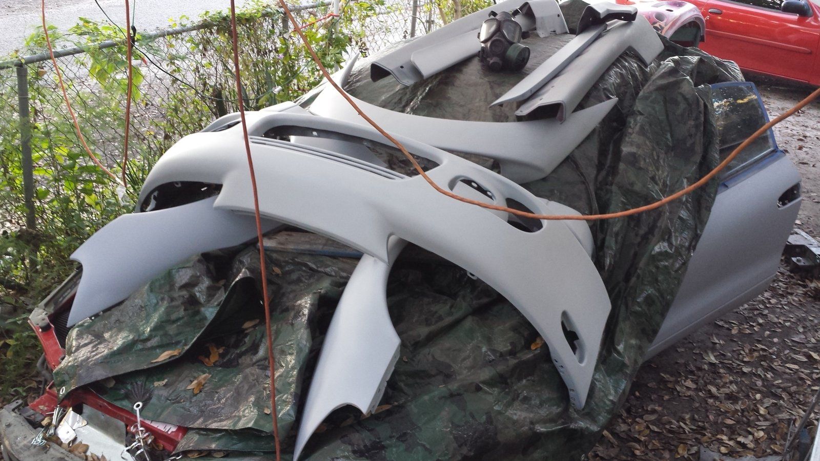

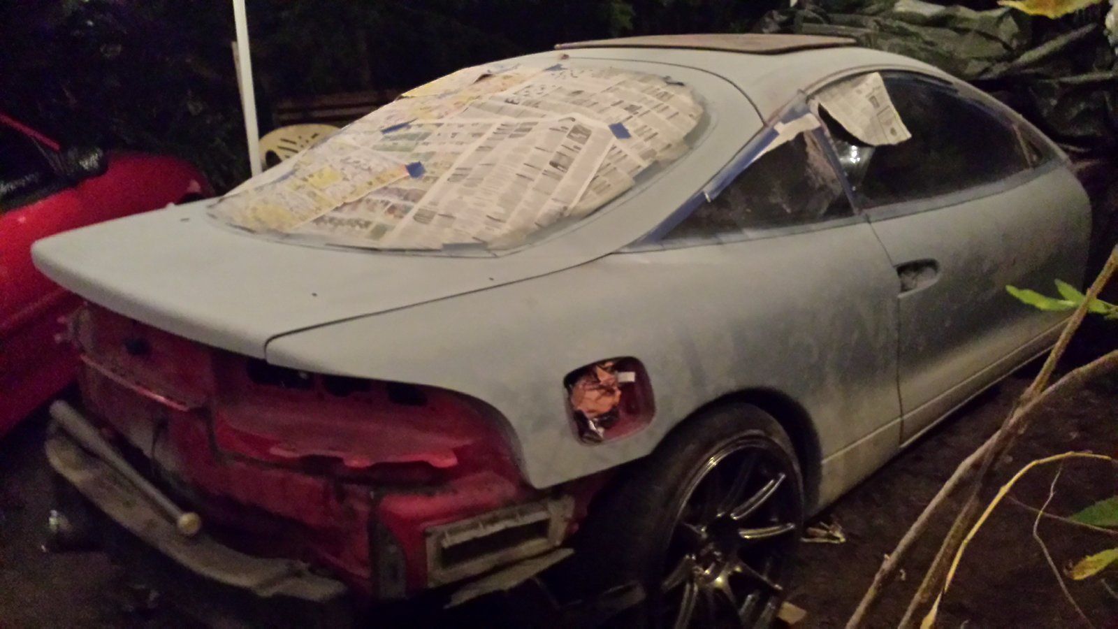

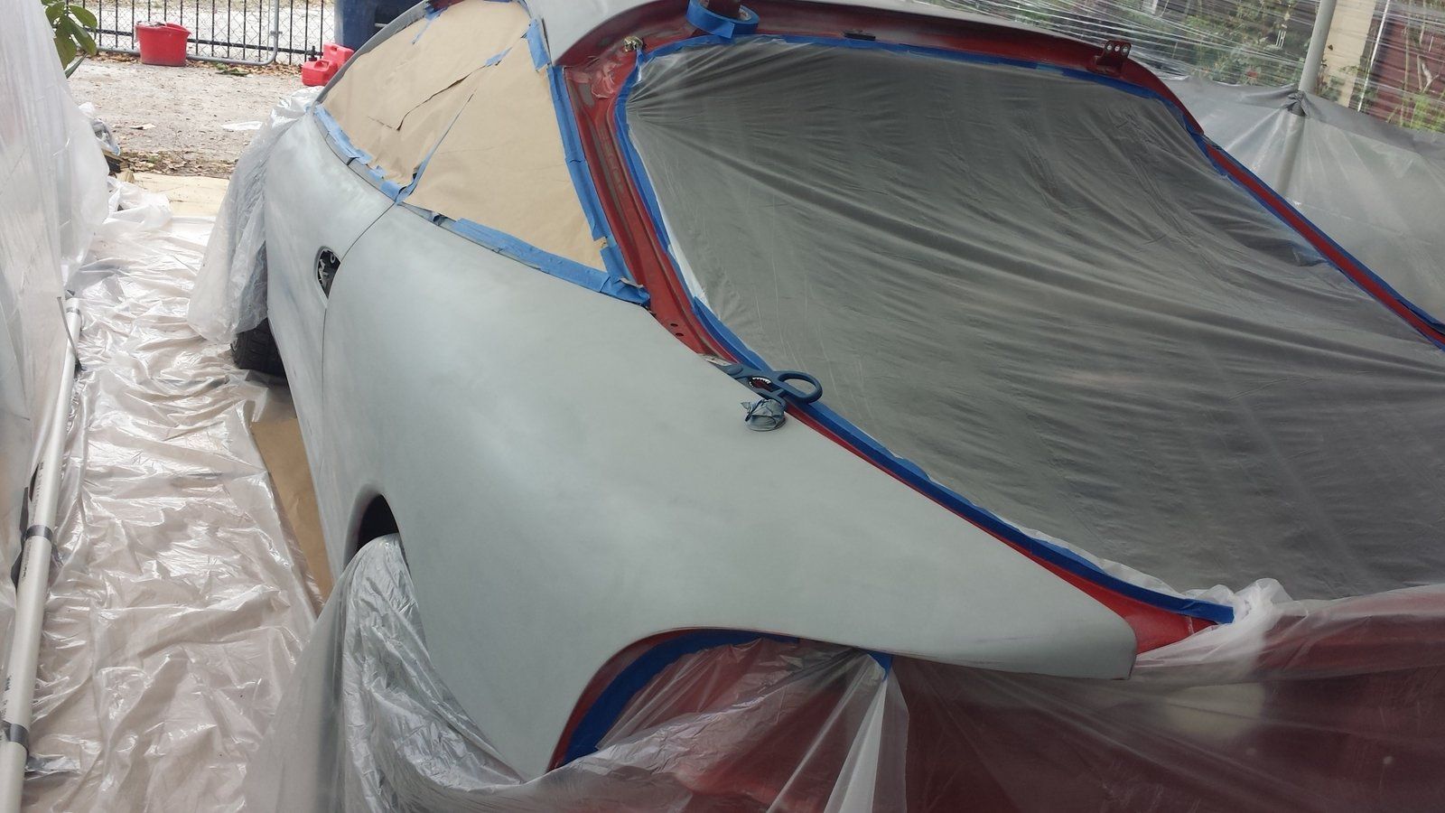

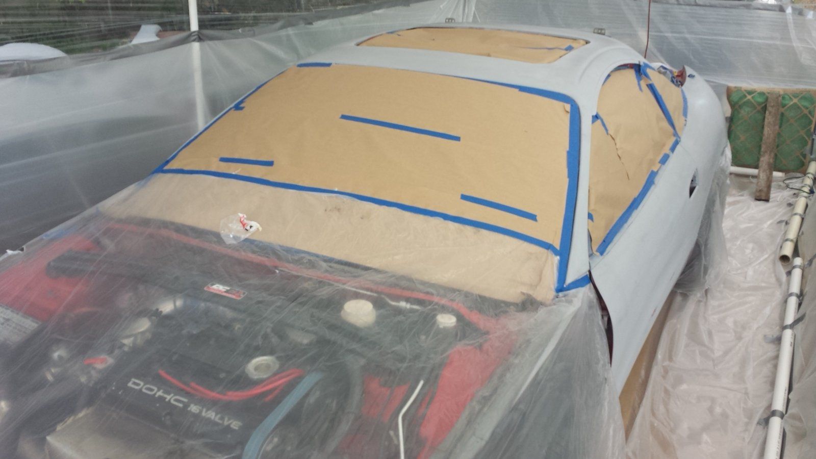

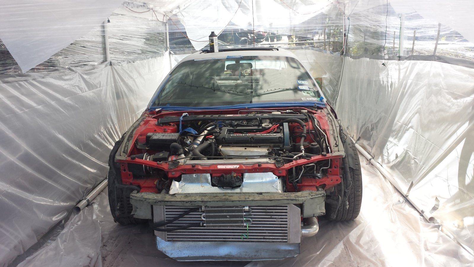

PREPPING FOR PAINT !!!!!!
YEAR (2015)

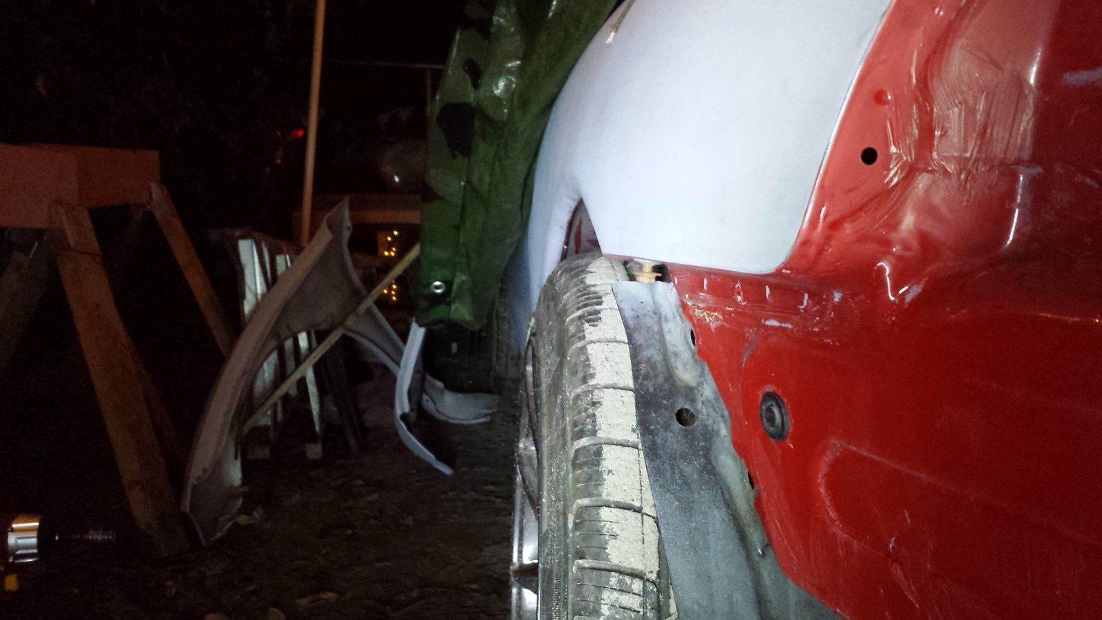

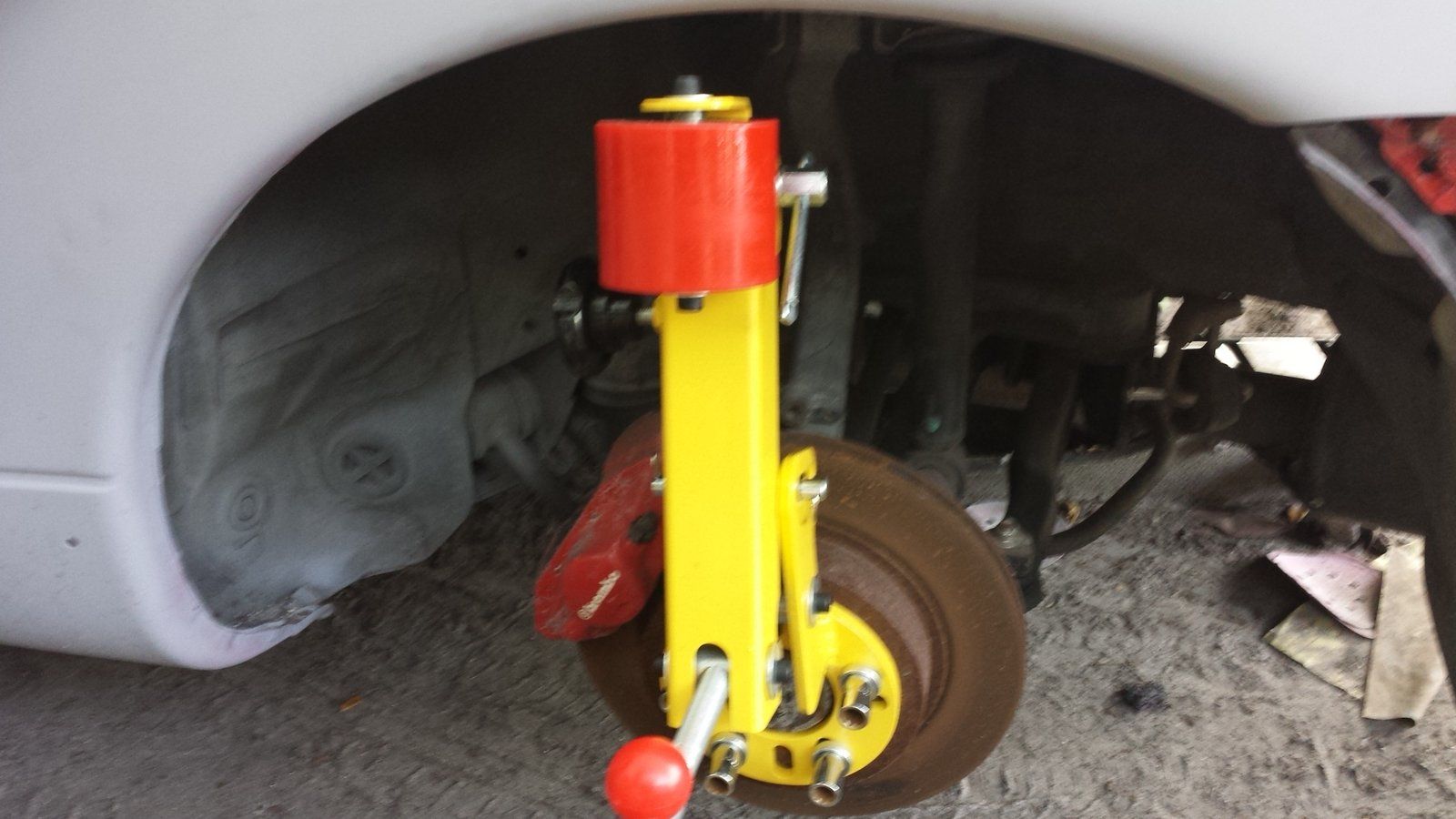

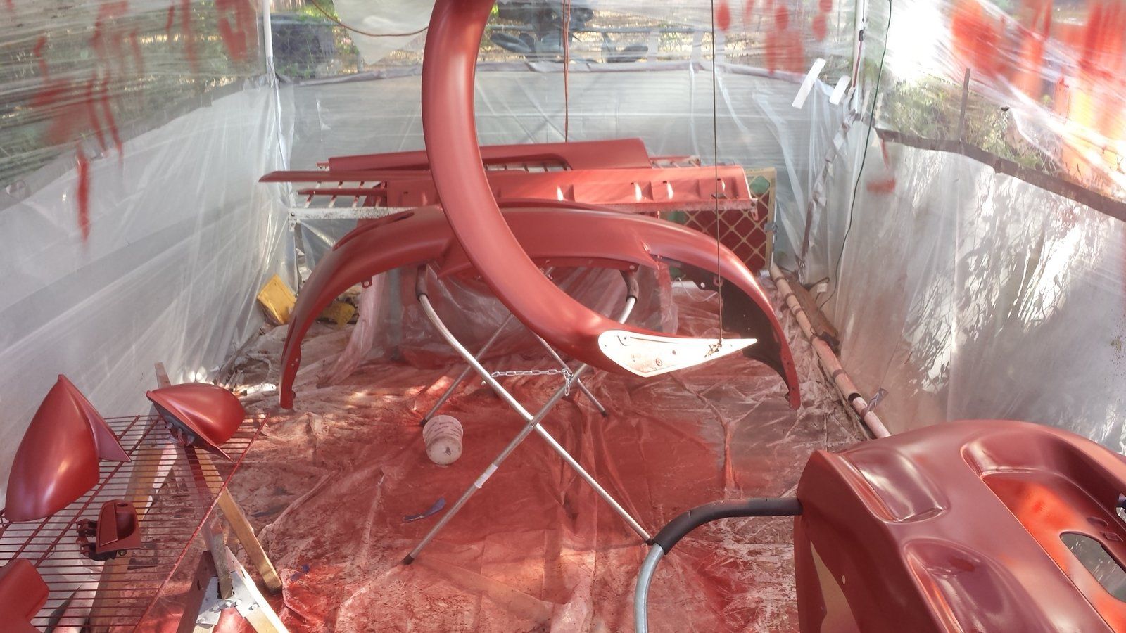

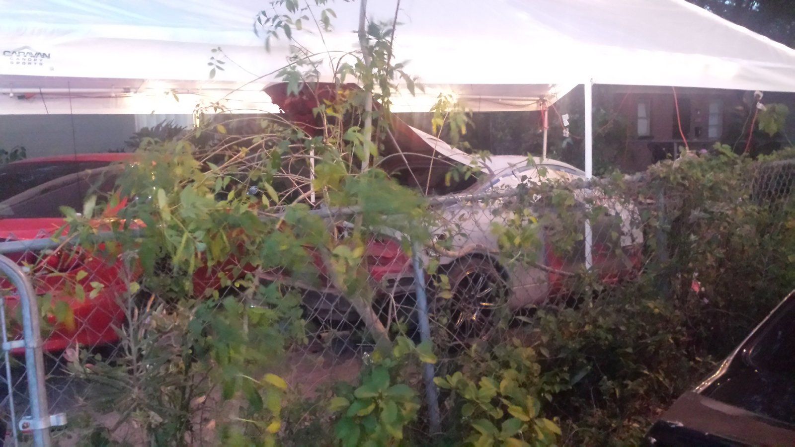

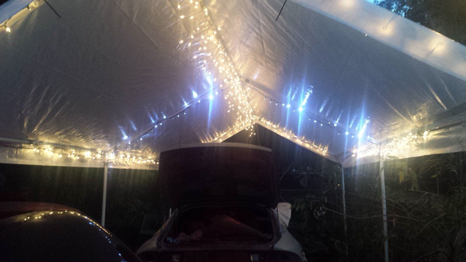

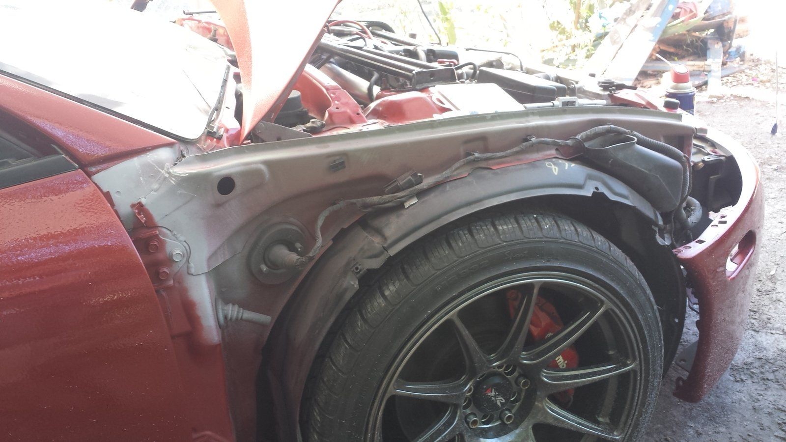

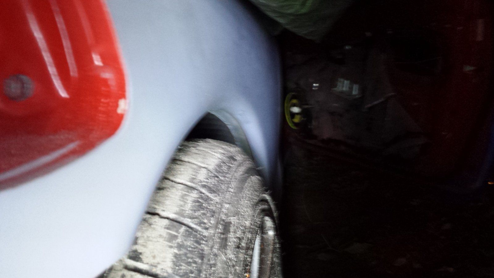

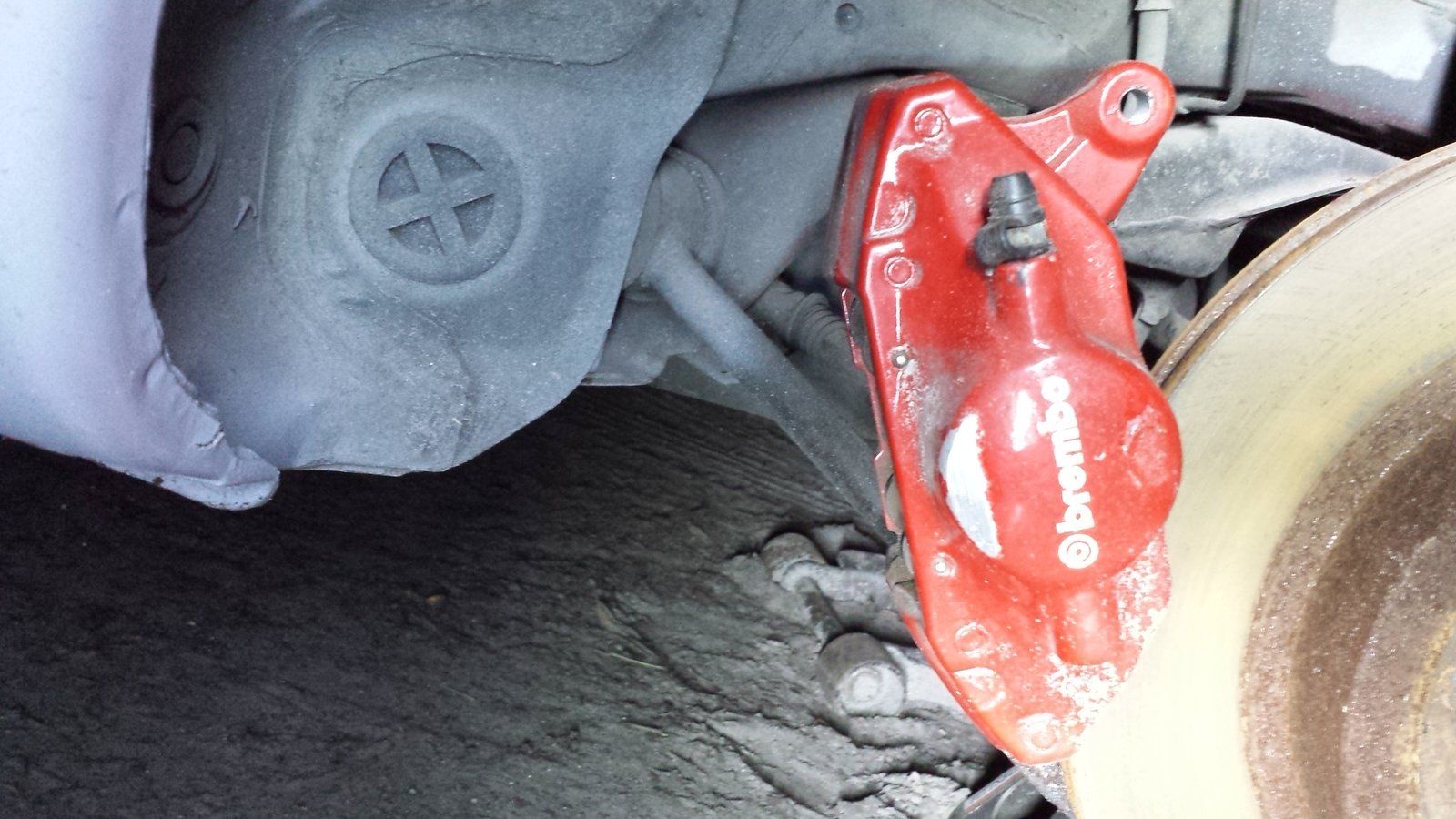

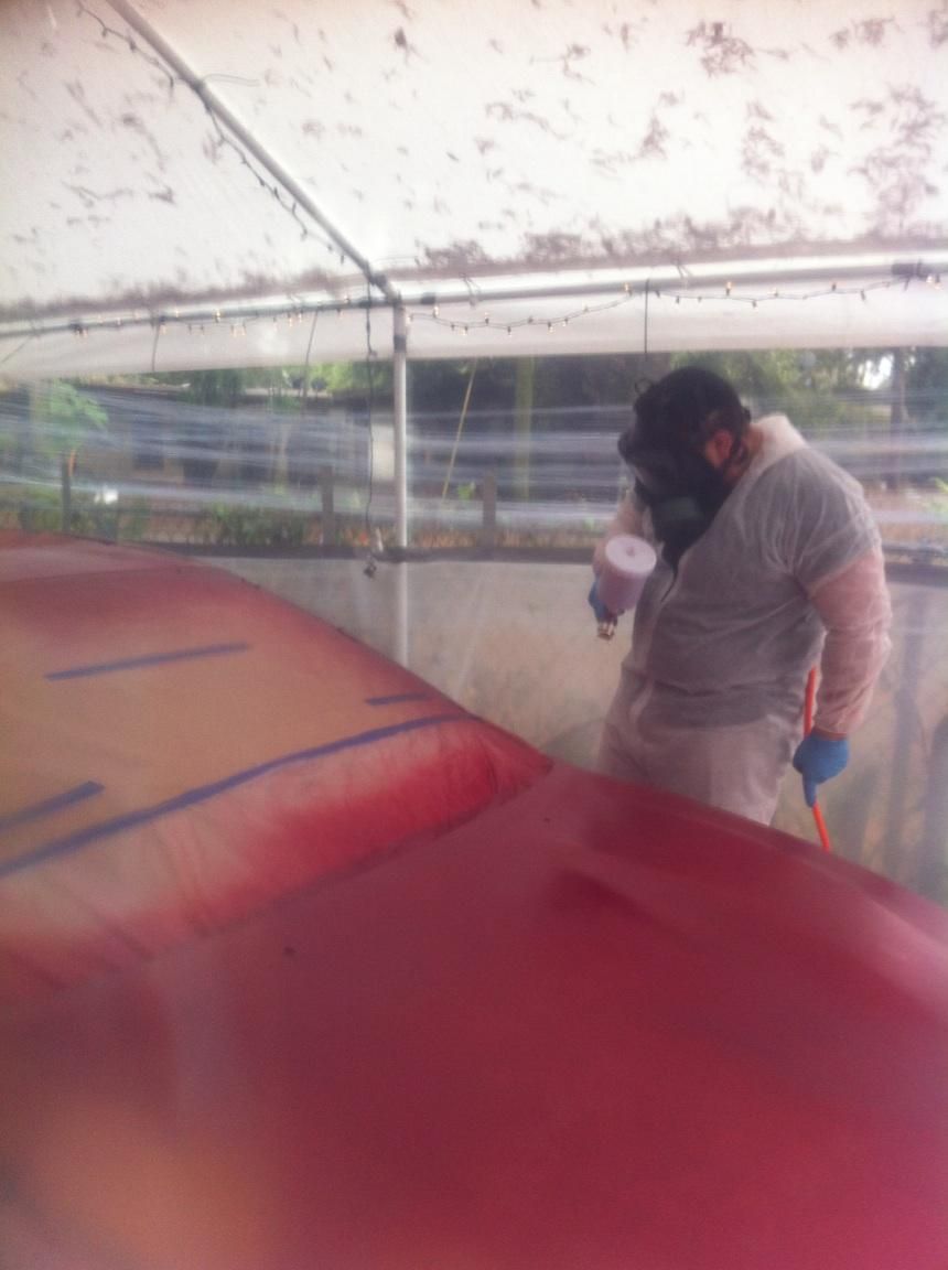

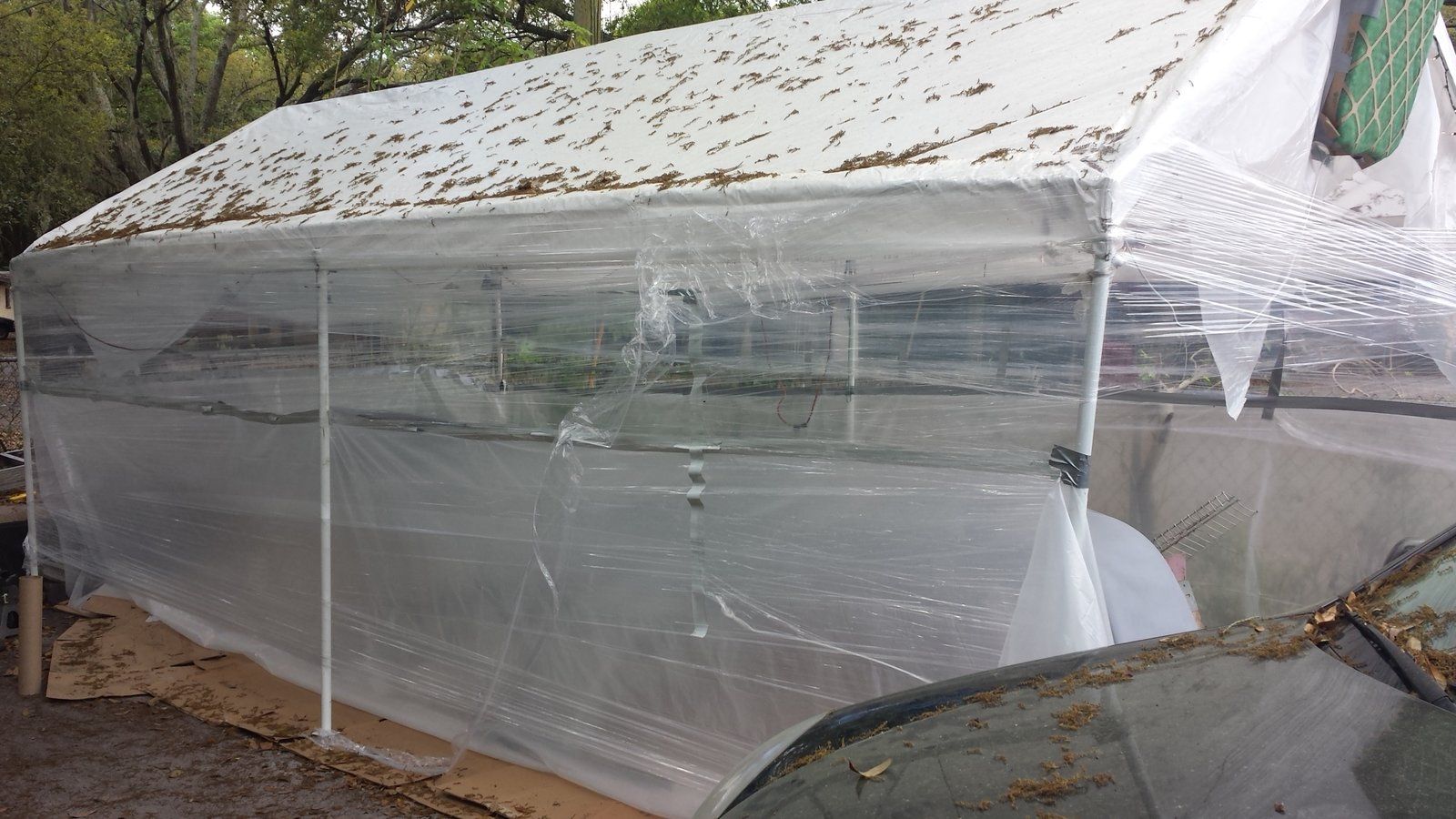

picked up a canopy to build a paint booth, also tried to use a fender roller to roll my rear lips, TOTAL FAIL P.O.S broke and shaved paint of my brembo, that's what i get for trying shit the right way, so i grabbed a mallet, a hammer and a rubber mallet and went to town, worked perfectly! no more rubbing on the tires.
Excuse the absence, lots has taken place; found a nice home for her out of the ghetto, to keep her safe. And since then.......

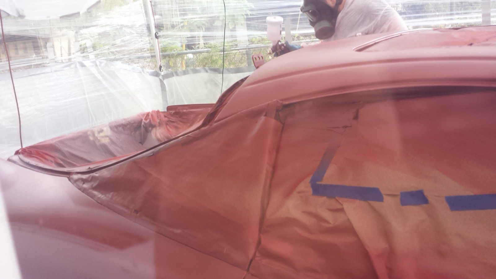

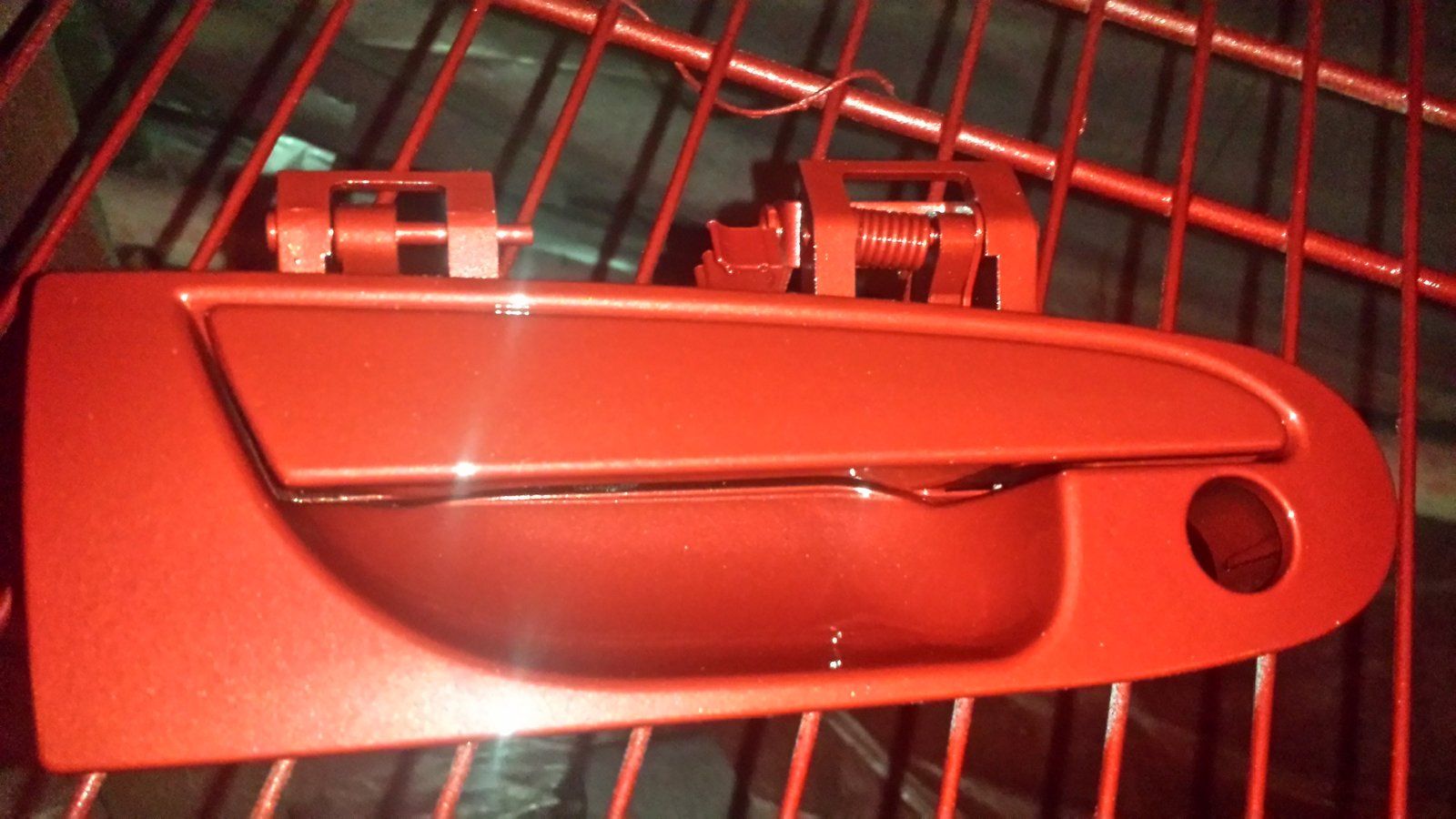

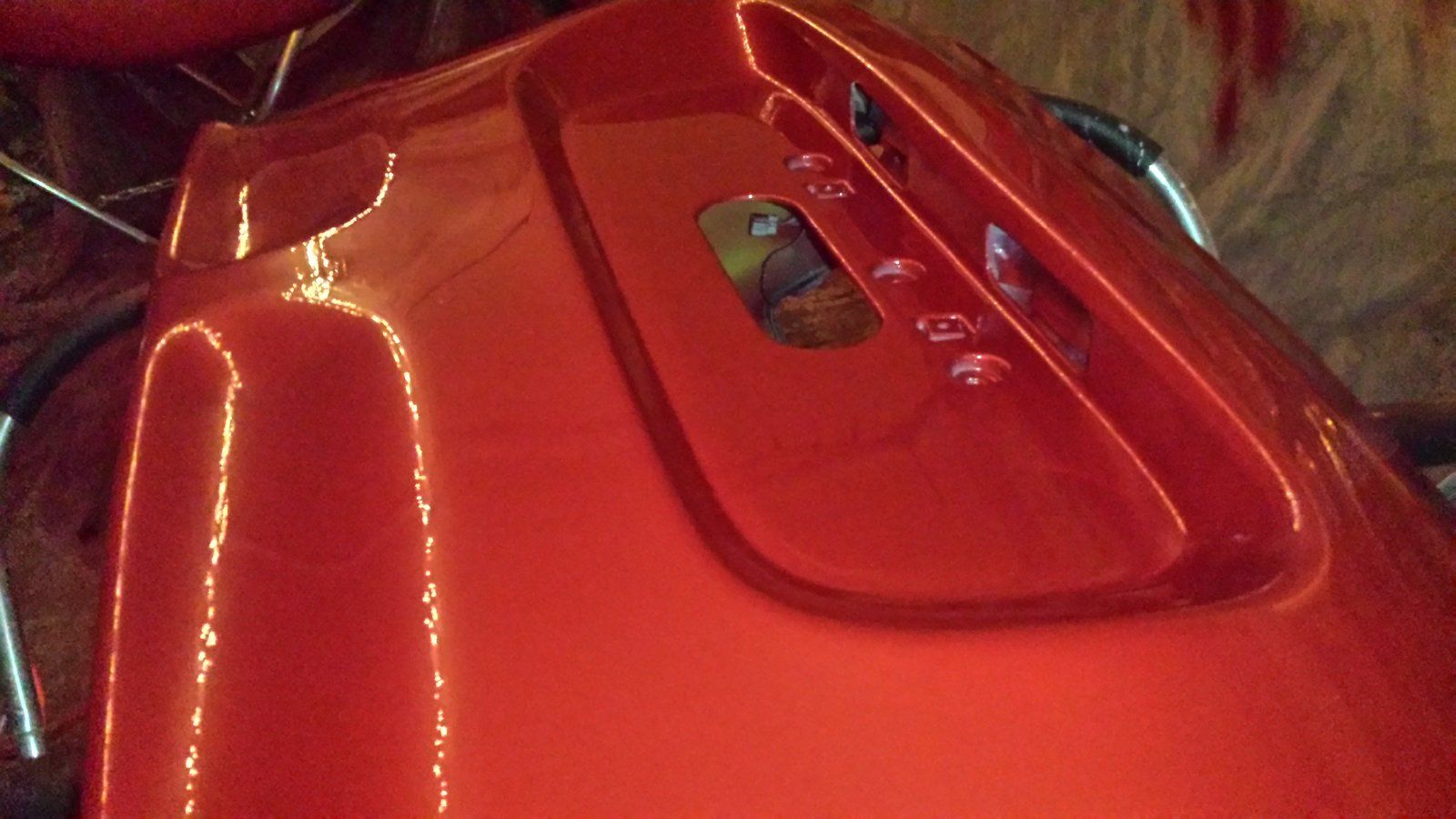

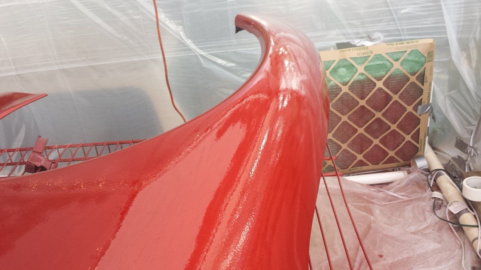

i had a bad valve regulator on the gun, so even though the paint went on well on the body the gloss has a bad case of peel. Ill re sand and redo in the future but for now it will have to do.

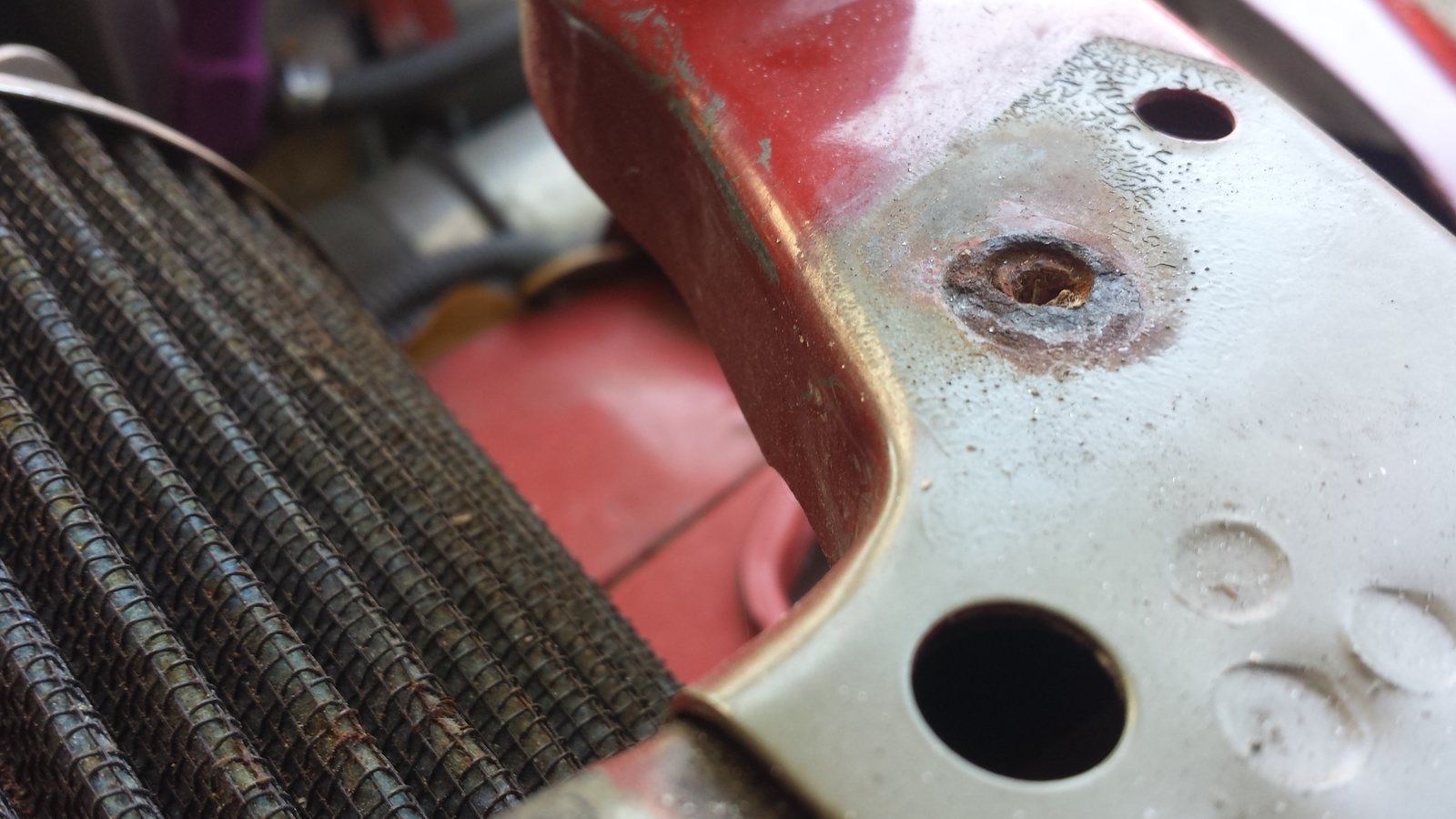

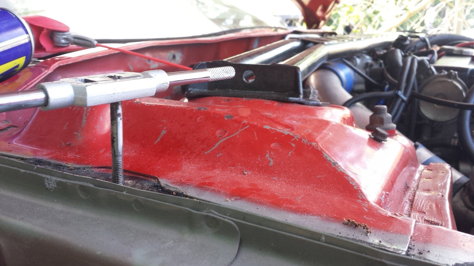

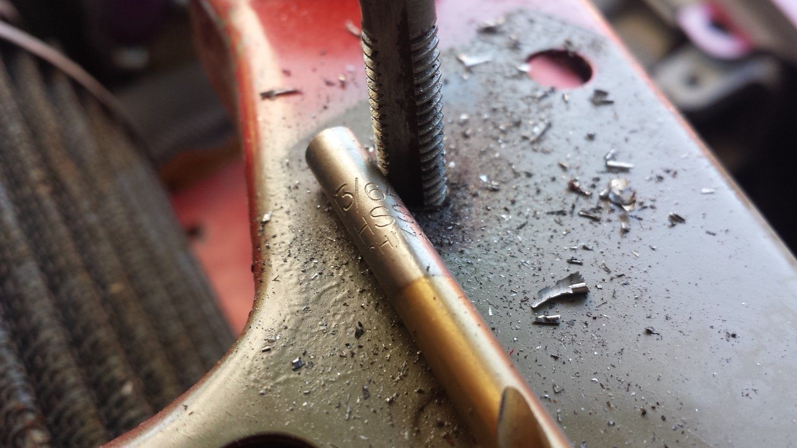

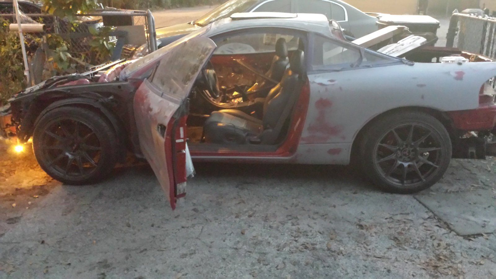

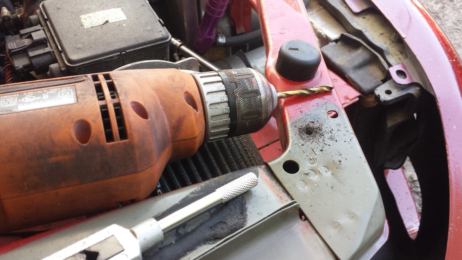

Since this car is... 1998-2015= 17yrs old now, all of the bolts snapped off upon disassembly.

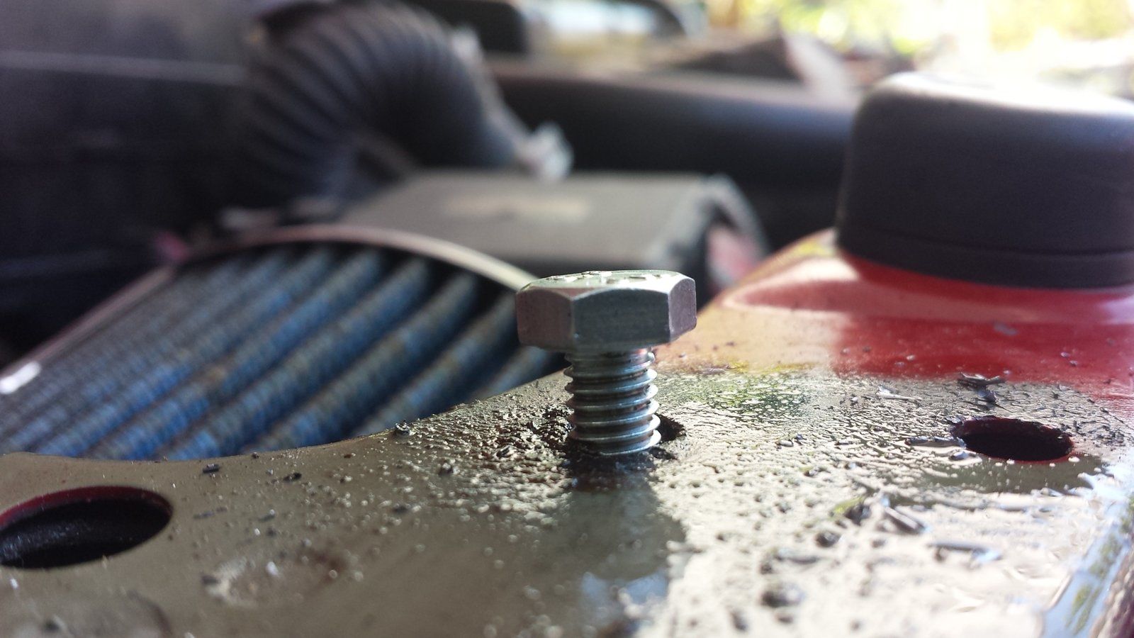

This is what i did to remedy the problem.
And DREW(Team Vanquish) thanks again brother.

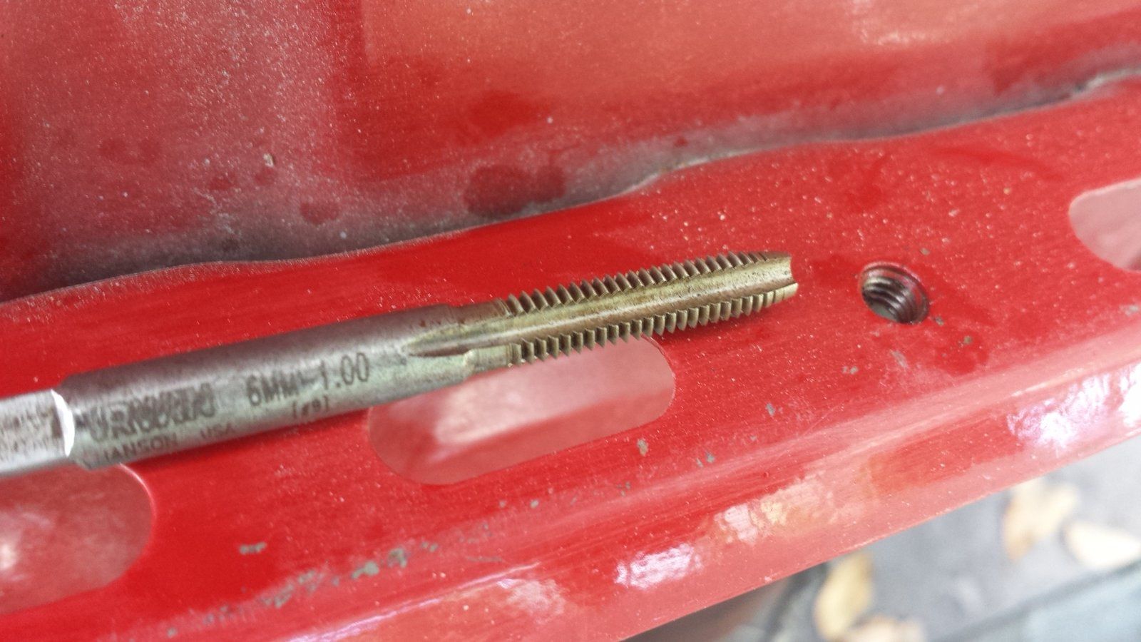

If any one finds this through google since i couldn't; here it is, the bolts for the body are m6x1.00+ w.e lenth you wish. You can use a 13/64 to drill first then tap.

see the orange peel?

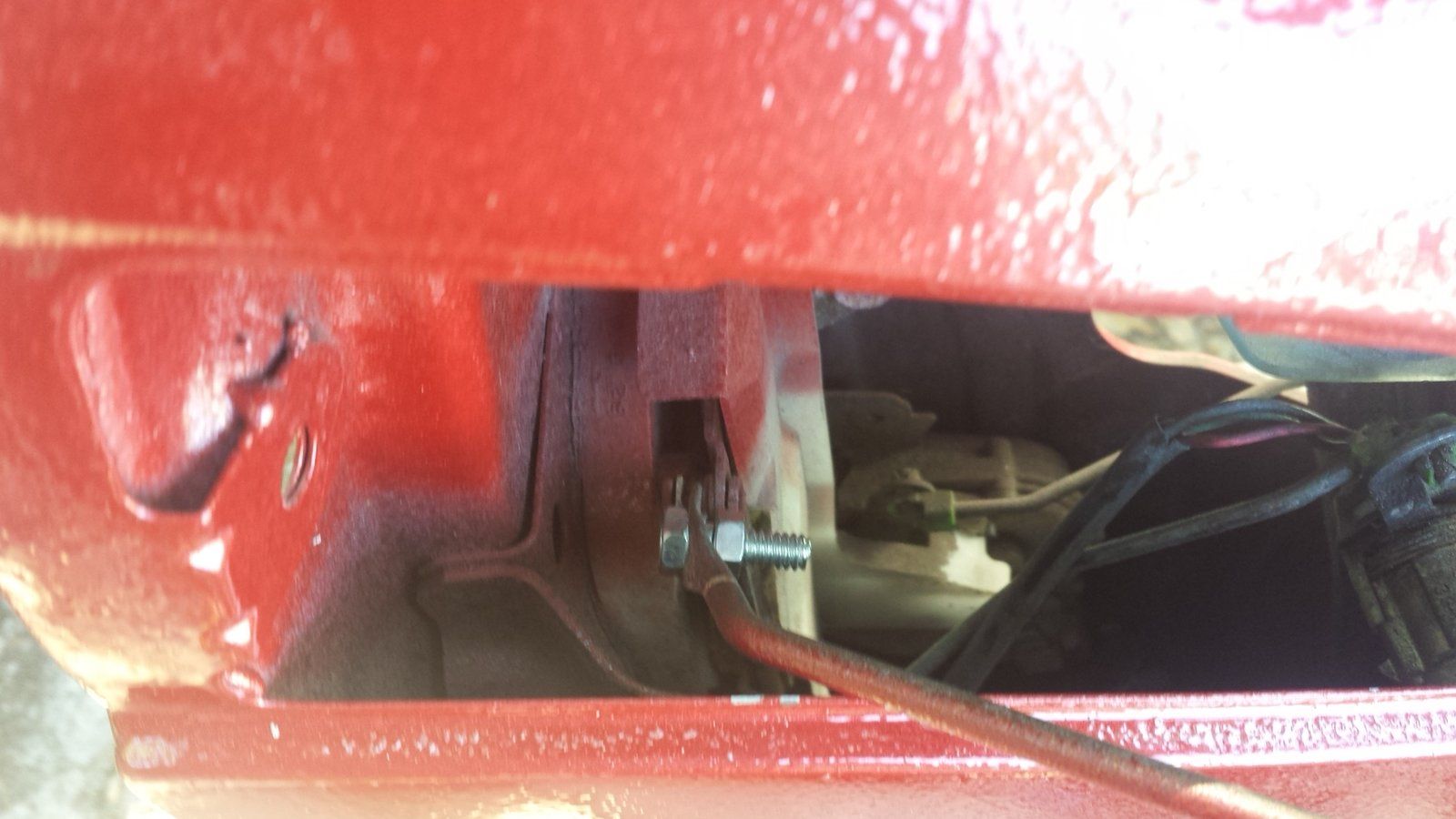

yeah, i also used a bolt/nut to reduce the pull needed to open the door since we all have this issue.

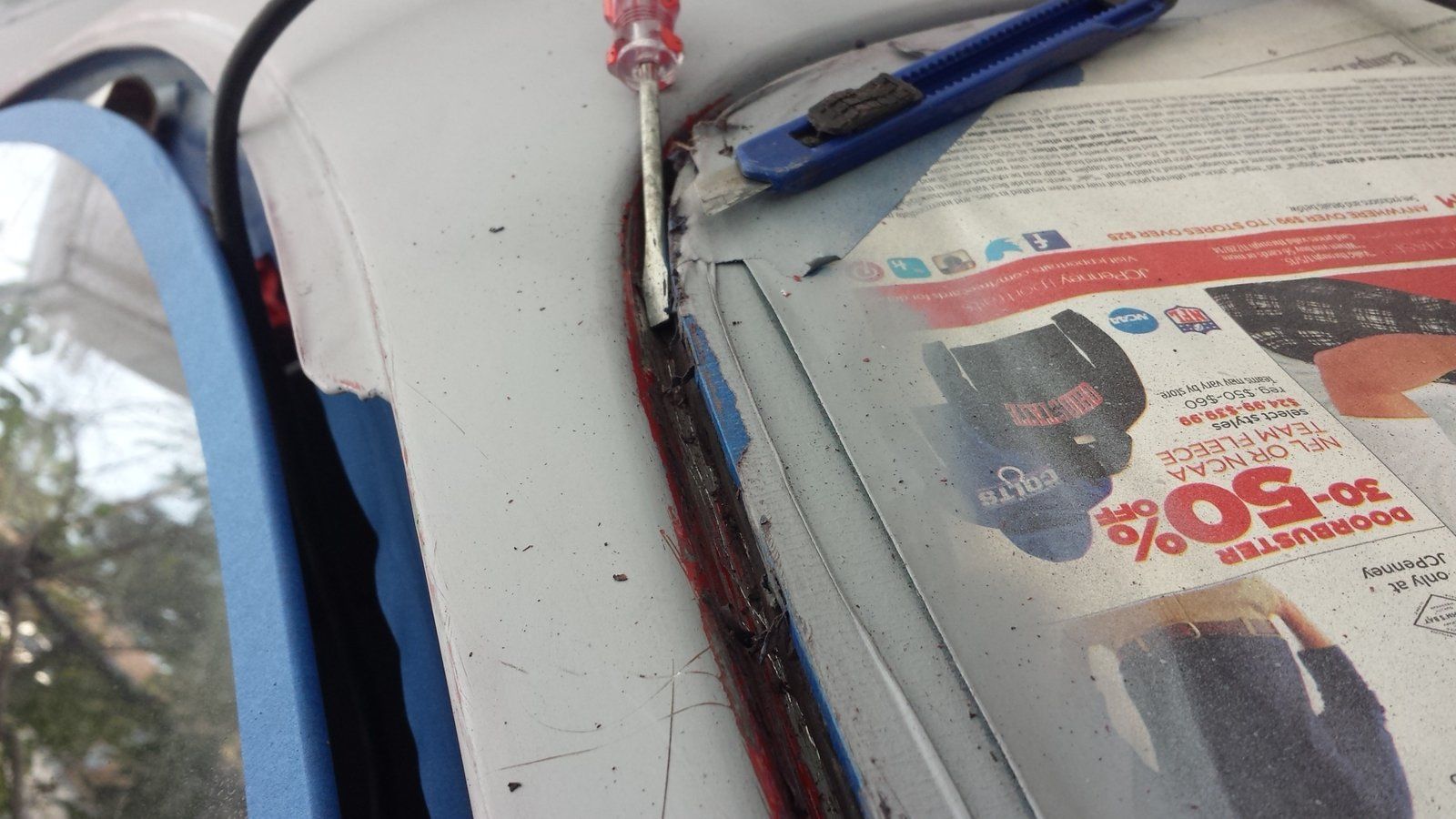

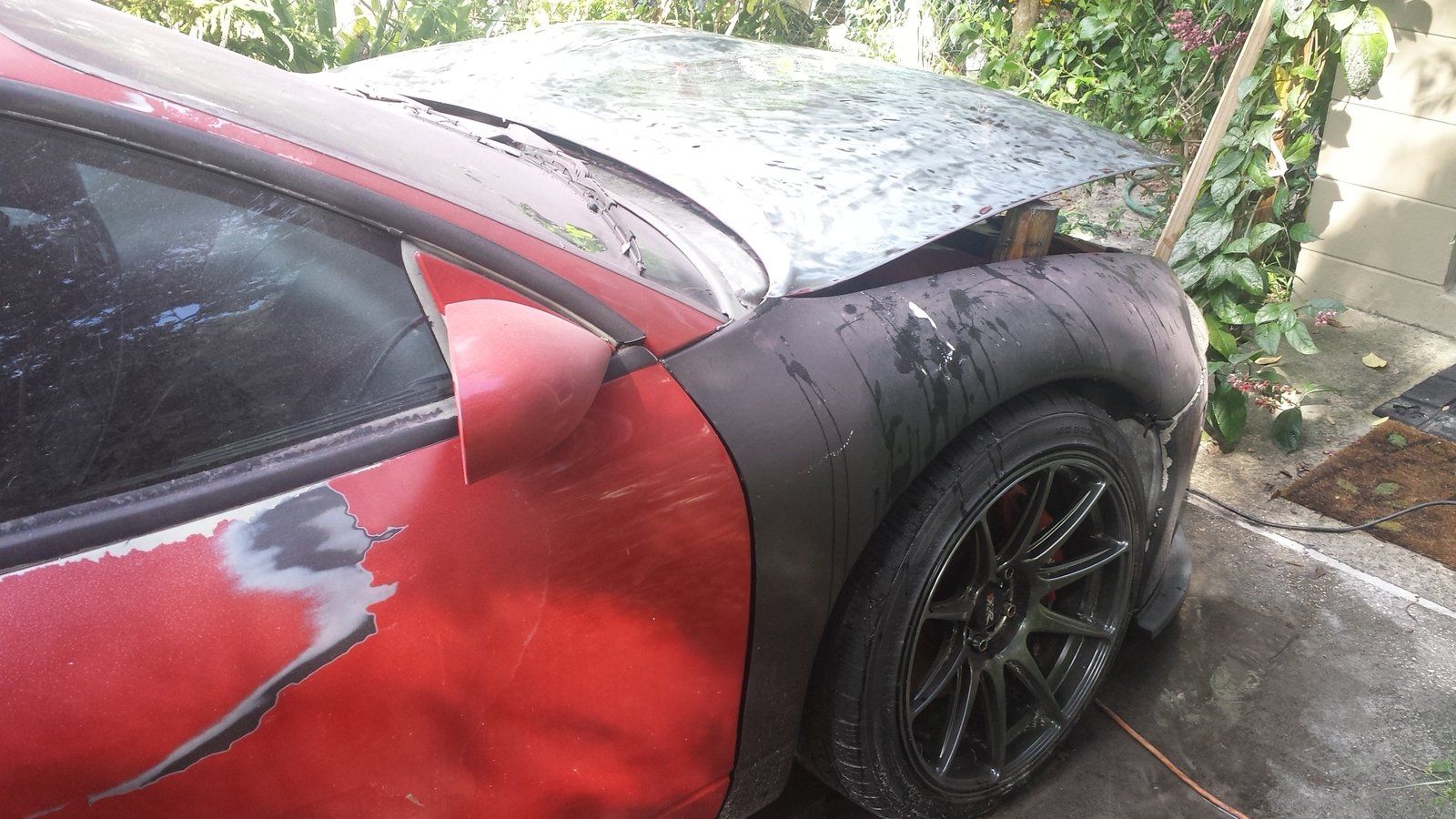

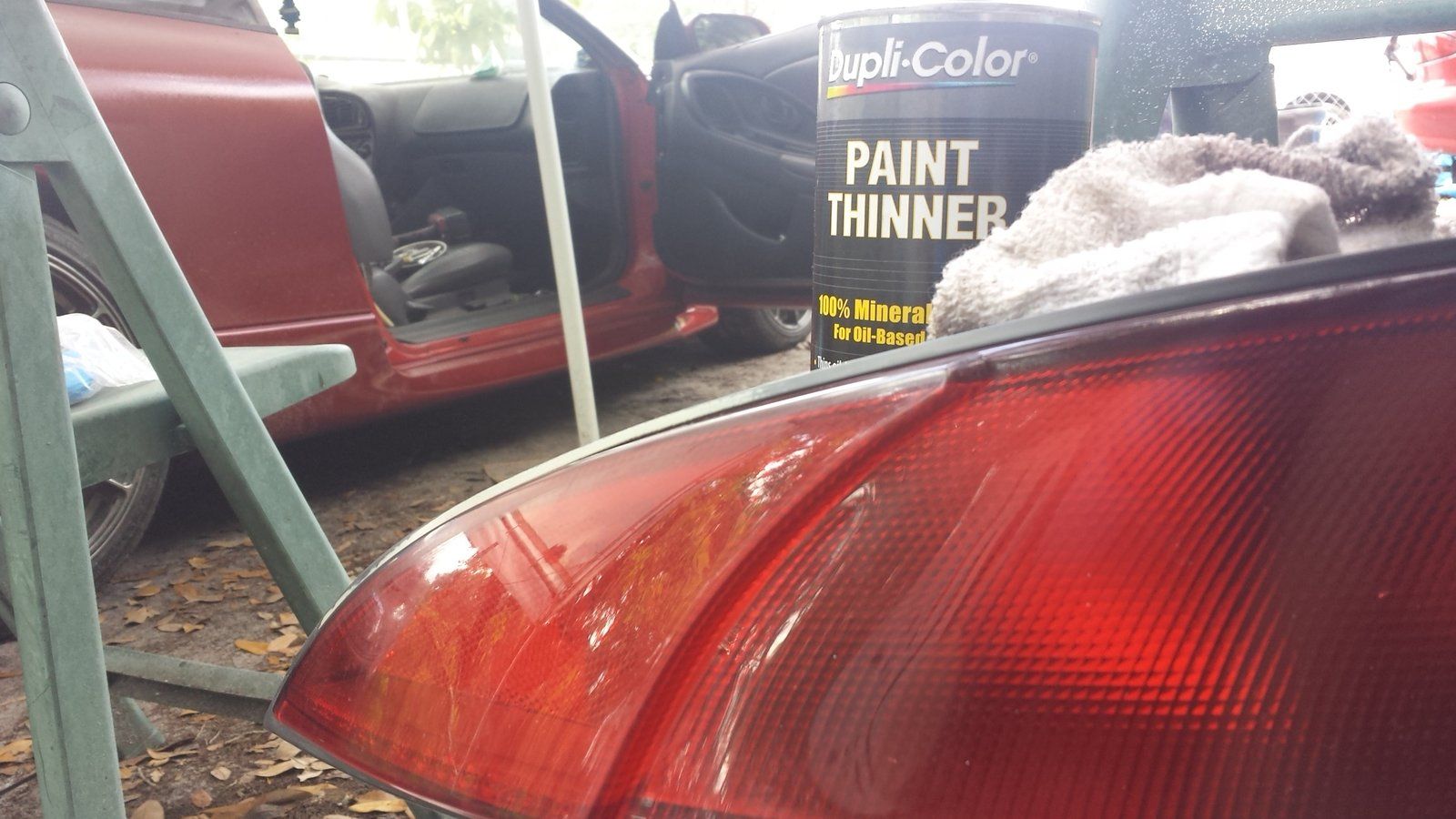

used paint thinner to rid myself of the leftover cancer, works well better than any of the other crap used on the internet.

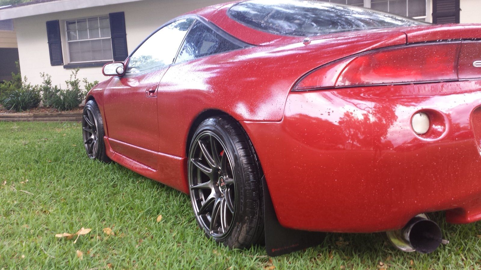

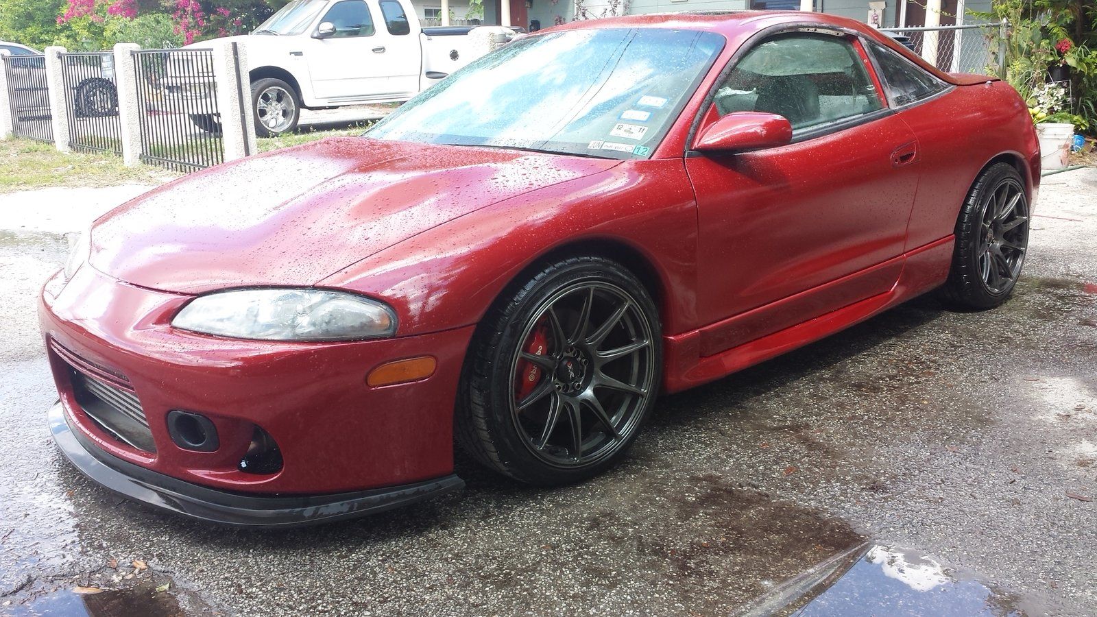

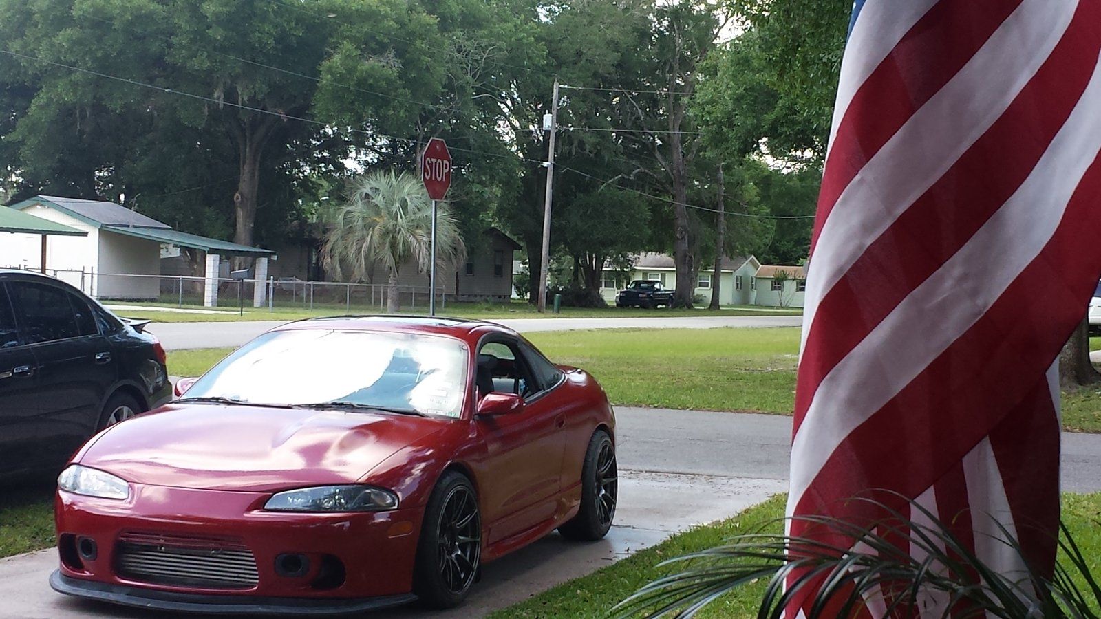

Alright fellow enthusiest, i said in the beggining that some of you may remember this name. RED5. well here she is.
Im a nerd too so here it is; like luke i to wish to become a jedi, but have only been a trooper thus far, so this is my X-Wing which will accompany me on my path.

My two favorite things in one pic AMERICA and my DSM

She just looks beautifull!
Do you have by any chance pictures of the inside of rear fender?
I would like to have an idea on how much i can hammer it ;)
thanks man,
Scroll above to post #29
But you can go all the way till you completely folded it againt the body...this may not be the best option for you, I was primered then.

As far as the orange peel goes, your problem is the Harbor Freight paint gun you used. I use that same gun for painting little stuff like engine brackets and parts for small projects. I use the Harbor Freight gun when I don't want to dirty up my nice gun.
The problem with the Harbor Freight gun is it doesn't atomize the paint very well. It ends up blobbing the paint by the time it hits the panel, and at that point it's no longer covering evenly. As a result, the paint builds in some areas unevenly which causes that excessive orange peel look. Regardless of the paint gun used, this always happens to some degree, hence having to wet sand and buff a fresh paint job. Just with a cheap paint gun that atomizes poorly, the orange peel effect is more pronounced. That's also the reason you pay $300+ for a quality paint gun. Most people who don't work in paint shops don't own high end painting equipment, which is also why most people don't paint their own stuff. For a job like this, it's always good to ask around and see if you can borrow a nice gun from a friend or something rather than buy one. You can also find good deals on Craigslist. You may find an autobody guy unloading stuff or getting out of the game. That's always a good scenario to get a good deal.
If you wanted to correct the issue, you do have some options. You could sand the car down to the color coat (assuming you applied a clear coat) until you knock the high spots of the orange peel. At that point, apply a few light coats of color with a better paint gun, followed by a few coats of clear.

don't worry, i like the constructive criticism, unfortunately i must say i believe your argument to be less than factual, see when i tossed the valve and sprayed the body parts separated without the valve i got no orange peel, so yes even though it's a cheap gun the root cause is the valve not the gun.
And ill be sanding it down(getting rid of clear) since that is the orange peel not the paint, paint came out fine.
I assure you, the root cause of your horrible orange peel is that cheap a$$ paint gun. If you've ever painted with a high end gun, you'd see the difference. On smaller parts, the effect is less obvious. On the larger panels though, it's easy to see. You'll save yourself a lot of work sanding and buffing of you upgrade your paint gun, I promise.
Even in this photo after you said you wet sanded and buffed, you can still see the effects of the orange peel. You probably won't be able to buff that level of imperfection out until you sand down to the color coat and respray the panel, which is why I suggested it. Again, I'm not knocking your project. I'm just trying to give some friendly advice for next time, or whatever.
