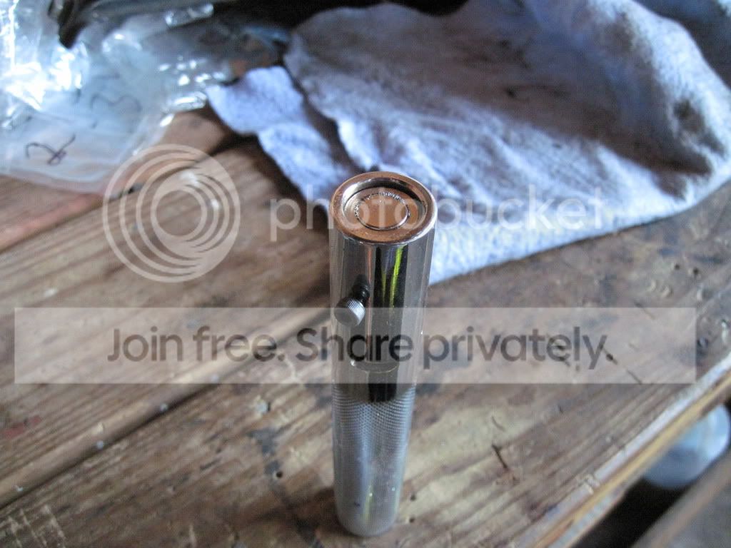

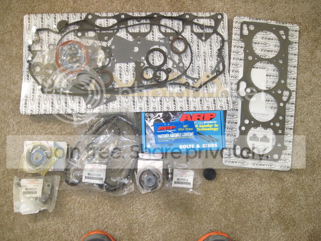

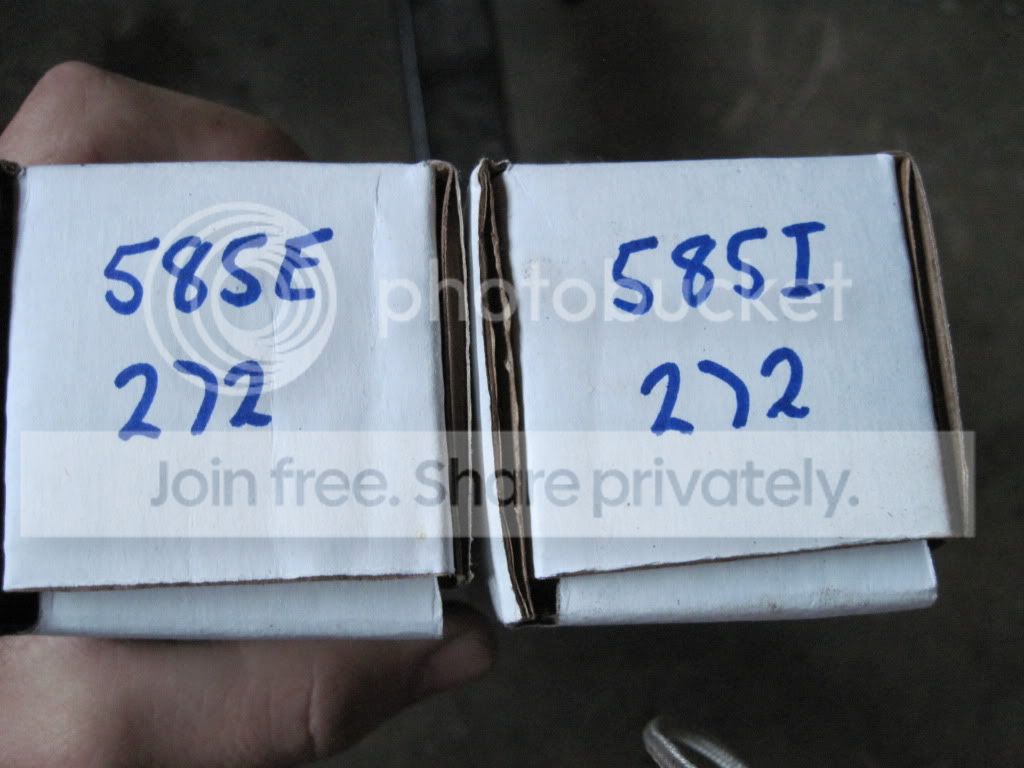

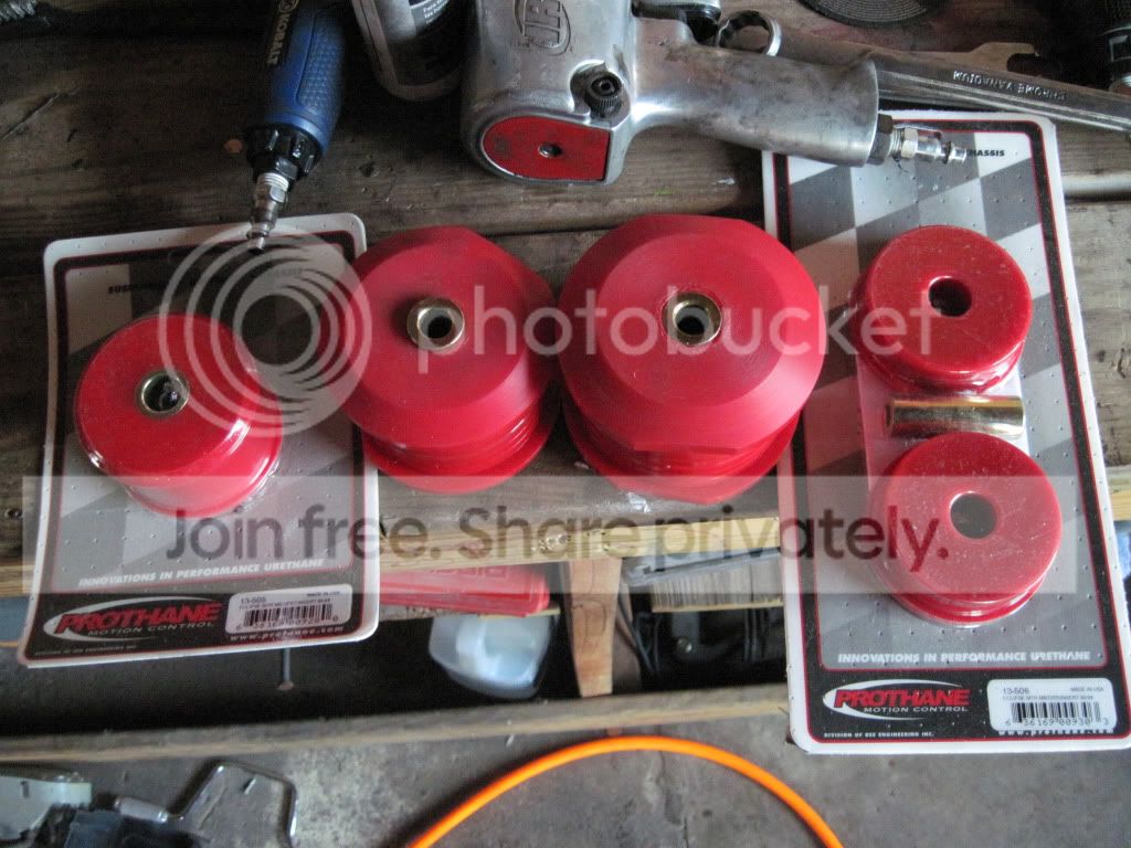

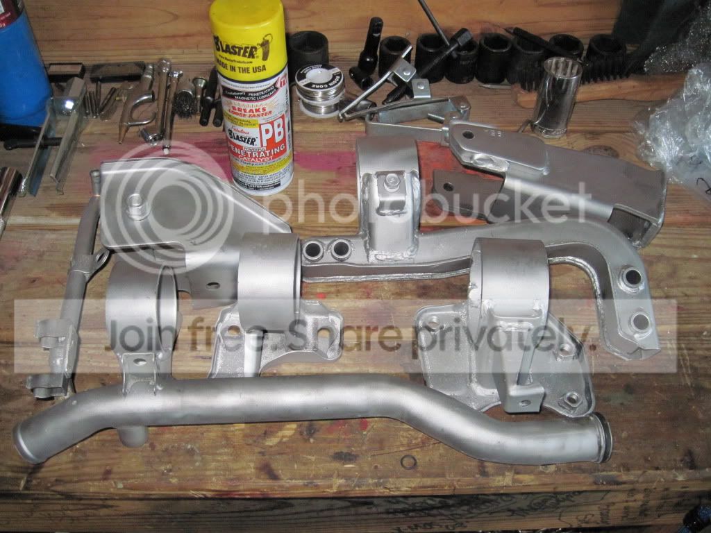

So I have been able to get a few things done. I got a puller and pulled the motor. Pulled all motor mounts, removed the rubber and had them media blasted so when they get the New Poly's they will be nice and clean. I got My arps and Cometic gasket also got a gasket kit and BSEK. Also received Delta HKS 272. I was able to get the final measurements for the tranny and I will be ordering the shims so I can reassemble the tranny. I bought six shifter base bushings and rebuilt my shifter base. They (mitsu) told me I needed two $1 bushings and four 10$ bushings. I bought the two $1 and guess what they work all the way around so I ordered four more. I have also been looking into Springs and Retainers and I ordered this tool off ebay for removing the keepers. It was $14 and seems like a decent tool I will give a good review on that this weekend. Any and all advice on things to look for upon disassembly would be very nice. I will be tearing the motor apart this weekend and any and all advice would be nice.

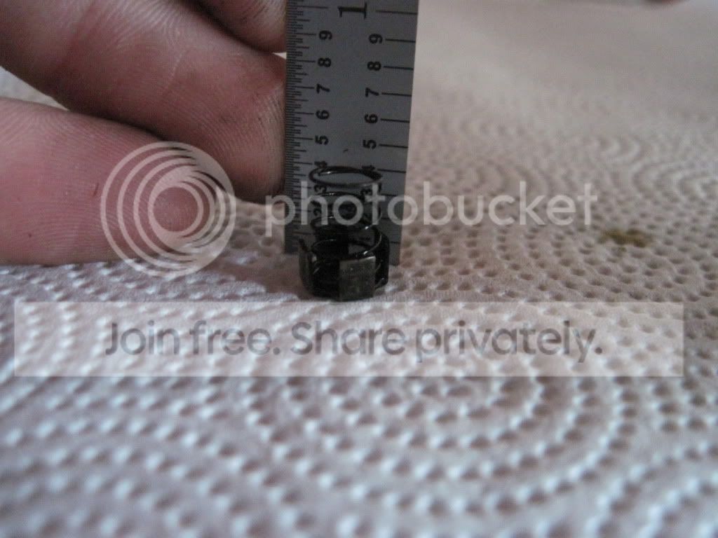

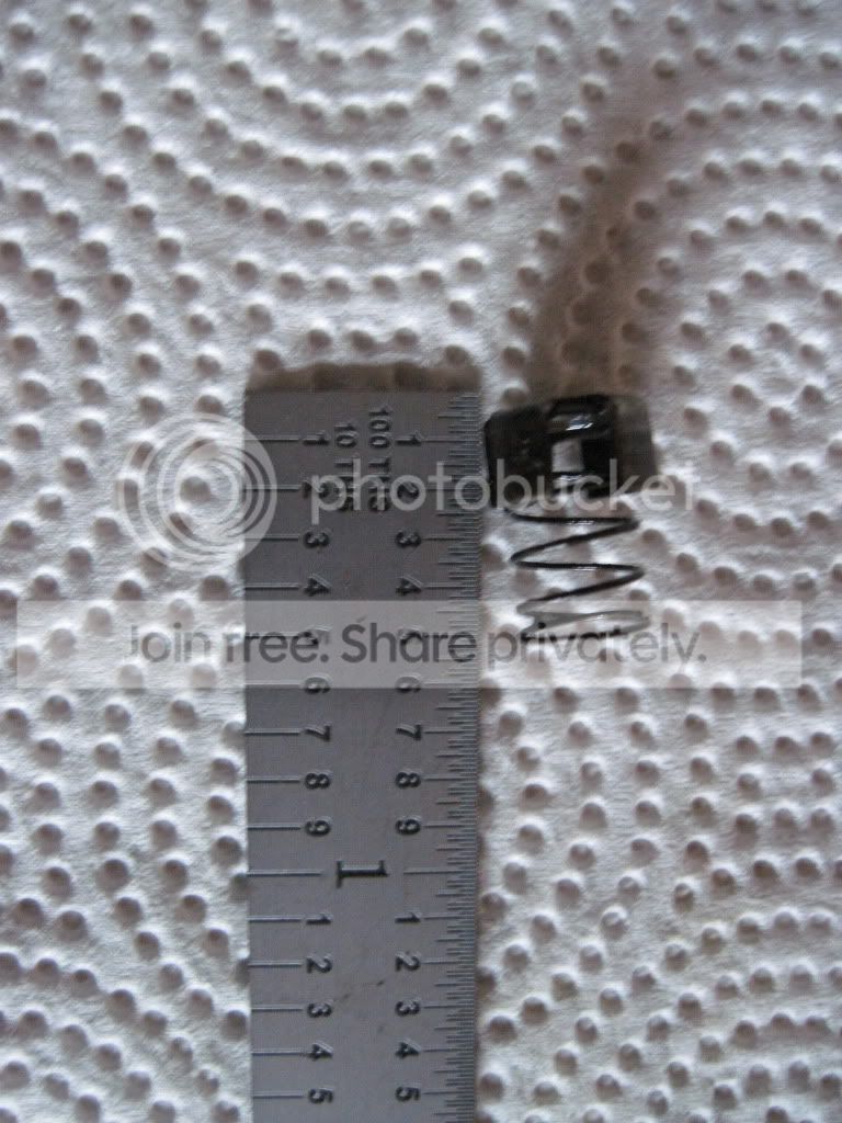

WHAT IS THIS??? DOES ANYONE KNOW??
I don't know the name but there is one of those in the slave cylinder, It shows it in the hannes manual. It goes in the hole for the clutch line.
Thanks I just rebuilt the slave as well so That it is a good chance. Thanks for replying and I will make sure it goes back in its place. Thanks again
