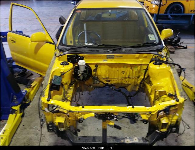

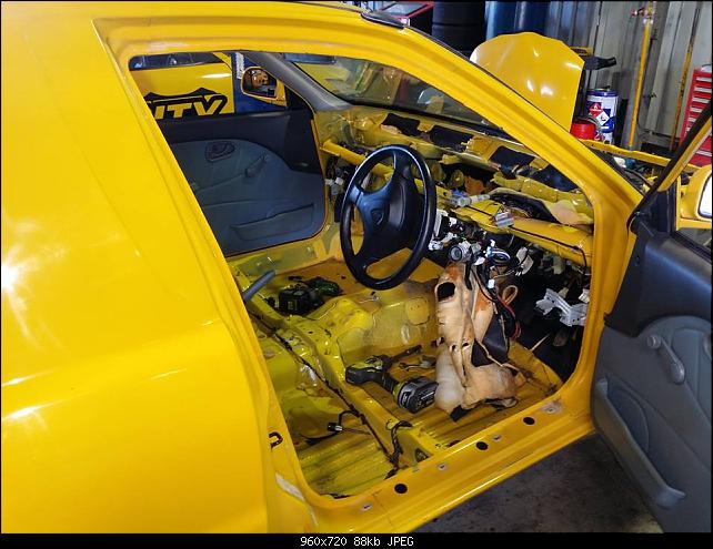

So the fun has started, I have taken everything out and weighed it along the way.

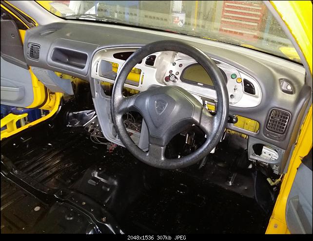

I took out all unwanted weight (sound deadening, power steering, air con factory seats)
The old 1.5 liter engine was removed along with all other unwanted bits

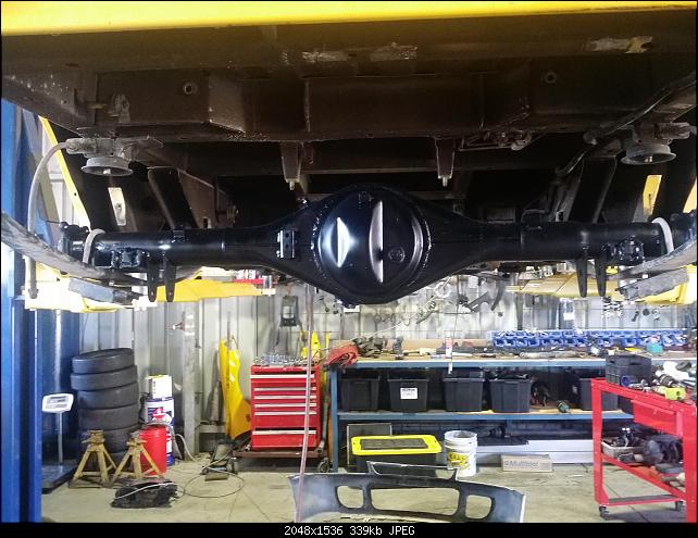

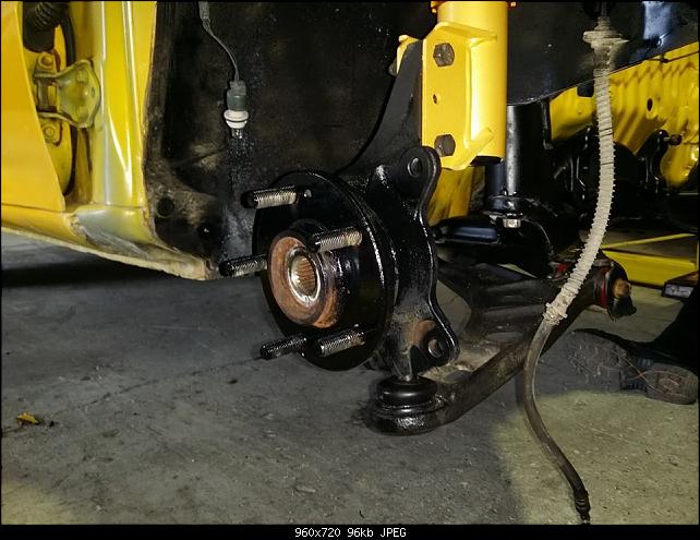

Did a 5 stud conversion as they are 4 stud from factory.Fabricated in a 2 link kit and the Tacoma rear diff with matching diff gears to suit the auto (RVR Hyper gear)

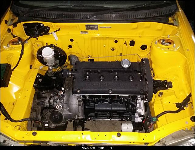

I fitted my old engine in and started to bolt everything up

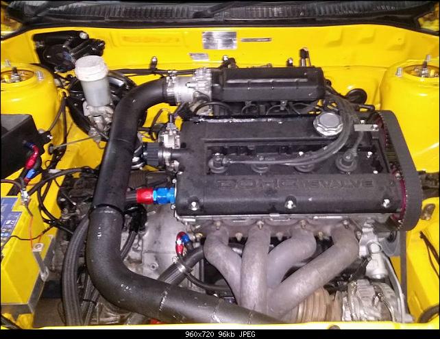

So the combo will be
2.1 alloy rod 4G64
Ported hyundai sonata head with hks valve springs
standard hyundai aspirated sonata cams un touched.
Hyundai sonata intake and throttle
Methanol and no intercooler
GTX3076 turbo
Mechanical fuel pump
Motec M4
Motec dash
Forced four shift box
A built auto out of a RVR, evo 10 paddle shifter on the steering wheel
The front end is an evo 2 front bar, headlights, bonnet and guards. They all bolt straight up, so it looks like an EVO2 pickup.

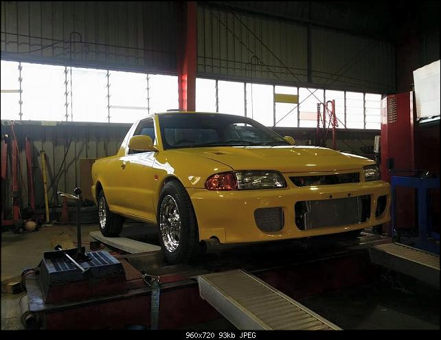

So after a 6 month build, we fired it up and gave it a tune through the front wheels (im lucky enough to have a 2wd dyno at my tyre shop). On 19 psi it made 320 at the front wheels through the auto with bugger all timing ans nice and rich on the lambda scale. I corner weighed it in full race trim and it came in at 2300lbs and 2570 with me in it (im 6'3 LOL)
Took it out for its maiden voyage. Really happy with the result
1st pass [email protected] 1.71 60
2nd pass [email protected] 1.554 60
3rd pass [email protected] 1.666 60
Tyres Hankook 205/65R15 basic tyres
Im leaving the line on 0 boost and it hits realy nice and hard almost instant
20 psi boost in top gear
