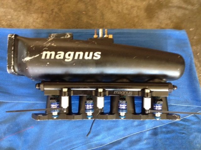

Magnus v3 cast intake manifold
Q45 throttle body
Tial bov
Magnus fuel rail 8an feed 6an return
Fic 1650 injectors

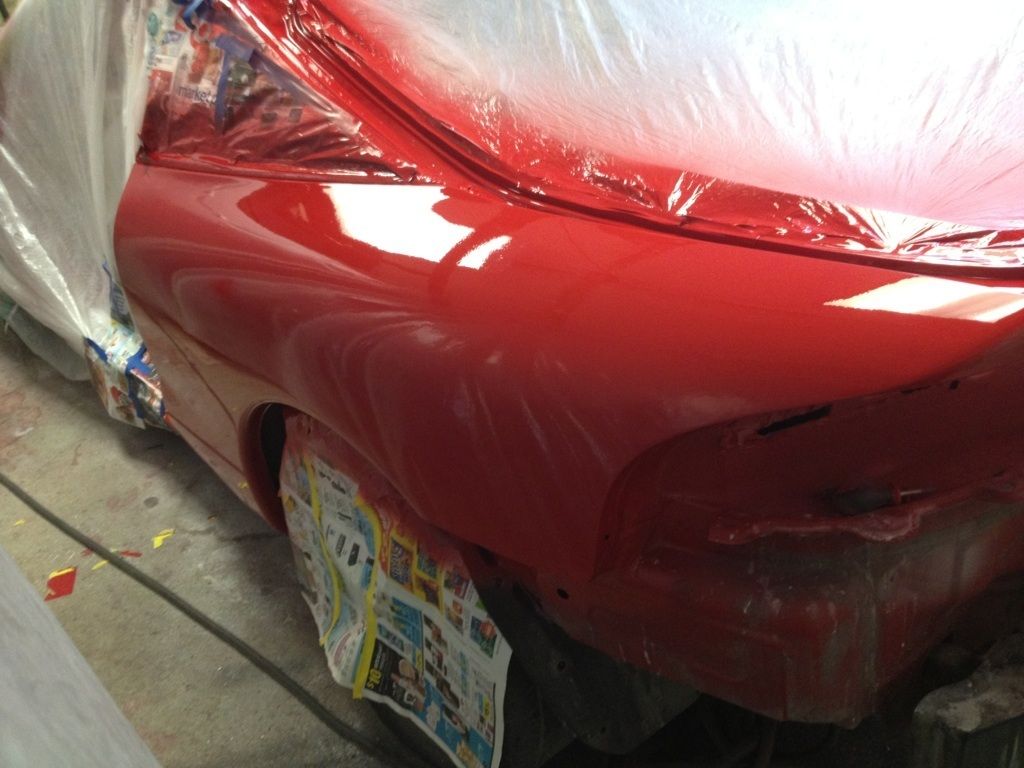

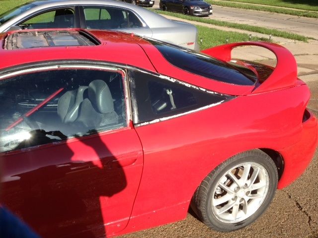

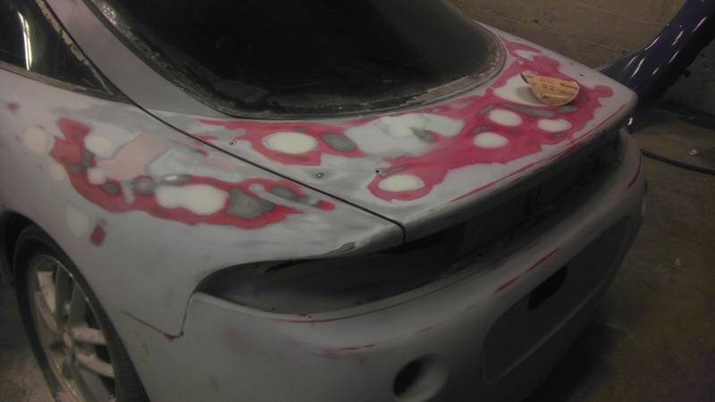

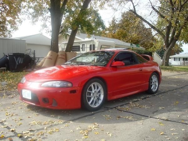

This around the time I got her

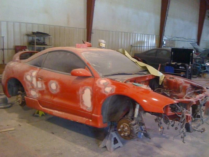

Body work. Also decided to shave off the antenna and rear wiper

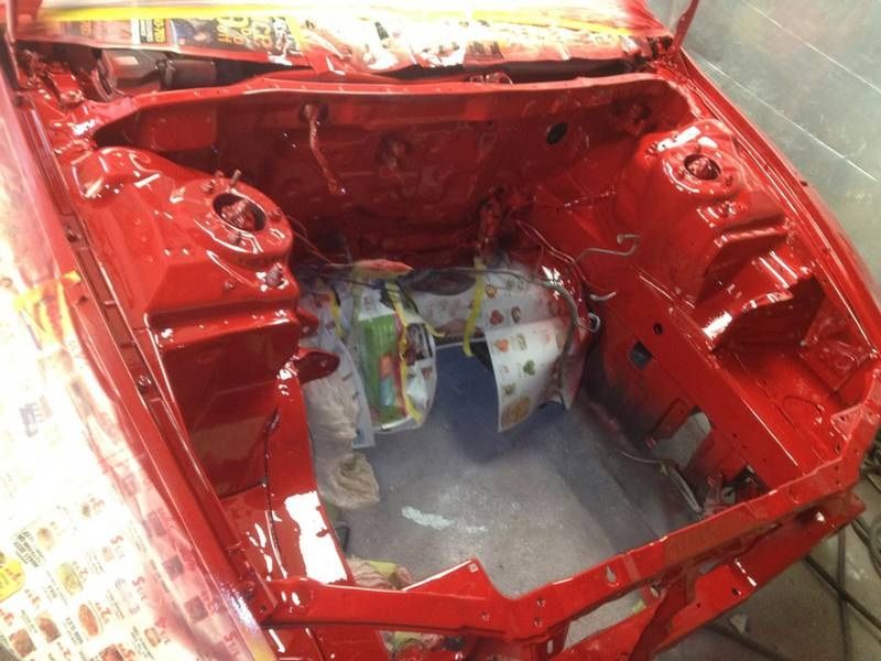

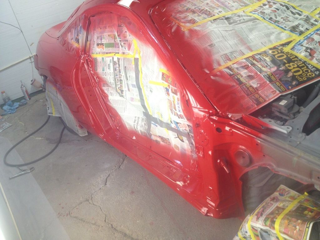

Fresh rally red paint
All done in the sun

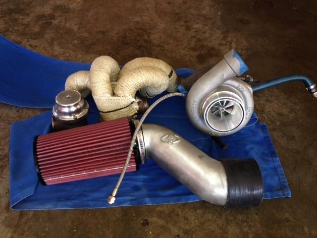

Turbo kit
Intake mani fuel rail and injectors

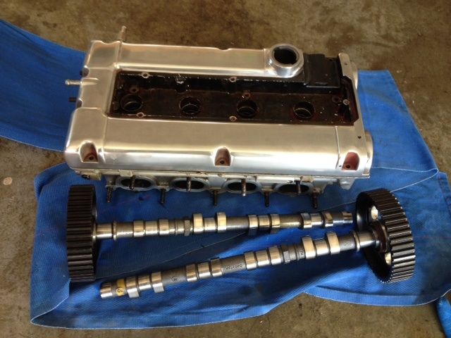

Head and cams

I have heard of the tire screaching problems people have with welded center diffs. on short turns but I have drag radials on stock gsx wheels so it shouldn't be a problem for me. As for the pic you see my car in that huge garage, it was there just for body work. It's back in my garage now ready for me to drop in the engine. I just need to know torque specs for arp L19's
