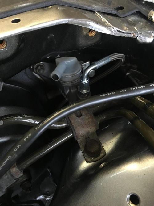

I was able to get a couple small things done today in the bay while it was raining, took the old accumulator and hardline for the clutch out and put a new master cylinder and SS clutch line in. Getting close to dropping the motor in, also getting a lot of good ideas from other build threads. I'm planning on getting the car running and playing around a little if the trans allows it. Then shipping the trans off sometime this summer to get built, when I do this I've been thinking of stripping down the suspension components on the car and sandblast and paint the entire underside. New bushing bearings the everything.

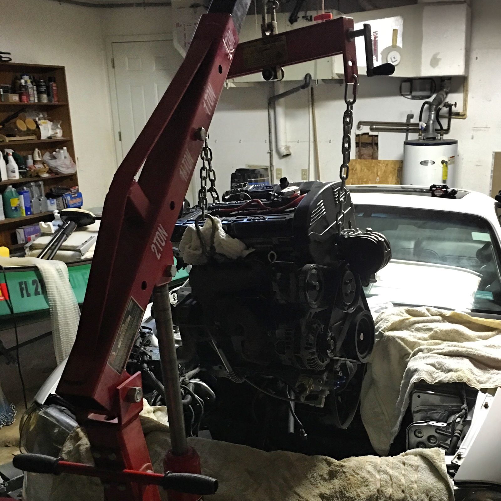

I was able to get the motor and trans in place! For now I'm going to be running a stock flywheel, freshly resurfaced with a stock pressure plate and act street disc. Everything will be stock for the most part until I run a few tanks of gas through and break in the motor. I'm also working on cleaning all the wires and replacing the loom and electrical tape while I'm at it. Once I get the motor cranked I will be relocating the battery to the back of the car with the Moroso batter disconnect switch and battery box.

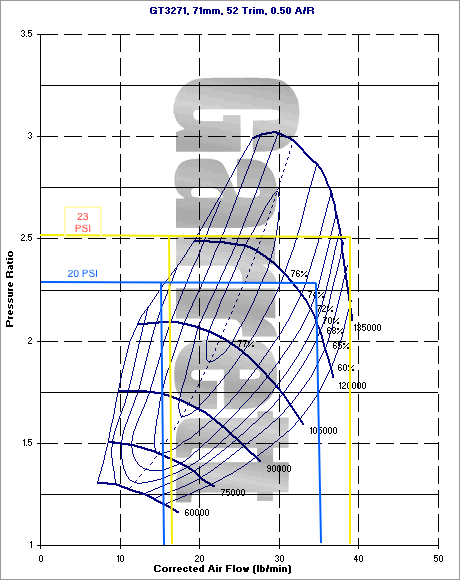

I am changing around the turbo setup, after looking at the compressor map I wasn't very impressed. Plus my goals for this build are a little more then this turbo is capable of. So I'm deciding between an hx-35 or an fp green. Here is the compressor map for the Garrett I will be putting up for sale shortly.

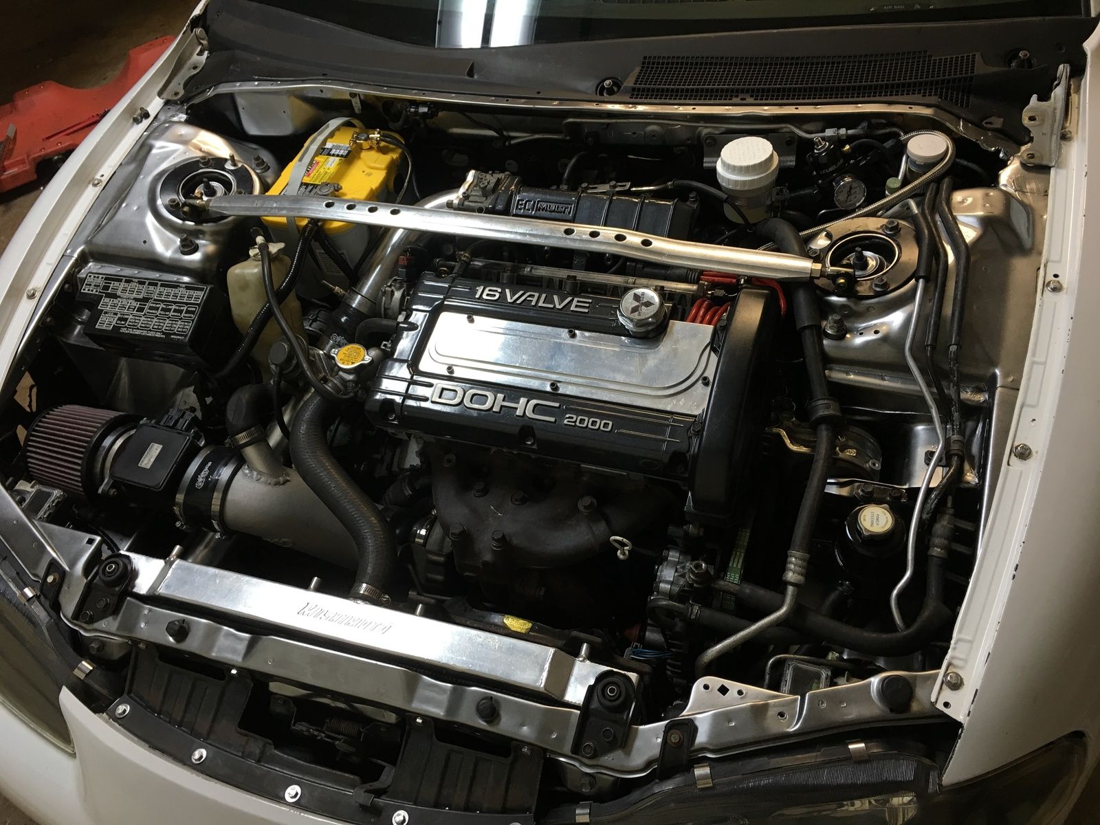

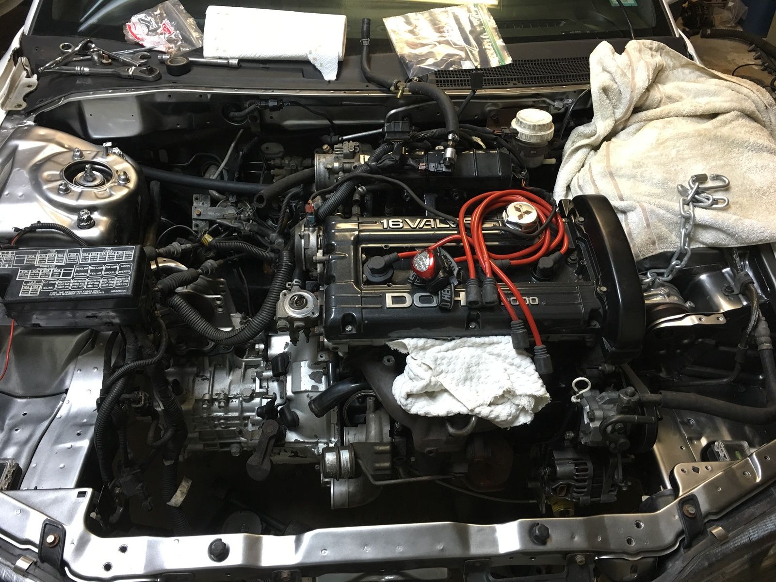

Was able to get it started earlier this week! Great feeling seeing it all come together, been working out bugs all week. Here is some pics of the progress.

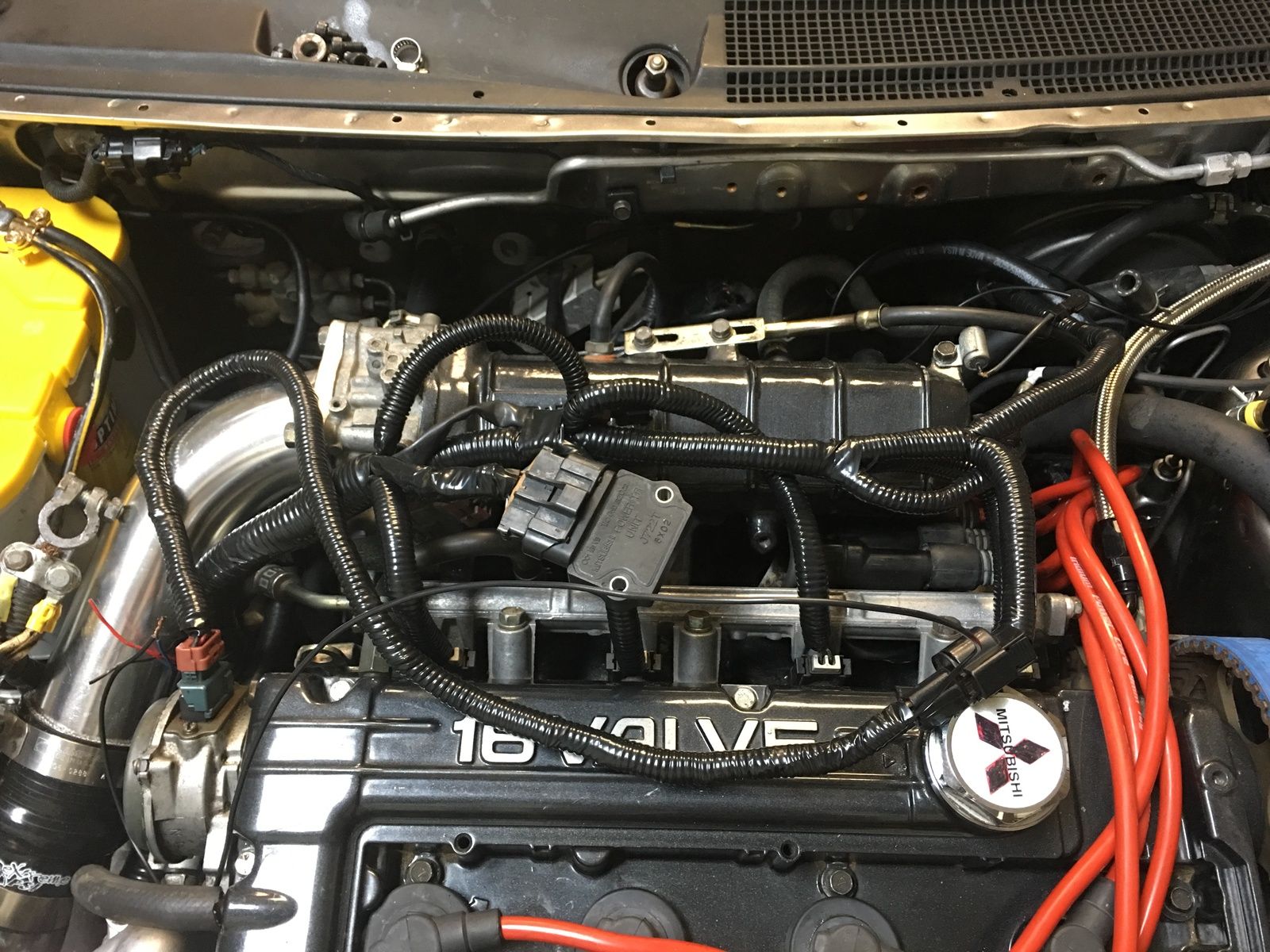

Before I tucked the wire inside the intake manifold I added wire loom and 3m tape around everything. I also had to extend the TPS, Coil harness and Flipped the injectors 180*

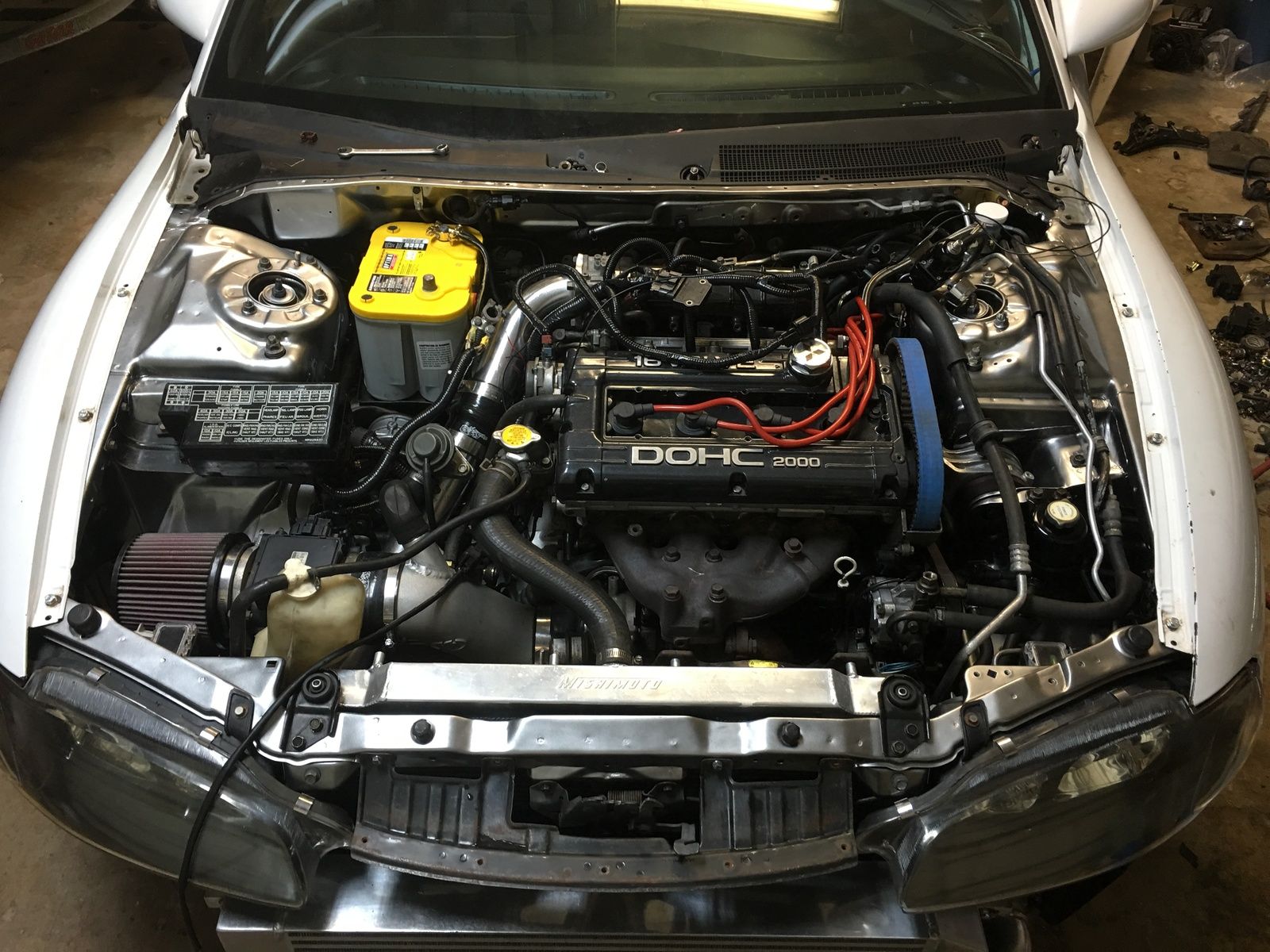

After tucking the wire and cleaning everything up, still need to relocate the overflow.
Checked the compression a few days ago, 180 across the board, was happy about that!
Oil pressure is High on cold start even with the oil port mod. 100+ or - psi on cold start then settles to 20psi at idle.
Turbo seal is shot on the t-25 but I wasn't to surprised with the shaft play before installing. Planning on using the Garett/Turbonetics manifold for now. Still on the fence about the turbo I will stay with, leaning towards the HY-35 with t3 hot side.

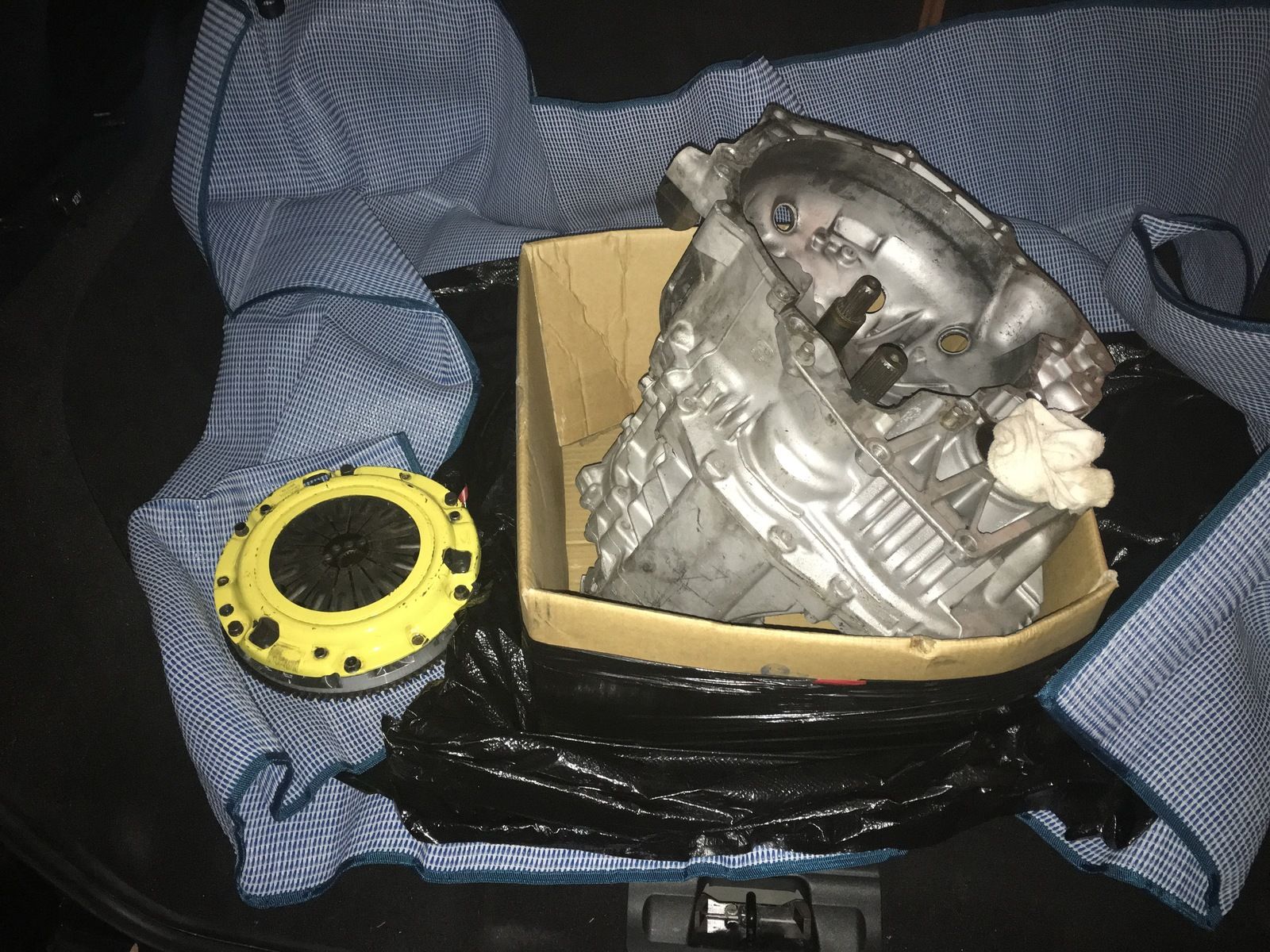

Here's my Shep Stage 3 with ACT 2600 and Fidenza Flywheel I picked up a few weeks back.

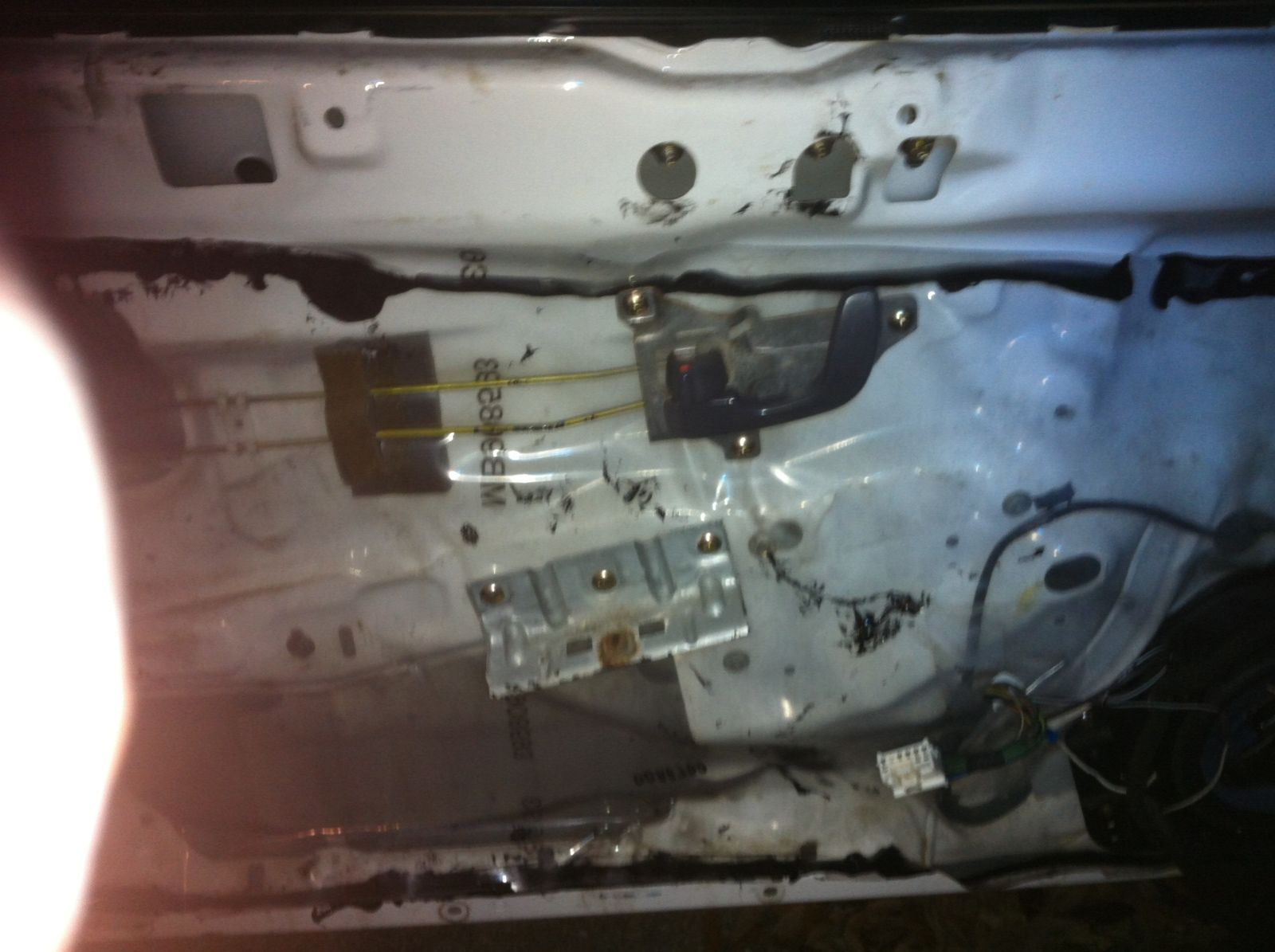

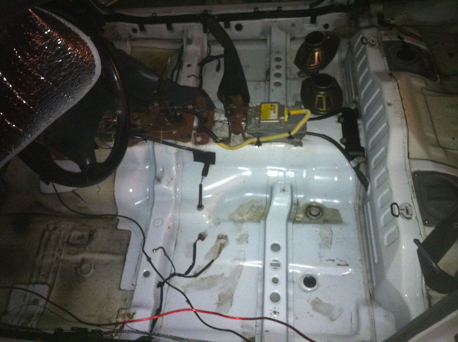

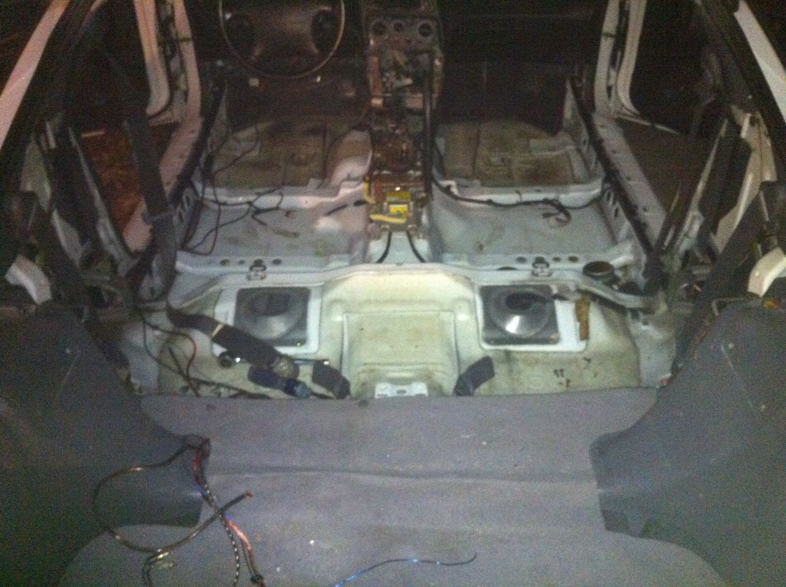

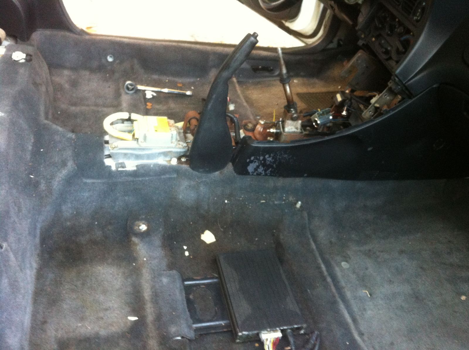

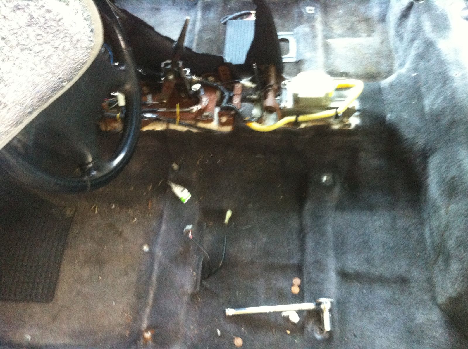

So the fun begins, first things first rip out all old interior and replace with black/grey. I'm also switching the carpet because thats trashed aswell.

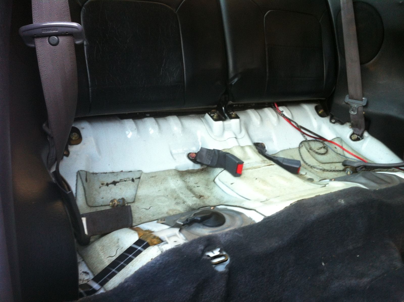

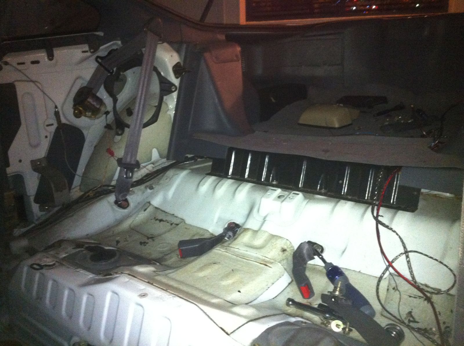

Here's some pics of the progress so far. More pics coming soon.
Painted black, with black leather seats. Everything is pretty worn out as you can see though.
