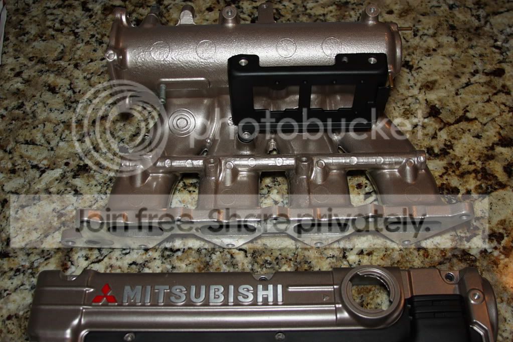

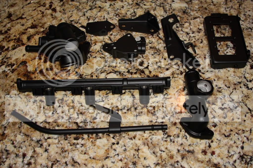

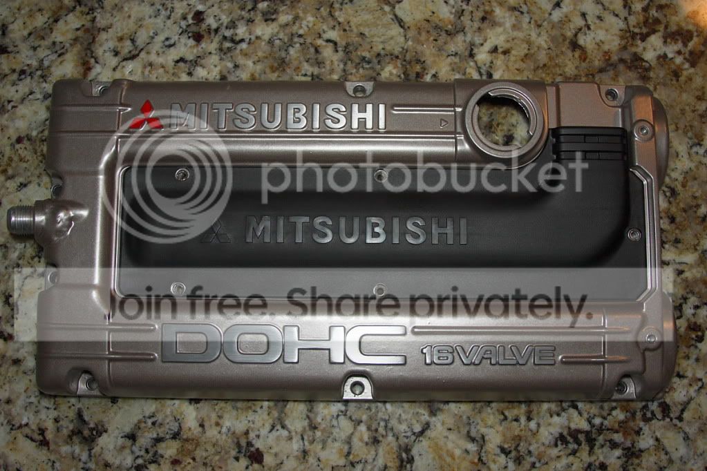

I picked up some parts from the powder coater today, which was a few days ahead of schedule. :)
I am happy with how they came out, the color combination is exactly what I wanted. It is actually really close to the factory color. The red Mitsubishi symbol sets it off well I think.

the parts came out very nice, especially the valve cover. im very jealous
Thanks! I spent a lot of time going back/forth trying to decide on a color scheme.
