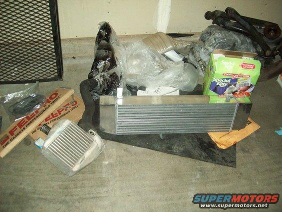

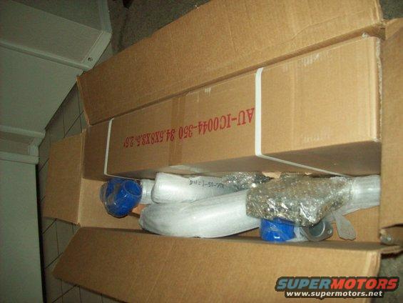

Look what came in the mail!

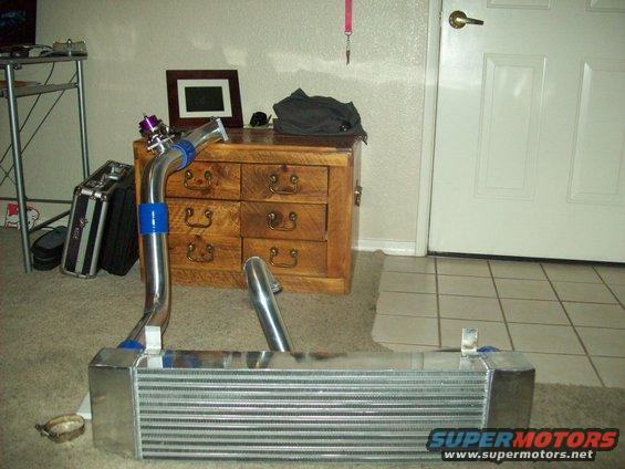

It is the PR FMIC kit, real nice kit, all the parts, only complaint, as with others, is the Tbolts, most of them worked, I only broke 3 of them.

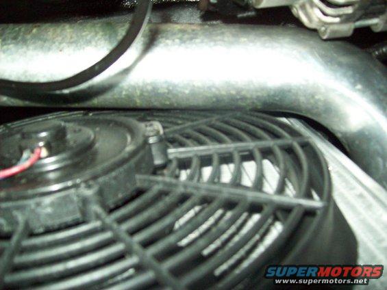

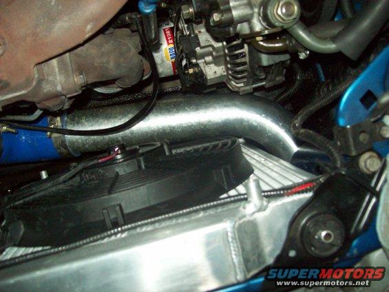

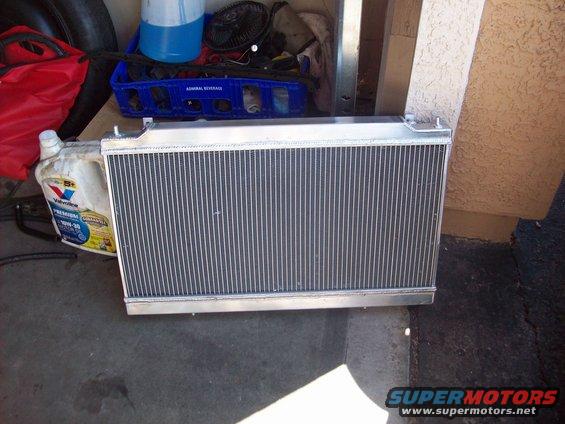

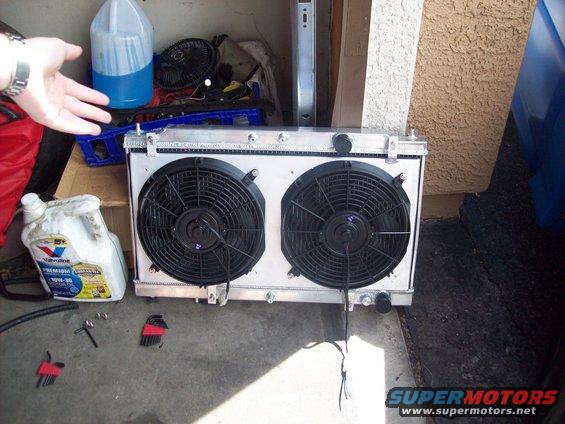

I also got this, the PR Radiator with shroud and 12" fans. I ended up not using the shroud and putting the fans on the front between the FMIC and Radiator.
Part of the reason I also mounted the fans on front is cause I had a little fitment issue:
Here is the FMIC next to the SMIC, BIG difference! LOL

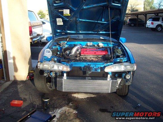

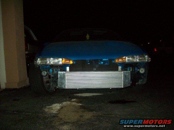

here is it mocked up with the bumper off:

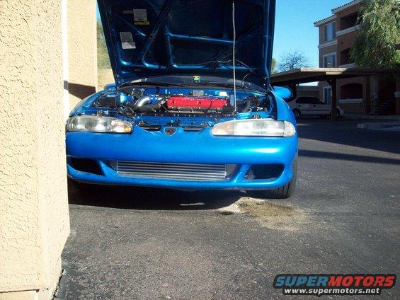

Getting there. Got it all finished up and put the bumper on.

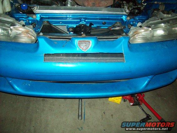

Cut a hole for airflow:

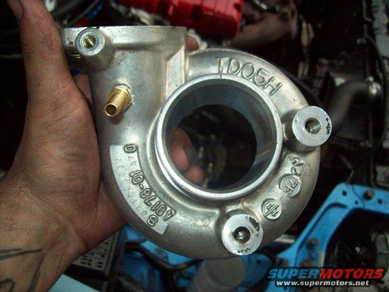

While i was doing all That, I also ported the compressor side of the turbo and added a boost nipple since the jpipe didnt have one.

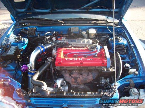

I also dropped the battery and took the abs otu so it all would fit. Here is a pic of it mostly finished, only thing missing that I dont hae a pic of is with the 3" Dejon intake and K&N cone filter.

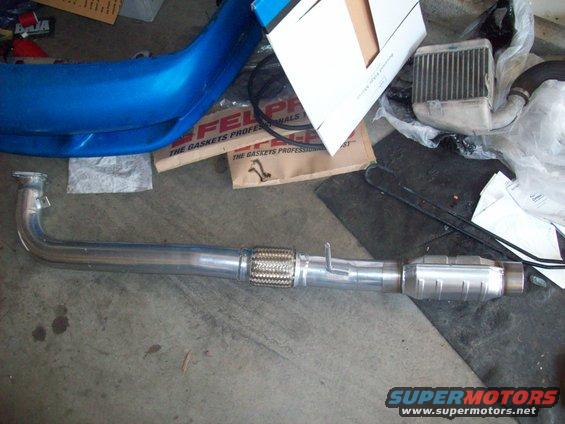

Added a 3" Magnaflow high flow cat and had it welded with 2 bolt flanges for easy drop out.

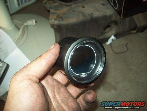

Put in my new prosport Evo gauges (no pics installed)
