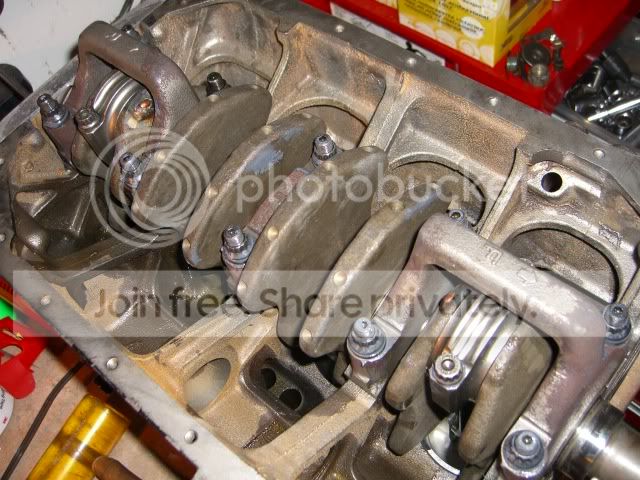

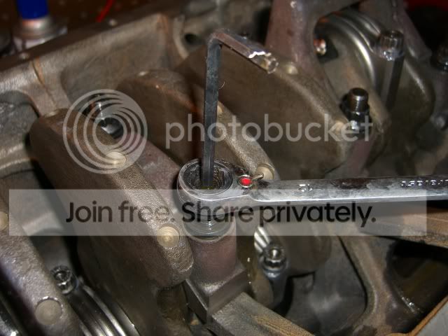

If the nut gets stuck on the main studs, just use a hex key and a ratcheting wrench to take em off.

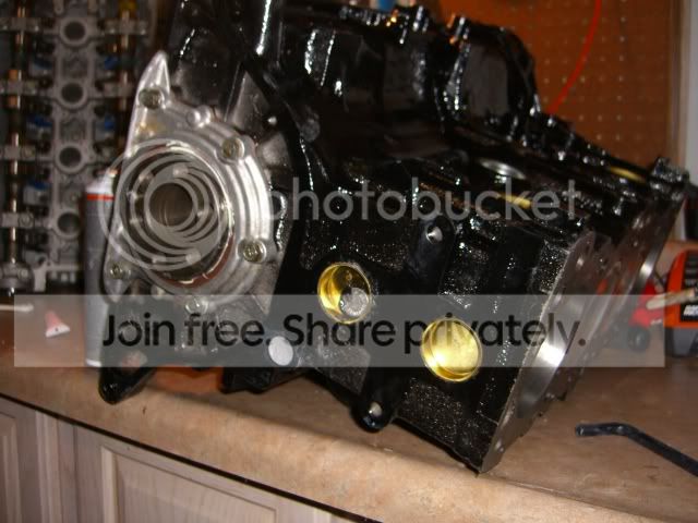

all done:

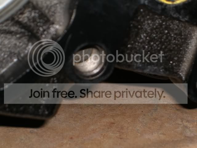

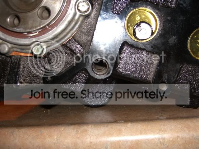

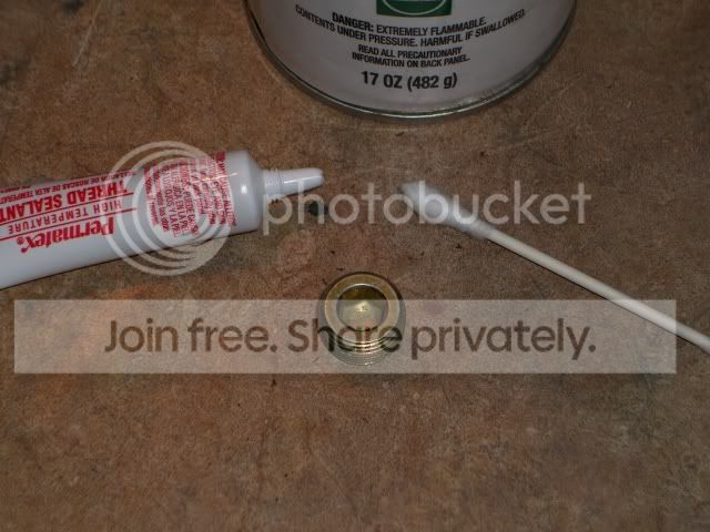

This stupid plug was the whole reason for this rebuild. I ordered a new OEM one from JNZ and took John and Dan's (92awddsm and projectsi) advice on using Permatex cup and core plug (red loctite) sealant and Permatex high temp thread sealant on this project. Mainly the permatex high temp (it's white) on the BSP plug.
I blasted it out with brake cleaner and swabbed the threads with a Q-tip before installing.
To make myself feel better, I filled it with "great stuff" from permatex.

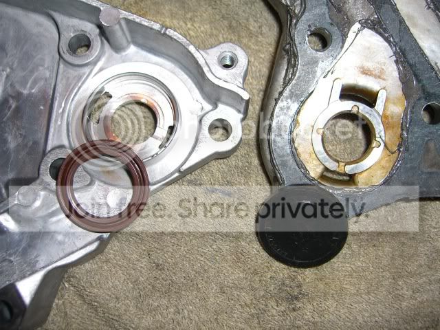

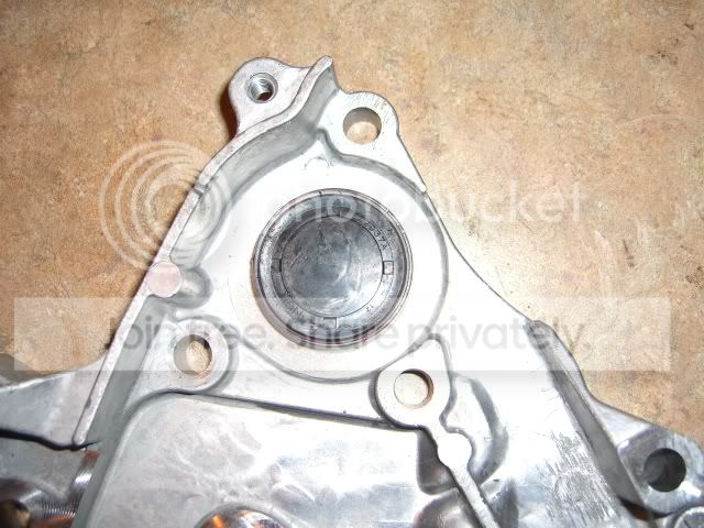

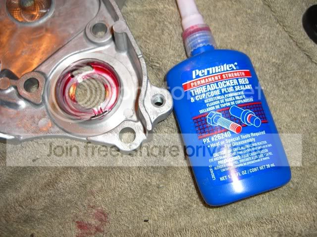

Last one for the night, installing the plug for the BSE on the front case. I'll get to the gears and pump once I get them from extremepsi (ordered brand spanking new ones).
New on the right, old on the left. I used the same method of rubber mallet and socket to pop out the core to swap out onto my new front case.
As dan's suggestion, permatex cup&core works really well.

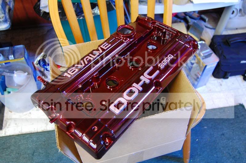

Coming Soon... (sorry I had to
red, black, and chrome is the theme here
all done:
