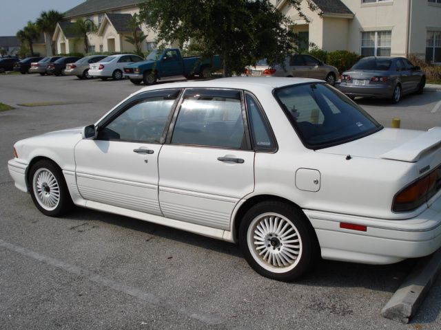

Freshly built engine w/ all new OEM parts (done back in the 90's when I worked as an Asst. Parts Manager at Route 9W Mitsubishi in Nyack, NY)
K&N Air Filter
3" Hahn Racecraft Downpipe
3" Custom Exhaust
Apexi N-1 Muffler
Stock 14b Turbo
Ported Turbo Inlet (Cold)
Ported Turbo Outlet (Hot)
Ported O2 Housing
Ported 95 2G Manifold
Turbo XS BOV
Walbro 255 lph Fuel Pump
Balance Shafts Eliminated
ACT 2600 Clutch
Auto Trans Fluid
Mobil 1 Synthetic Oil 15w50
HKS EVC EZ
HKS FCD (Fuel Cut Defensor)
NGK 7mm Spark Plug Wires
NGK BPR6ES Plugs
Autometer UltraLight 30 Lb. Boost Guage
Autometer Ultralight Air/Fuel Guage
Autometer UltraLight Exhaust Temp. Guage
Autometer UltraLight Oil Pressure Guage
Autometer UltraLight Water Temp. Guage
Mofugas 2 Guage A-Pillar Pod
Mofugas 3 Guage Panel (Above Radio)
Aluminum Nokya Pedals
KYB AGX Adjustable Shocks (8 position rear & 4 position front)
KYB 2" Lowered Springs
16x7 ADT Rims
Yokohama AVS ES 100 Tires 225/45
Vacuum Hose Tee (Wastegate) Modification
Grant Detachable Steering Wheel Column Kit
Momo Corse SilverJet Steering Wheel
Momo Raptor Shift Knob with Alcantara (Silver/Gray)
Momo Alcantara Shifter Boot (Gray)
Other Undisclosed Mods & Tricks of the trade
