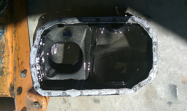

We've been playing with the shifter length and I've been having some issues getting into fourth gear. Well, this run I missed 4th and the motor rev'd up to about 10k-11k and hung there awhile. Motor stopped, I pulled over and was pushed off the track. We pushed her onto the trailer and were spectators the rest of the night.

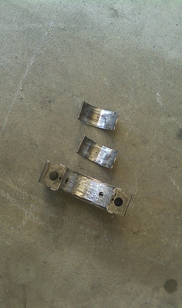

We dropped the oil pan and found pretty sparkles in the oil along with some pretty torn up bearing.

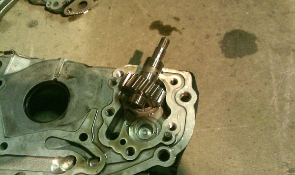

Not surprising, we found the oil pump had seized.

I kept it because it was built by the machine shop I use so I knew where it came from.
My motor spun a rod bearing earlier this year and I still have not had a chance to tear it completely apart and look into what caused it. But my situation was similar, I missed a shift and the rpm's were very high when I came to the next stop there was a loud knocking. I'm just curious what bearing yours spun? I never thought it could have been my oil pump that seized.
