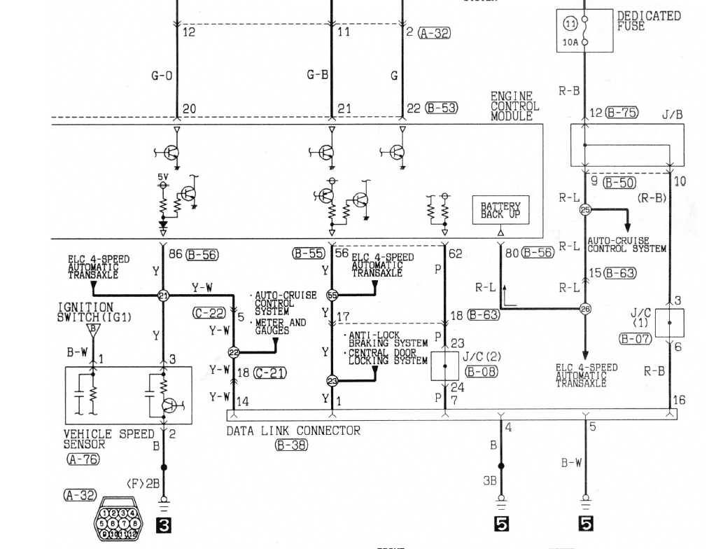

Sorry to post more diagrams but it helps to have something to look at while discussing.
2g-obd2-png.684422
ODB2 pin 1 is used to tell the ECU and others that they should be in diagnostic mode by pulling it low. If ECMTuning checked out the ECU I'm assuming that it functioned on their test rig, You can try unplugging that pin from the connector and see if it goes high at the ECU.
ODB2 pin 7 is used to pass data between the ECU and Diag tool/Datalogger. Once the Datalogger has pulled pin 1 low it has to send magical data to the ECU to get it to start talking to it.
Grounding the Blue/Green wire from ECU pin 38 to MPI pin 6 turns the MPI Relay on to power the ECU and various sensors. Grounding the White/Red wire from ECU pin 8 to MPI pin 5 turns the fuel pump on, on the 93/96 cars.
You said that the CEL turns on, but does it turn off after 5 seconds? You also stated that the boost gauge does not move when you turn the key on or while you crank the engine.
Have you found anything else going on?
2g-obd2-png.684422
