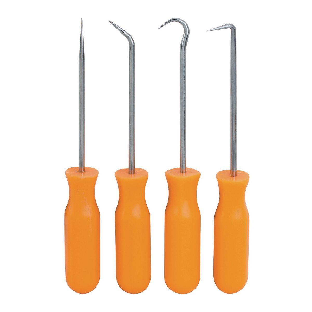

Try a small pick you can get at HF. It should pull it out.
Harbor Freight:
