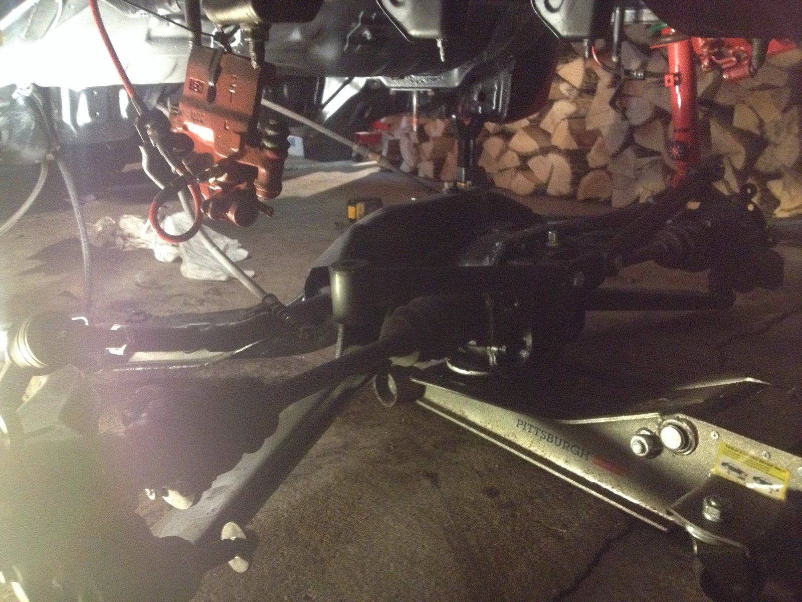

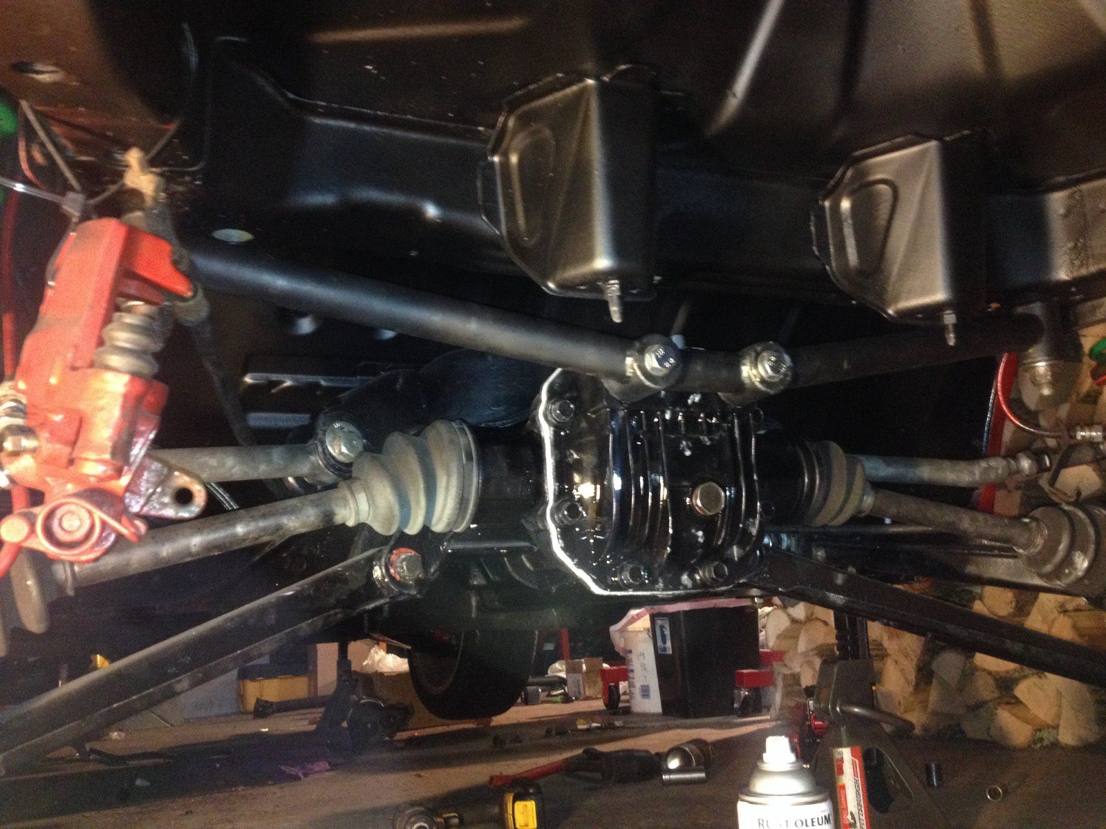

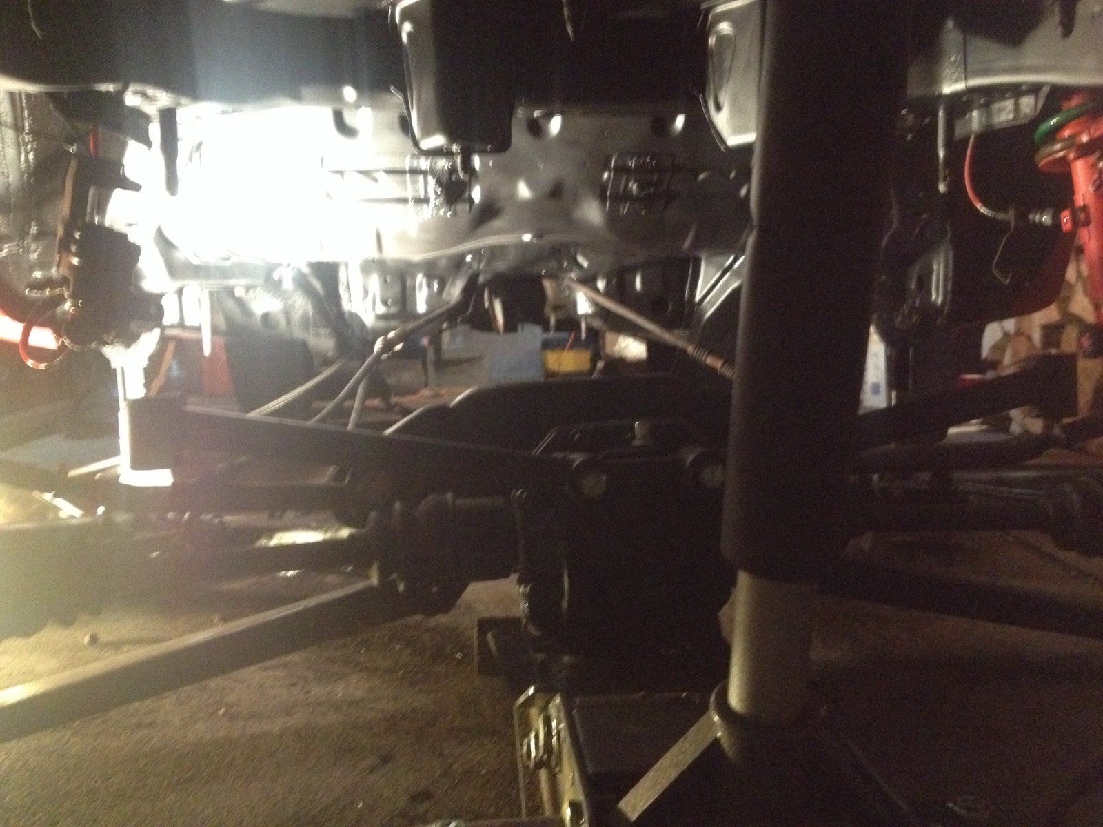

Rear end is completely undercoated, the rear subframe was installed. The rtm bushings were a tight fit but everything is rock solid

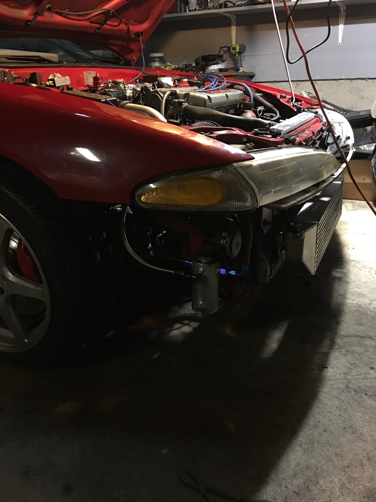

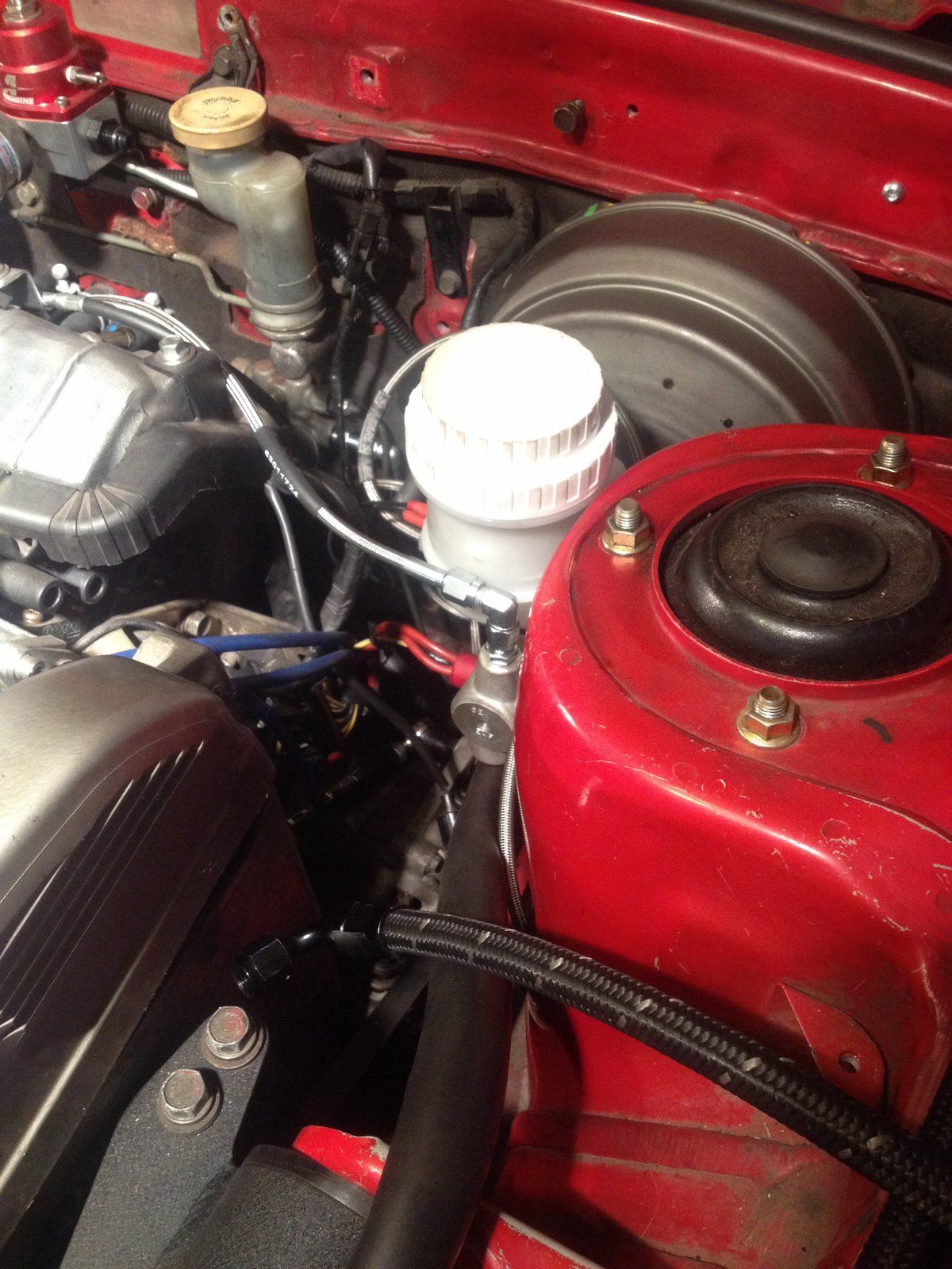

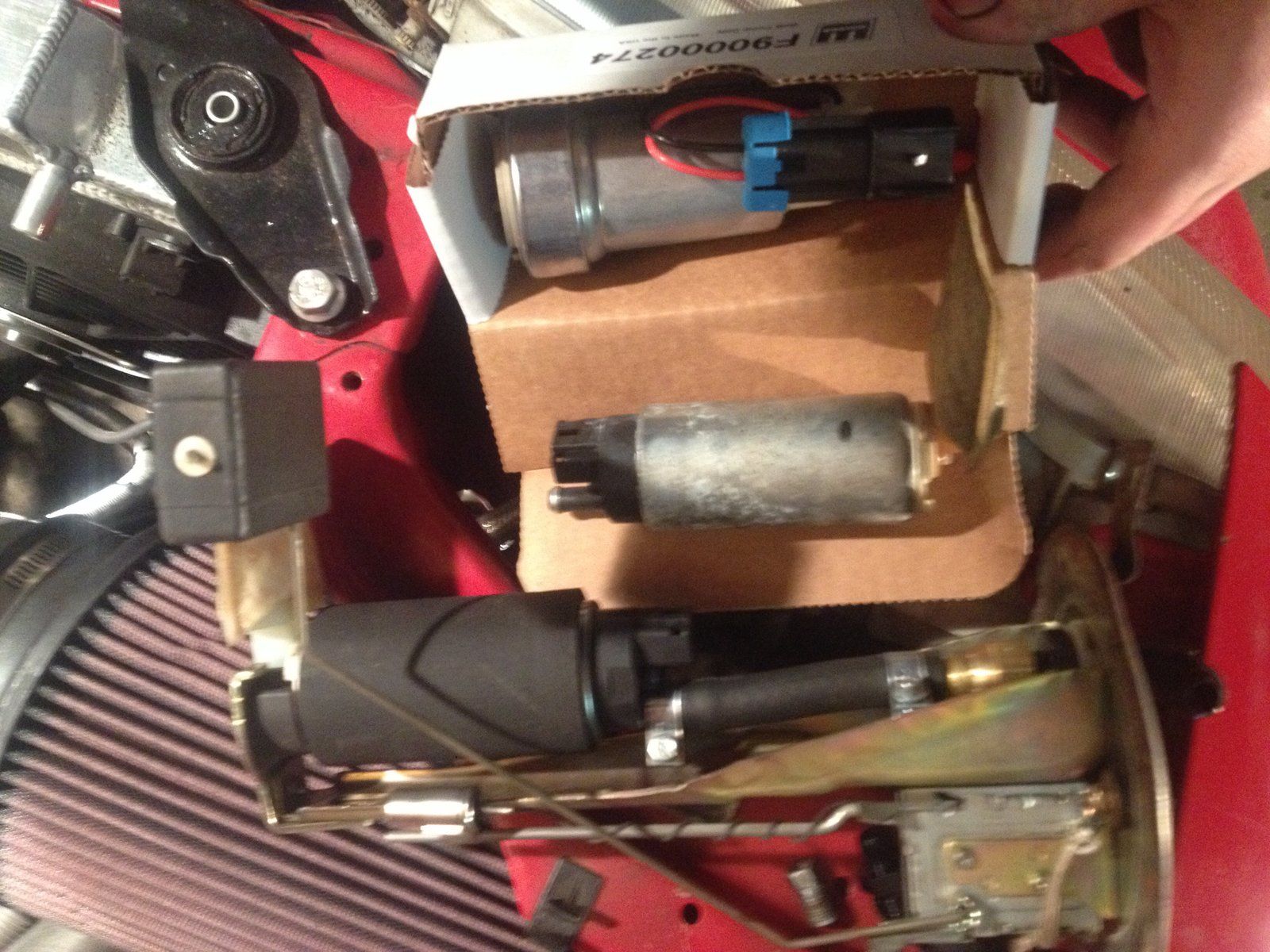

Plans for tmrw......Install front camber kit, complete the 3g mc and booster upgrade as i need to bend all new lines. Then the new gas tank will be installed with the walbro 450 I purchased. More pics to come tmrw guys!
Gas tank will be mounted tmrw, front camber kit installed and new front axles installed. More pics to come
Is that booster from a 3000gt or a 3g eclipse, if you could maybe make a list of what was needed / from where .... to do that conversion. I really would like to give that try as I am going after a what I like to call a "Streetfighter" decent power "400-450hp" "auto-cross handling / braking, besides an obvious turbo and ECM link all the rest I am going to try and keep Mitsubishi borrowed or stolen ....... that booster upgrade should really help in the stopping department ......
The booster is from a 3g eclipse, as was the master cylinder. The front brakes are from a 1g 3000gtvr4 made by powerstop with powerstop rotors. Rtm brake lines and brackets with evo 8 wheels. I also added speed bleeders all around. Monday I will be modding one of my fuel pump hangers for the walbro 450, i plan on drilling out all the rivets and rewiring everything, Im gunna use weatherpack connectors for everything. The fuel pump im gunna start the car on is the 255 walbro, the hanger is perfect so i didnt wanna cut it all up.

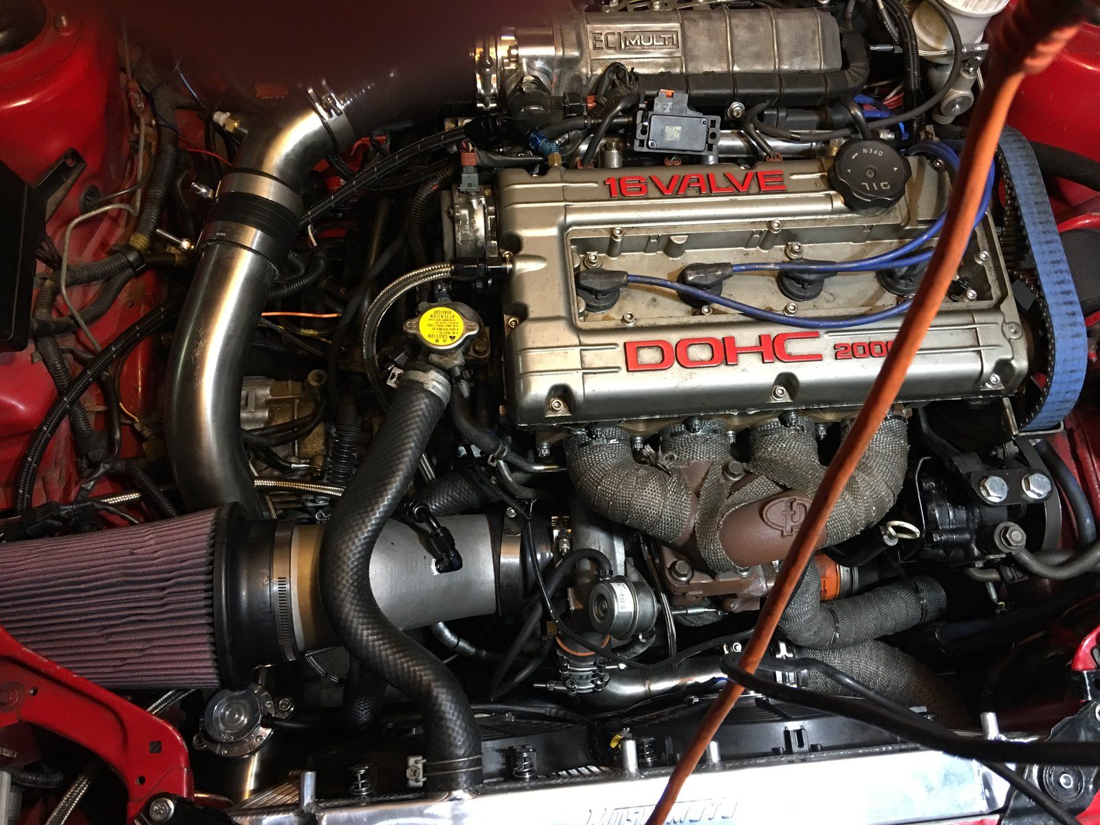

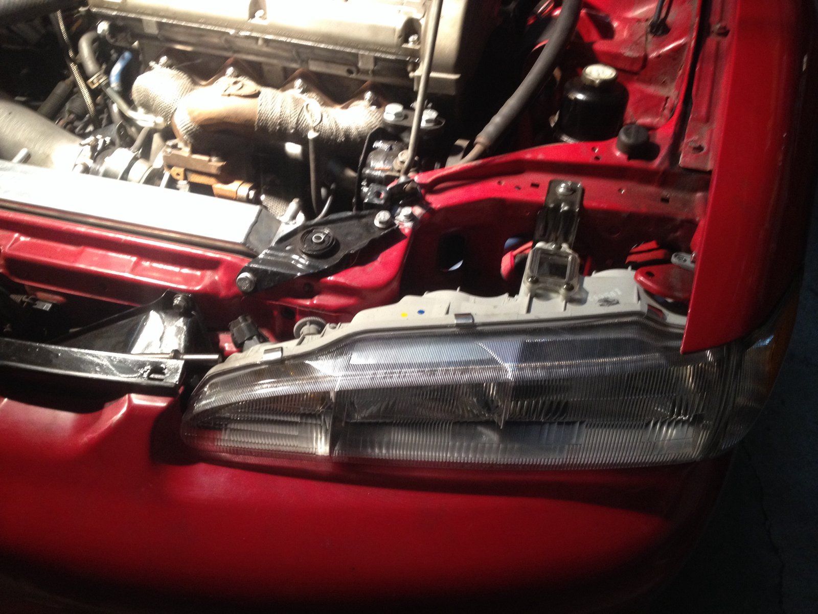

Smoke is from the heat wrap. Still gotta install lc2 and wire it into the harness. Then finishing welding the exhaust up. Then..... I can't believe I'm saying this. I'm done. Haha yah right :applause:

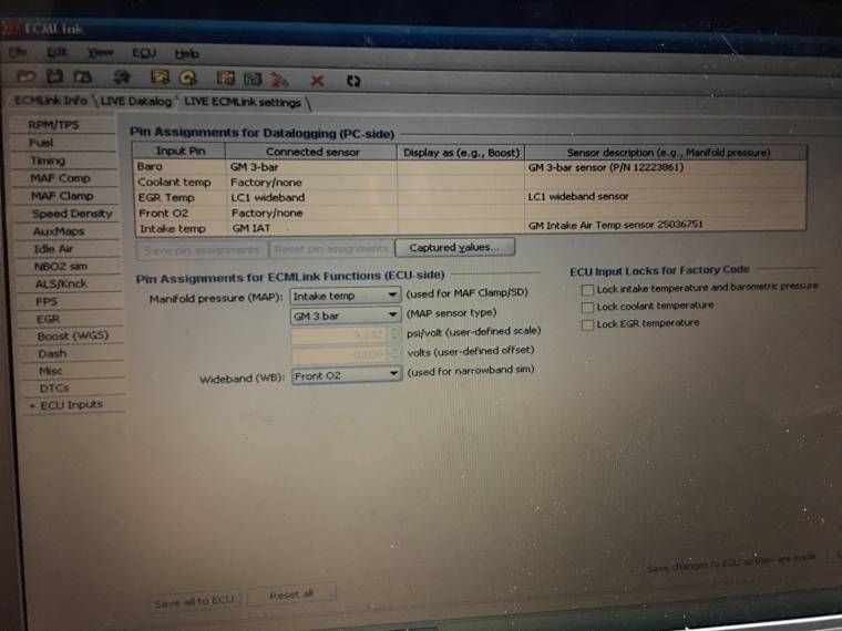

Engine is running good, I wired the lc2 into the harness tonight, still learning dsmlink. Doing things the correct way takes so much more time:banghead:. All wired soldered with weather pack connectors. Engine is running a little ruff at idle, gotta do some more reading...

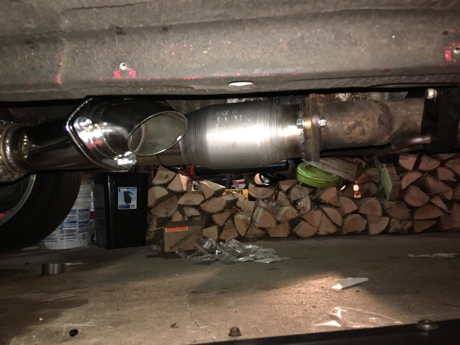

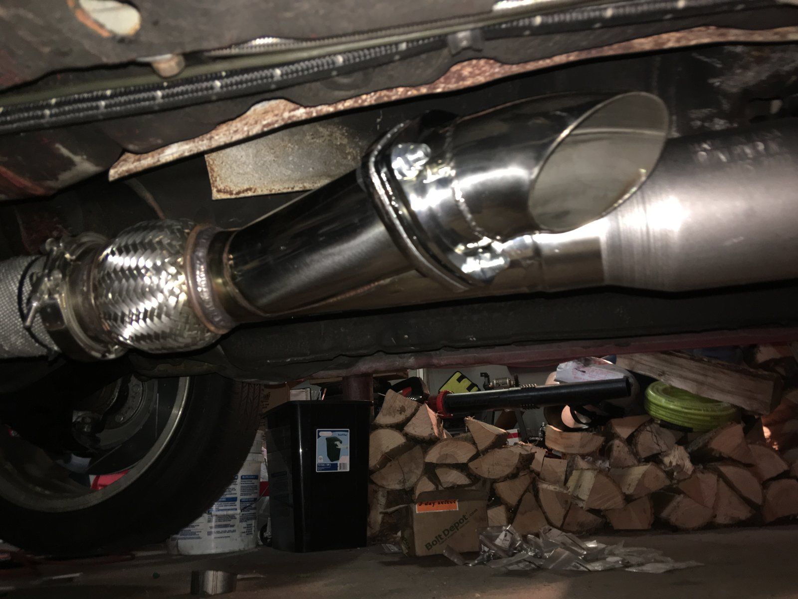

So I wasn't happy with my exhaust so I redid everything in 304 stainless, I tig welded everything myself using a longevity 200sx. I purchased a qtp exhaust cutout I will be installing this weekend. I originally had the exhaust externally dumped. It sounded like shit. The exhaust is 3 inch vibrant 304 stainless with a vibrant cat to a buschur rear section. Before the cat I made the cutout in stainless. I'm pretty proud of how it came out.
