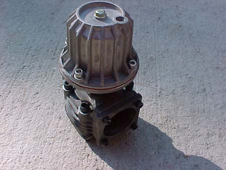

Today has been interesting to say the least. T/S Greddy boost controller to find out not all the parts are installed. Missing the solenoid. Well after that I had more questions than a few. The biggest one is on the MBC. There are 2 barbed fittings, Where do the hoses go that are not there? From the install manual looks as if one goes to the control valve for the manual controller. The LICP has a nipple that is capped off with a bolt. Would the other hose go there? Dont know if it make as a differance but the turbo is a 25g (make is unknow) and the waste gate is a HKS 50mm. Hmm hope wastegate and MBC are the same!! Don't want to confuse folks.
Thanks Alex, but I guess I'm not explaining myself well enough. The fittings I am asking about are on the wastegate. I am finishing the electronic boost controler as soon as I find a solenoid. Not sure if the acronym MBC is short for main boost controller or manual. My logic is if nothing is hooked (vacuum or pressure) to the wastegate all it will do is relieve boost once the spring has been overcome. Is this a correct assumption or am I all gagged up.

If I understand you correctly, the answer is "NO". The wastegate doesn't get overcome by exhaust gas rather by intake pressure signal. In other words, if vacuum/pressure lines are not hooked up to the wastegate, the gate will never open resulting in out of control boost.
OK You have my undivided attention!! So one hose goes to the intake would that be the hose coming out of the side of the wastegate or the end. The pic shows the area where the fitting is supposed to go. where does the other hose go? Would that be dependant on my setup?
http://www.stockreco.com/Mvc-HDR343f.jpg

That looks to be the Deltagate which I'm not familiar with nor am I with your ebc but the basic concept is this: Pressure source (usually off the compressor housing or T'ed off the BOV line) goes to the boost controller (in your case an EBC) and the output of the controller goes to the wastegate to signal it when to open. Your set up is a little more complicated because of the Deltagate/EBC combo but if you have the factory manual for both, following the basic concept of boost contolling, you should be able to figure this out. ;)

Well I have the manual for the EBC but nothing for the wastegate. The manual is GReddy B-Spec II it basically show a stock system with an Internal wastegate and a wastegate actuator. It also shows a solenoid going to the inlet tubing (which I don't have). Kind of wished i didn't by this 1/2 assed modded car. What a headache. Still looking on GReddy site if I can get the acrobat reader to install the new updates. Anyone with an external wastegate??

Well I think I have answered my question. The side port is for boost pressure and the top port is for turbo intake pressure. Anyone disagree.
