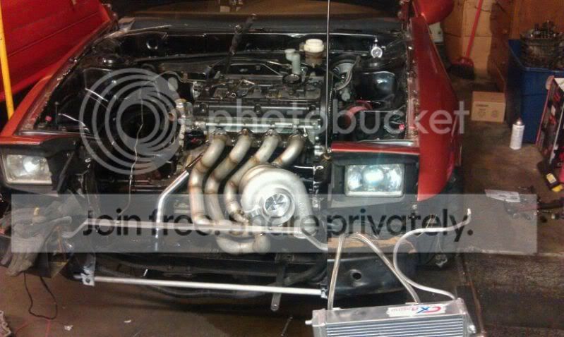

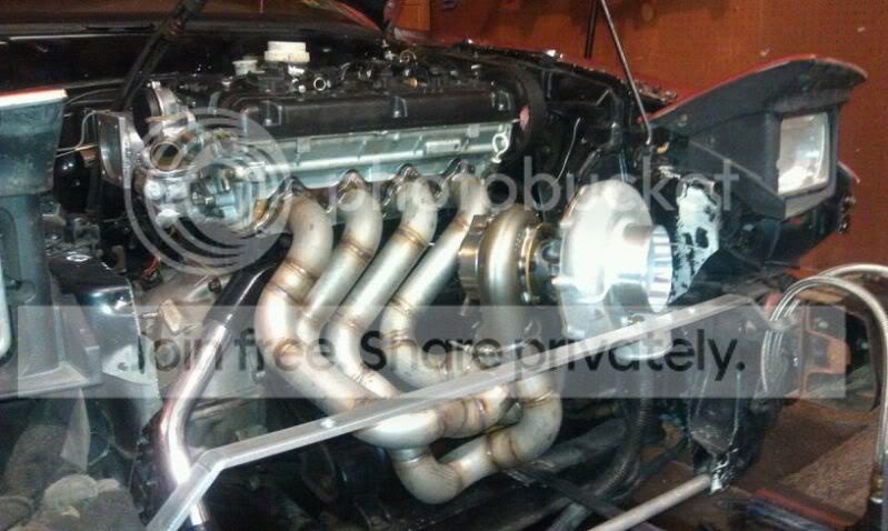

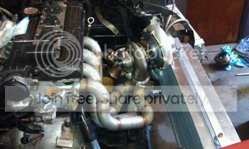

Still working on the talon now the front facing manifold is done and about to be ceramic coated. Next up is finishing the vband setup off of the throttle body and into the intercooler.

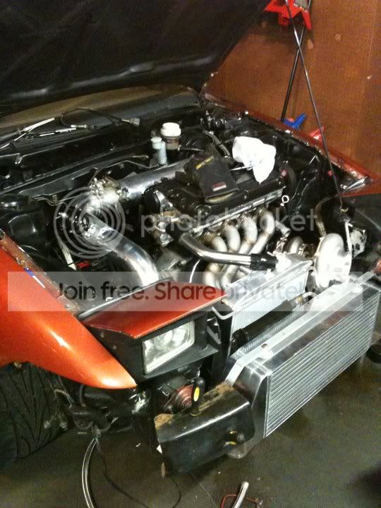

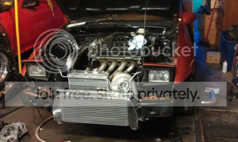

Here are pics of the q45 cut and the vband tacked on. Intercooler piping is 3.5" same size as the throttle body.
Going to work on getting the ends cut off the bottom of the intercooler next and weld on 3.5 inch end facing back toward the throttle body. We are also going to run aluminum pipe with couplers into the radiator since stock hoses won't work on the radiator. I will post up more progress as the car continues progressing.
