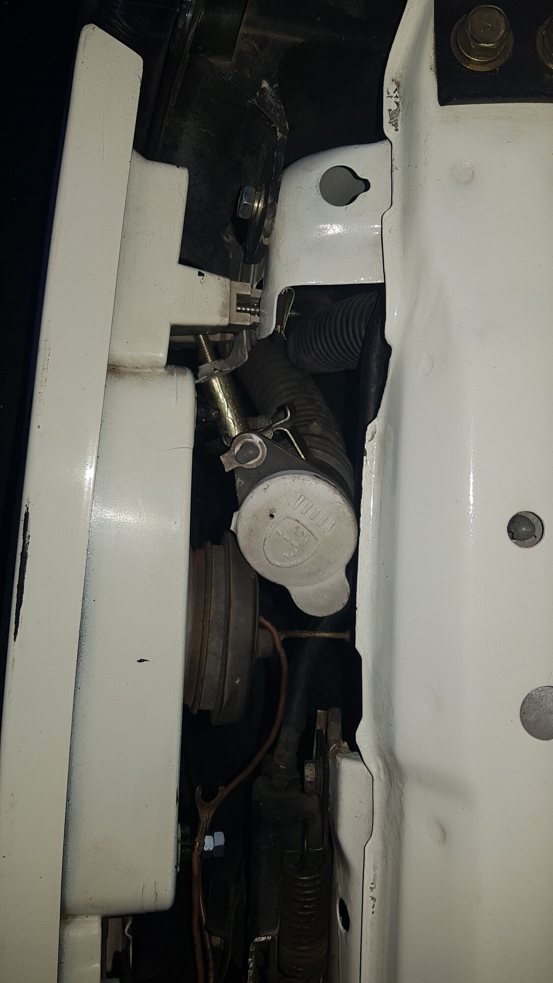

Okey. do the engine bay's outer side/wheel arch.
Before..
Cleaned a little from rust..
the final result...

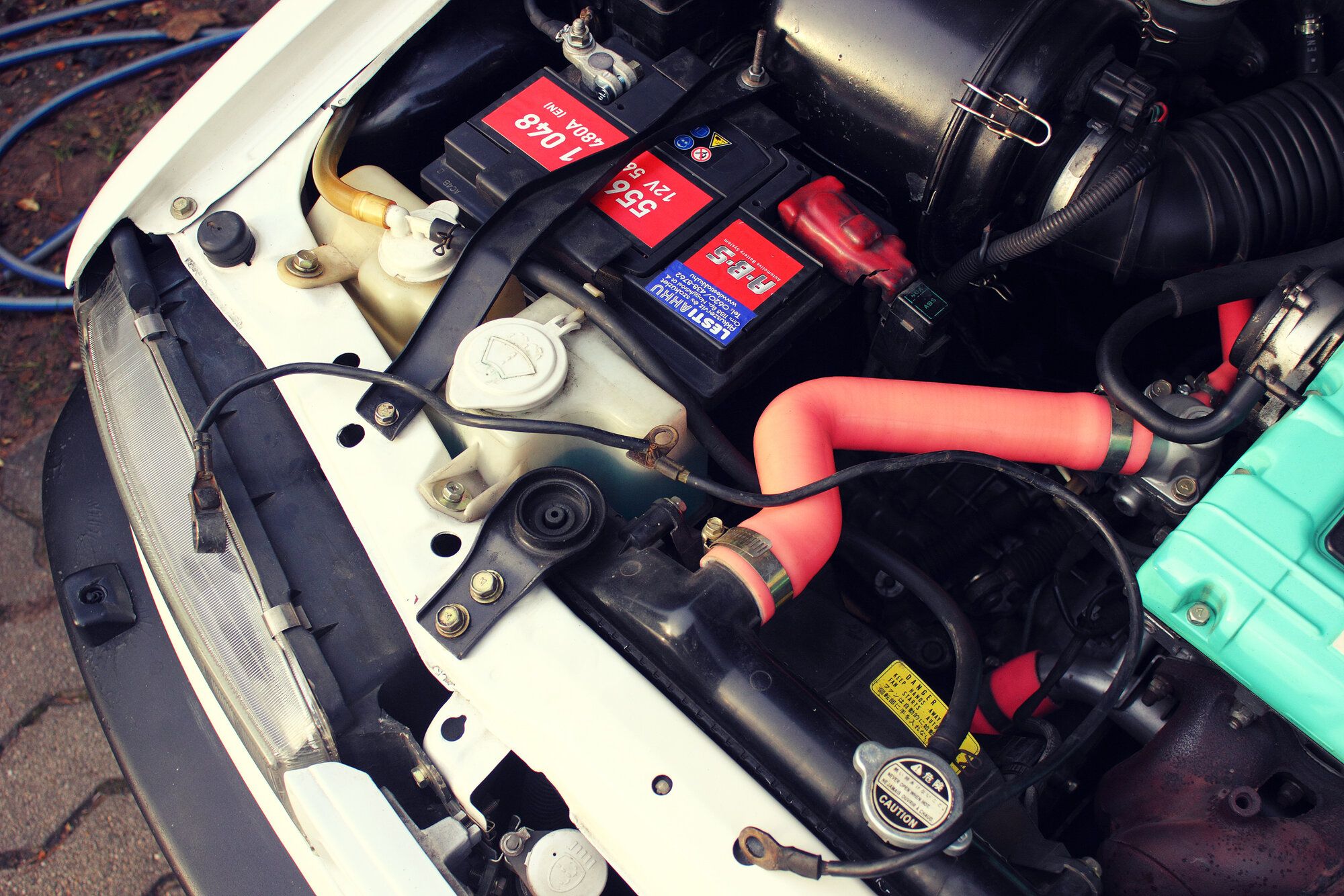

-And i finished the engine bay..
Before:
After:

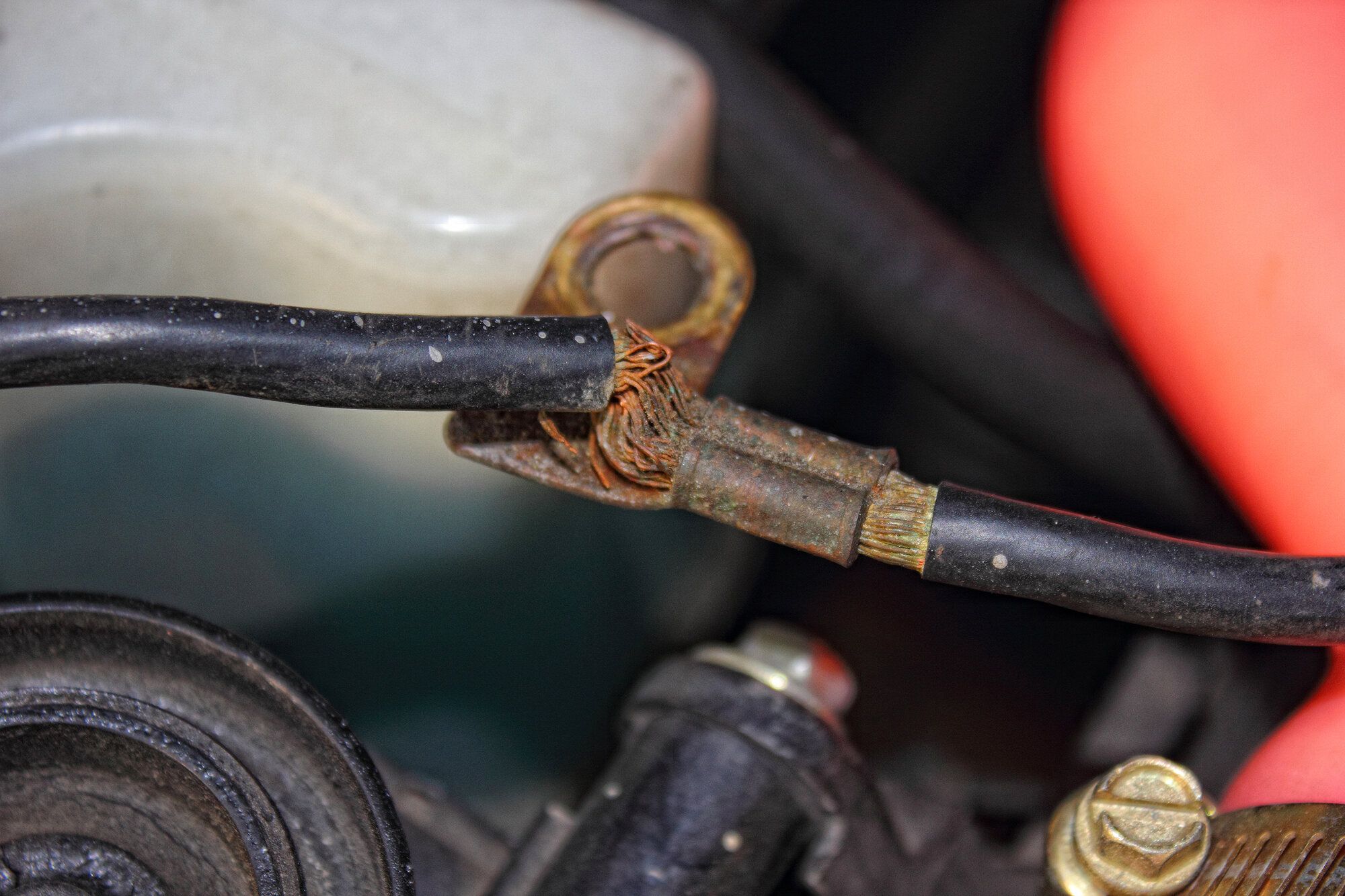

ohh i almost forgot.. Last days of summer: Alternator is dead.
I had a spare Alt. on my spare 4G63T engine..
Later I repaired&renewed the old one
