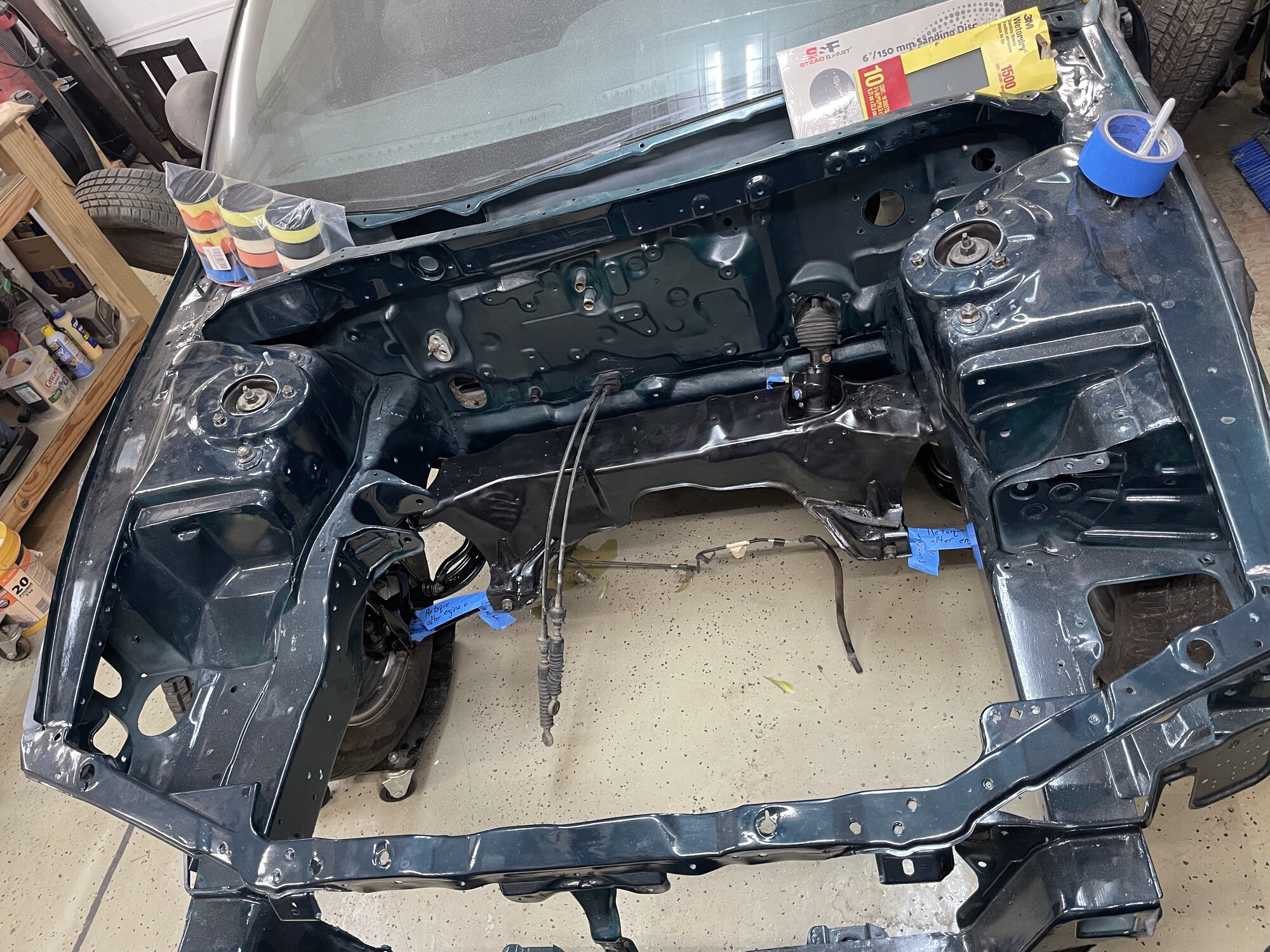

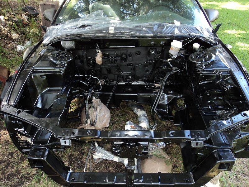

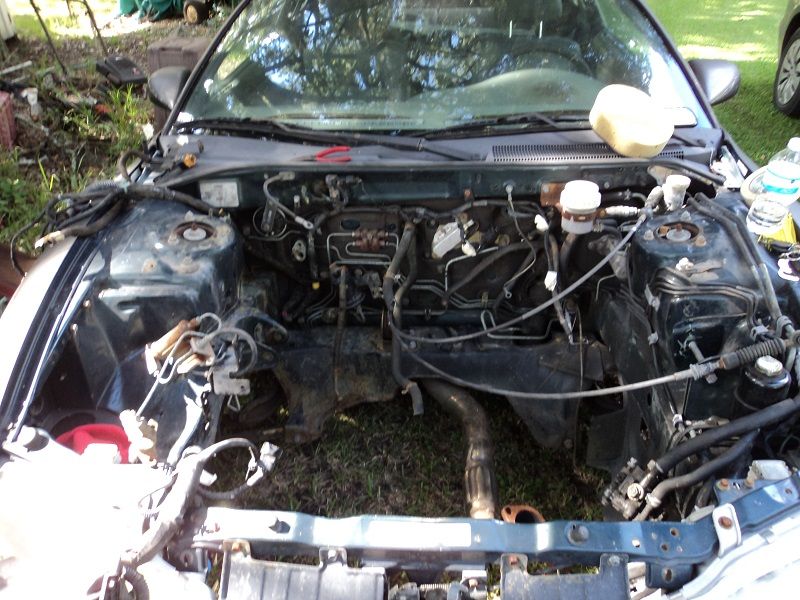

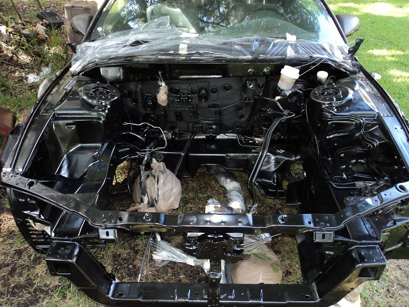

Engine bay empty and dirty. Before.
After. I used a couple shaker cans of primer, rust inhibitor, and flat black. On my next project, I will remove all the lines prior to painting.

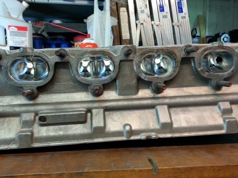

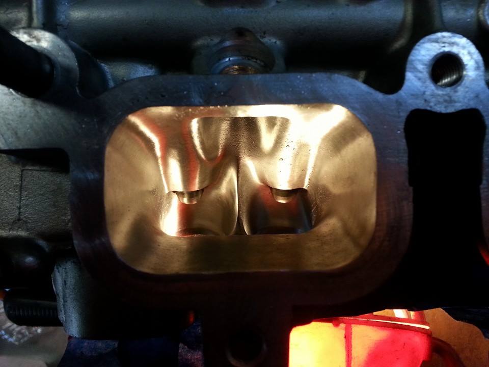

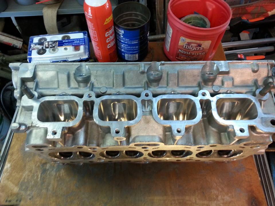

This head was difficult to identify, but Im fairly certain is a 1g 6 bolt hyundai head, even though it has different sized exhaust studs. I watched Jafromobile's Cylinder Head 204 video and ported my head. . If you havnt watched any of his videos, stop what your doing and watch them all. He has an insane amount of knowledge, know how, and tutorial videos about the 4g63 engine.
Exhaust

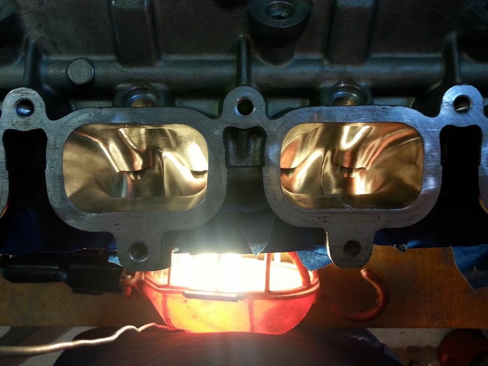

Intake

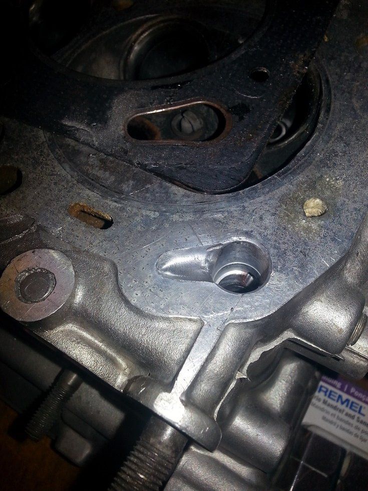

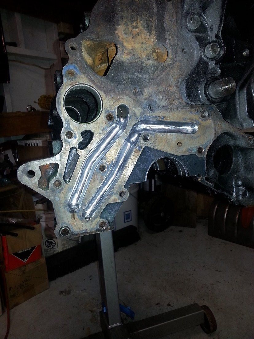

I will upload a few more pics of progress eventually. Since these I have finished oil port mods on the block, taken a few passes over the combustion chamber to clean it up a bit, and gotten a ton of parts in.[DOUBLEPOST=1408283080][/DOUBLEPOST]For the oiling system, I enlarged the tear drop on the head from 0.058" to about 0.110". The main feed in the block also had huge chunks of casting, so those were removed and cleaned up a bit. Video reference:
There are also numerous threads by BogusSVO where he shows you step by step what to look for and how to do these mods. I prefer the videos because Jafro will typically give you more OEM spec measurements then necessary, but useful down the road.

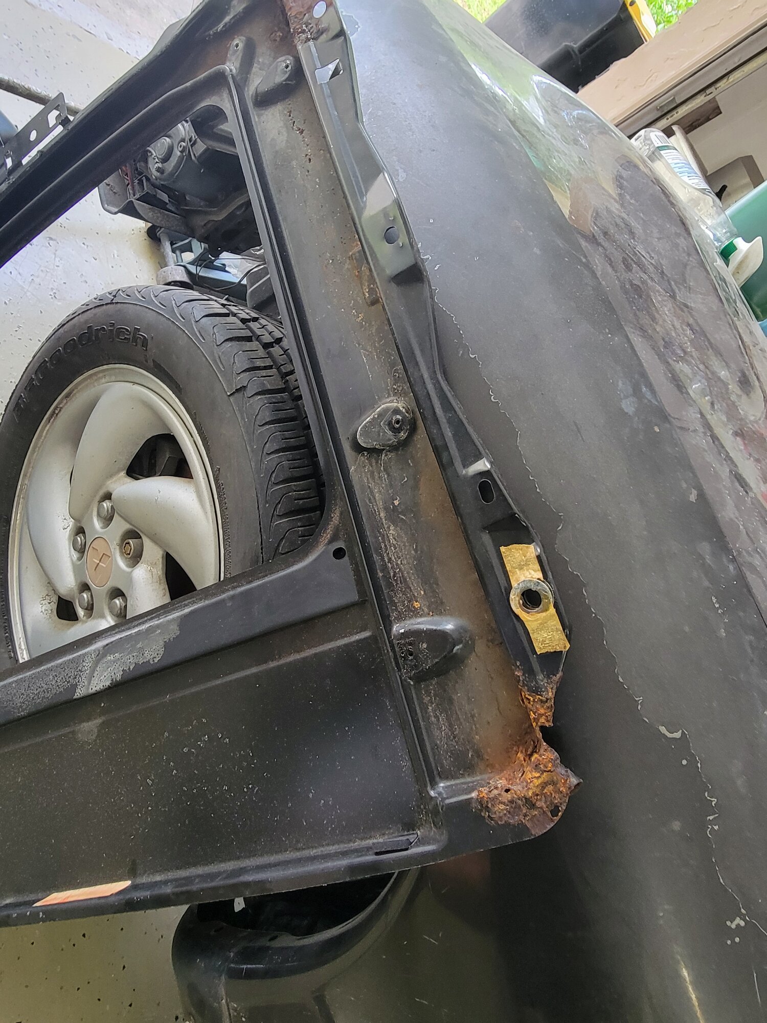

Body/Chassis

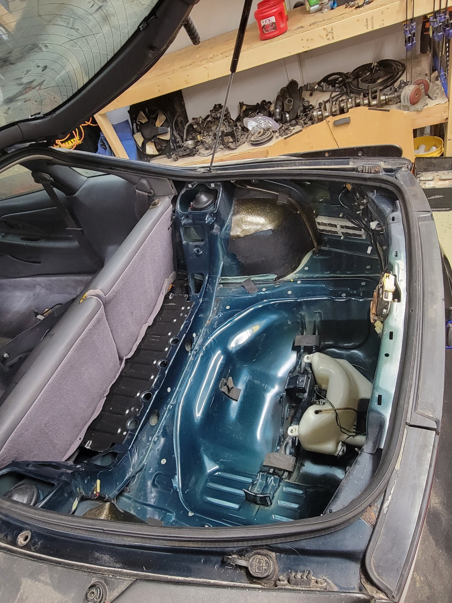

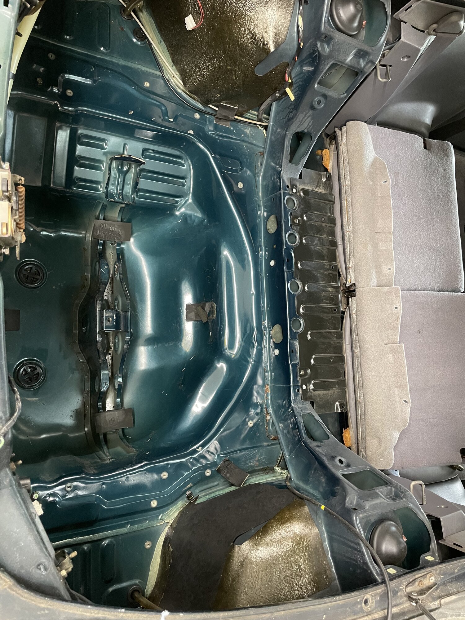

  • Completely gutted, cleaned, and reinstalled interior twice due to rats making a nice home under the spare tire. 1st time this happened was in 2017-2018 and I didnt notice for a few weeks. 2nd time was this year and I was able to catch it and remedy the issue within a day or two of noticing signs of rats again. Luckily, only damage was a wire chewed that was meant to connect a CD changer to the stock Infinity amp.

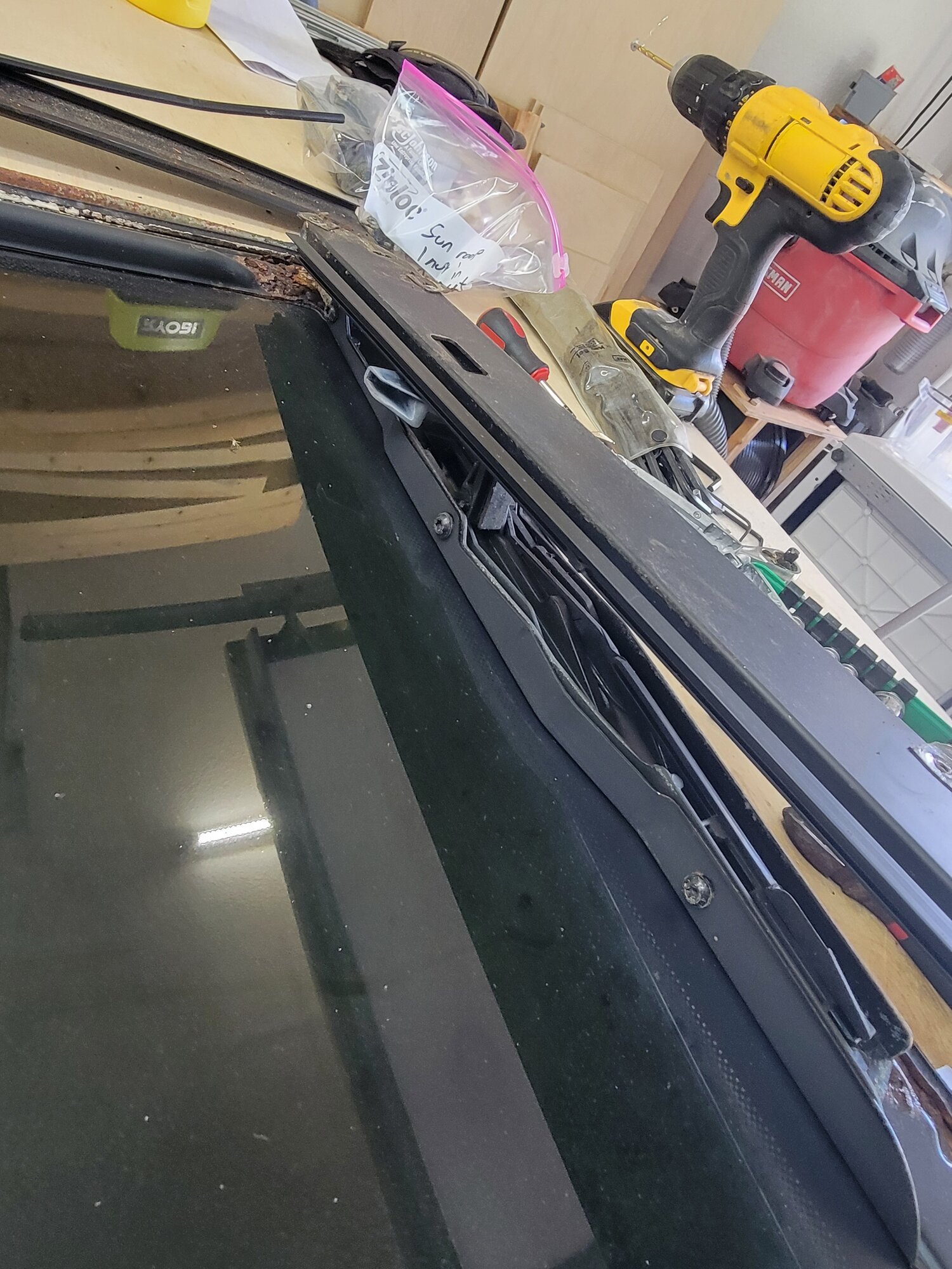

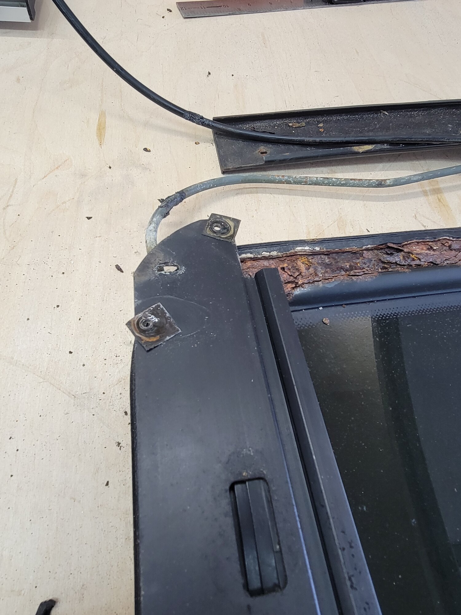

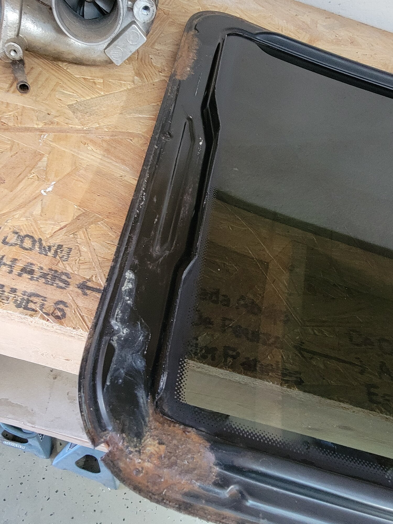

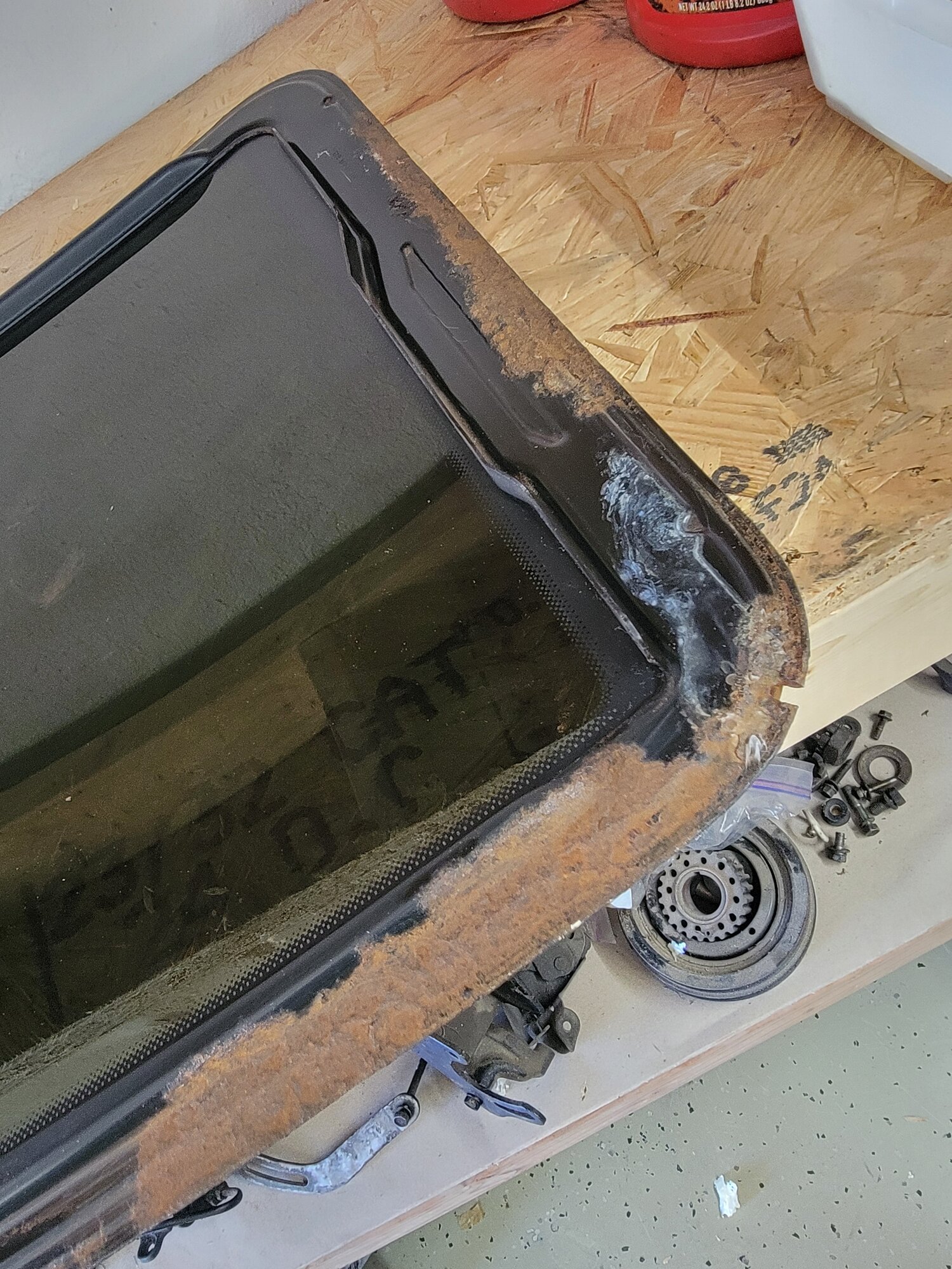

  • Restored headliner, visors, and sunroof

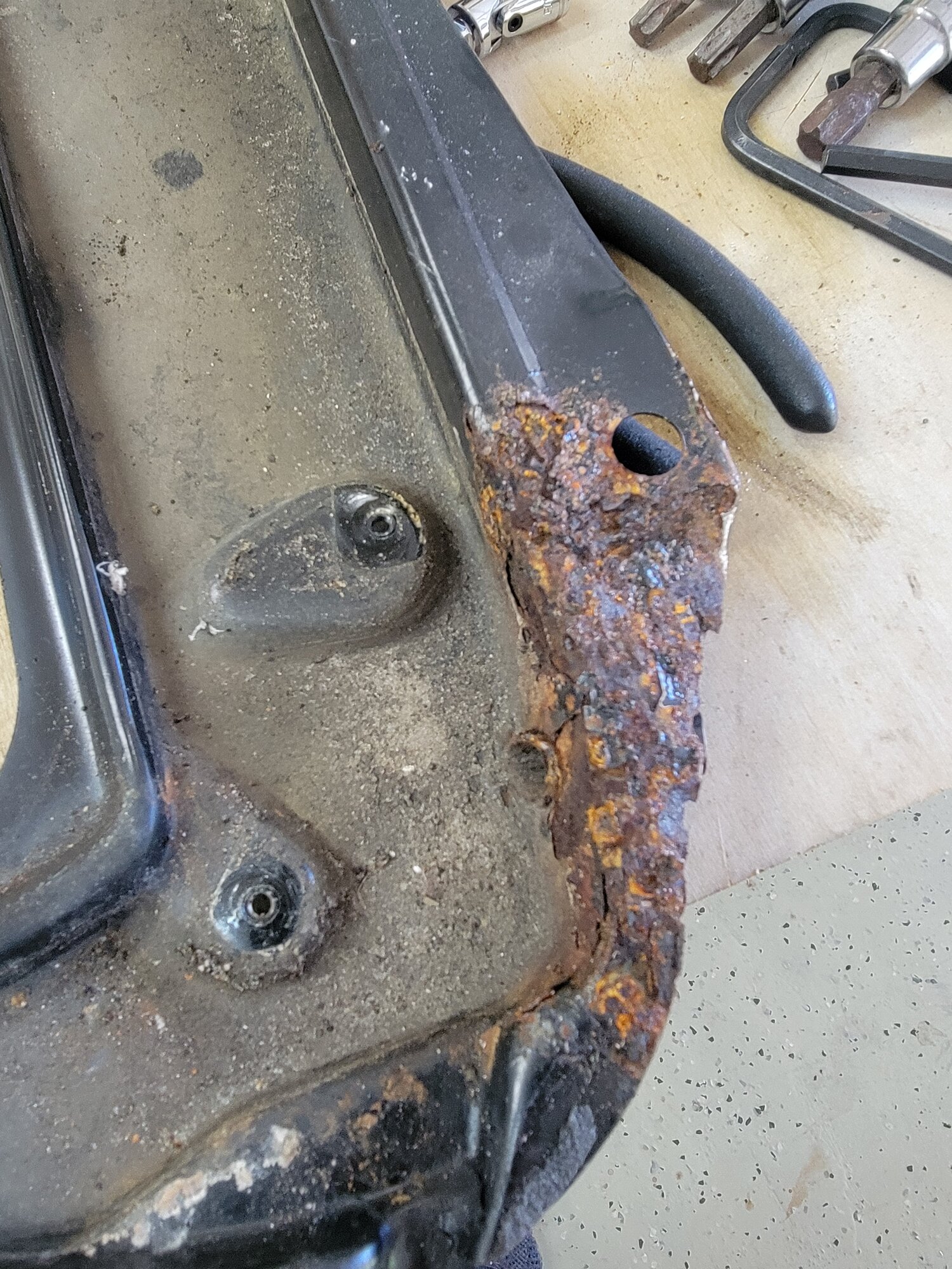

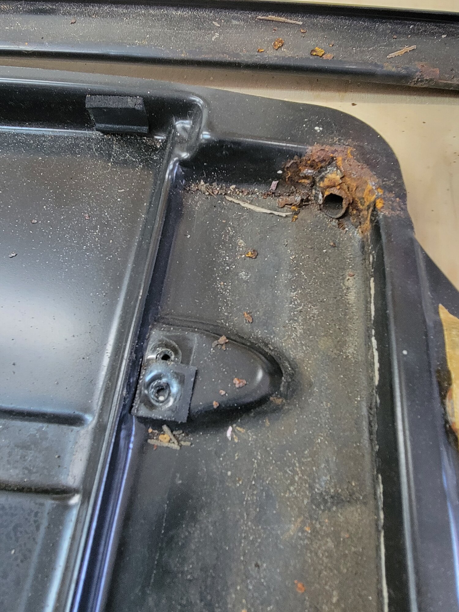

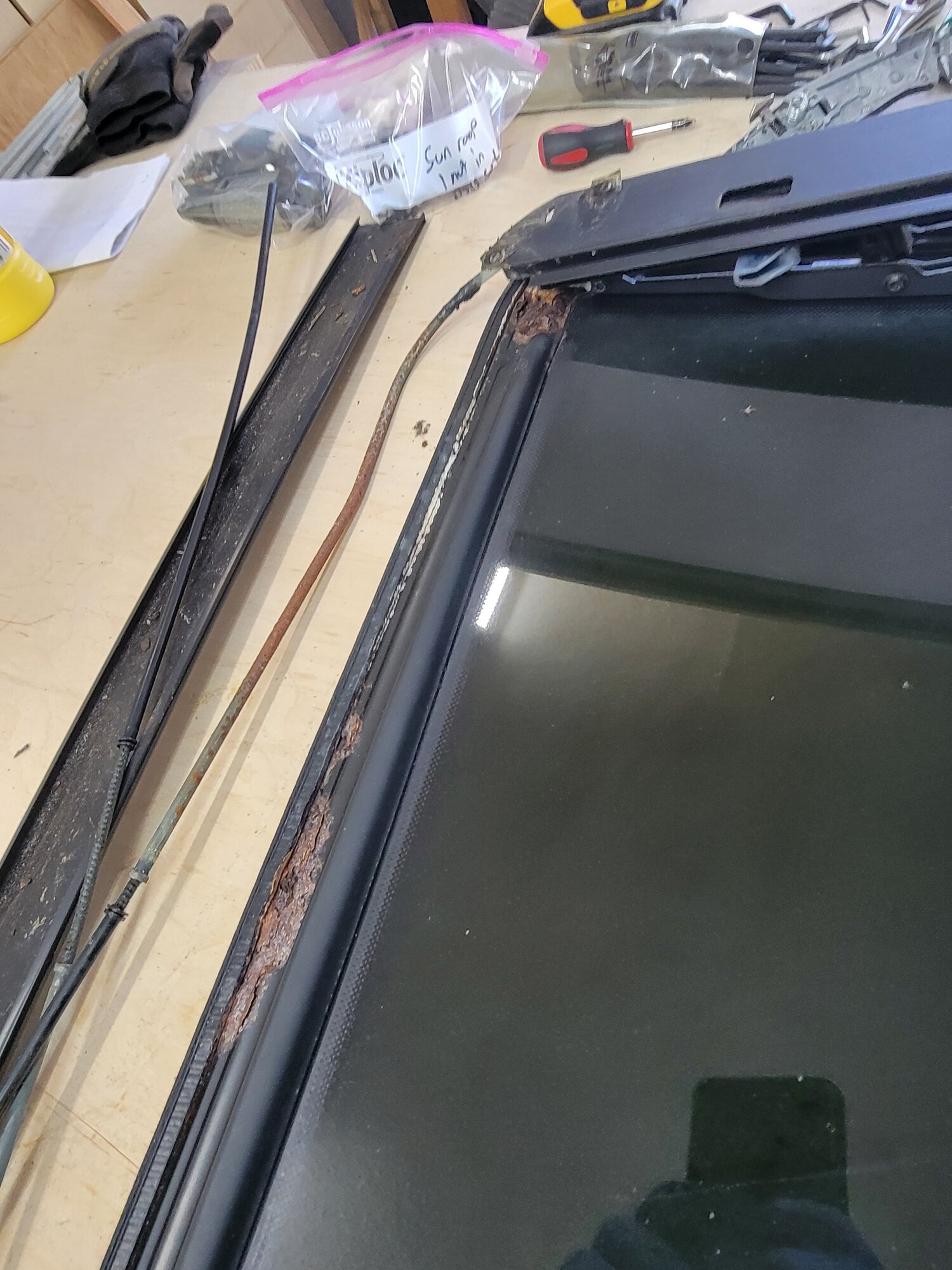

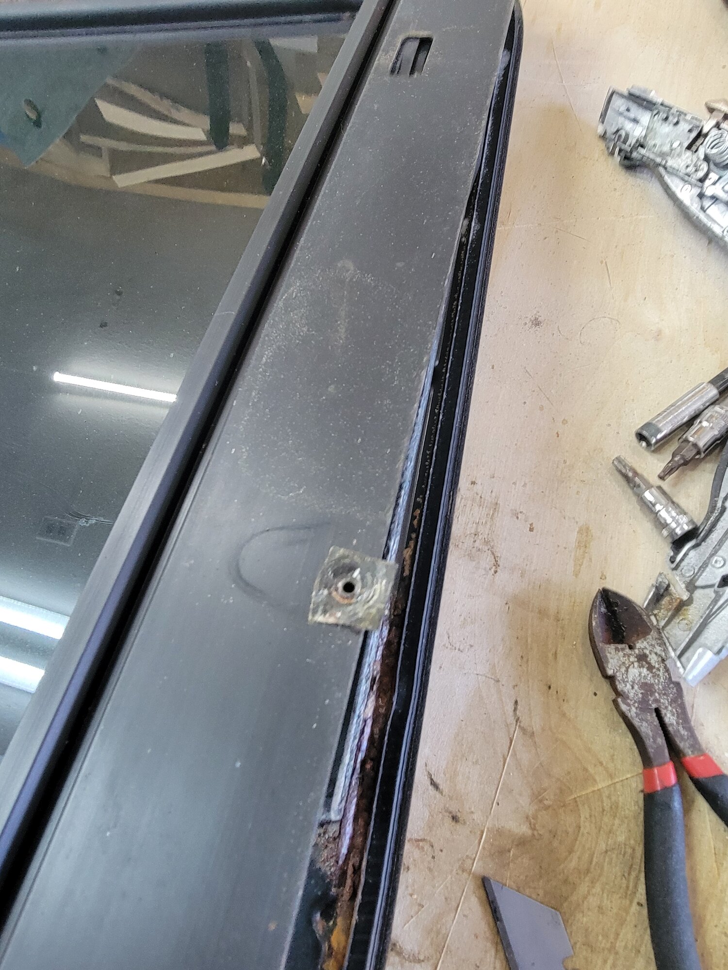

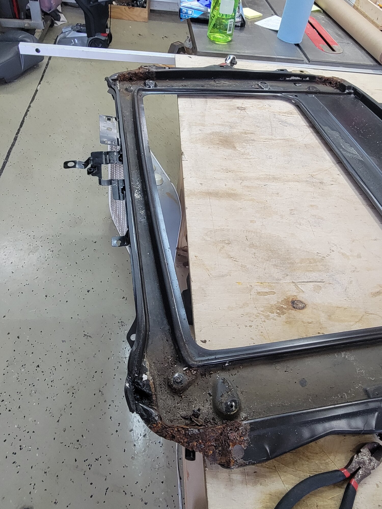

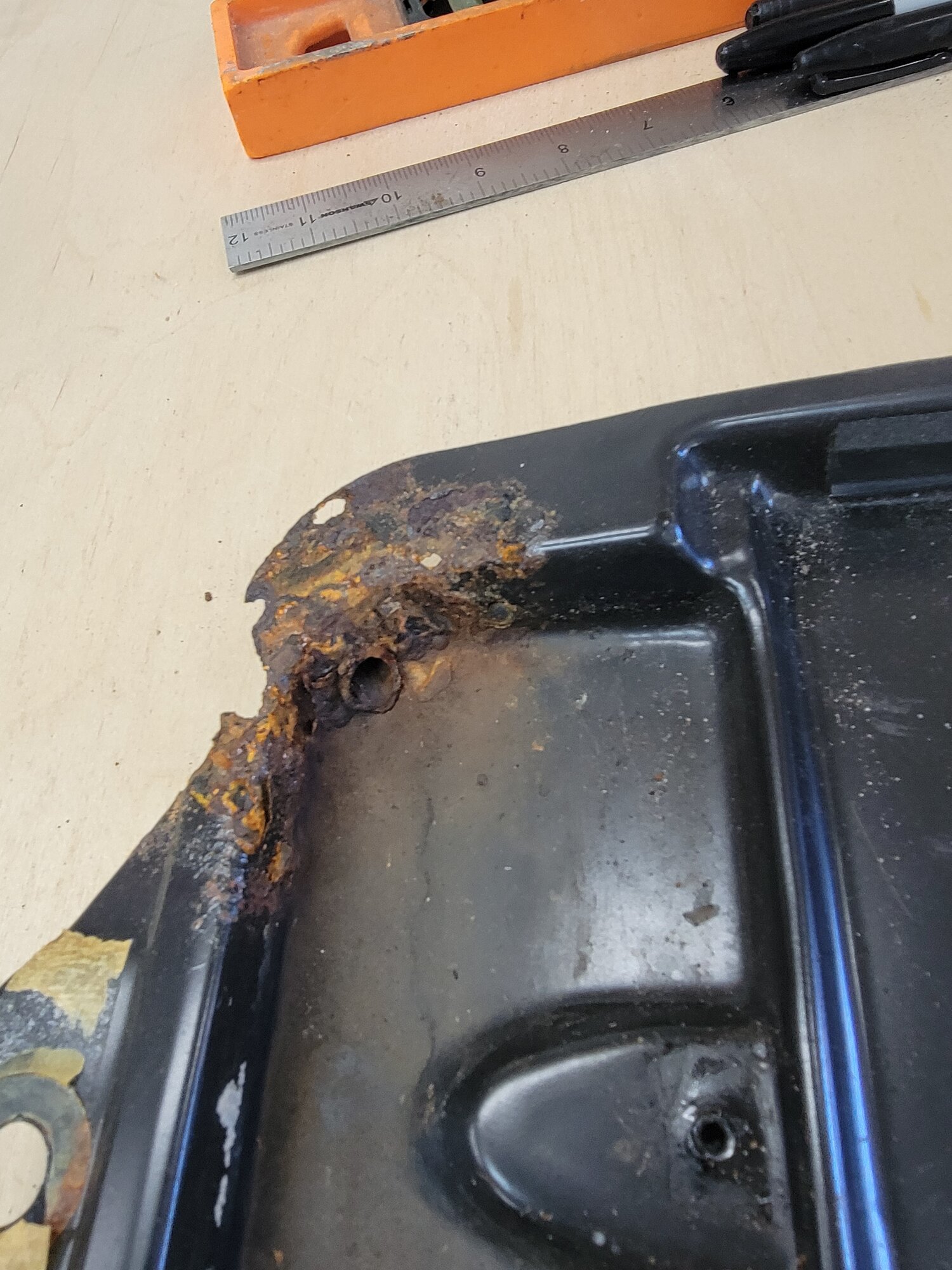

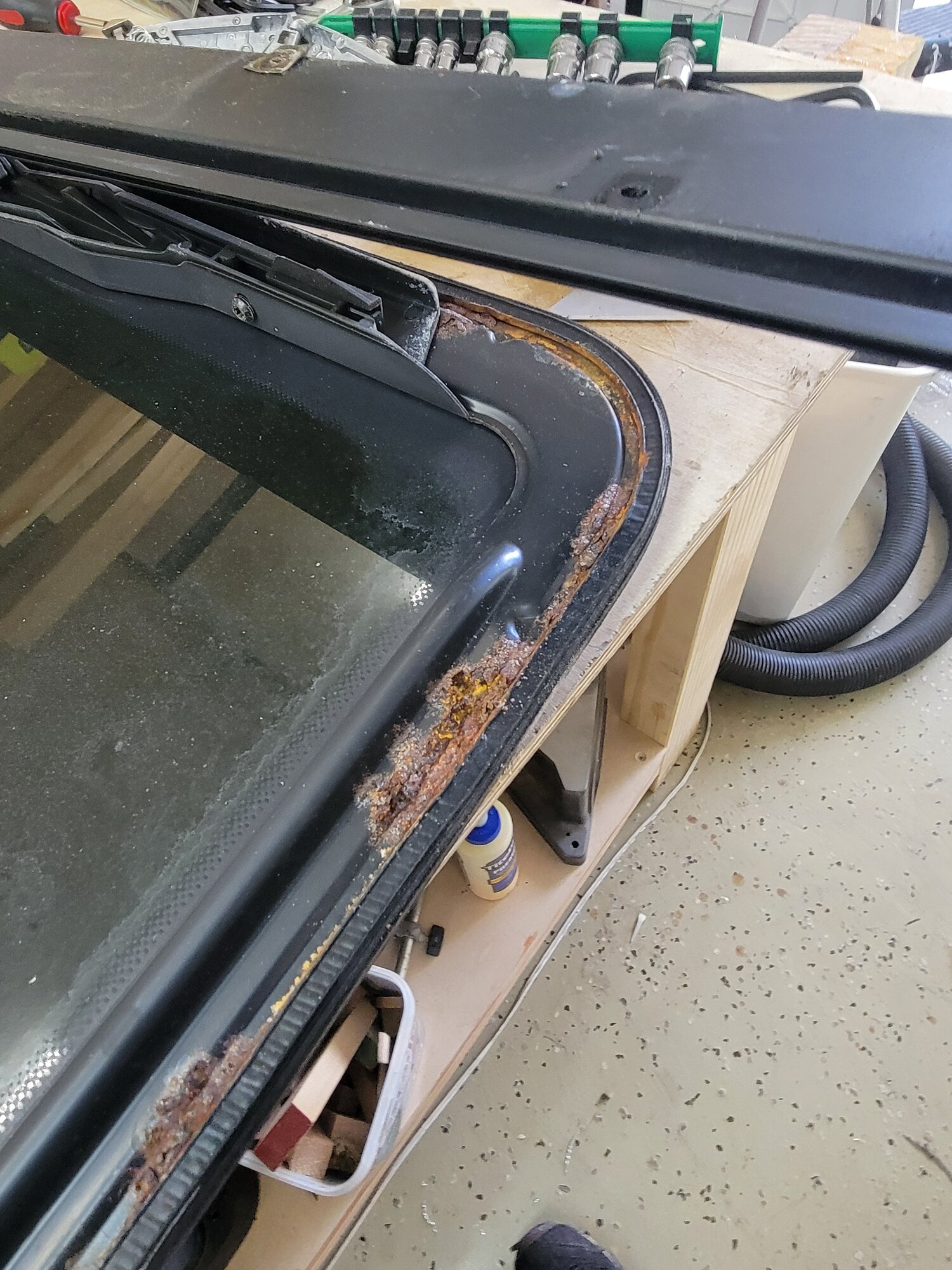

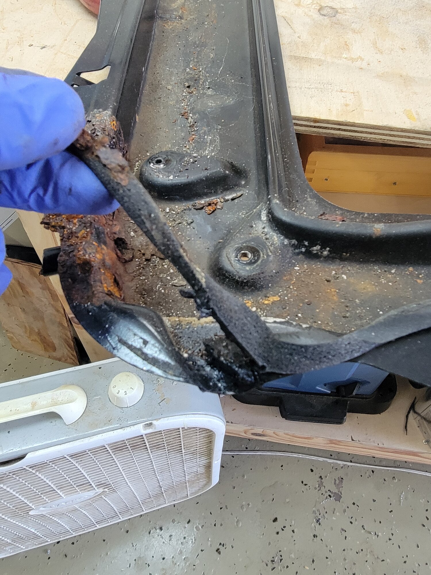

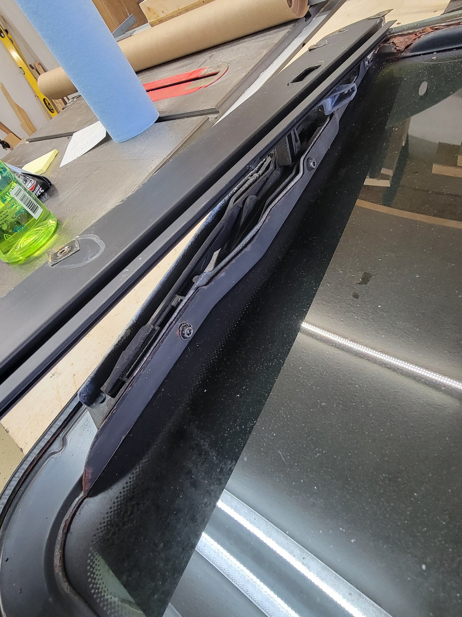

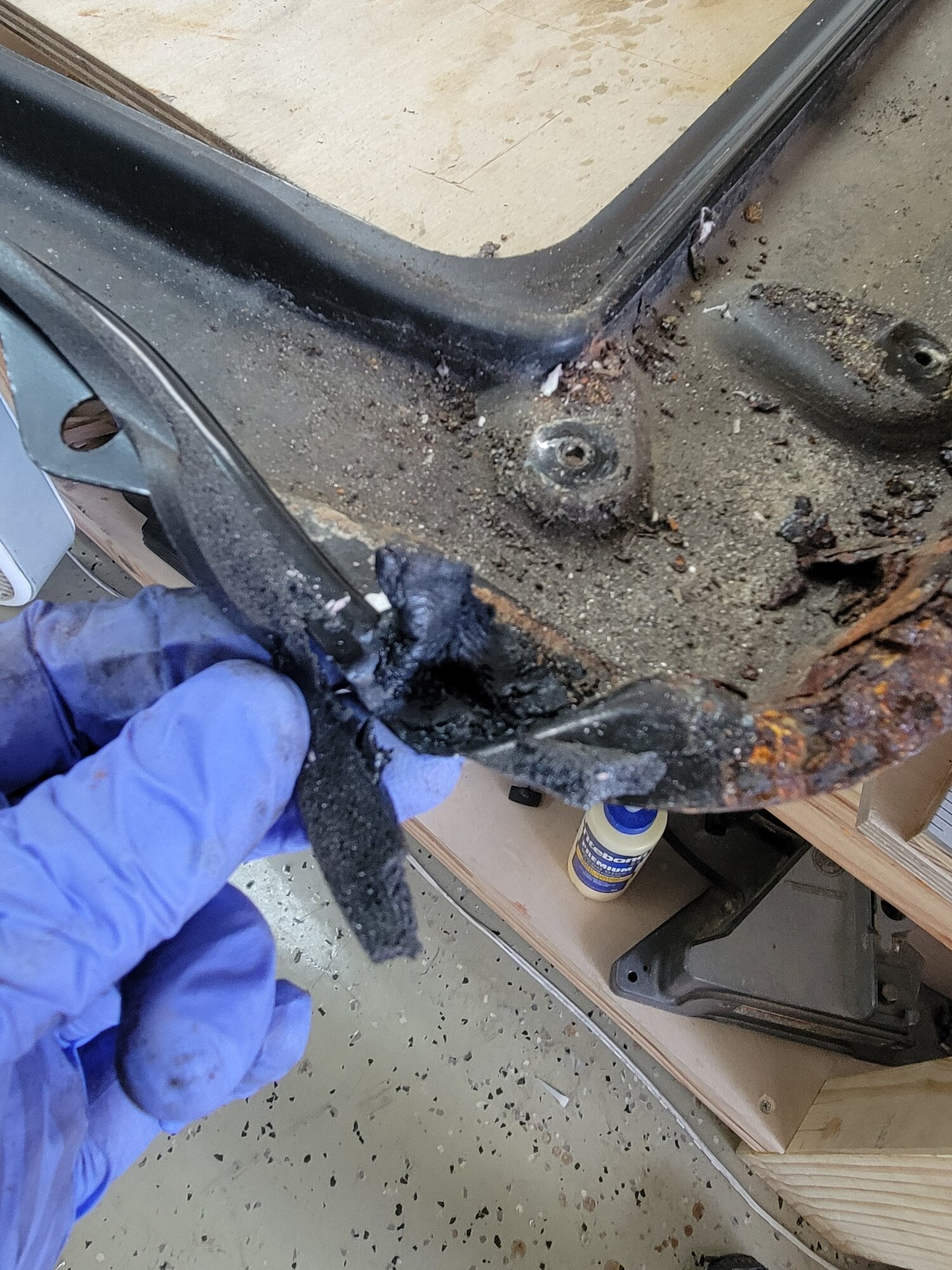

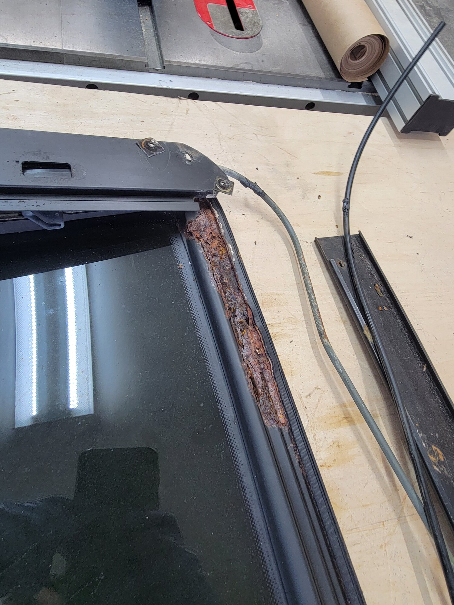

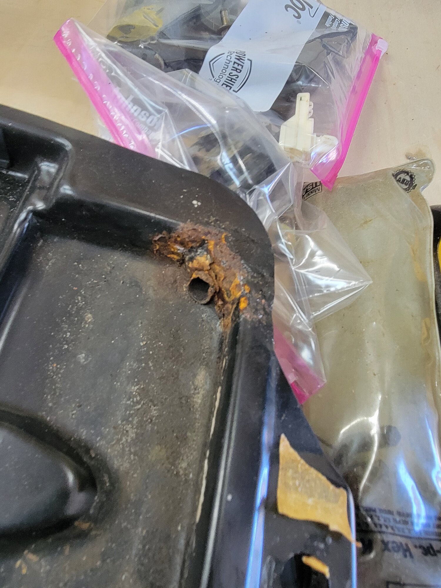

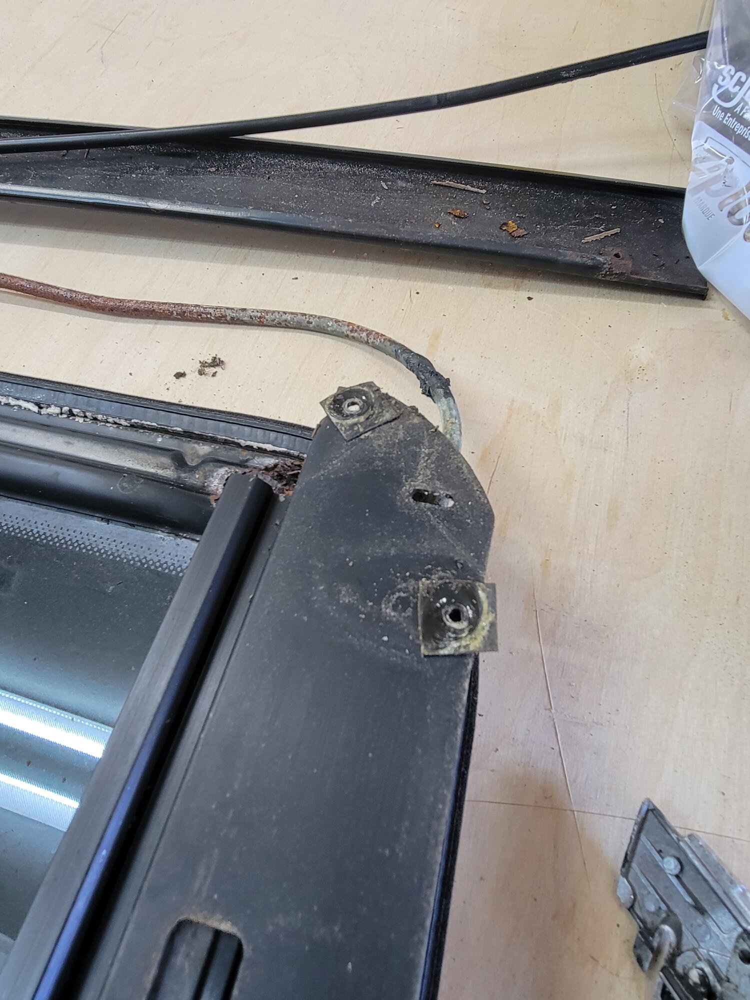

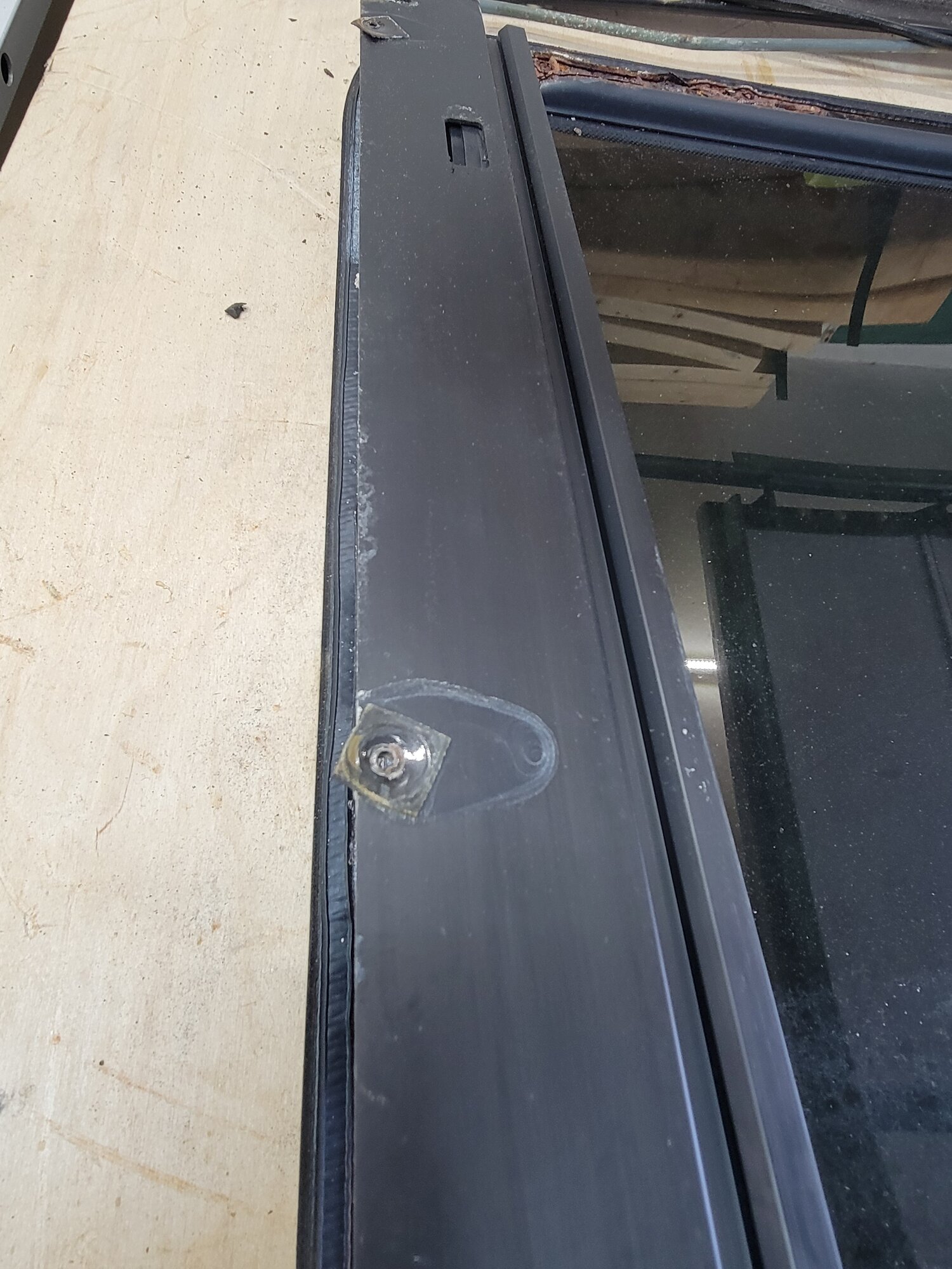

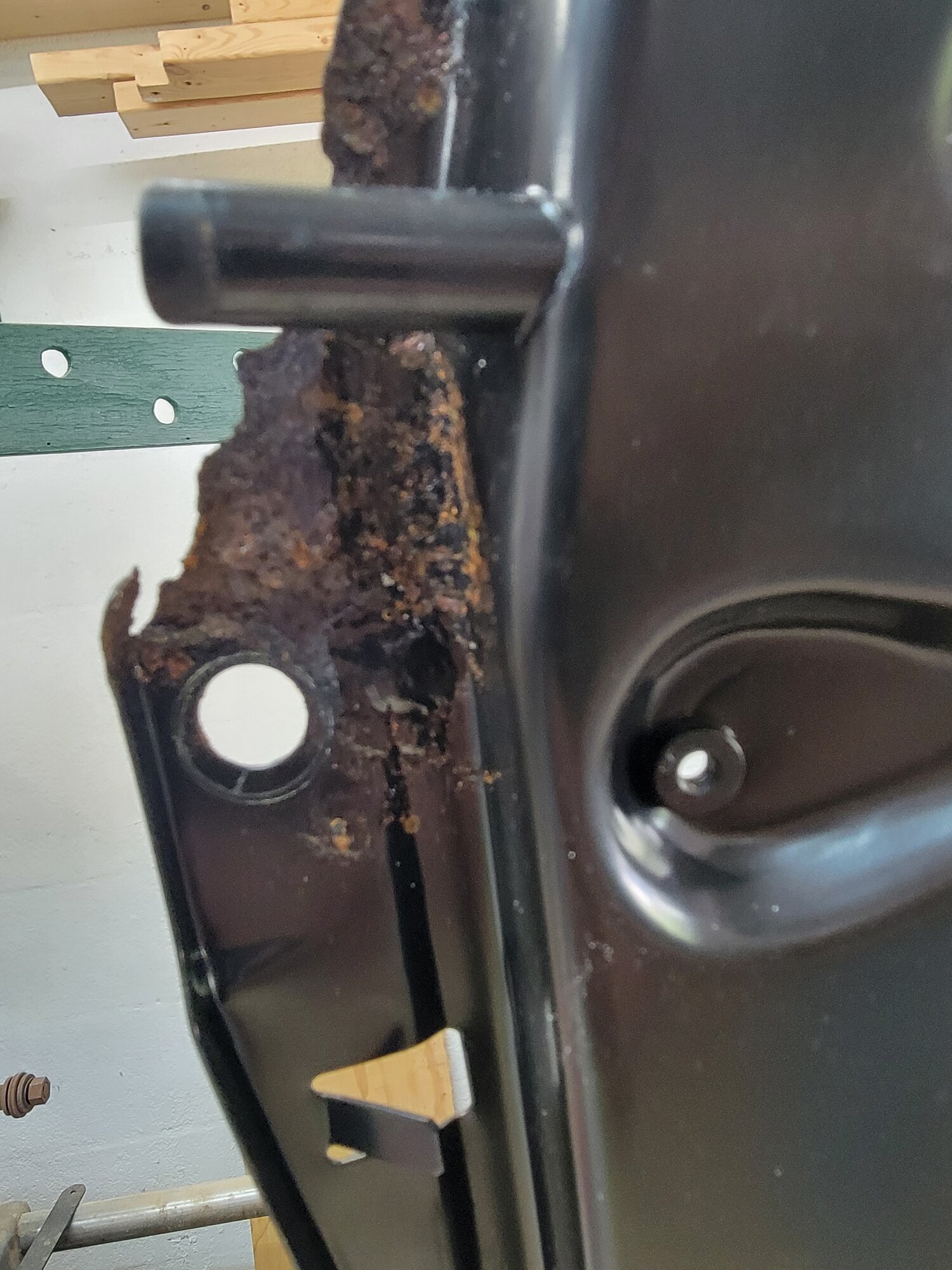

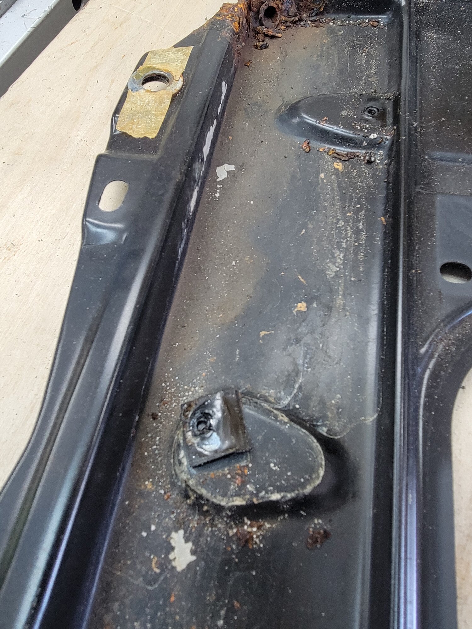

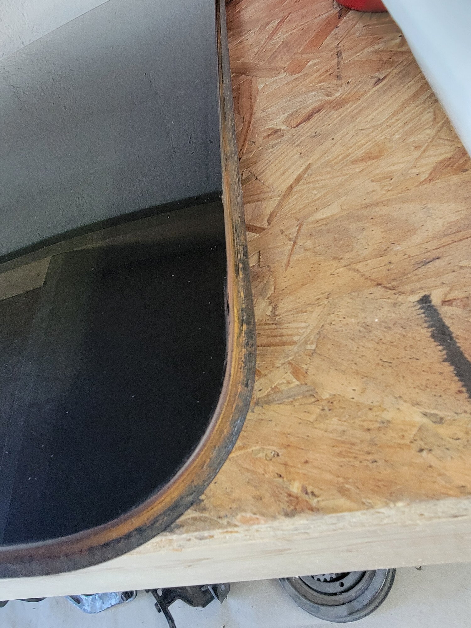

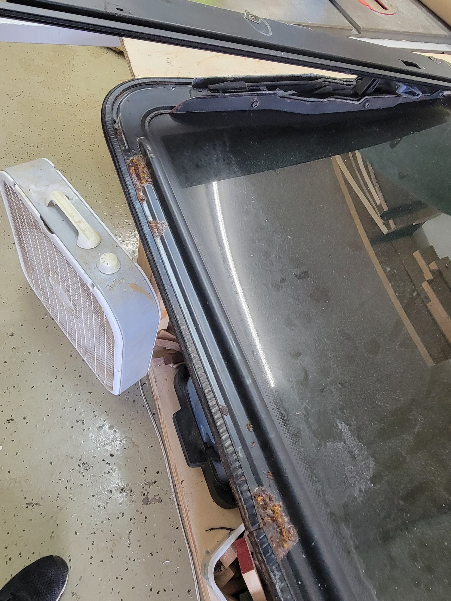

    • Sun roof and track was rusted in corners and repaired. New OEM seal waiting to be installed

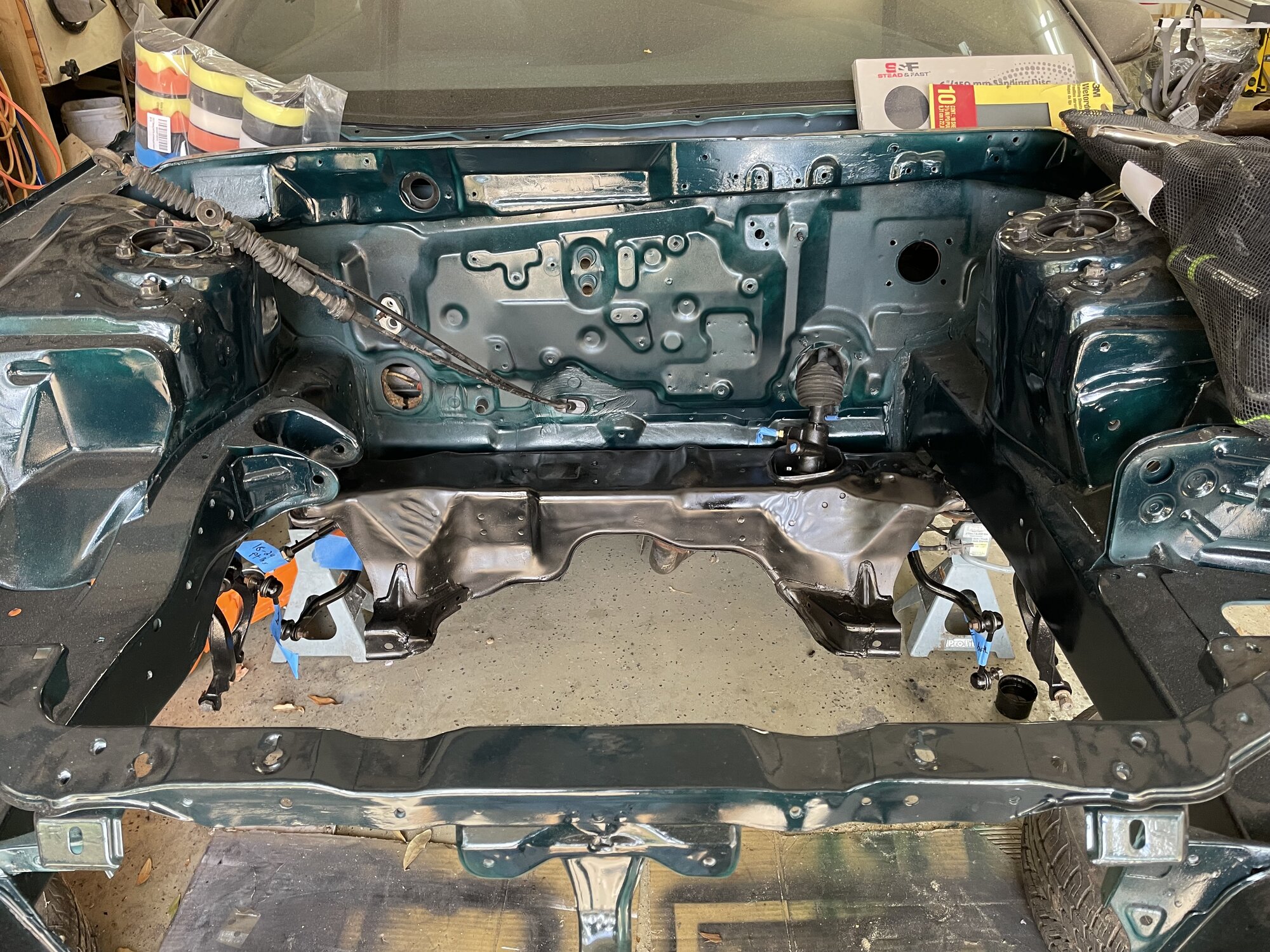

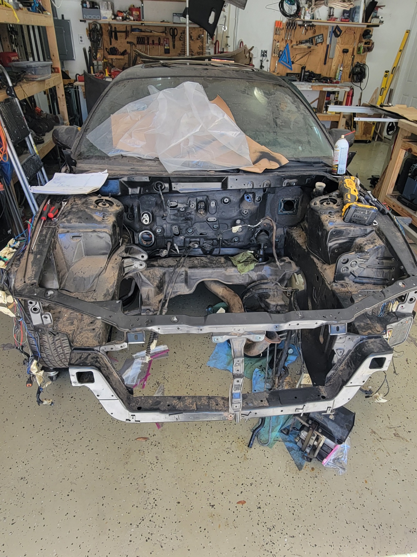

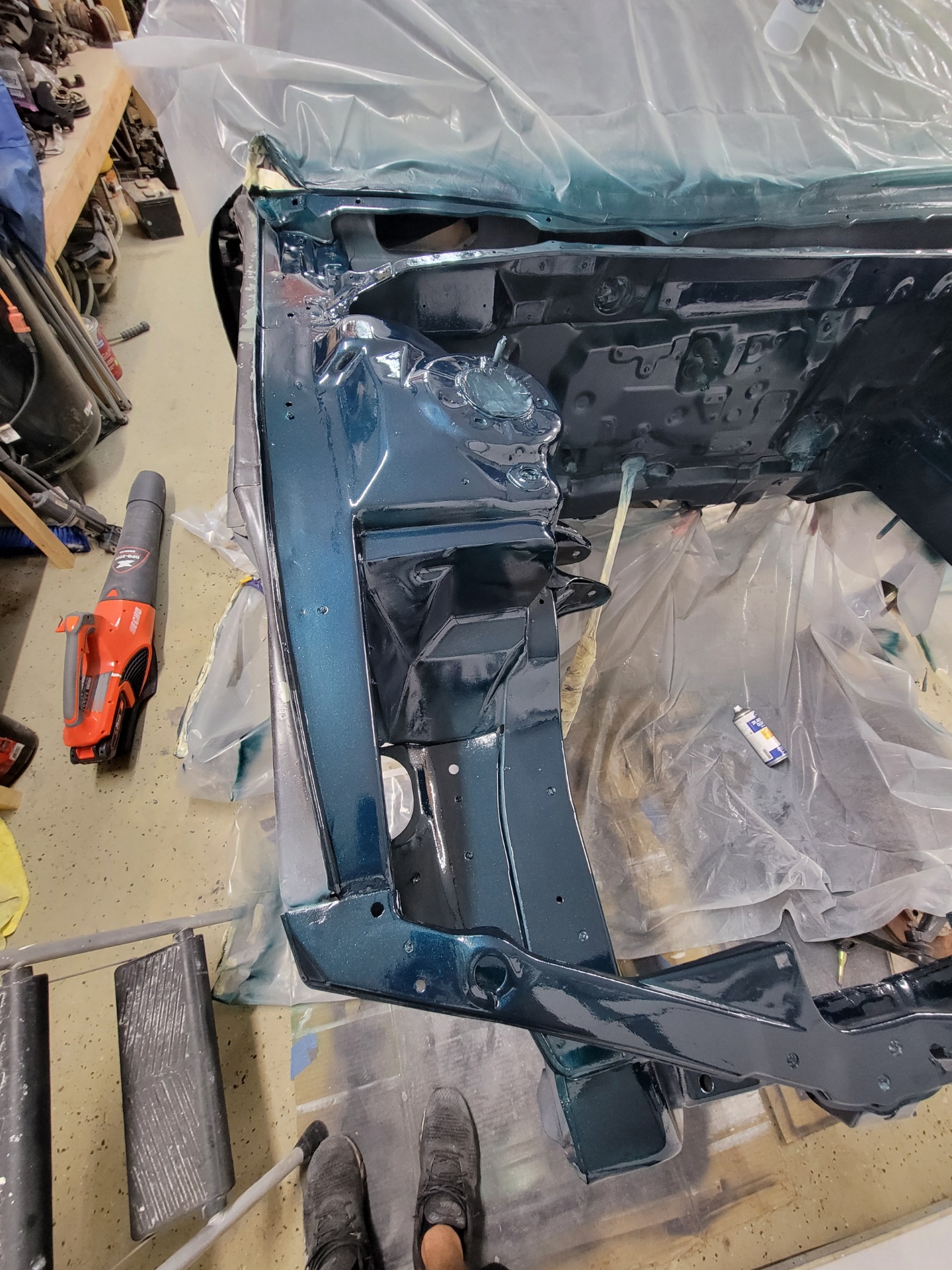

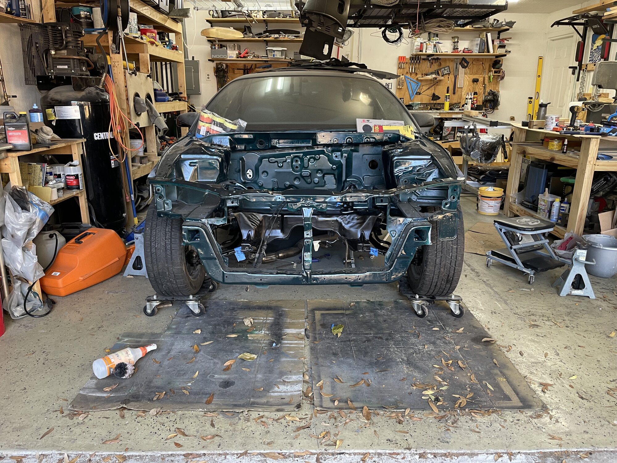

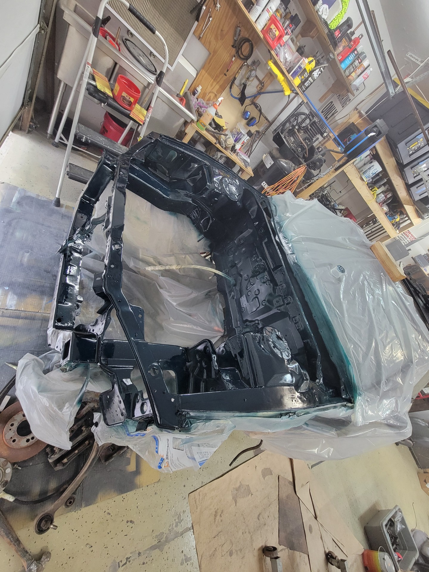

  • Completely gutted engine bay, did some minor shaving to get a feel for body work, and painted it back to the factory green color.

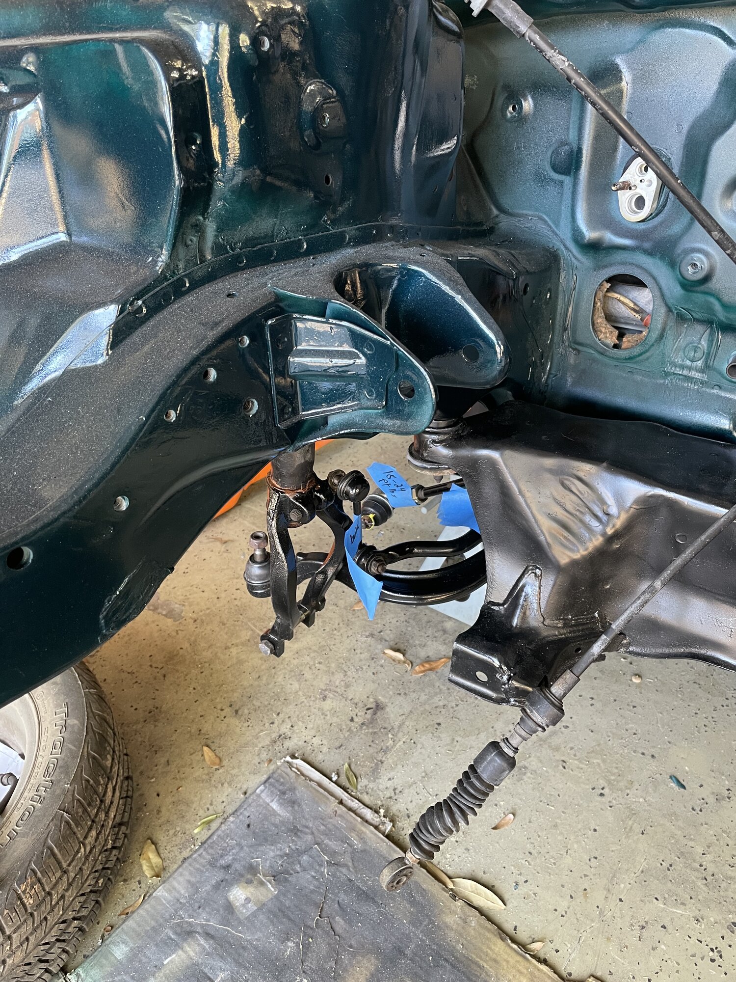

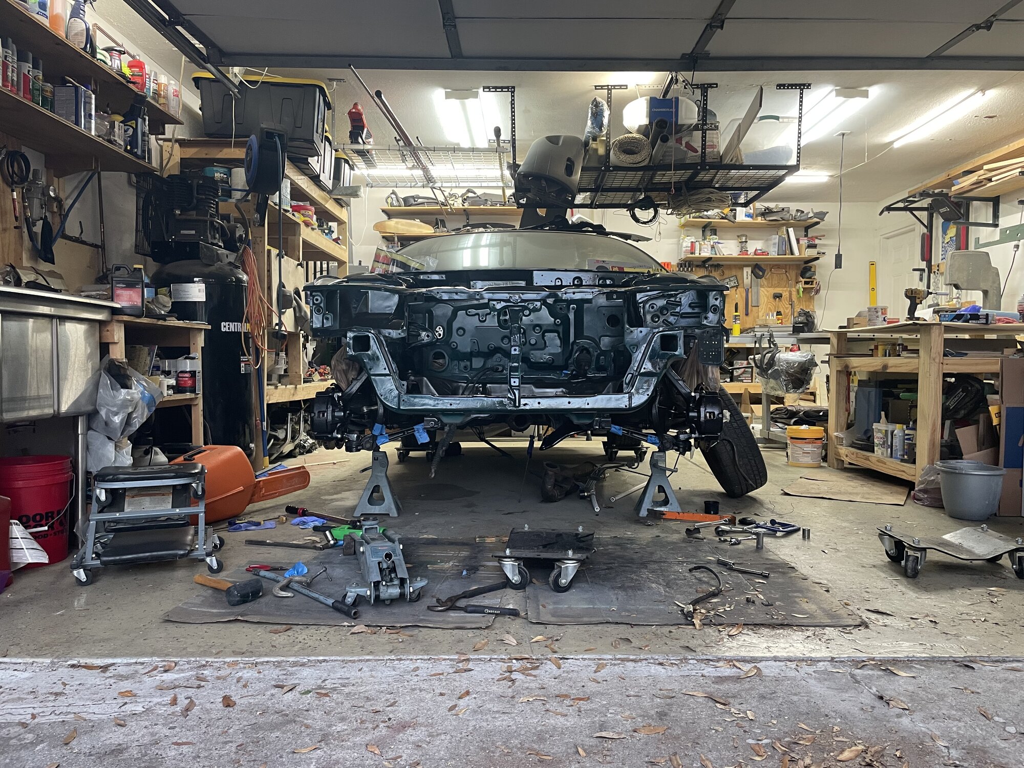

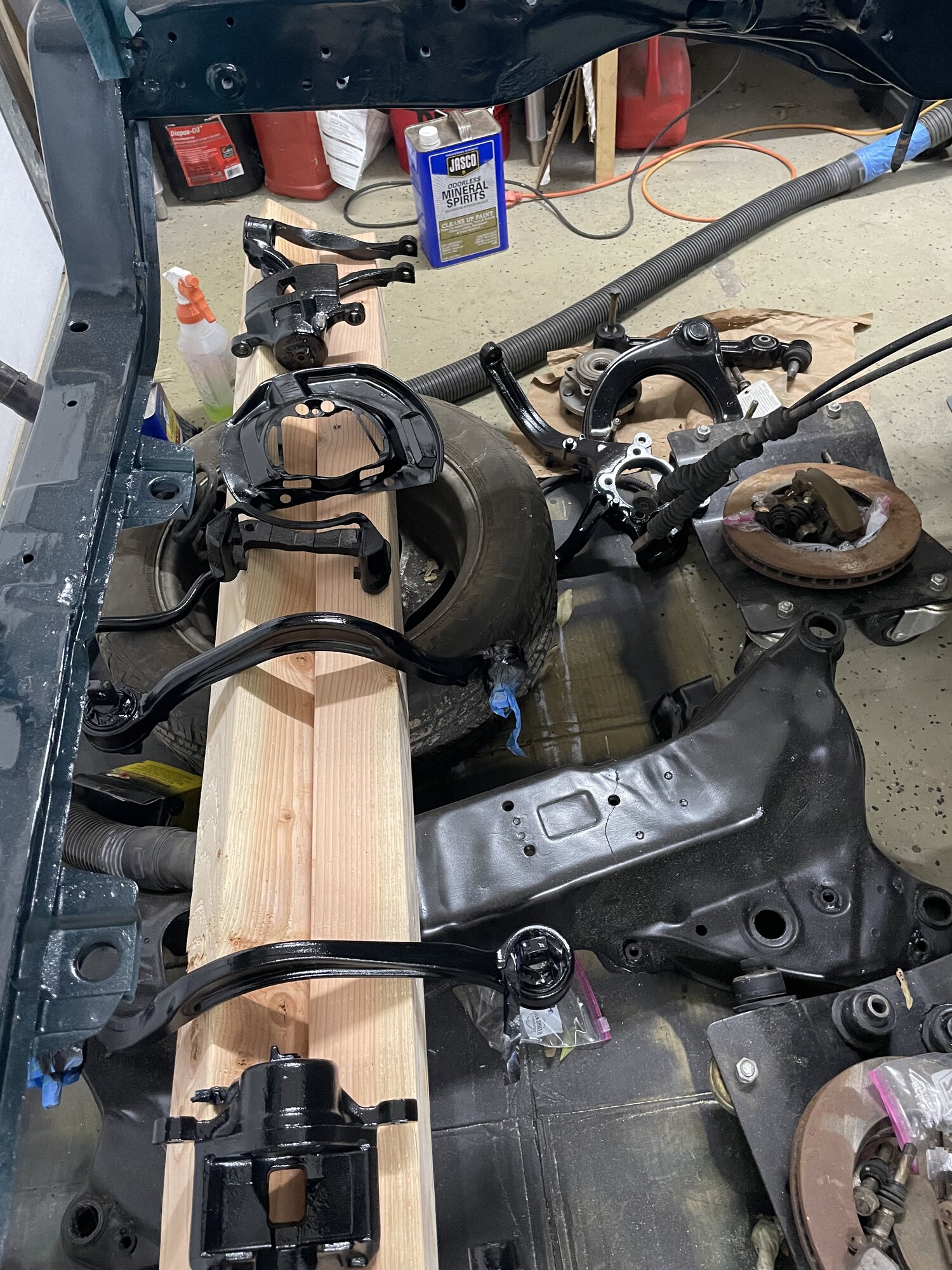

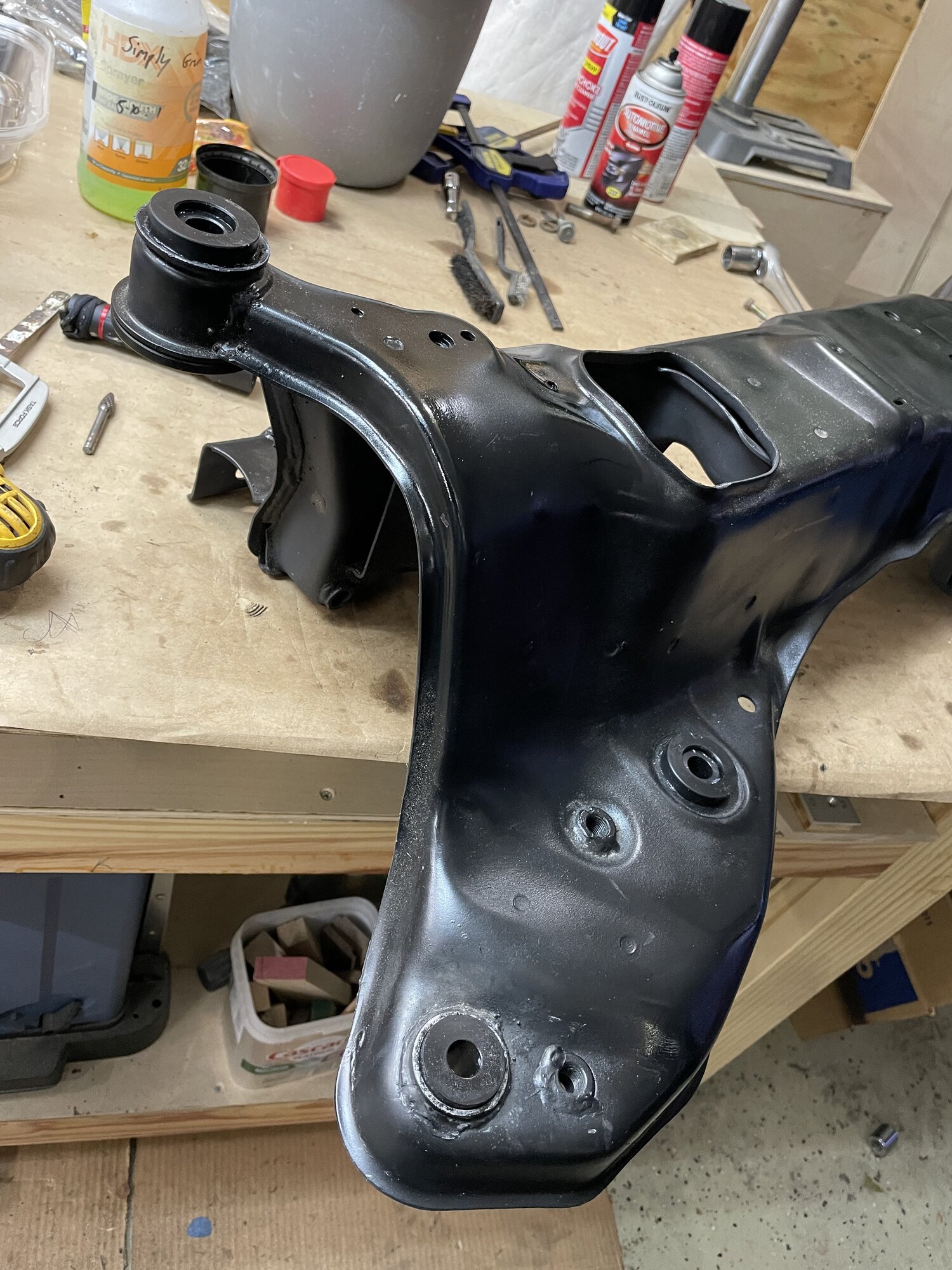

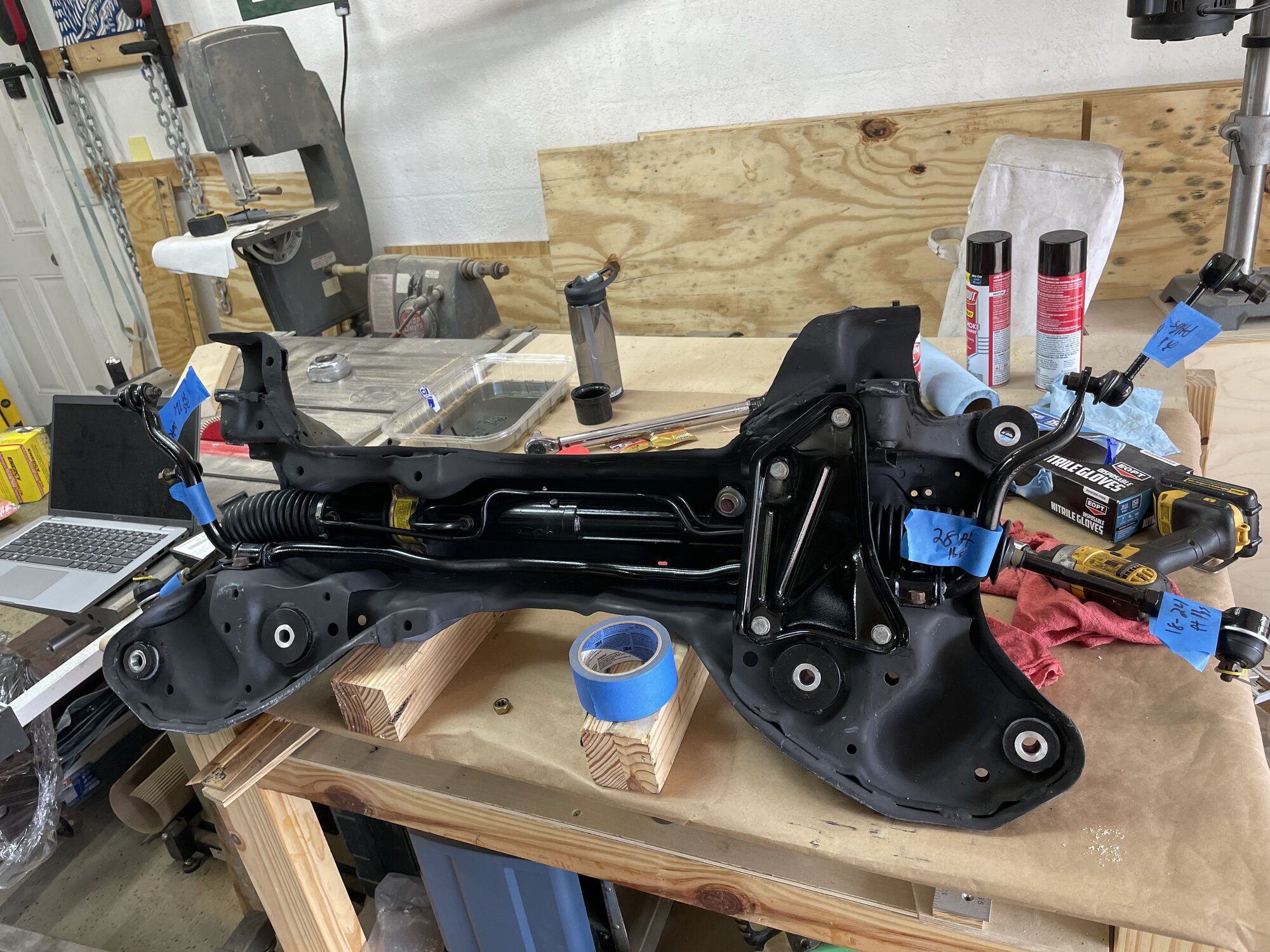

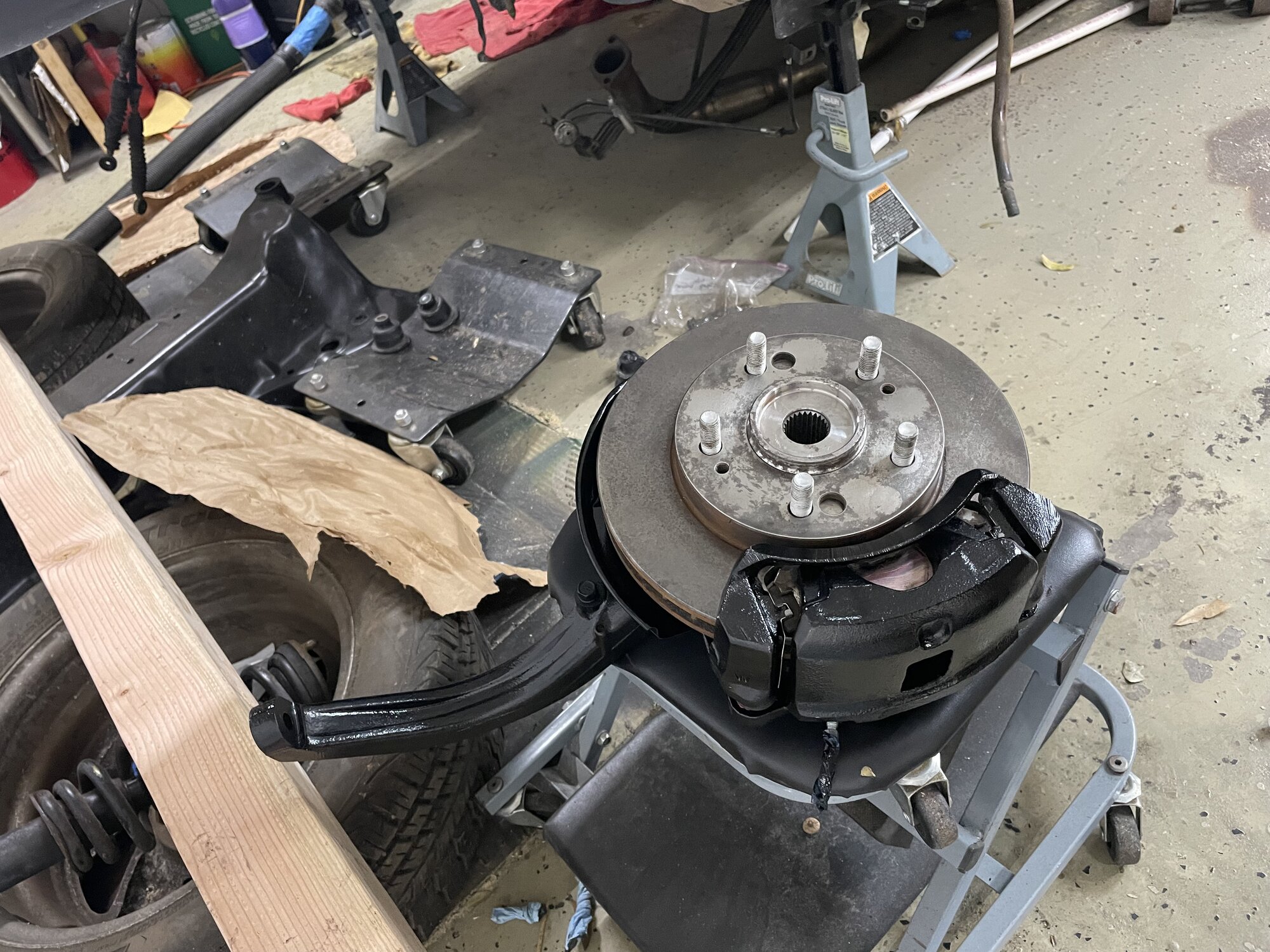

  • Removed front end suspension, subframe, rack and pinion, and replaced basically every rubber part, seal, gasket with OEM parts

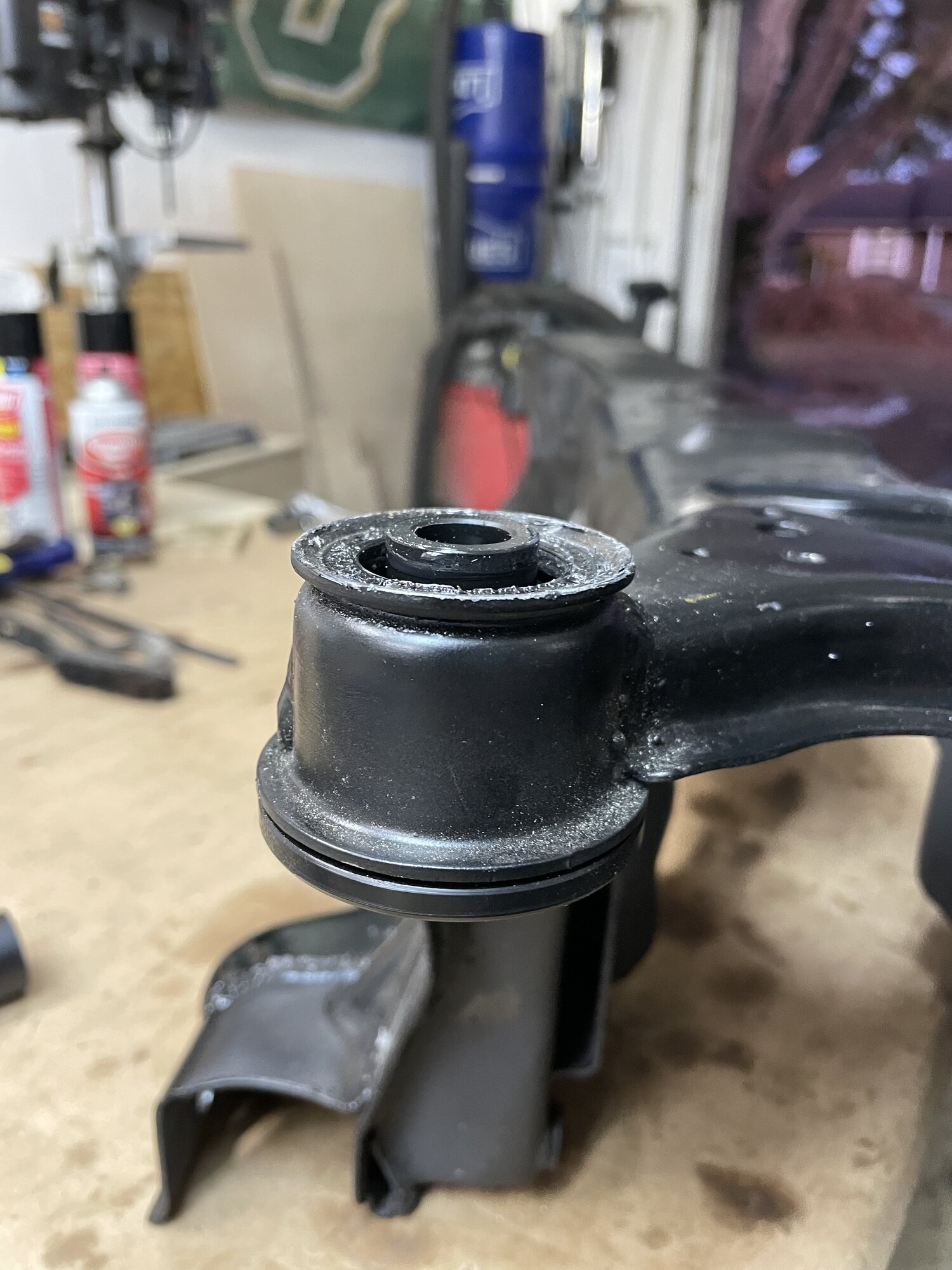

    • Using energy suspension master bushing kit to replace bushings along the way
      • These have all been installed using a ball joint press and some blocks of wood to prevent the bushing from popping out one side. After a couple, I was press these in pretty fast.
    • POM front subframe bushings
      • Ball joint press is all thats needed for these

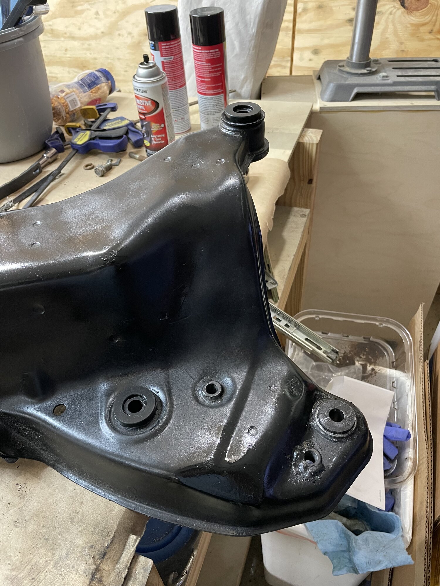

    • Every part was inspected, cleaned, greased, treated for rust as needed, and received a coat of primer and semi-gloss black for easy cleaning

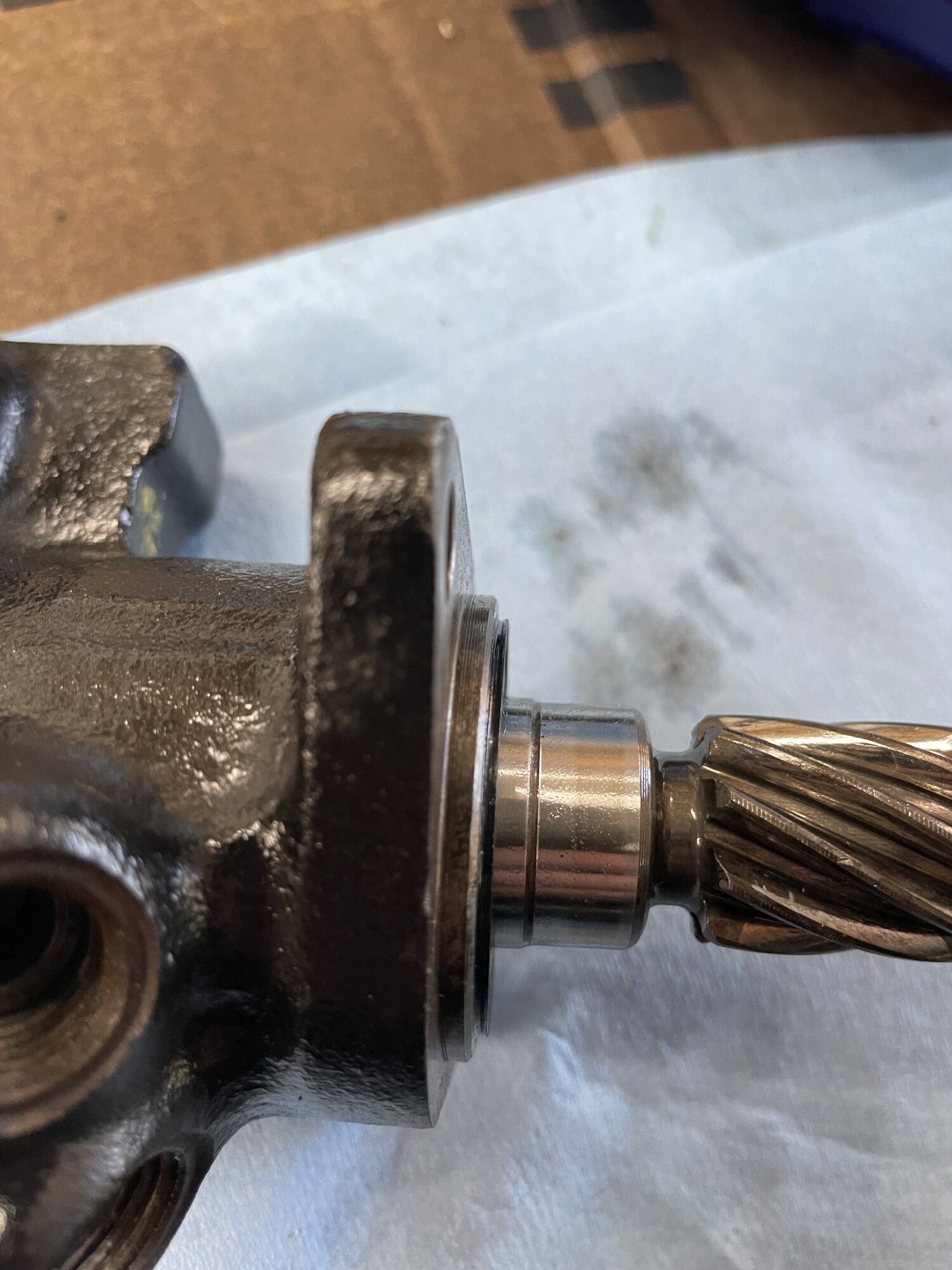

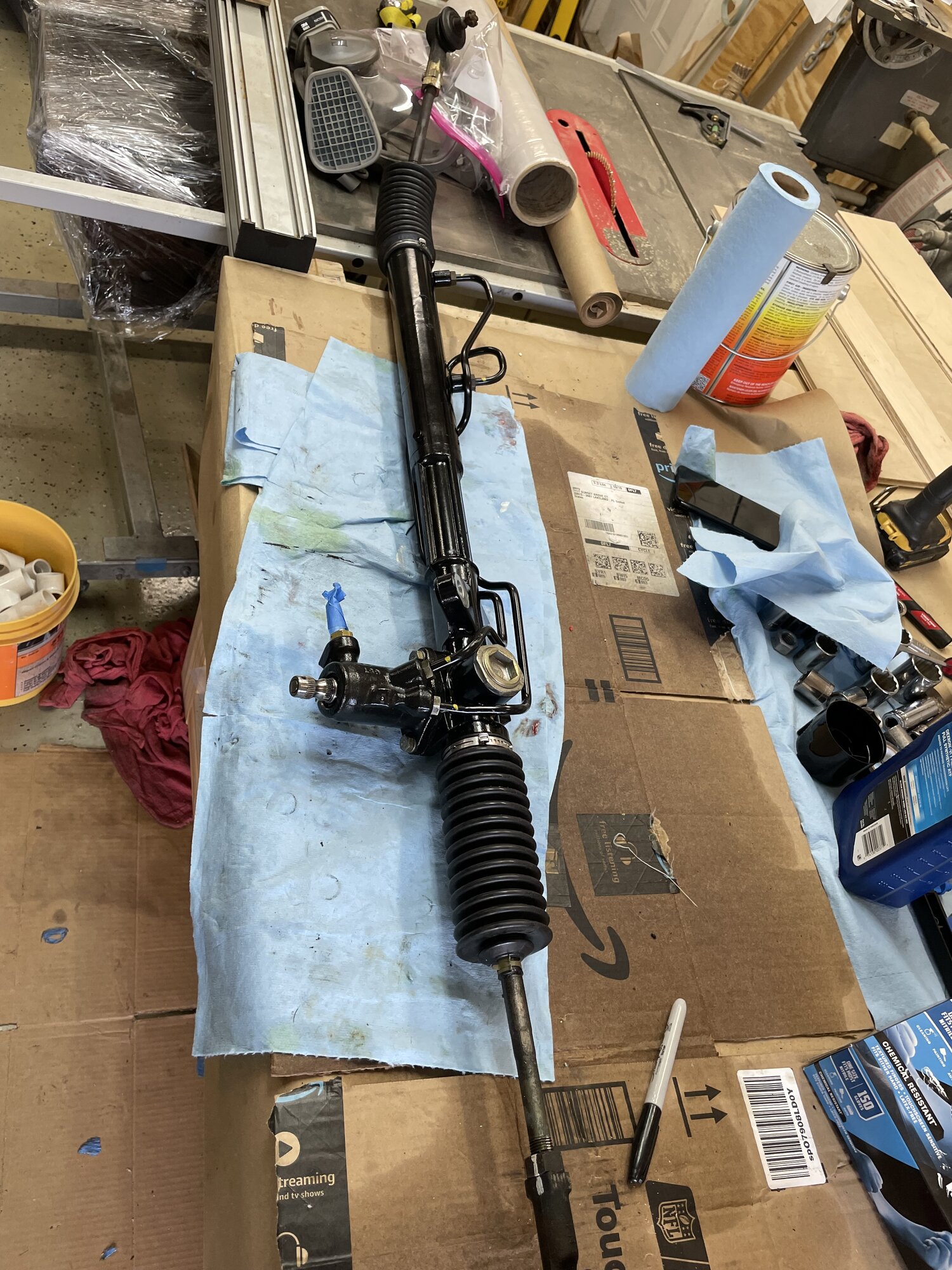

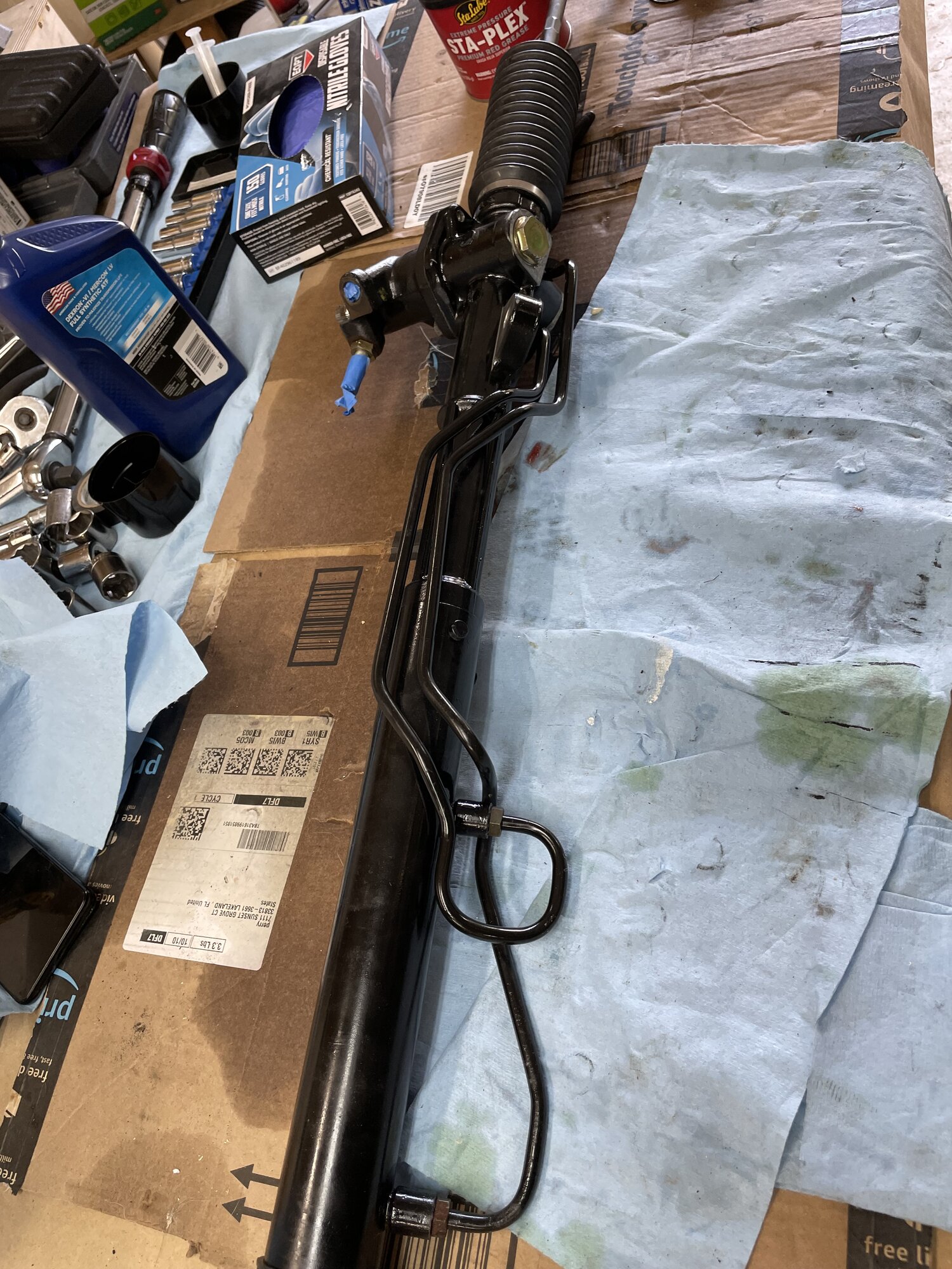

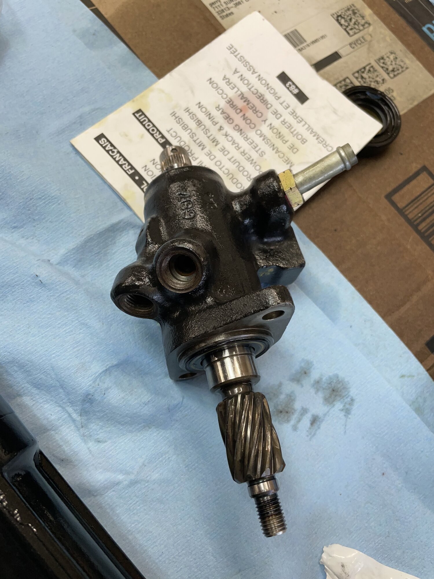

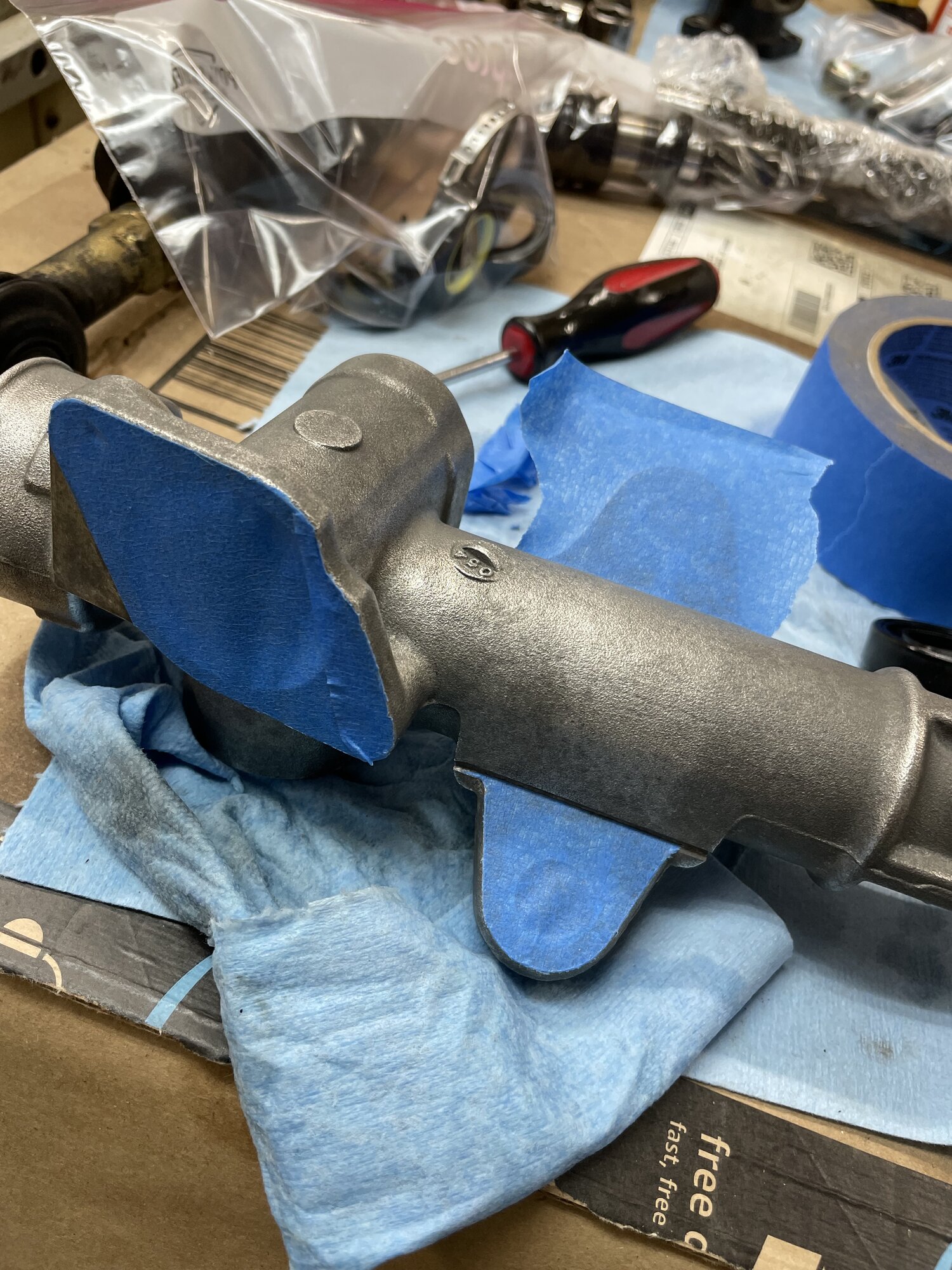

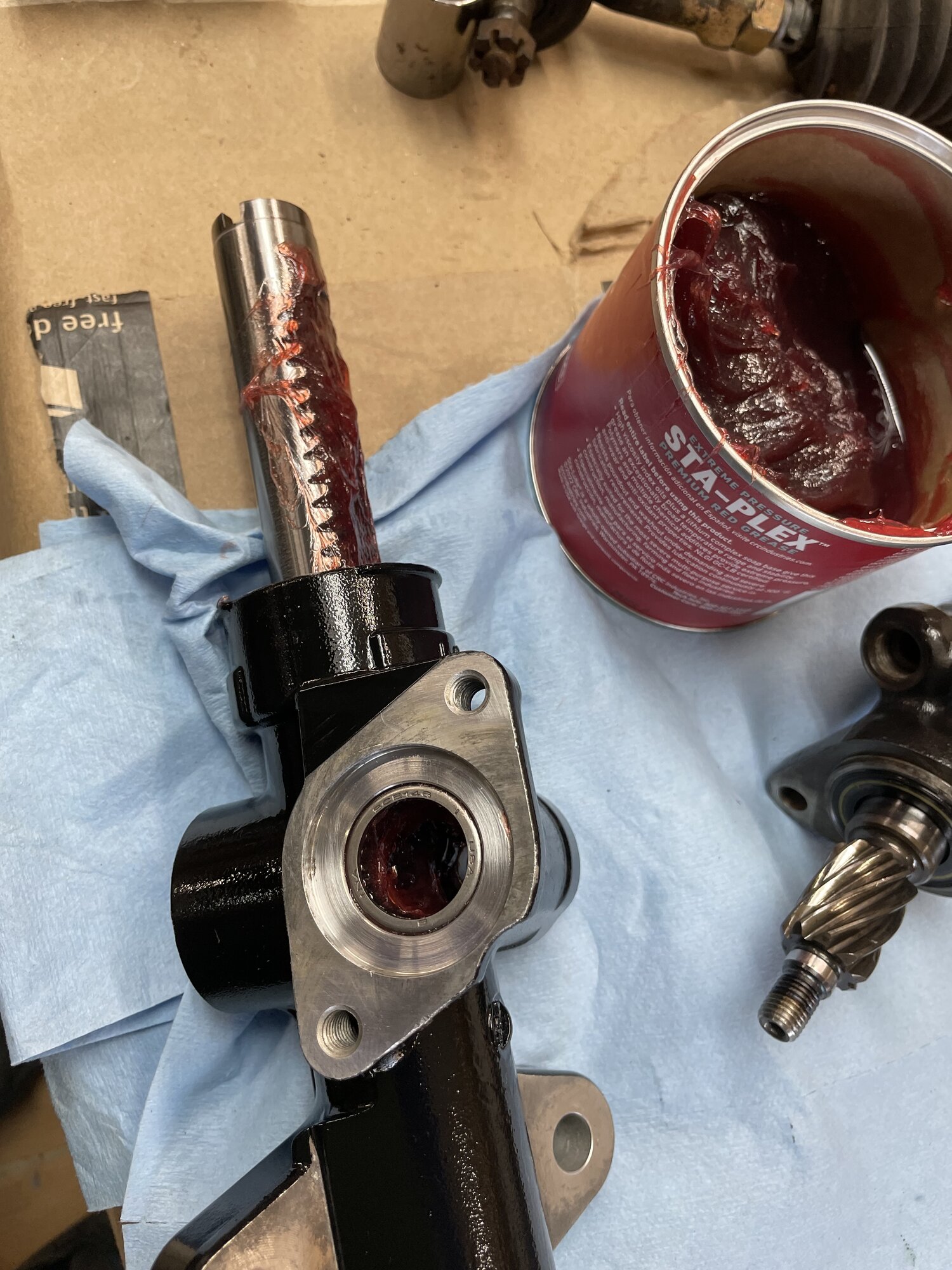

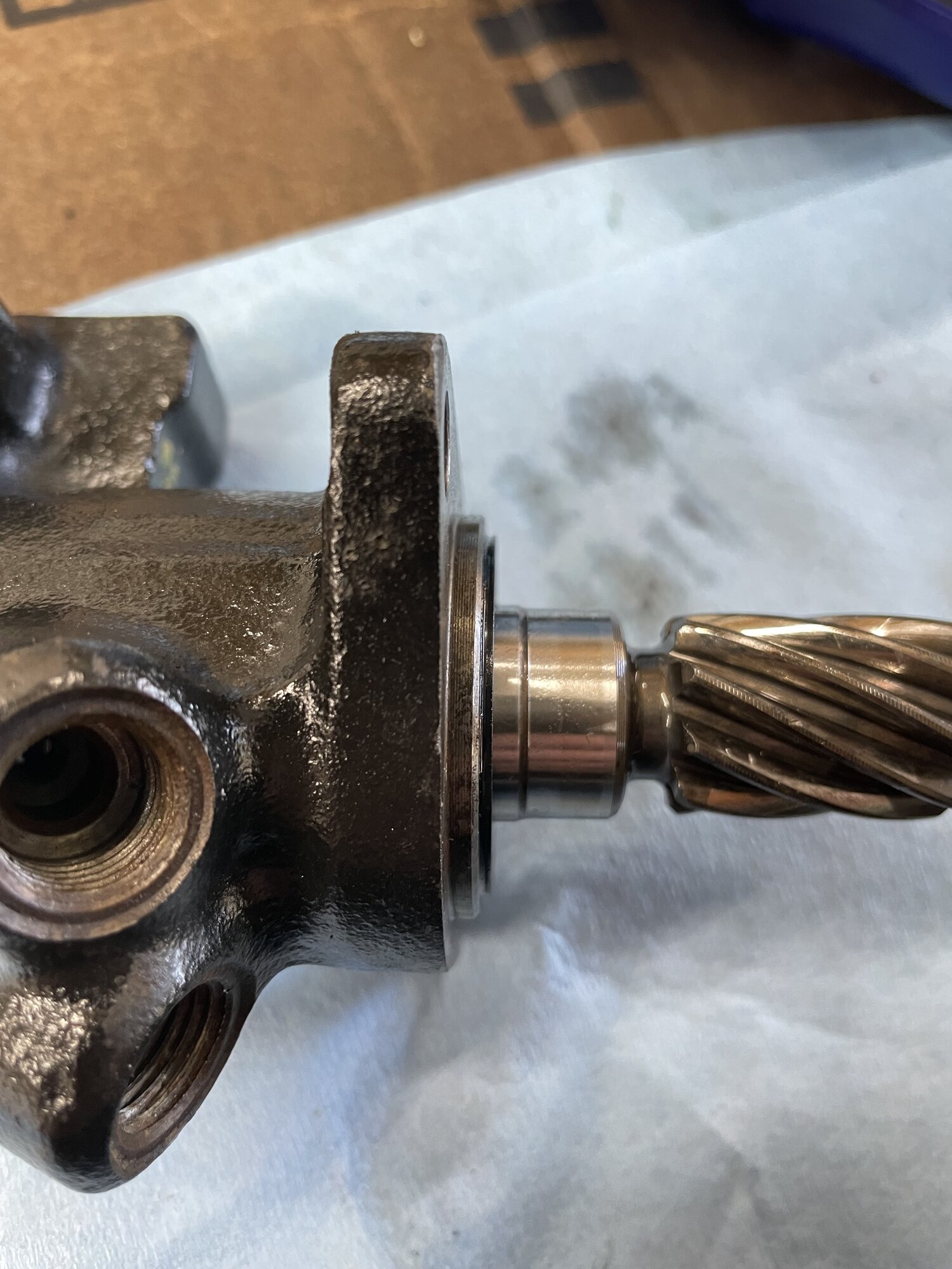

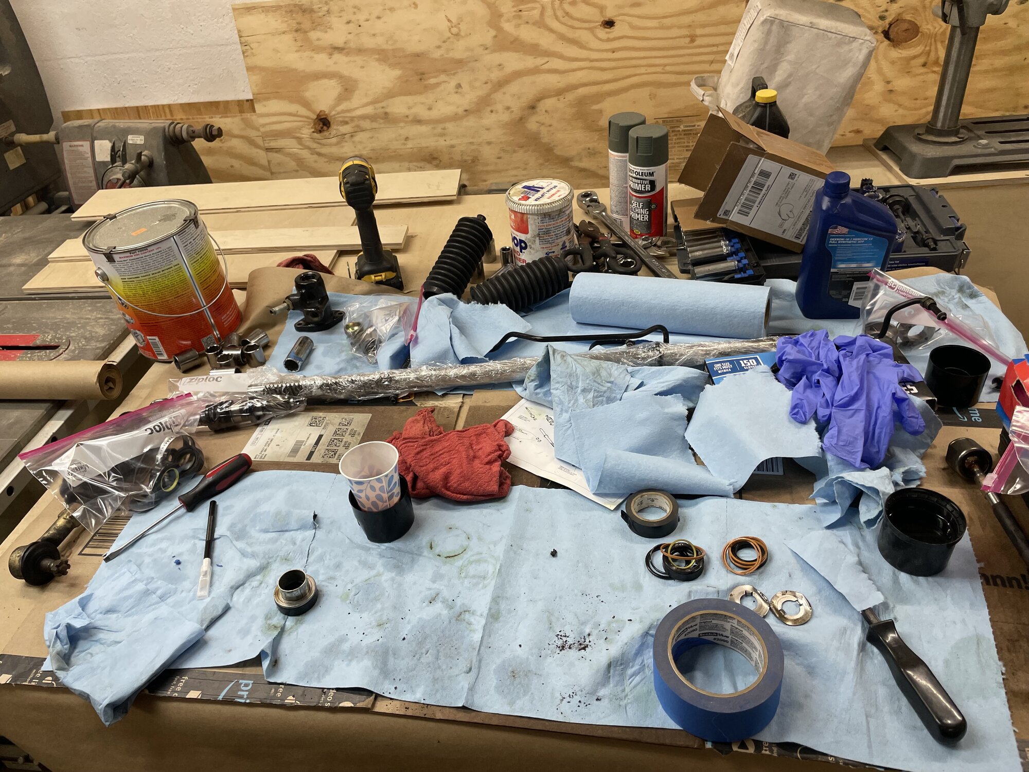

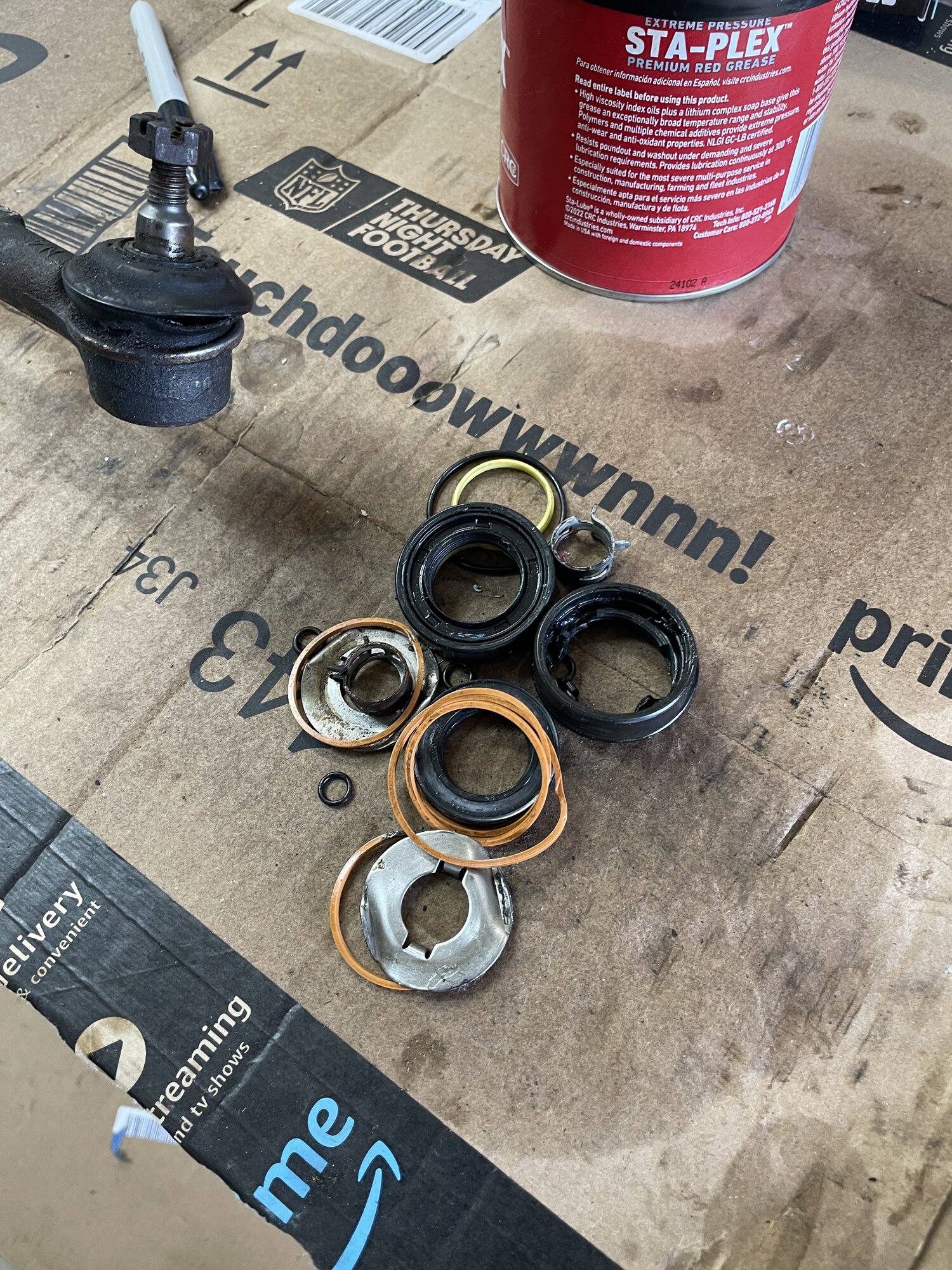

    • Rebuilt rack and pinion
    • Replaced calipers with some Cardone calipers at cost (I think 11$ per caliper, cheaper than buying parts to rebuild what I have).
    • Every dust boot cover was replaced with an OEM boot - these were fun to find.

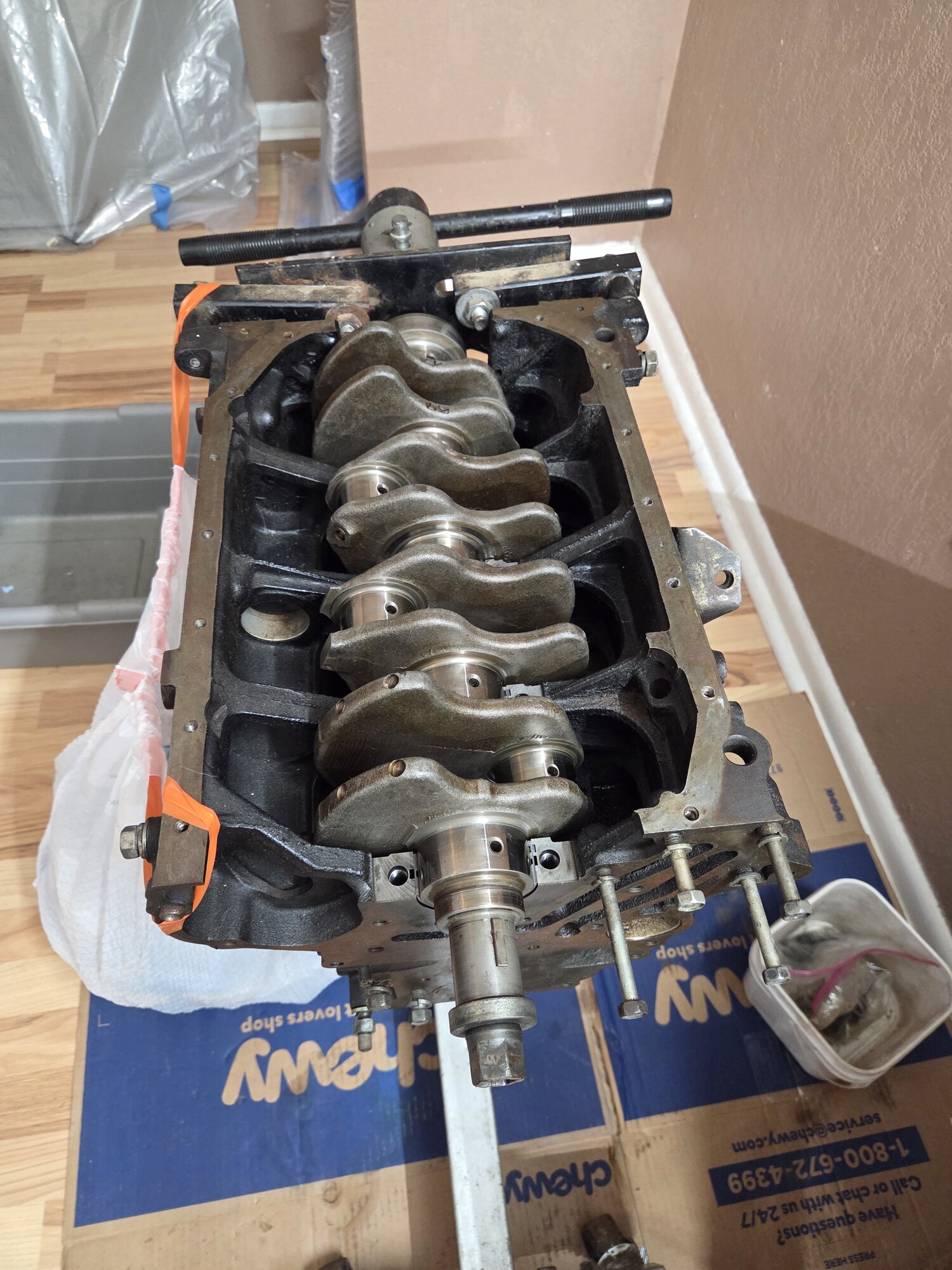

  • In the process of blue printing virgin 6-bolt block

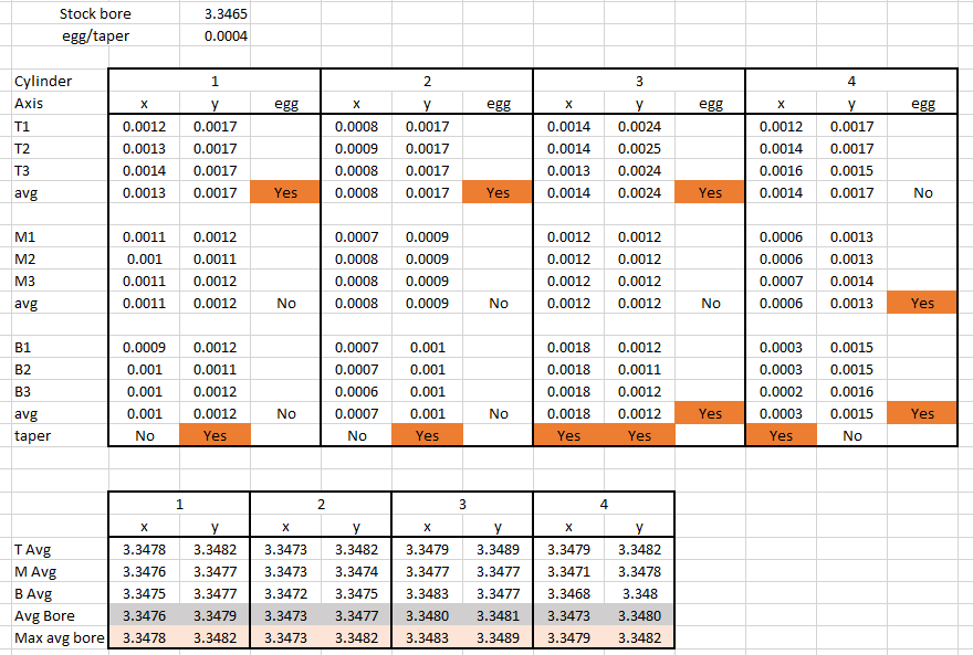

    • Cylinders will likely need a hone and I need to remeasure with a larger micrometer to see if I can use 2g pistons/1g rods or if I need to go aftermarket. I do have a set of .020 over pistons (I think Wisecos) on 1g rods. My preference would be the 2g piston set up since Im likely only going to run a 20g on this car at most.
  • 6-bolt crank is perfect, dead center in every specification range
  • Need to check block mains, but im expecting them to be 100% fine as the crank is perfect and the bearings were in very good condition.

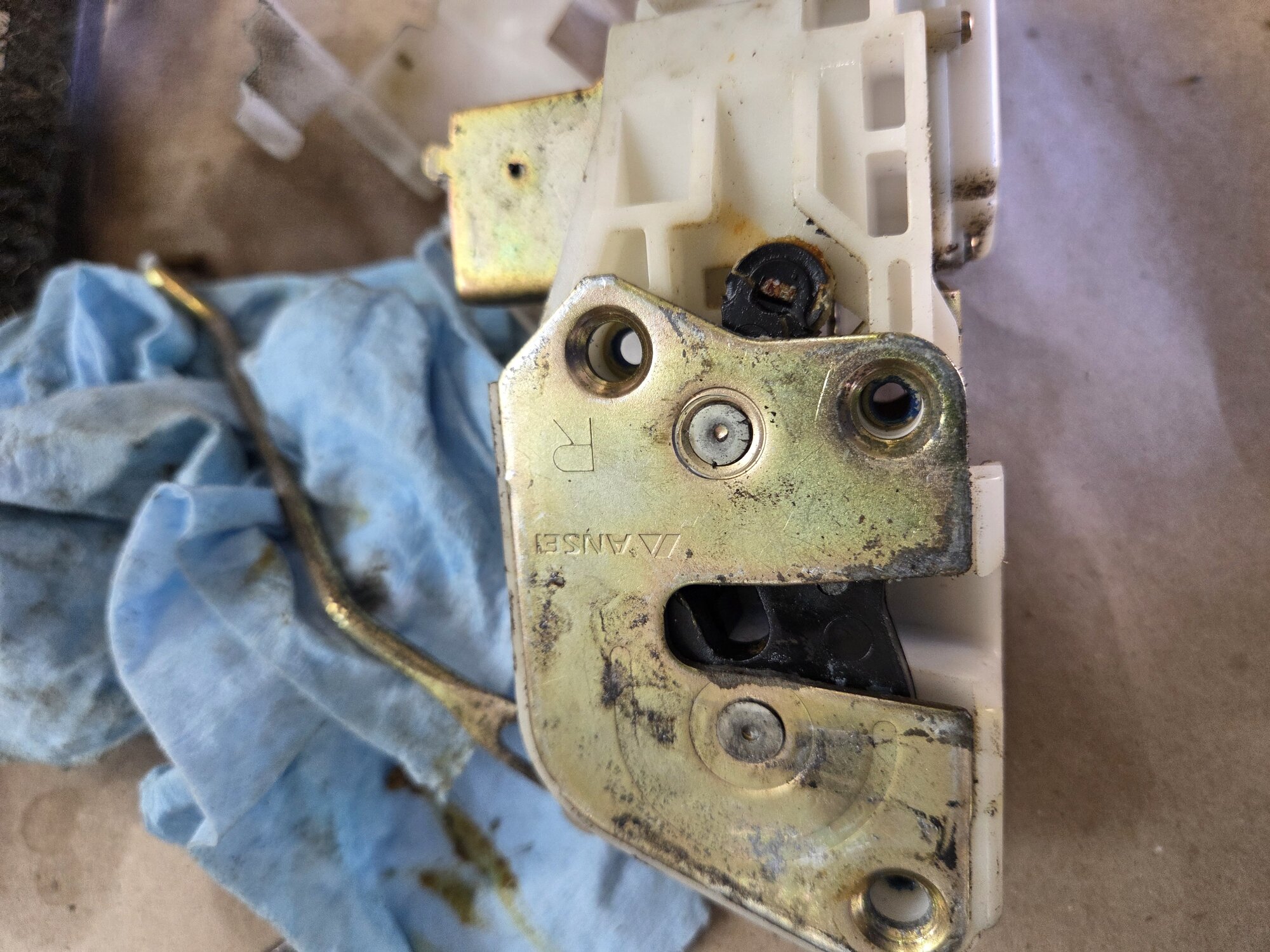

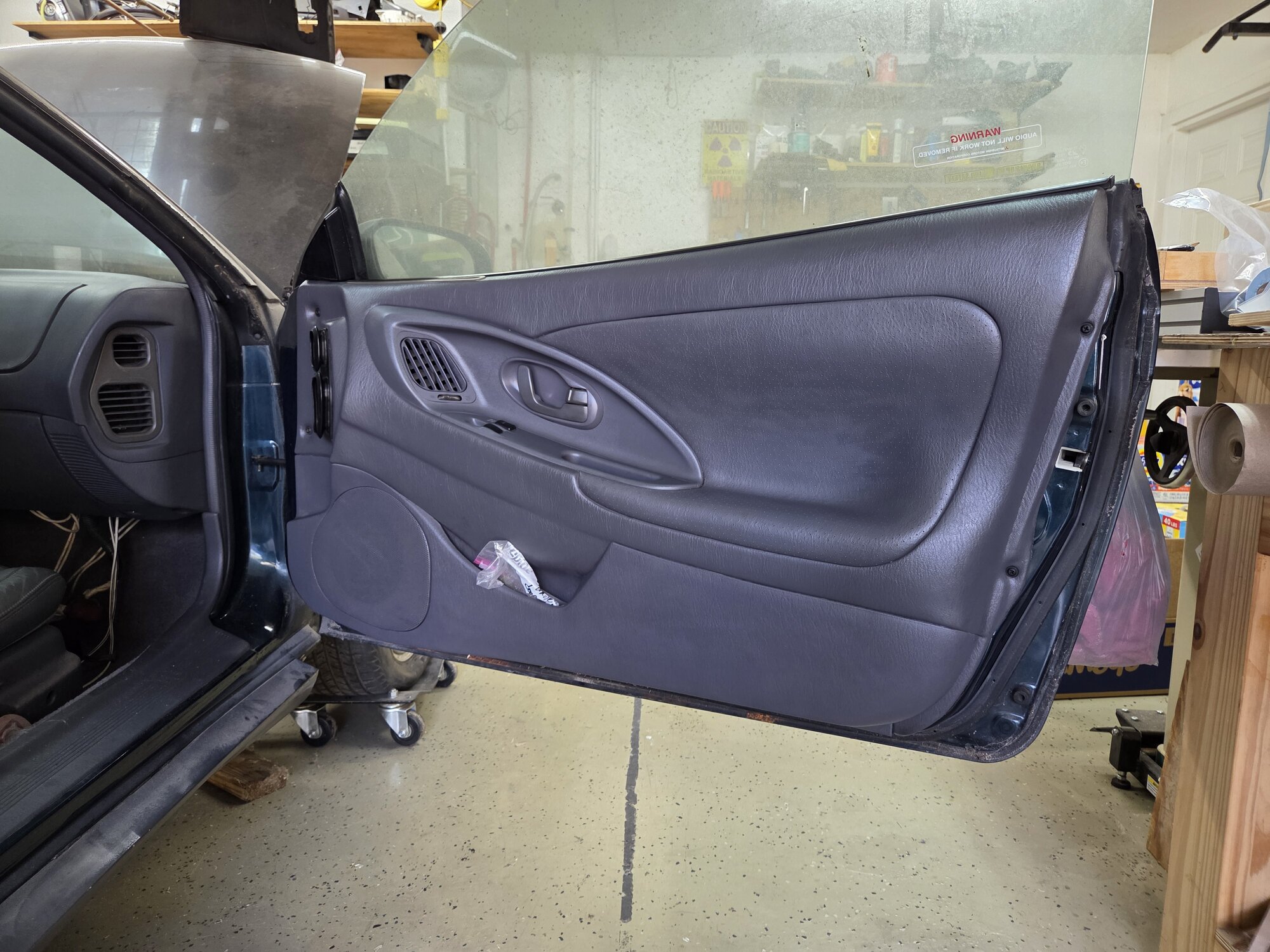

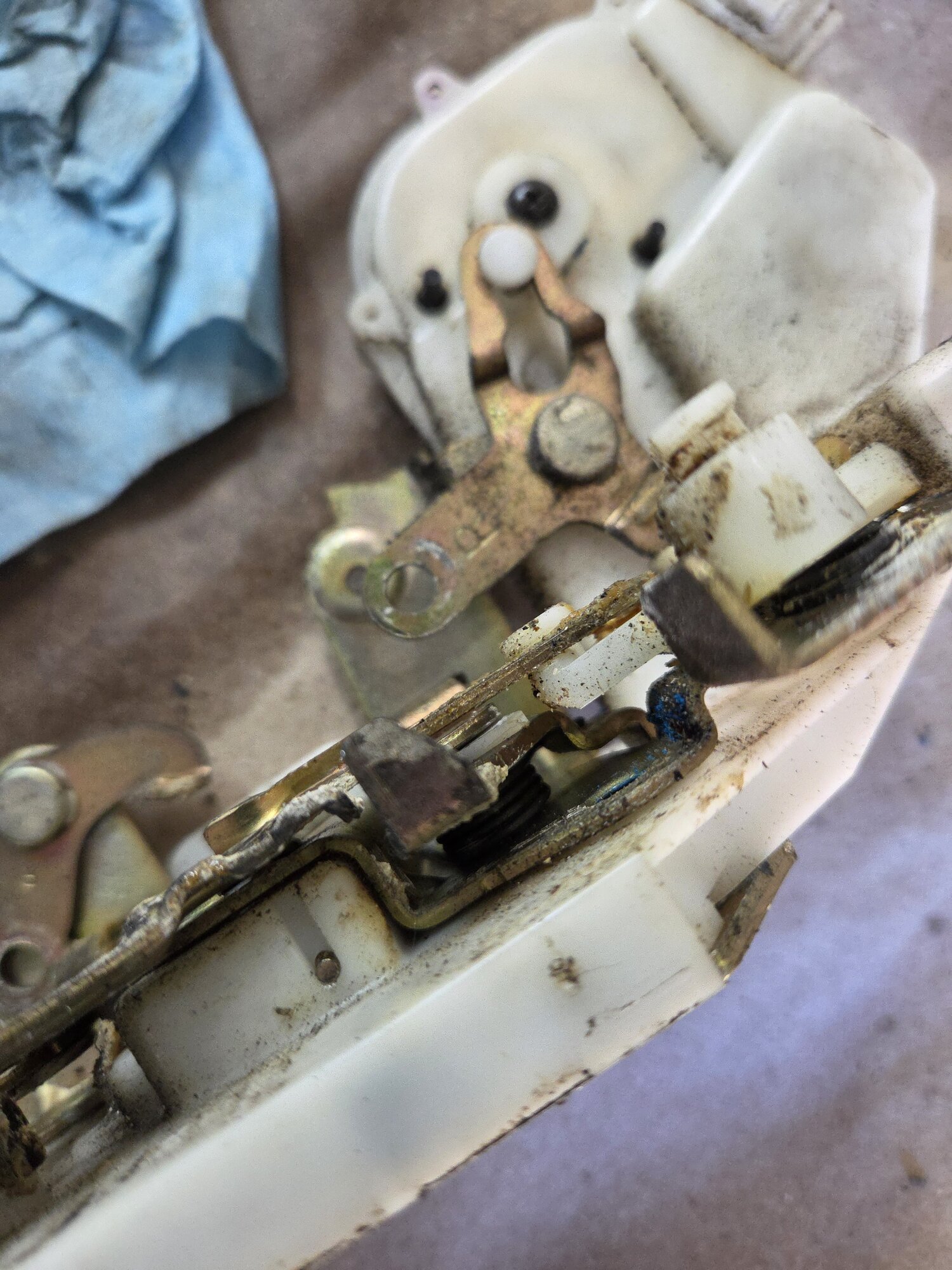

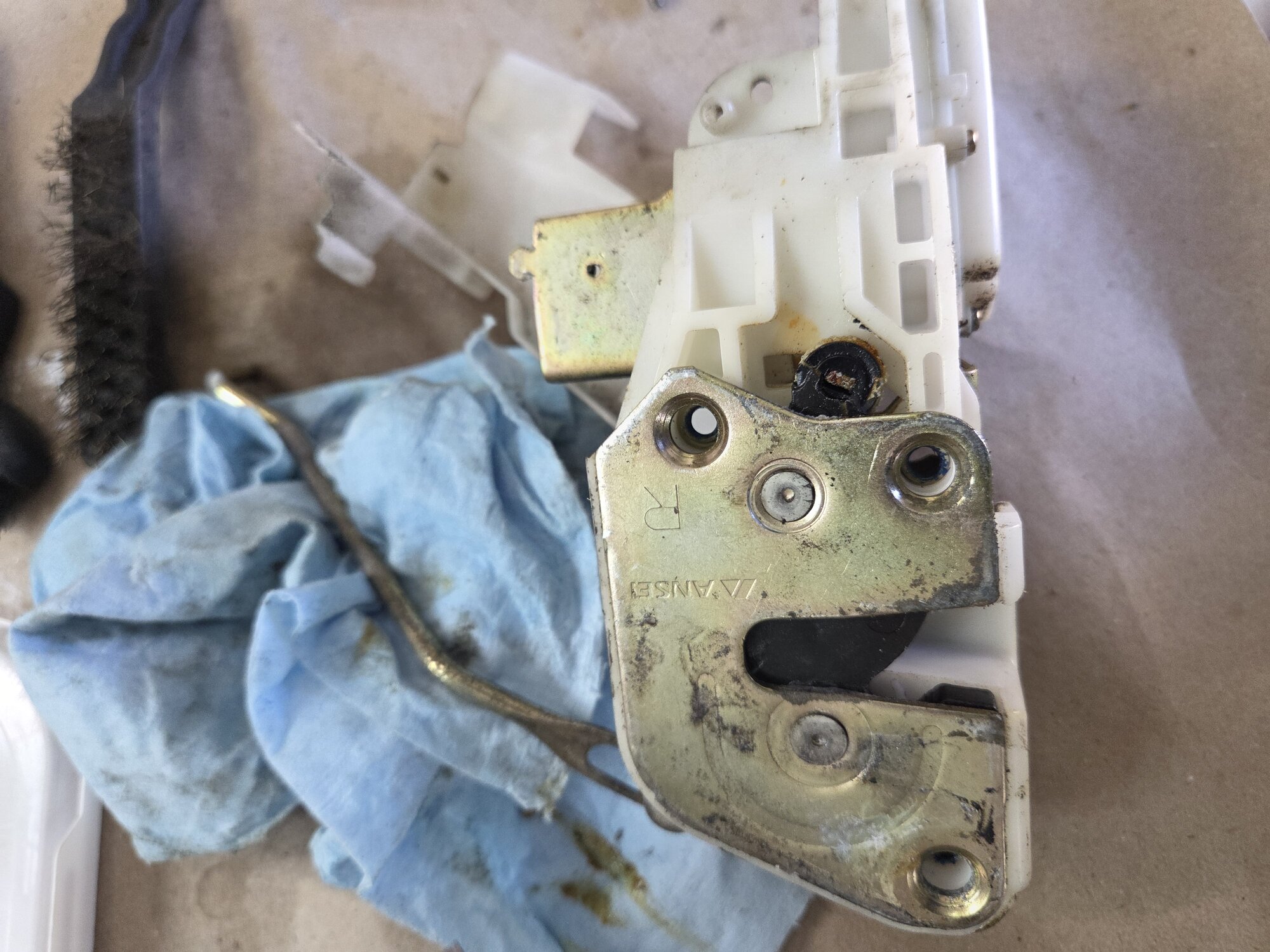

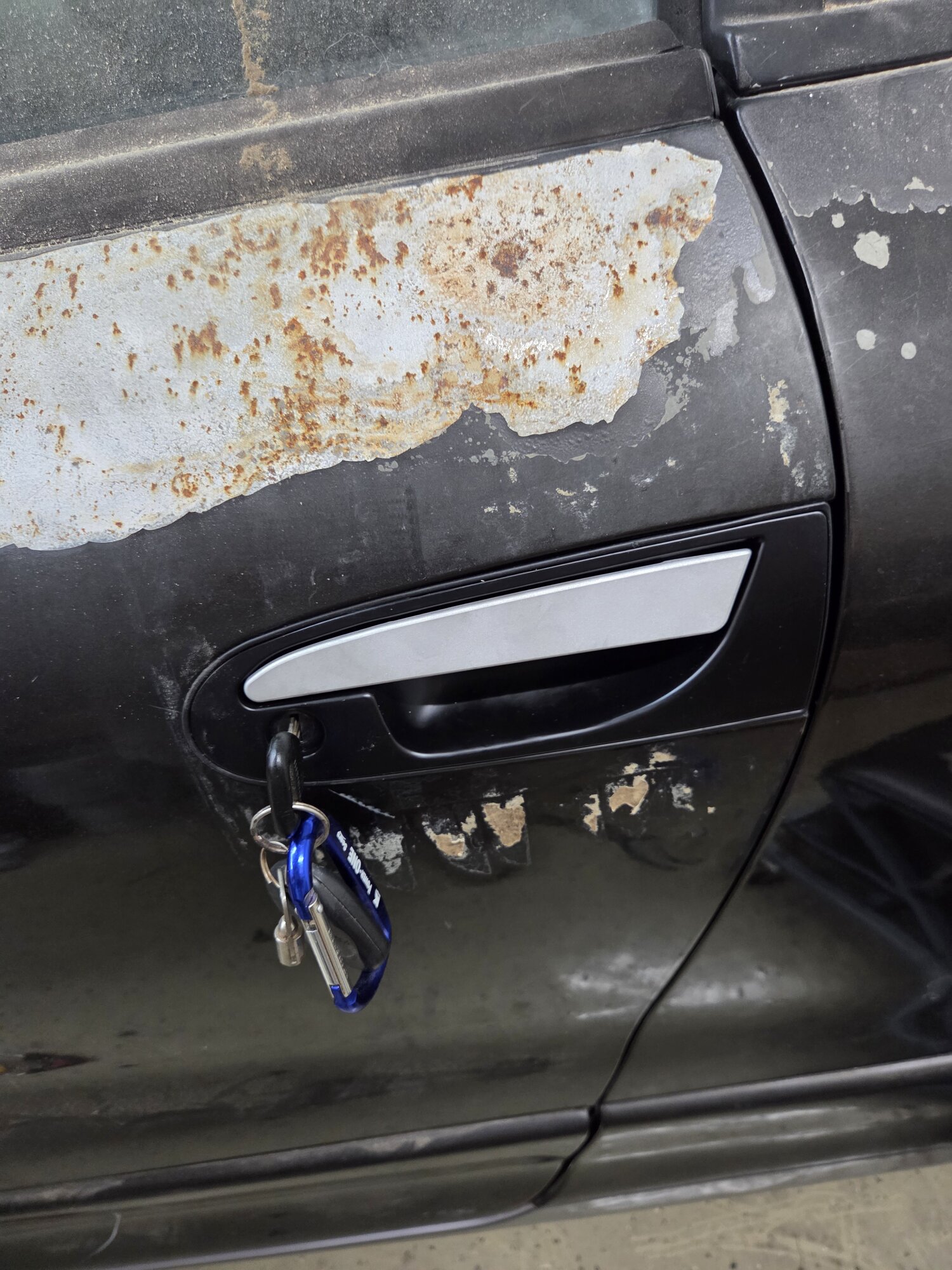

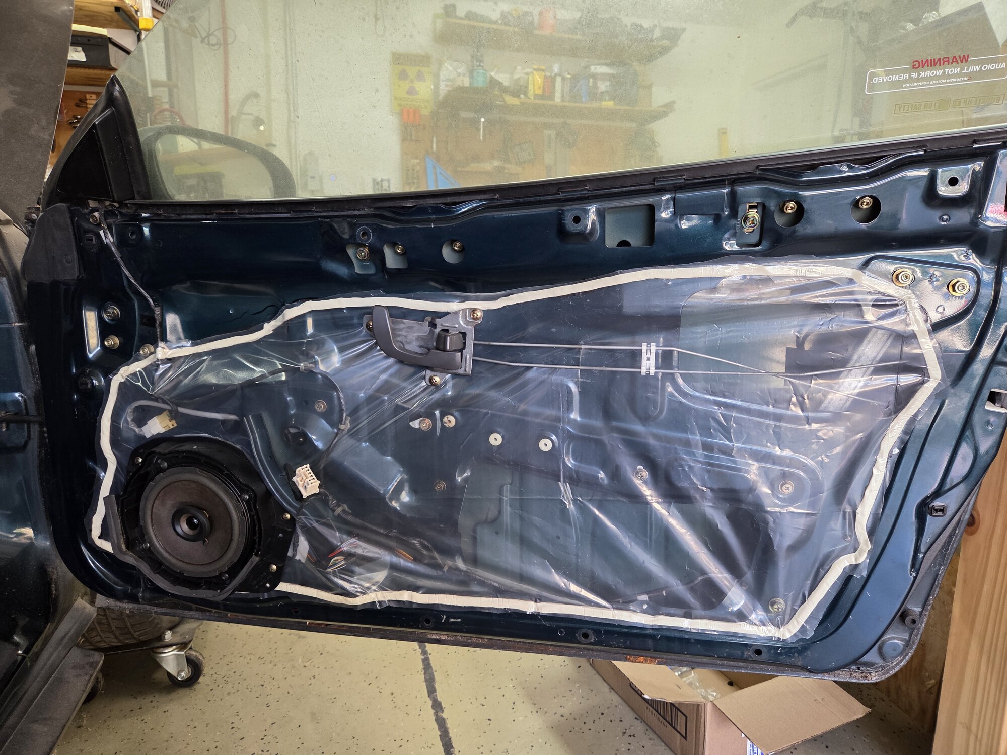

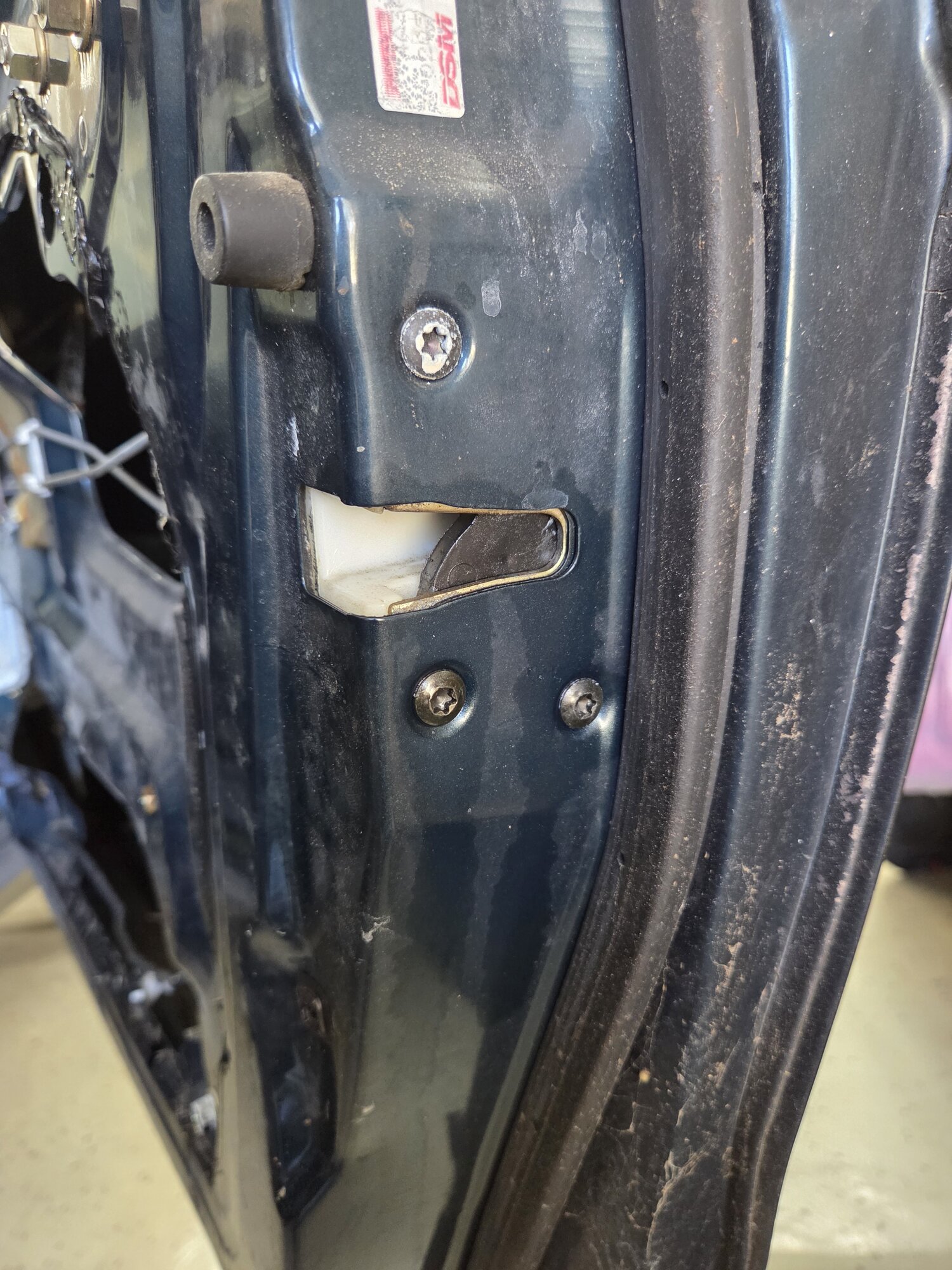

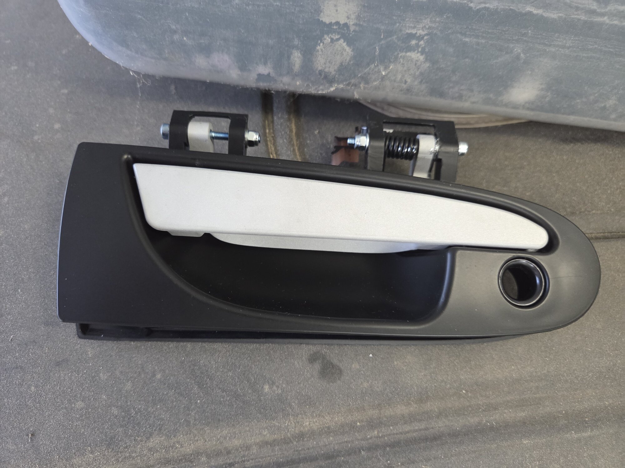

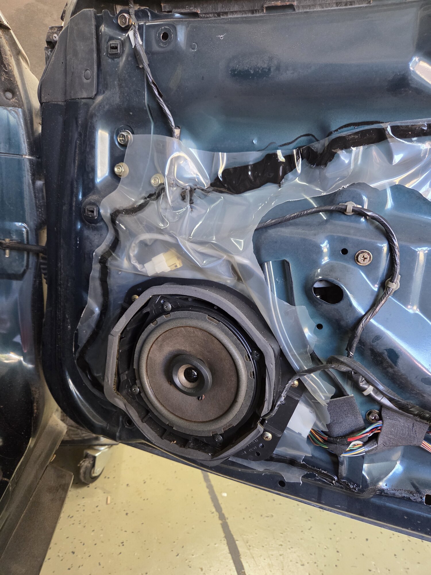

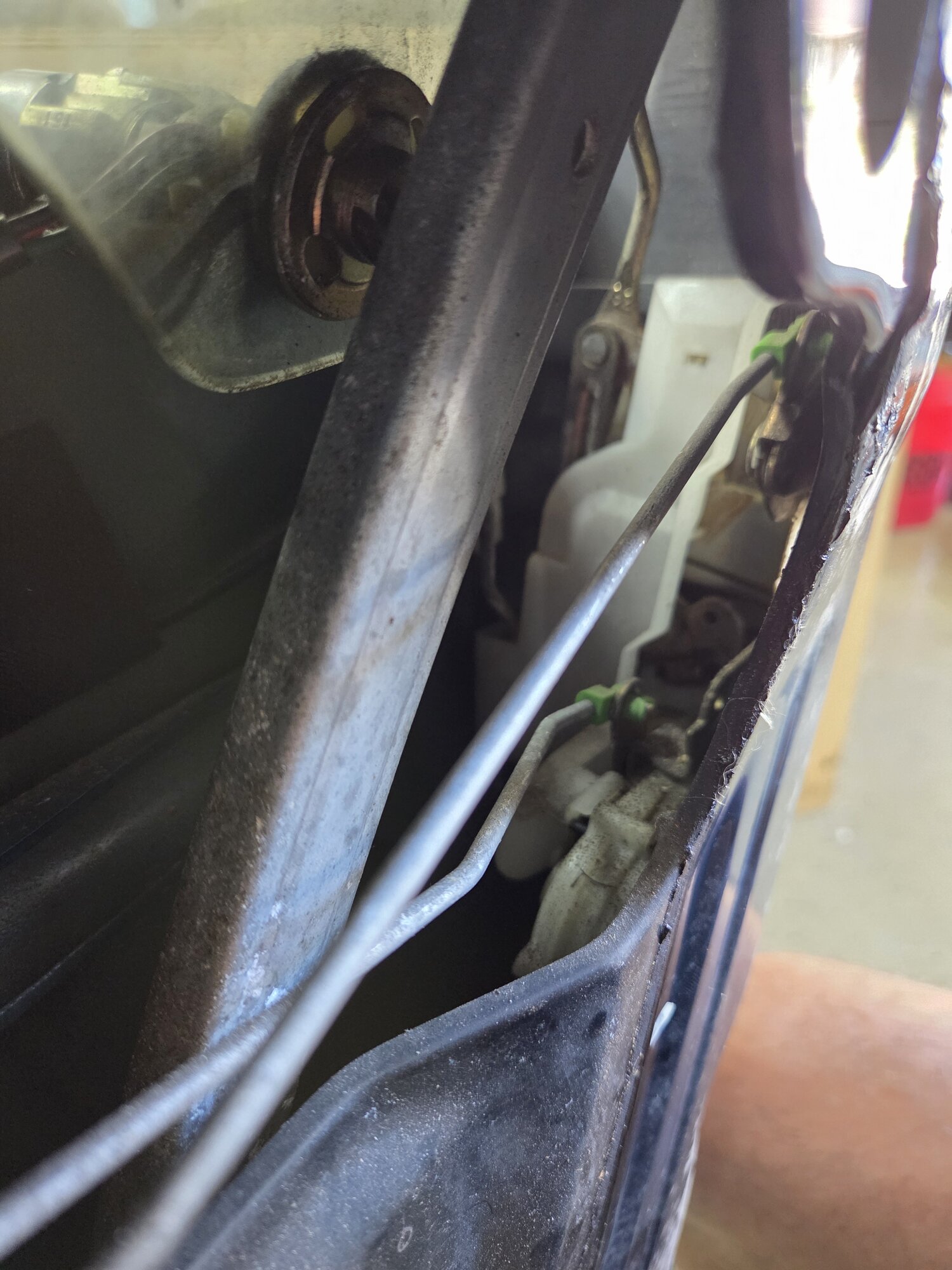

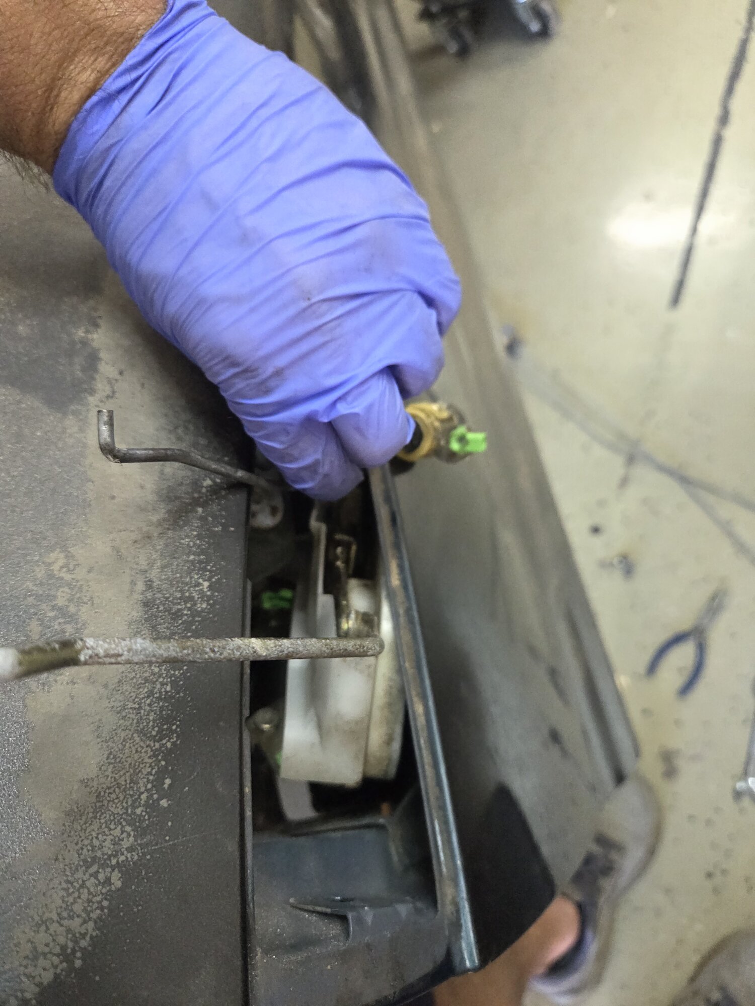

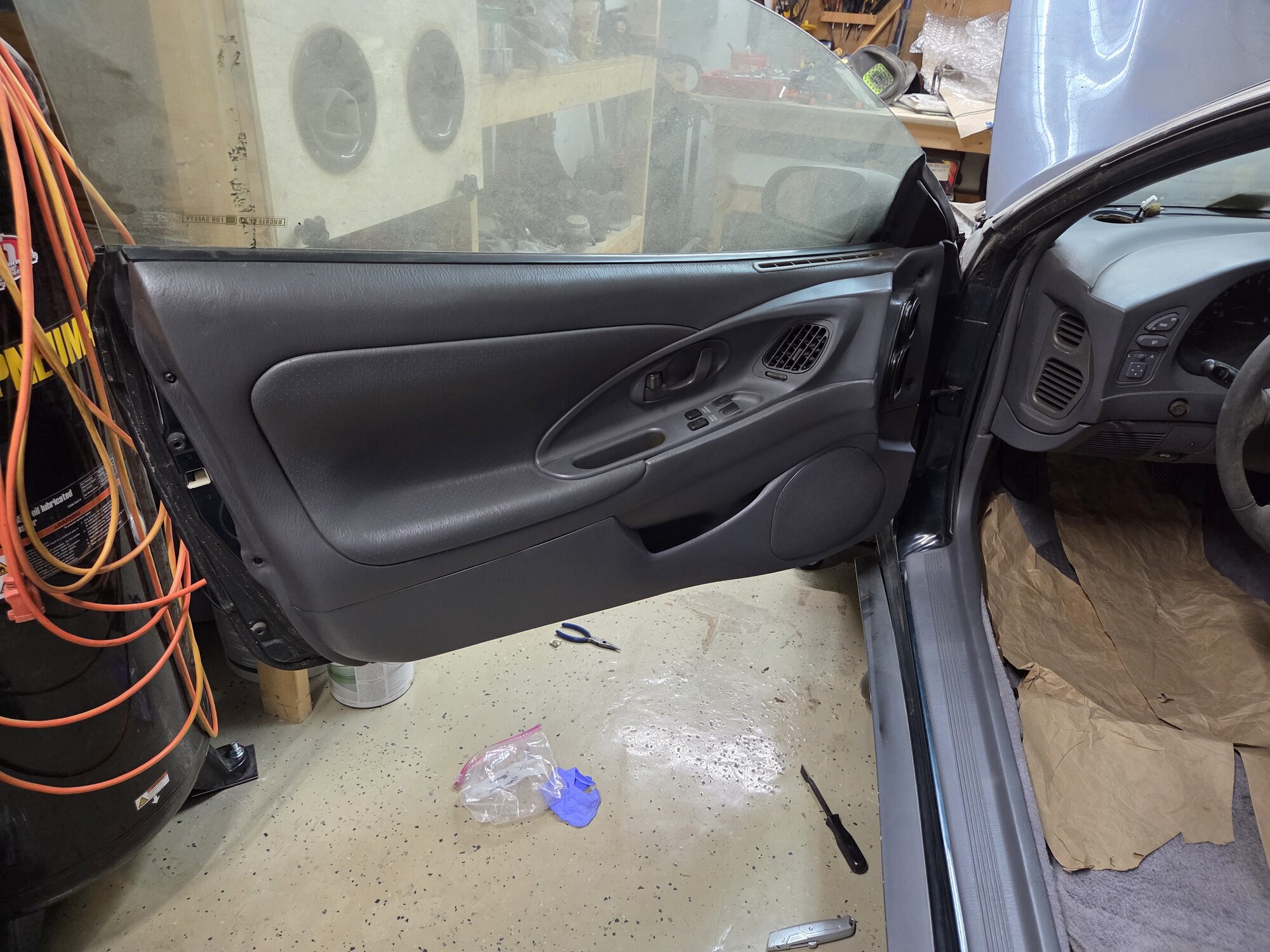

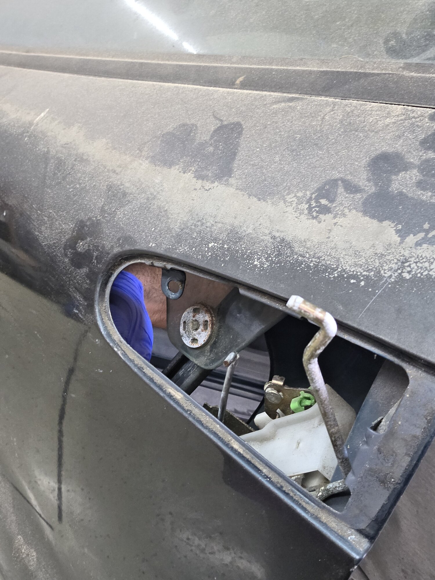

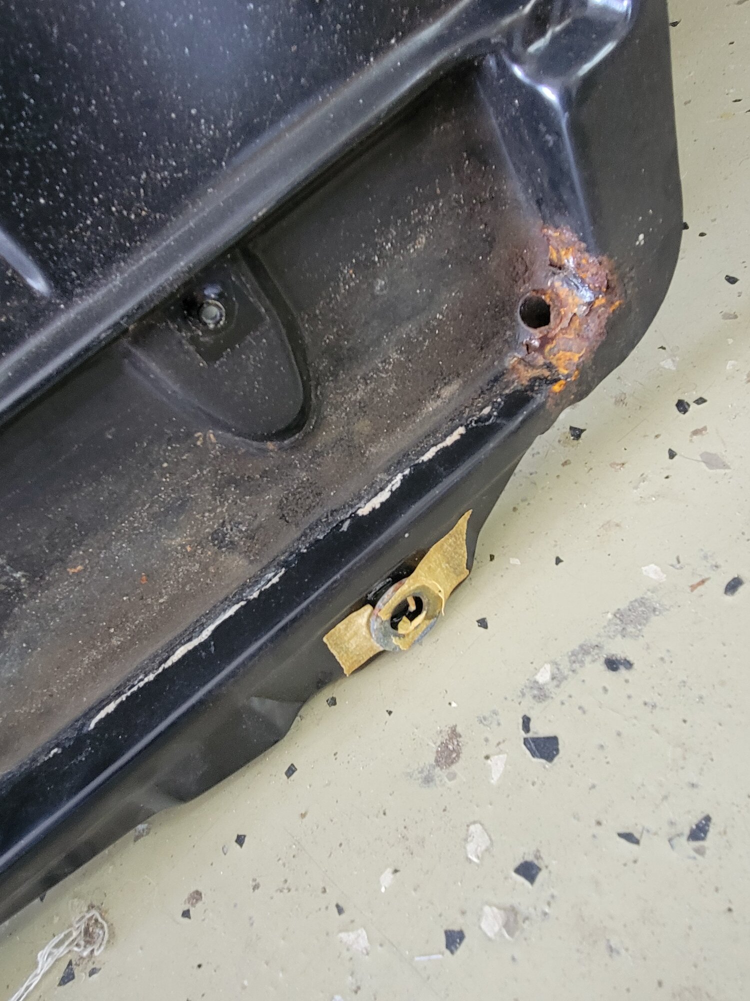

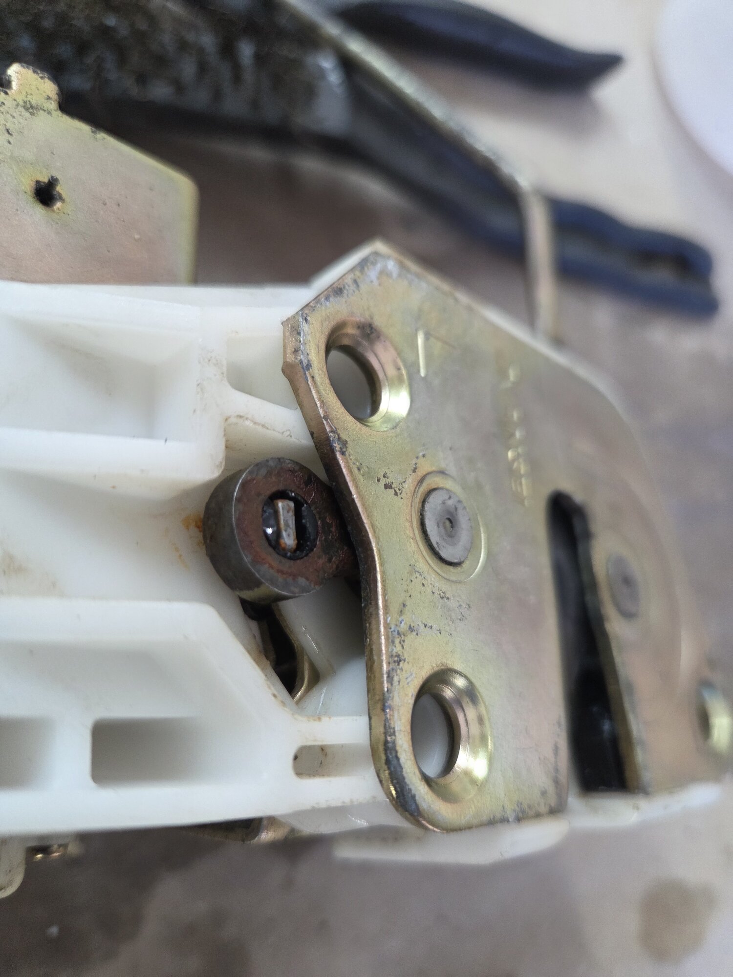

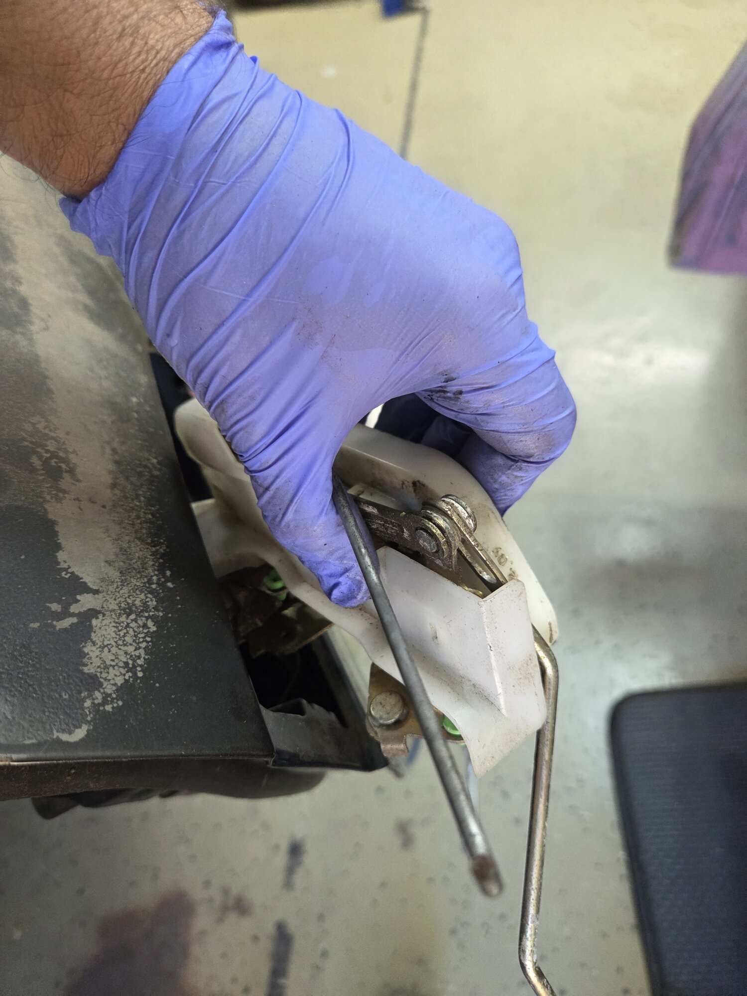

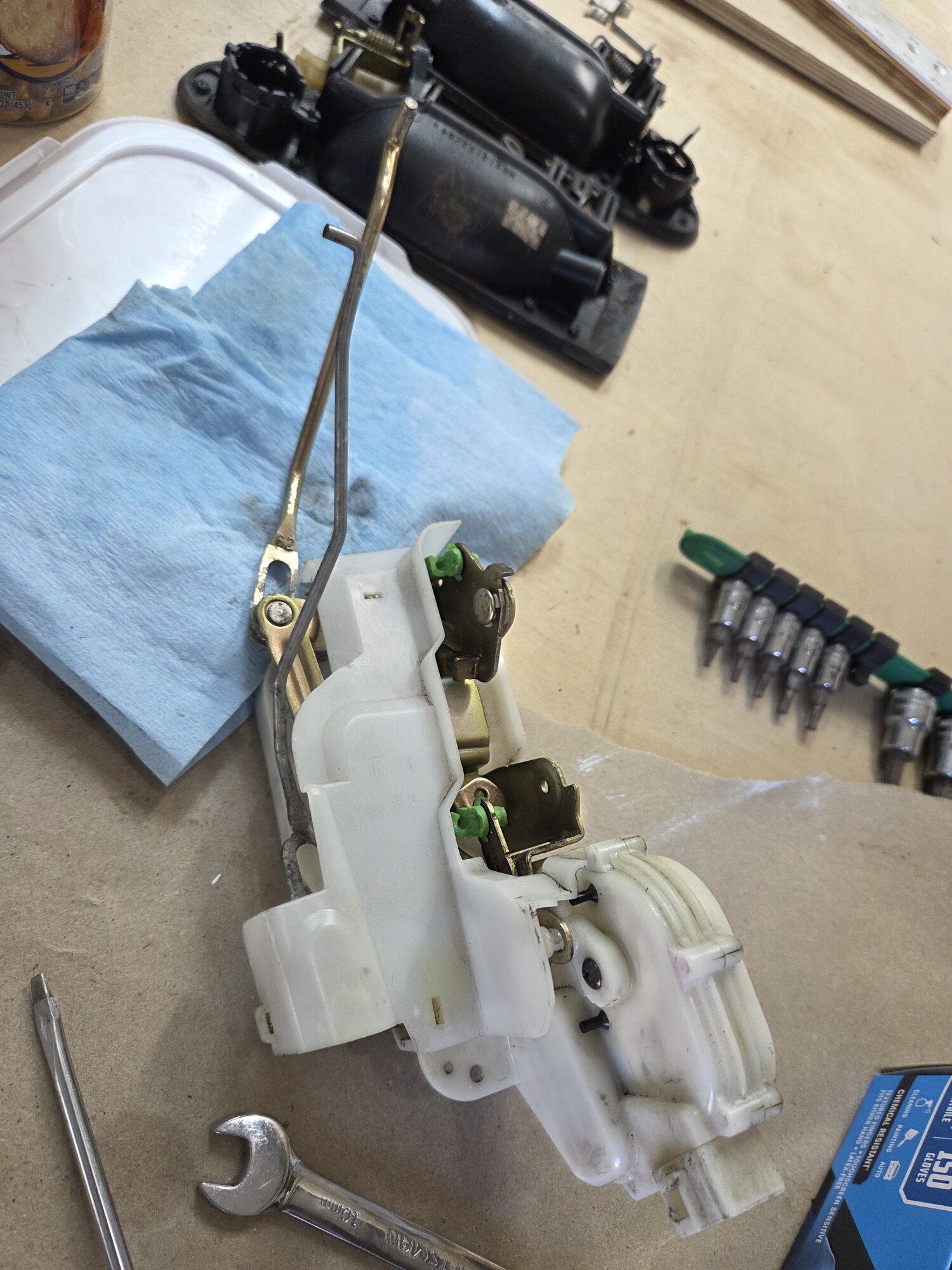

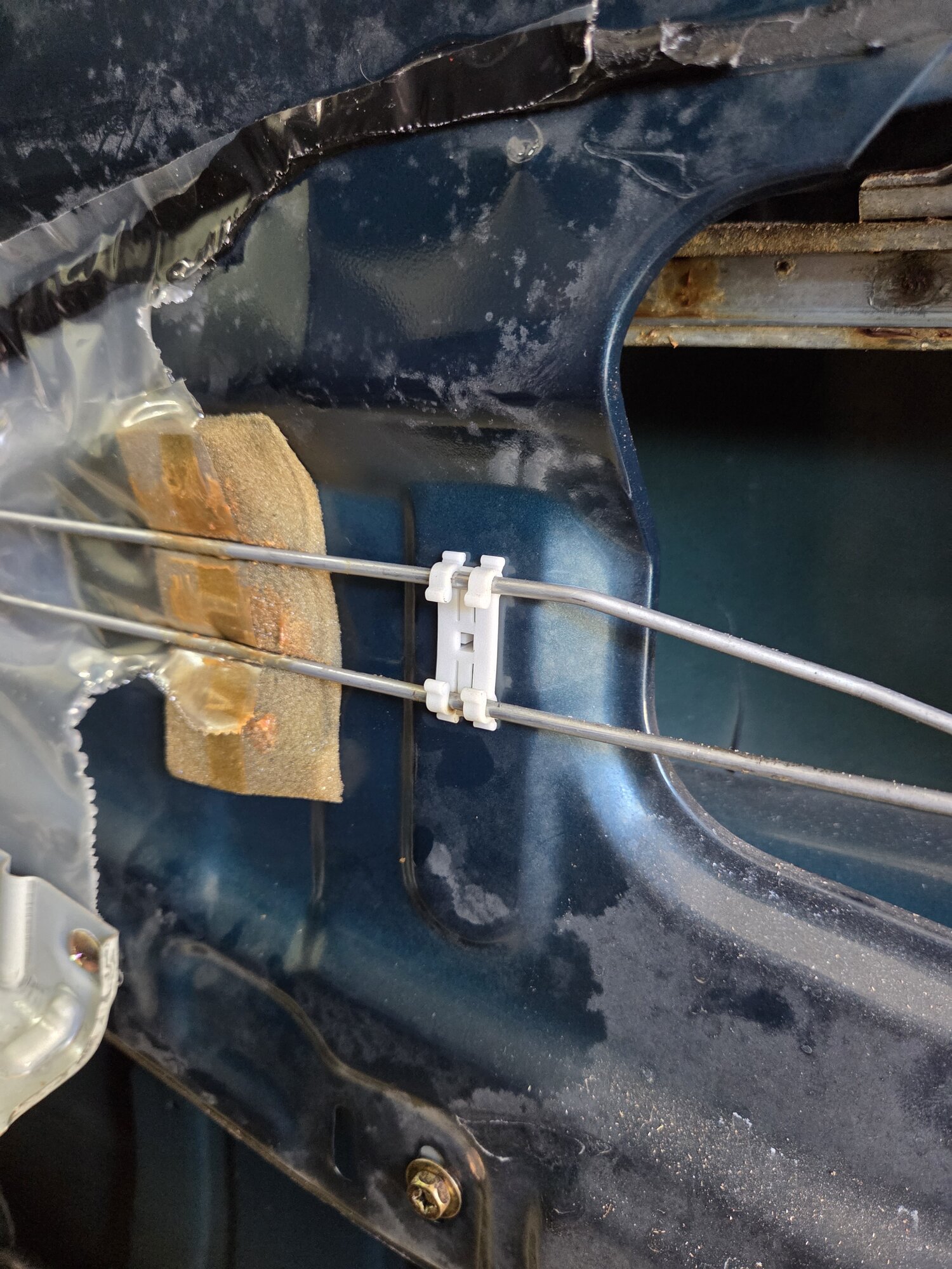

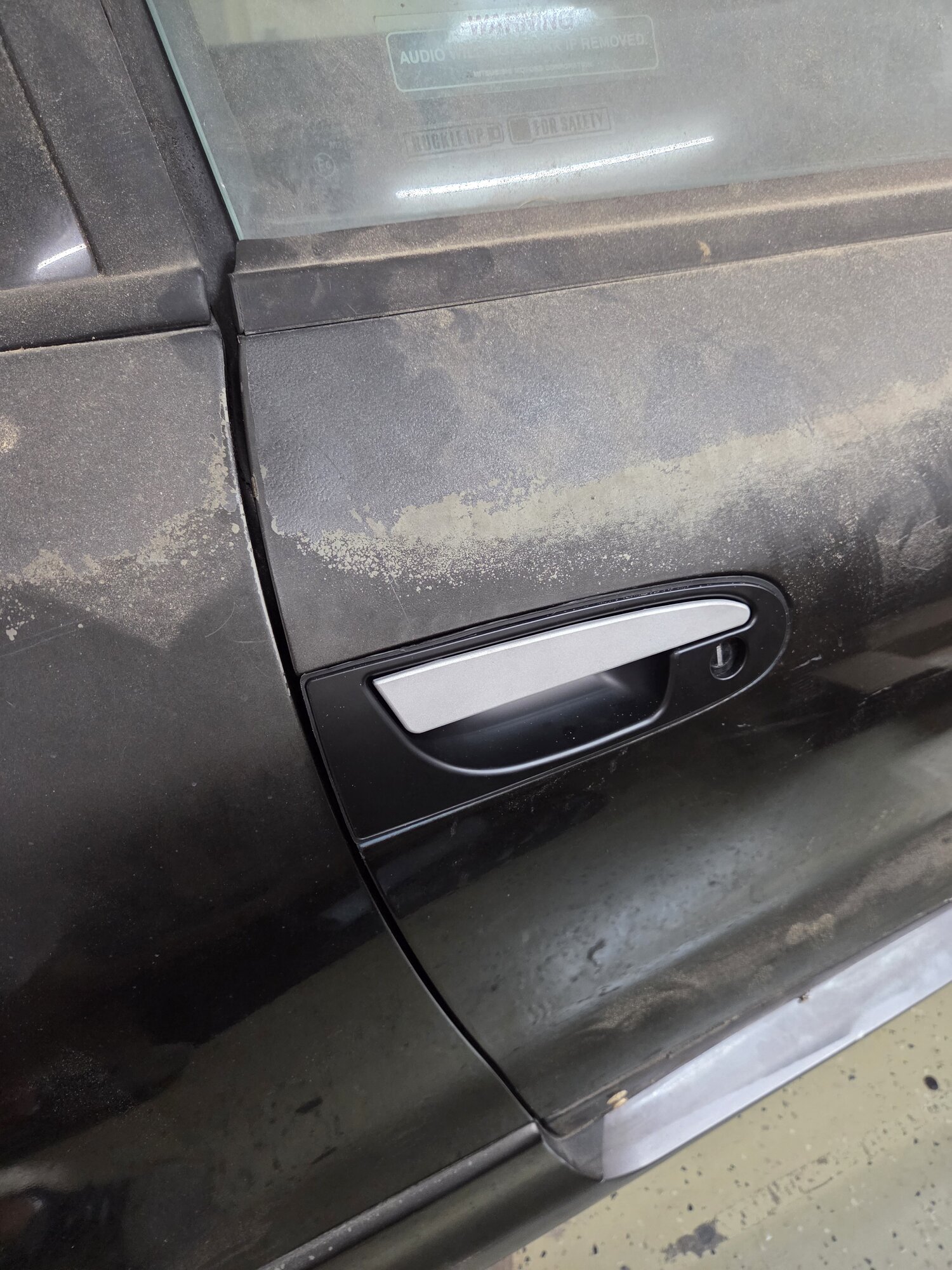

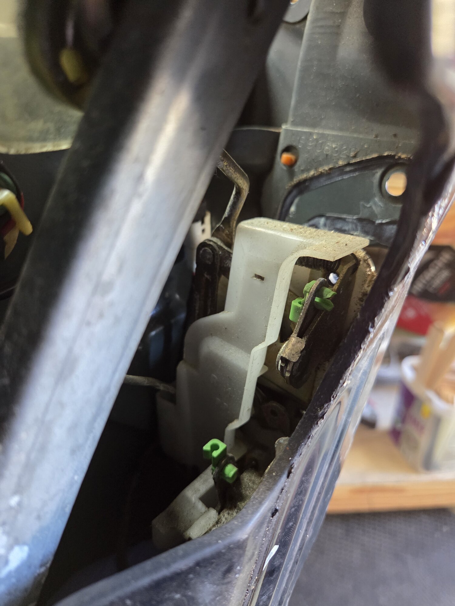

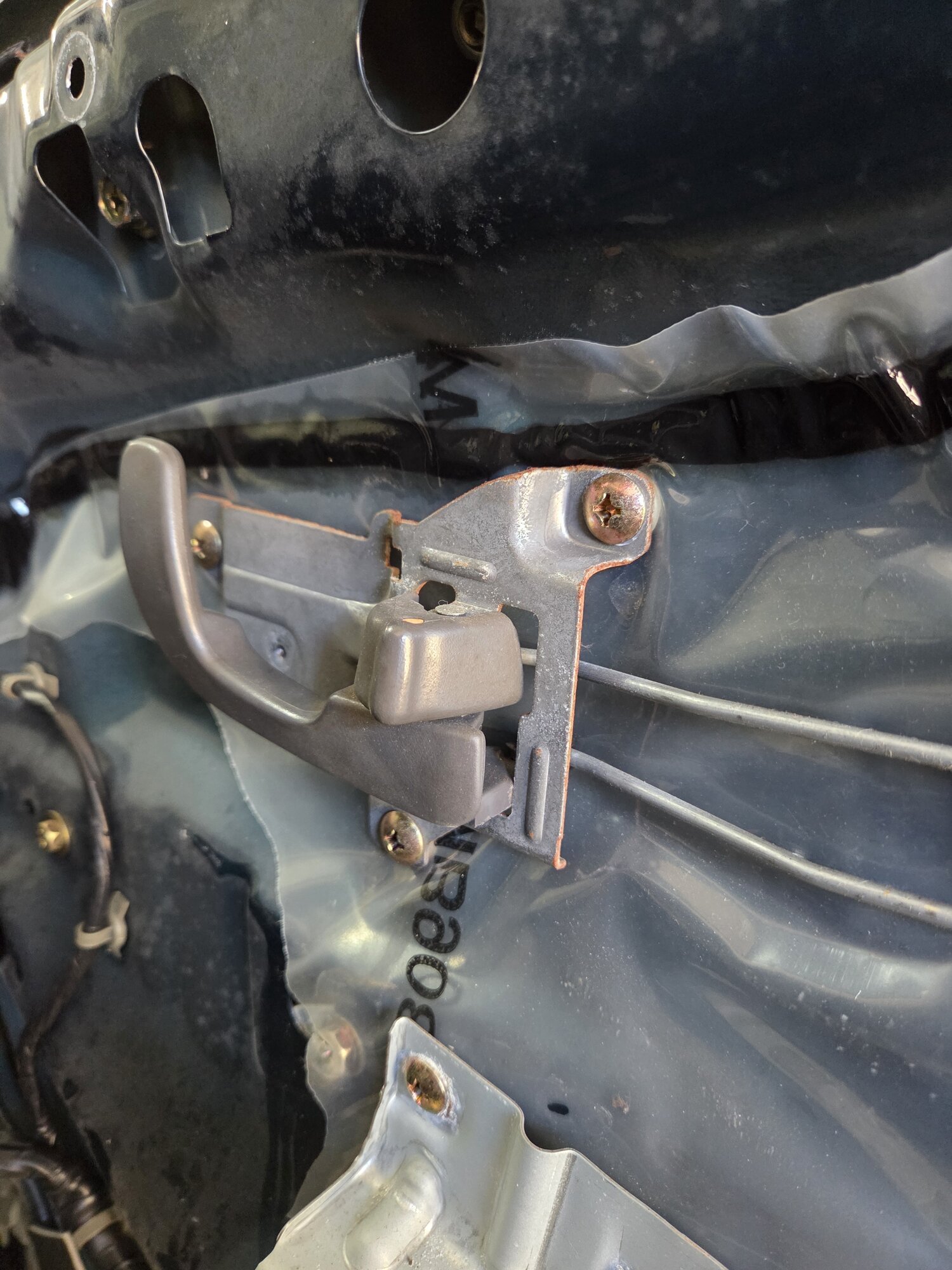

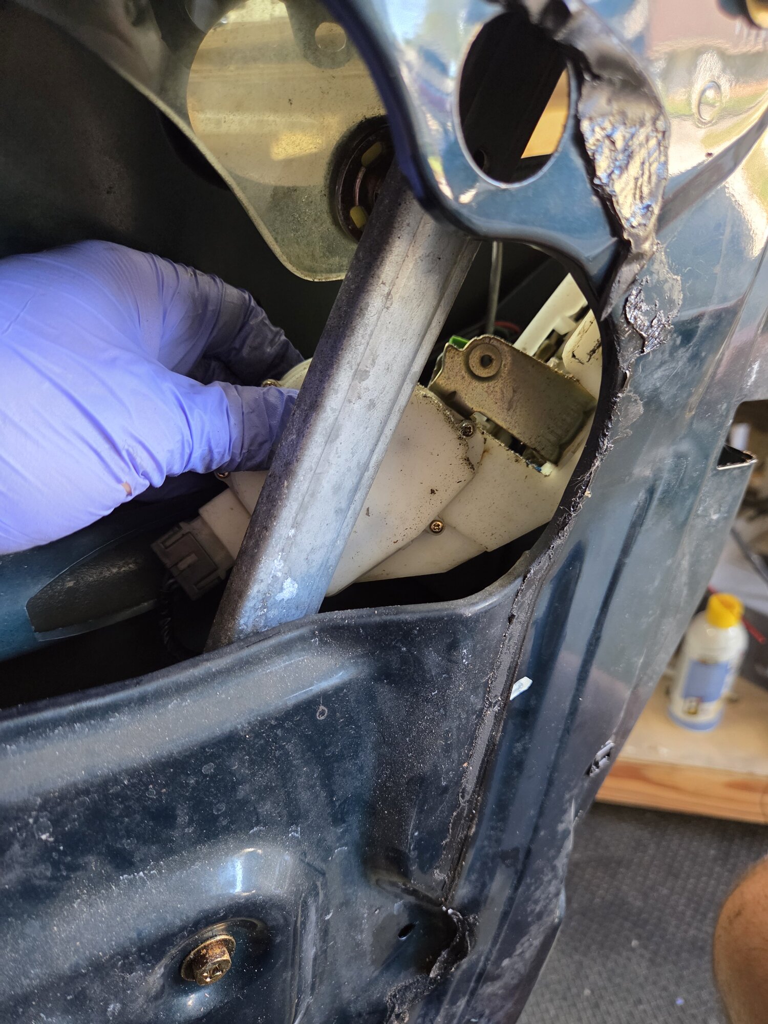

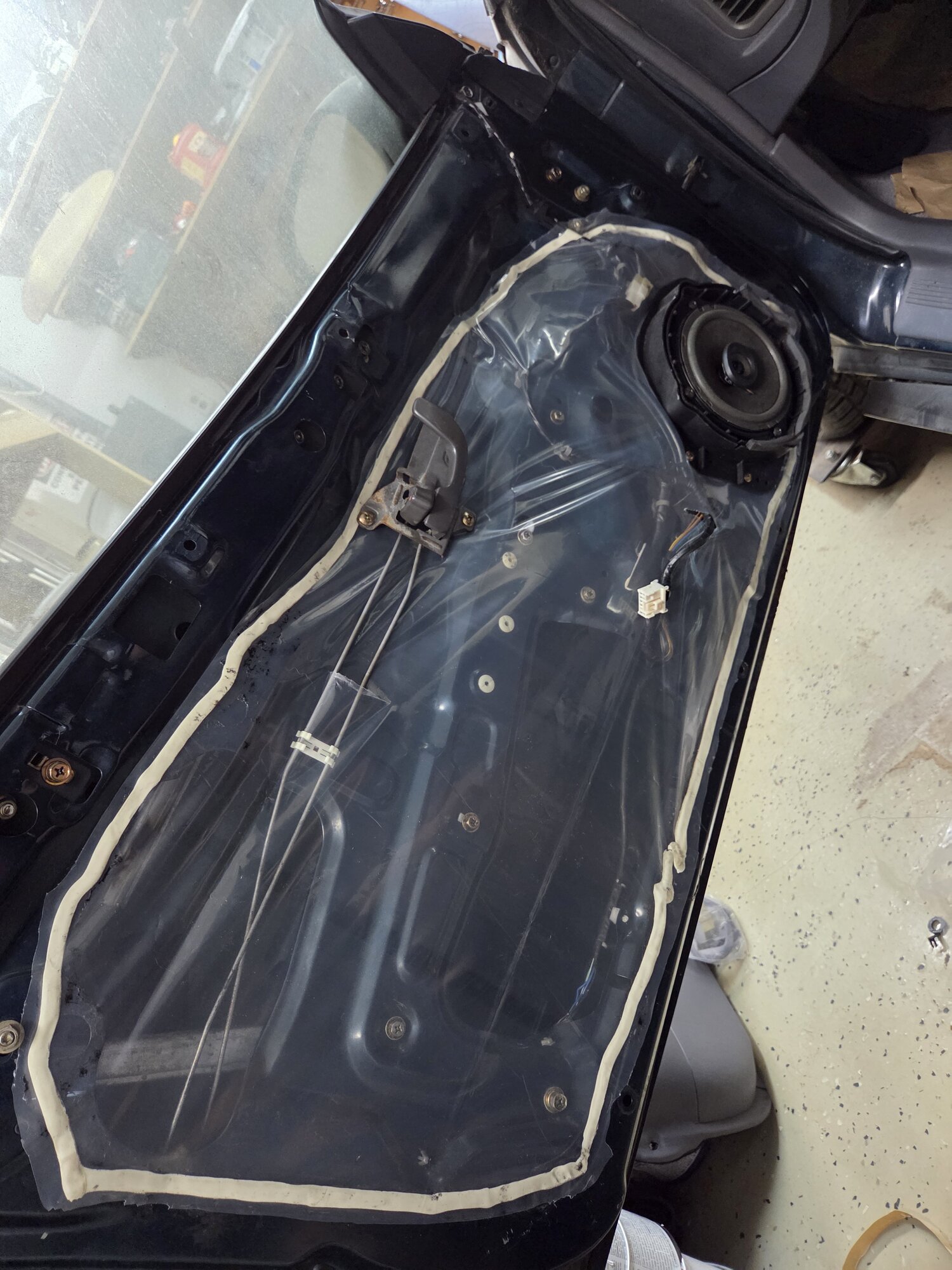

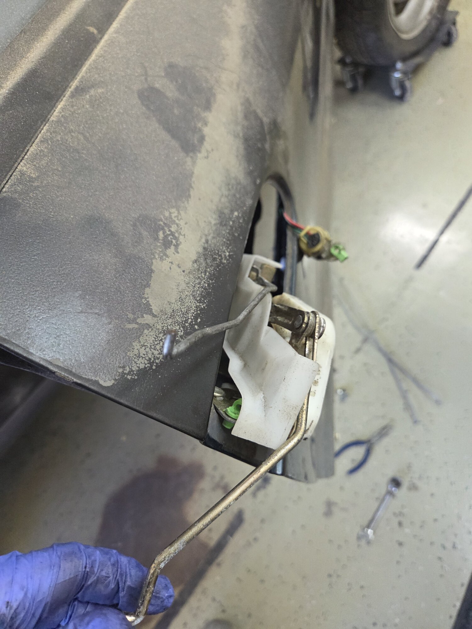

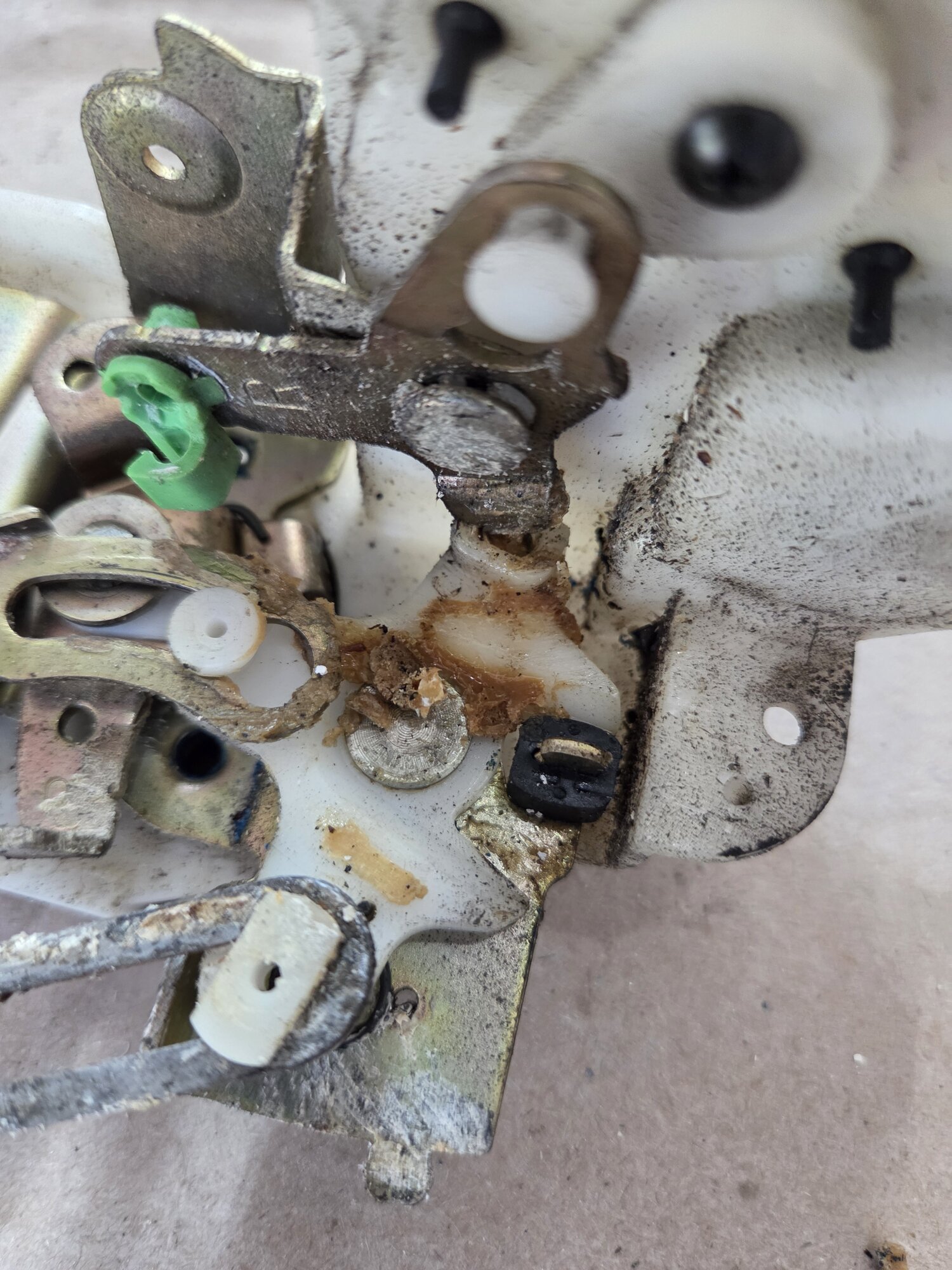

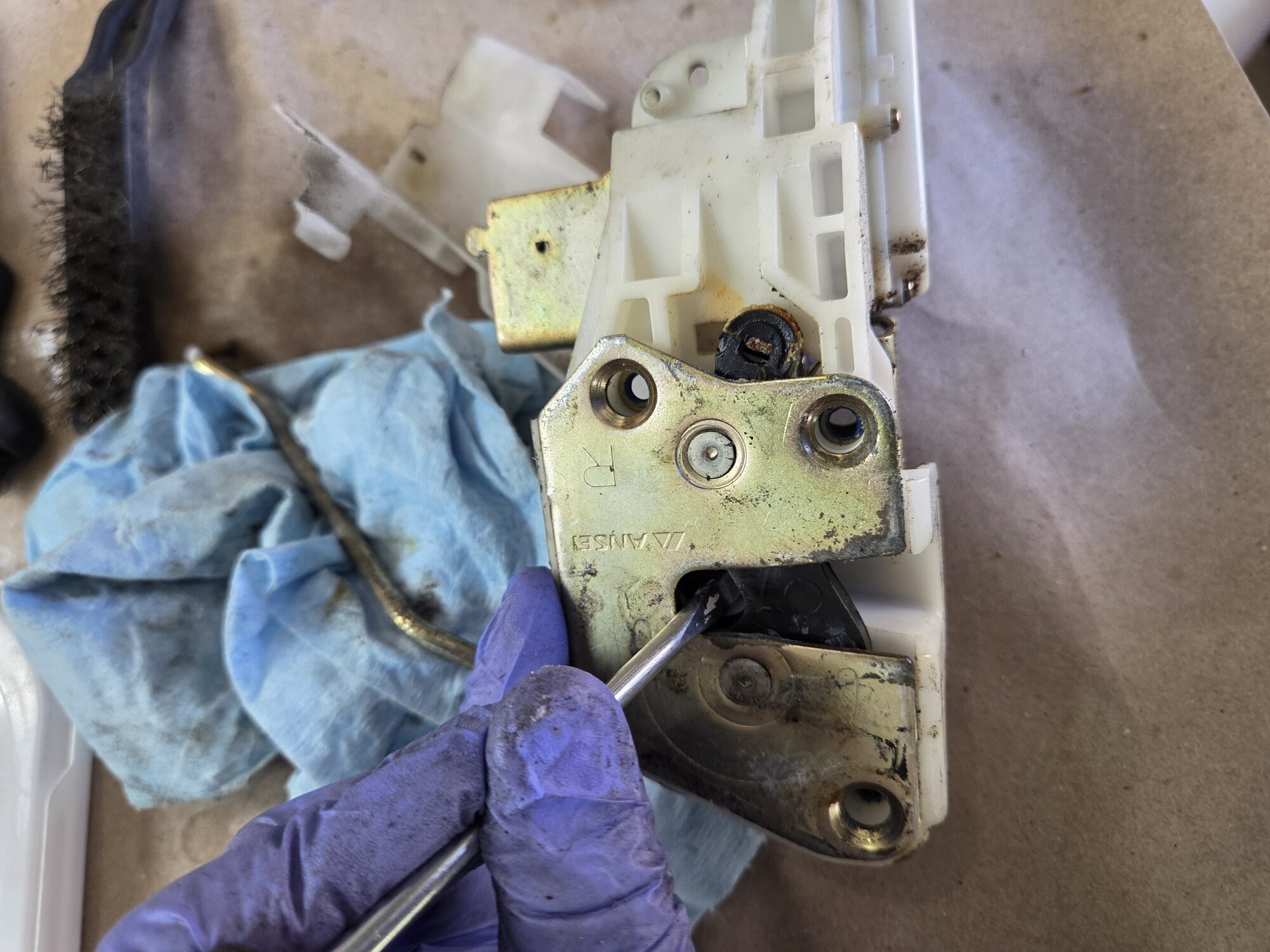

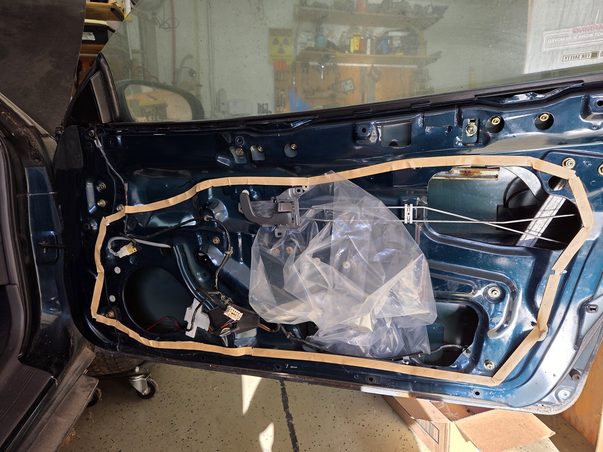

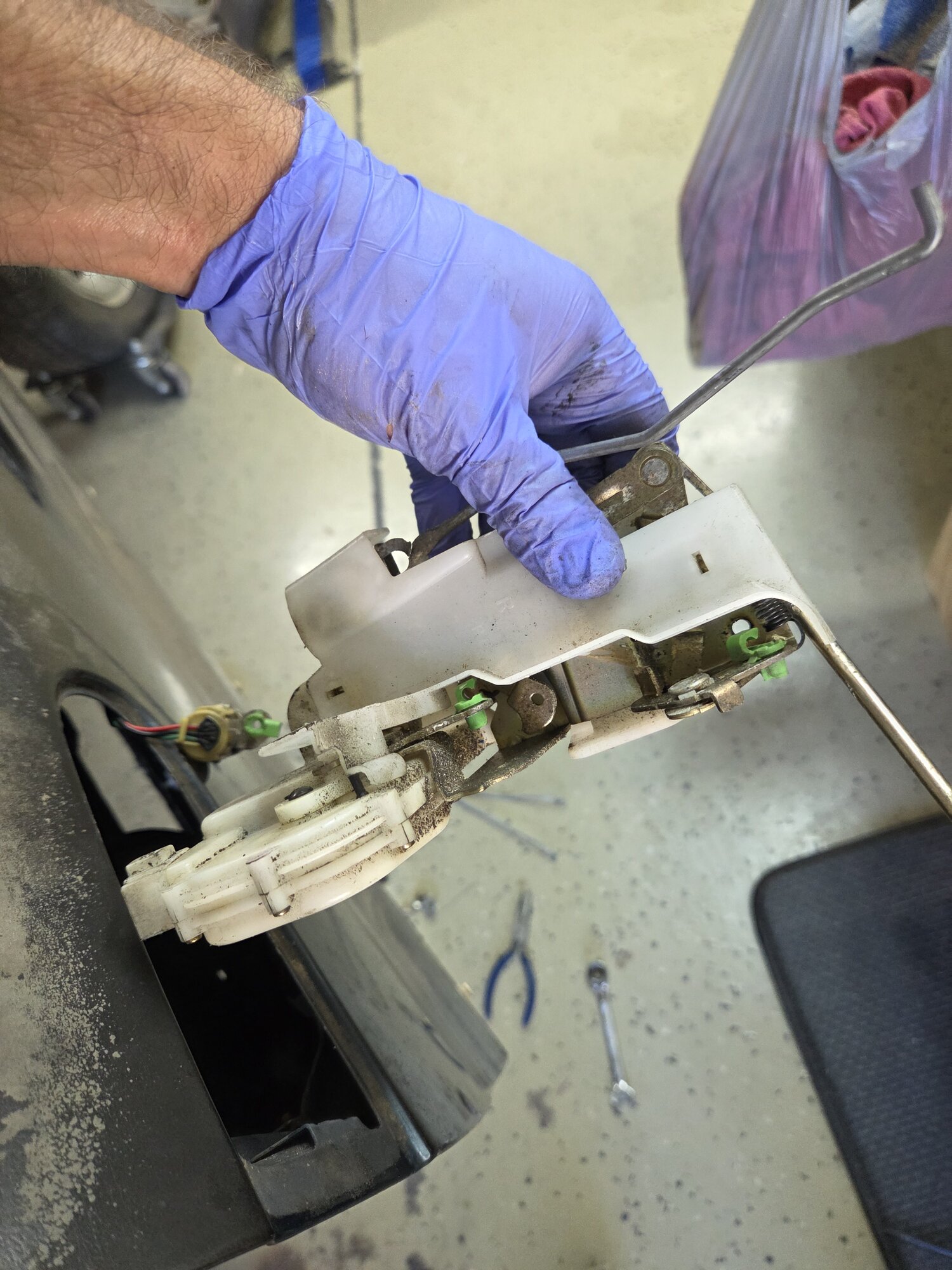

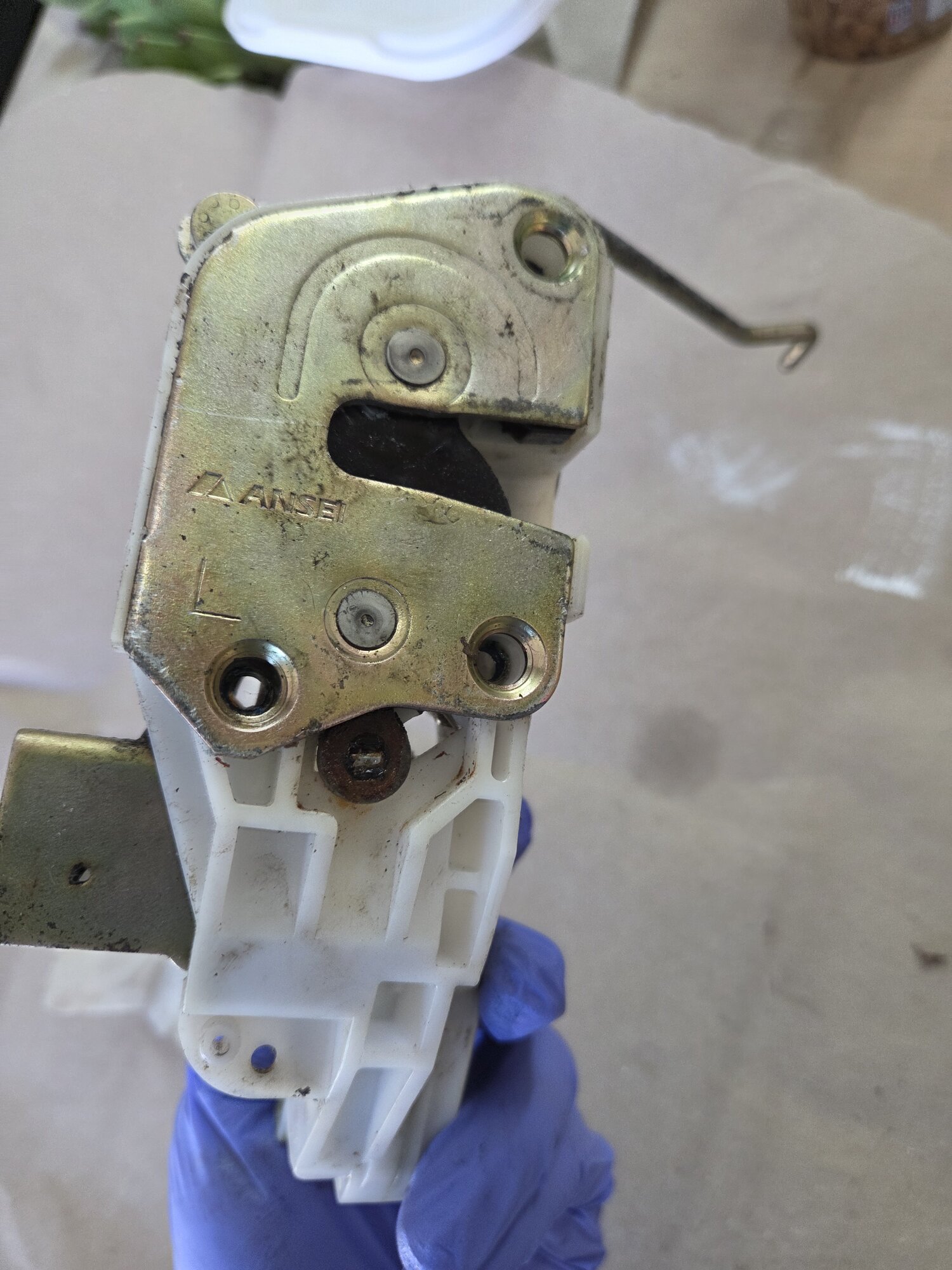

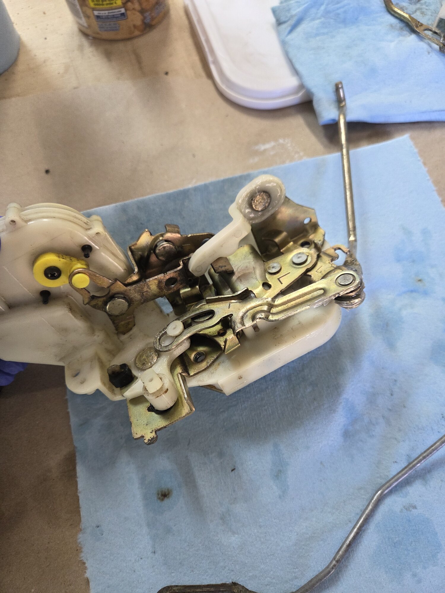

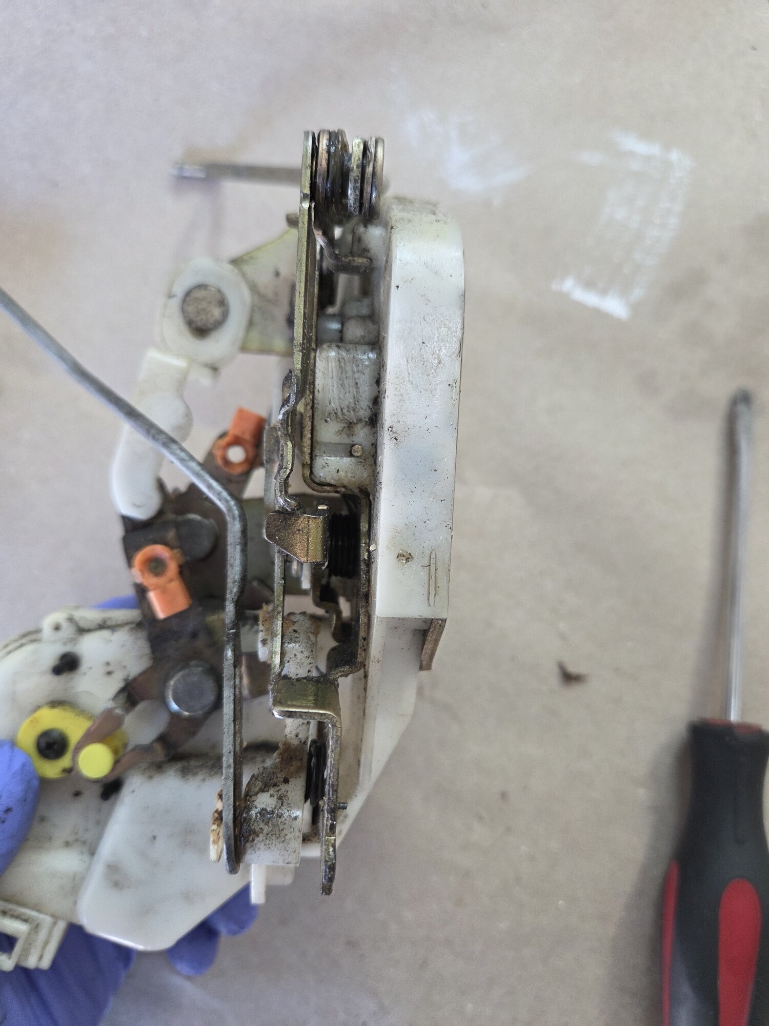

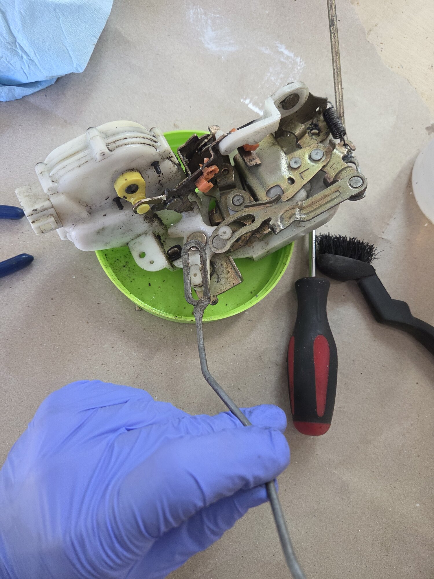

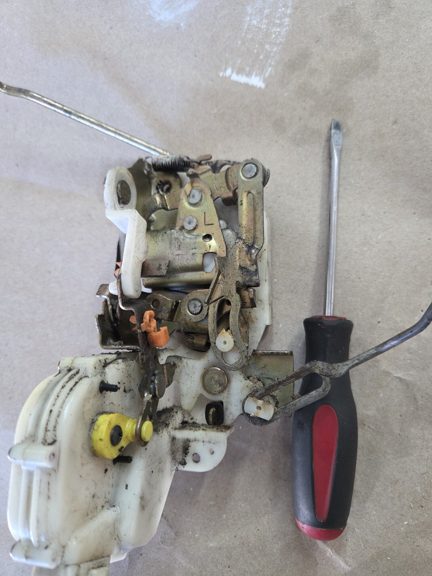

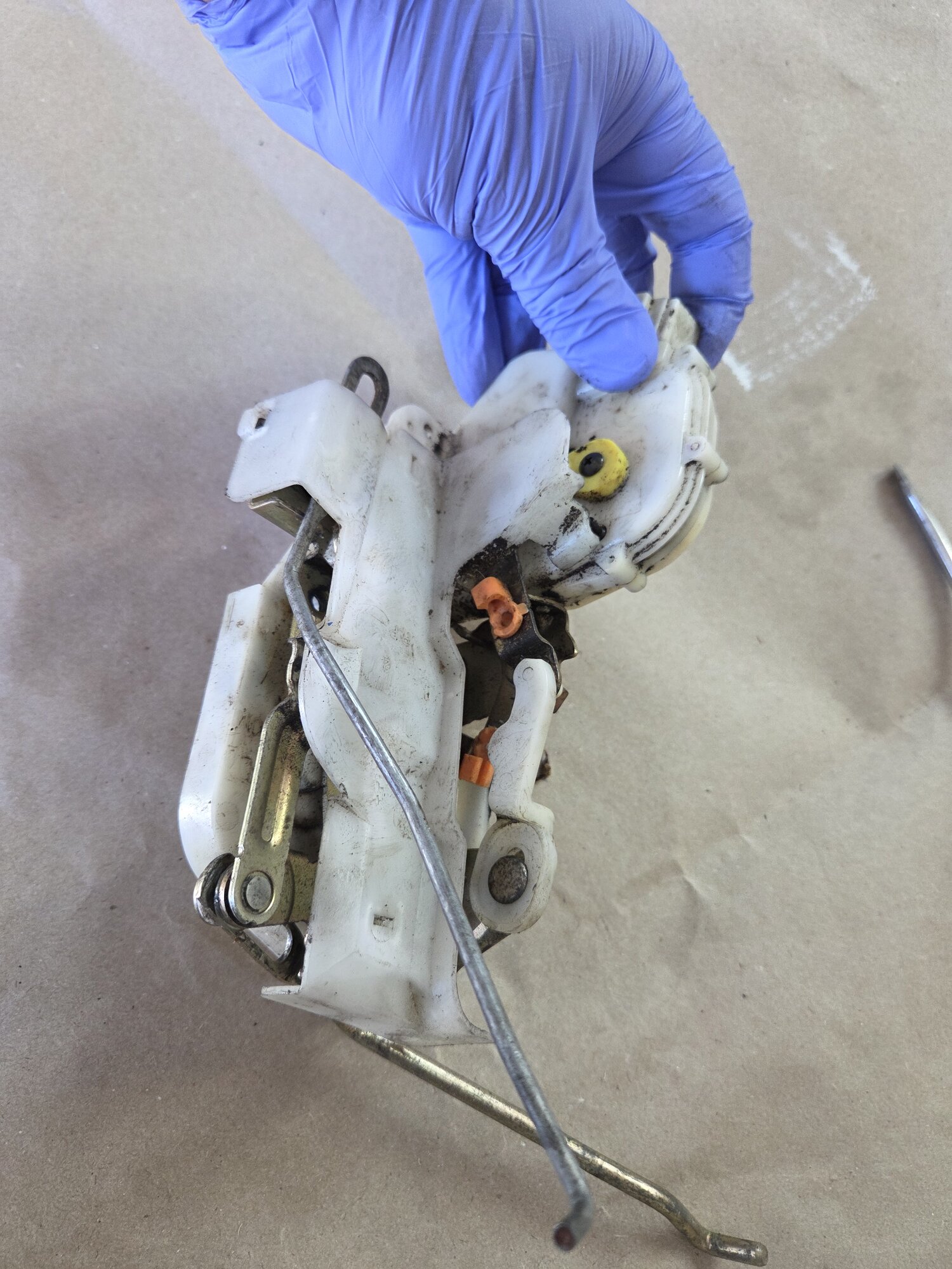

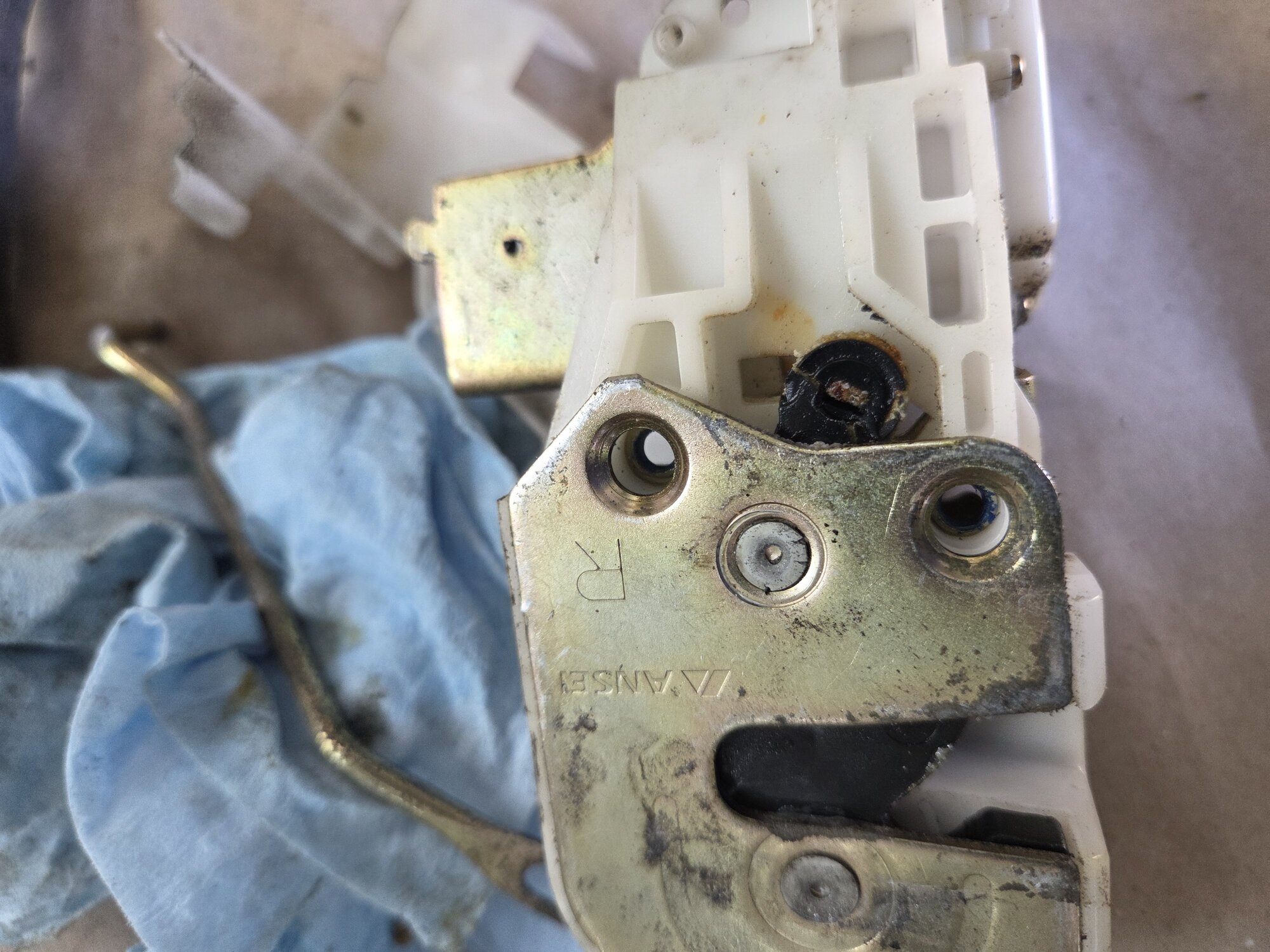

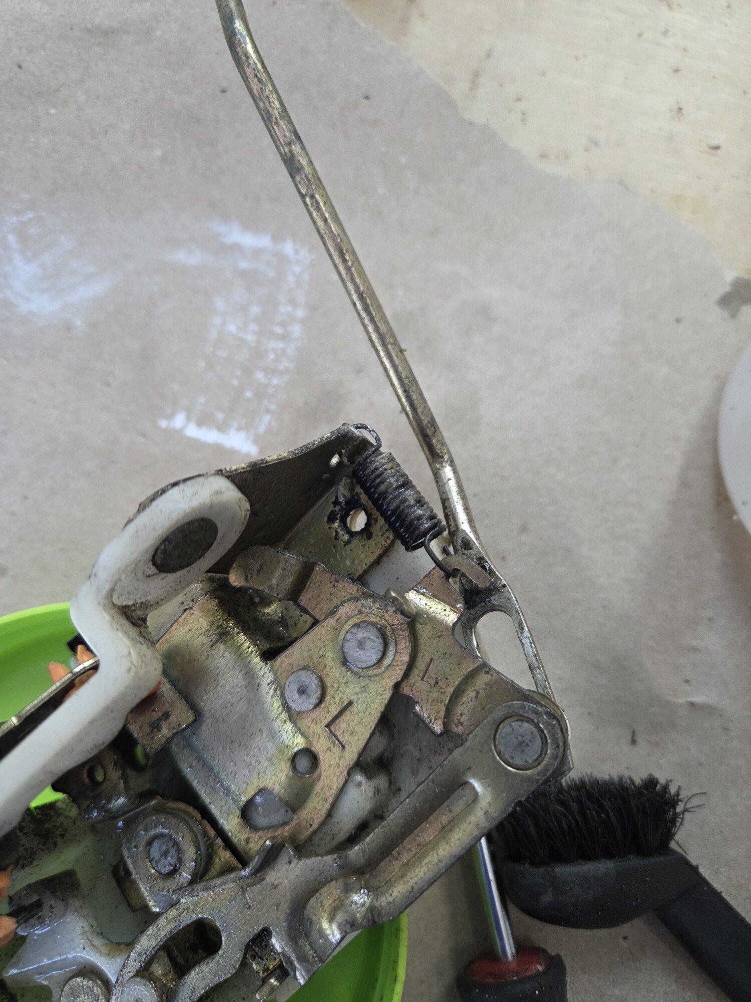

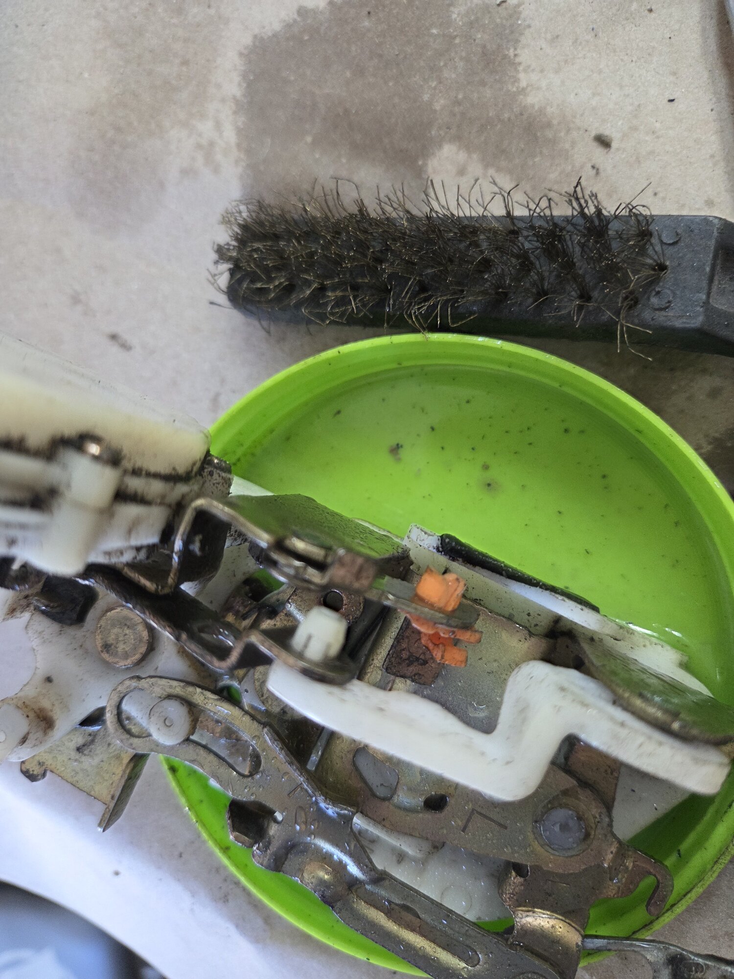

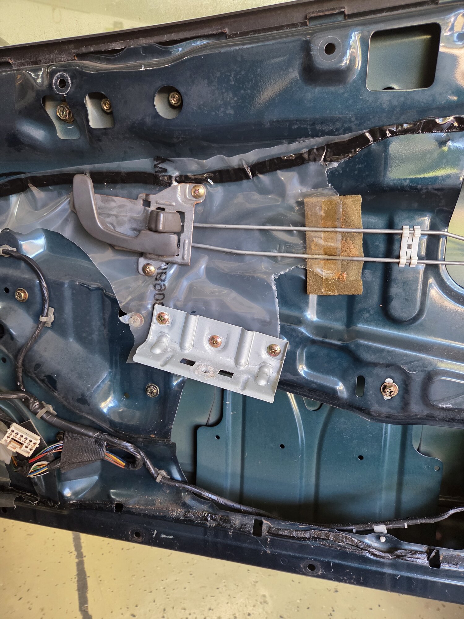

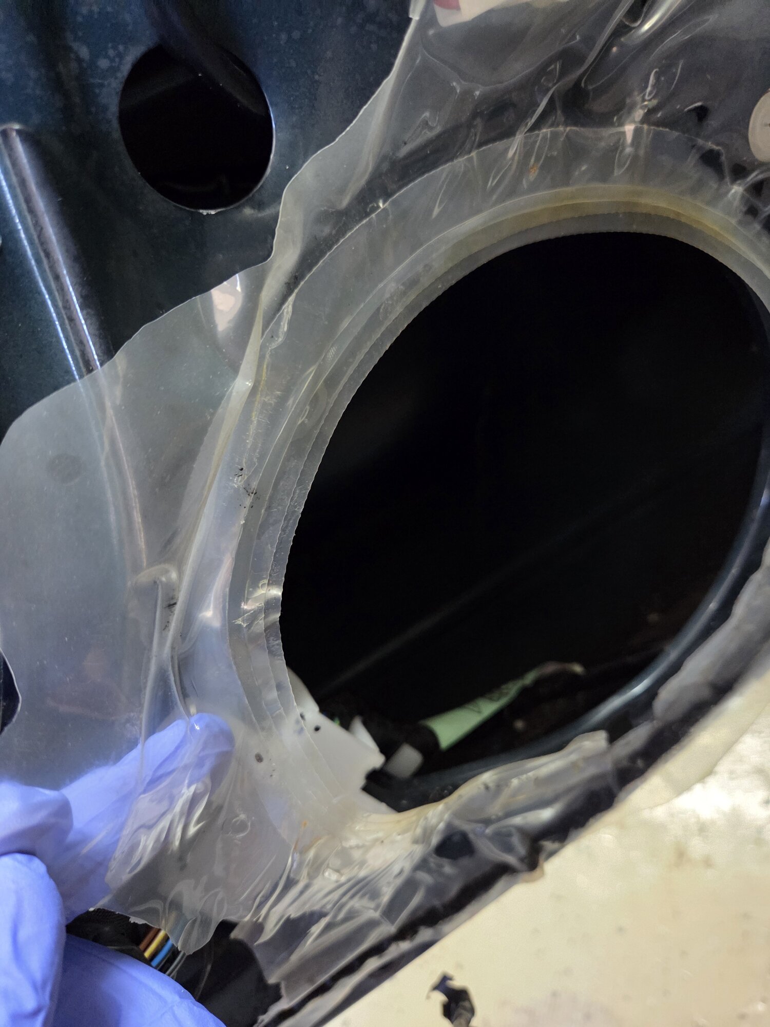

Door panel, door lock refurbishment, and those sweet sweet aluminum door handle installations. The door lock was sticking and not latching properly. Disassembly, cleaning, some light grease, and lubrication fixed it all. I might write up a tech article on it since I had to search for a few sources to get all the right info.

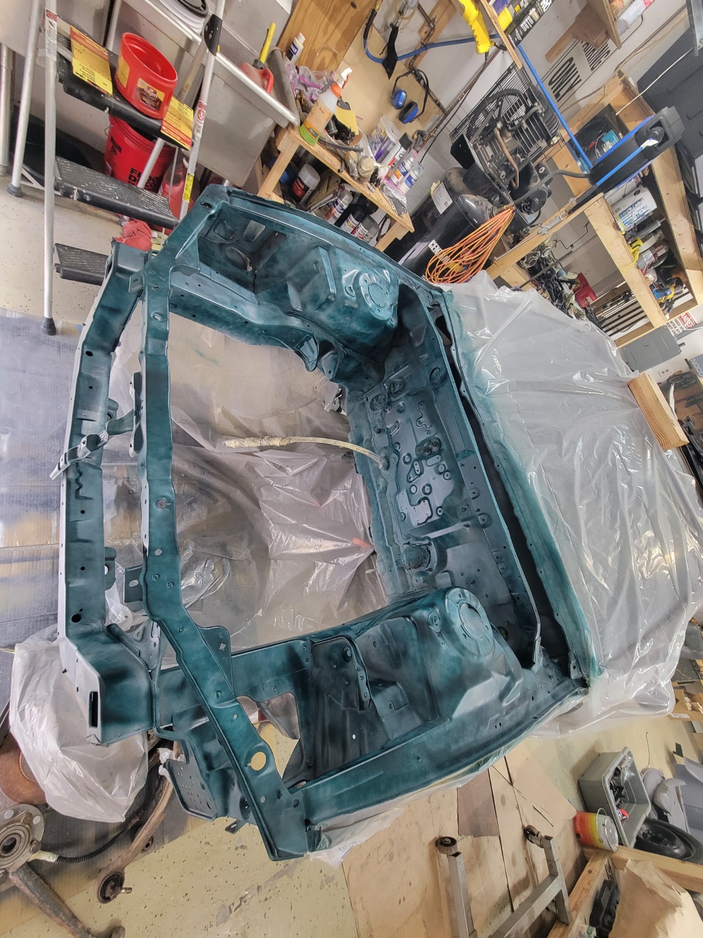

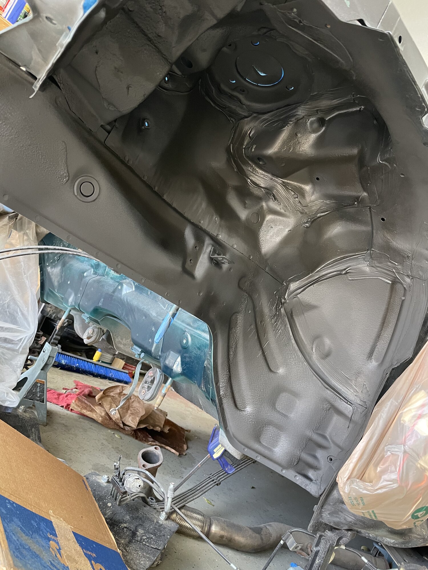

Painted engine bay back to OEM colors. This was a test using Eastbay rattle cans in a very very poorly set up area. I didnt really care about overspray but when I get around to painting the body, Ill make a more acceptable DIY set up.

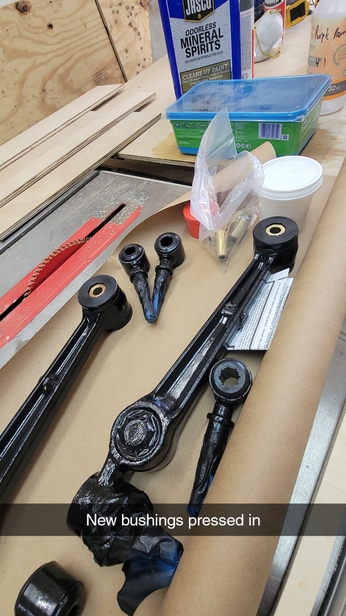

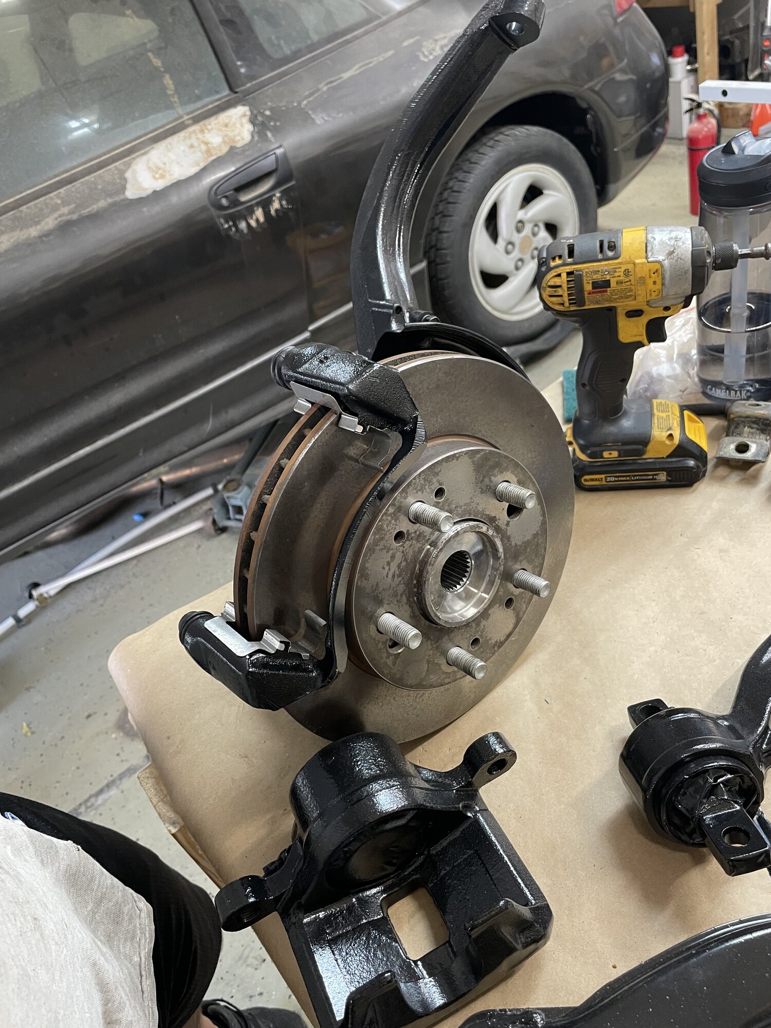

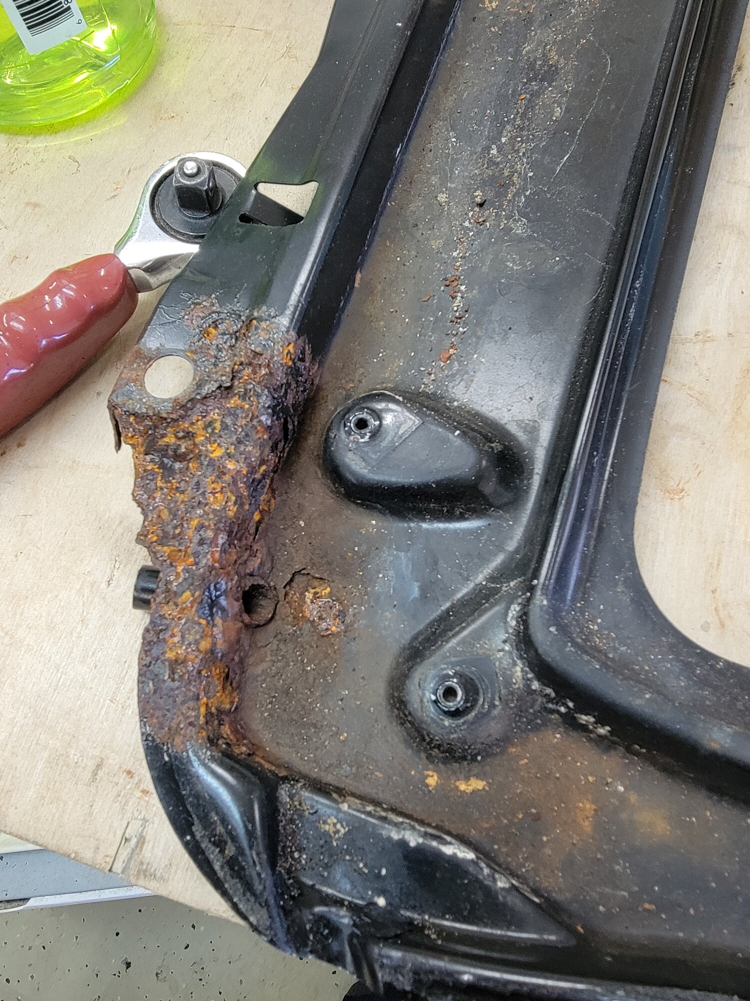

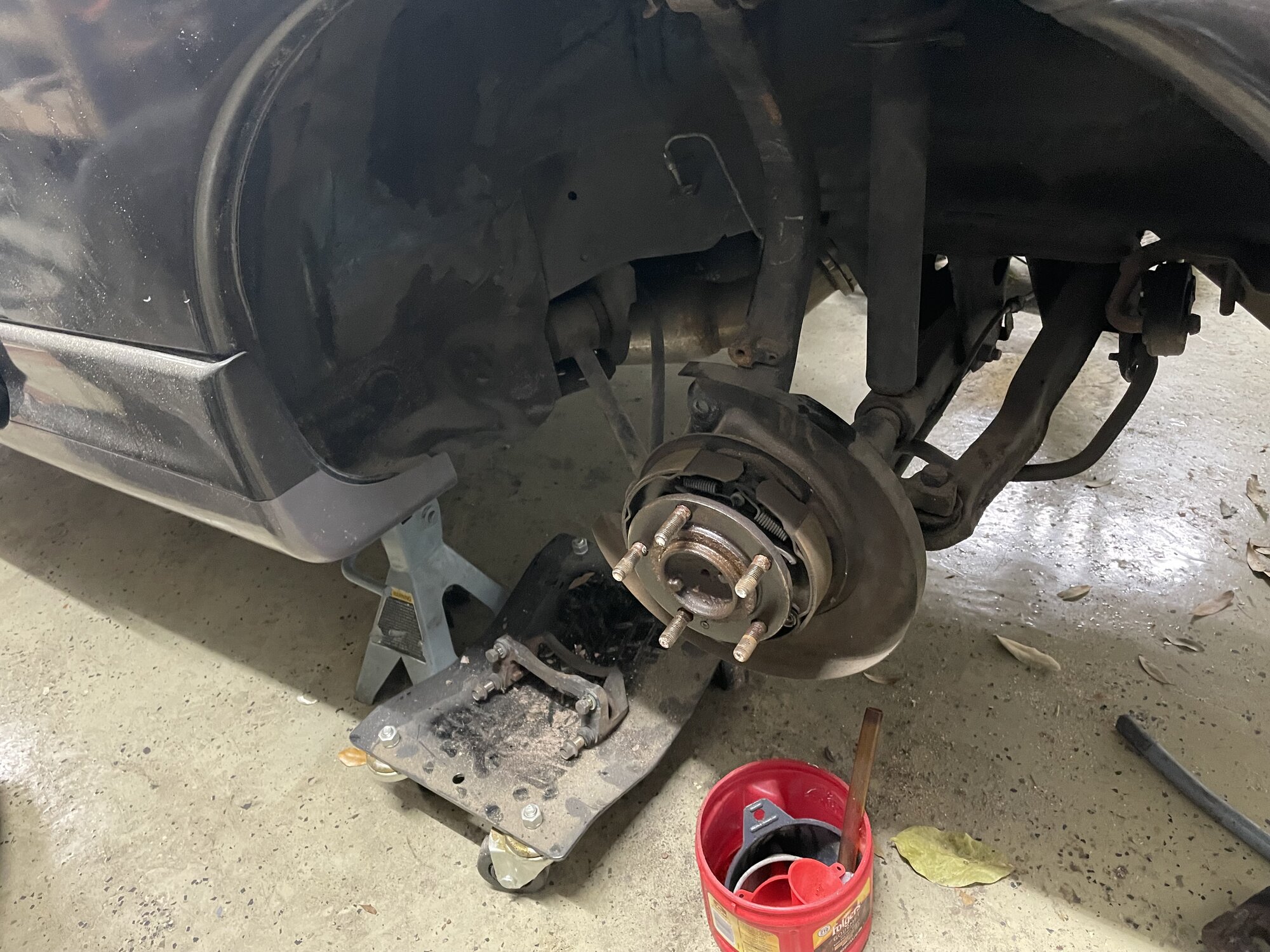

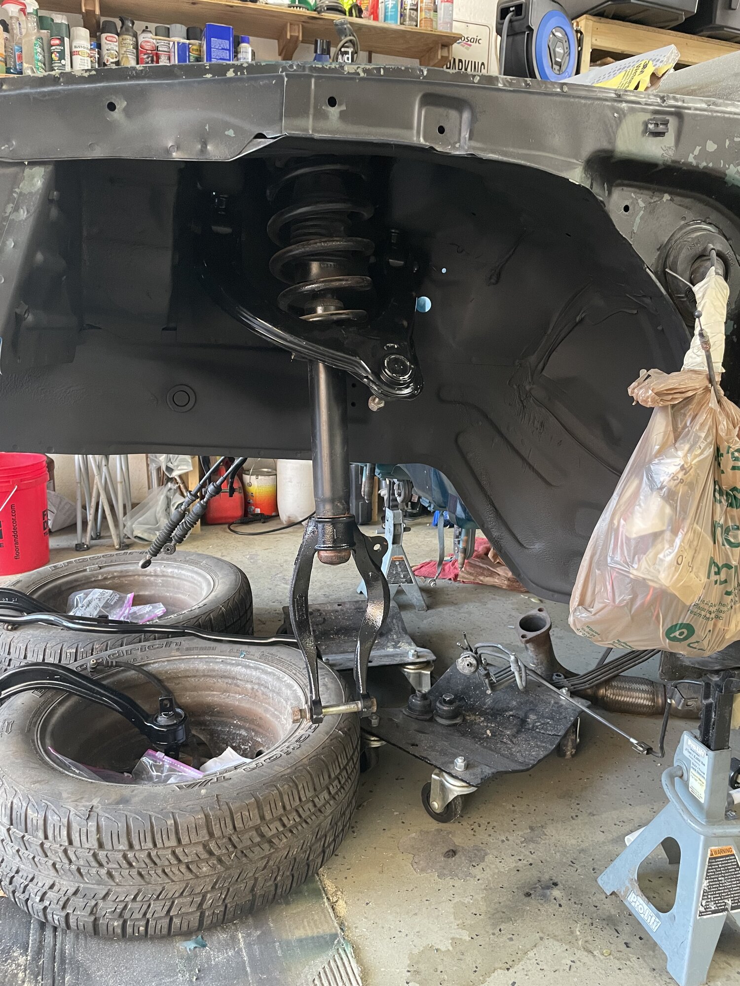

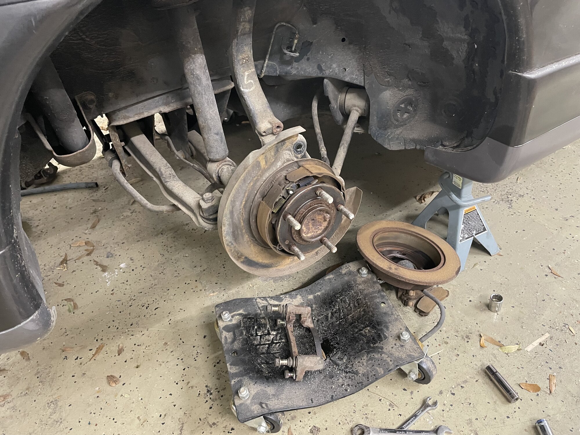

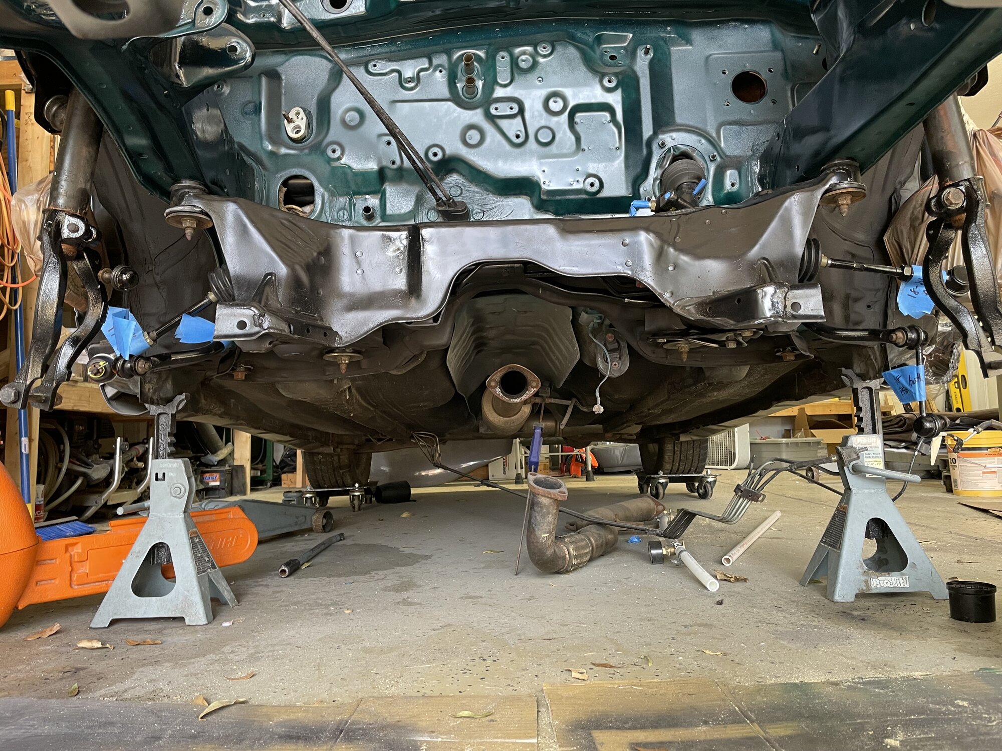

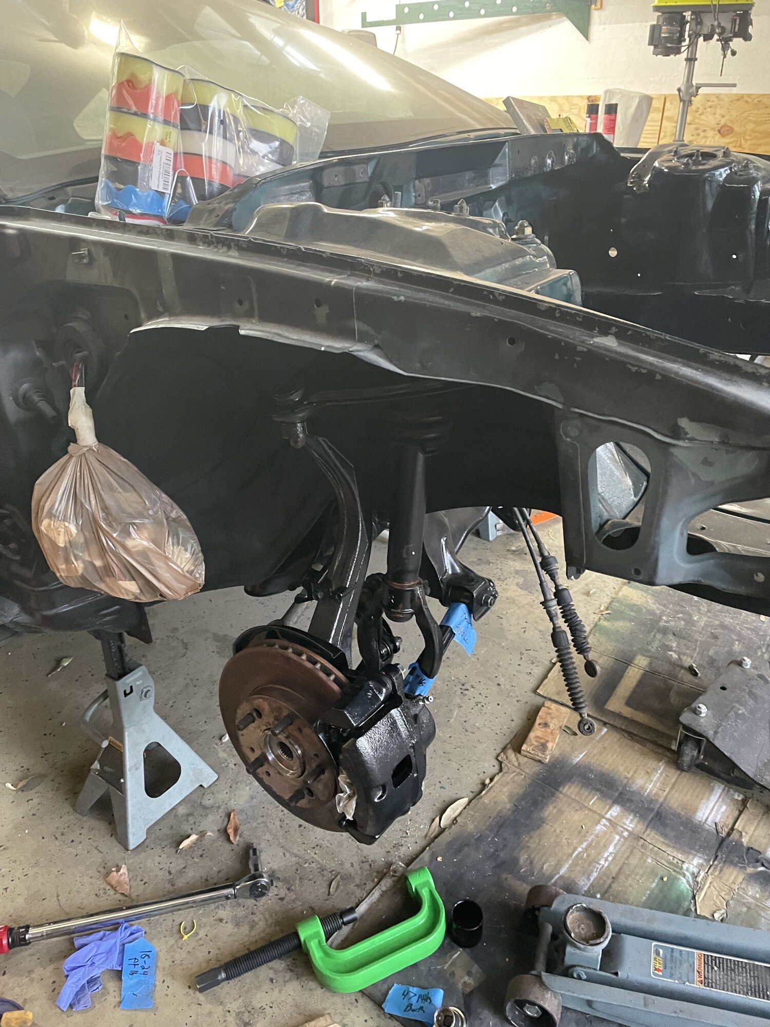

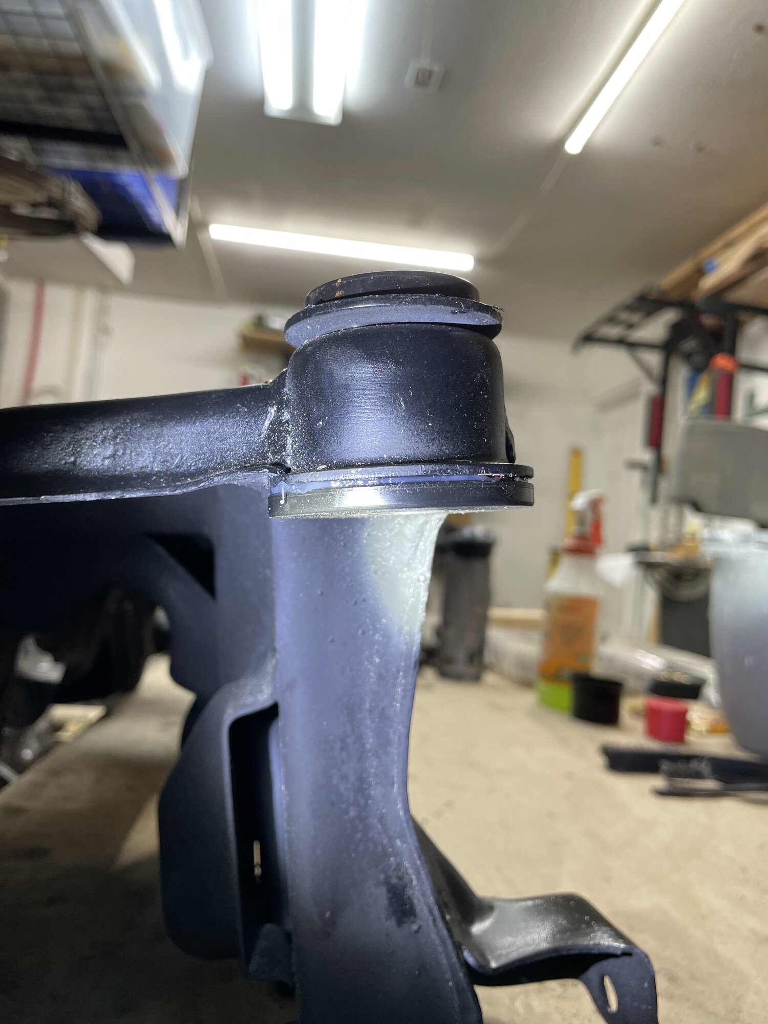

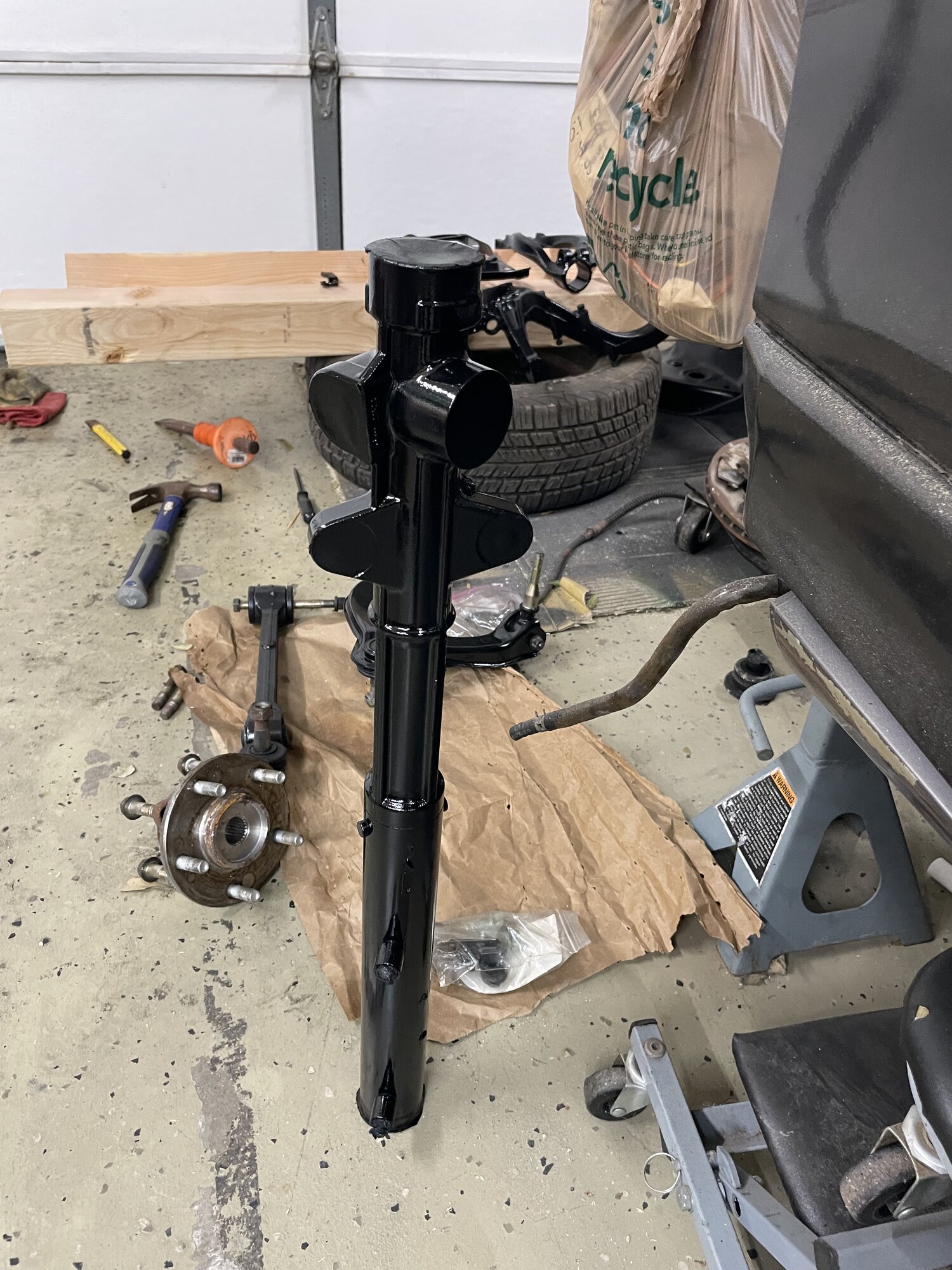

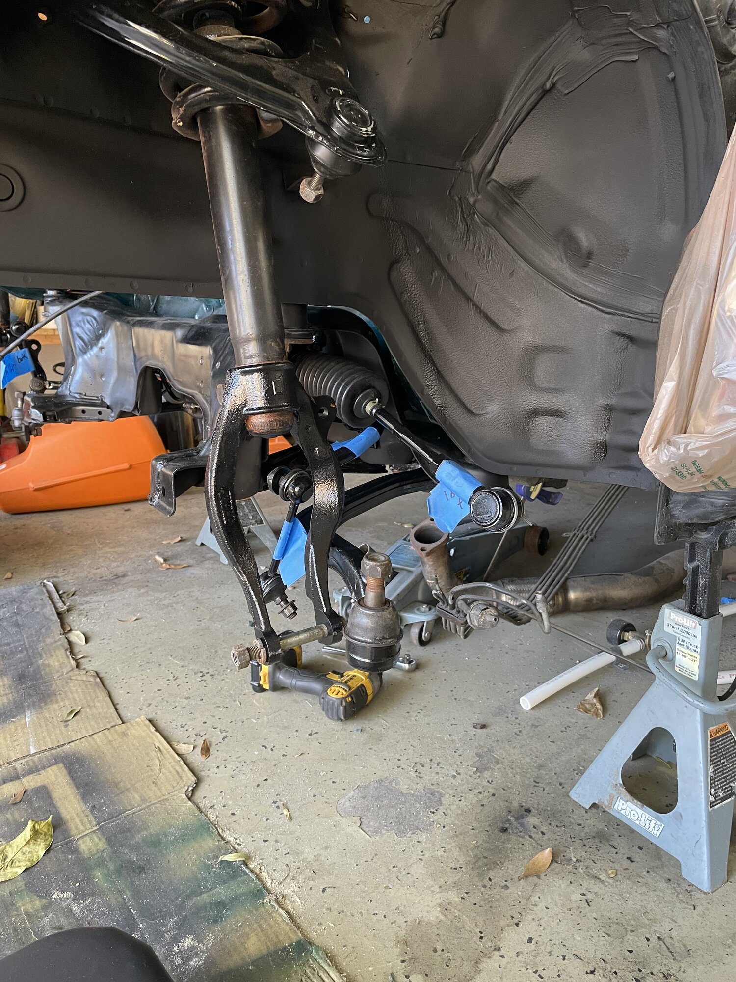

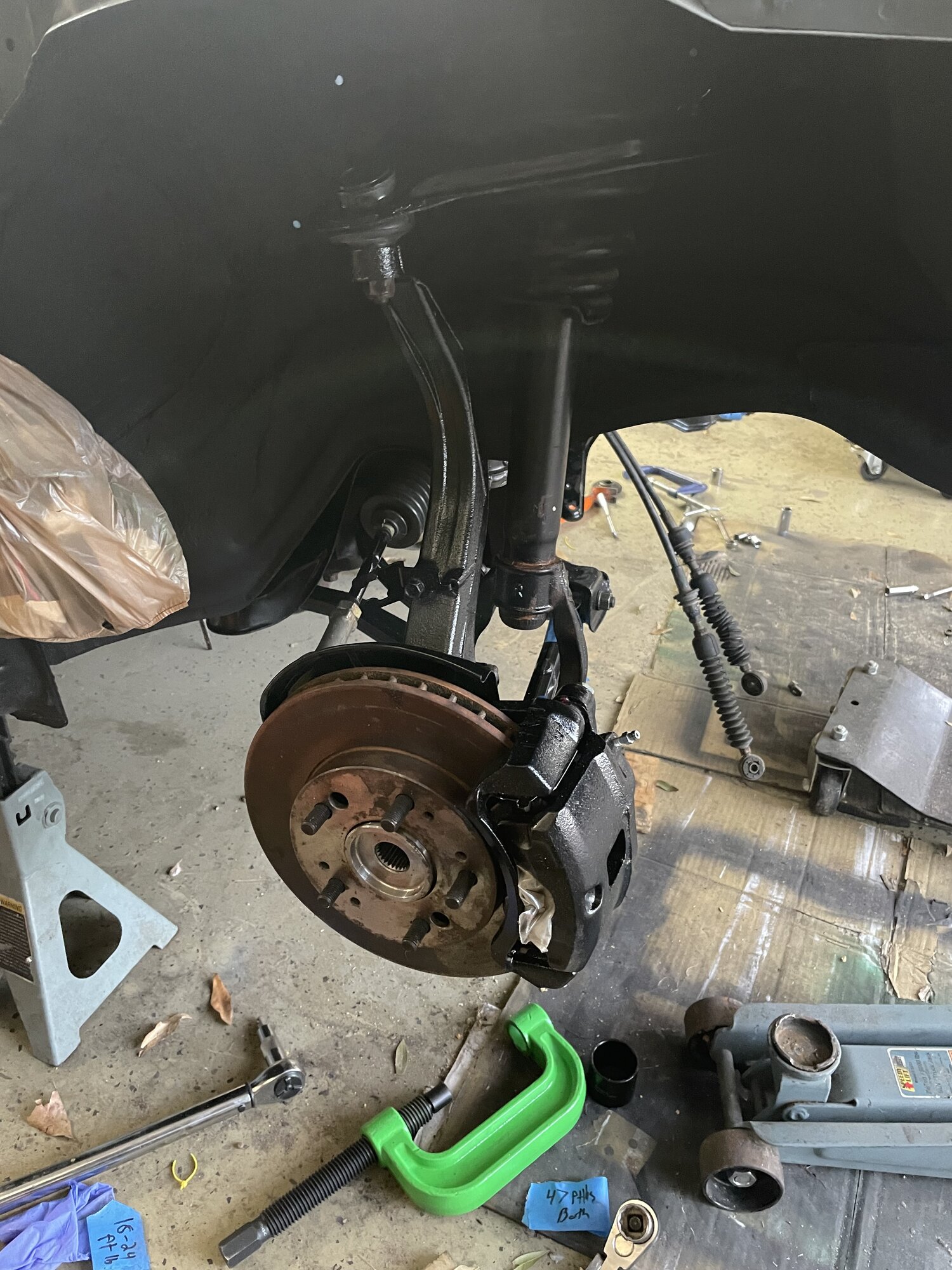

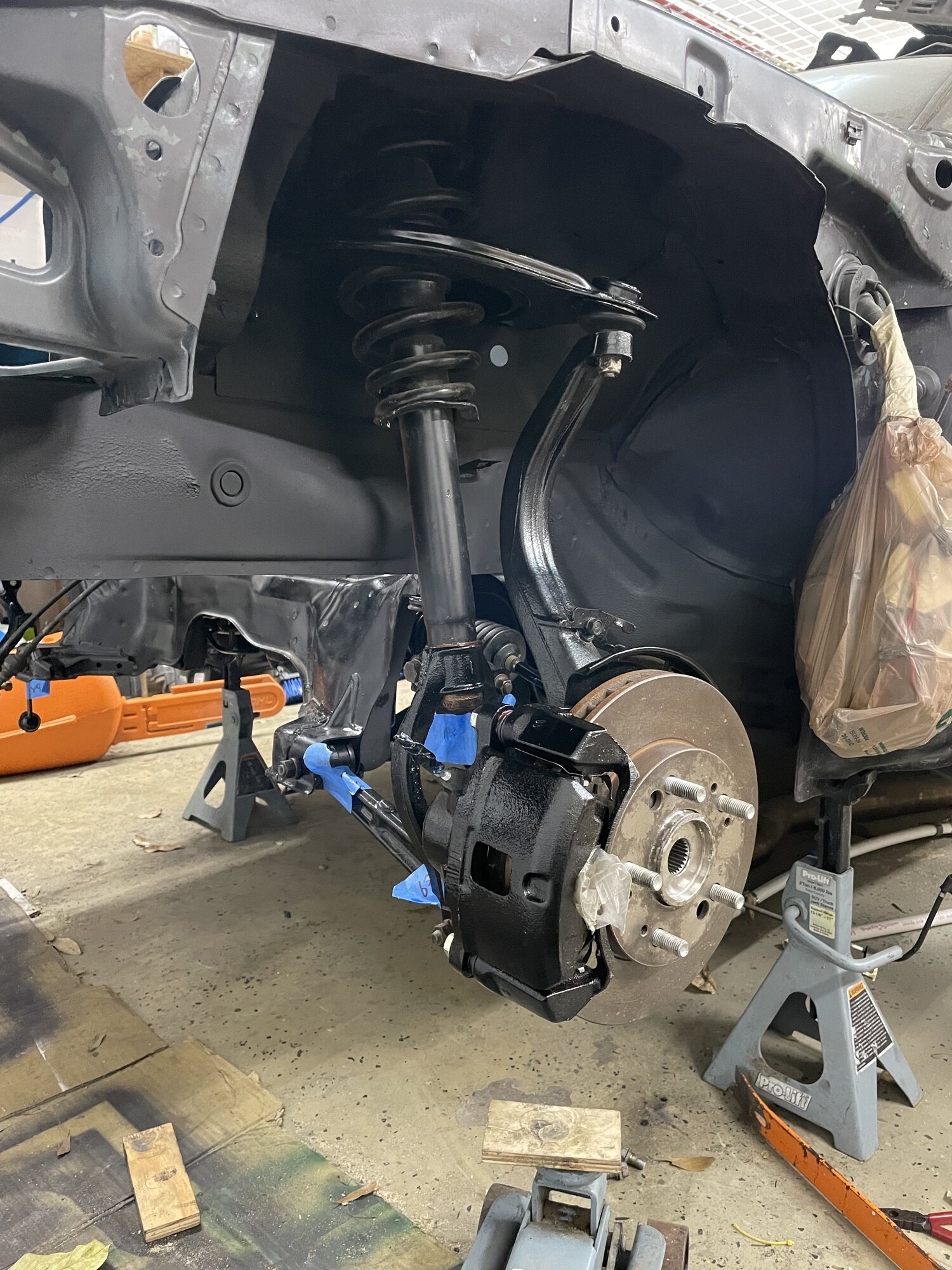

Everything suspension, brakes, and wheel wells. Replaced the things that needed to be replaced. Pressed in new polyurethane bushings. New brake components. Sprayed wheel wells with rubberized undercoating. Made a DIY sandblasting cabinet that Im likely going to repurpose/burn it down and buy one that works a bit better.
Also ran new brake lines for an ABS to non-ABS conversion (not shown). This was actually really fun. I used the old lines as a template.

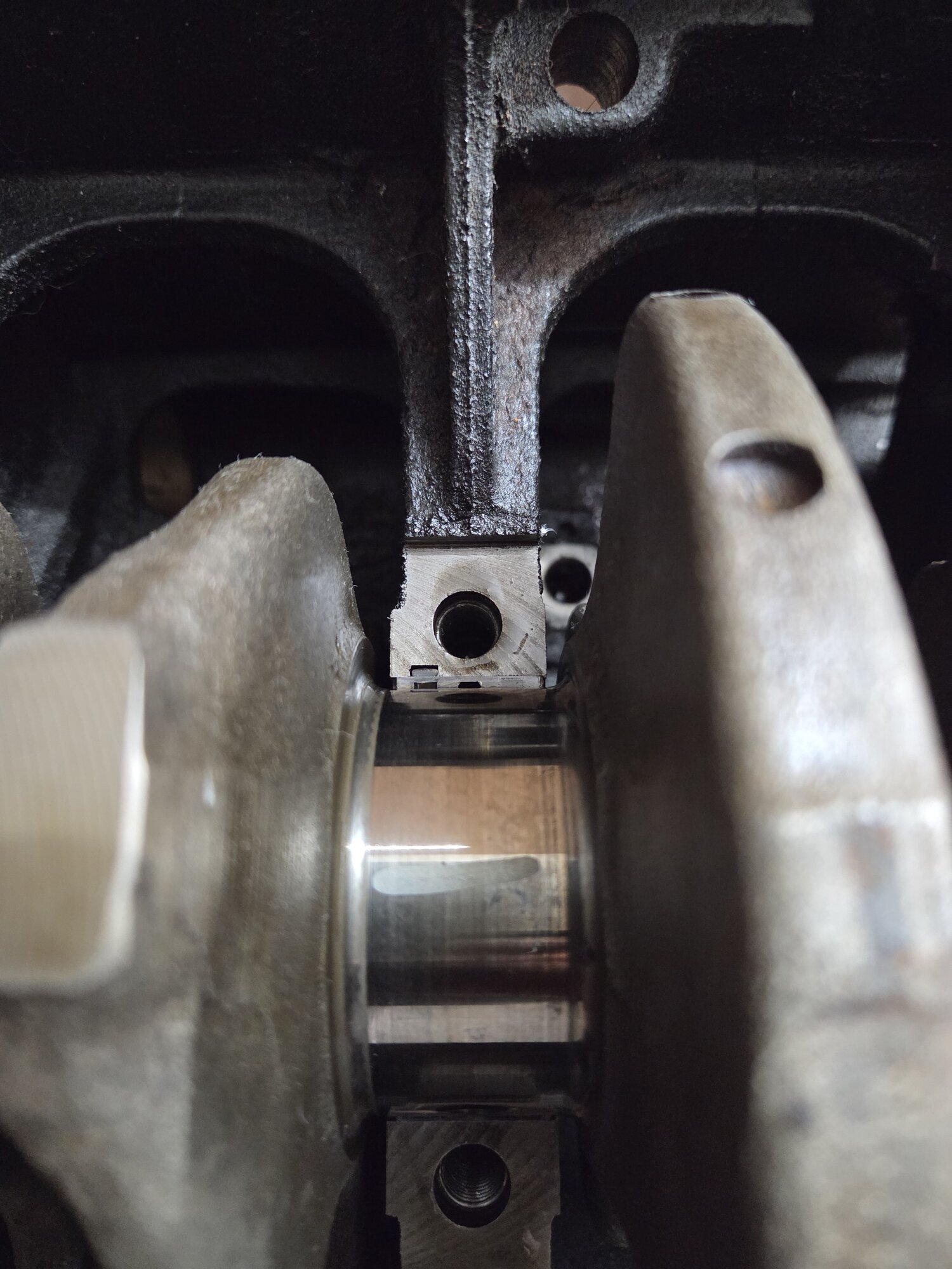

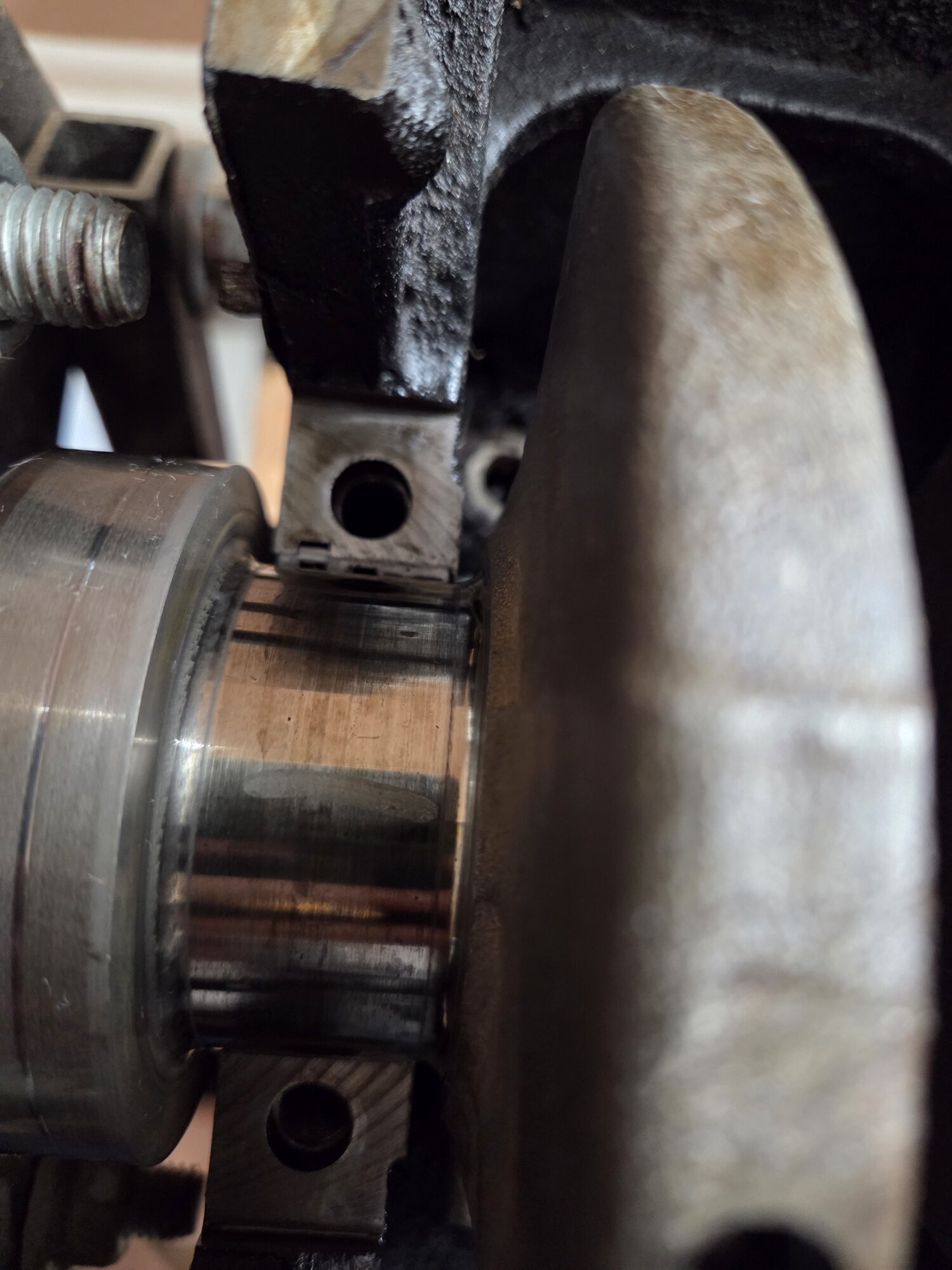

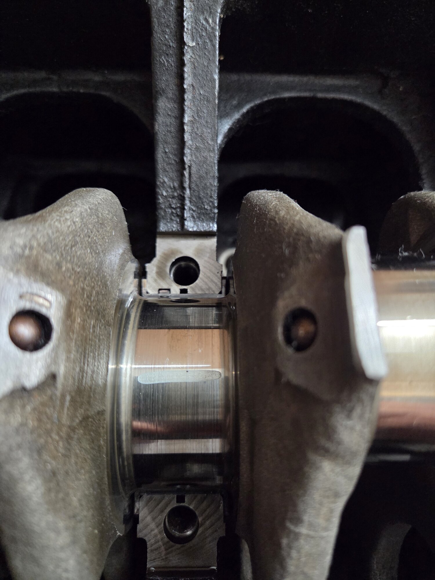

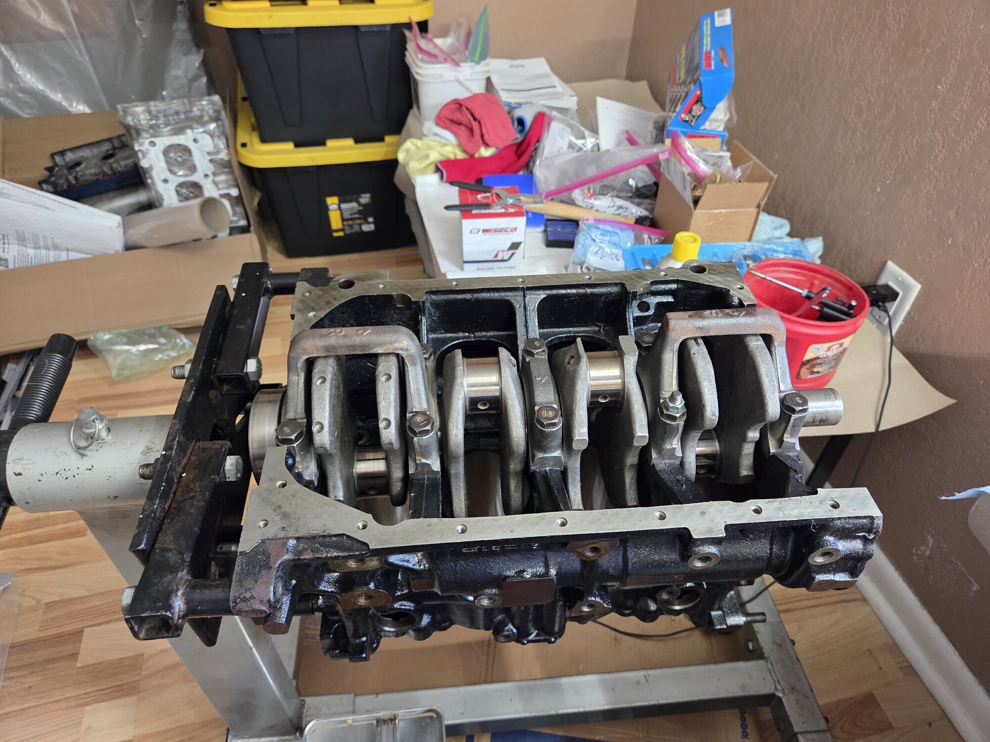

Some misc blueprinting of the crank. I ended up ordering new rods and block will see machine shop in December!! Huge milestone for me! I have a ton more pics on my phone to upload at some point as well.

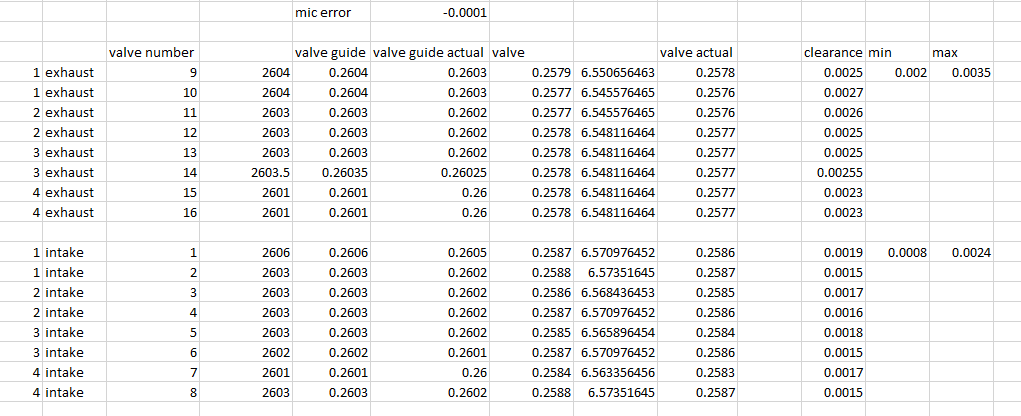

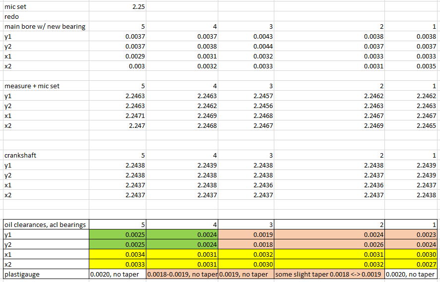

Various blueprint maths:
Valve guide clearances:
Cylinders:

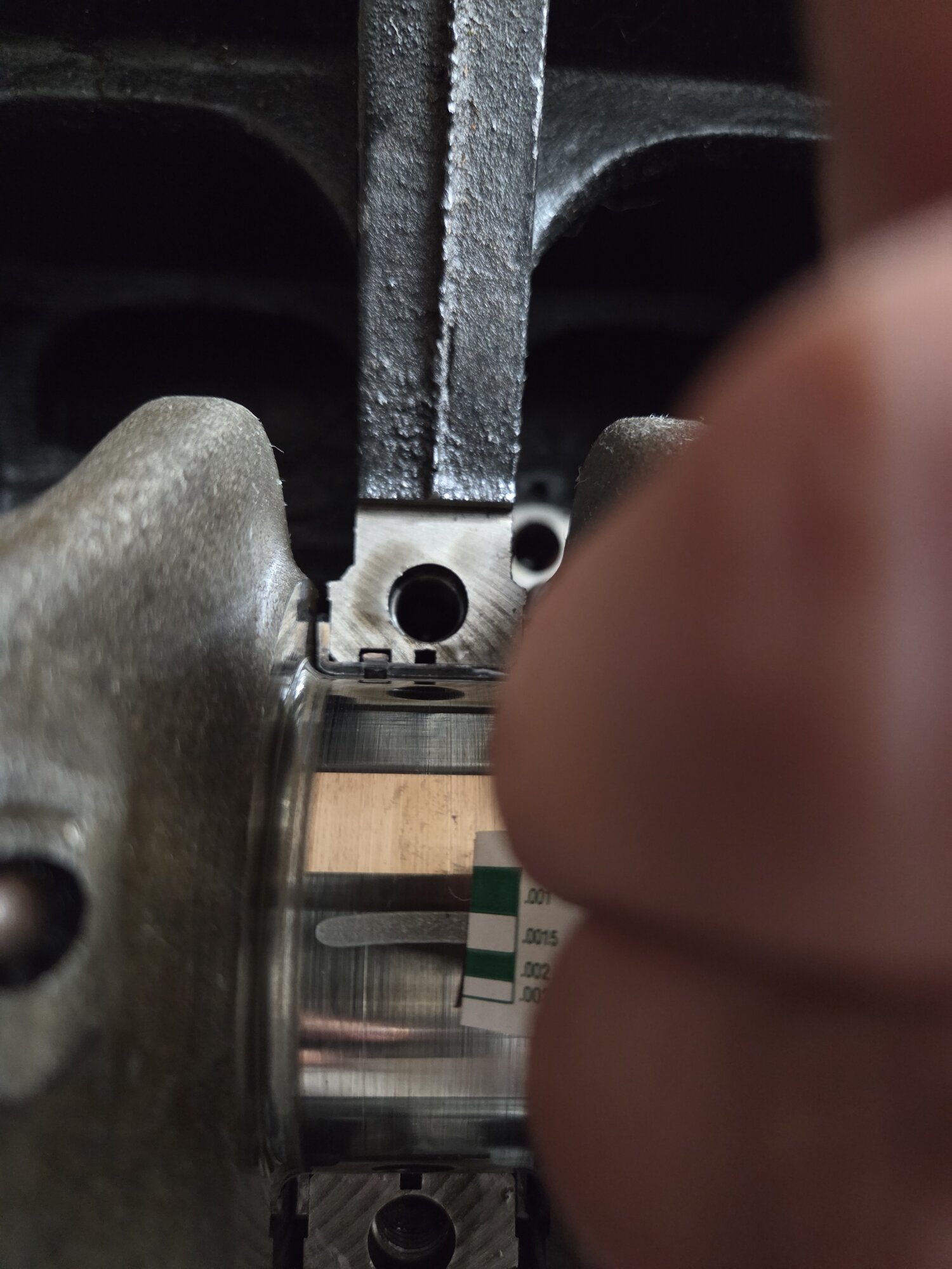

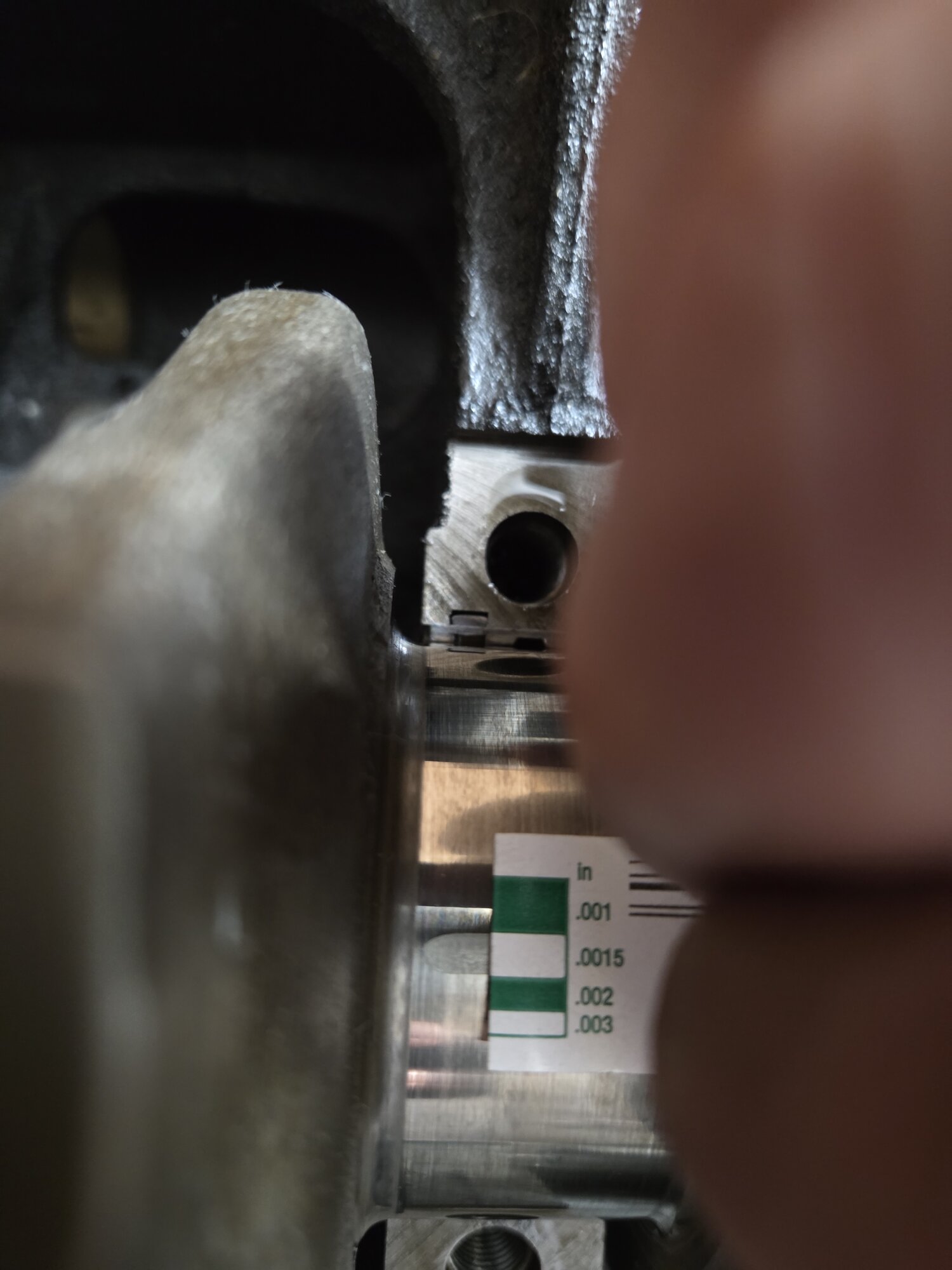

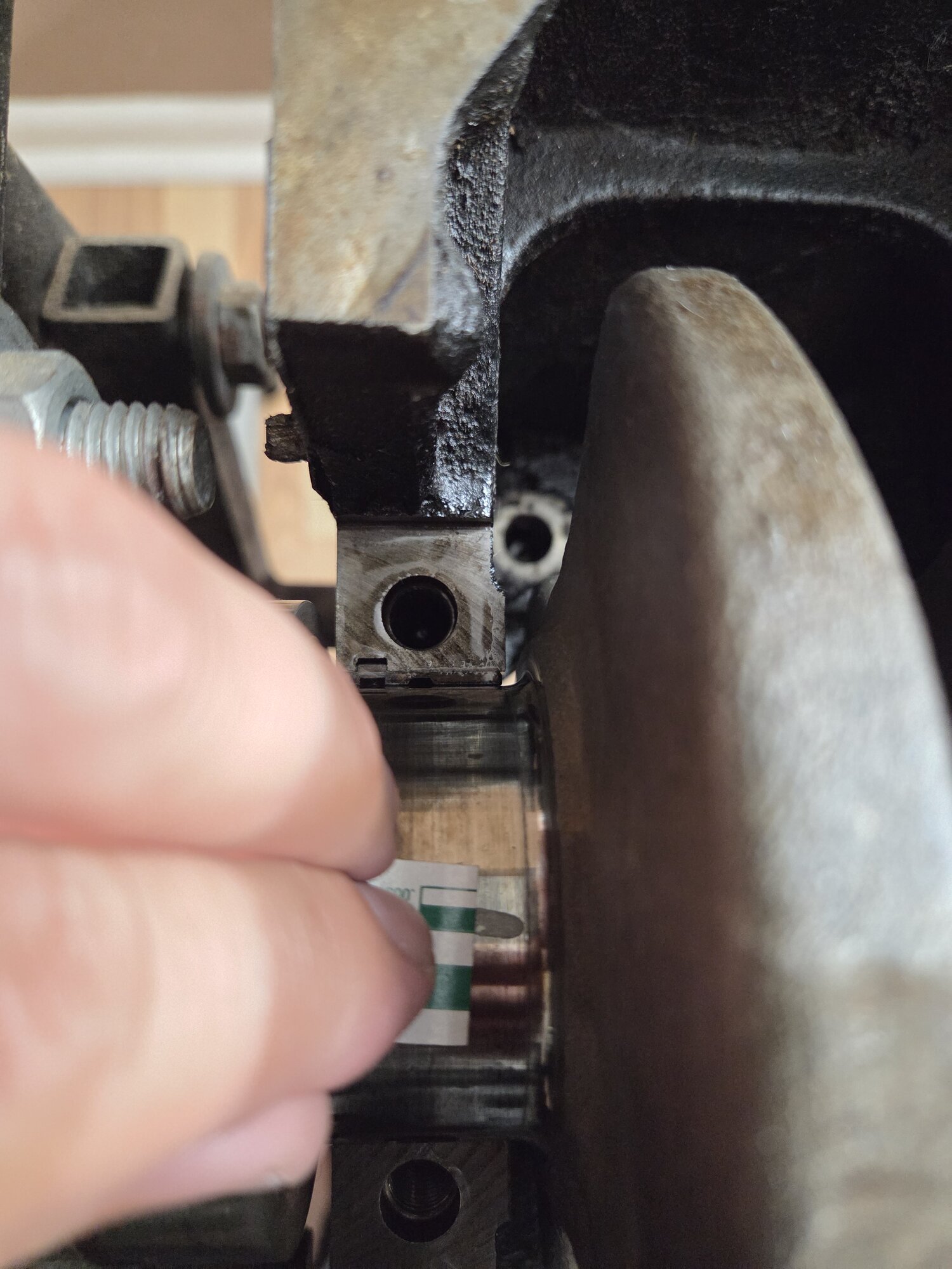

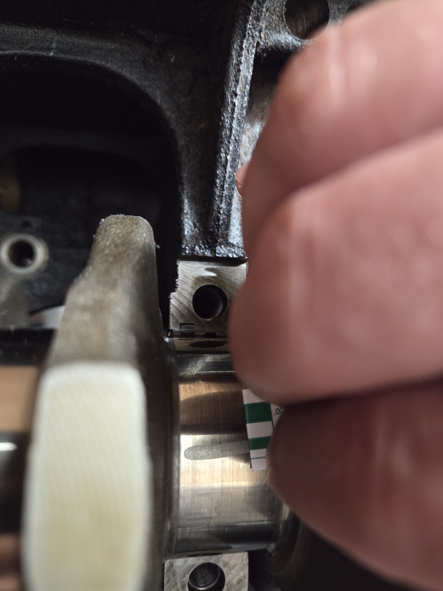

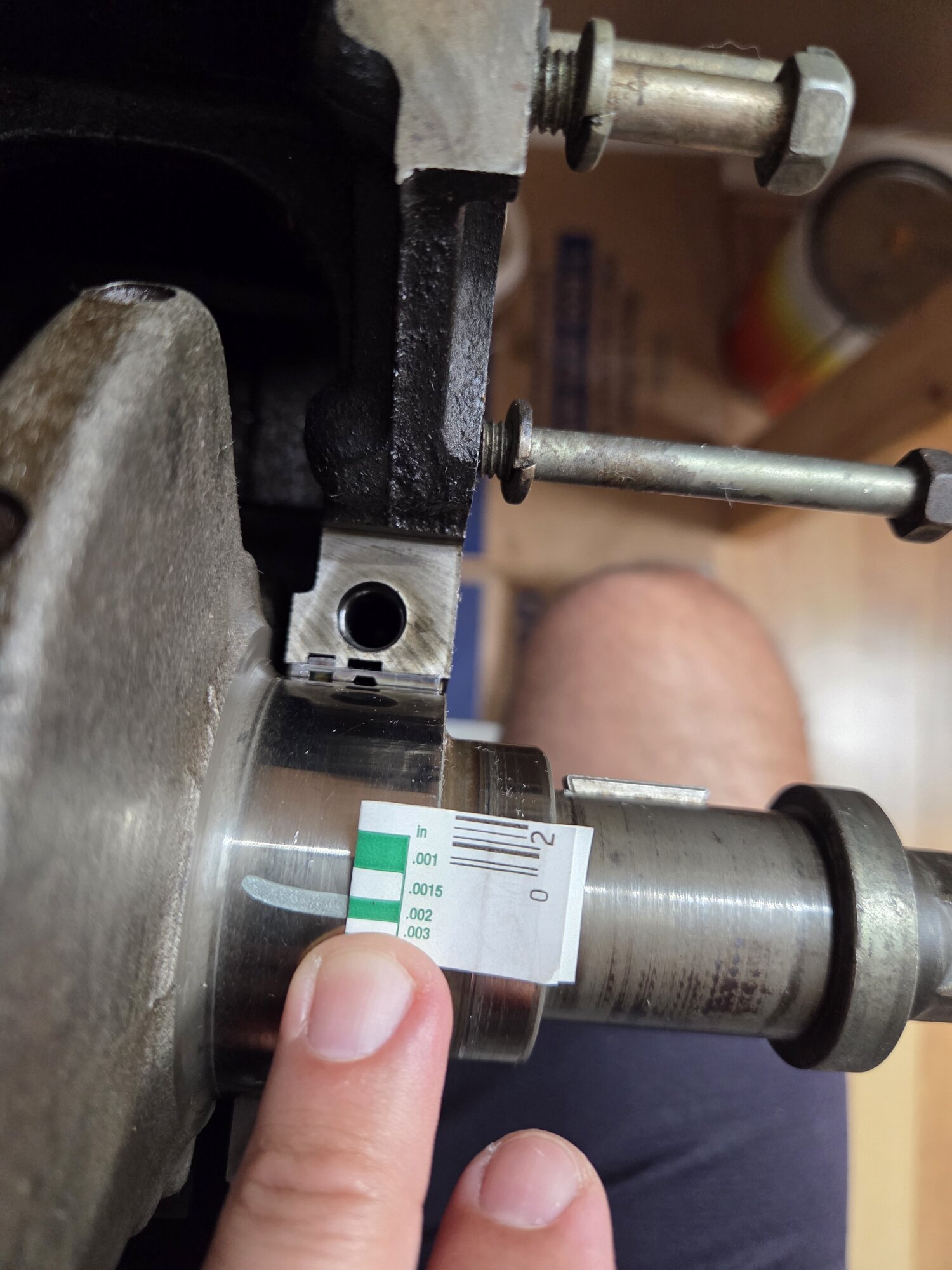

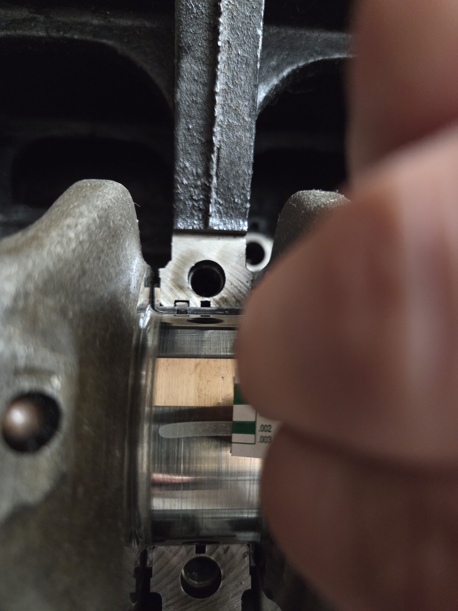

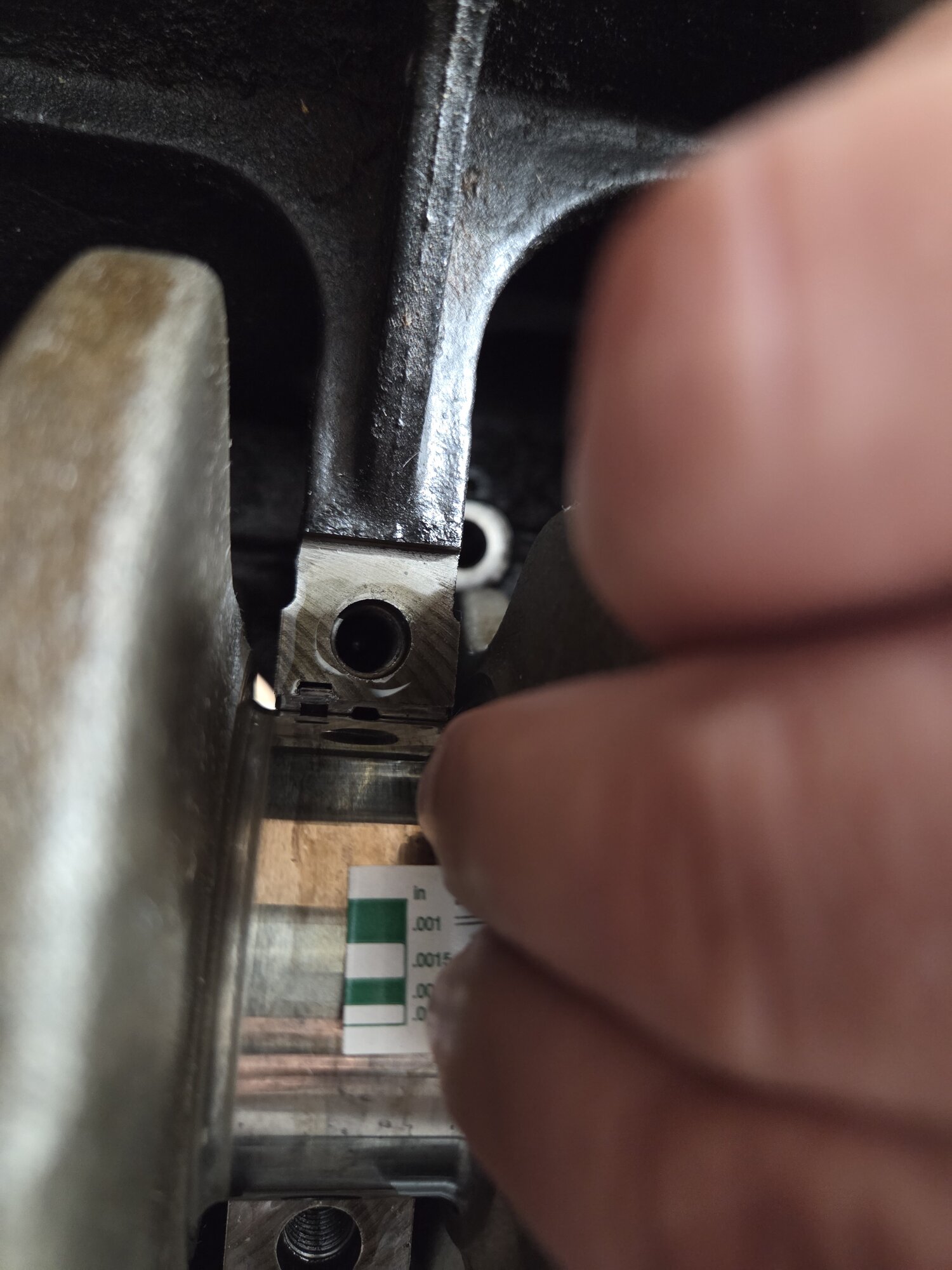

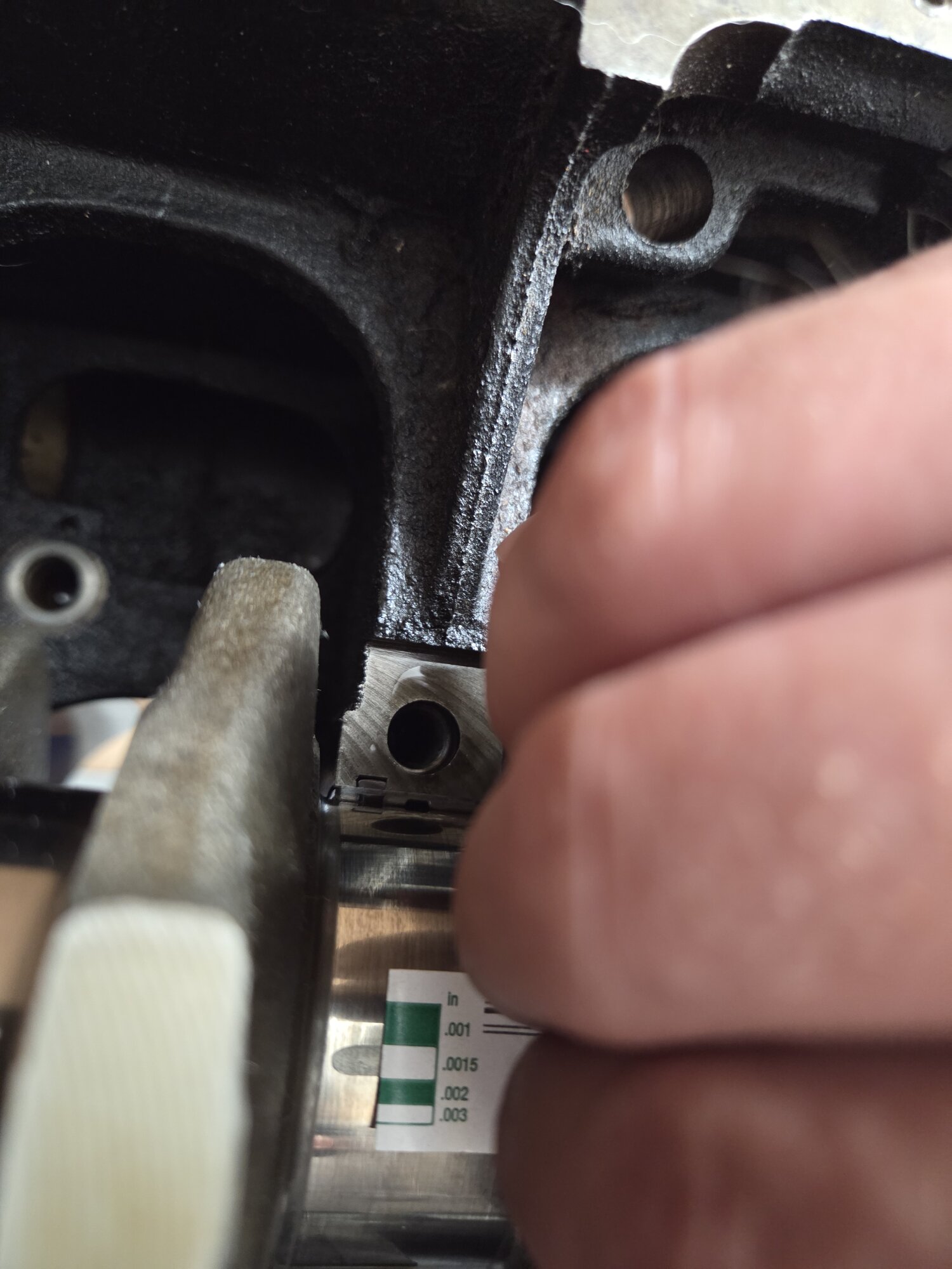

Main oil clearances. Im not happy with the procedure I used. Now that the crank and mains are spotless, Im going to redo the measurements again. With the condition of the crank being dead on stock specification ranges, Im not expecting this much wear/unevenness. Theres a lot of error I introduced while learning to use a mic.

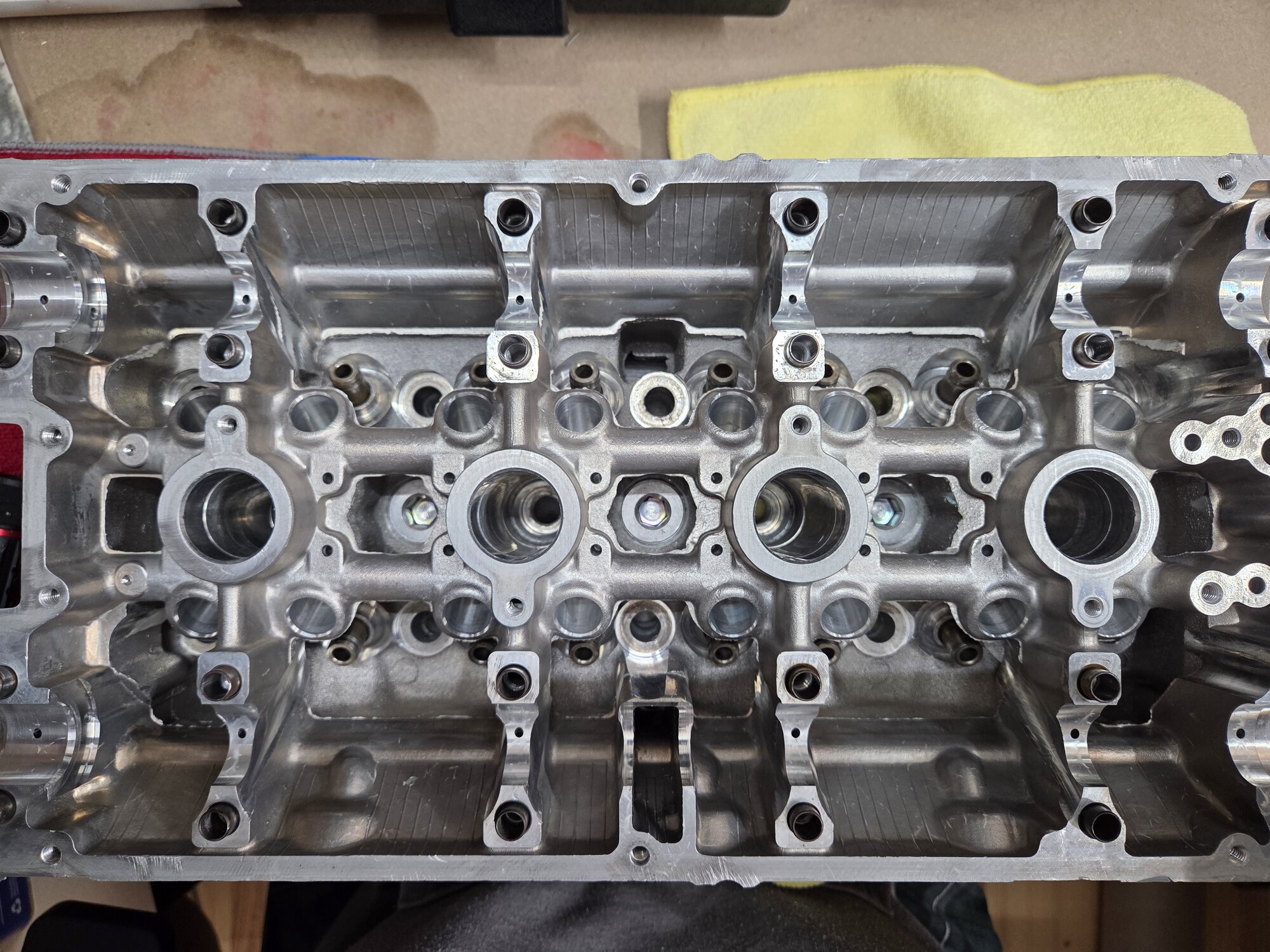

Head:

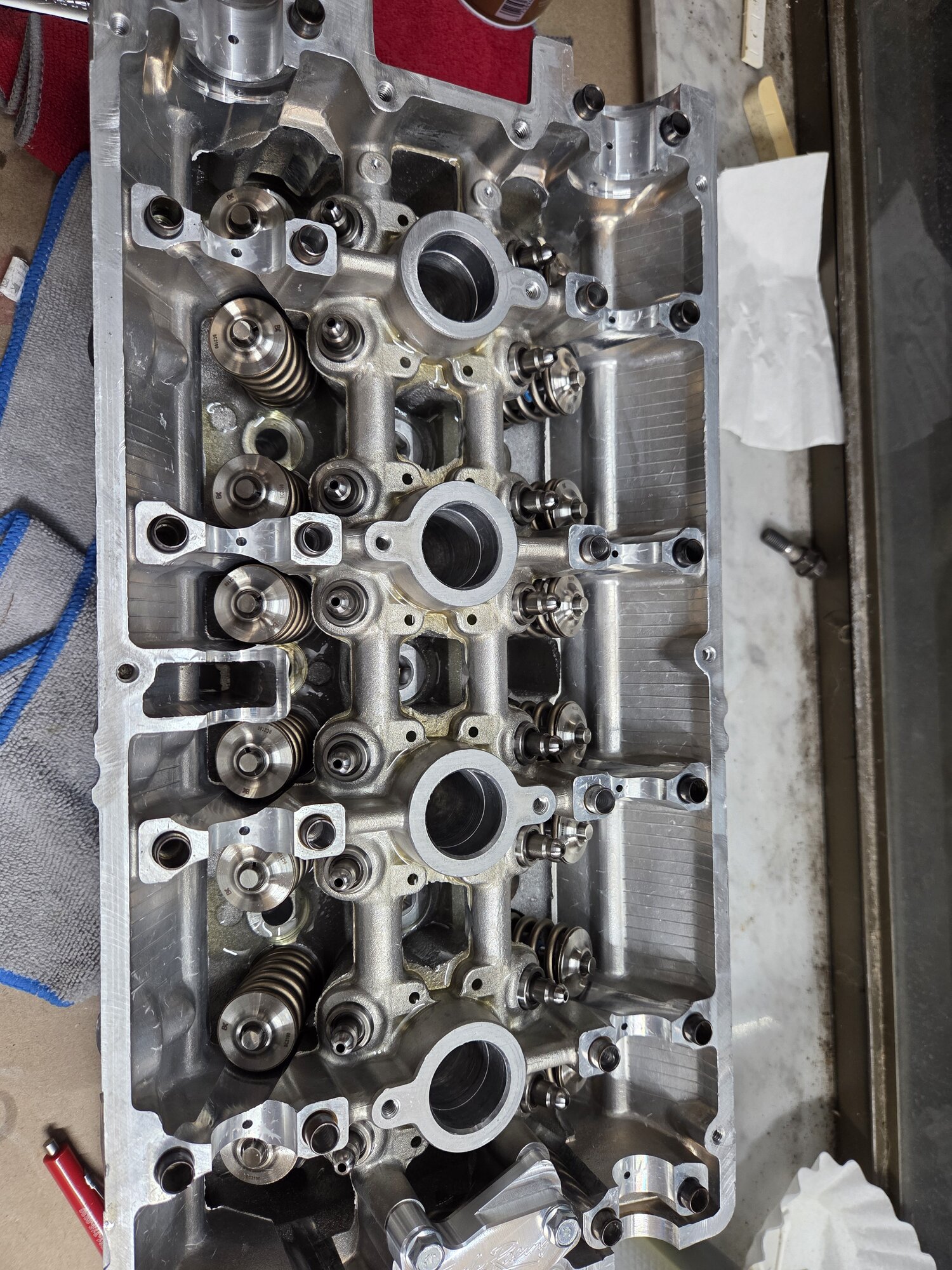

Ended up using the ultrasonic again - I missed cleaning out the small holes/shafts for each lifter. Figured a 2nd round couldnt hurt and the water was definitely a bit dirty. Also probably had some left over valve grinding compound in it from earlier this year. Valves now hold full vacuum easily - Ill post before/after vacuum results later.

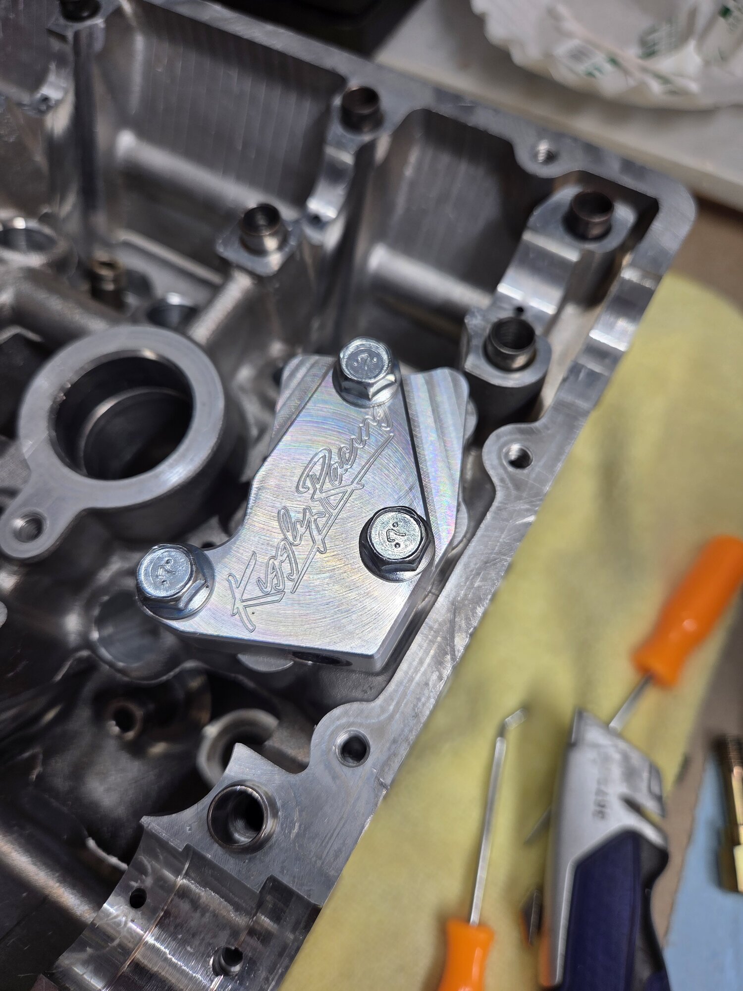

For the good news - installed my first part in this super clean head - a Kiggly pressure regulator. Definitely got the motivation up seeing this in its final home and Im looking forward to getting this thing rebuilt again! Ill likely just get oil plugs in this weekend. Once valve stem seals show up, Ill be able to put this thing together completely.

Head now has a valve train assembly, but need to check rockers before installing cams.

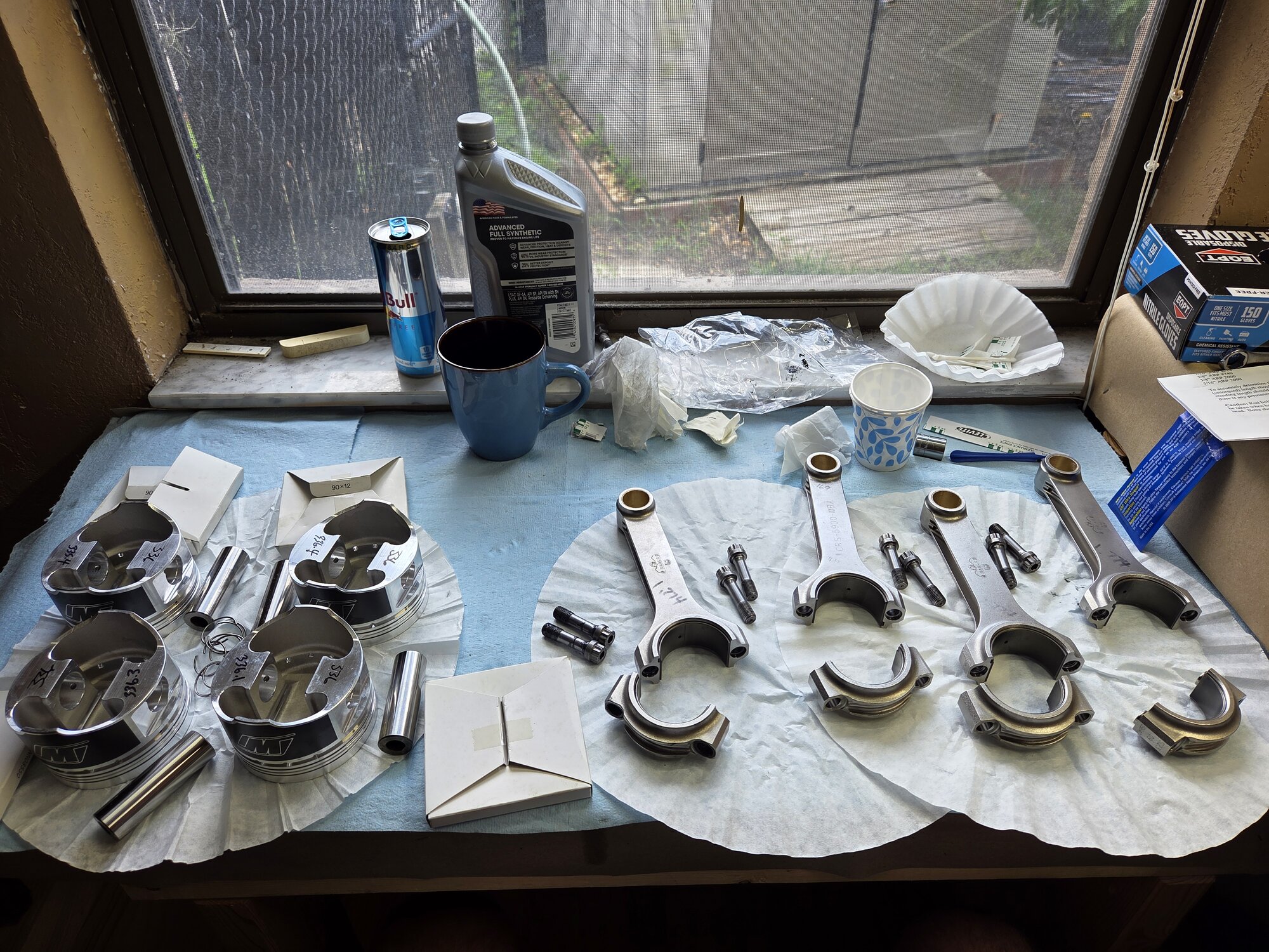

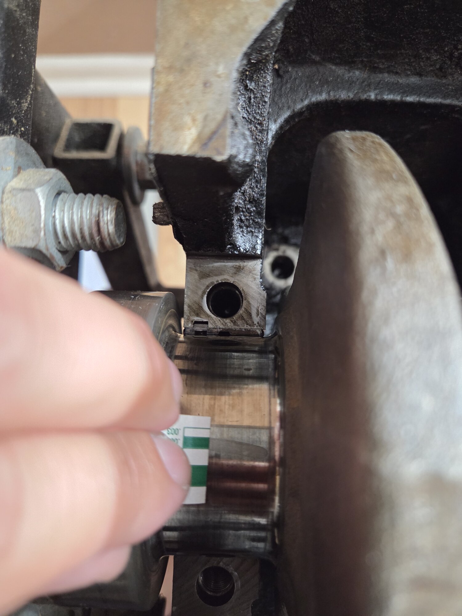

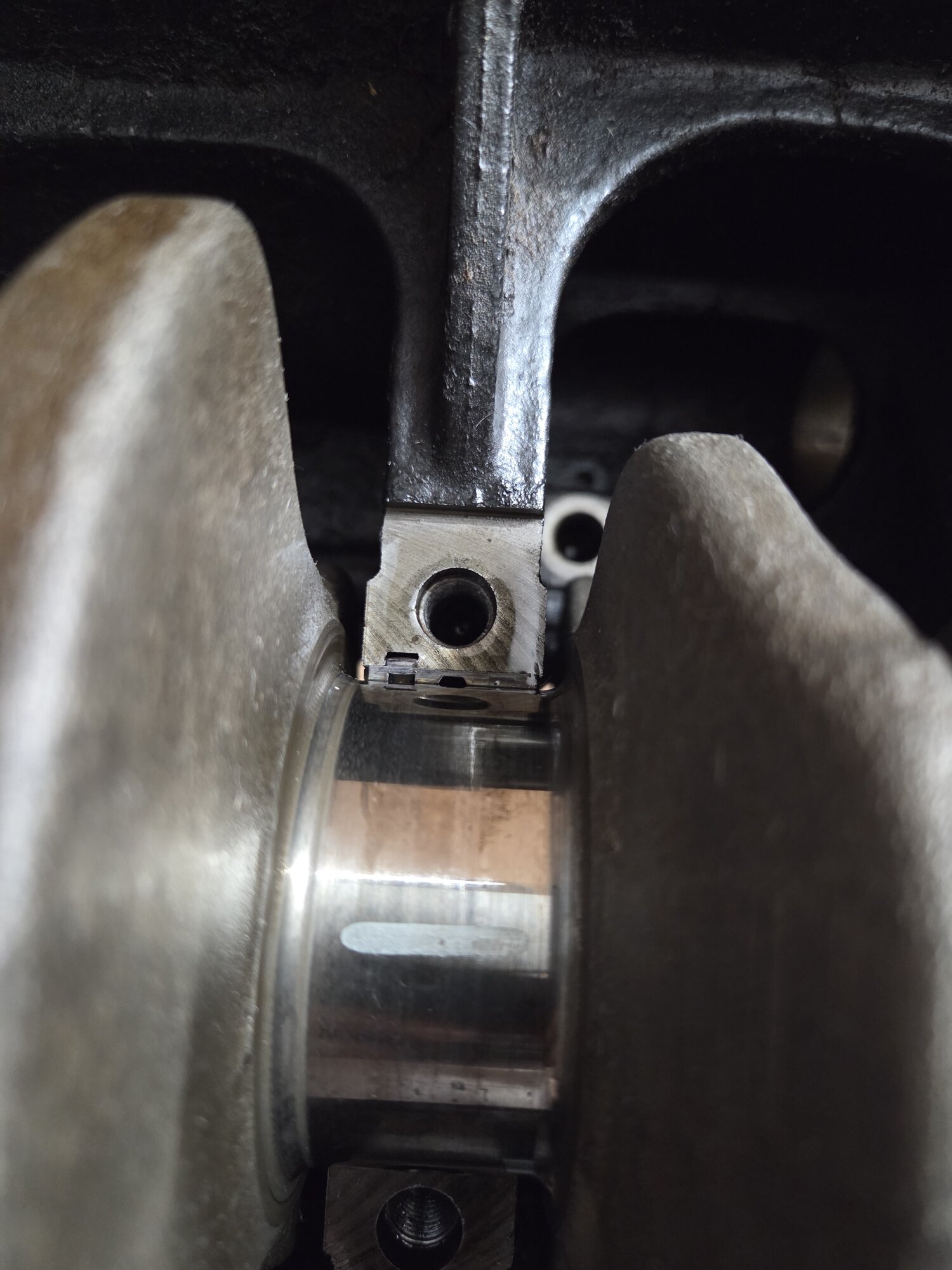

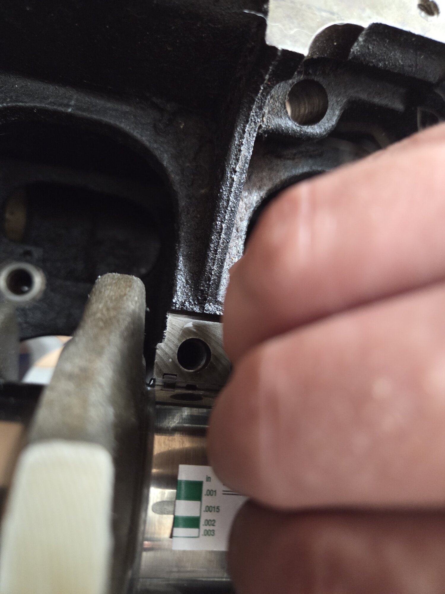

Block went through final clean out of machine shop. Fit up pistons to rods and took final plastigauge readings for mains and rods. 0.0020 across the board for both, with middle mains being a hair tighter around 0.0018ish using the eye squints and plastigauge ranges.
Everything is disassembled again and wrapped in plastic. Going to torch, tape, and paint block, get parts for assembly in order, and start on assembly!

And head pic.
Speaking of, make sure you check those valve guide crevices. I found some old valve seal material.

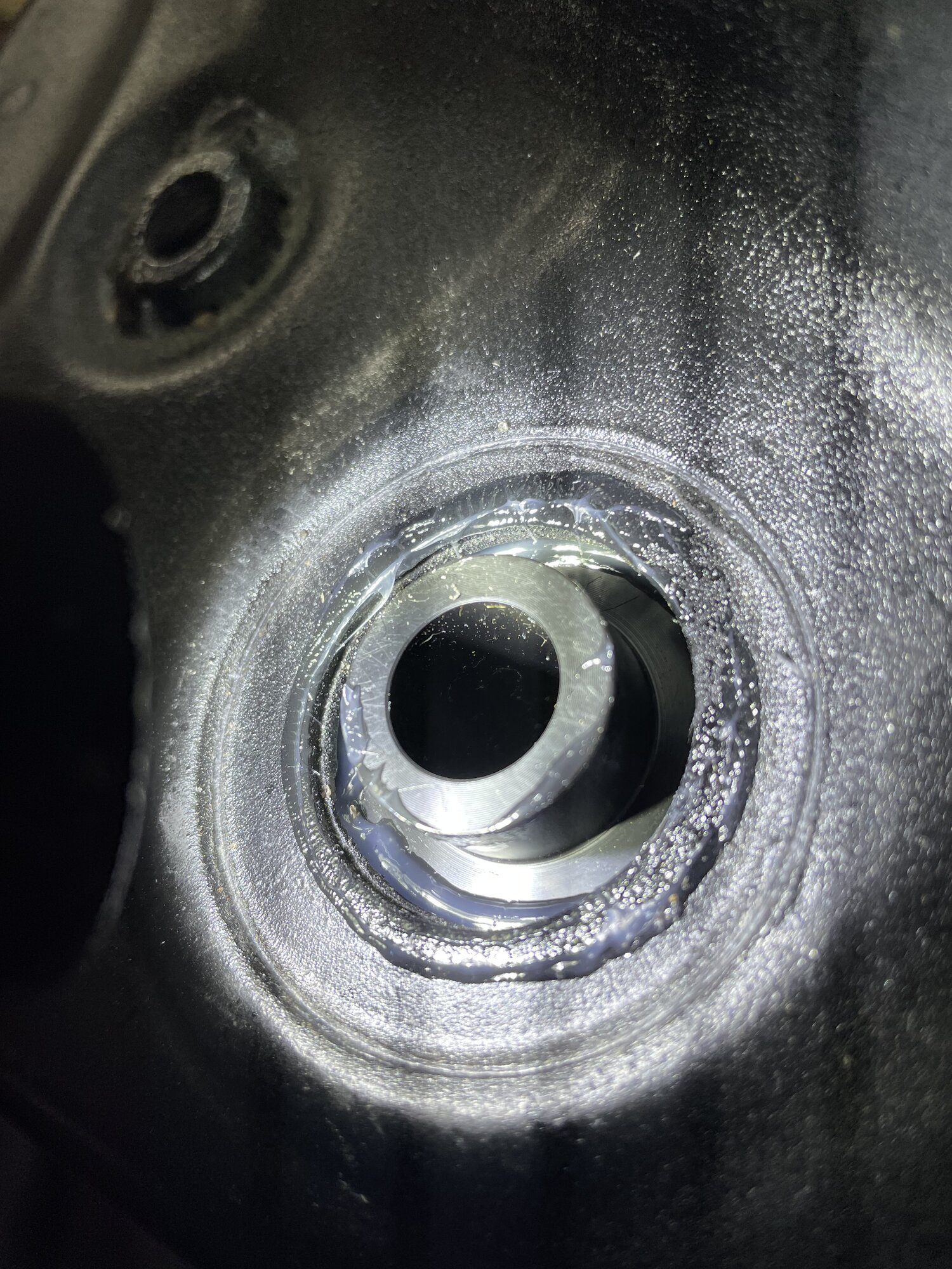

Freeze plugs installed, BS bearings installed. Ended up seeing some metal shavings from installation so going to clean up block 1 more time before starting final assembly.

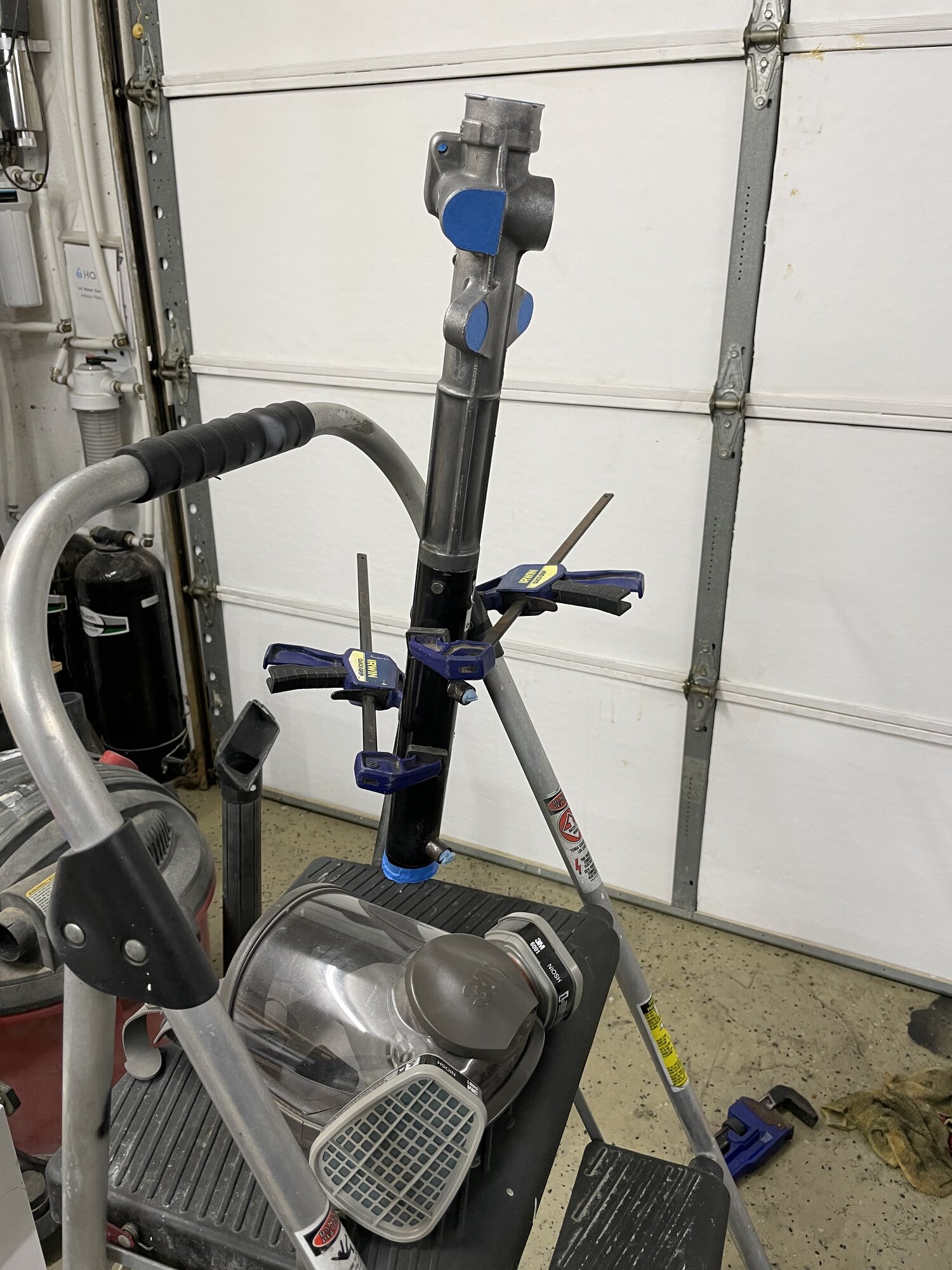

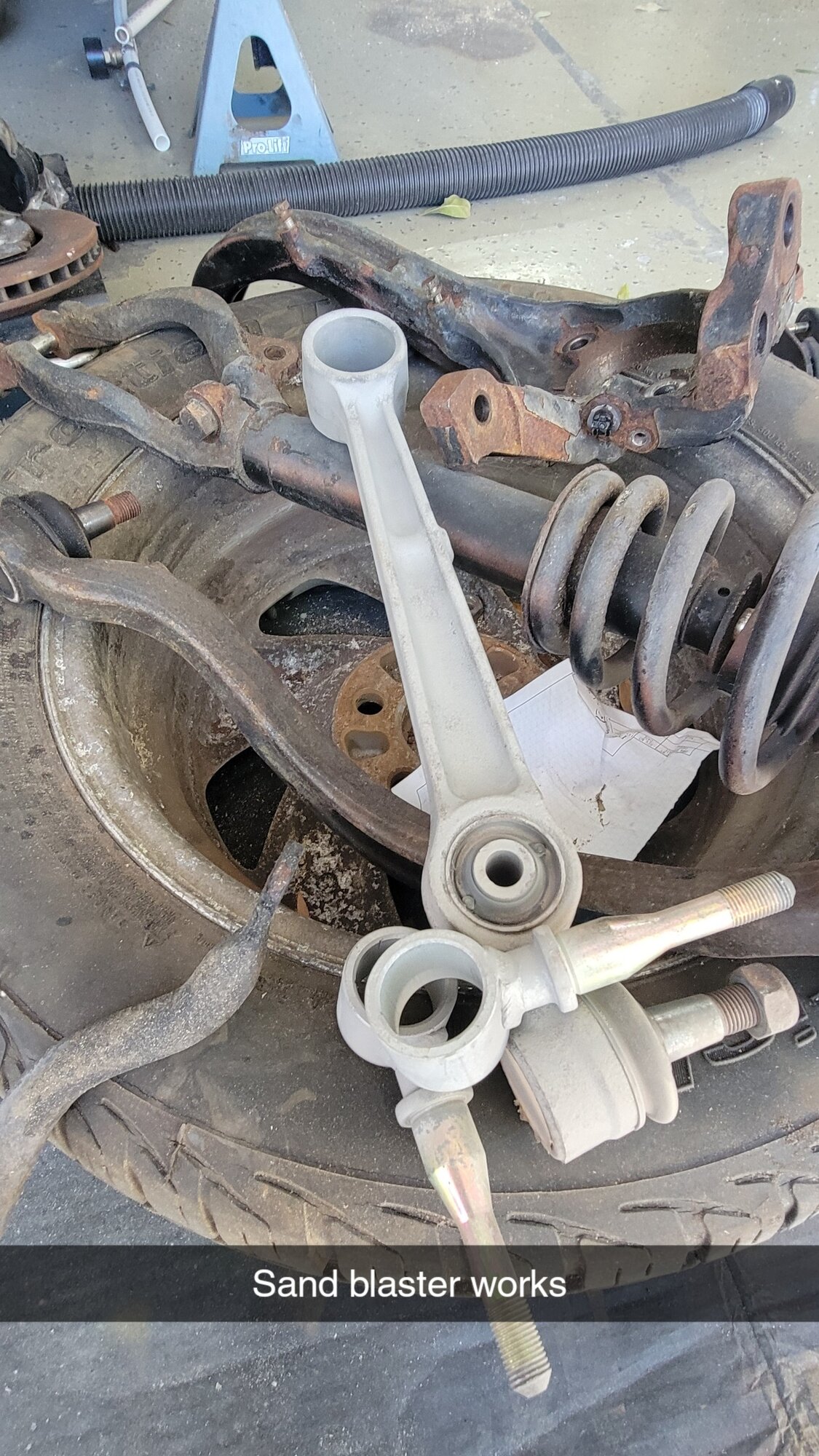

Last time I was sandblasting parts, it was in a homemade cabinet that is no longer with us. Replaced it w a harbor freight model and its getting the job done 10x faster.
Sandblasted a bunch of random motor stuff and started painting parts w KBS. Overall, very satisfied.
