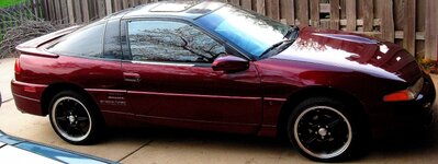

Just picked up a 92 Eagle AWD/Turbo
Mobile Wiring
33
Nov 2, 2005
Davenport, Iowa
Now i have had 6 DSMs all n/t FWDs only. Now i got a 92 AWD Turbo. All the other cars ran just fine. With this one i have a few probs.
Yes I am a newb to AWD Turbos, but i am very capable to work on this.
Here is the list of things wrong.
1- Idle revs up and down over and over.
2- Rear diff sounds funny ( Clunks at slow speed )
3- Clutch drops the gear at top and picks up the gear at bottom.
4- Speedo is slow by 20mph
All my other cars were A/T FWD so this one is new to me
I thought id ask b4 i just took it all apart. Any help would be great.
I also plan on doing all the upgrades i have found here.
I have read threw alot of post, but couldnt find just these things. I found that these cars have low idle issues, but not a rev issue.
Thanks again for your help guys.
