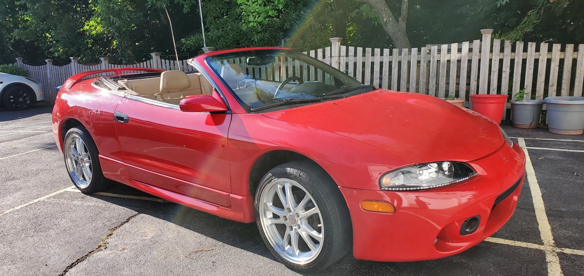

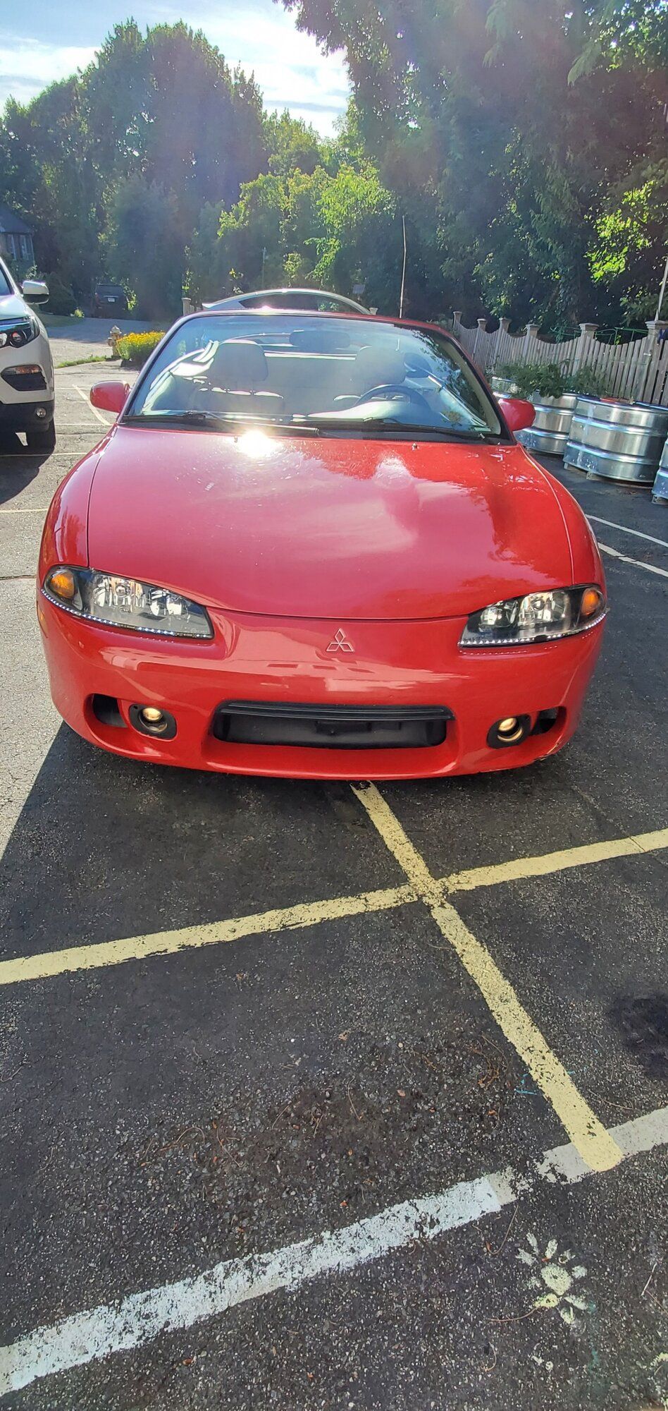

Starting very small. I polished the front headlights with a 3m polishing kit. Next, I replaced the stock halogens with Sylvania Silver halogens, high and low beams. Since I had to remove the air intact to install one of the bulbs, this was my first modification to a car.

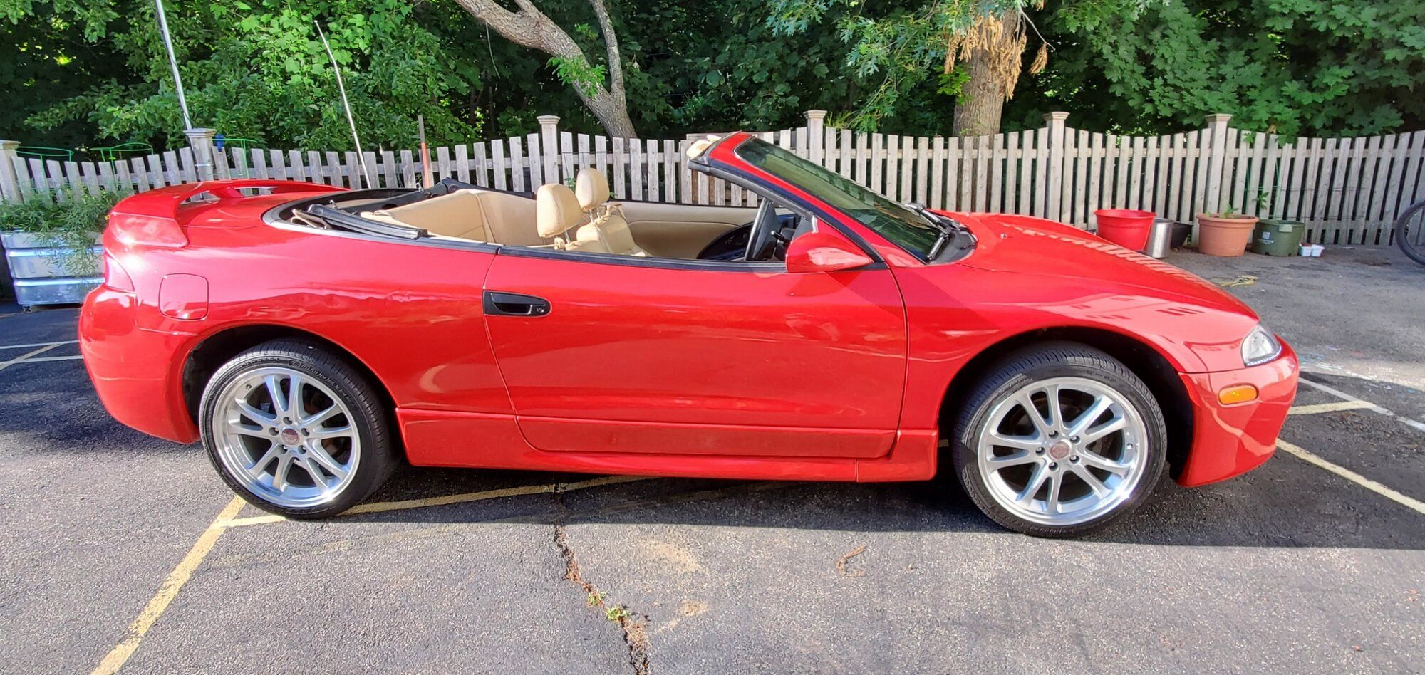

Nice looking car. Be sure to fill out the details of the car in your profile so we can better help you with questions. Has the timing belt ever been replaced? Even with low miles, a 23 year old belt is on borrowed time.

The leds under the headlights make your car look bedazzled, LOL. You can always turn your fog lamps into DRLs if you want to change.
