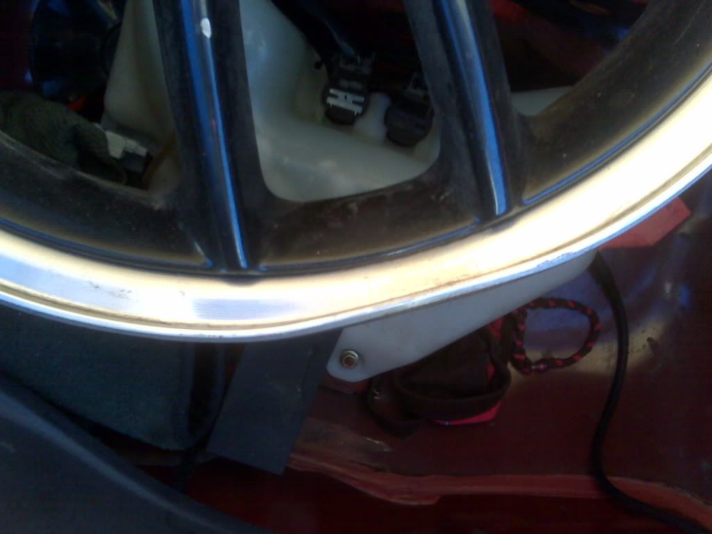

With the car running, I immediately wanted to clean it up a little bit and repaired the oem 17" rim (it was leaking when mated with a tire). I didn't want to have the bastard 16" rim (in pic) on there anymore. By repaired, I mean I took a hammer and 2x4 to it. This was the before pic:
I didn't get an after pic, but I couldn't pick that rim out from the other 3 now, it looks normal. Also, I got to work putting a new bumper on there, the PO rammed into shit frequently and with abandon. Thank God it looked like the only ramming they did looked like it was at the local walmart parking lot, and no serious damage. I also bought a grille set off of ebay from thegrilleguy to over the holes in the bumper, people on tuners love to hate this grille set, but I quite like the look and for now, its not inhibiting anything, I still get good airflow. New bumper:

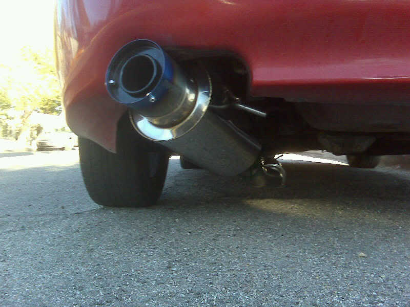

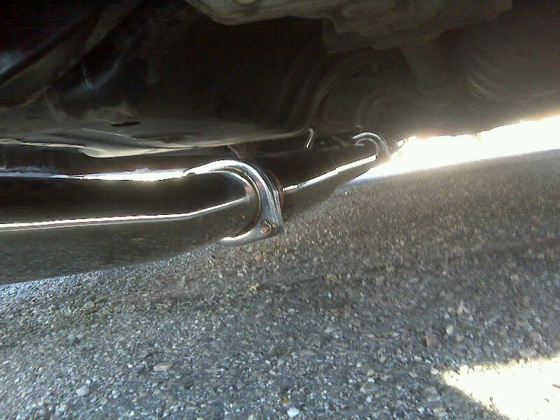

I still don't know whether they sent me the correct exhaust or not, I had to cut off the supports on the muffler and re-weld to get it to hang, and also cut and re-weld the flanges. It still hangs low, but there is enough clearance to go over speed bumps and whatnot. I have after pictures, I'll have to post them up later.

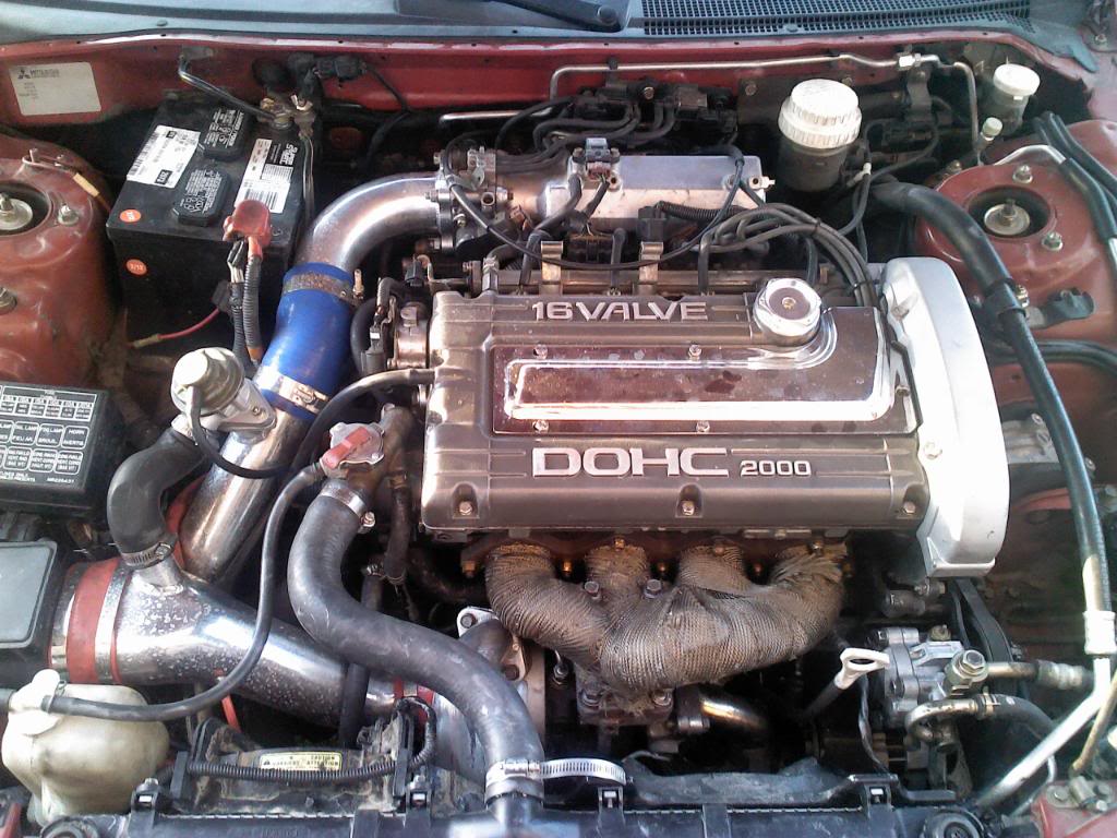

This build is about to go into high gear, I thought this would be a good opportunity to chart my progress, and if anyone enjoys it along the way, so be it. This is a rough outline I did on a whim, there will be more pictures and info as time goes on, I plan to document all the work I do. Stay tuned.
Almost forgot, more pics as it is today, all I have on my cell phone, don't take a million pics of my car.

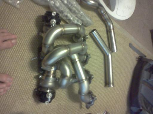

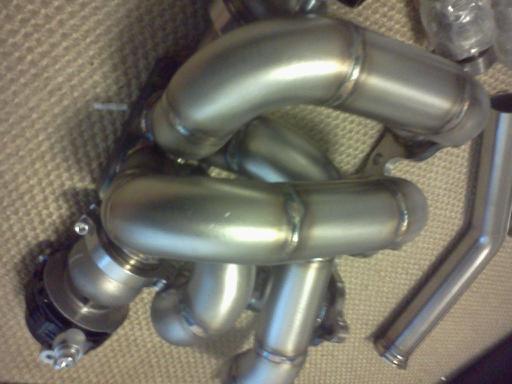

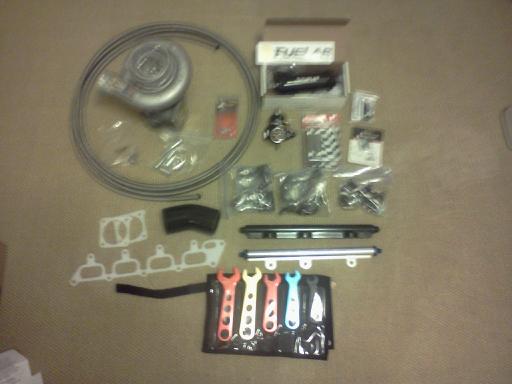

Got a snap of all the new parts I got in:
The turbo justin rebuilt for me, its a HX35 H1c w/12cm2 divided housing. Also All the parts mentioned on the list above have come in as well. I picked up a FIC fuel rail on trade, still not sure which one im going to use, most likely the magnus. I now have all the parts I need to completely redo my fuel system from tank to FPR in -8an SS. Also picked up some P2P Phenolic heat gaskets for the intake manifold and 2 for the 1G TB I have, ive heard good things about the heat reduction. School has ramped up quite a bit so im not sure when all of this is going to happen, thought id update with a shitty picture, excuse my terrible cameraphone, but its all i have :coy:
Also, my AC compresser clutch has shit the bed, so im going to take off the entire IM while im switching out the fuel rail and such to be able to replace it. Too hot here to get rid of the AC. Bleh.
Nice setup, good call going twin scroll. Super responsive. How much was your manifold or is it in the works?
Manifold is in the works. The entire setup is being made by tim from punishment, its costing 1350$ for the manifold, 2 dumptubes, and custom 3" o2 housing. I'm sending in my hotside so he can fabricate it to fit this week or next hopefully. It's flanged for 2 tial mvs gates, those i picked up on the cheap brand new for 385 combined. Had to lurk the classifieds for awhile to get a good deal. Just working on putting together the stainless lines for my wastegates and fuel system right now. I ordered the wrong service kit for my injectors, im waiting on the new seals so I can throw in the fuel system finally.

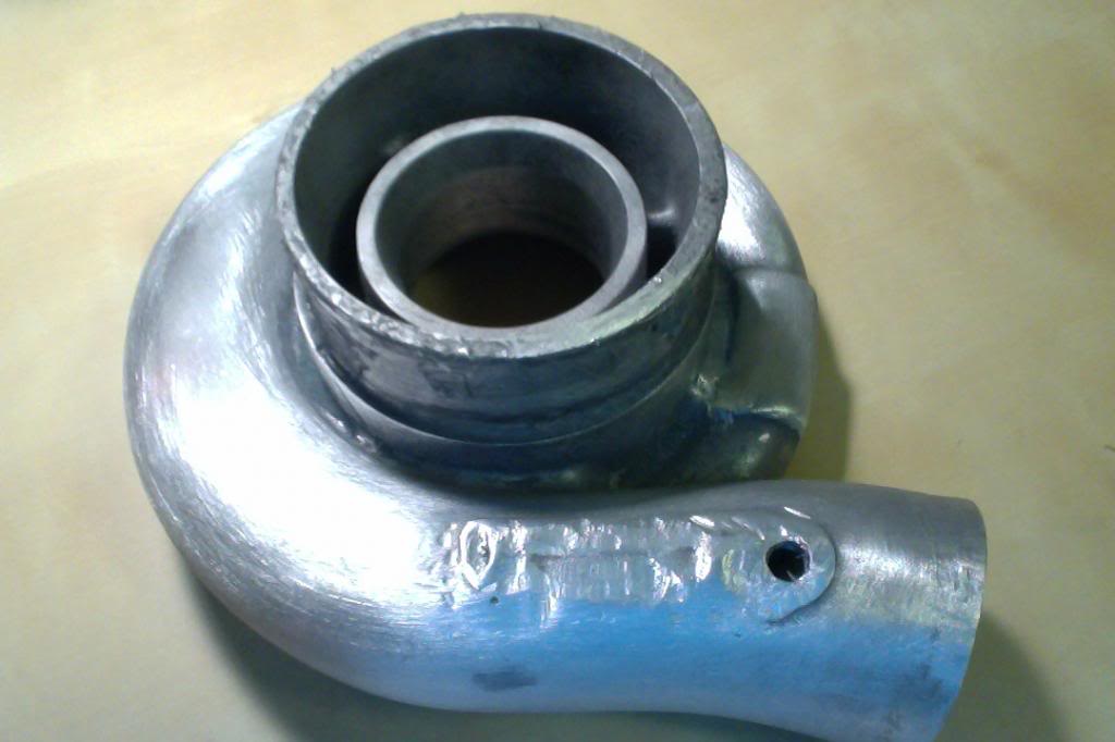

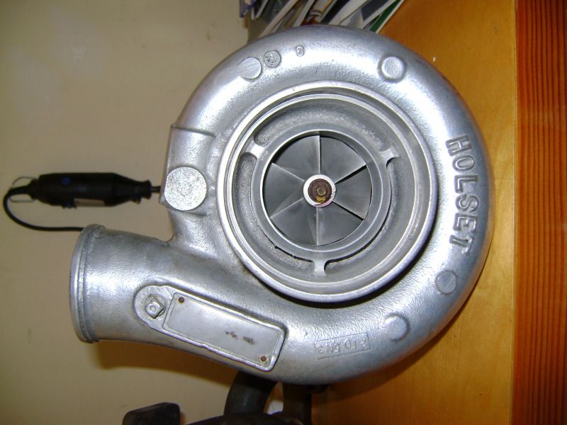

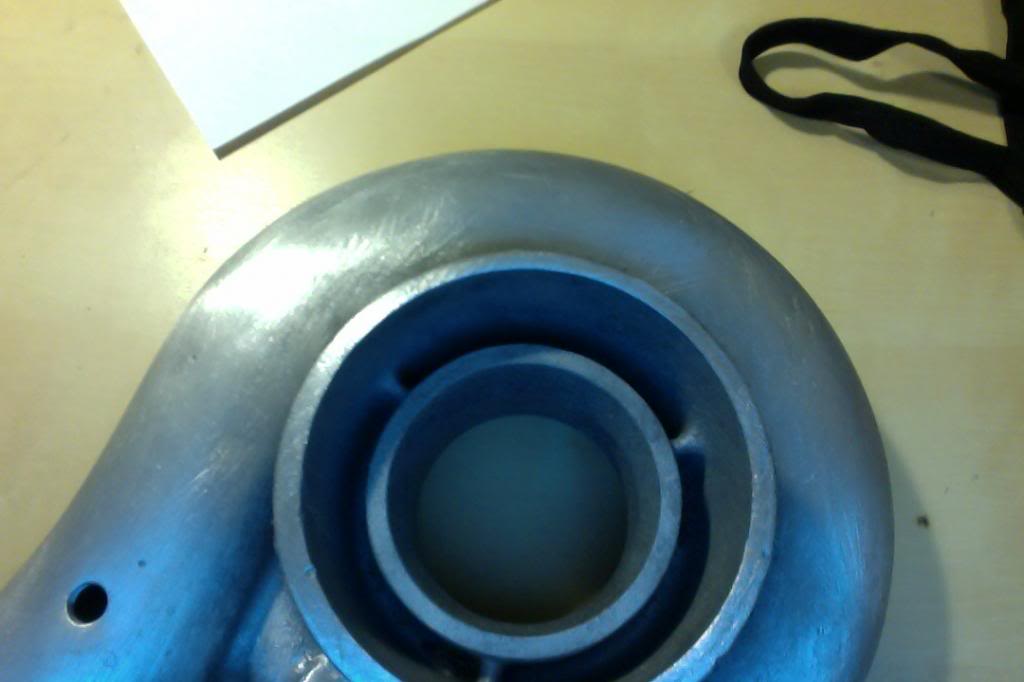

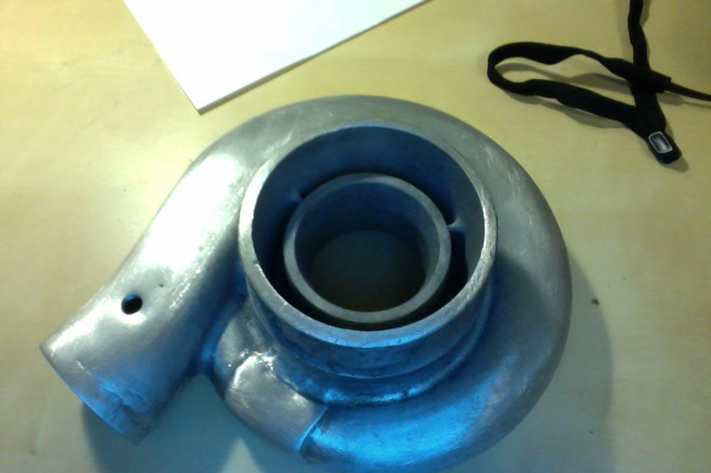

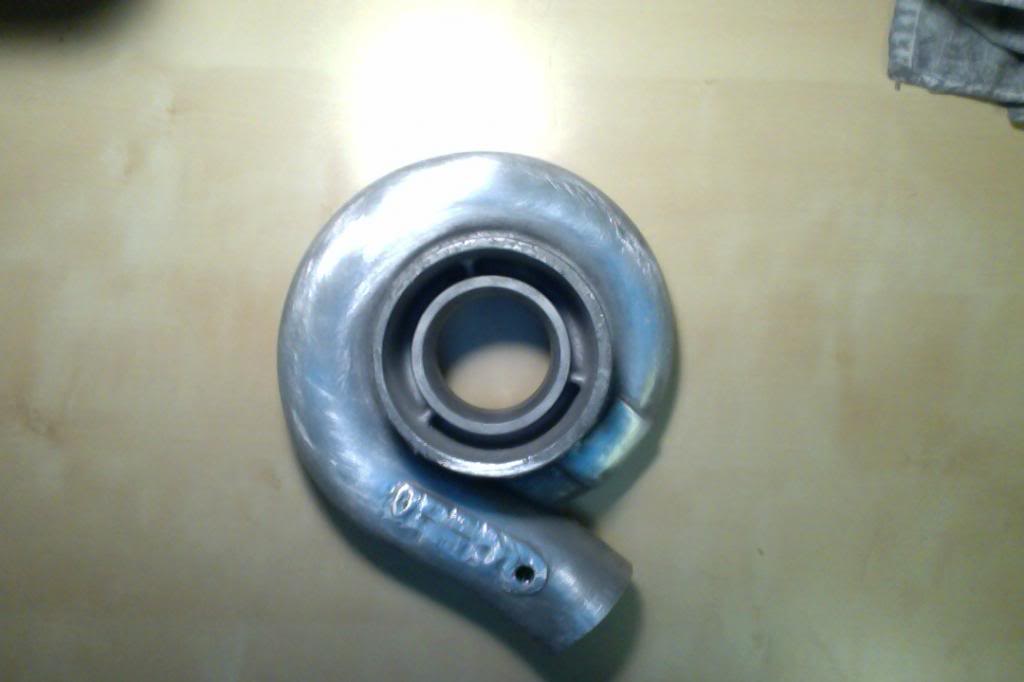

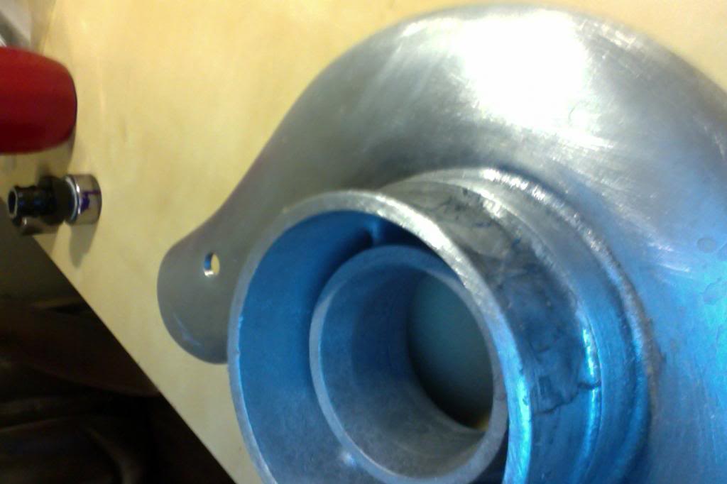

In progress polishing of holset compressor housing:
Stock:
Shaving in progress, sanding down casting smooth:

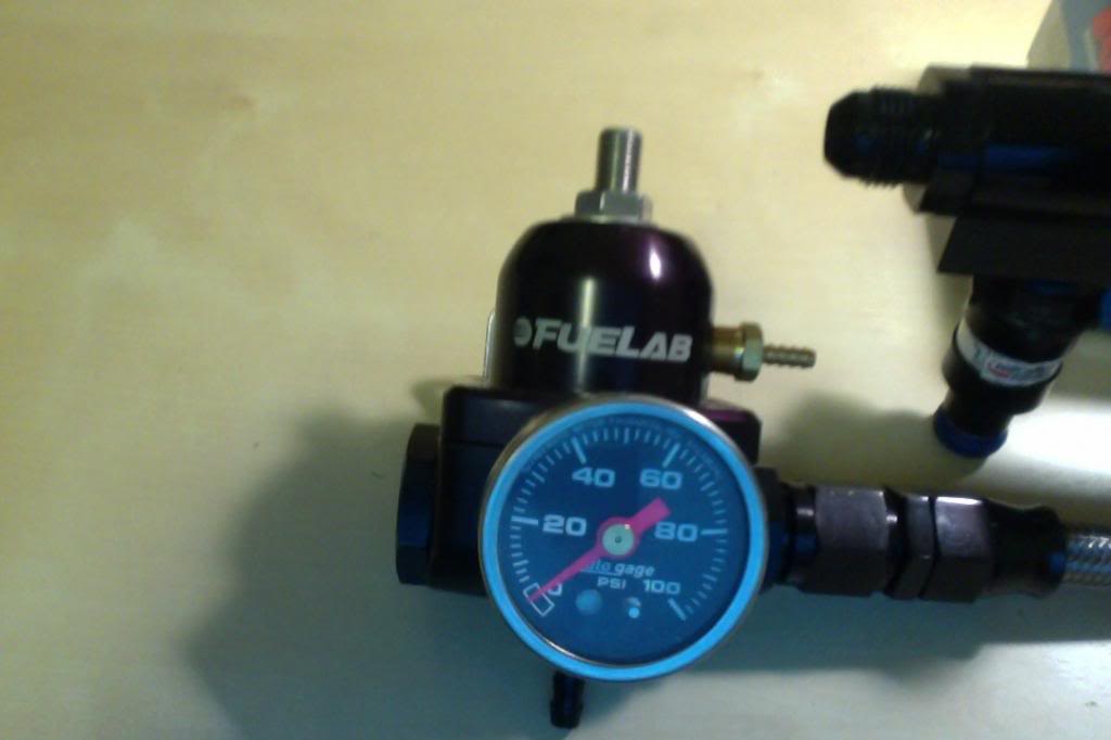

Fuelab FPR w/Autometer pressure gauge:

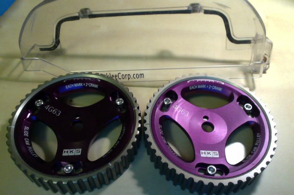

HKS Adjustable Camgears w/Zaklee clear cam cover

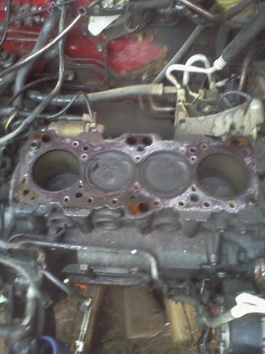

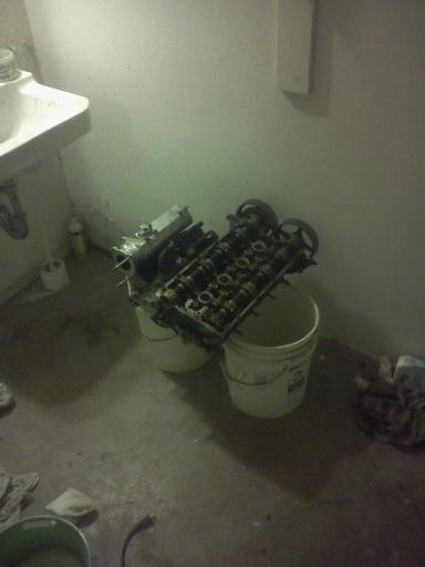

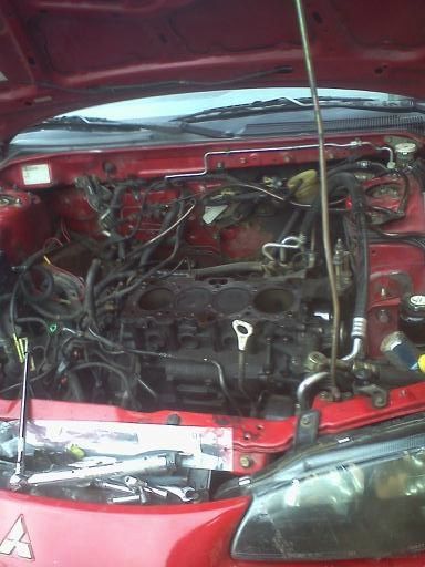

Pics from the other day, first time the head has been seperated from the block since it rolled off the production line:
Everything pulled basically except for shortblock, trans, alternator, and ac compressor:
Cylinder money shot, everything looks good for an all stock setup with north of 100k.
My workbench LOL, cylinder head before all components removed:
Nice bench! That thing is classy ;)
How goes the tear down?
Going great, the head dissasembly was so simple. The biggest pain in the ass was seperating the camgears from the bolts, I probably should have loosed them before I removed the head. After that was done, it only took me 30 mins to completely remove the cam retainers, cams, rockers, springs, lifters, & valves. Happy about that. On the head, many of the coolant holes were plugged with goo. Previous owner looked to have run tap water as well, good amount of orange everywhere. Water pump was rusted to shit. Head is going out to the machine shop. I am also rebuilding a 1g throttle body, I couldnt get out the bolts that hold on the fiav for shit, I heated em up, but only ended up starting to strip the philips threads. I got annoyed with spending too much time on it, and just grabbed a drill and knocked the heads off and vicegripped the shafts out of there. Need new hardware now :|

continuing to finish polish job on compressor housing.

I spend an INCREDIBLE amount of time on minutiae. All this sanding, polishing, cleaning, painting of parts takes an incredible amount of time, since i am dissasembling every part. I wish I wasn't so anal. Sometimes I wonder why the hell im spending all the time I am on details like that. Till next time.

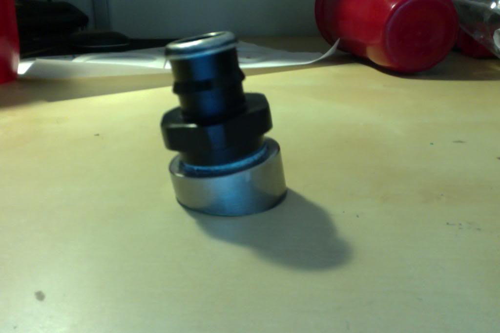

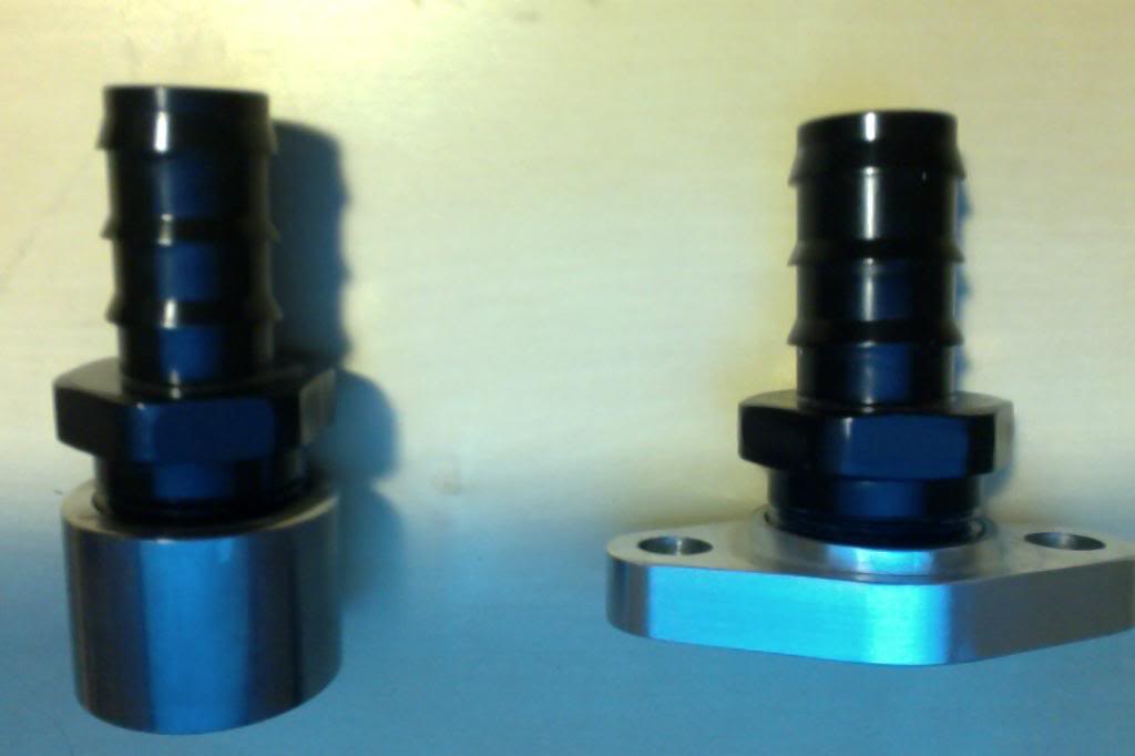

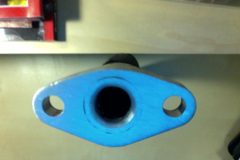

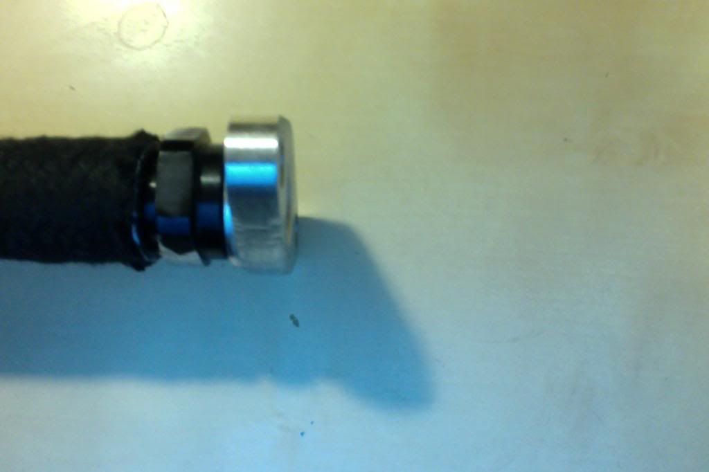

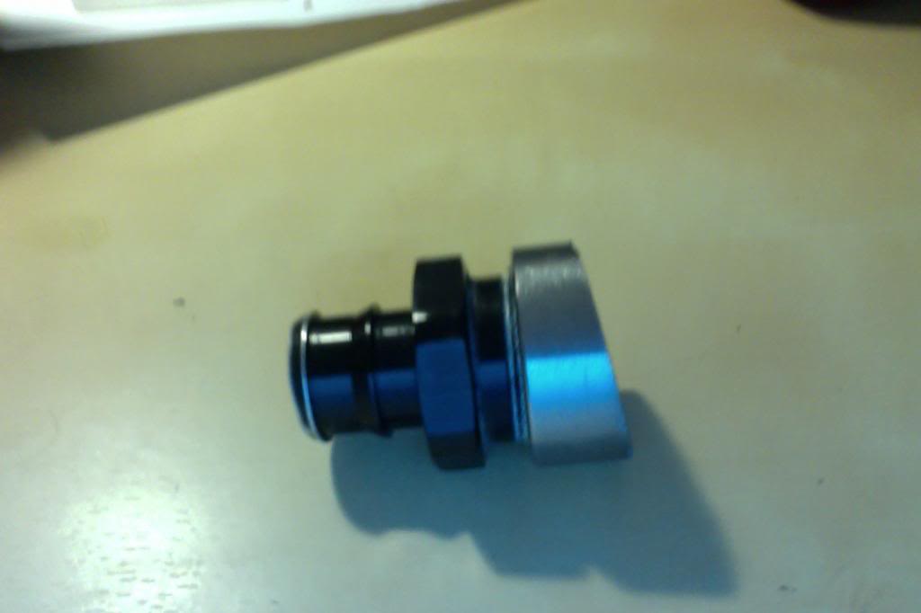

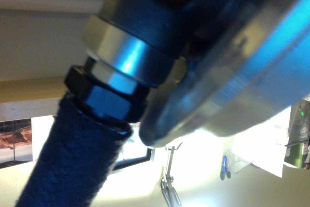

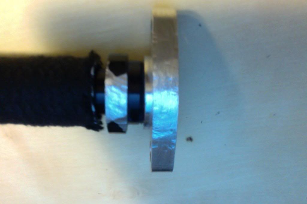

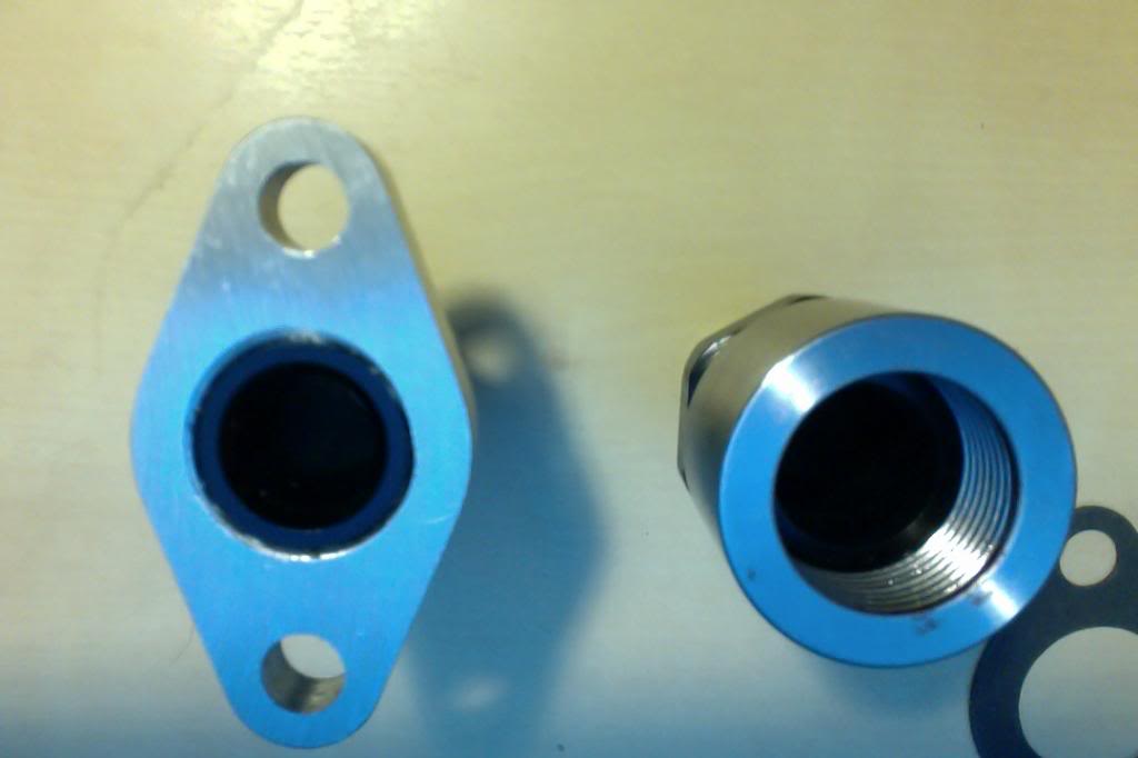

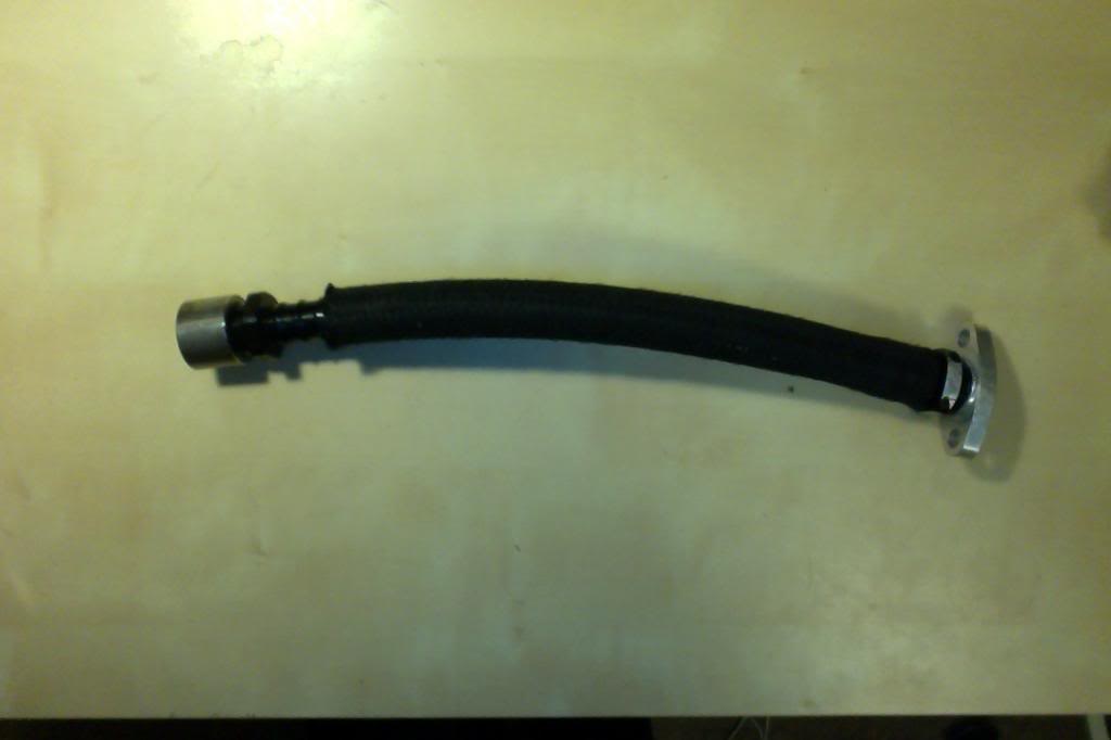

Thought i'd post up pictures of my custom -12an holset oil return drain. I had to make a few modifications because the H1C has the vband compressor cover which gets directly in the way of the outlet. I got it to fit however. Picture of the line in its entirety:
Flanges and fittings I used, before grinding:
Went to work with the grinder on the flange and fitting to clearance it enough to fit on the holset CHRA:
Bottom of flange, there was some overlap when fitting was screwed in all the way, ground that down and ported all around the inlet so that the oil flows unrestricted from the odd shaped H1C oil return port:
Finally, fittment of the oil return on the CHRA, with vband on literally clears the compressor cover by mere millimeters, even without the vband on you can see how tight it is:
Voila, a -12an return done the right way with fittings. I could have jerry-rigged it with hoseclamps, but i wanted something that looked slick and was rock solid.
Next update back ill take more pictures of the compressor housing, the polishing is really coming along, it is almost done! I'll never shave and polish another holset cover again, thats for damn sure, I have over 10 hours into the one I have and I want out! Stay tuned.

This thing has been a labor of love, too much sanding as it is! Got some new wire wheels to attack the casting marks in the crevice around the inlet, hopefully they work good and i can begin the finish sanding process.
