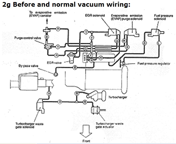

9.5 psi sounds like the LOW BOOST, which the ECU goes to when you have severe knock issues. Are you sure the previous owner hasn't bypassed the Waste Gate Solenoid? Normally, the ECU energizes the BCS, which bleeds off 4-5 psi, and allows the wastegate to stay closed until 13-14 psi. If you aren't running good premium fuel, and the ECU hears too much knock, it turns off the BCS solenoid, which makes the wastegate see the full boost pressure, and it opens at <10psi.
You should compare your vacuum line routing, to make sure the BCS is still in the system to bleed off some boost.
http://www.dsmchips.com/2Gvacuum.jpg
If you have installed a manual boost controller, the BCS is optional, and most guys bypass it. You need to leave it plugged into the harness to avoid an MIL though.
