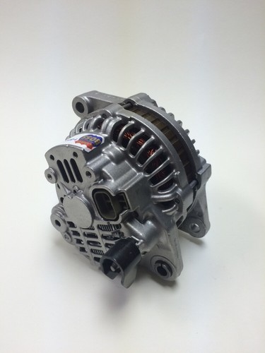

To the OP, keep in mind that Optima red tops are just starting batteries so they don’t have any deep cycle characteristics. With any significant electrical demand additions, a yellow top (or equivalent), is recommended. As others have pointed out a high amp alternator is also advisable. I run this 150A, that pops up on eBay from time to time, on my eclipse:
