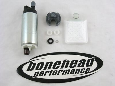

i bought them a 255 walboro and.....

You didnt mention adding an afpr when installing the 255. Did it already have one? Possibly/inevitably overrunning the stock fpr. Does the car have a wideband you can look at? Smell raw fuel? Might be a current problem or become one soon.
The PO installed it, the set that i bought shouldve had it ill post the link to it

A fuel pump kit does not Include a pressure regulator.
