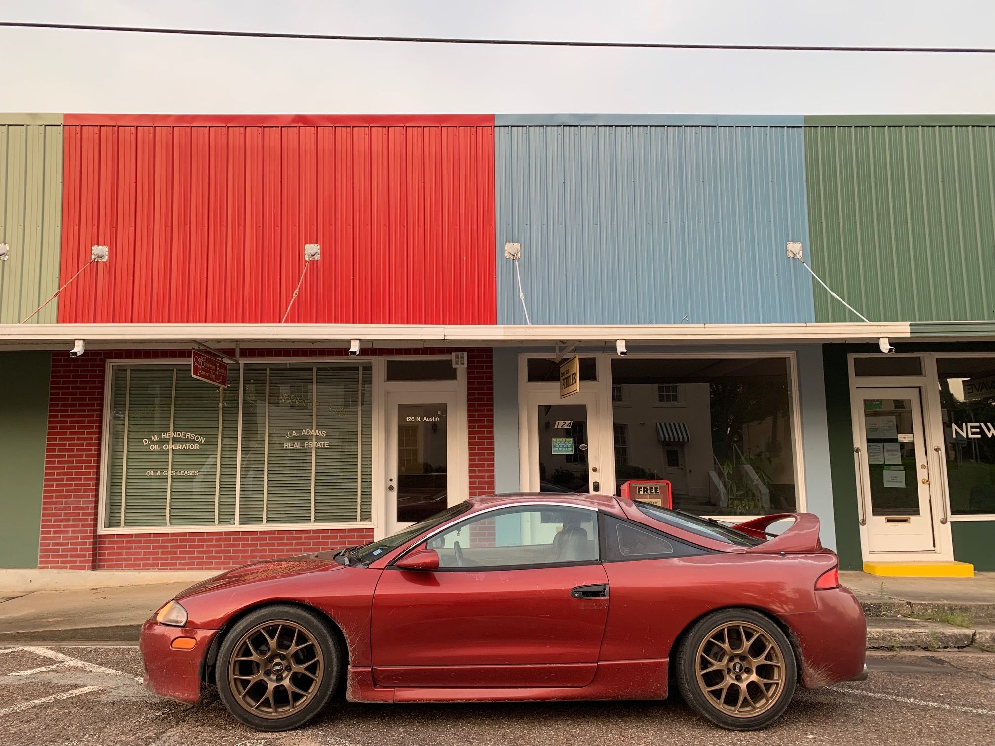

Hawthorne : '97 GS-T
Car will not break records or turn heads. Just everyday fun car to drive.
Got this car last Wednesday (5/8/2019) with most of the parts on the car. Funny enough I actually purchased the Evo wheels and then sold them to the owner I bought the car from.
This car will remain tame and 100% streetable. I do have a second car to daily if need be, but not as fun to drive as this chassis.
