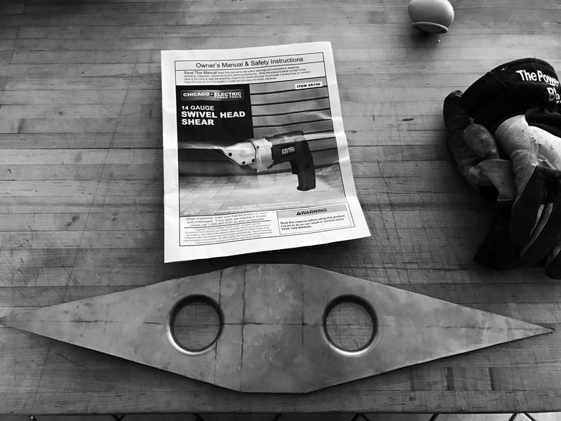

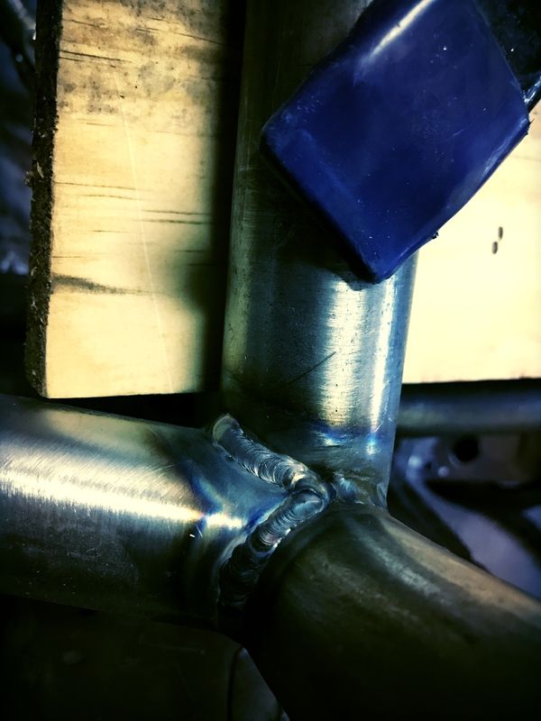

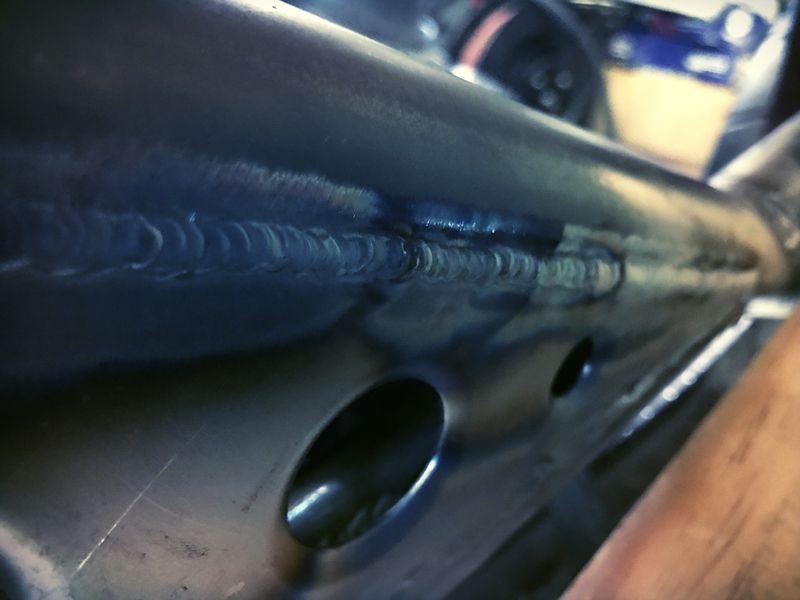

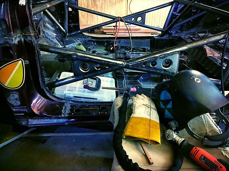

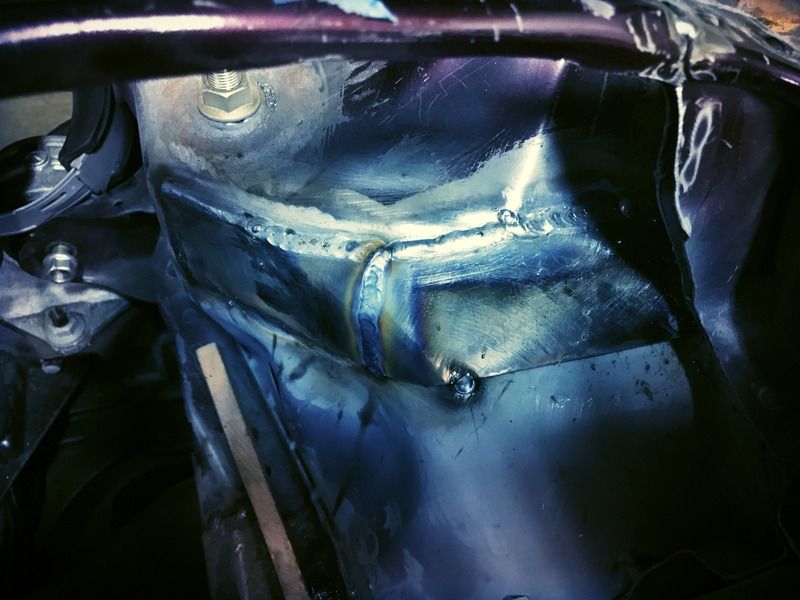

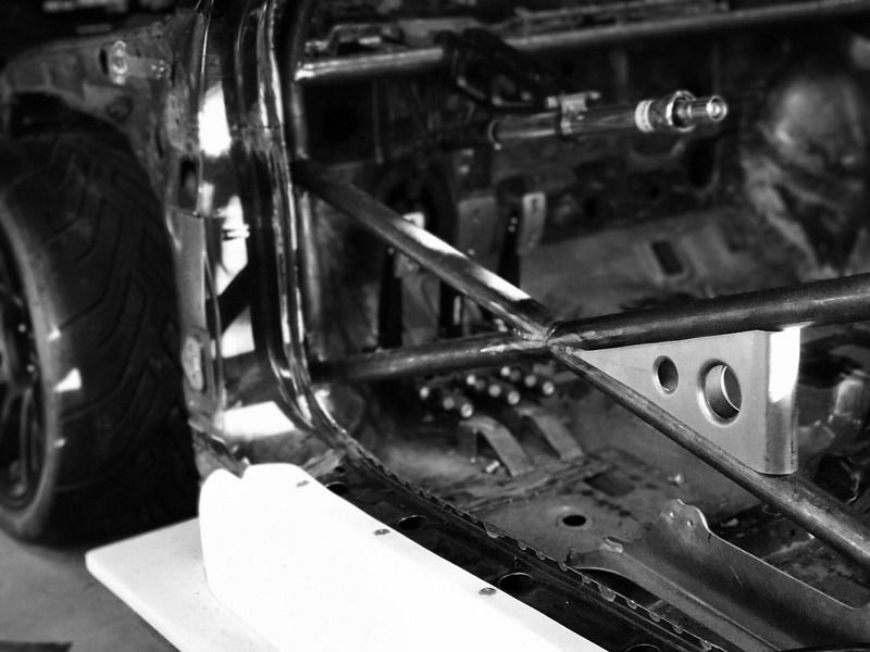

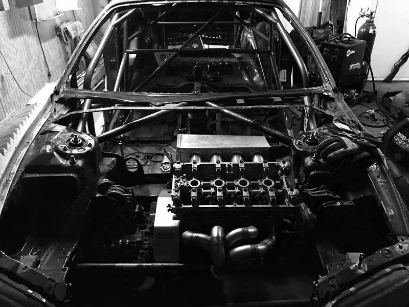

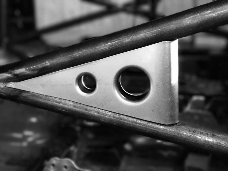

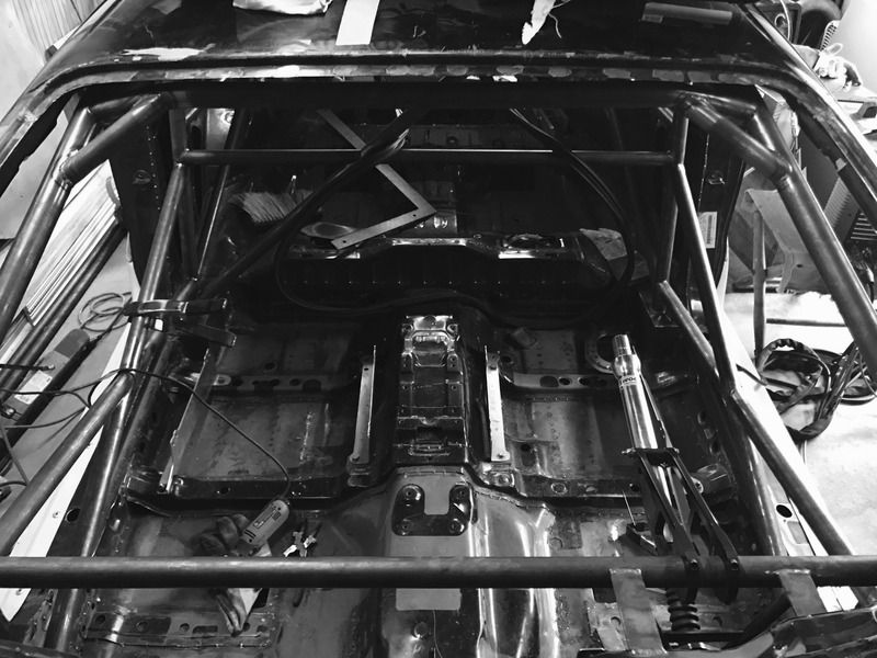

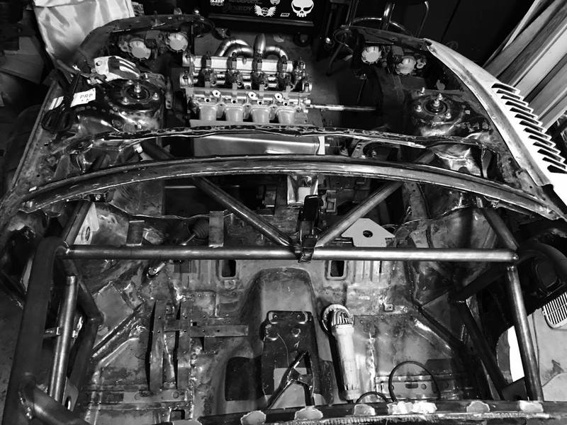

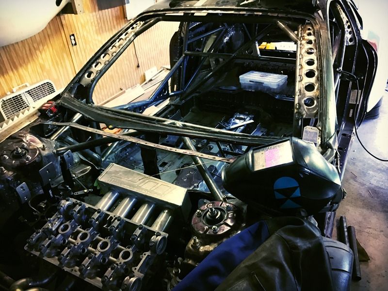

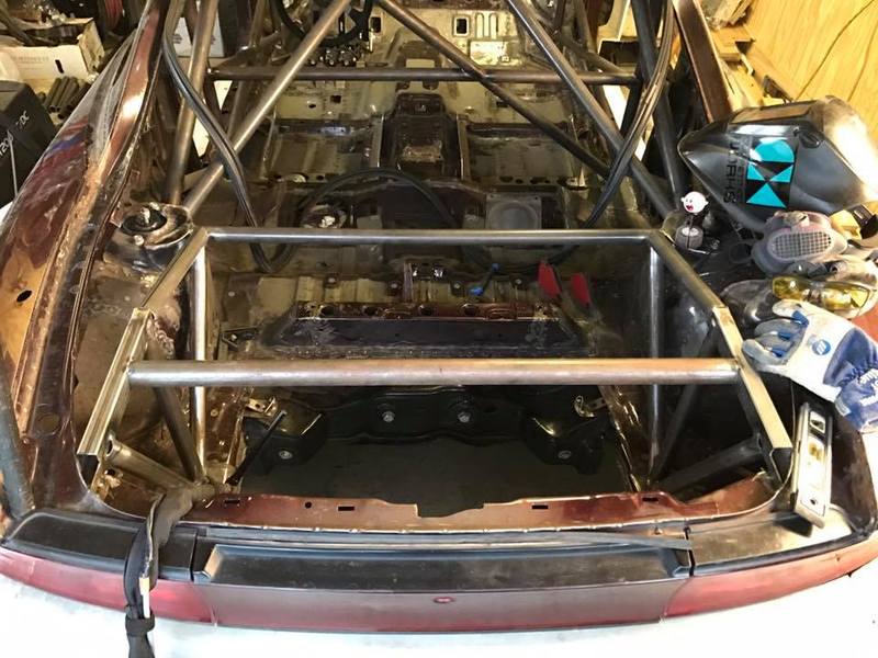

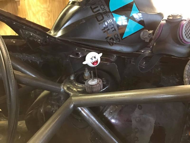

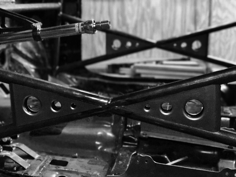

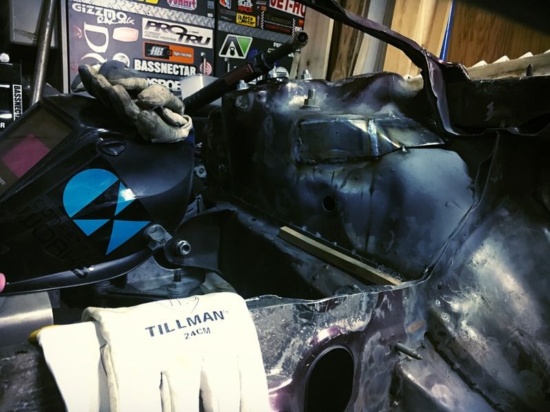

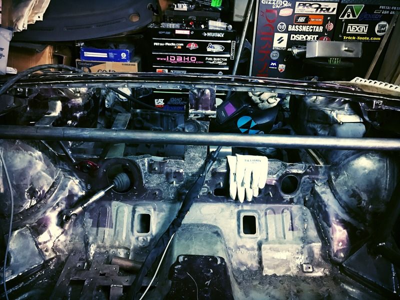

A little TIG and a little MIG. Measure, cut, shape, bend , melt and repeat. Fire wall removed in a few areas so the cage and be integrated into the strut tower area. There is still one more plate to be added to the area but it's close. Then on to the other side before tubes are cut. I'll be happy when I'm done with this cage.
Wow, What a build, I give you serious props for being so detailed oriented. Keep up the good work!
Im coming across old threads mentioning inner fender clearance is there a problem on the frame or just outer skins?
I'm don't completely understand your question? Could you add some more details so I know better what your talking about? Or add a link to the thread posts?
