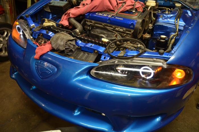

Finally, I slipped on my custom intake manifold and started the process of fabbing up the intercooler pipes. The OLOA VR4 is going to use a GM MAF with ECMlink, a Tial BOV, and big Spearco 2-216 core FMIC with the classic short route piping. The pipes should be pretty easy to build.
