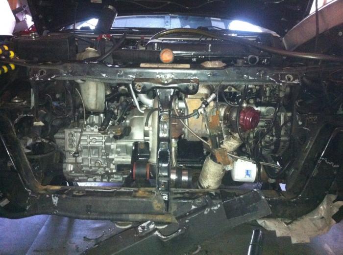

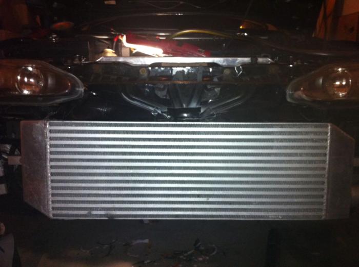

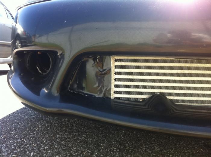

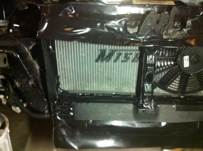

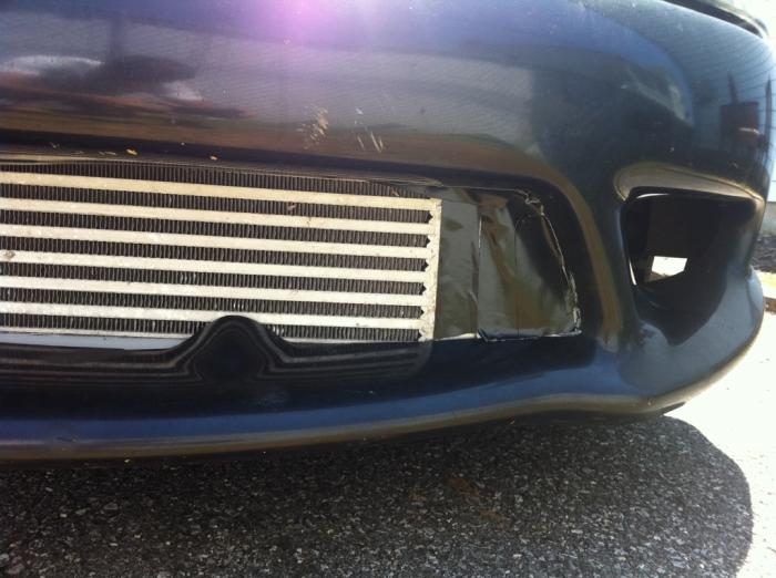

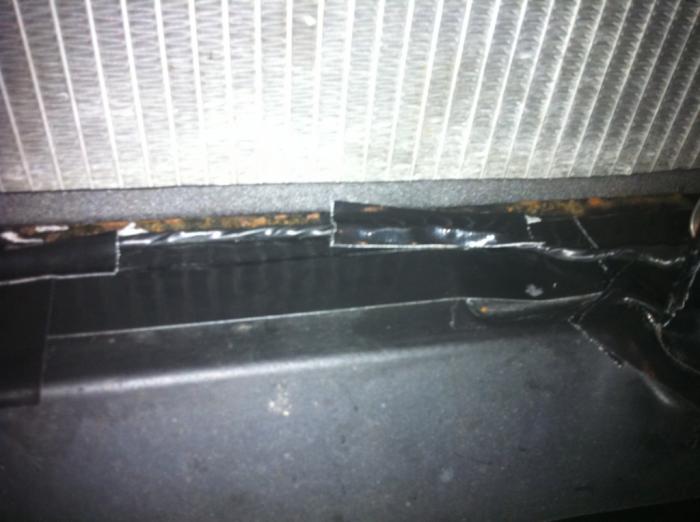

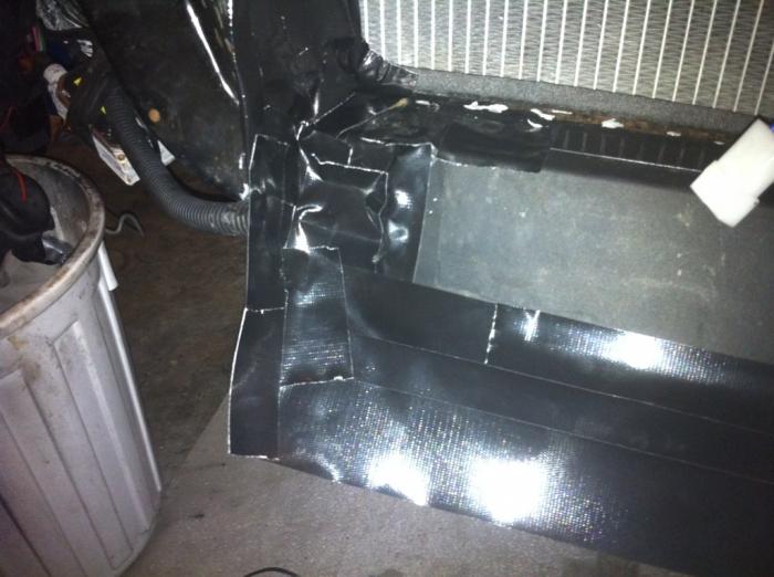

Last night I finished mocking up the upper intercooler pipe and I did a temp install of the L1R turbo. Steve pulled out the VPC and harness in anticipation of the ECMlink that we are going to use for tuning. We have a work day scheduled for Saturday and we are hoping to get the exhaust built, IC pipes finished, and the car running by the end of the weekend. We should be streaming live too so if you want to tune and watch you can.
