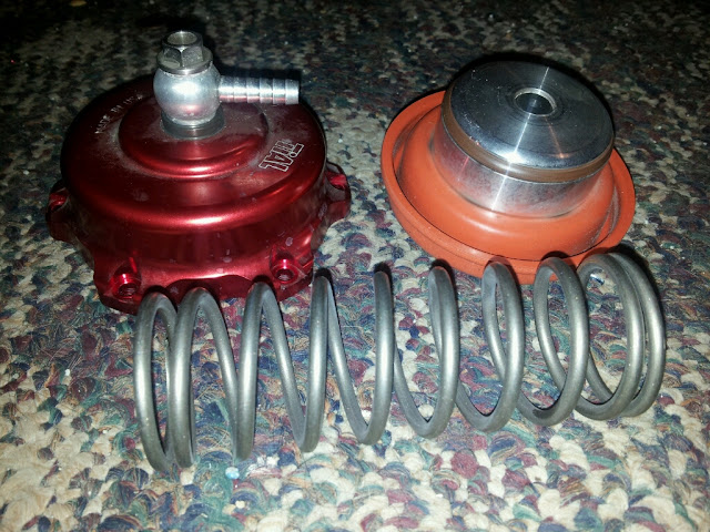

And I have removed my bov and am going to clean it, I have a stiff spring in there, from my experience ive used 9lbs and from what I vaguely remember, wasnt no where near as stiff as this current one. Can you tell feom the picture roughly what the sprig is rated for?

Didn't see the question about your Tial BOV answered, but I know that the spring you run in your Tial Bov depends on the amount of vaccum you run at idle, so check here to make sure you're running the right colored spring, good luck:
http://www.tialmedia.com/documents/BOVspc.png
Ah thanks, I believe I have a plain colored spring in mine. I however took it apart and oil up everything, cleaned it and it works properly now, somewhat. anything under 3500 rpm it makes the psh-psh-psh-psh noise while anything over I get the sexiest sound a car could ever make, just pure bliss. Lol
