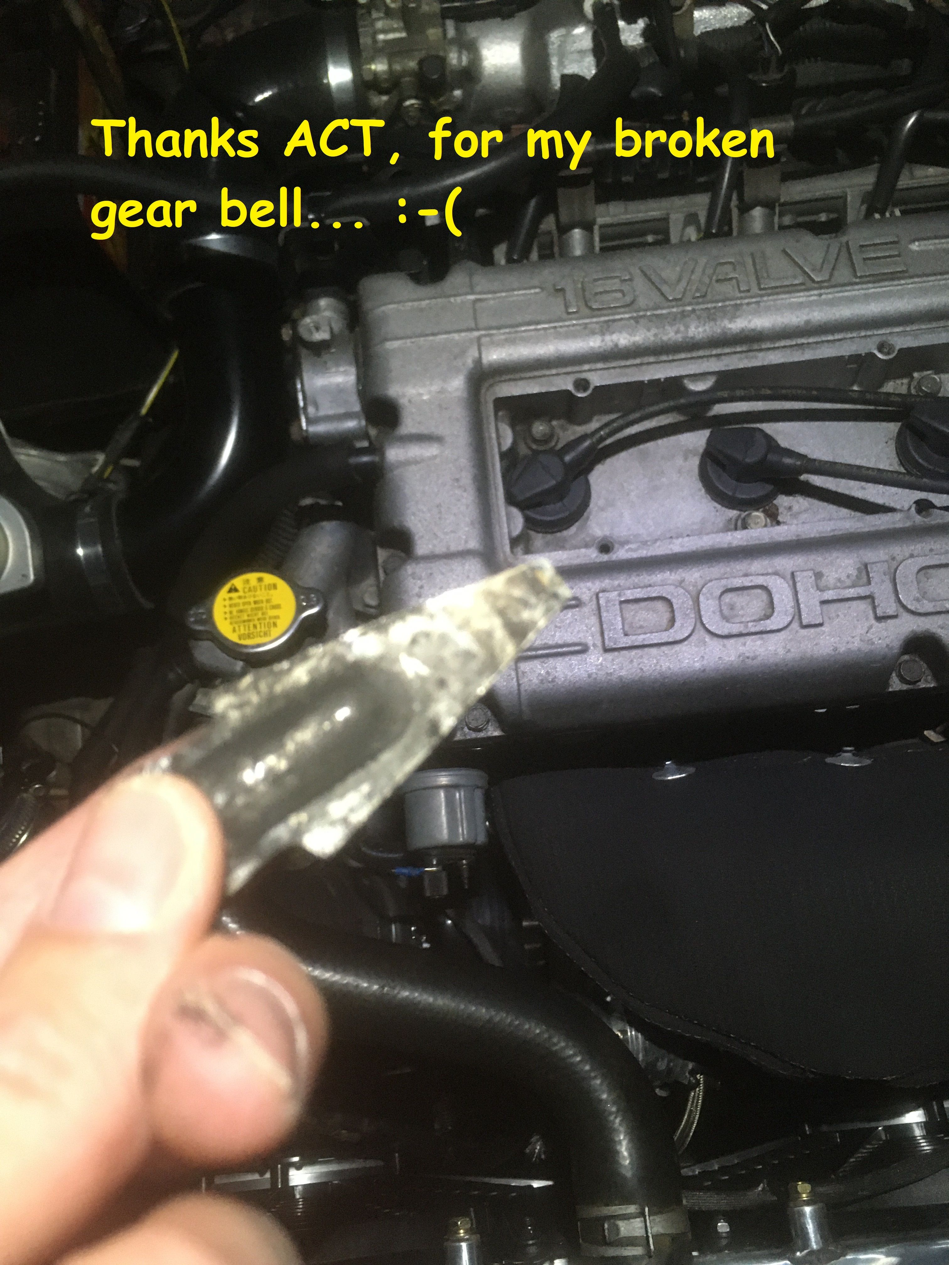

after my clutch and tranny damage on my ACT. I bought an used Evo3 Tranny with front LSD. I built in this my dsm front diff and ctr diff. I think the special ratio from the fifth 7500upm@188mph is great for german autobahn/highway. i have now an competition clutch twin disc, the first 80miles were great. All syncros, keys, springs, seals on the tranny are now new. it shift so smoothly.

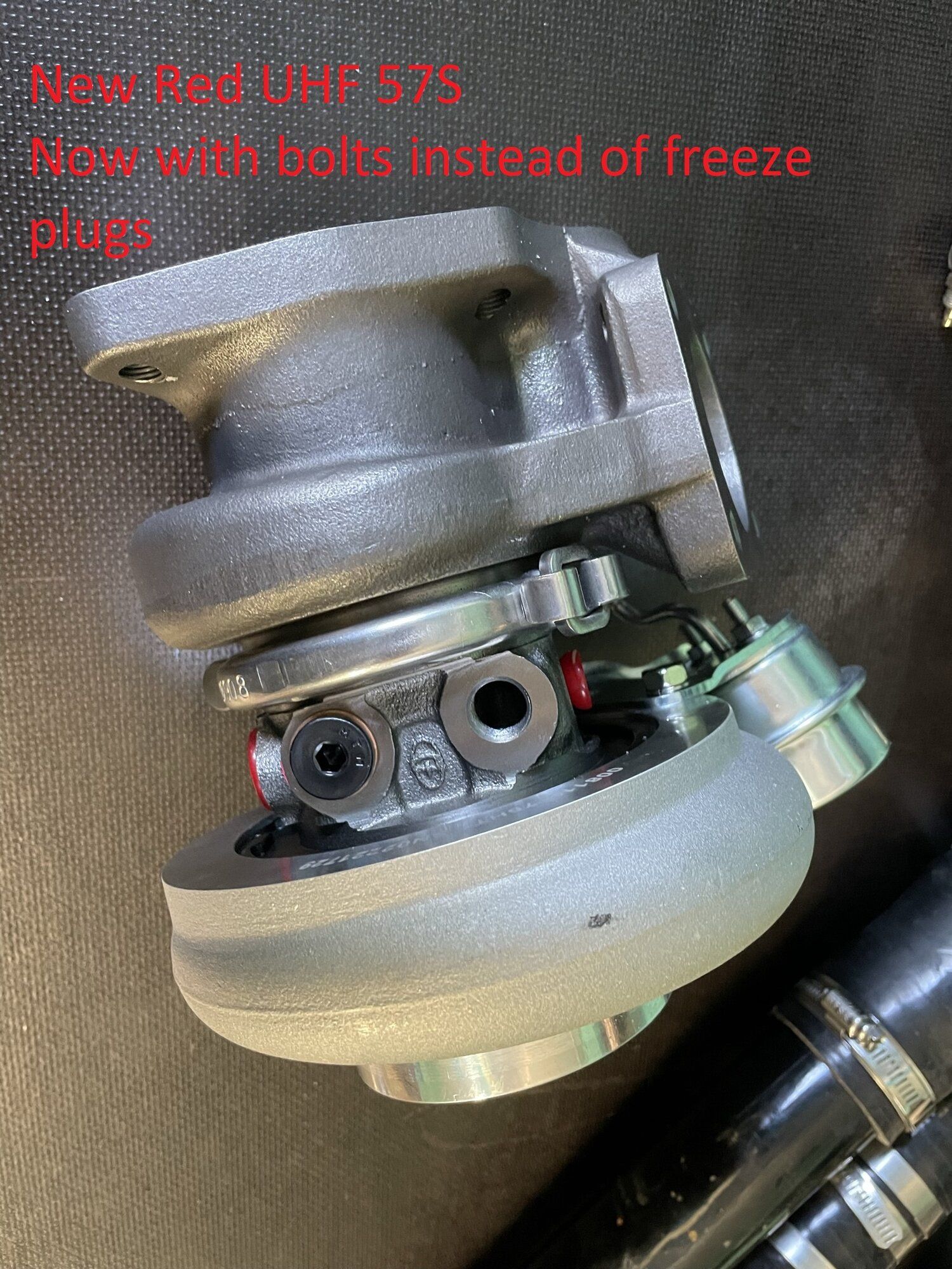

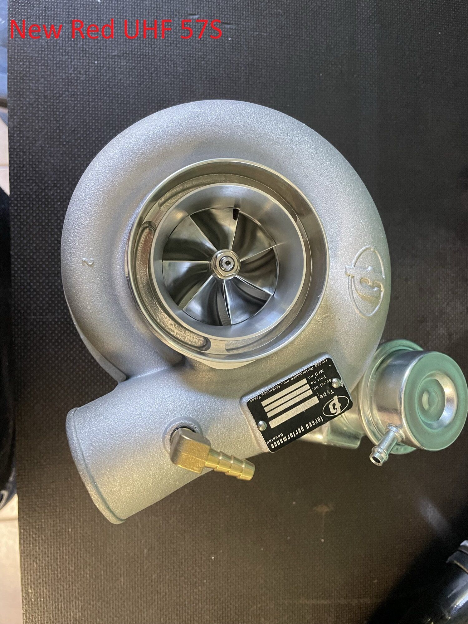

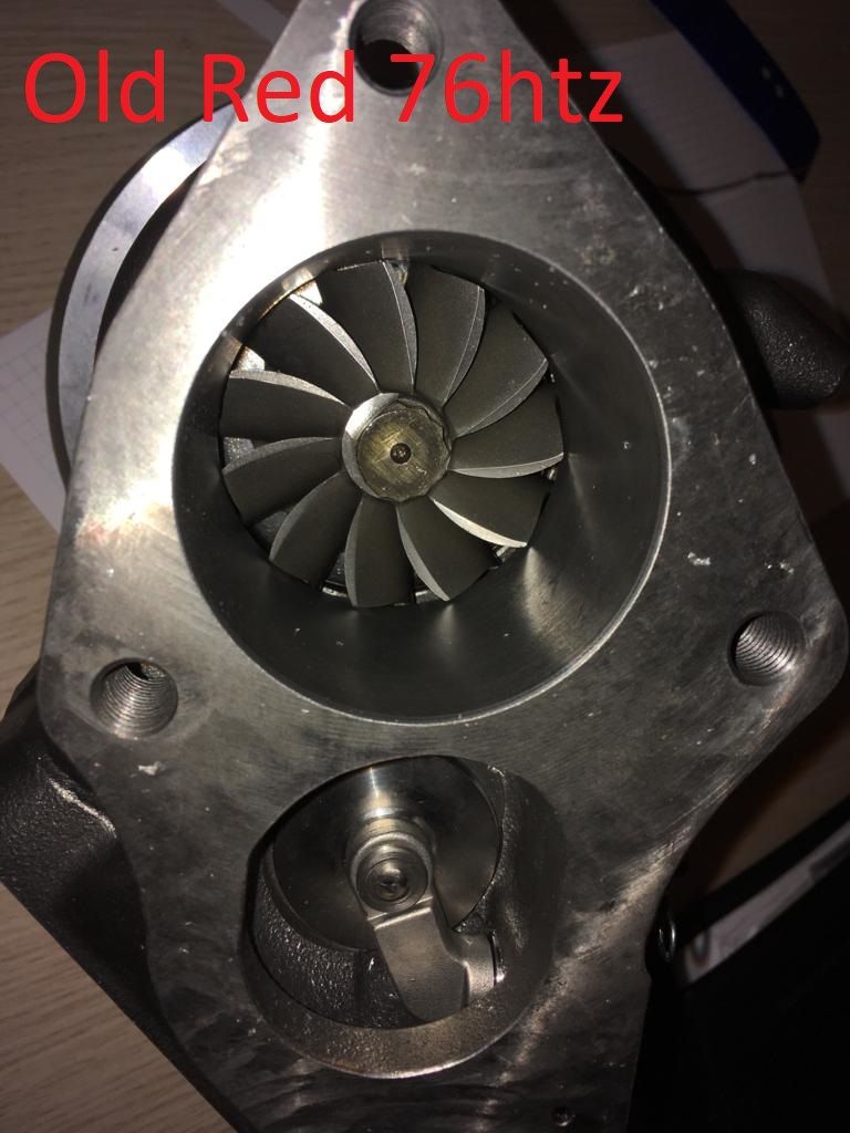

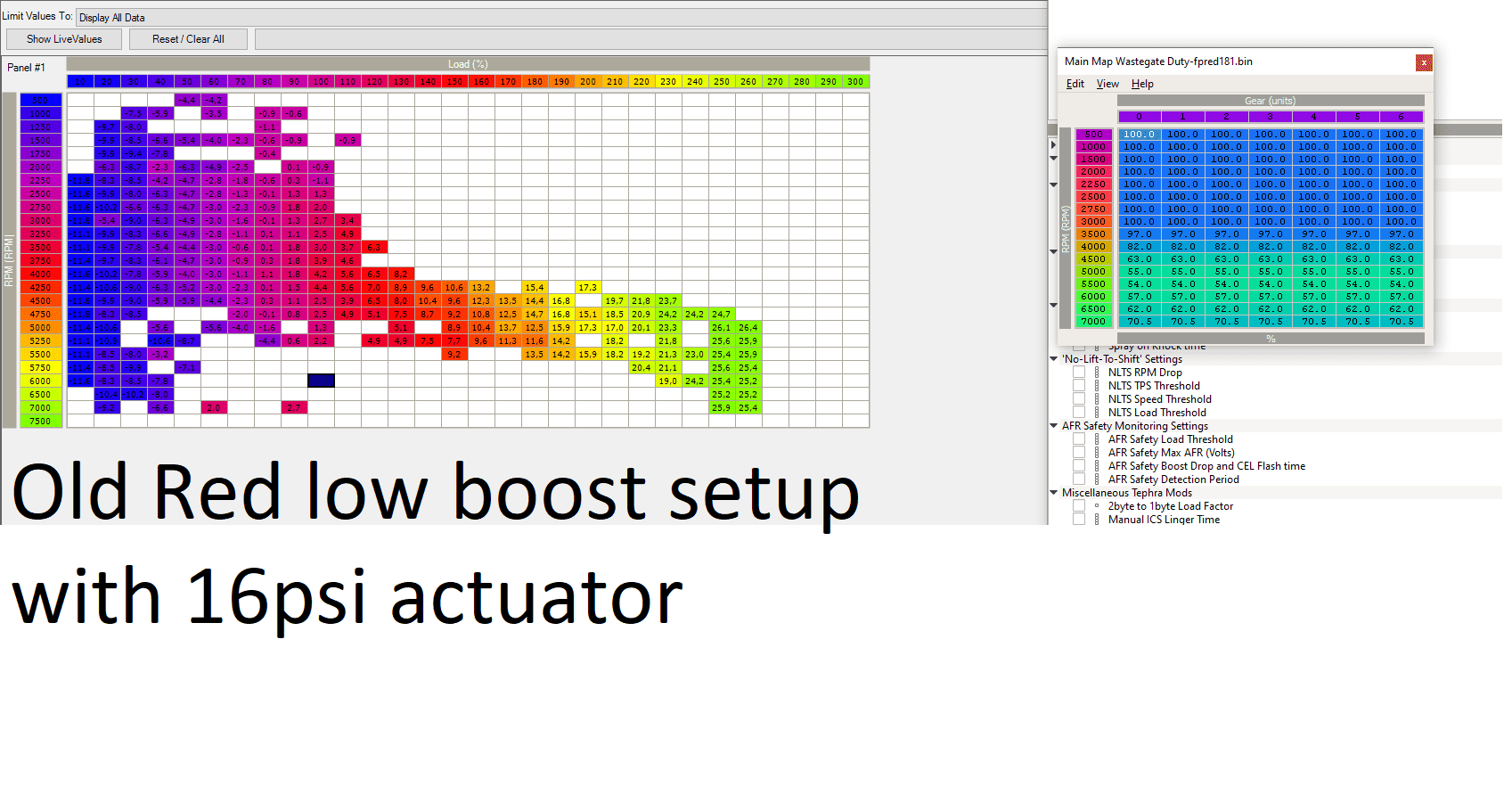

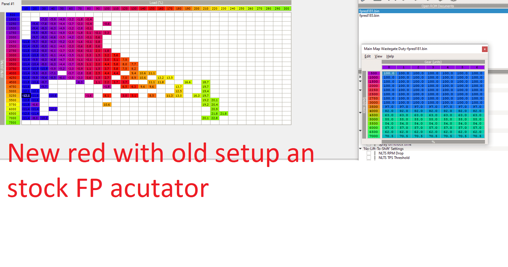

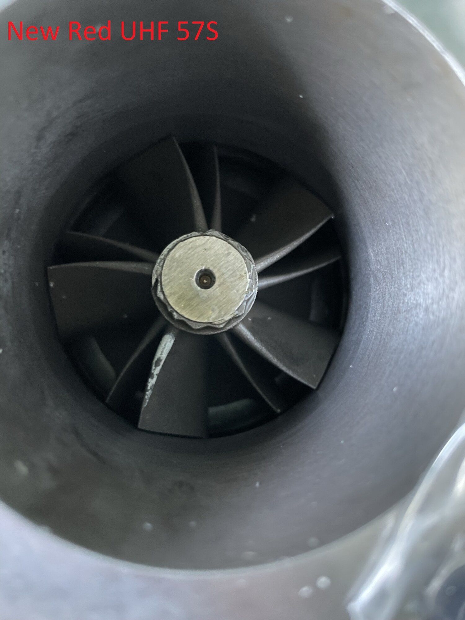

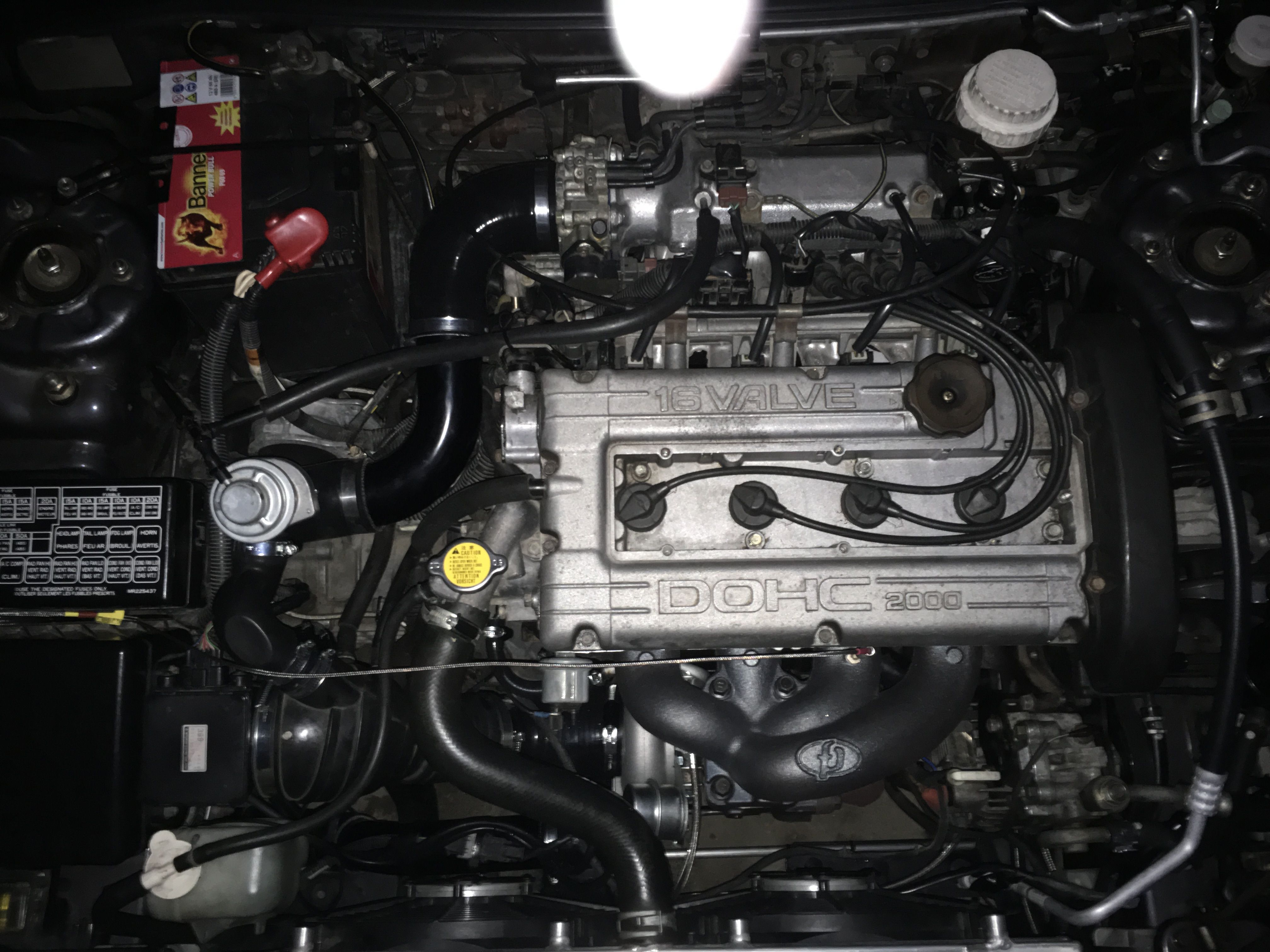

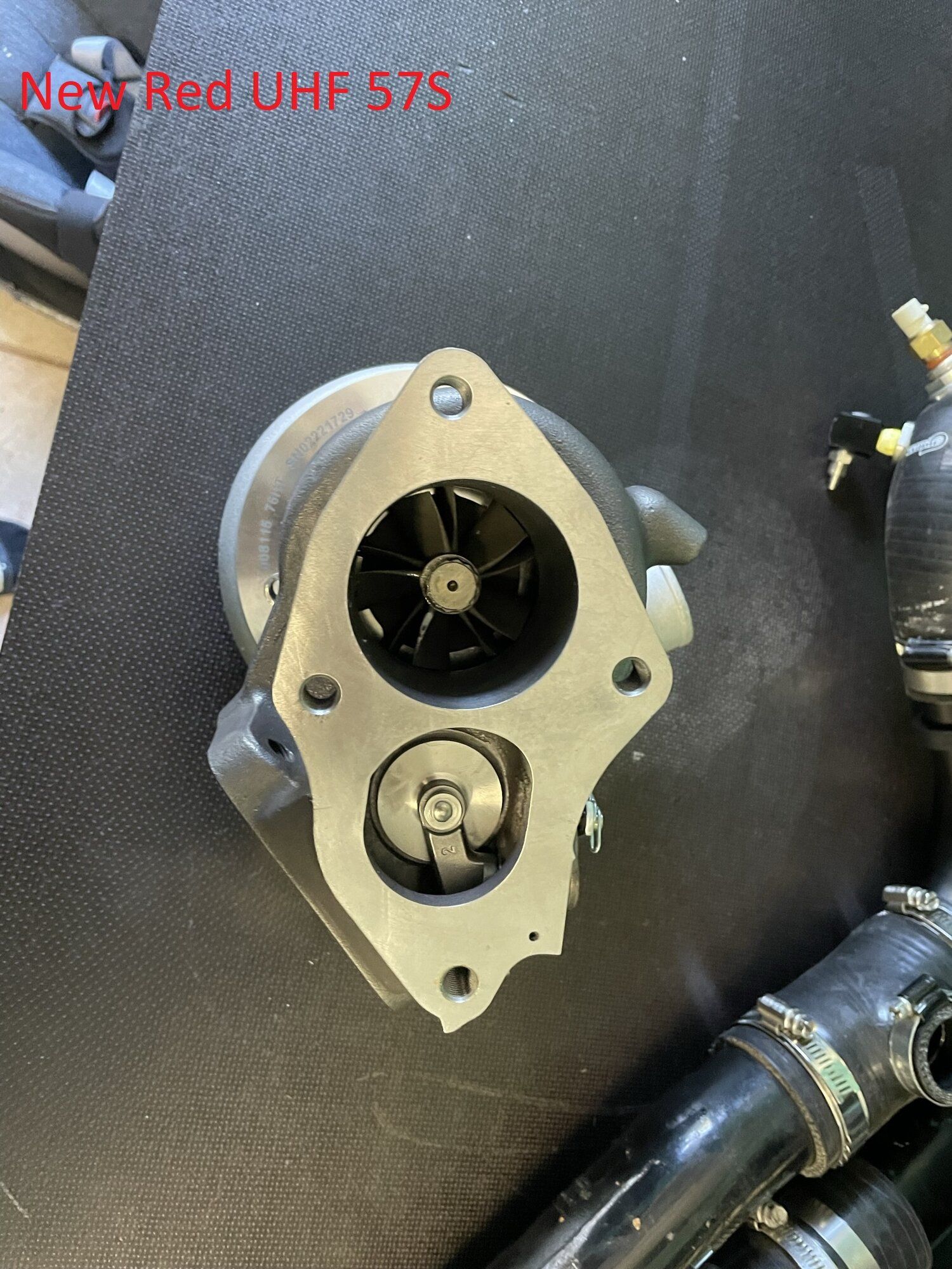

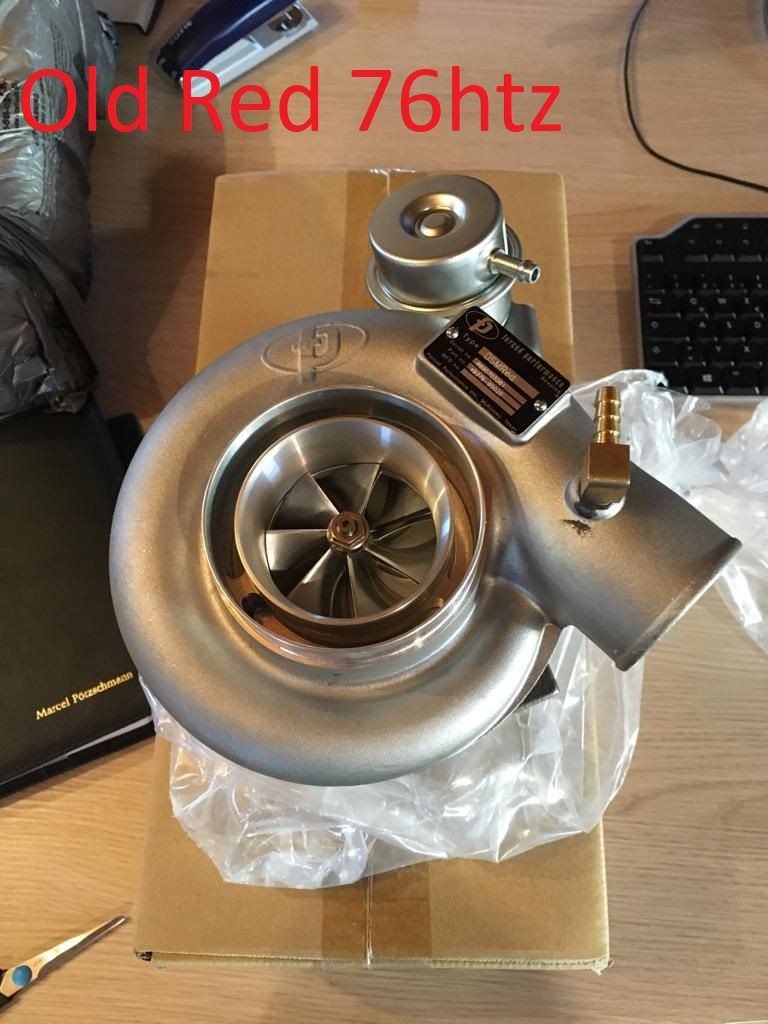

Hey,

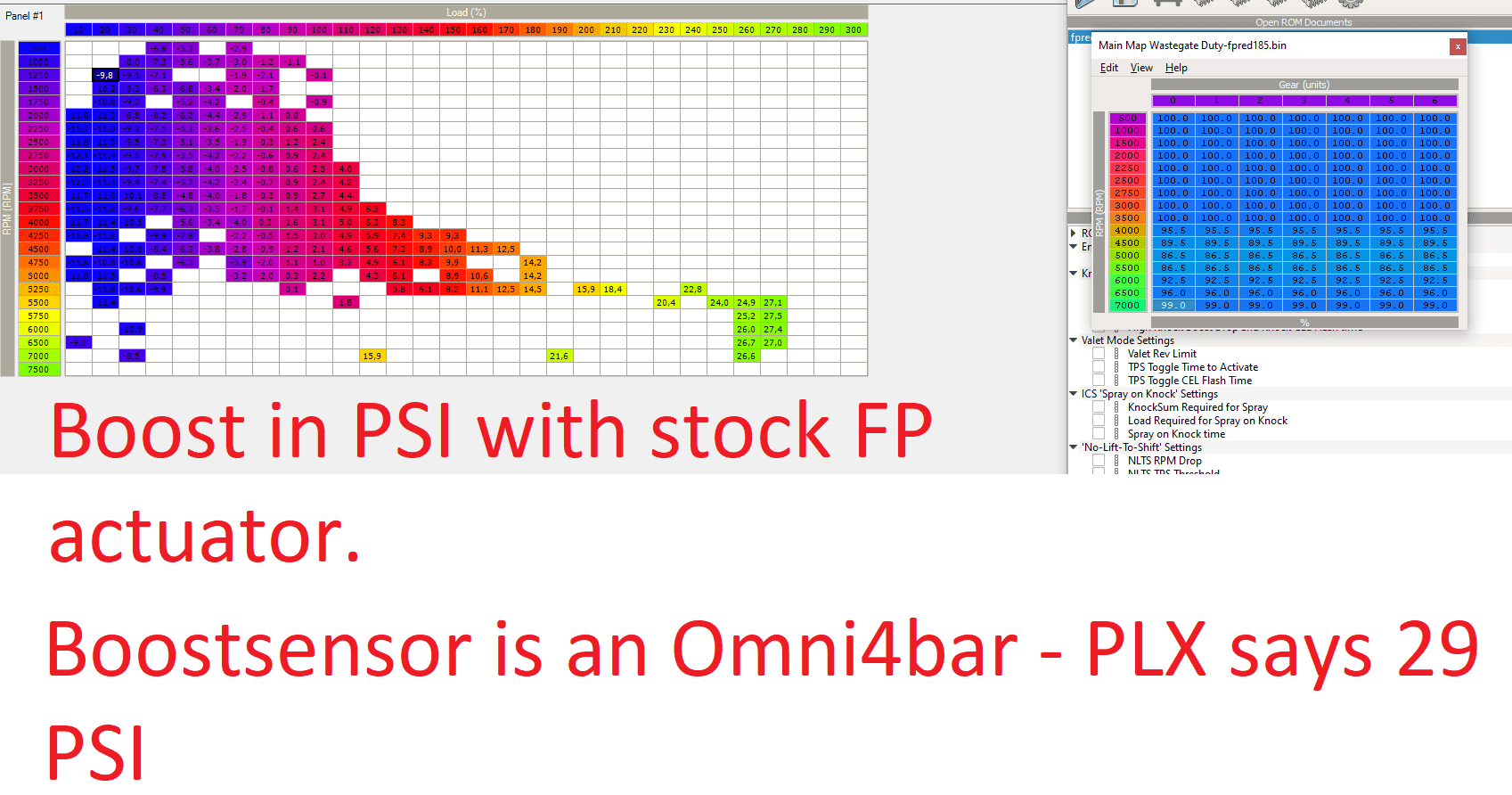

after my turbo damage(https://www.dsmtuners.com/threads/f...r-3-years-and-10000mls.541710/#post-153865771) i installed now the FP Red UHF 57s. The new one is much better than the old one. He spools much earlier. It accelerates out of corners much nicer. With the old one I would never have 27psi at 7000rpm with the stock fp actuator.
I will only drive with 27psi for now. On my main map, i will drive with pure water, for roadtrips with less timing. On my alternate maps, i will drive with 40percent ethanol in the water injection with more timing.
From 60mph till 125 mph i driven today in 10.2 sekonds.

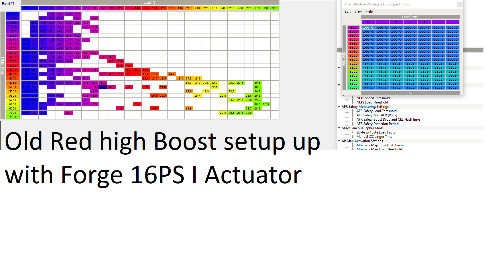

Today, i made my new wgdc setup with stock fp actuator.
