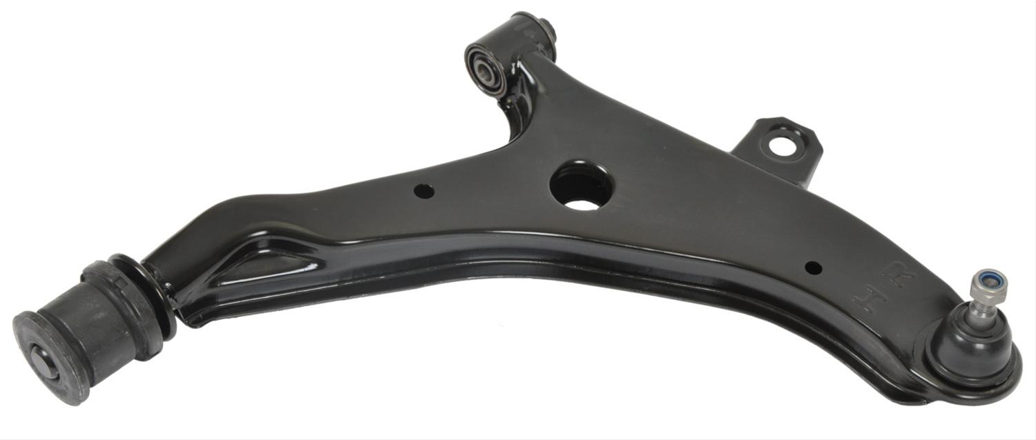

Im trying to locate a Moog part but having a hard time finding the correct part number.
I believe this is the correct one but the picture does not look right and that worries me. Can anyone confirm?
