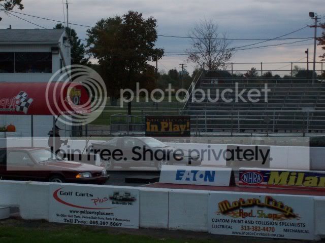

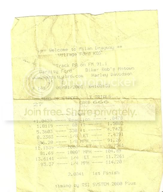

Milan dragway was nearly empty as the weather was nearing the high 40's at best. I pulled in, went through tech and straight up to the starting line. On the way there WOT pulls resulted in 14psi. Things felt good off the launch, wipers started going, hit 2nd, hit 3rd, MISSED 4th! Slammed it in and got back on the gas feeling like a newb! This was only my 2nd trip down the 1320 ever so I had no idea how I did other then the car felt great up until that missed shift. Grabbed my time slip and nearly flipped out!
I met my goals for the year and then some! The 1/8th time and MPH meant that it could've potentially been a 12.9 second pass!
Of course, what could've been doesn't mean anything so I lined back up again. Launch wasn't as good (1.85) and I missed the proper rpm shift point for the 1-2 then missed 4th again! Something didn't feel right after that. Drove around and found out I dumped oil all over the track! Apparently I blew the line for my oil pressure gauge. Lesson learned, never use a mechanical oil pressure gauge, especially with nylon line. So now I have a nasty rod knock and the car will be down until next year. Didn't even get a chance to turn the boost up. But at least I got my goal for this year. Next year it's low 12's or bust!

Looking at the 8th and speed, I think low 13's and high 12's were definately possible, I seriously just need to get more practice out there. Get that 60ft down to 1.7 and make sure to hit 4th and I'll have a good next year. And this year yes everything was done on the stock smic and piping.
Oh yeah and I was car #27, the mustang next to me was filling in for the antichrist. Wish I was deep in the 11's! Not quite possible at 14psi.
