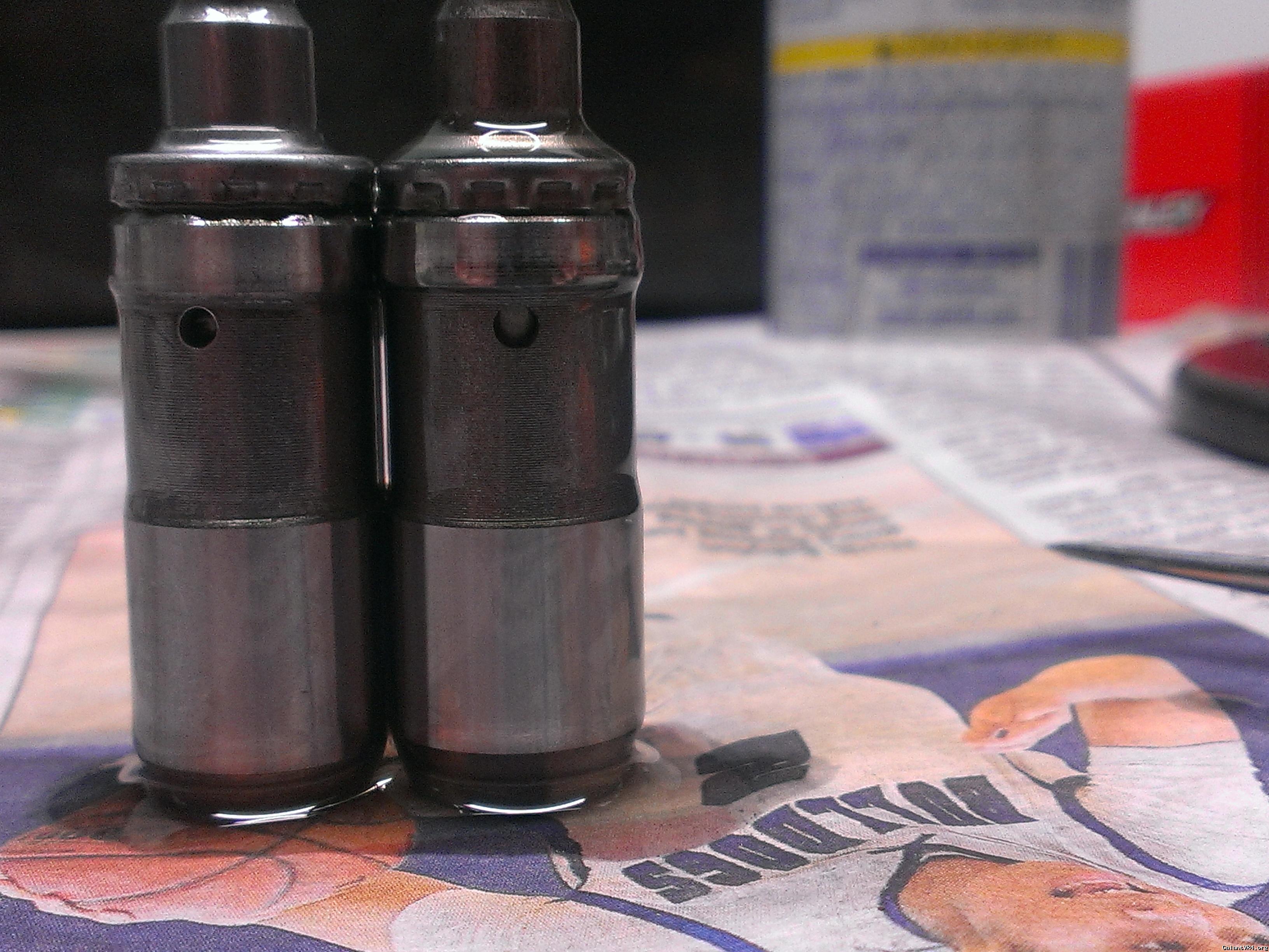

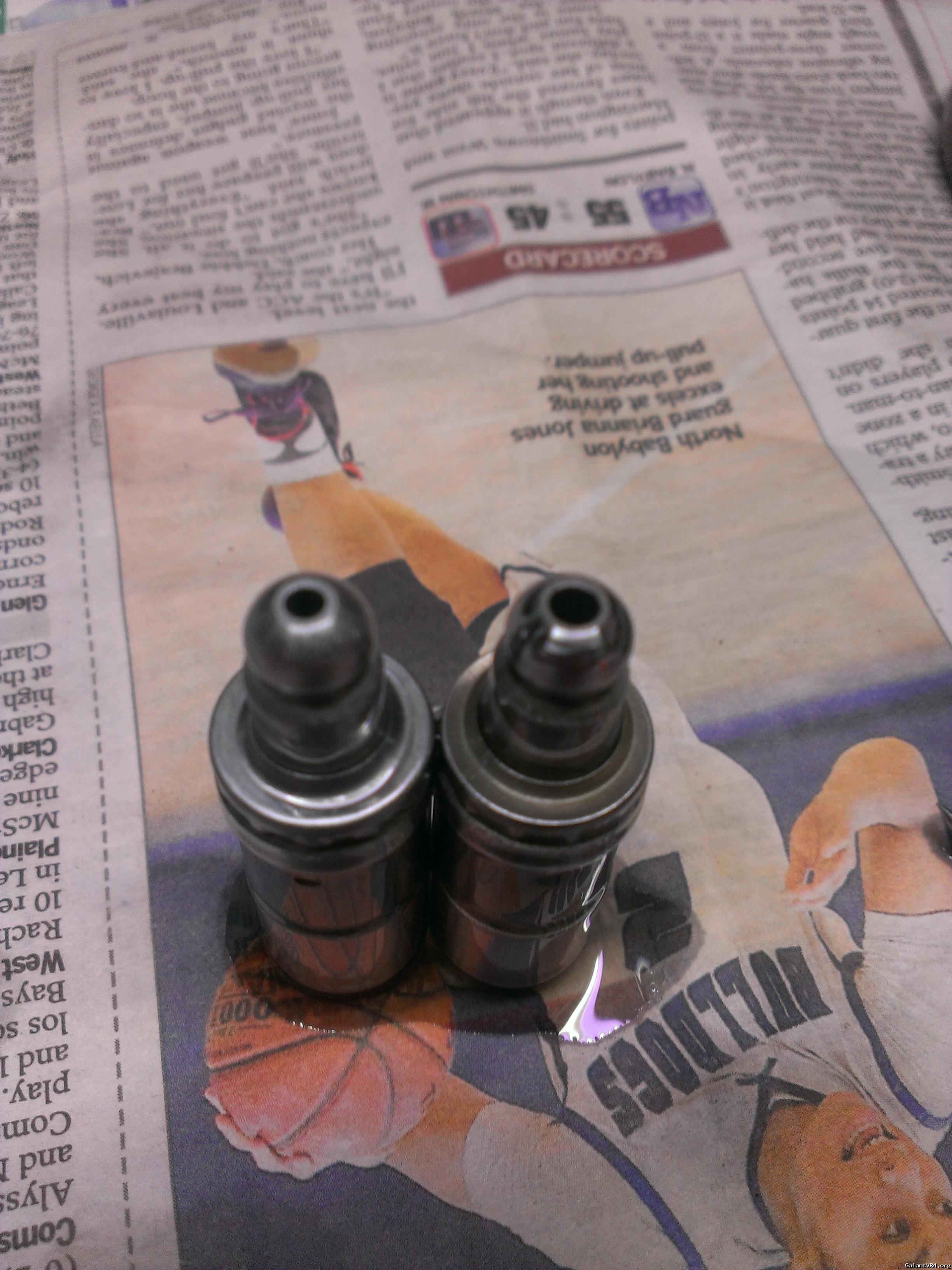

Got a set from engnbldr. not as nice as the last set. The new one is on the left one i got last year is on the right.
Both holes are smaller on the new ones. Some of the caps are very loose and pressure can escape from underneath them. Not too happy with that. I'm going to try to crimp them down tighter. I emailed him about them. He told me his distributor passed away and has found a different source since last year. He can't get the other ones anymore.
Again, not saying ANY of the Engnbldr lifters are good or bad, just something I'd look into if i were in the market to buy some from him.
