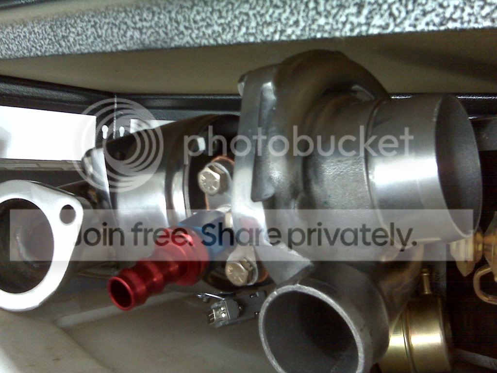

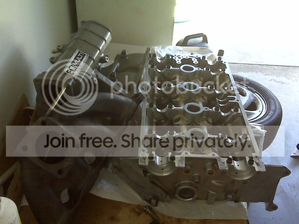

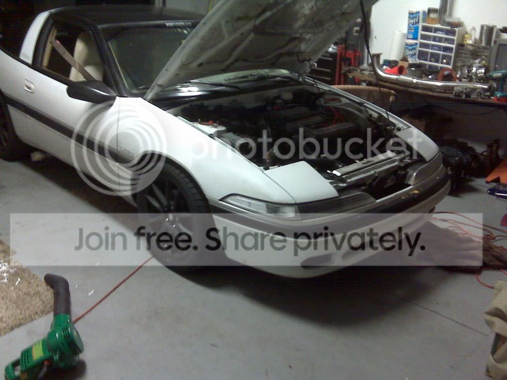

So her are some pics of my build in process. Im doing .20 over Evo 9 pistons with OEM rings, on 1g big rods with arp's, Engine pro main and rod bearings, brass freeze plugs, vitton valve seals, BSE kit, MLS gasket, Arp studs, timing belt, water pump, timing tensioner, new main studs, oil pump, and 3g lifter.

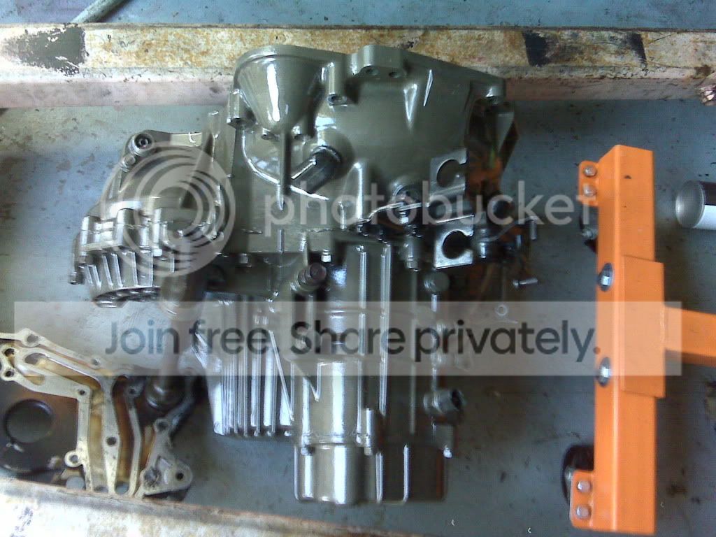

As for as the transmission im throwing in my 2600 pp and got a new Slowboy street disc, and oem Throw out bearing, and extended slave cylinder rod.
now heres some pics before teardown

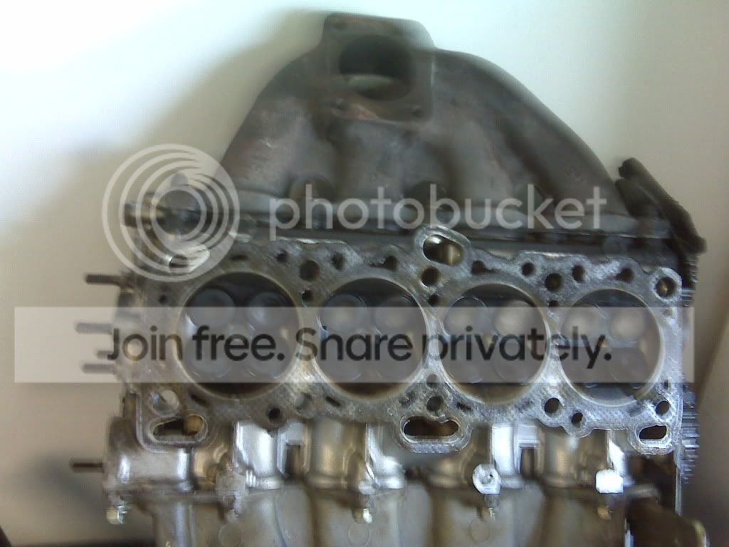

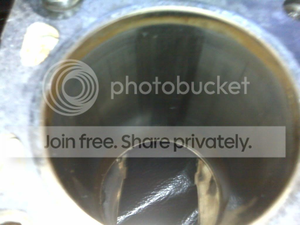

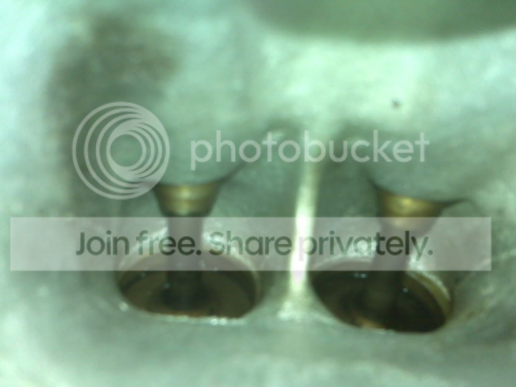

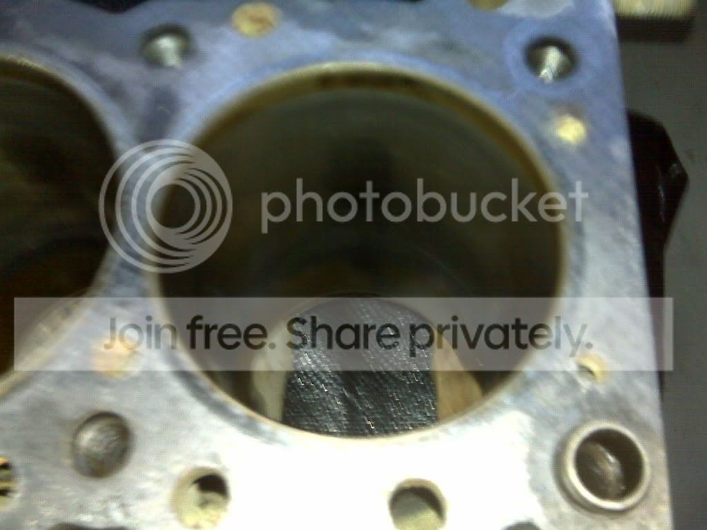

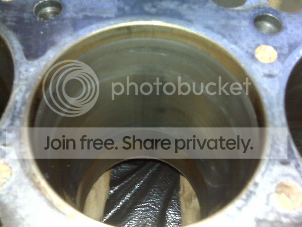

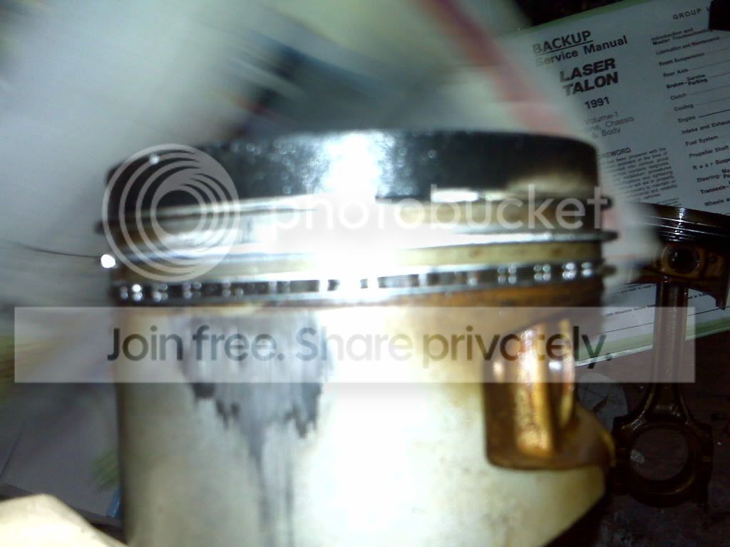

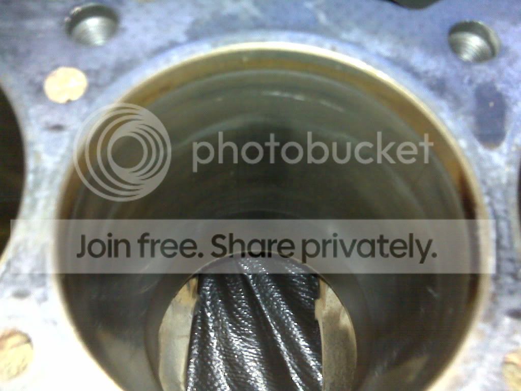

So pulling the motor apart i found the damage, but still dont know what caused it?

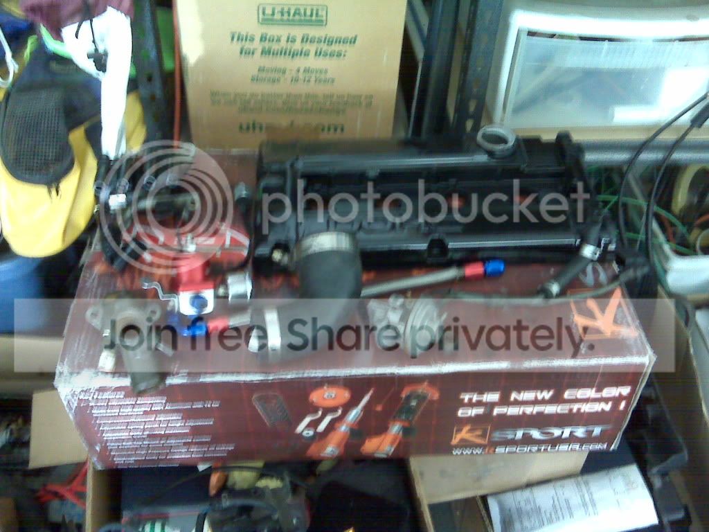

Heres some pics of parts waiting for install
Ported 1G manifold
Bullseye v trim

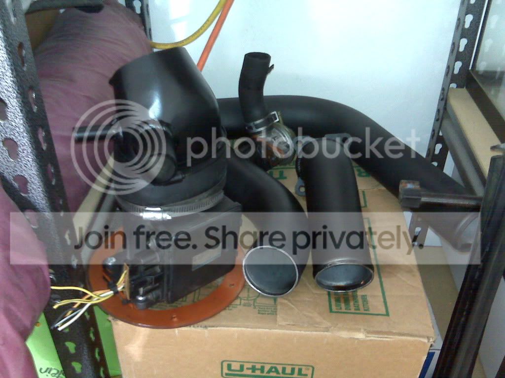

2g Maf with PR intercooler piping
Shaved valve cover

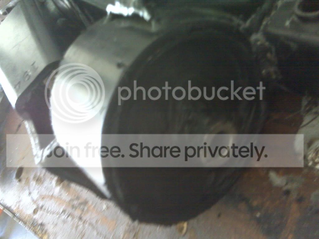

Filled Motor mounts with window weld/ Cutting board
