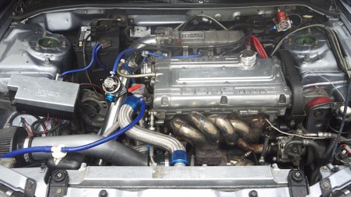

Found out where my leaks are! My oil leak is coming from my manifold DEFINITLY NEED A NEW GASKET, my Anti-freeze leak is still unknown BUT I'm guessing the head gasket is blown or just worn to the point its not holding up that good anymore..my car doesn't over heat or get too hot so i think its the gasket being old not blown..I DEFINITLY need the Gaskets Replaced ASAP!!!!!
Also have an electrical problem...whenever I use my healdights/brights/power windows/radio/ anything like that my IDLE gets messed up and starts complaining at me..SOO I'm guessing I need a battery replacement, and maybe even a capacitor to manage all the electronics I have, I say capacitor because I have an expensive stereo system so maybe thats hogging all the power...I definitely have some crazy power surge messing a lot of shit up... :/

Any special steps to taking off a cold air intake? mine is injen, and i just want to check my turbo for shaft play..just wondering if i could rip er' off or not LOL
bump!>?
yes, u can 'rip her off', but first disconnect your maf plug, remove the blow off valve recirc tube, and undo the clamp that connects the pipe to the turbo. Also, check to see if any of your emmision hose are still on there. (they will be on the underside of the intake pipe)
