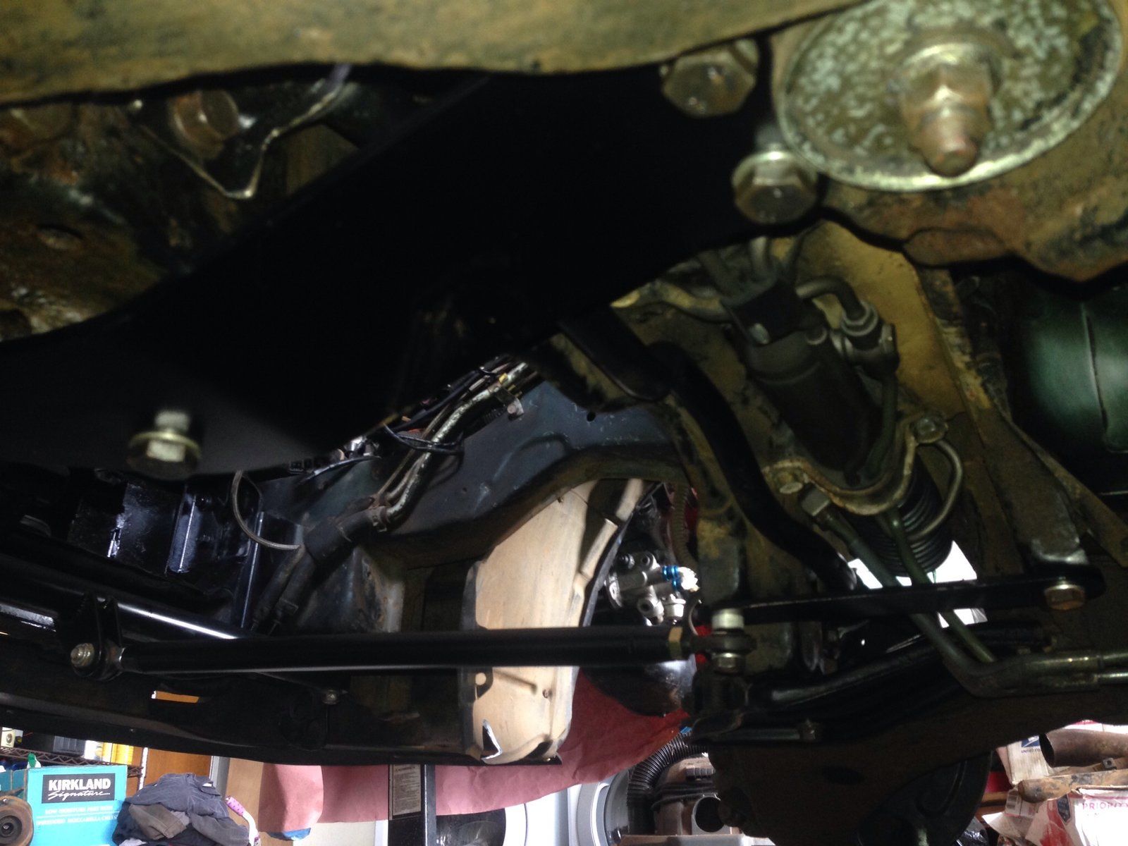

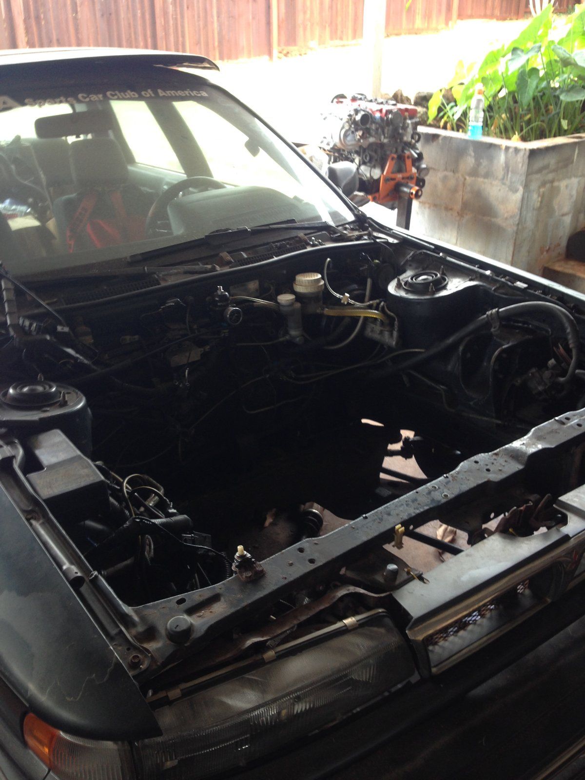

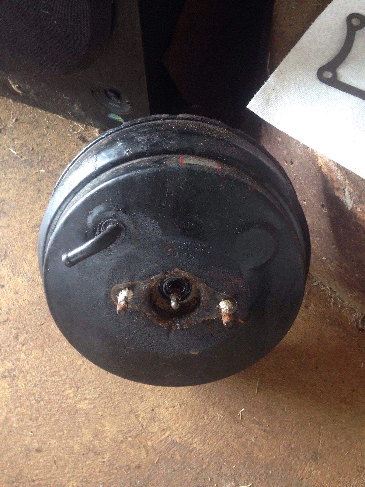

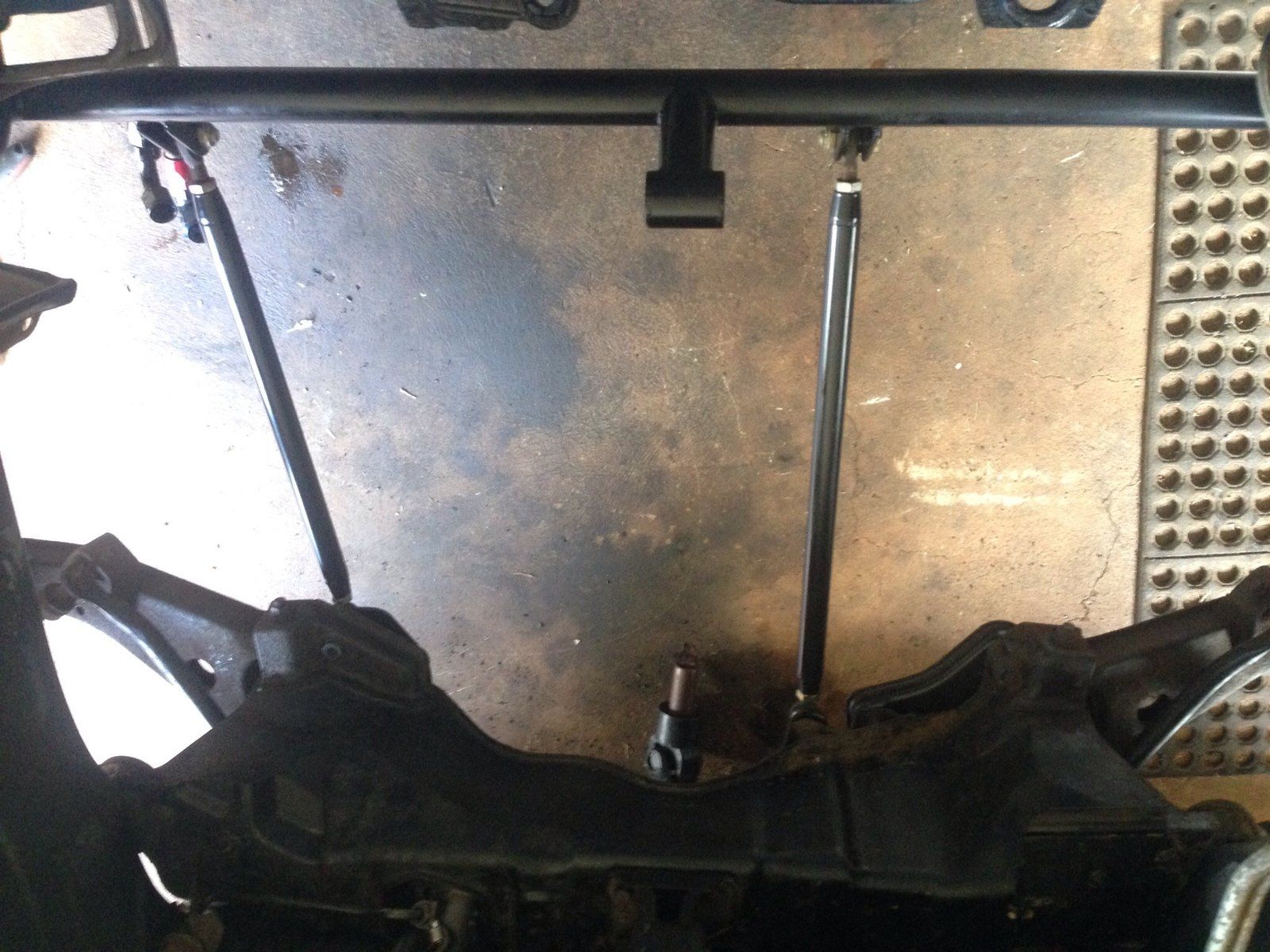

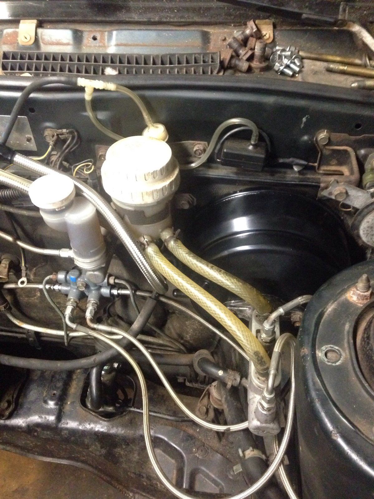

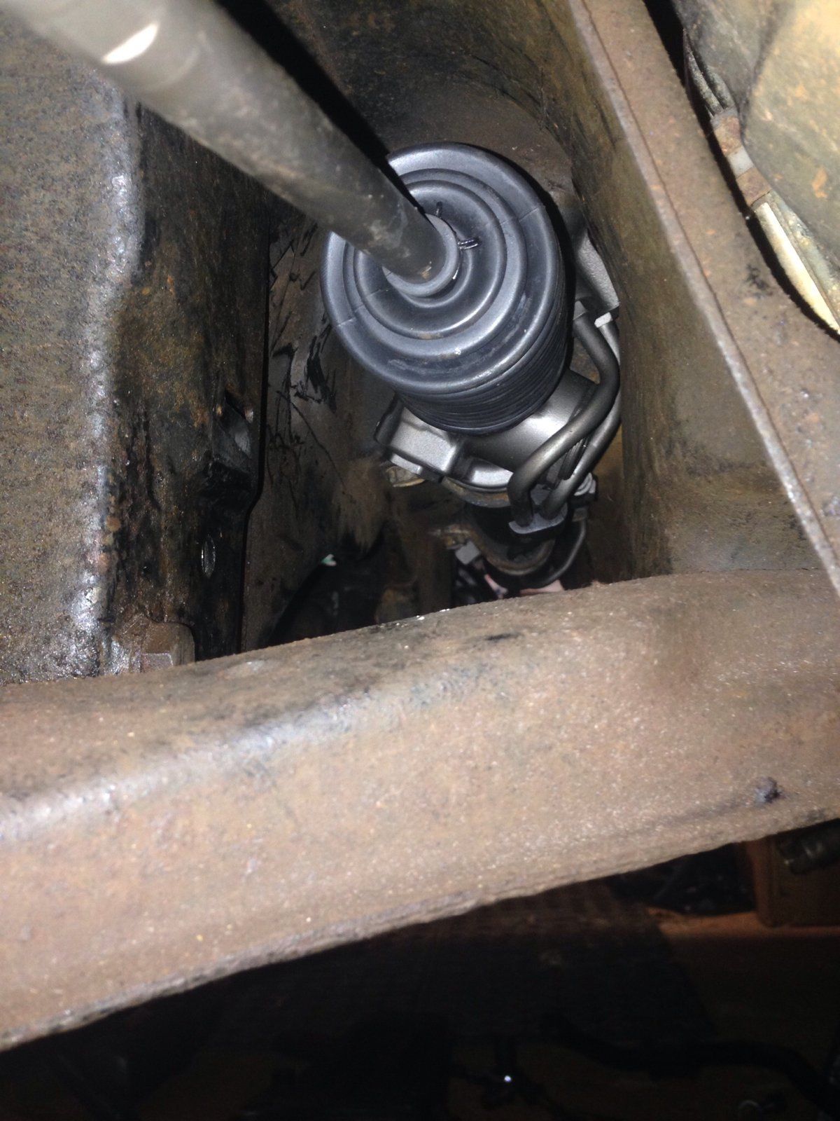

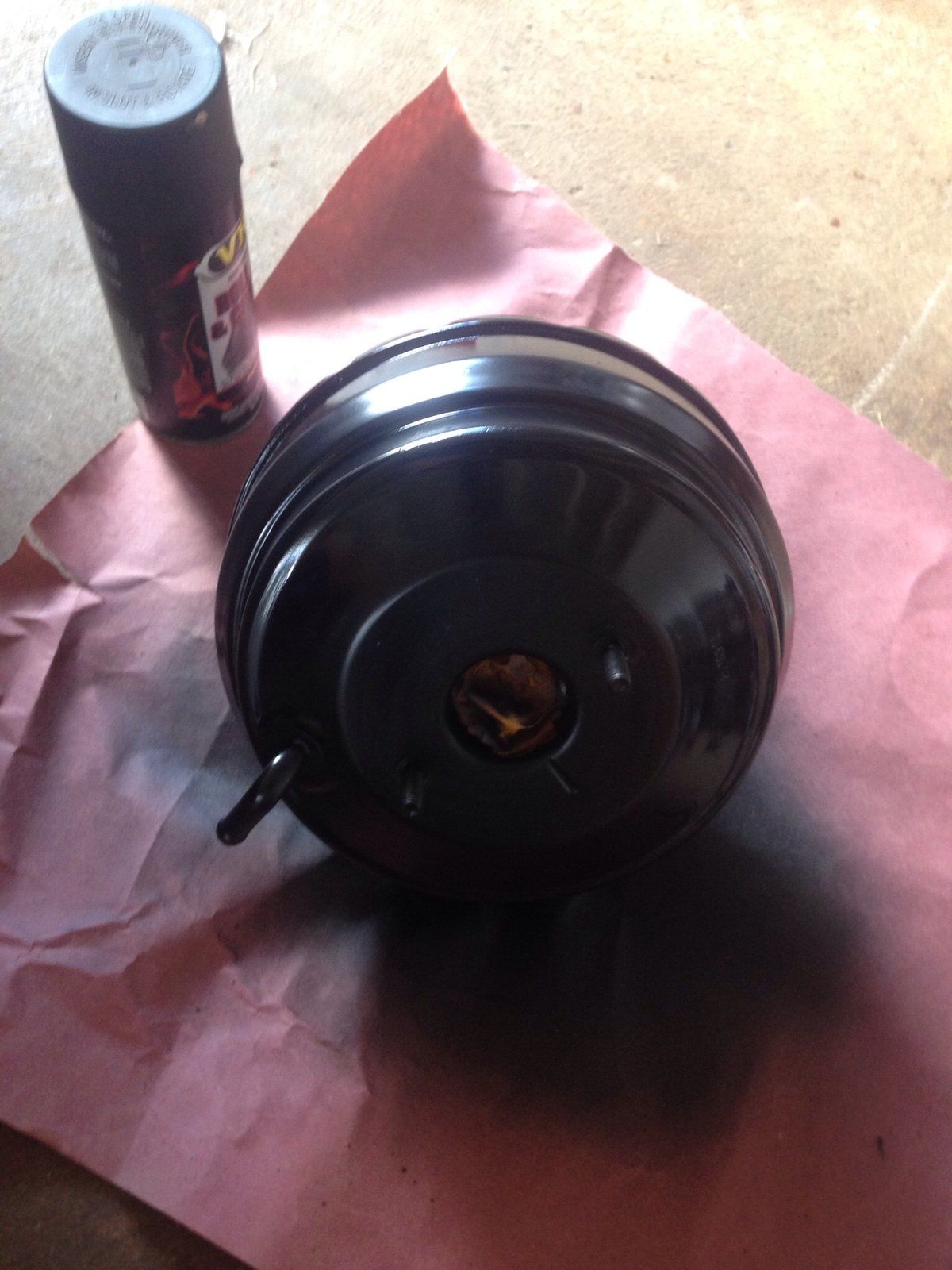

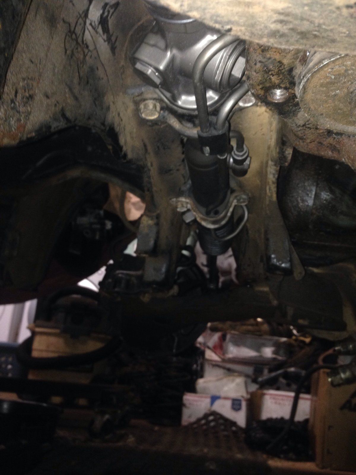

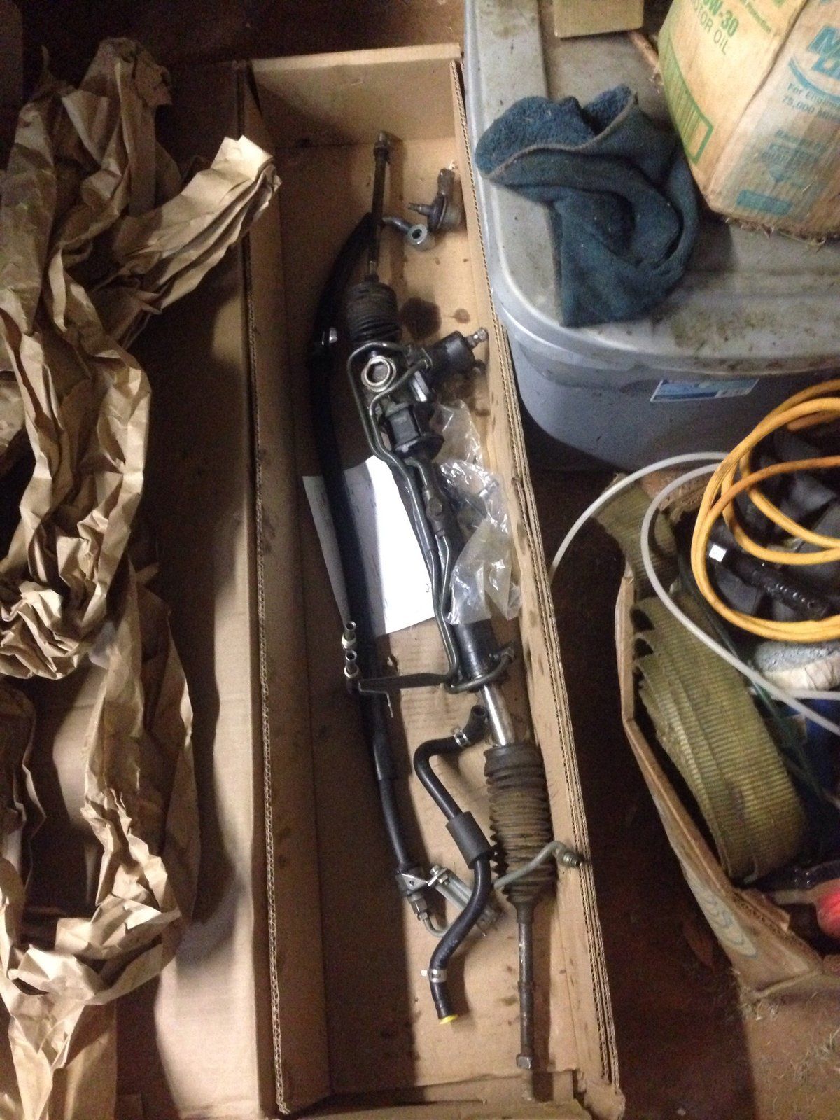

Alright my fellow tuners, gvr4 got some lovin today LOL! :) Was able to swap out the old brake booster for a good 2g one out of my parts car. So stoked I did this, I had a feeling the booster was junk. And sure enough I know the issue now had about a 1/2 quart of brake fluid in it, from the old leaking master. And I know it had to of damaged the diagram. I have all new brakes all around and now a 2g master and booster setup to compliment. Should really improve the non abs system setup I have now. Cuz before they felt like crap and that booster just wasn't cutting it. Also got the old dead and super leaky steering rack out. Swapped in the new one I got from a member and then had rebuilt by buyautoparts.com. Thanks again to them for helping me get a solid oem 4ws front rack! ;) Now after I button up a few little things, I can finally get the motor and new trans in! Can not wait and should be able to get this done by the weekend. If all goes well and I'm not hurting tomorow from today LOL. More soon, really wanna thank all the tuners that help and support my projects. Couldn't do it without you guys. Almost have a fully worked over gvr4 with only 120k on the clock. I've pretty much had my hands on every bit of this car, restoring it. Oh ya!! :dsm: :hellyeah: :rocks:
New 2g getting some rust removal and paint.
Old gvr4 junk stocker
New 2g unit and master installed
Old crap leaking rack
New one installed :)
New one
