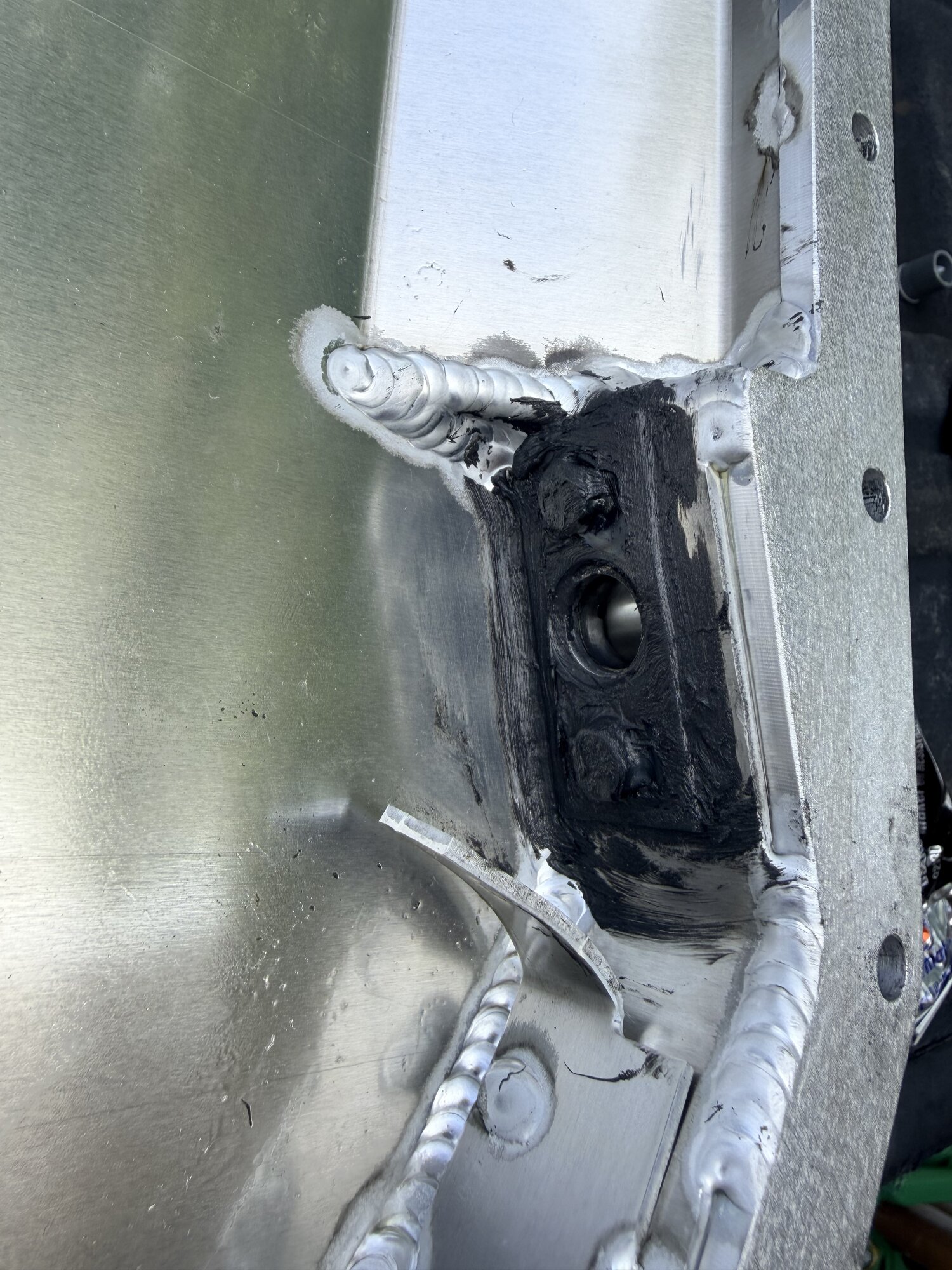

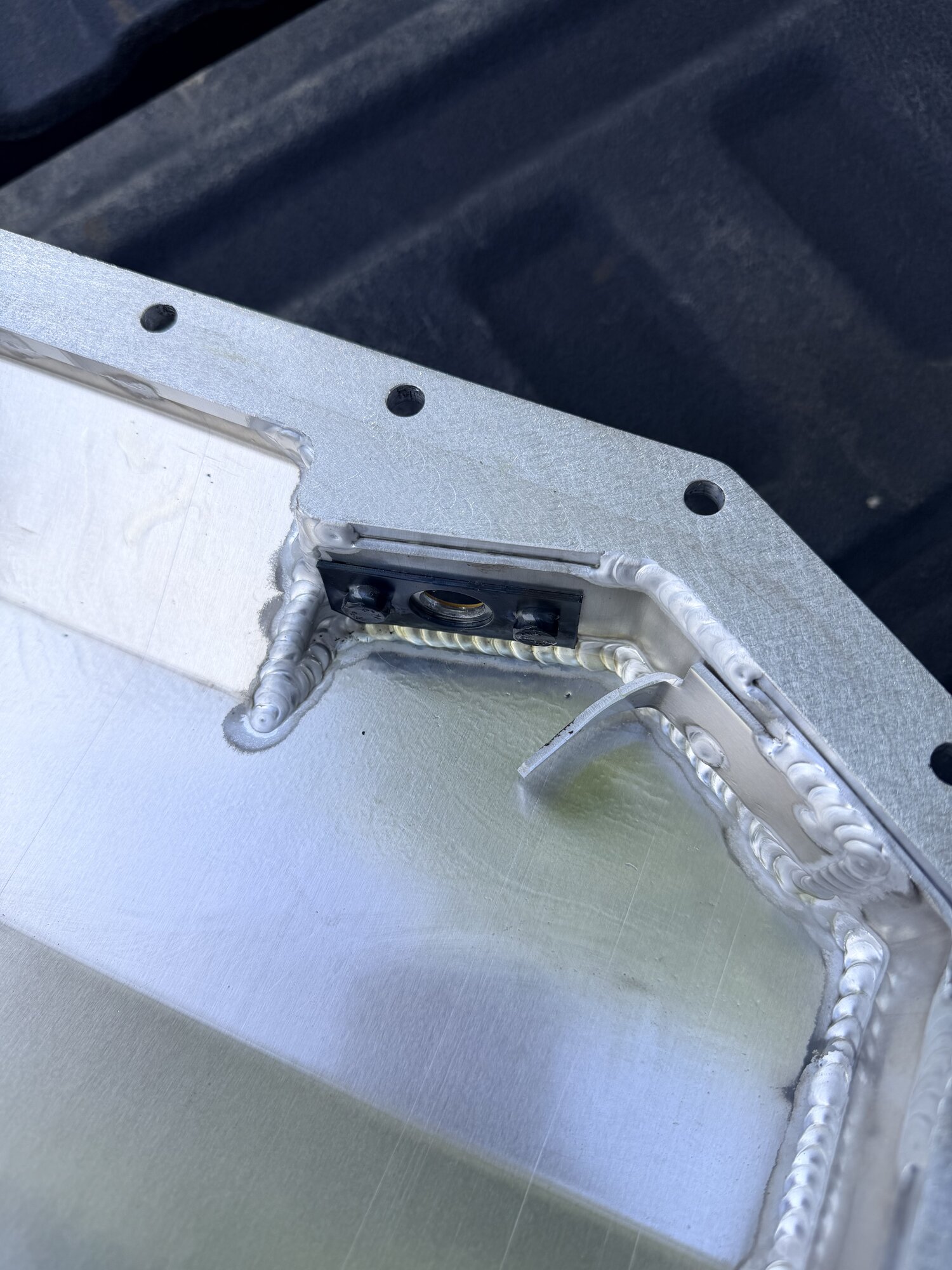

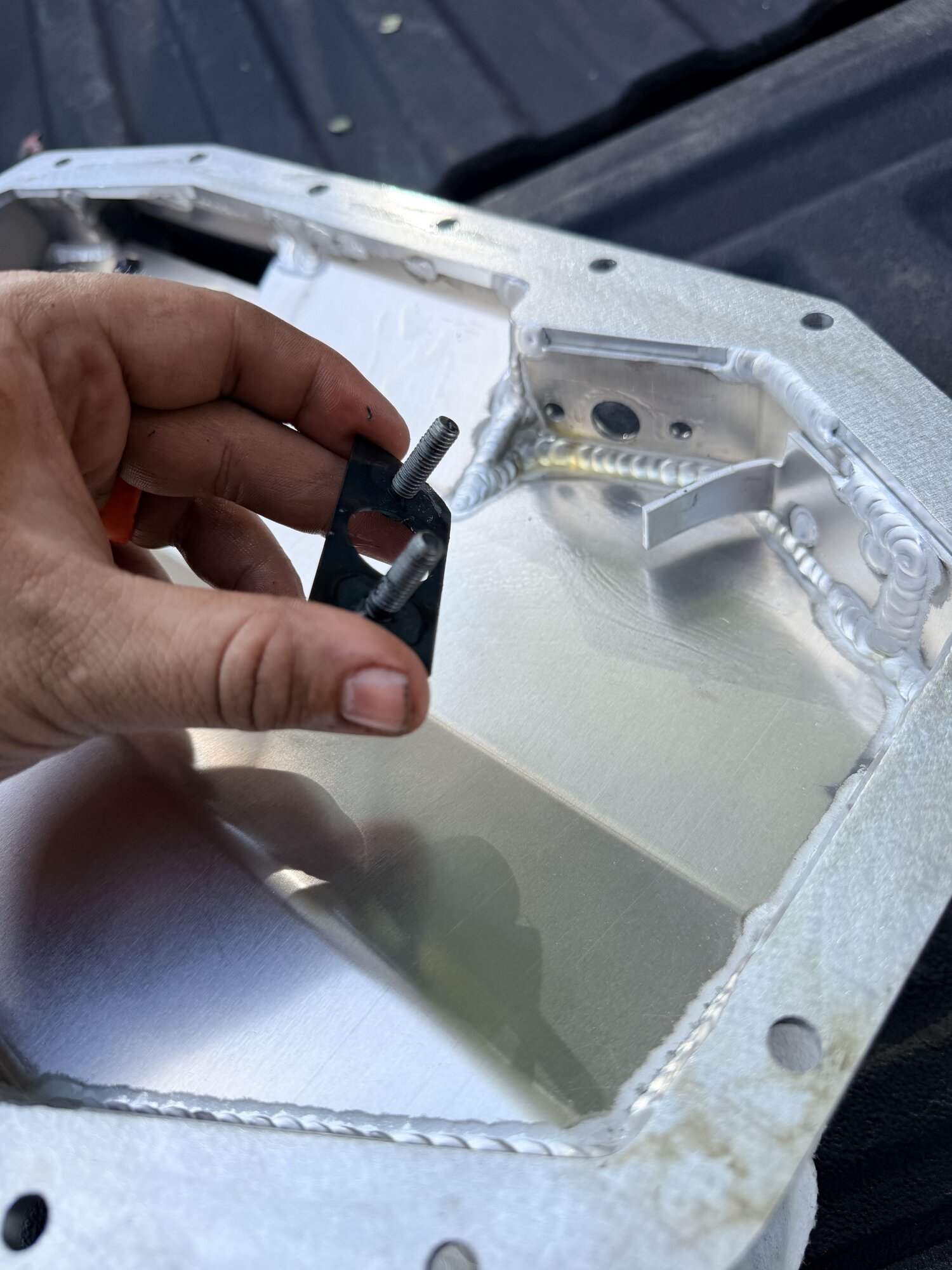

I’m sure if you’ve continued with the building you’ve already ran into this or know about it but I would also suggest before the pan is installed to apply rtv to the turbo drain plate that has the studs on it because I’ve had issues with the oil leaking out the threads on the studs
Yep, my Moroso pan totally leaks at that location! Not alot, but enough to be a nuisance. I’m planning to pull the oil pan this winter so I’ll try the silicone when the time comes, thanks!
