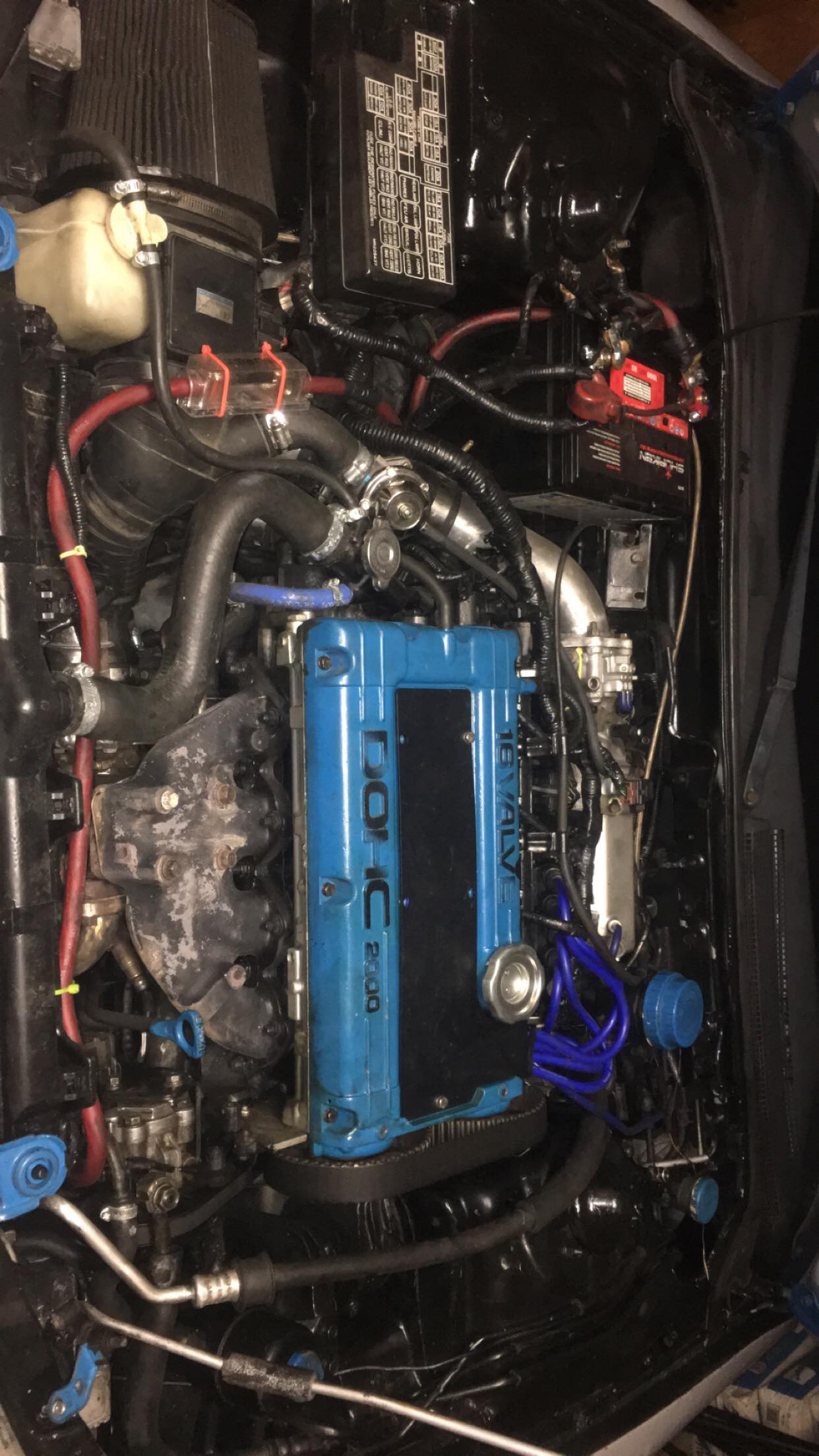

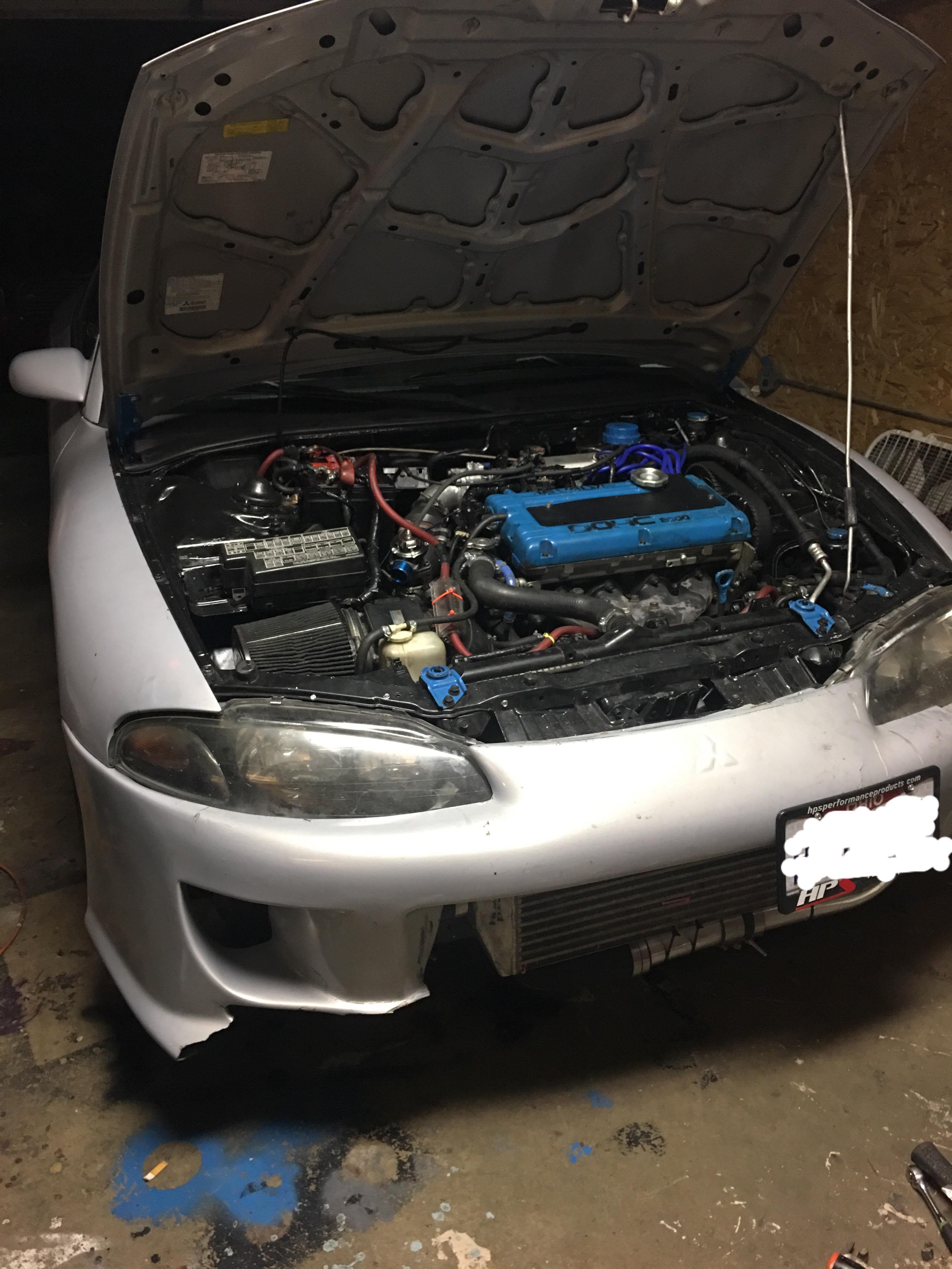

Car is currently got the engine bay completely repainted.

Bought an Built engine.
Wisco 10.0:1 E85 HD Pistons
Manley H-Beam Rods.
ARP Main and Rod bolts.
BC springs/retainers.
Had STOCK cams, but i replaced them with genuine HKS 272/272 cams from a 1g (Had to drill into cams to fit 2g sensor onto it)
Timing redone with oem parts and kevlar timing belt (This was pain for me to figure out even with engine out of the car. BUT I GOT IT!)
Got an FP Intake w/ the 9" filter.
Got a custom catch can with -10an fittings on my VC and catch can.
Got a 1g TB and going to port my 2g Intake Manifold for it.
