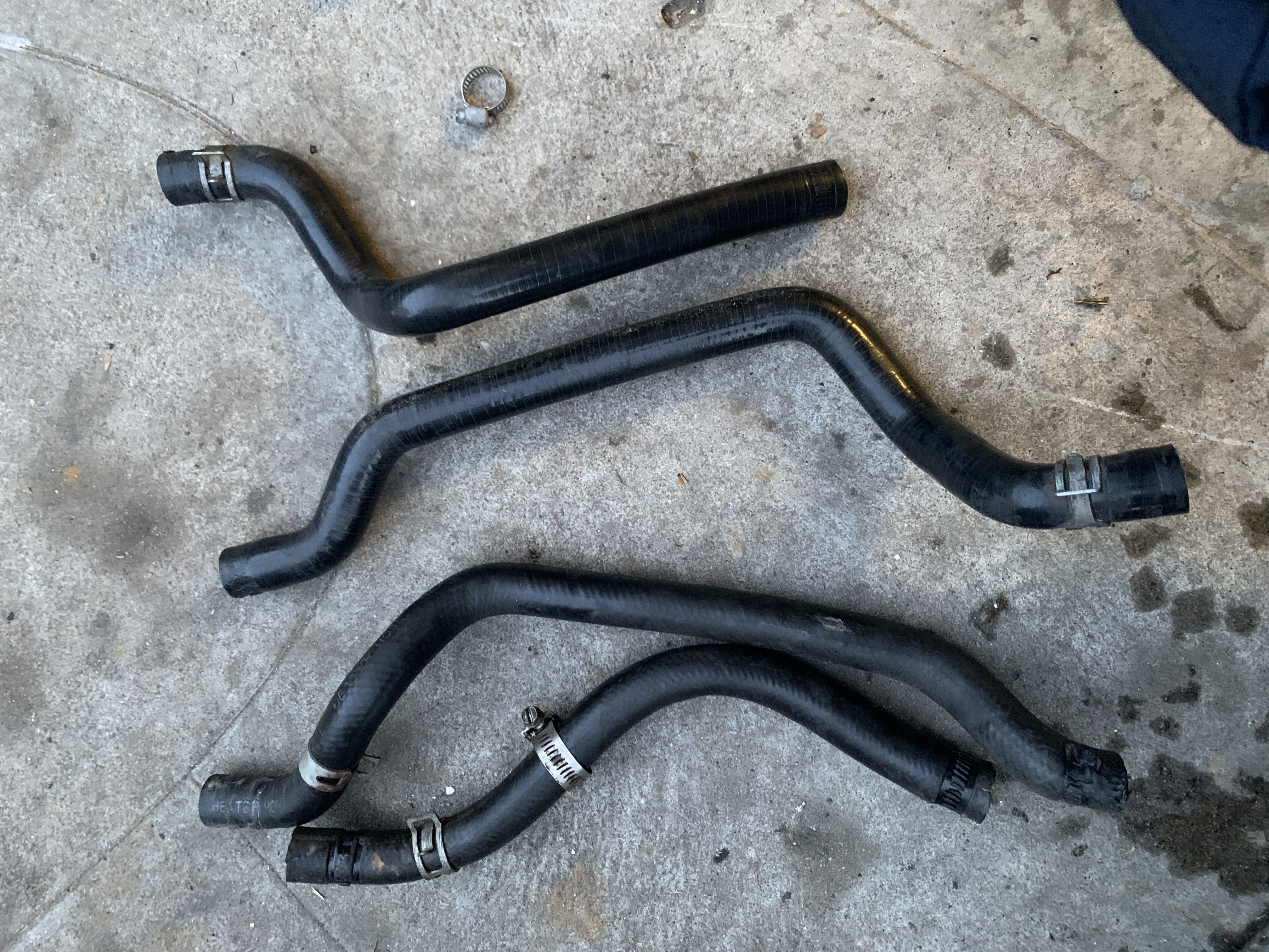

some connectors were broken, it had worn out water hose lines, it had so much rtv on the water pipes (thermostat housing and water pump connections),

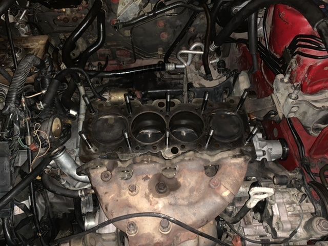

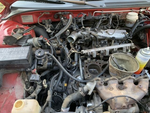

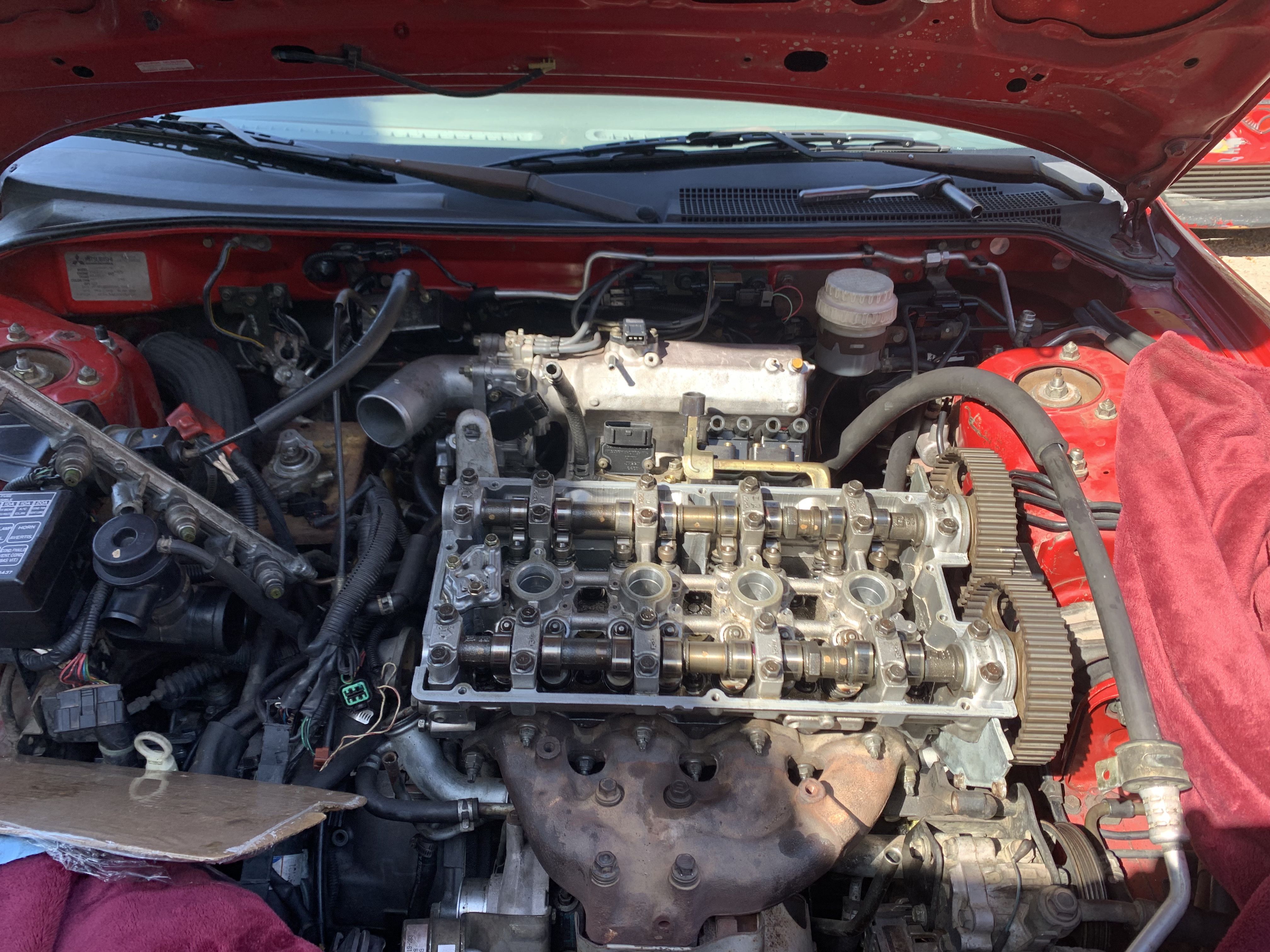

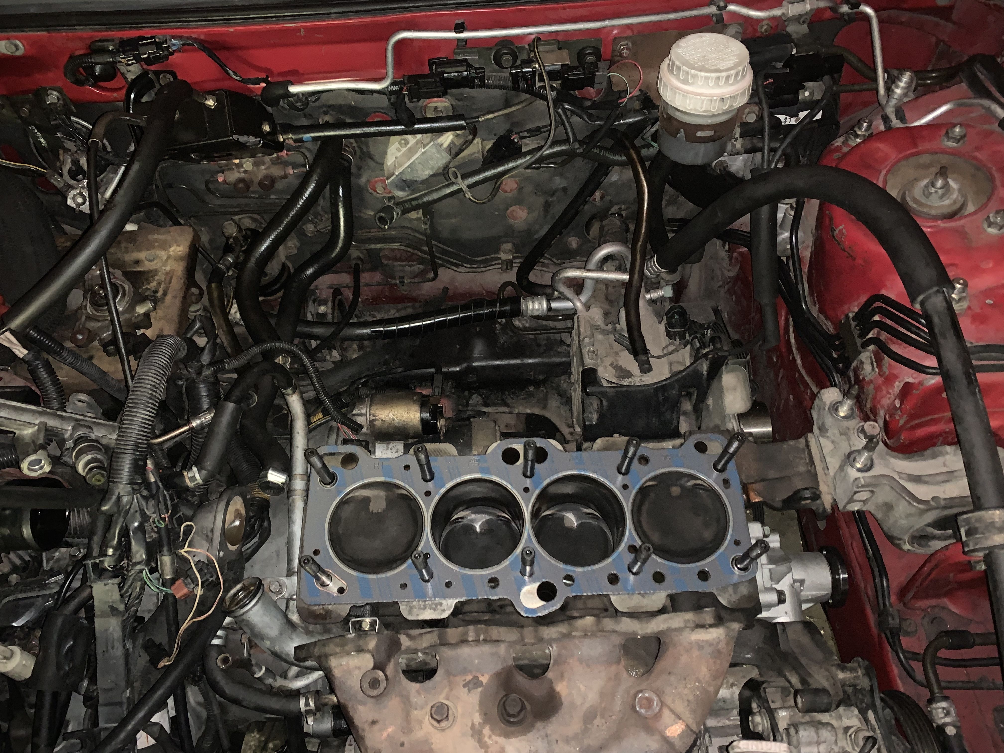

Her is a view of the disassemble.
Here I’m cleaning the most I can all around the block.
I usually remove the intake and exhaust for cleaning and inspecting/changing what Evers I see wrong or bad, but because all what I want, is to pass smog and get it register, I did it this way.
It was tricky doing it this ways which it was my first time not removing the manifolds. It feels wrong doing it this way and so many times came to my mind to take them off,. (Maybe because I’m not used to ).
After it gets registered, I will order gaskets/seals and water hoses to replace all.

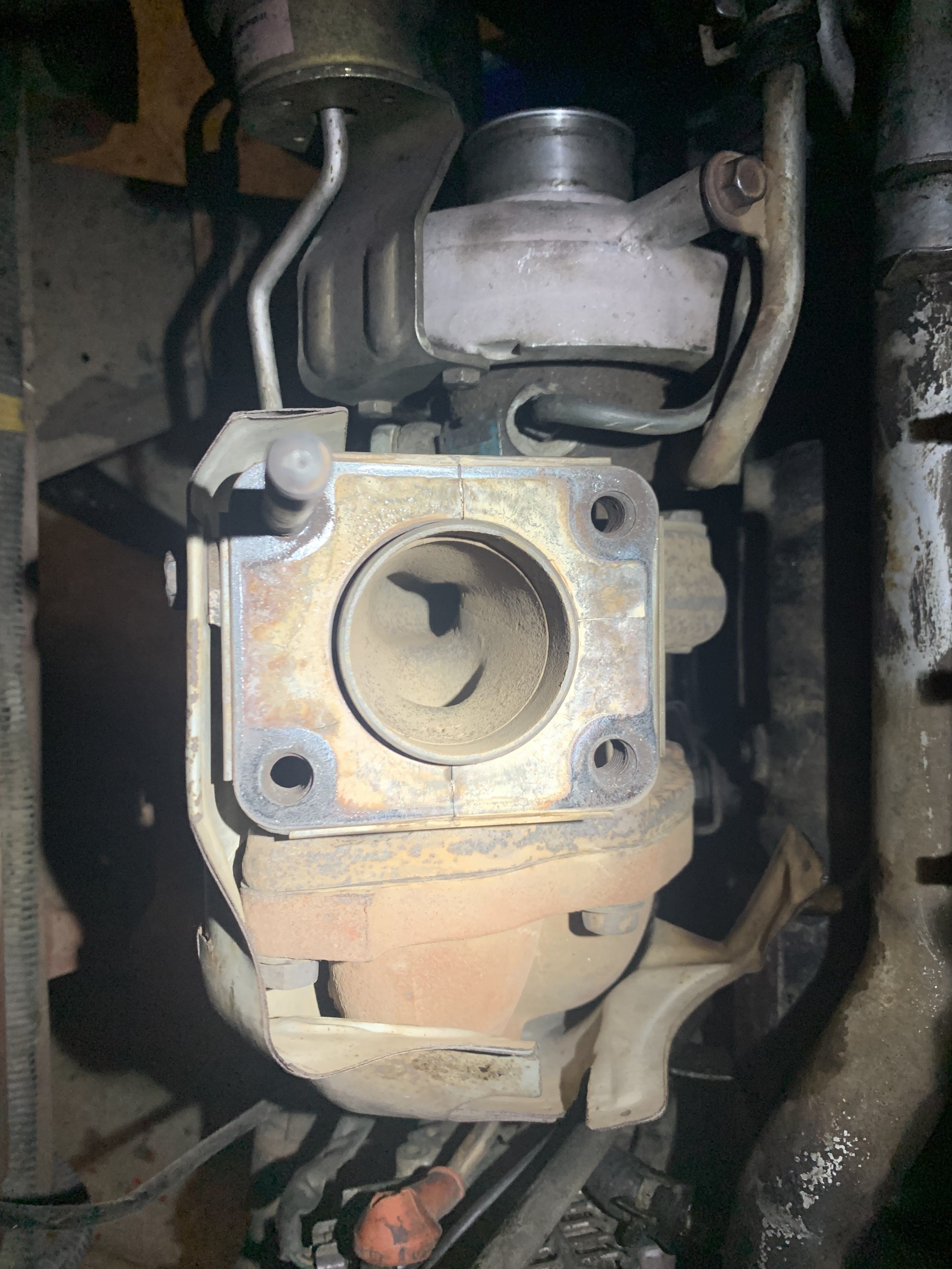

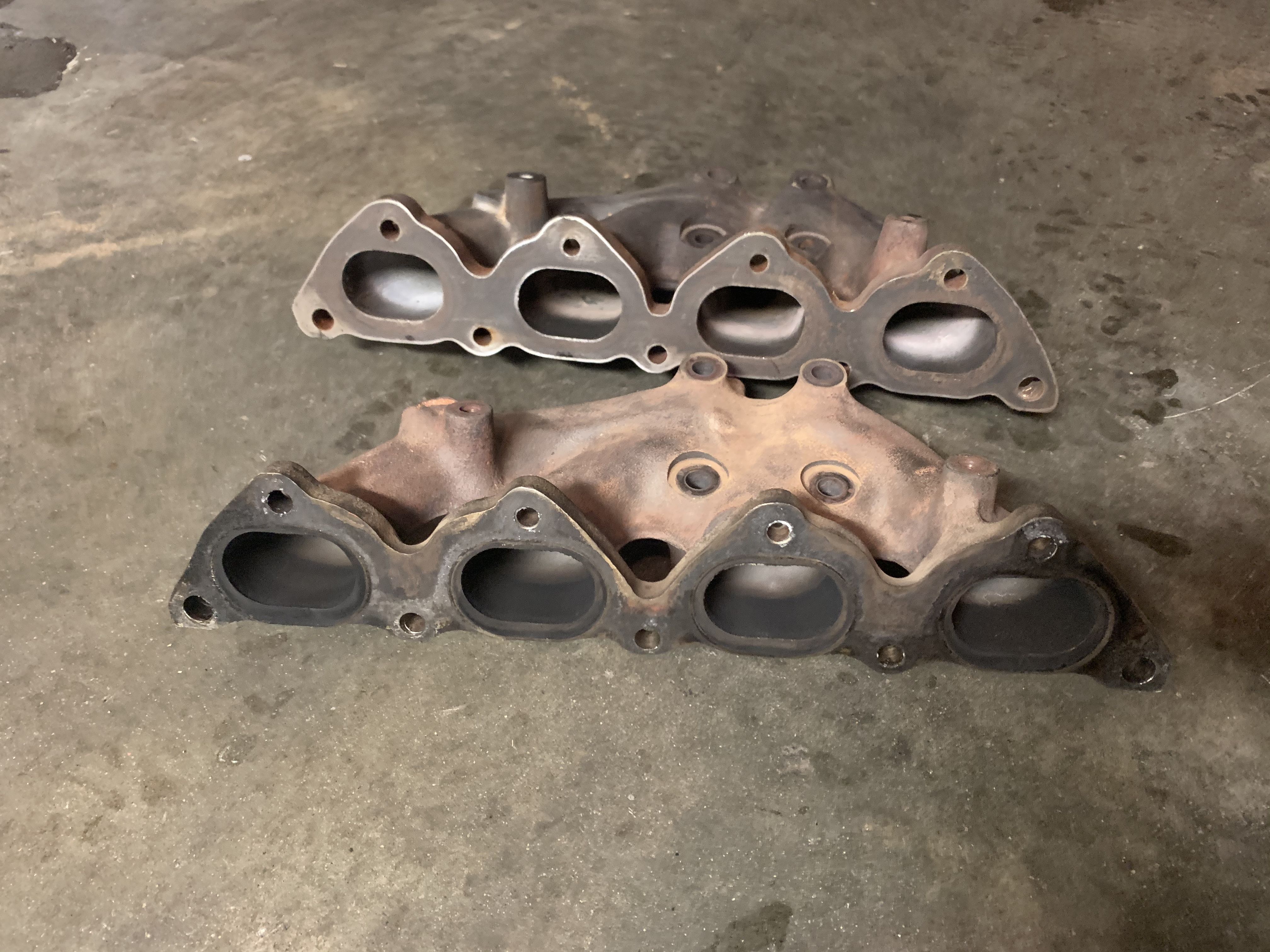

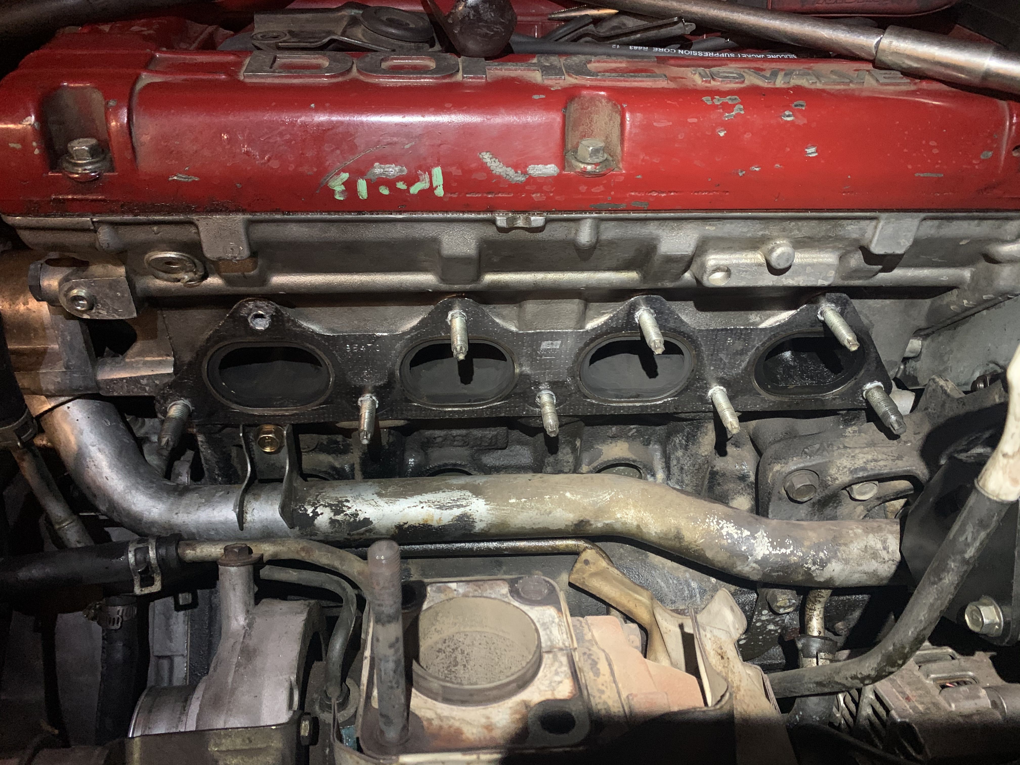

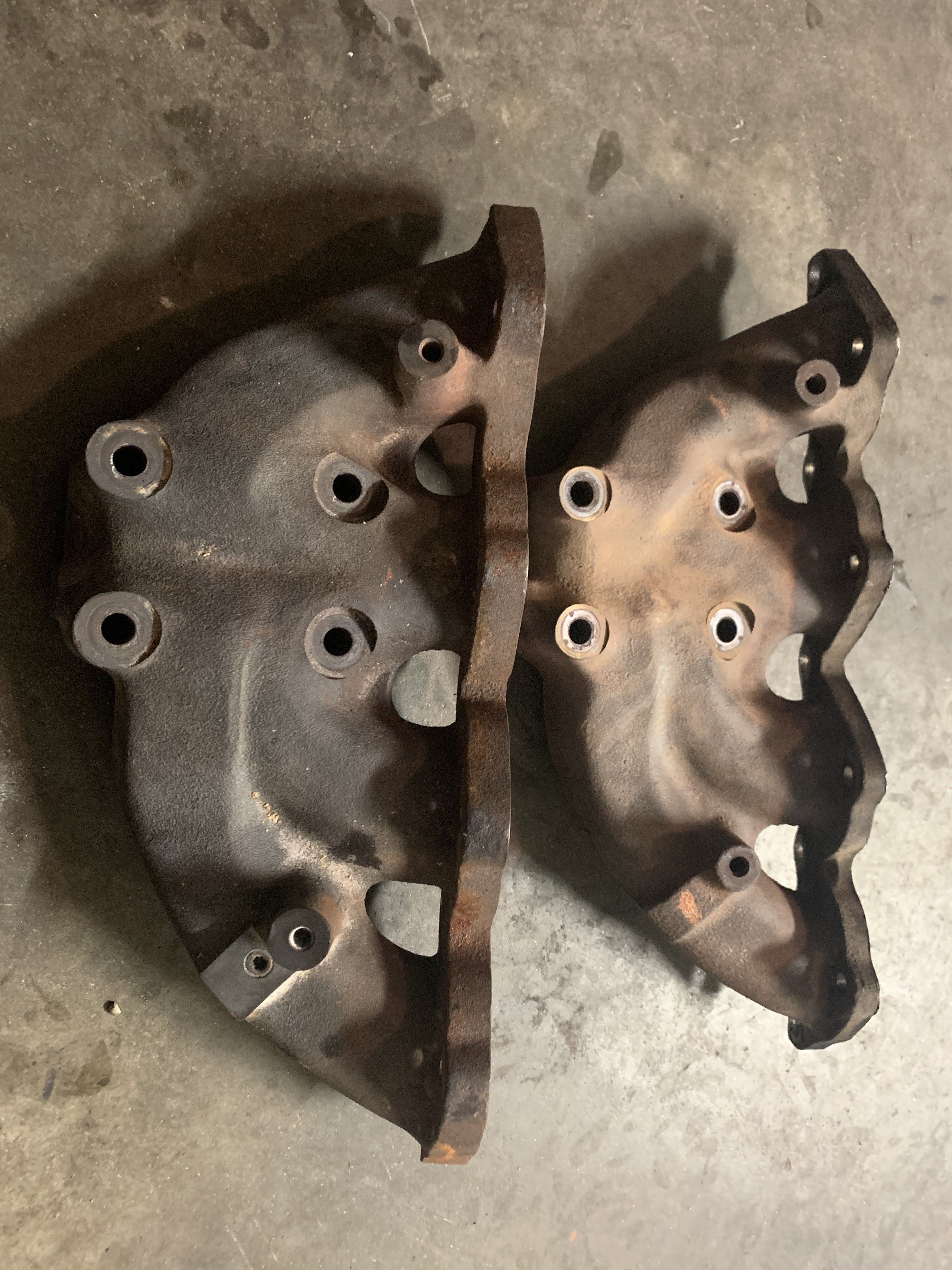

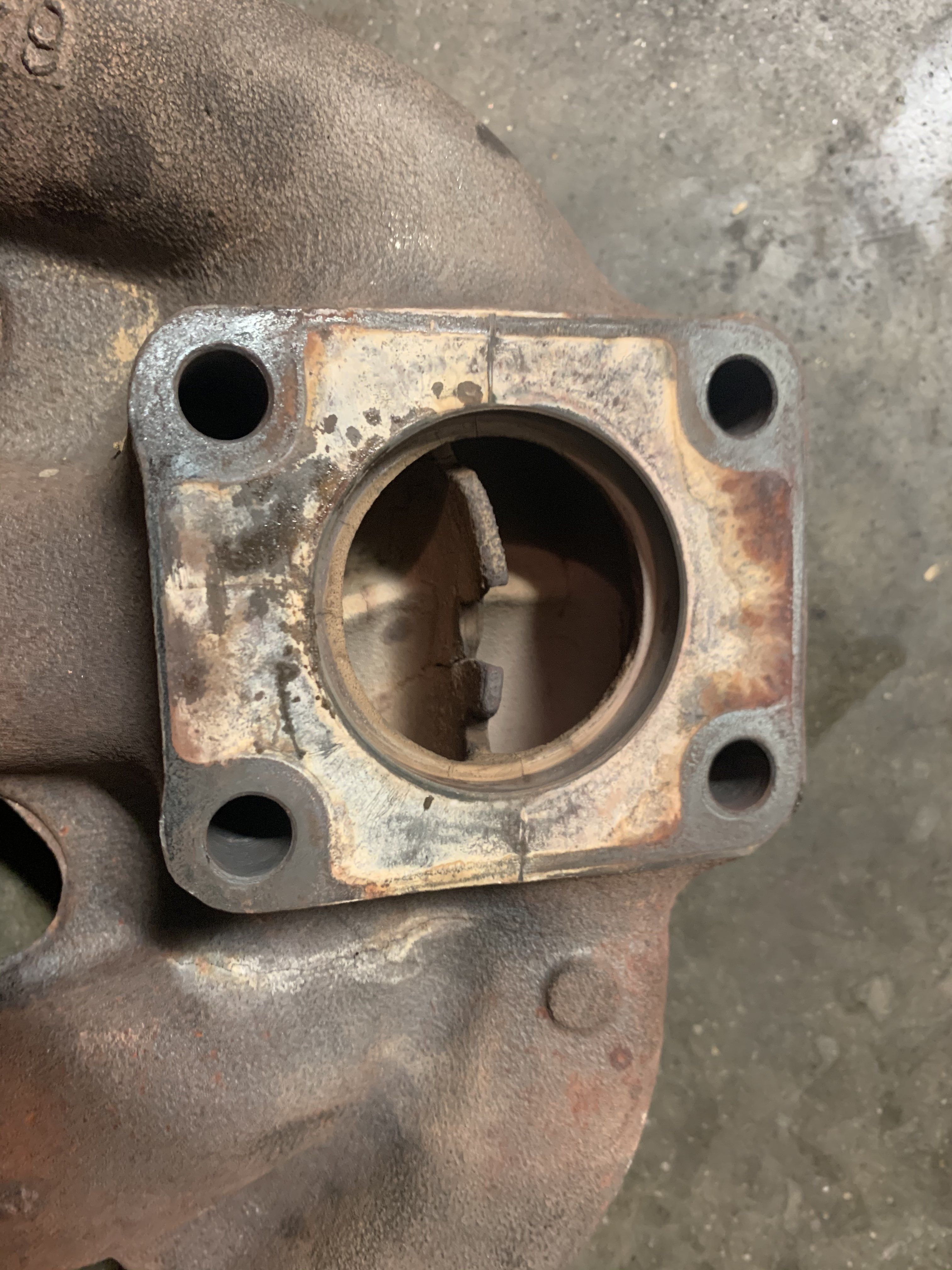

I got the head but found a huge leak on the exhaust manifold gasket (head to manifold).
I replaced the gasket and it keeps leaking so I replaced the manifold which end up being warp on both sides (head and turbo side).
The gasket from manifold to turbo was cracked and leaking as well, here are some pics.

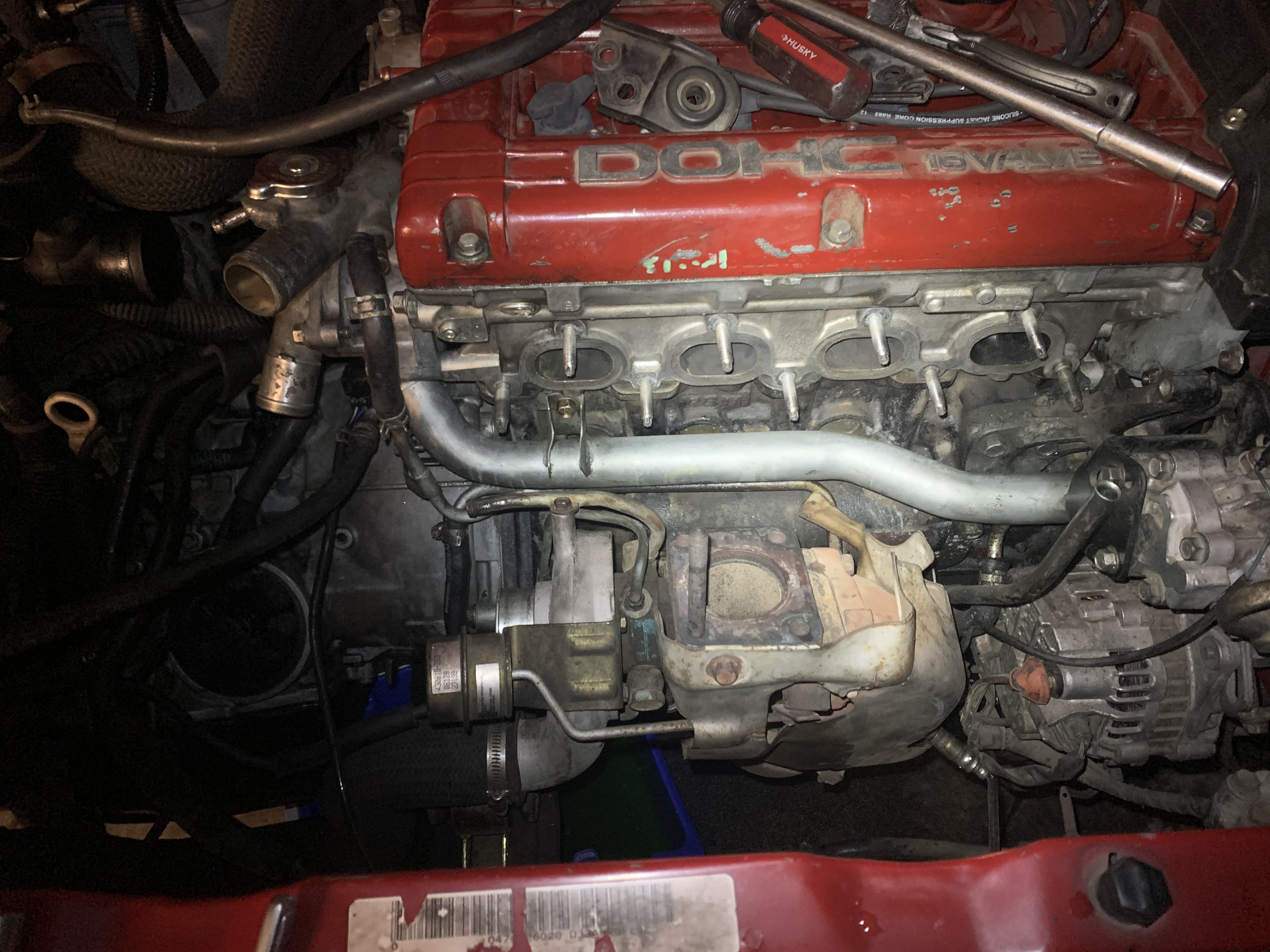

I swap the manifold to an EVO3 that I had laying around and a ss gasket.

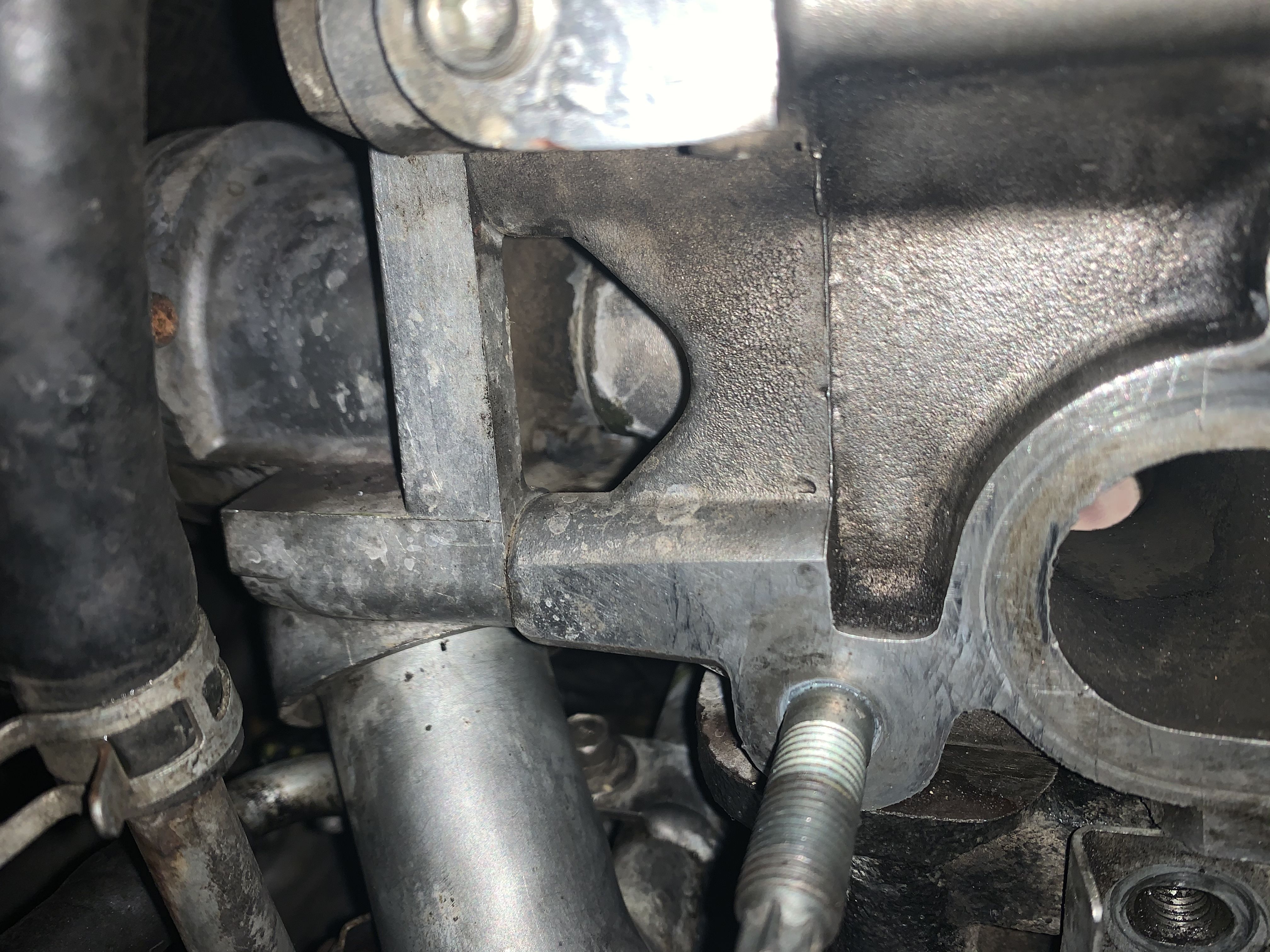

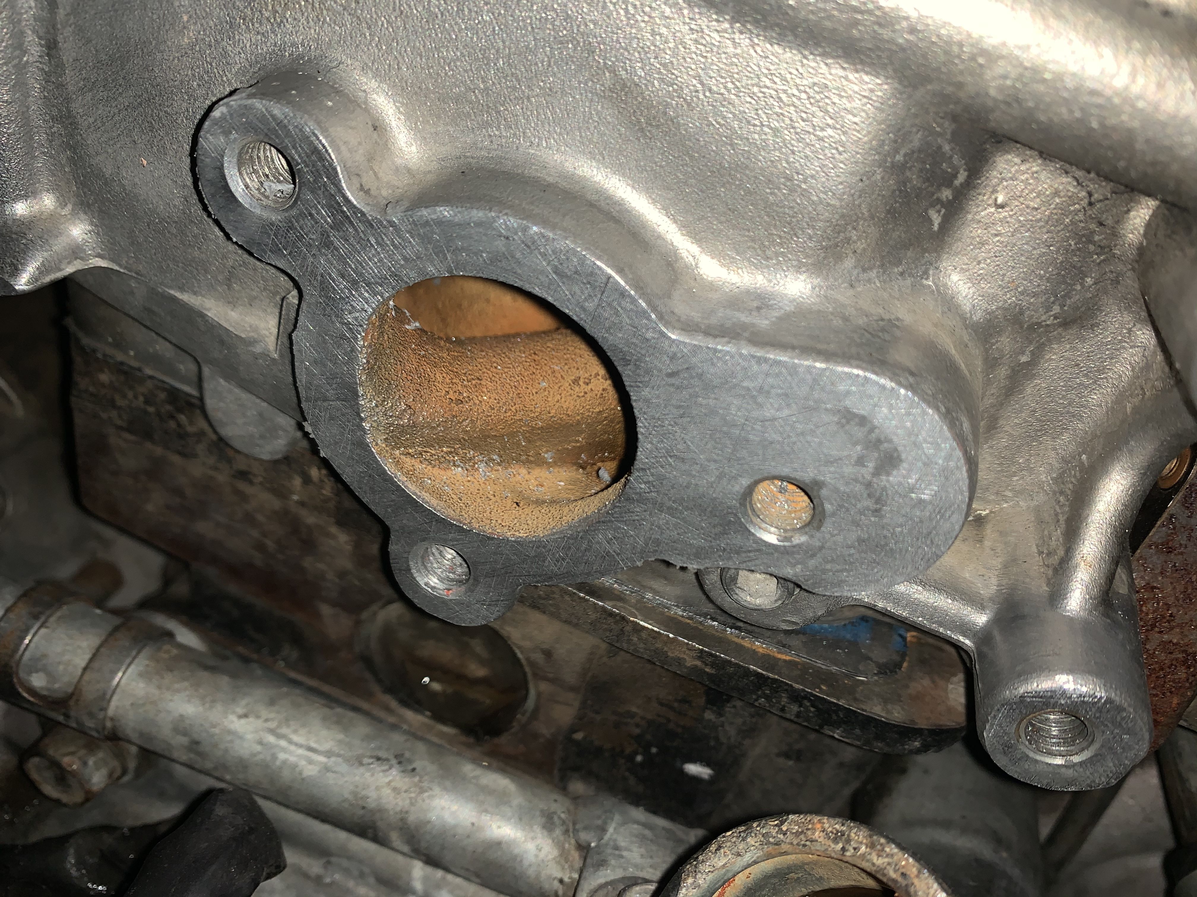

Did a little clean up before putting the manifold and trace a coolant leak it used to have,
You can see the leak it used to have between the head and thermostat housing.
I know, I fixed the head gasket, but it kept leaking from that area,
So I will get the housing off and sand it to straight up.
Here is the way it was before the cleaning.
I seafoam it from the factory boost nipple, at the intake which is light up to #1 Piston.
I couldn’t rive it up for a longer period of time to remove everything, BECAUSE
The fire department came thinking there was a fire in the hood, so we all were looking to see where the fire was at, Yea yea Yea, Even me knowing it was my freaking car, I had to let them know I didn’t know where the smog was coming from.
Good no one was outside when the car was smoking and when everyone came out to see, I had the car off, so after all that happen, I couldn’t turn on the car anymore, so that’s why I start tearing it down.

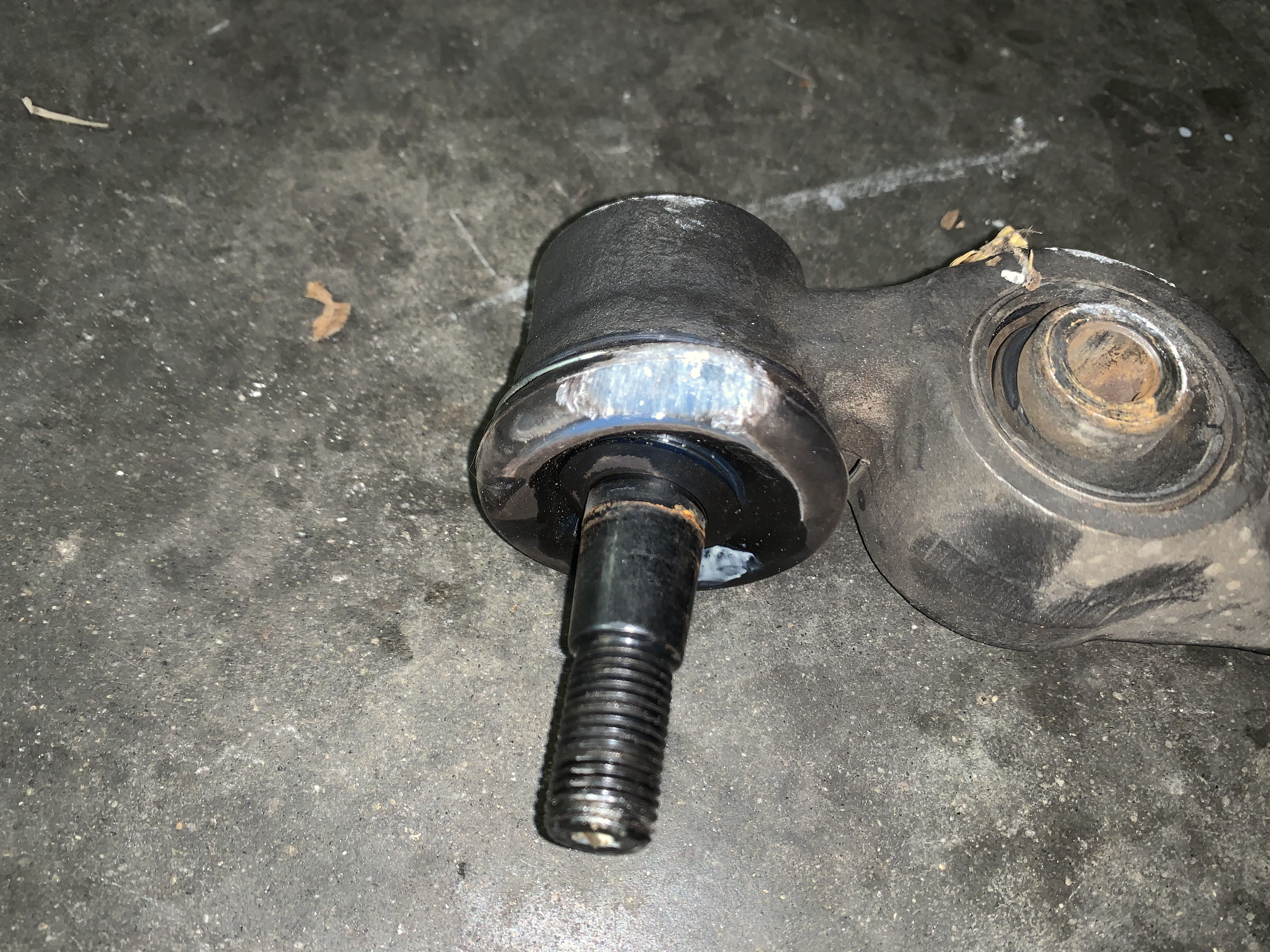

I notes. A Squishy noise coming from the front, well, it end up a ball joint (lower control arm), so I have my Volks tubular arms and Bobby’s upper arms and decided to put them on my weekend car and the once on the weekend car put them on my daily.
Here is a proof of the squishy noise
I replace both, upper arms with ball joints and lower arms from the weekend to the daily.

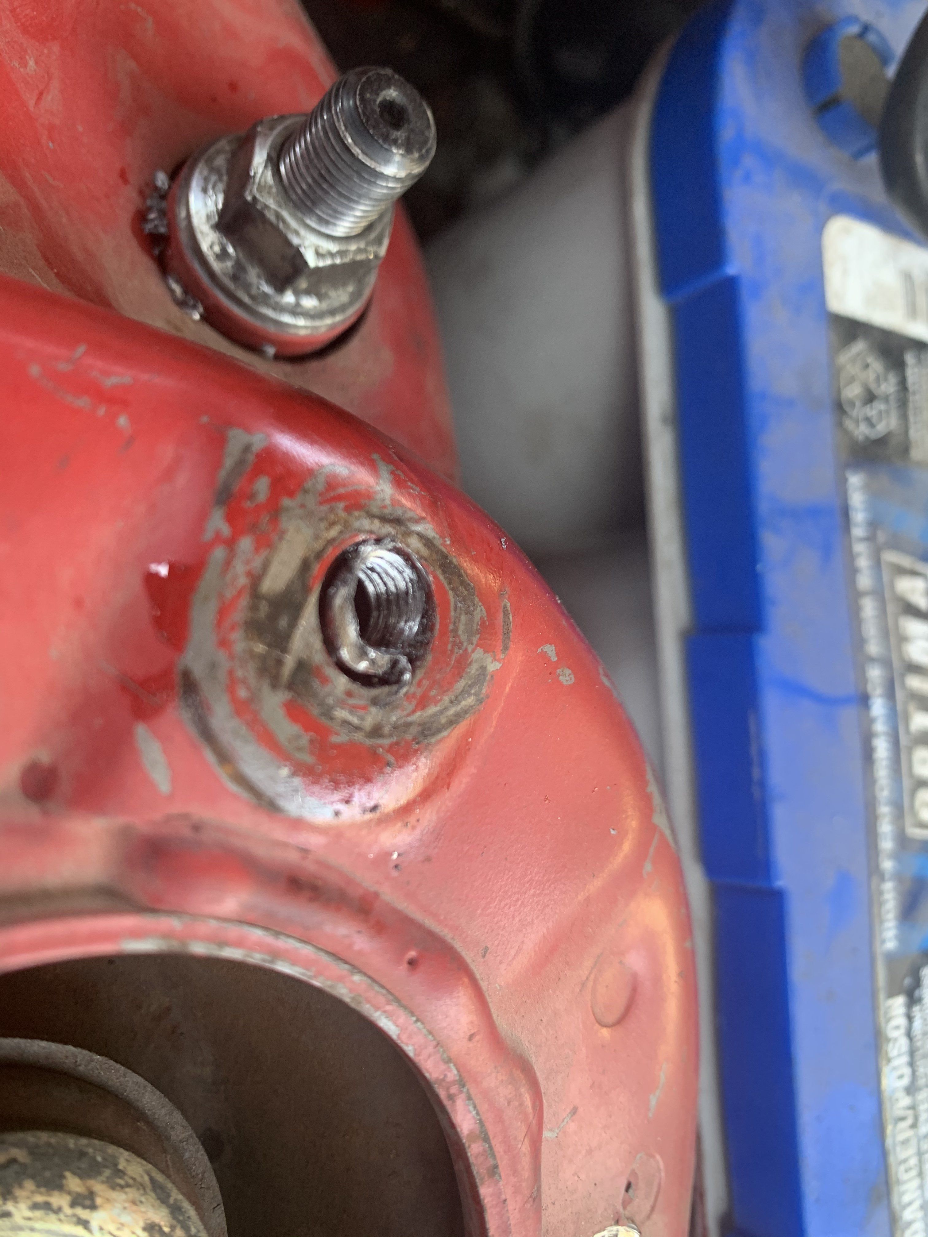

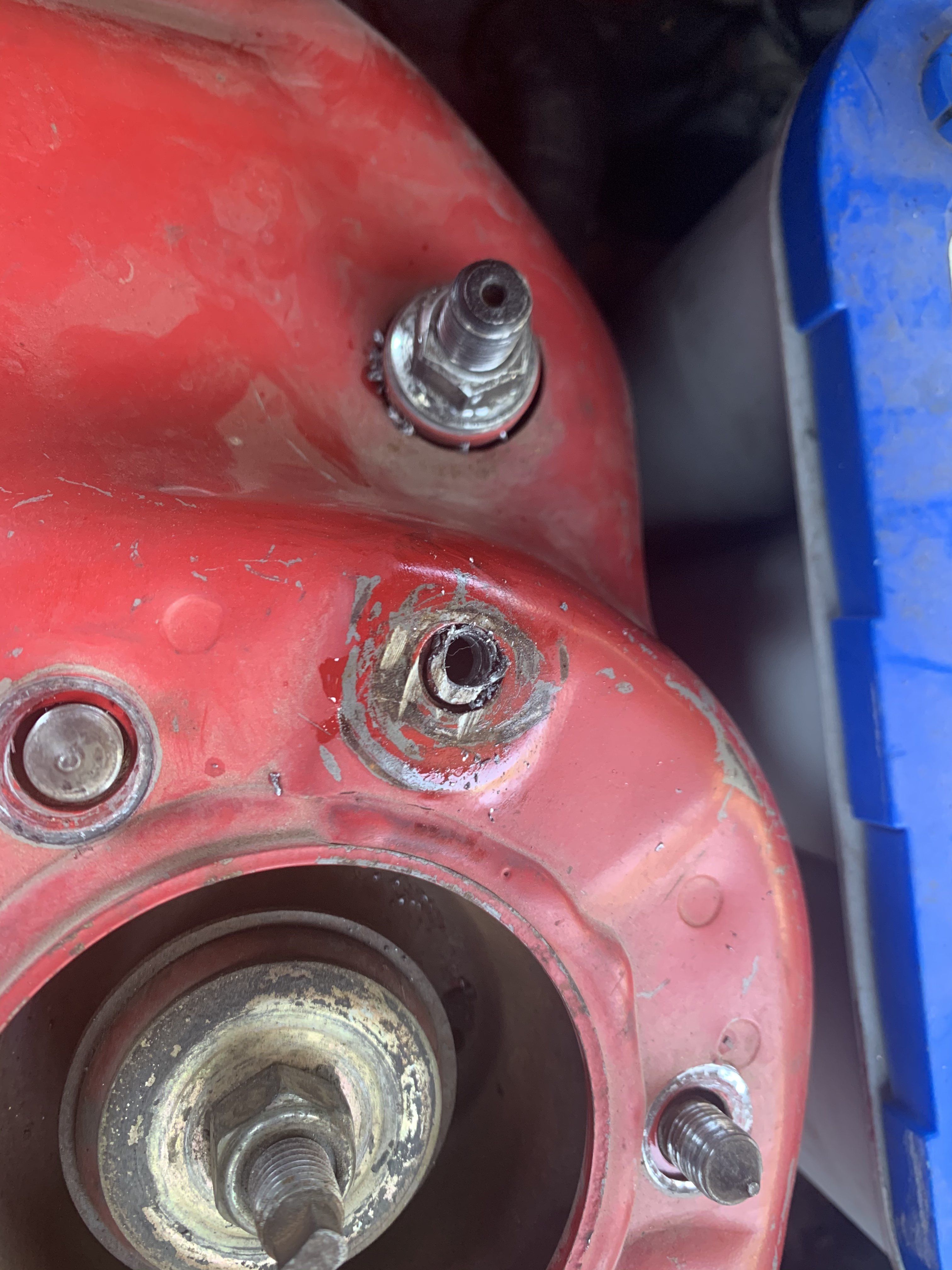

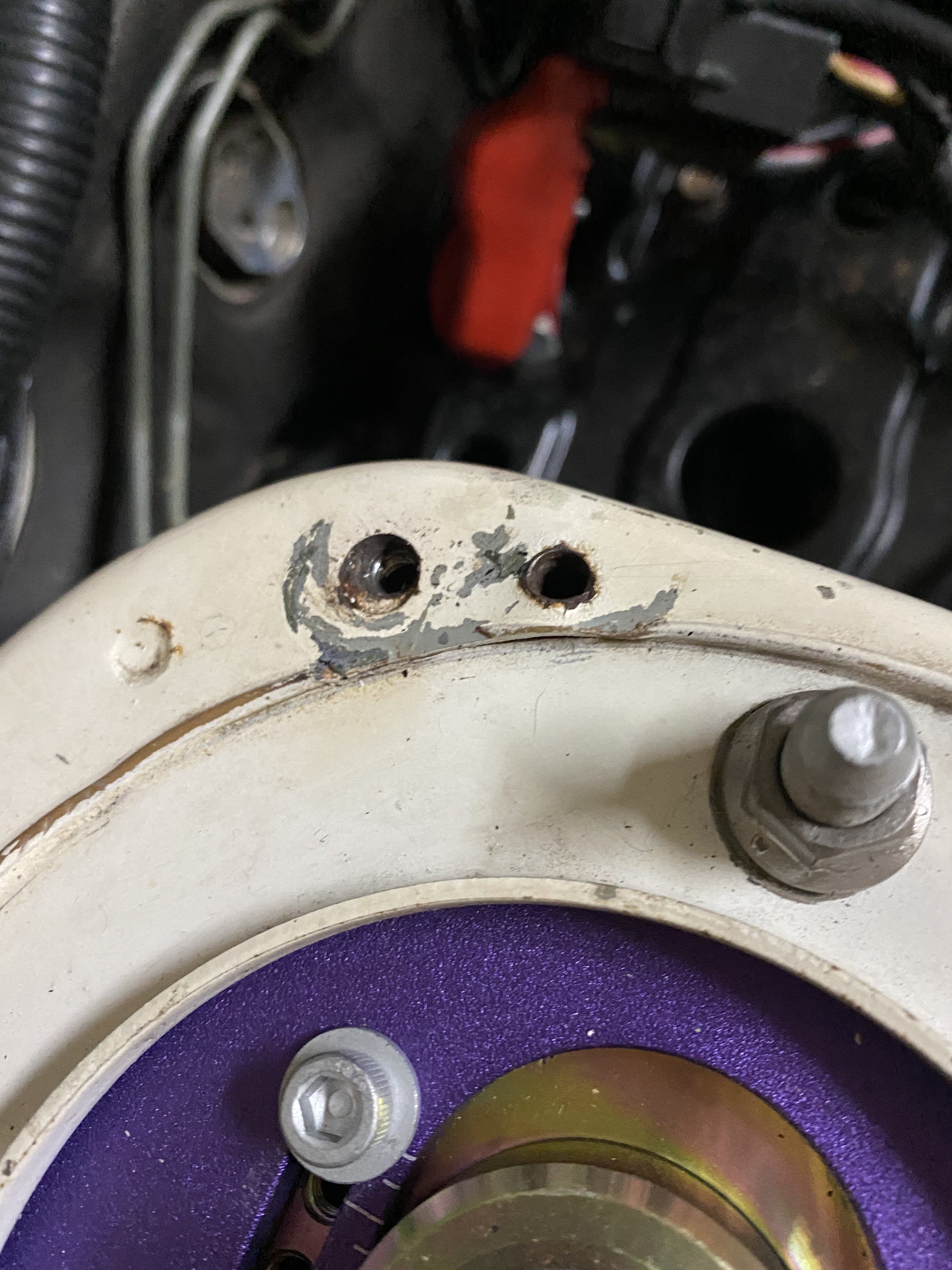

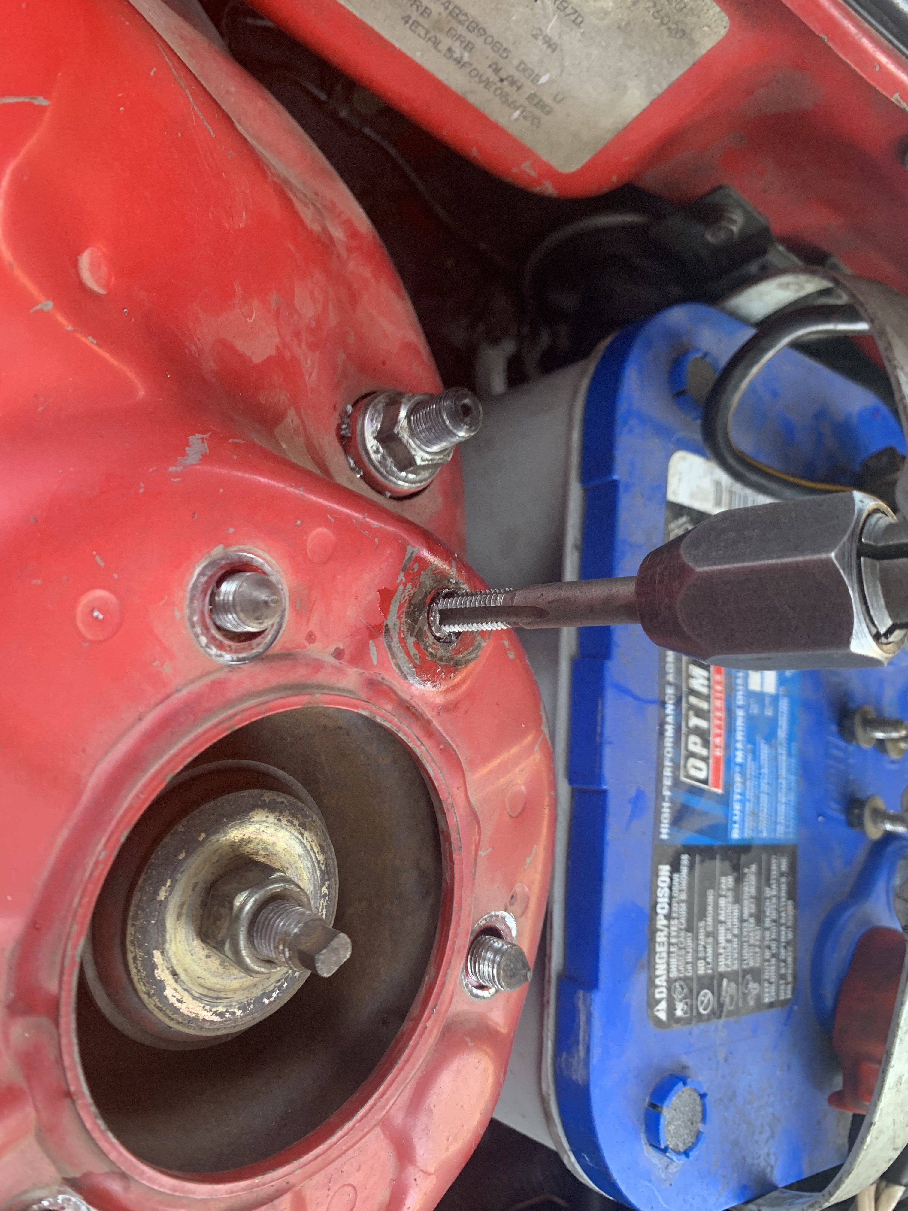

I forgot to mention, the car came with no battery tie down, the bolt was Brocken flash on the tower, so I drill a hole into the bolt and threaded.
The Brocken bolt has achico seat which it has much meat to be able to drill it and thread it, this way I can use a short bolt to tide down the battery bracket.
Here are some pics to describe what I mean and hope it helps for others in this situation.
This is by no means the best way to fix it, it’s just a bandaid.

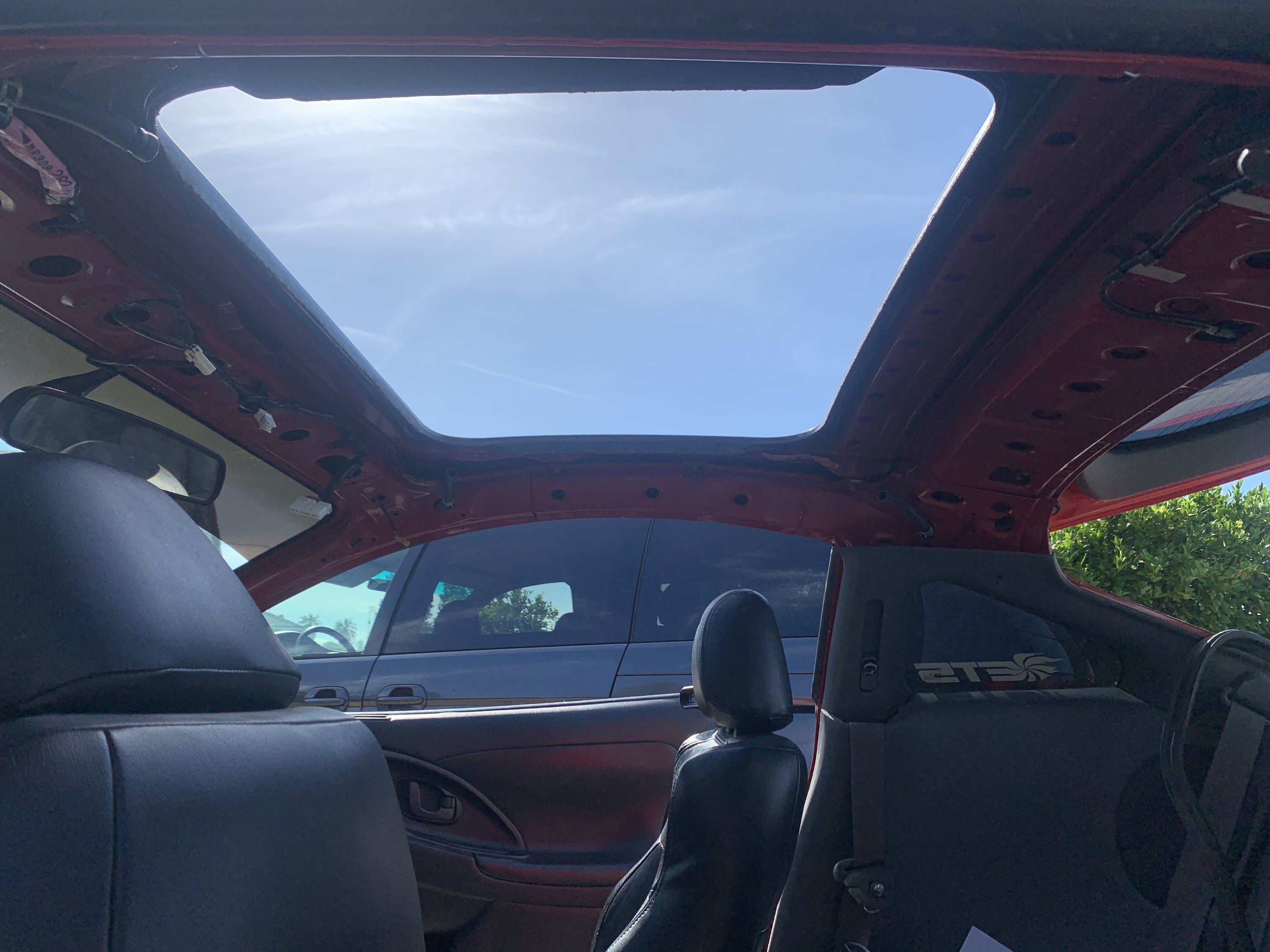

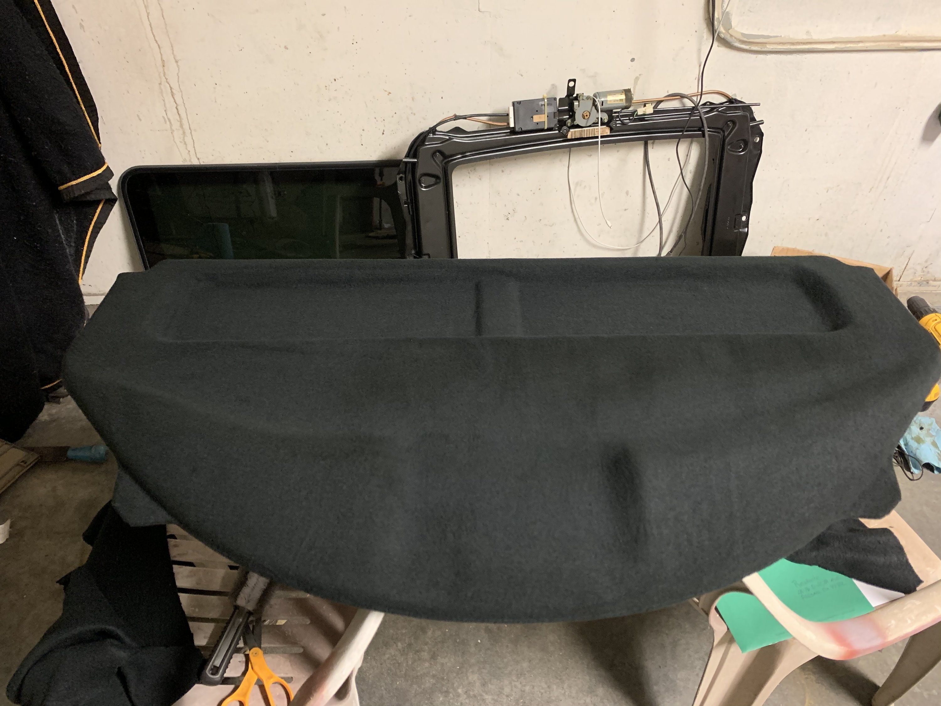

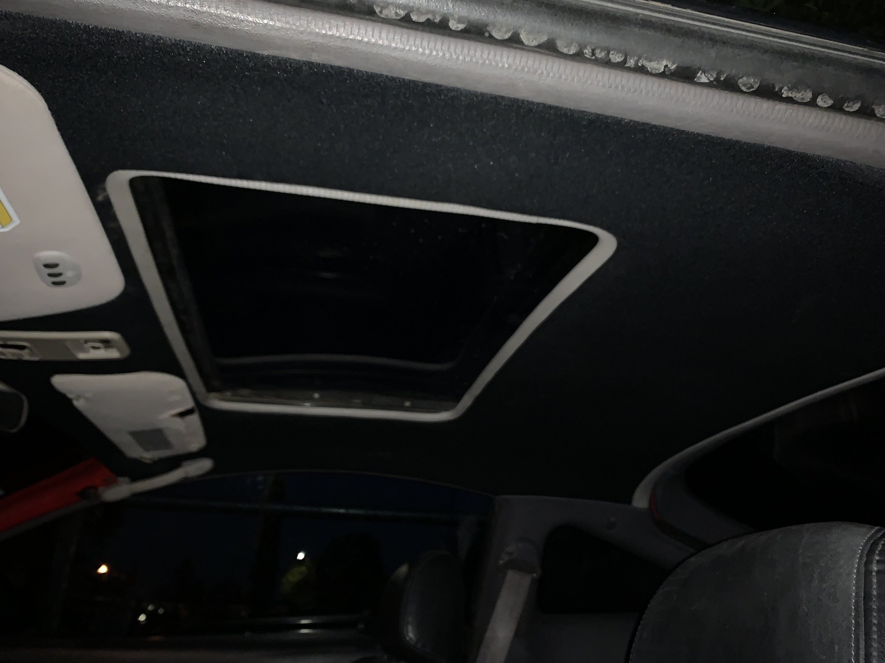

    I spot an avenger in the junkyard with good interior and I took the sunroof and dash, the dash is black so I’m planning to change the interior to black.

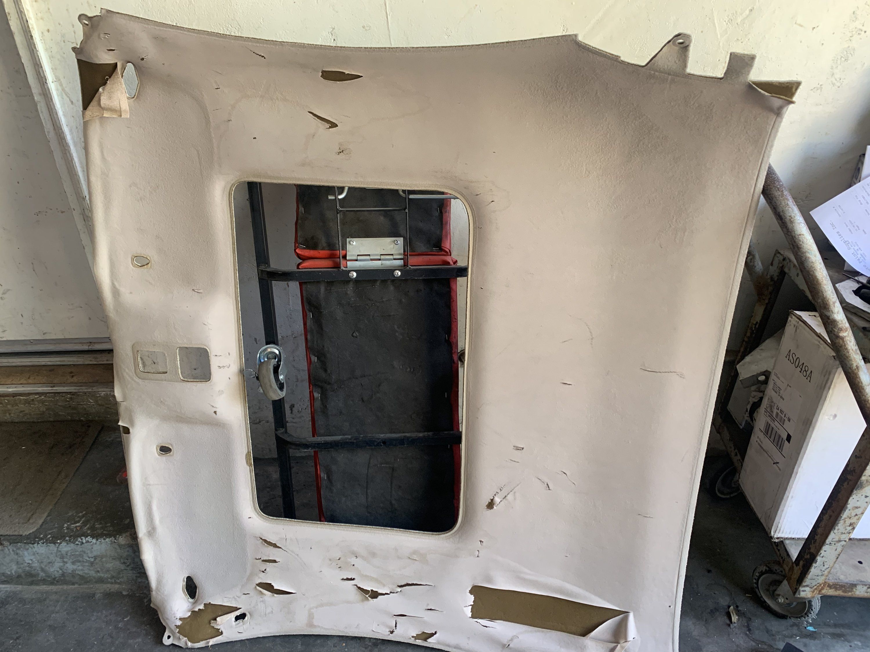

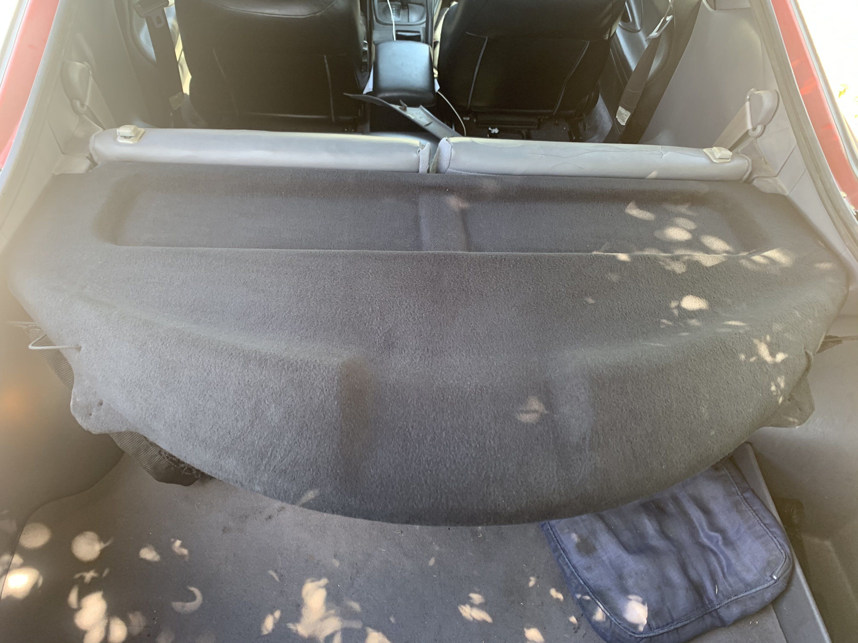

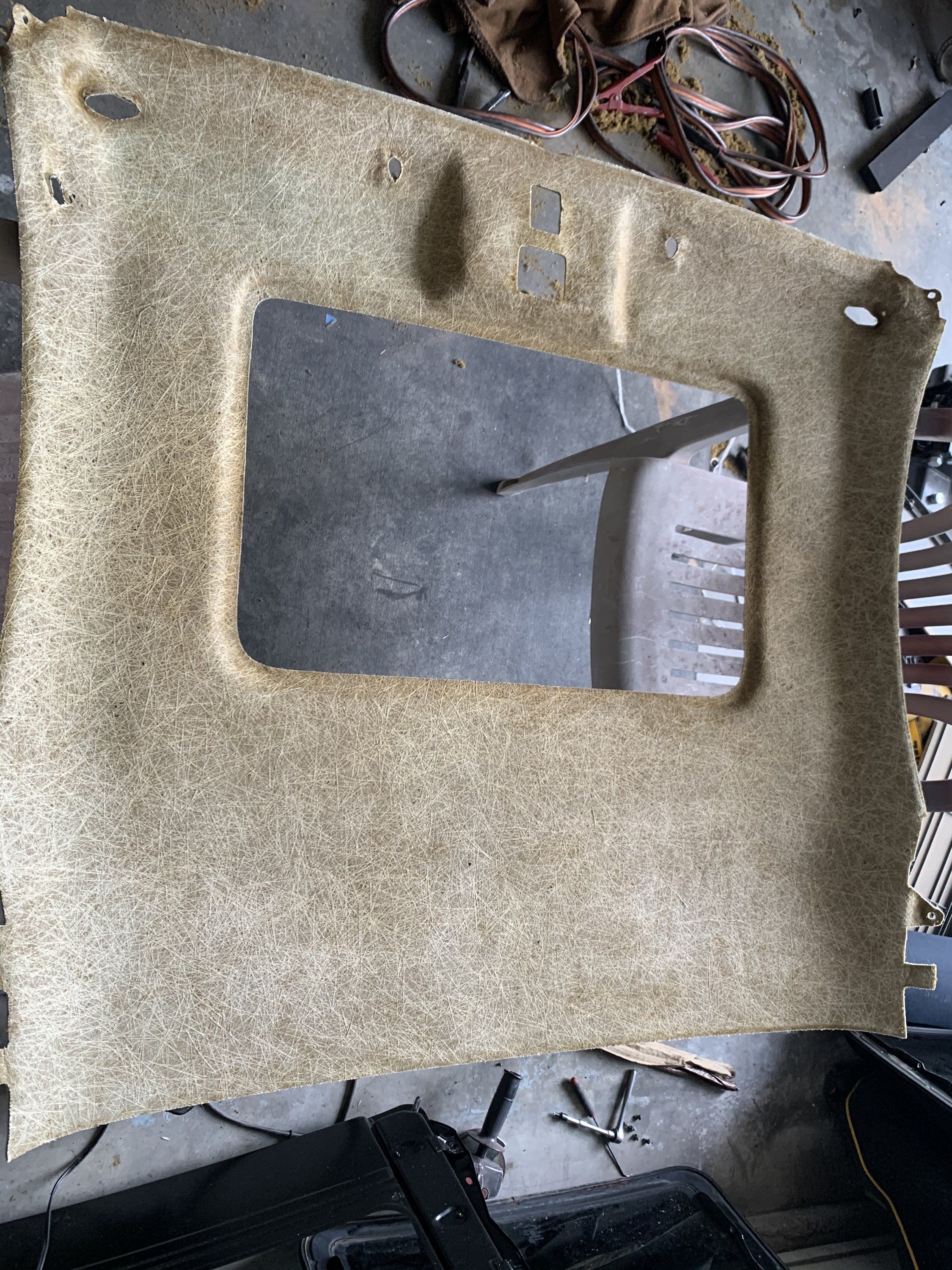

    I removed the head liner in my TSI which was in very bad shape, I got it out and scrap all the fabric off and replace it with a black one.
    Here are some pics of the process.

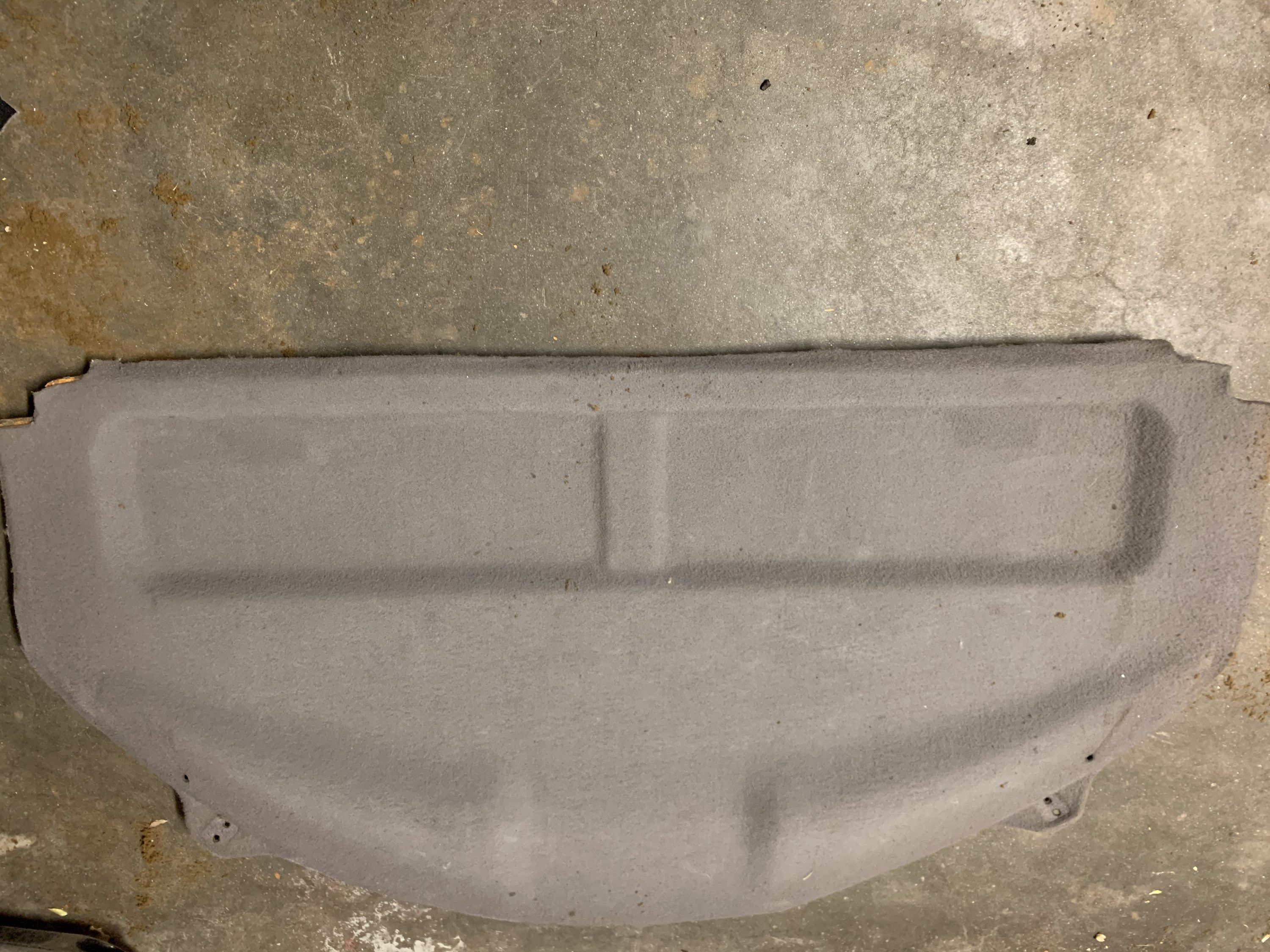

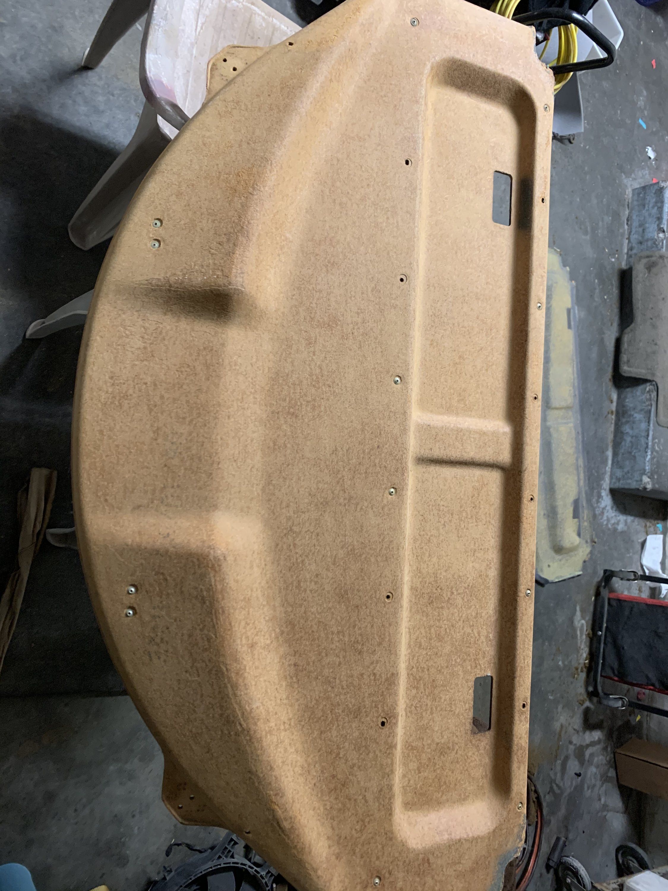

  • I also did the cargo cover as well now that I had all material handy.

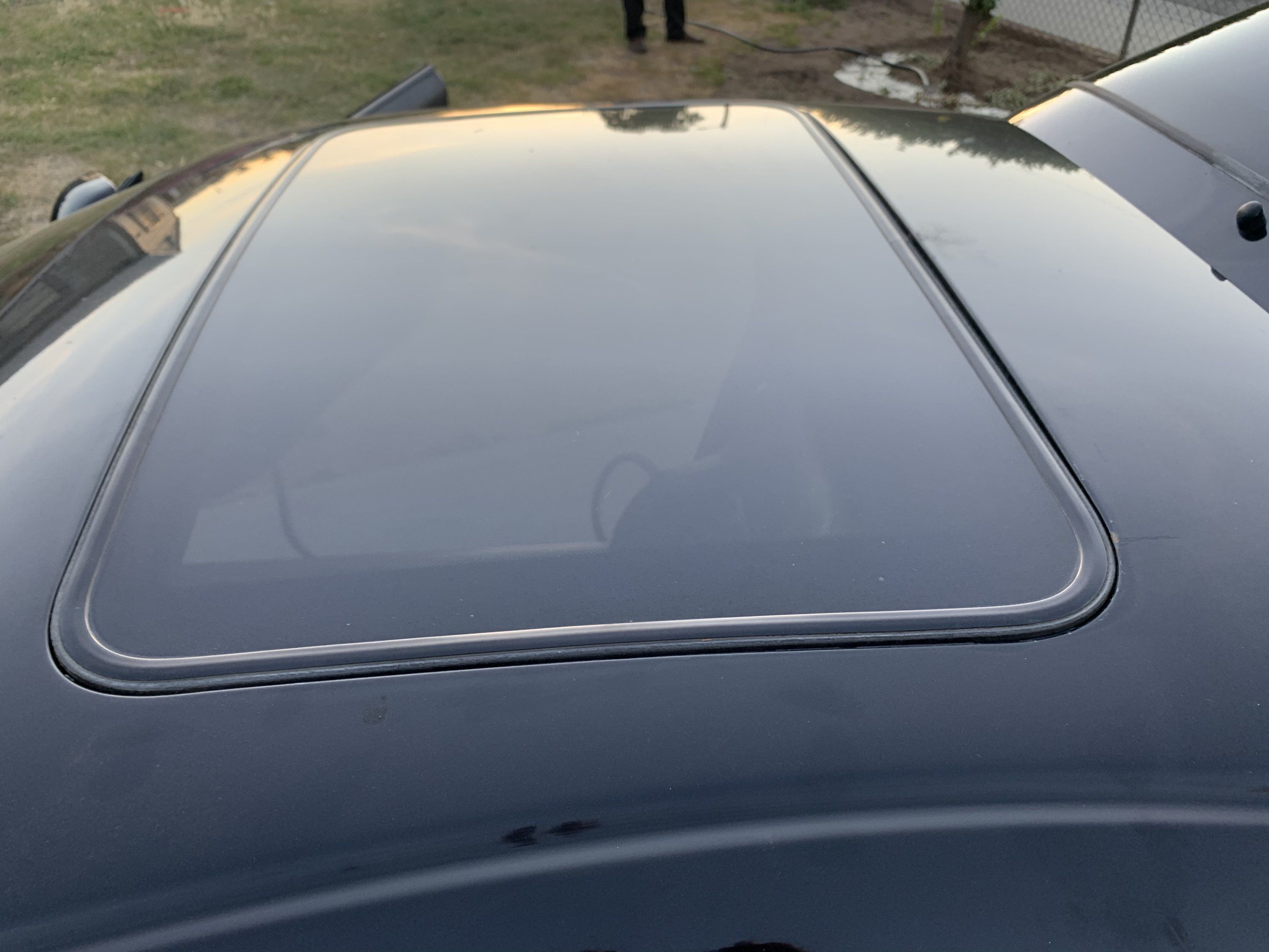

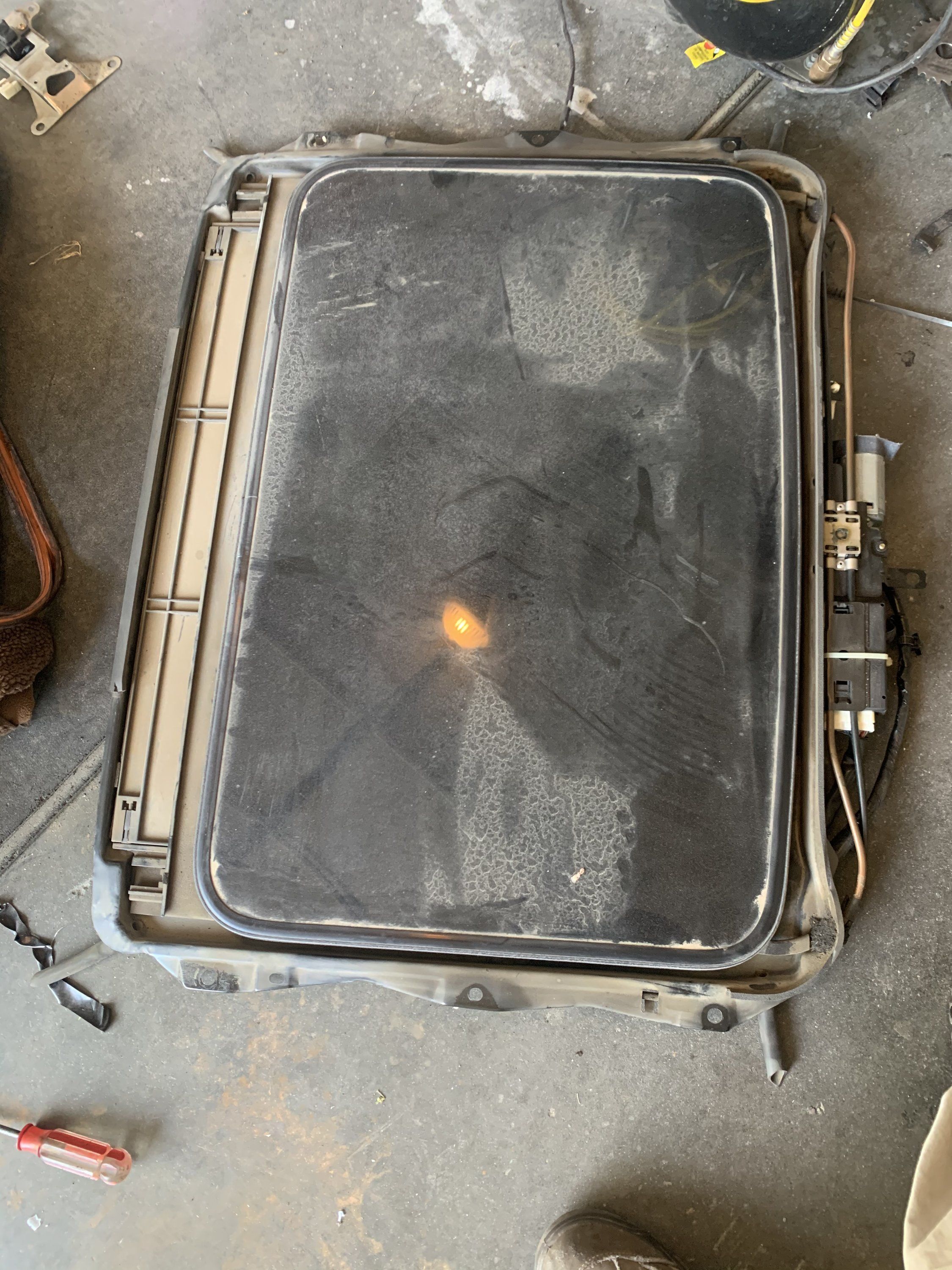

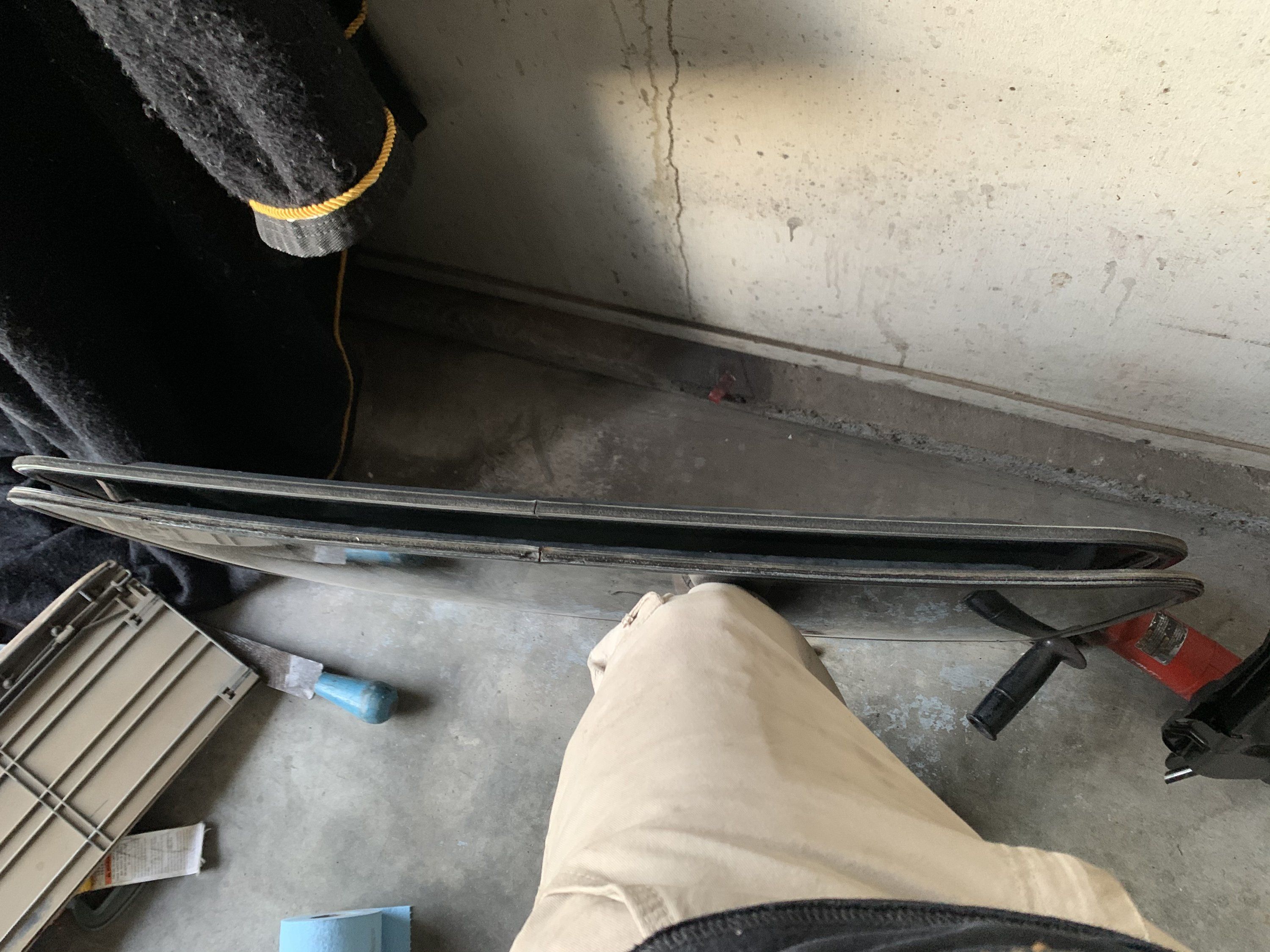

  • So now having the sunroof handy as well, it was time to fix it, It was broken and couldn’t open it up.
  • Here is the finish look, I couldn’t be more satisfied with the results.
  • Now, just for the record, I have read a bunch of threads the avenger sunroof fits the dsm, but not all works, the sunroof armature is the same as the dsm BUT, the sunroof glass is a bit different, it has the same dimension as the dsm but it is flat from the rear end. The glass seats lower then the dsm and the dsm angles a bit on both rear corners,
  • Here is a pic comparing both, the one on top is avenger and the lower one is the dsm., you can see at the corners how the dsm angles a bit making the center section of the window to be taller.
