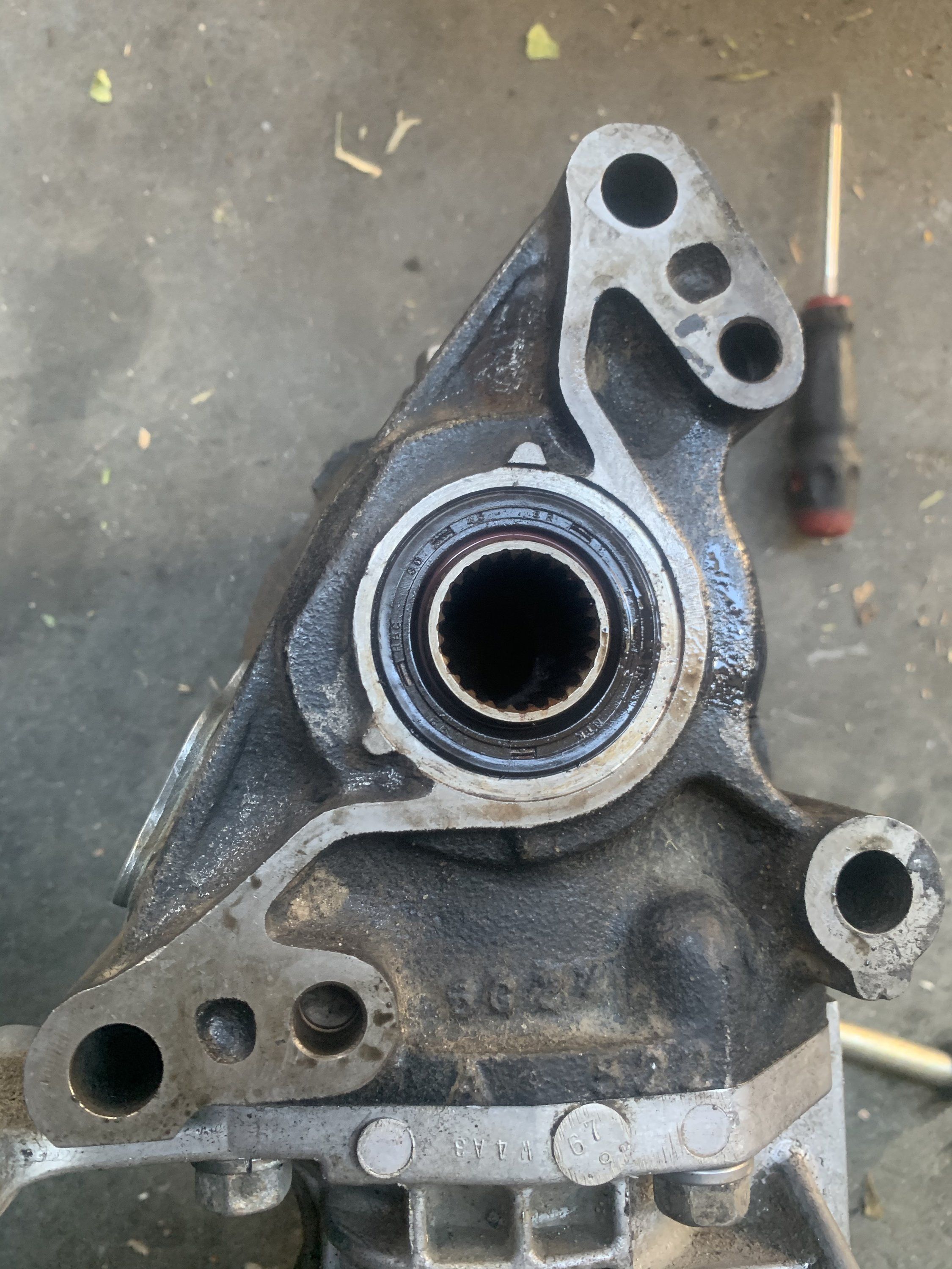

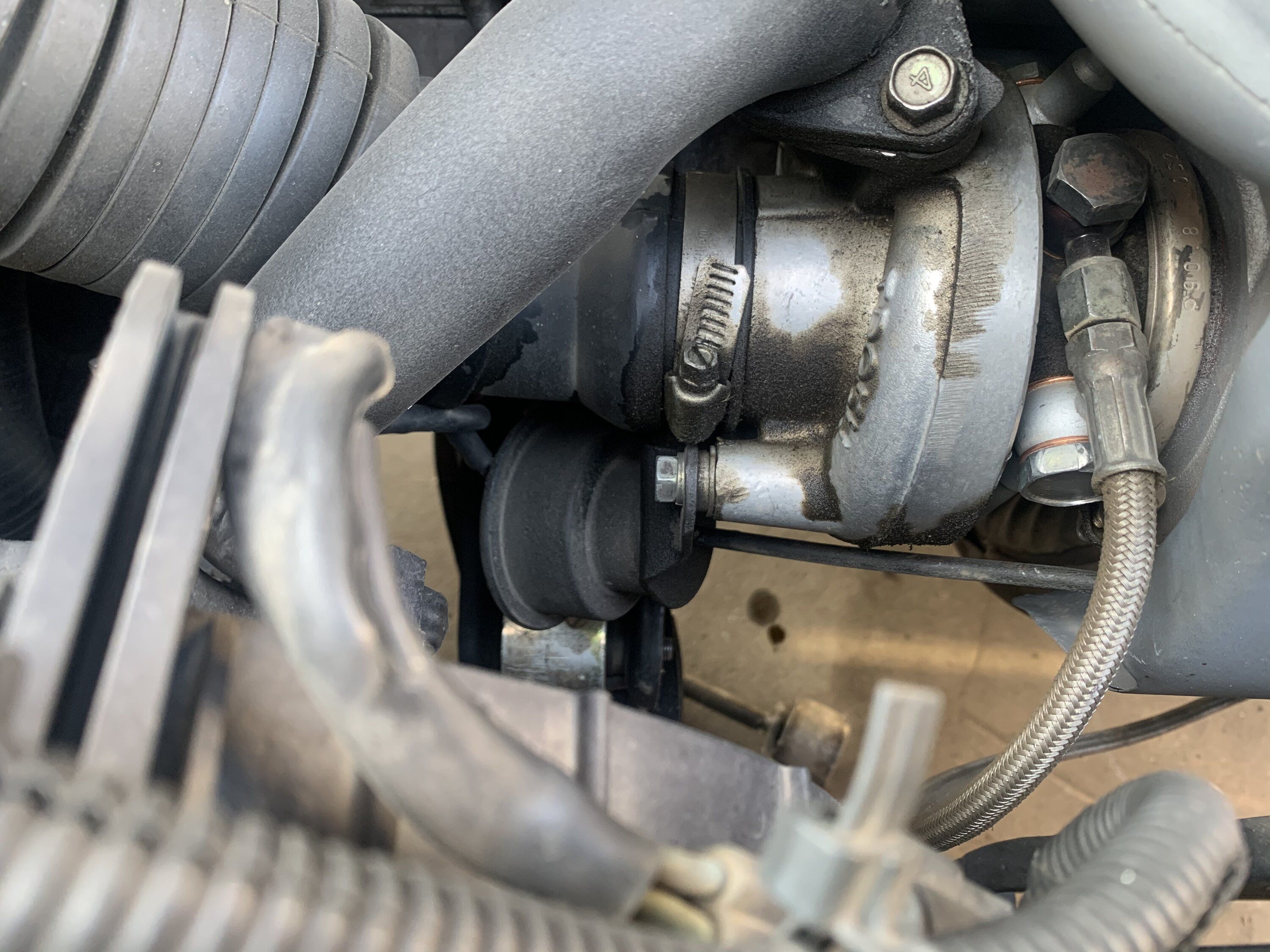

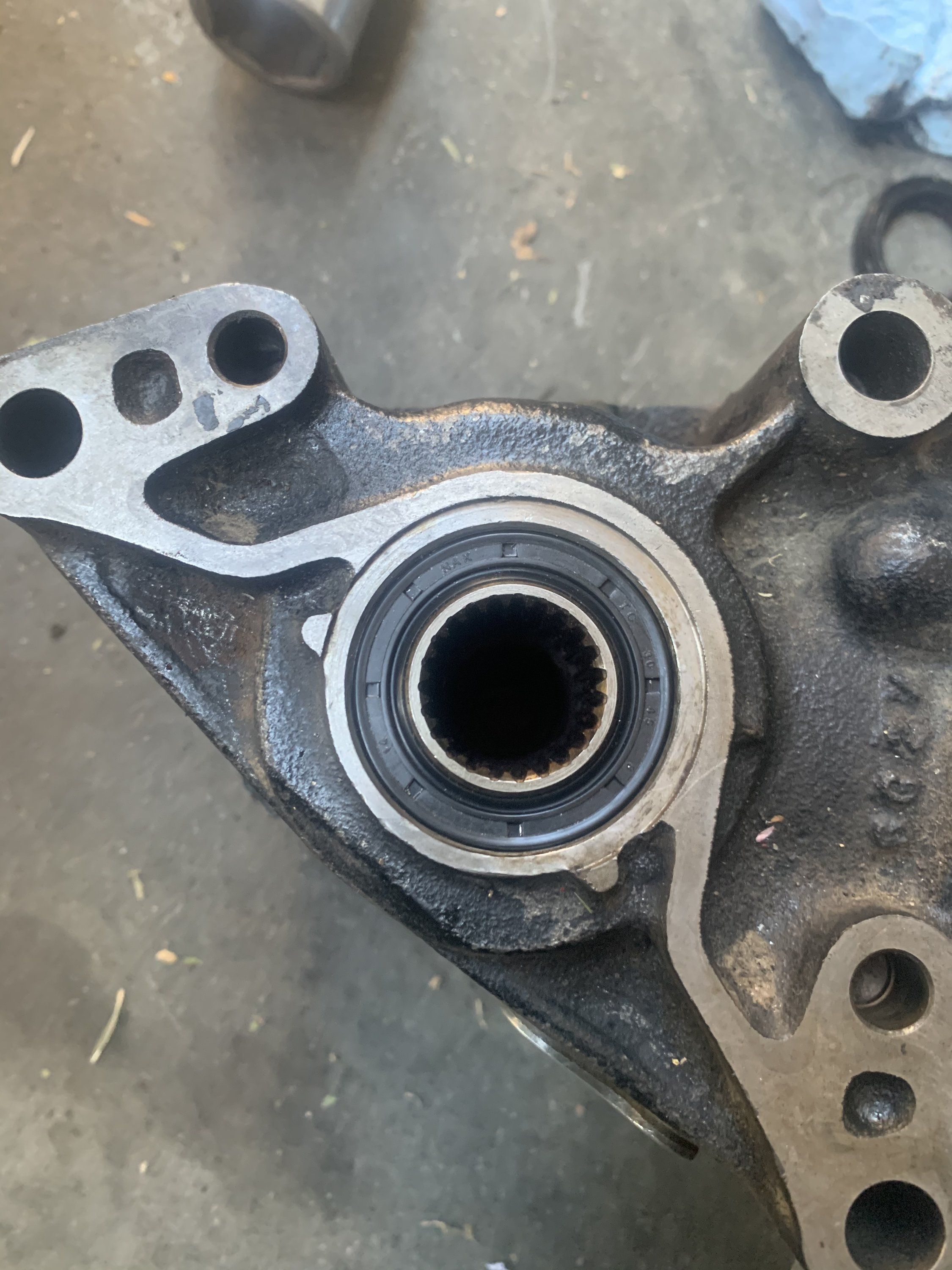

The leak is from the transfer case, When I reinstall it, I add some shockwave oil which is orange, and the oil leak is orange, the oil is clean and I can tell very well is transfer case oil.
It’s the seal where the input shaft goes in to the Tcase, you can see in the pic the wetness between the Tcase and transmission, I will change the seal and get the outer shaft seal replaced at the same time to make sure there will be no leaks in the future.

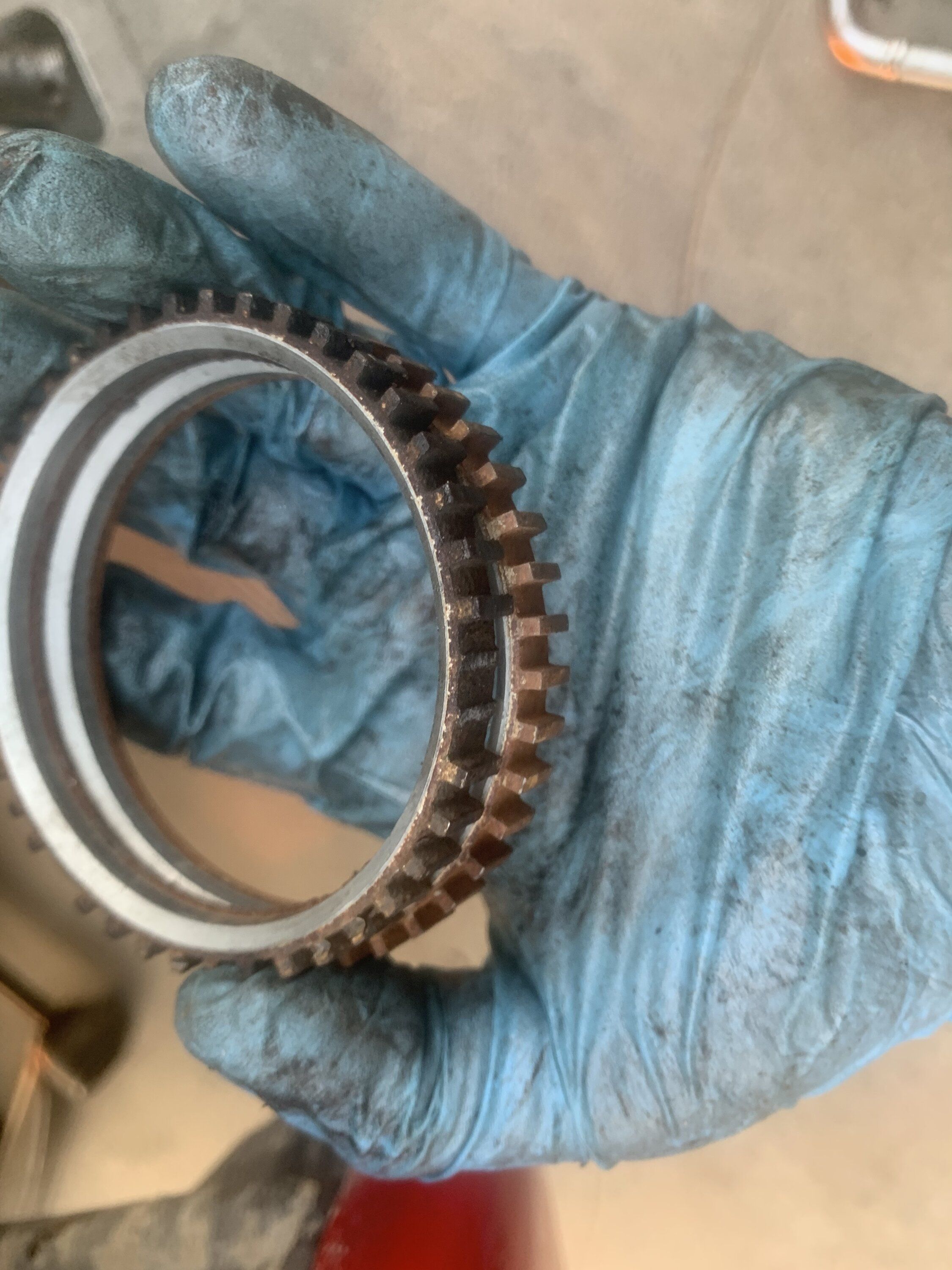

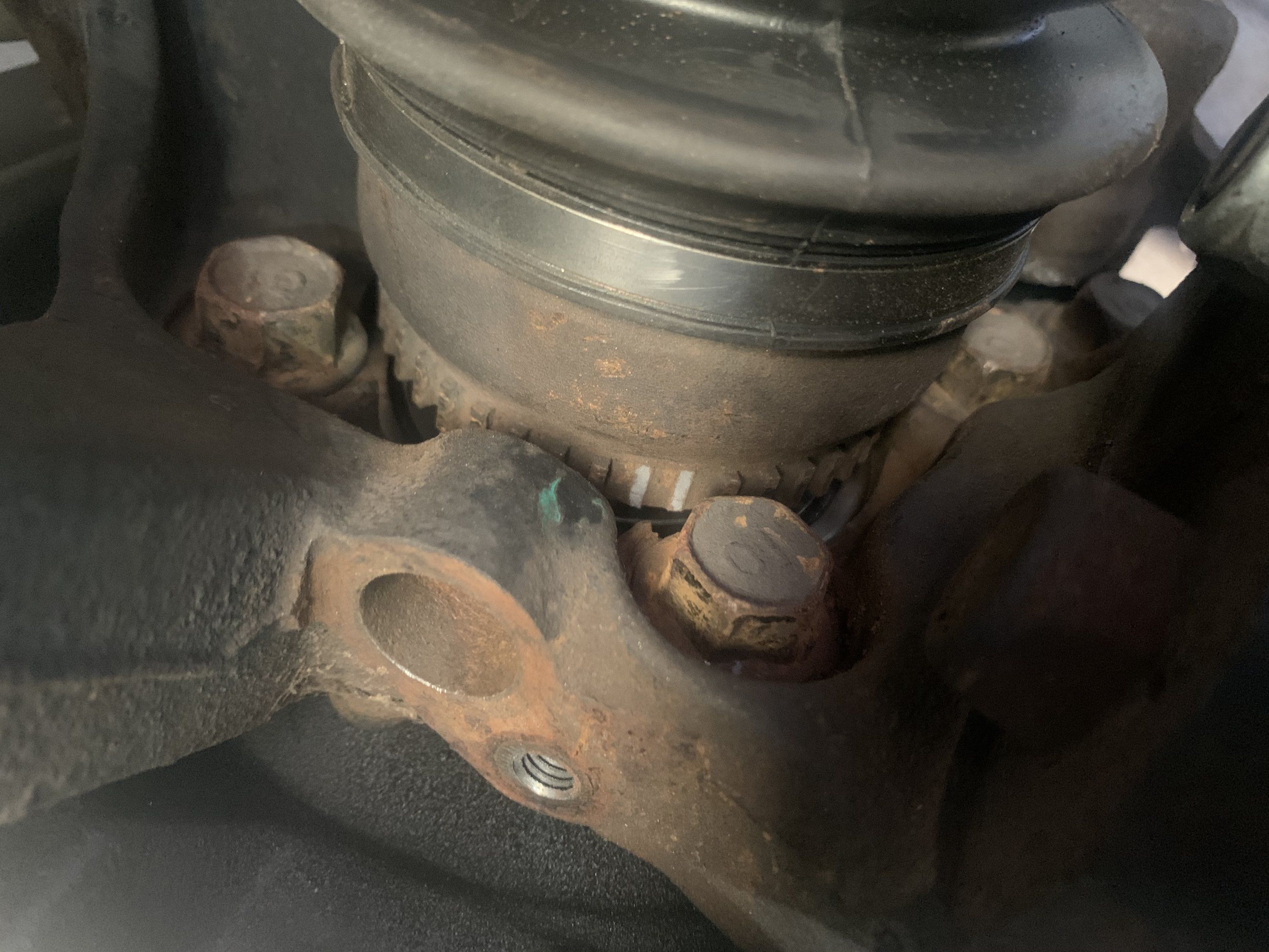

I still have the driver side brakes acting up and figure out, it’s the abs system that kicks in below 20 mph.
I went to clean up the abs sensor and I found what was the problem, the gear ring that goes around the axle broke 3 teeth, the abs is catching that and thinking the tire is turning slower or better say, it’s slipping and the abs system kicks in.
I removed the abs fuse, took it for a spin and the problem disappeared.
Well, now to the search for a new axle gear ring to replace it.
I will use it as is with the abs system disabled for now.

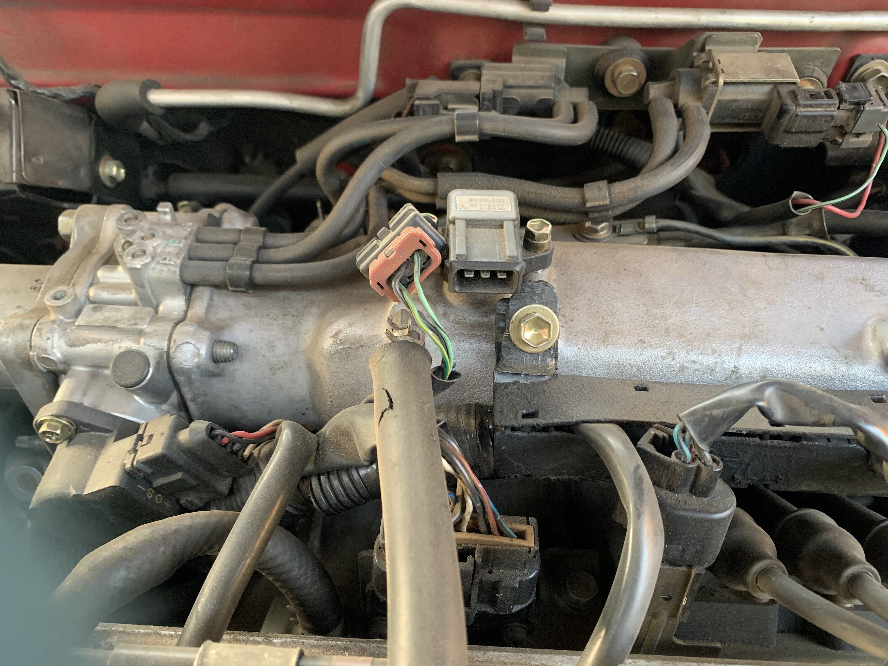

BIG THANKS TO 98 DSM WHO DONATED THE BRACKET and contribute to the build. I appreciate the effort to look for it and send it to me. And at no cost.
Here is a comparación between both. You can see the provision it has for the knock sensor connector.
Here is how it seats now, I can see the connector in there:tease:

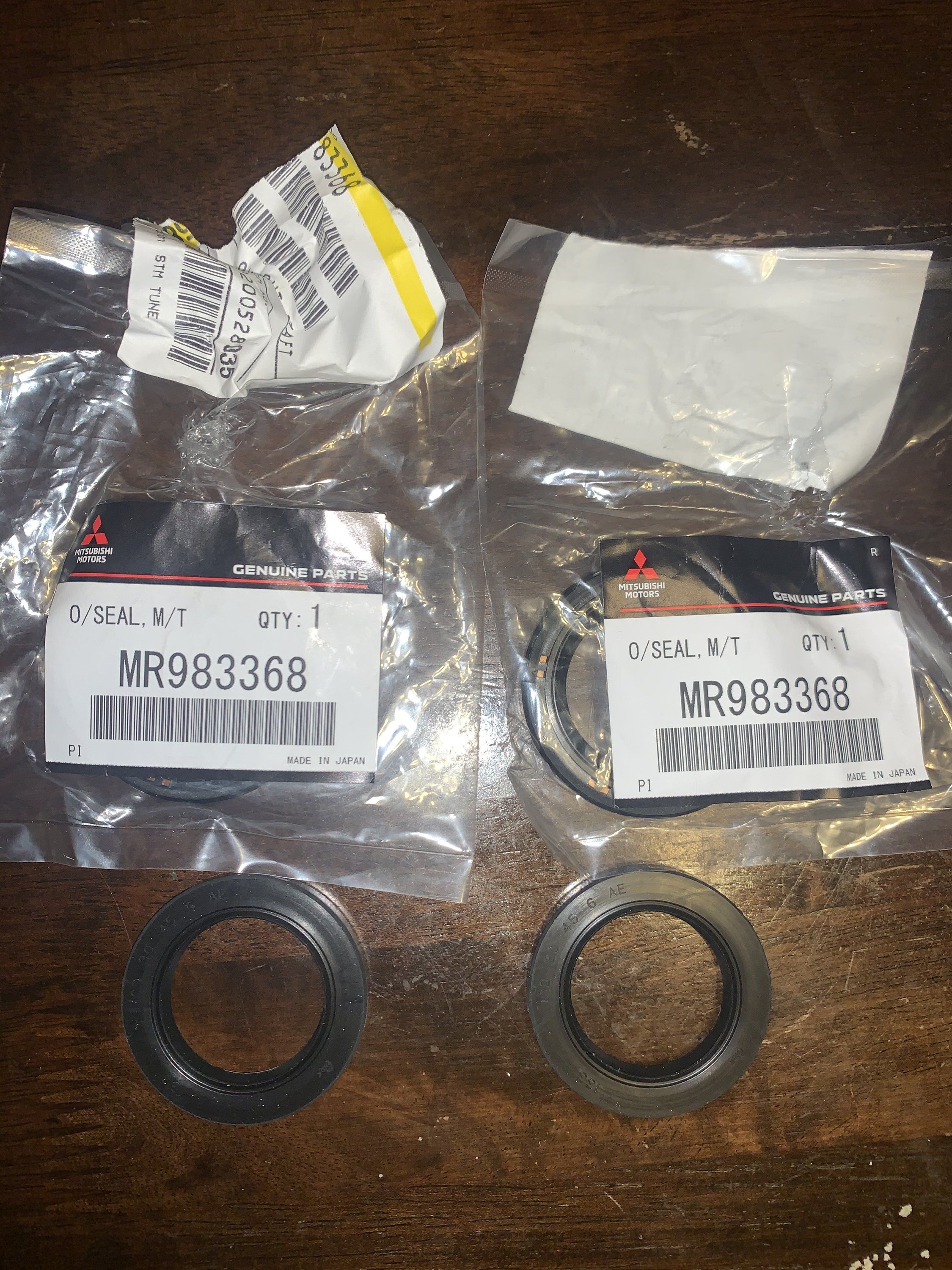

I ordered two sets of seals for the Tcase, I replaced both seals and save a set for the other car.

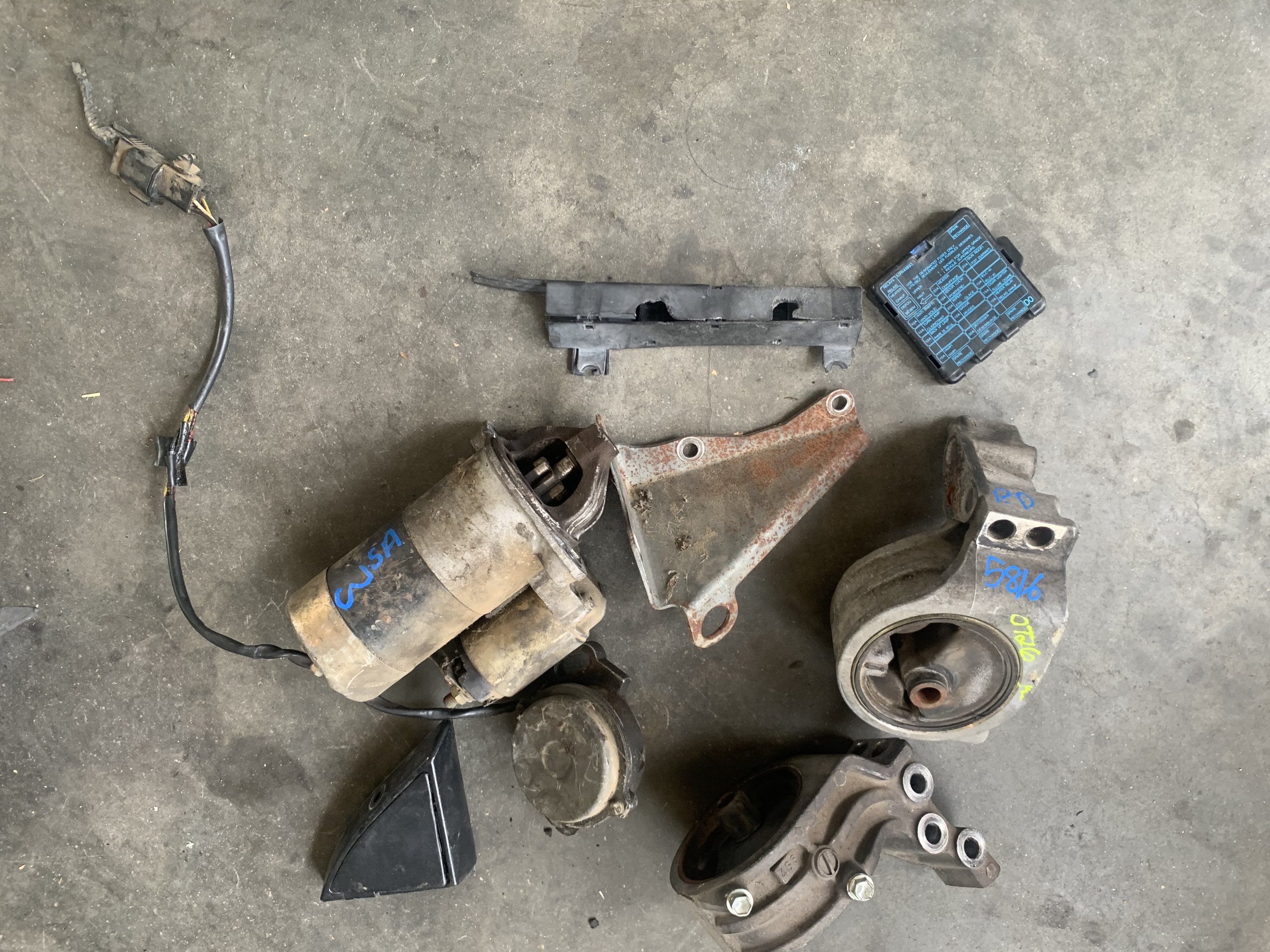

I found a 95 talon fwd at the junkyard, it entered 3 days ago and I got most of the parts I needed to complete my car.
I will update the thread later on, so keep tune.
As mention, here are the parts I got.

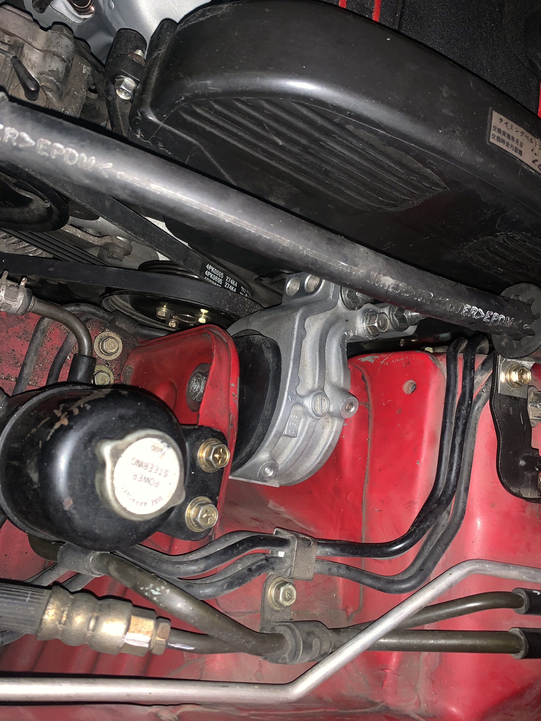

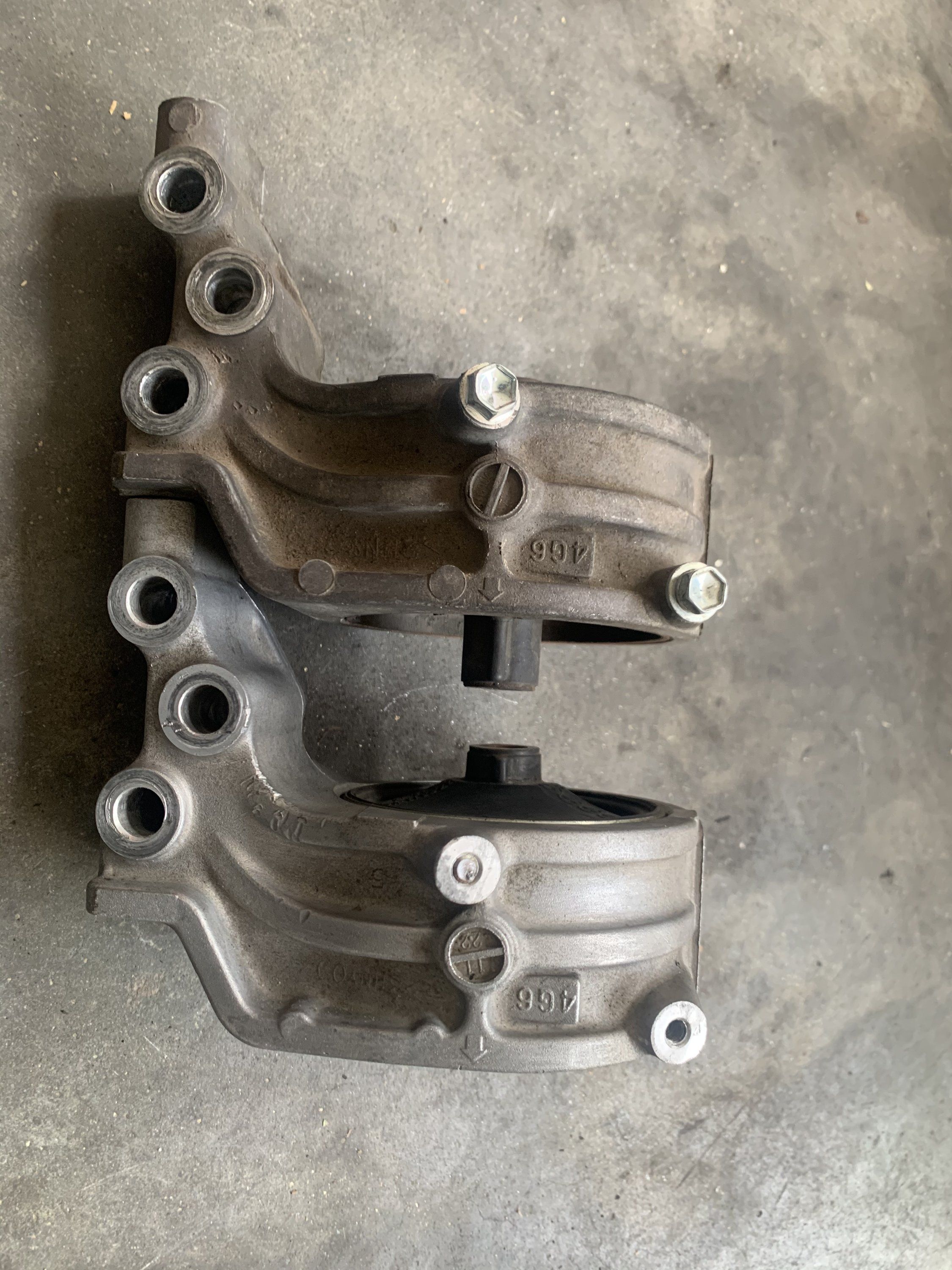

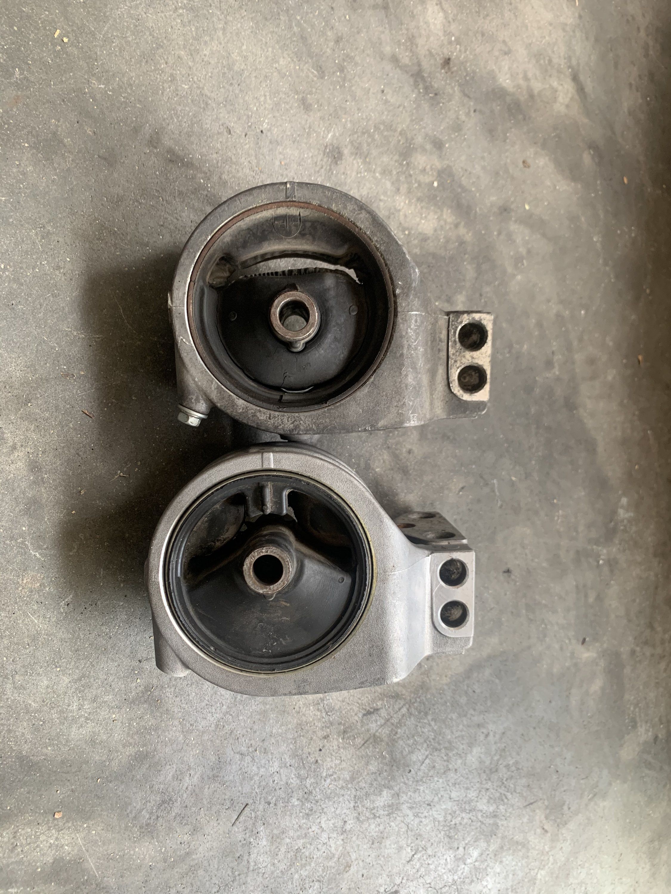

Here is the motor mount it’s a bit different then the one was on the car, wondering if autos and manuals uses different motor mounts, or it came of a galant?
You can see the center mounting locations is a bit higher in one mount then the other, well I put it in anyways and I add the wall protector or what ever you call it, I only have one so I have to source the o the one later on.
Here is installed.

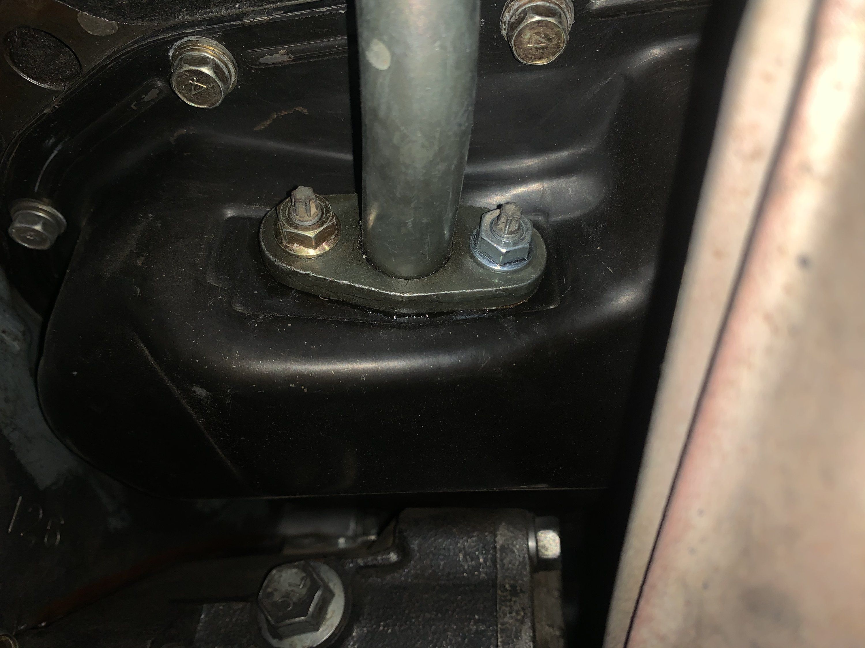

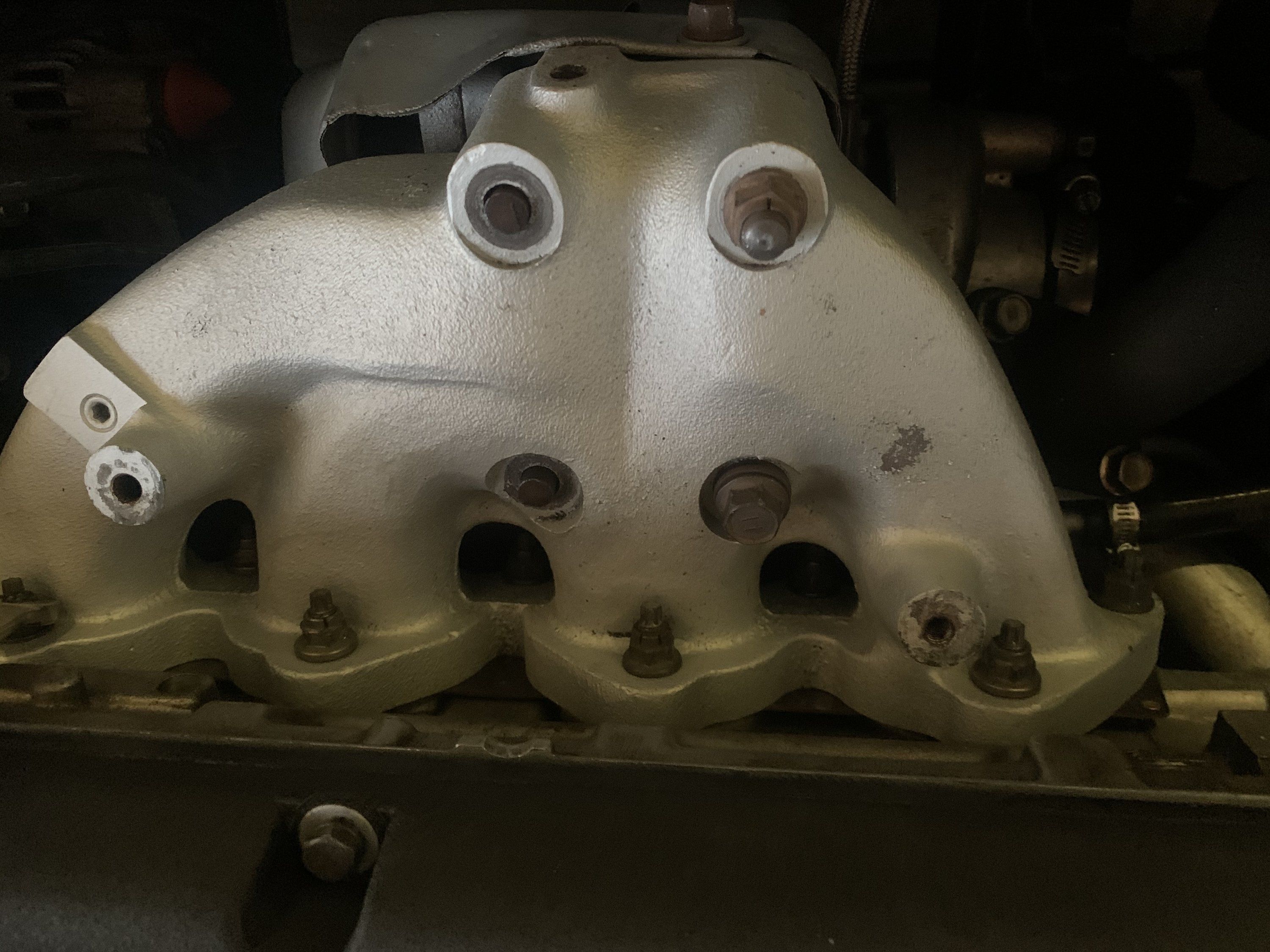

I removed the manifold heat shield to bolt on the front hoist and look what I found, two bolts were Brocken, no wondering the loose of power I was feeling,.
Lucky me I got the bolts out with my bare fingers, I replaced them with some other used once.
unfortunately, I couldn’t install the hoist because the evo manifold is to thick and the nut , hits the manifold and a sucker won’t get in, I have to bolt it down with and open wrench, so for now I will leave it as is, whenever I have to remove the manifold,I will grind down that area to be able to fit a socket.

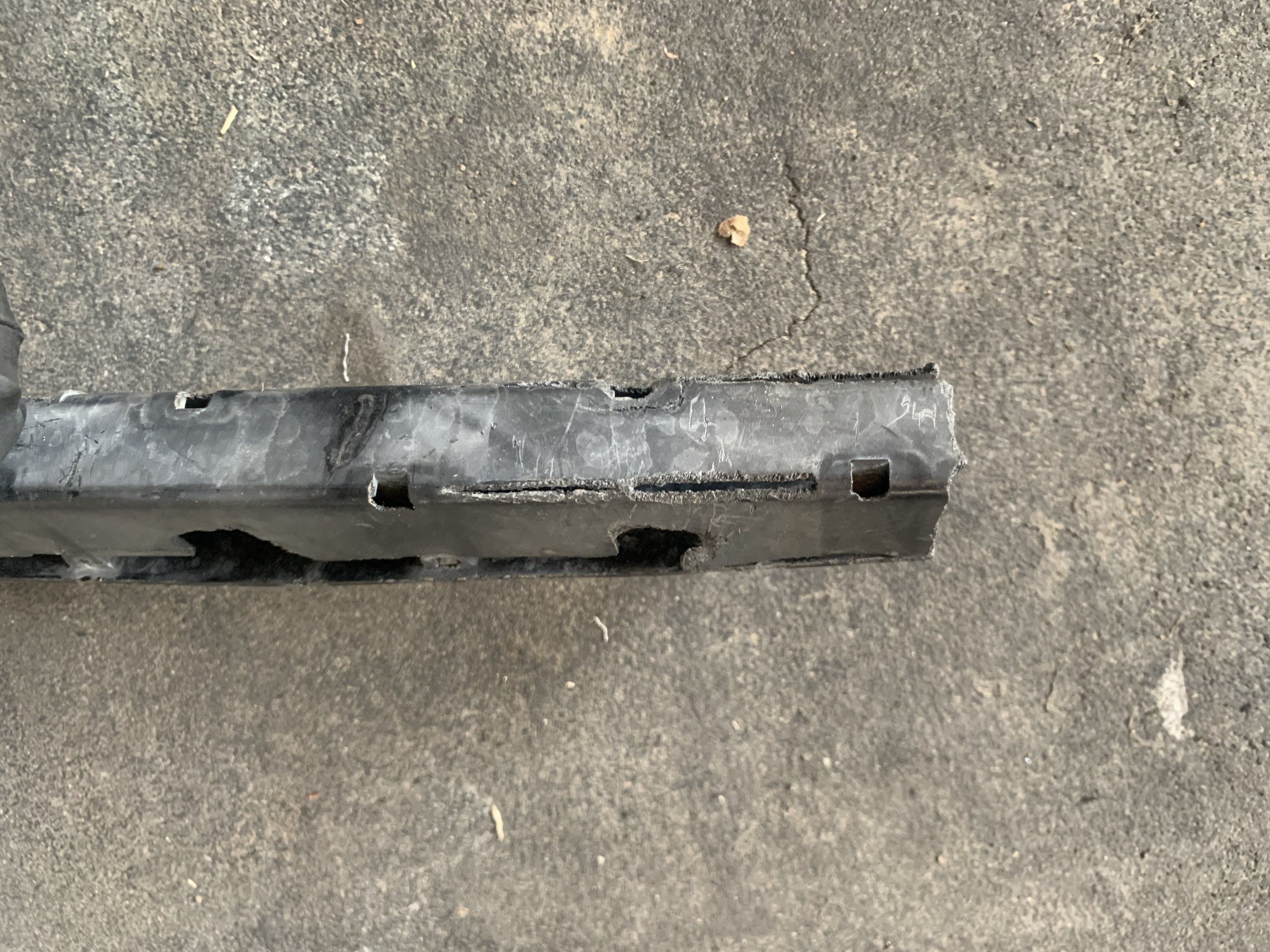

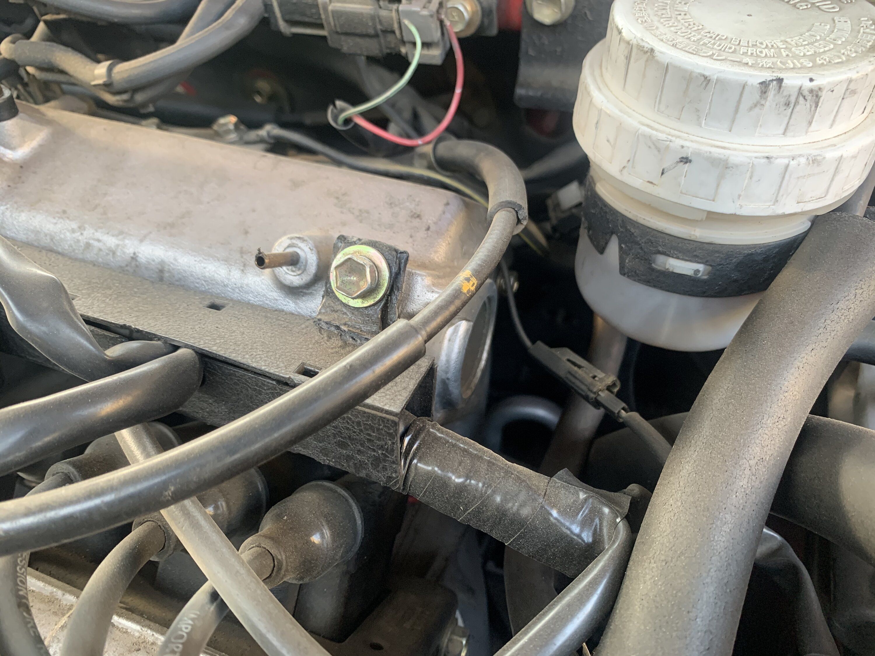

The plastic, or harnes guid/holder or what ever it’s called was in bad shape, so I reinforce it, paint it and put it on. Herís how I got it.
And here is installed.

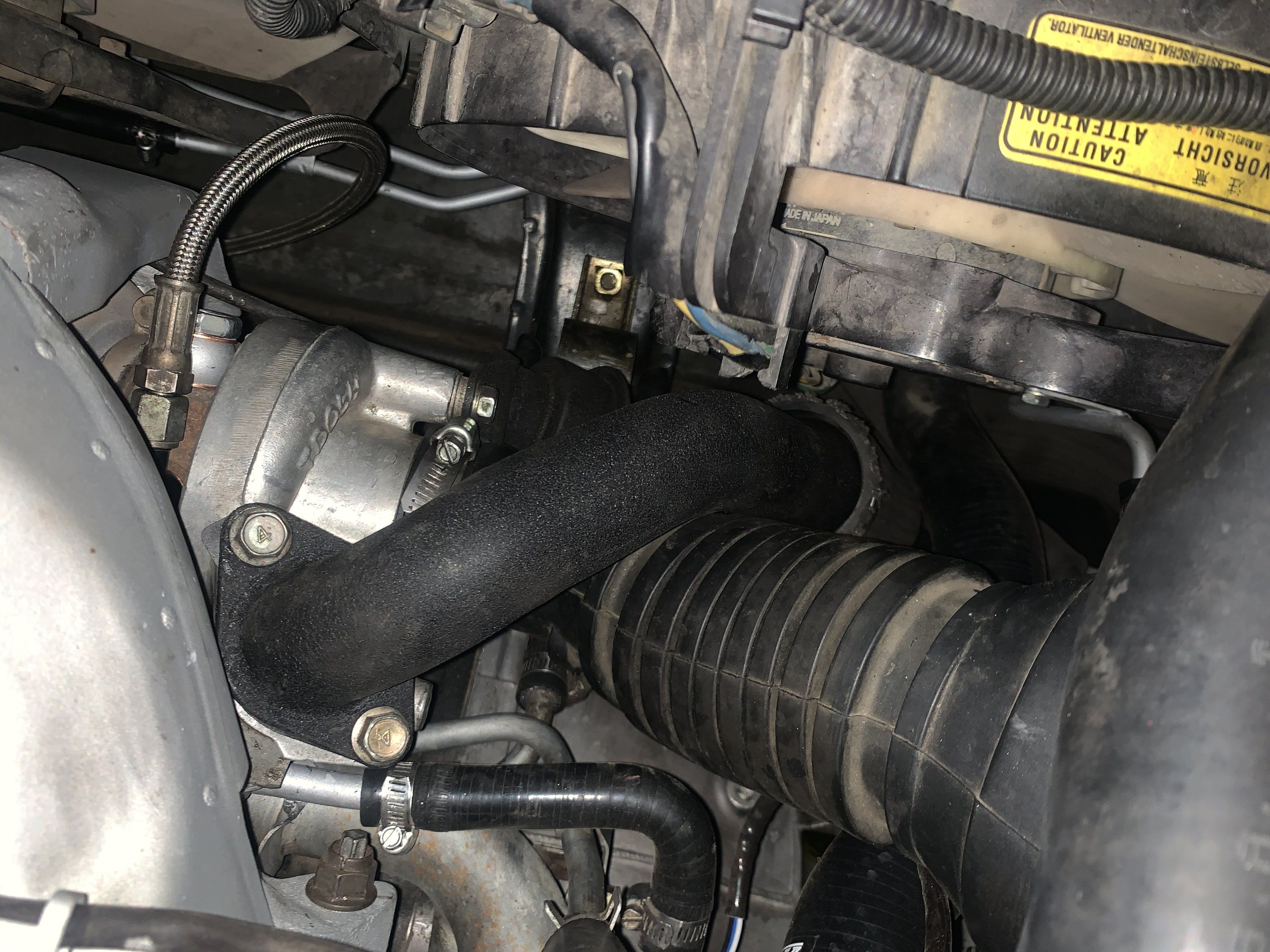

I removed the famous EBay Jpipe that I modified and make it look original, I sand down the welds And make it look smooth and paint it wrinkle black to get a stockish look.

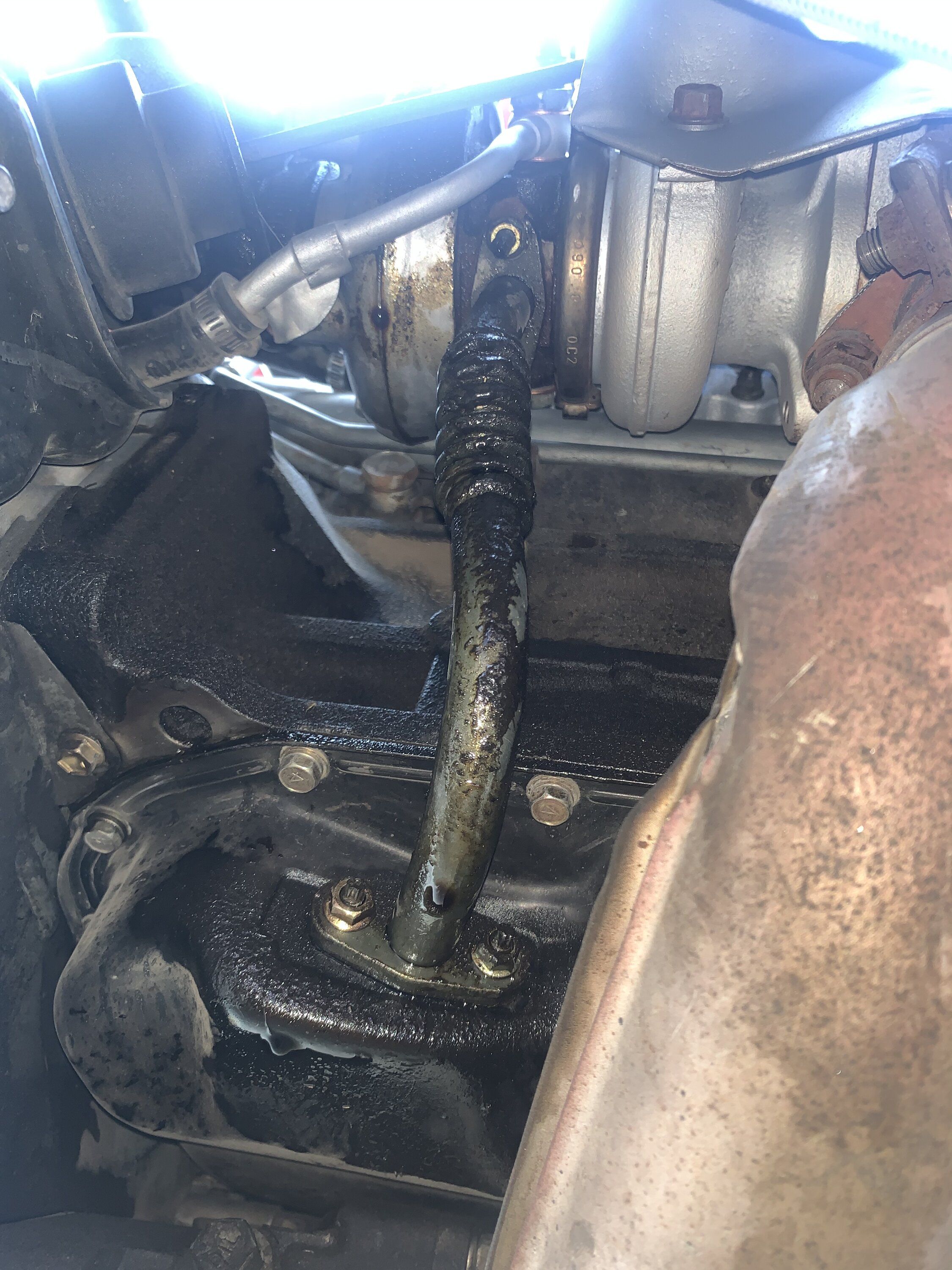

I send down the engine to check how it looks, I haven’t see it since I replaced the Tcase seal.

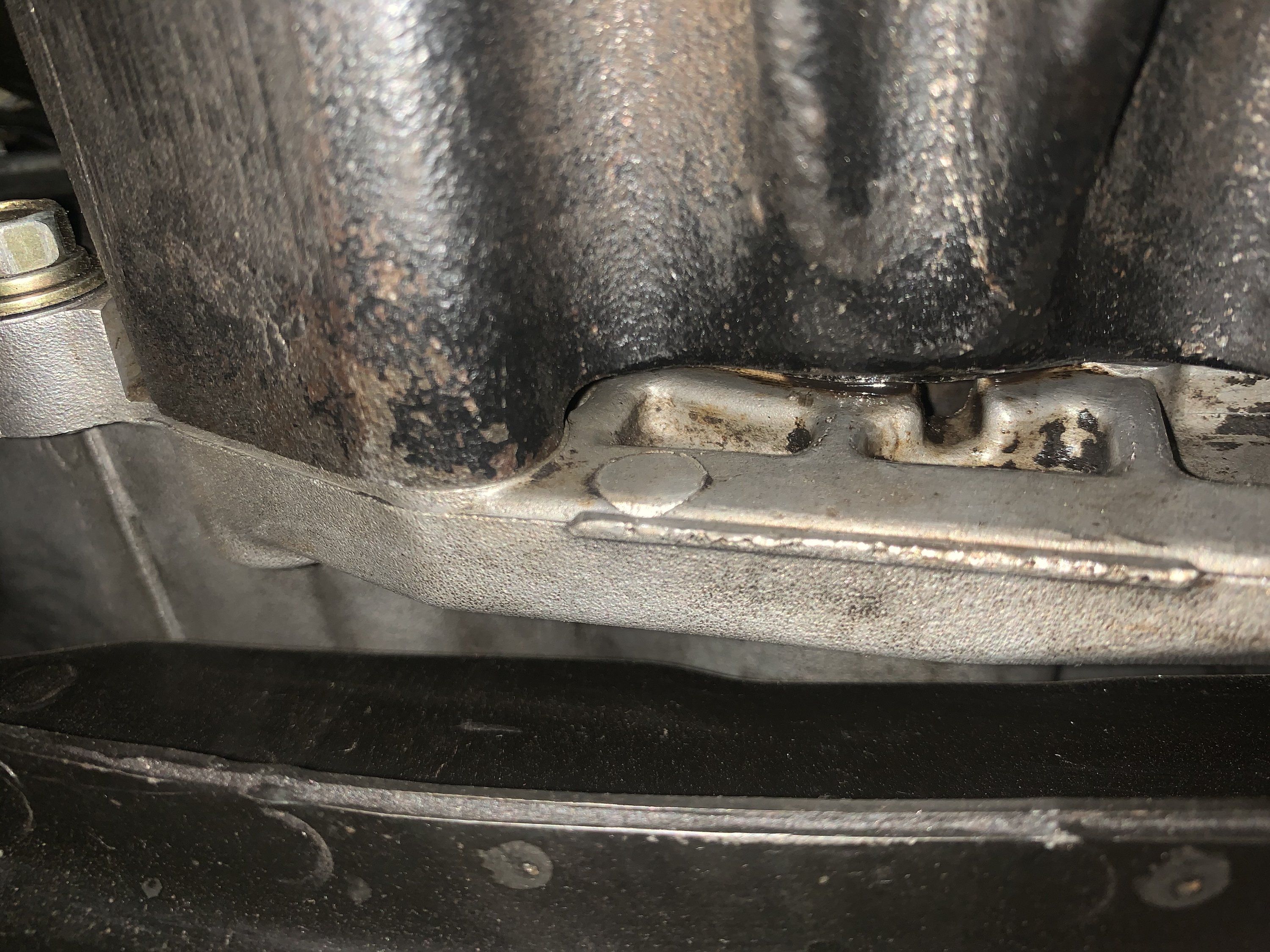

Well, I found a very light leak at the Tcase and transmission Union, I didn’t go deep to see what was it, I will give a bit more time to have an idea how bad is the leak, looks like is very minimal so will see,.
I also see the oil return line a bit wet, that definitely will have be changed, here are some pics of the leak.

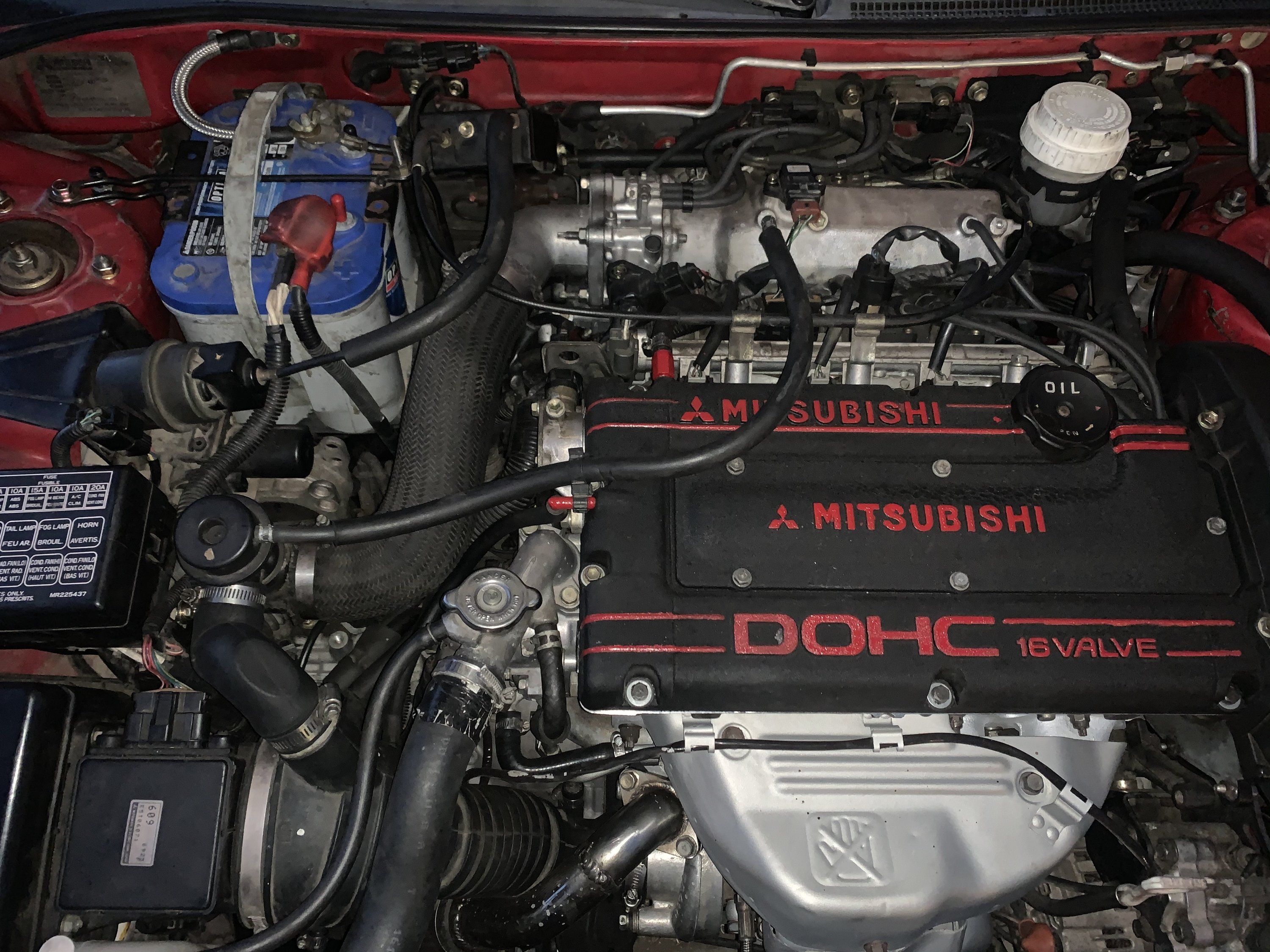

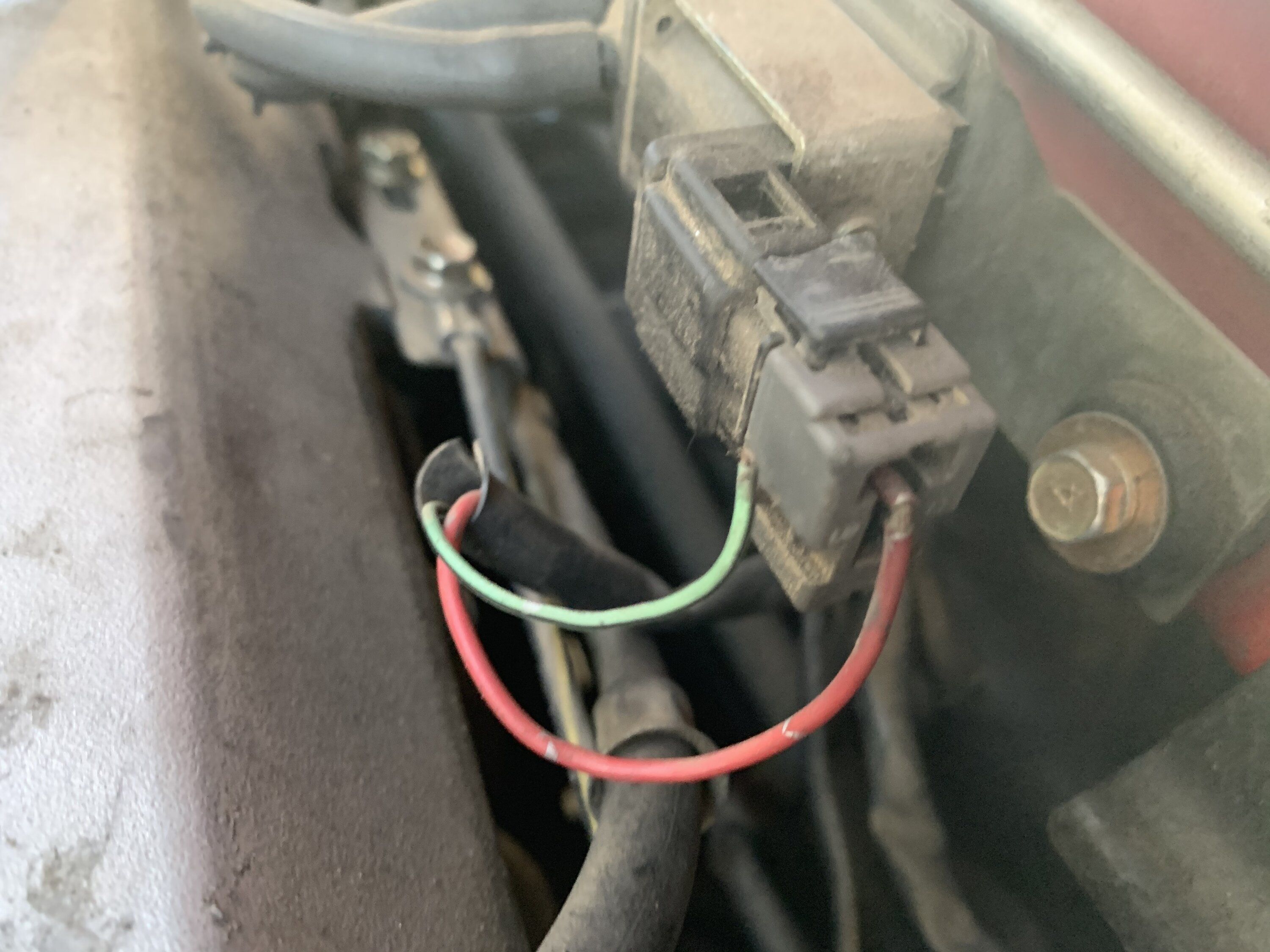

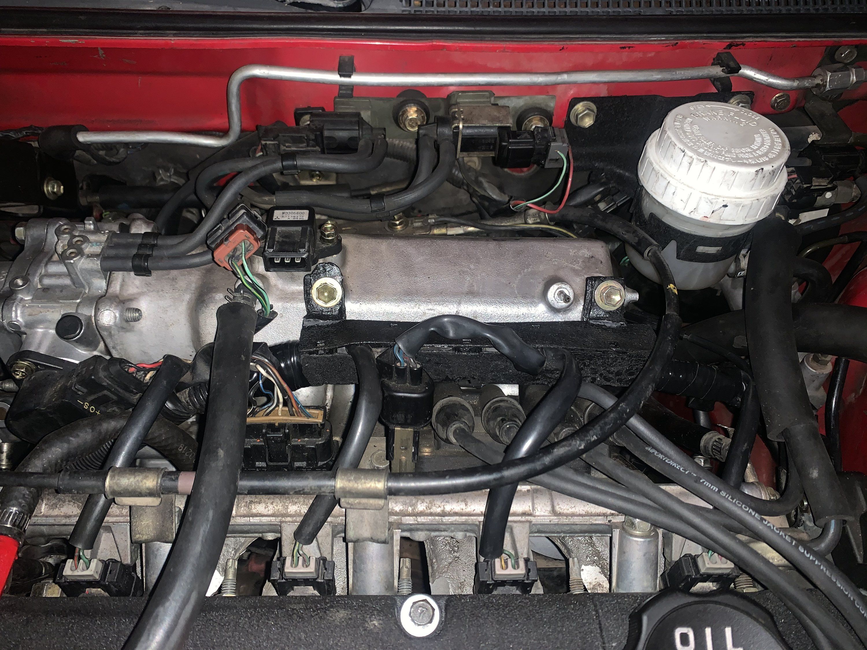

It had CEL on and all were from the map, sensors and vacoom related, well I fixed everything except the Brocken sensor wire and the egr that it leaks,

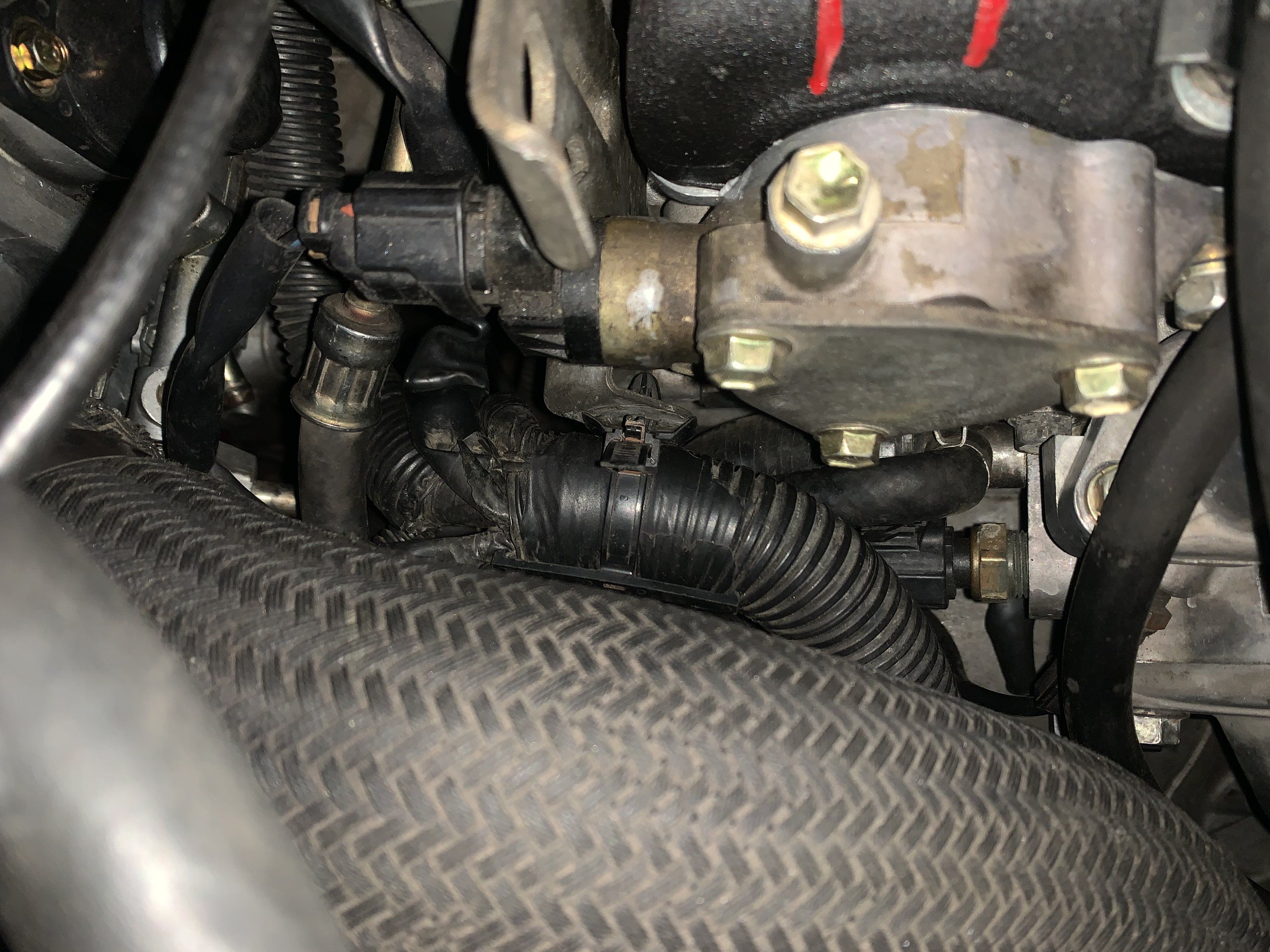

My old egr valve was leaking and I just replaced it with this used one, it was good but didn’t last, so I will look for another one to replaced it , odd they are not selling it es anymore, I could grind it only used.
Well the valve cover gasket is leaking but I didn’t have time to replace it, I’ll see if I can do that before leaving to work, the good news is the Tcase is dry which means all seals under there are good, i did replaced both t case seals buck was worried about the transmission input shaft being bad but apparently is all good.

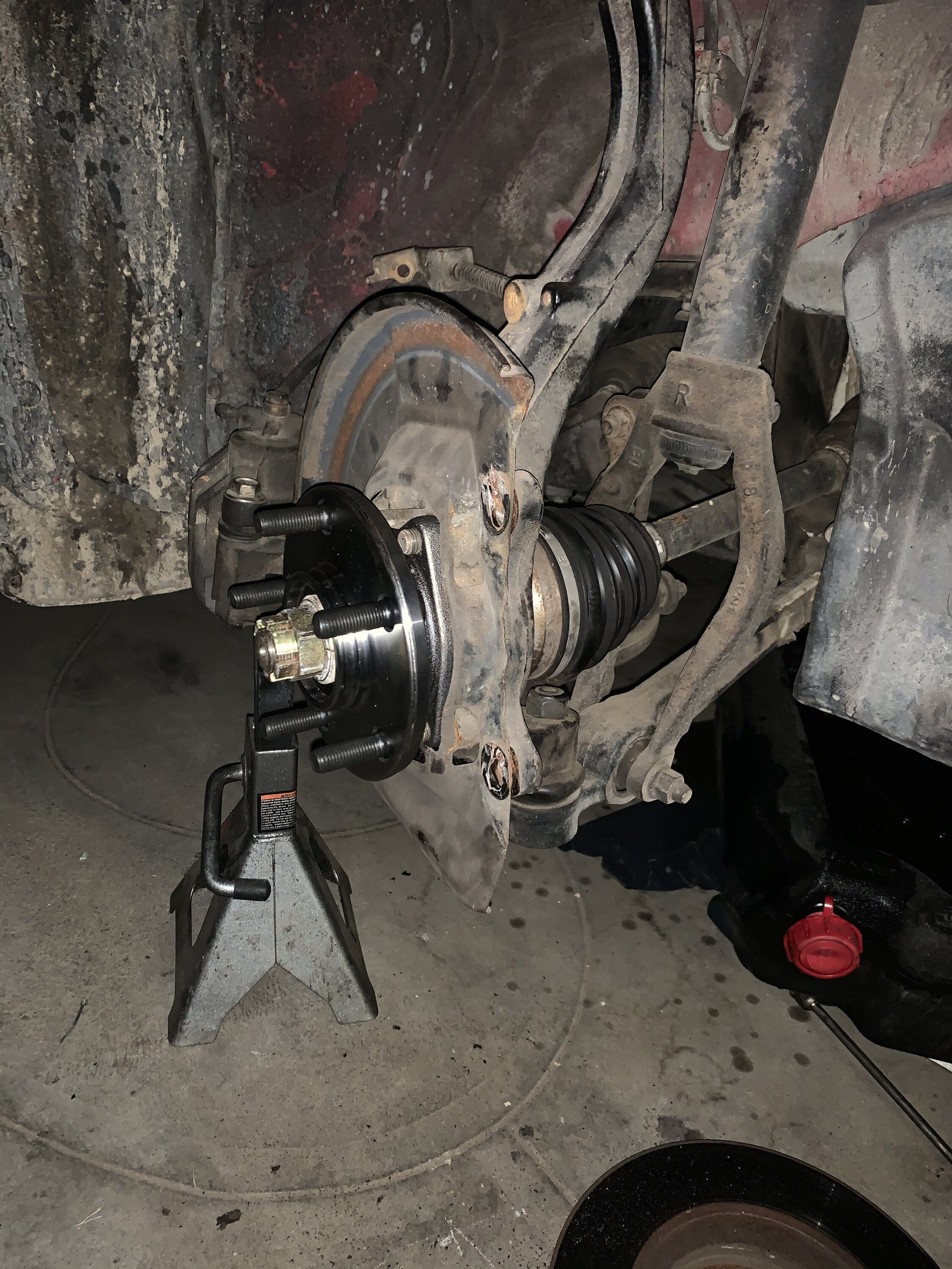

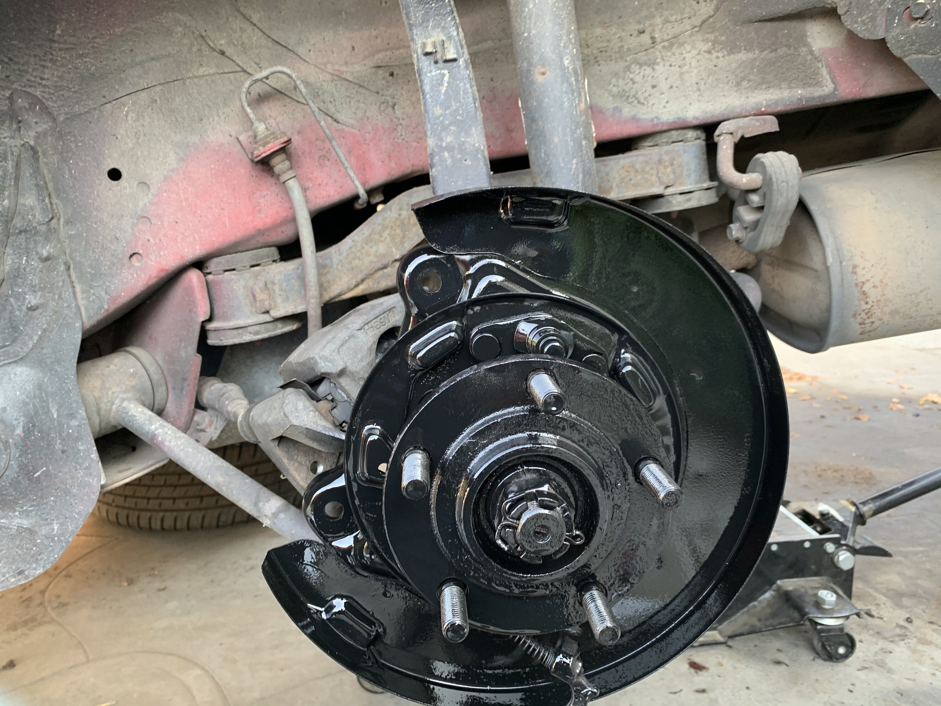

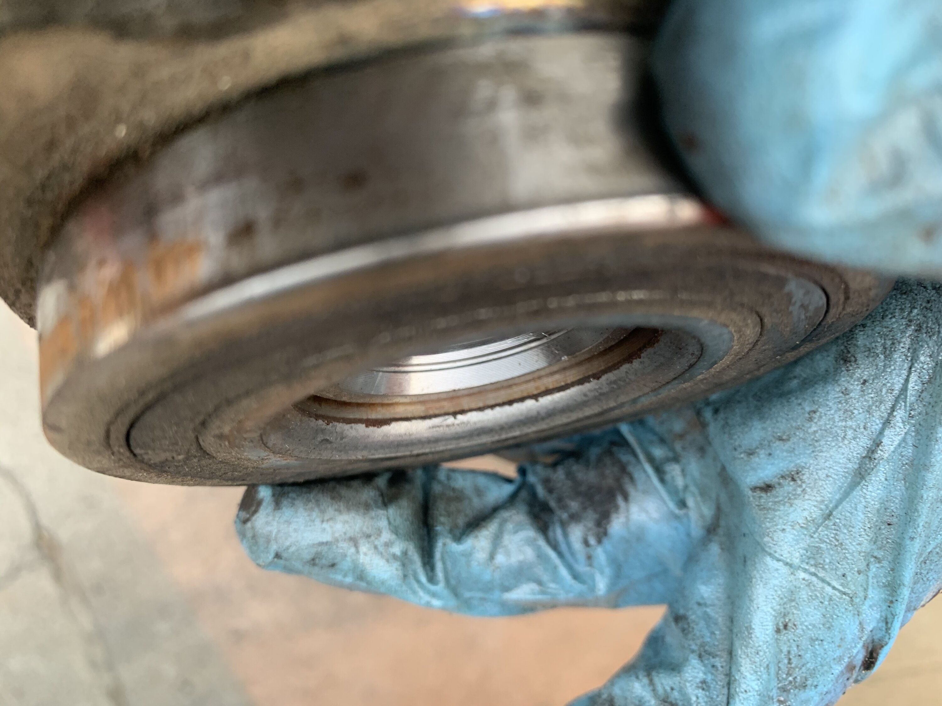

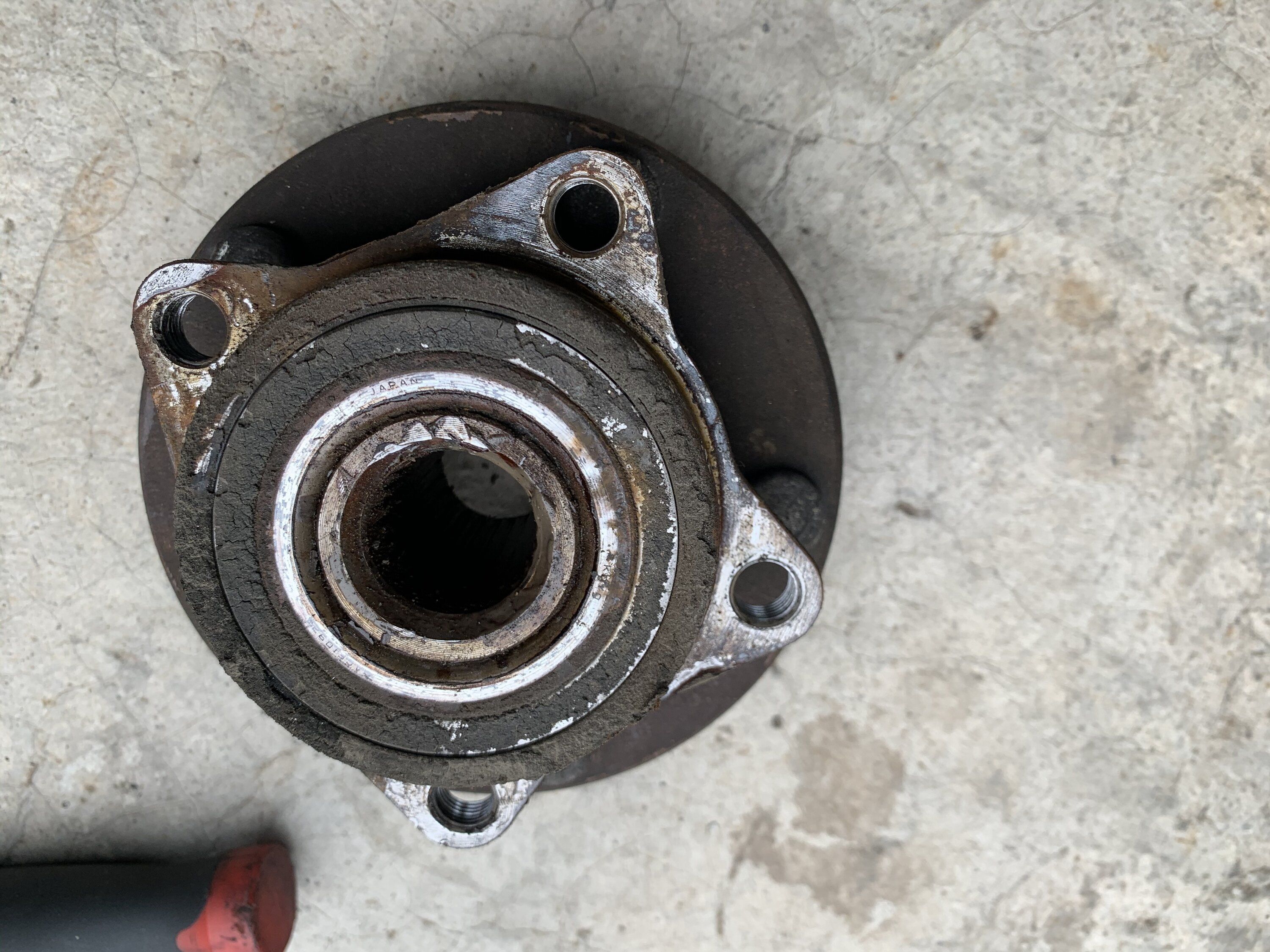

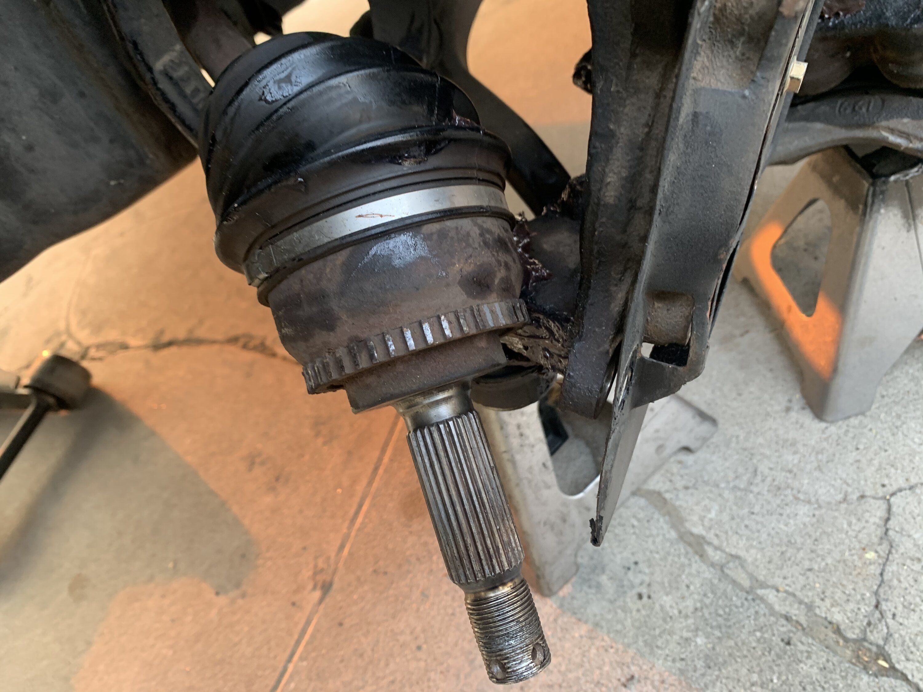

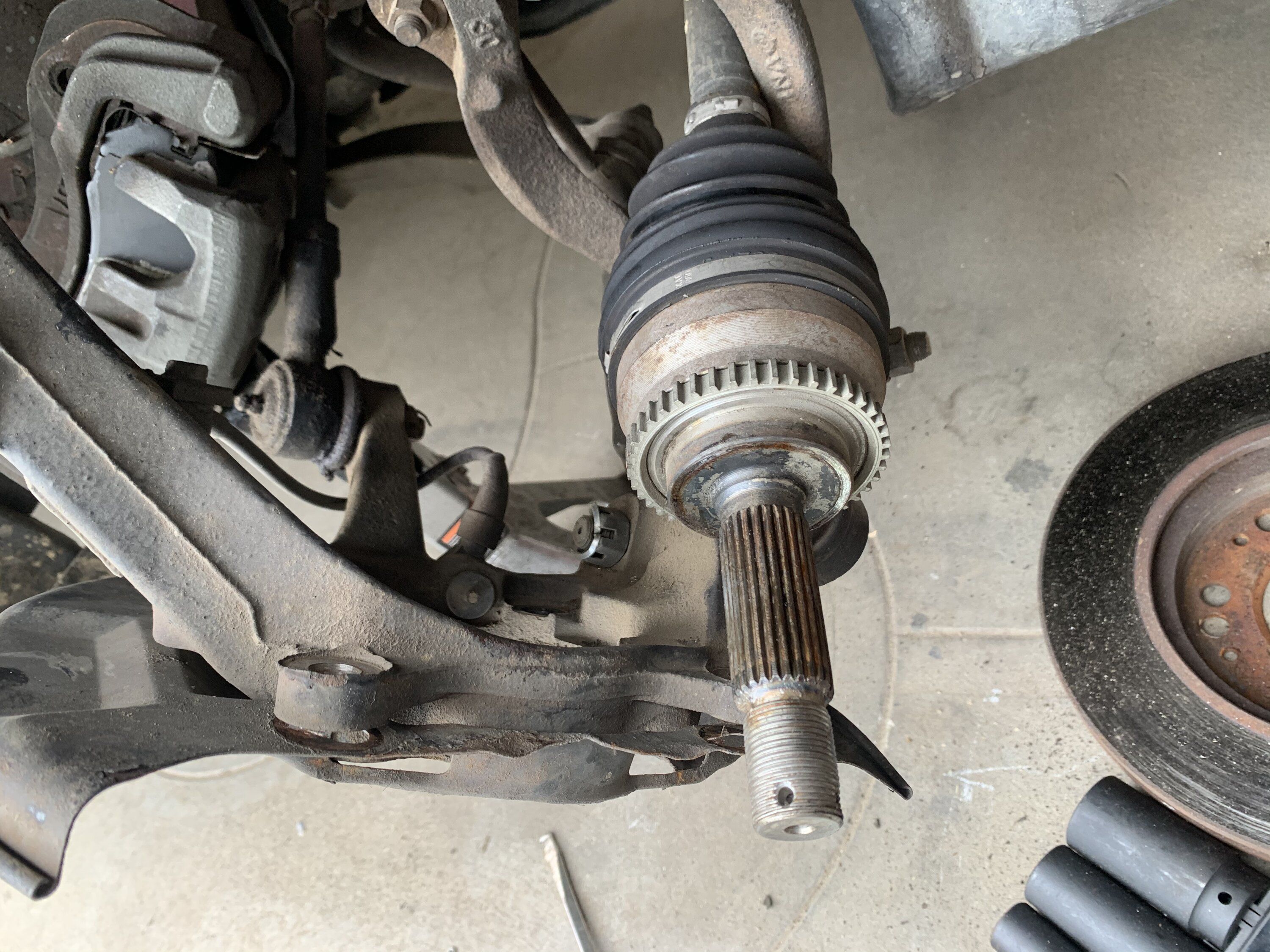

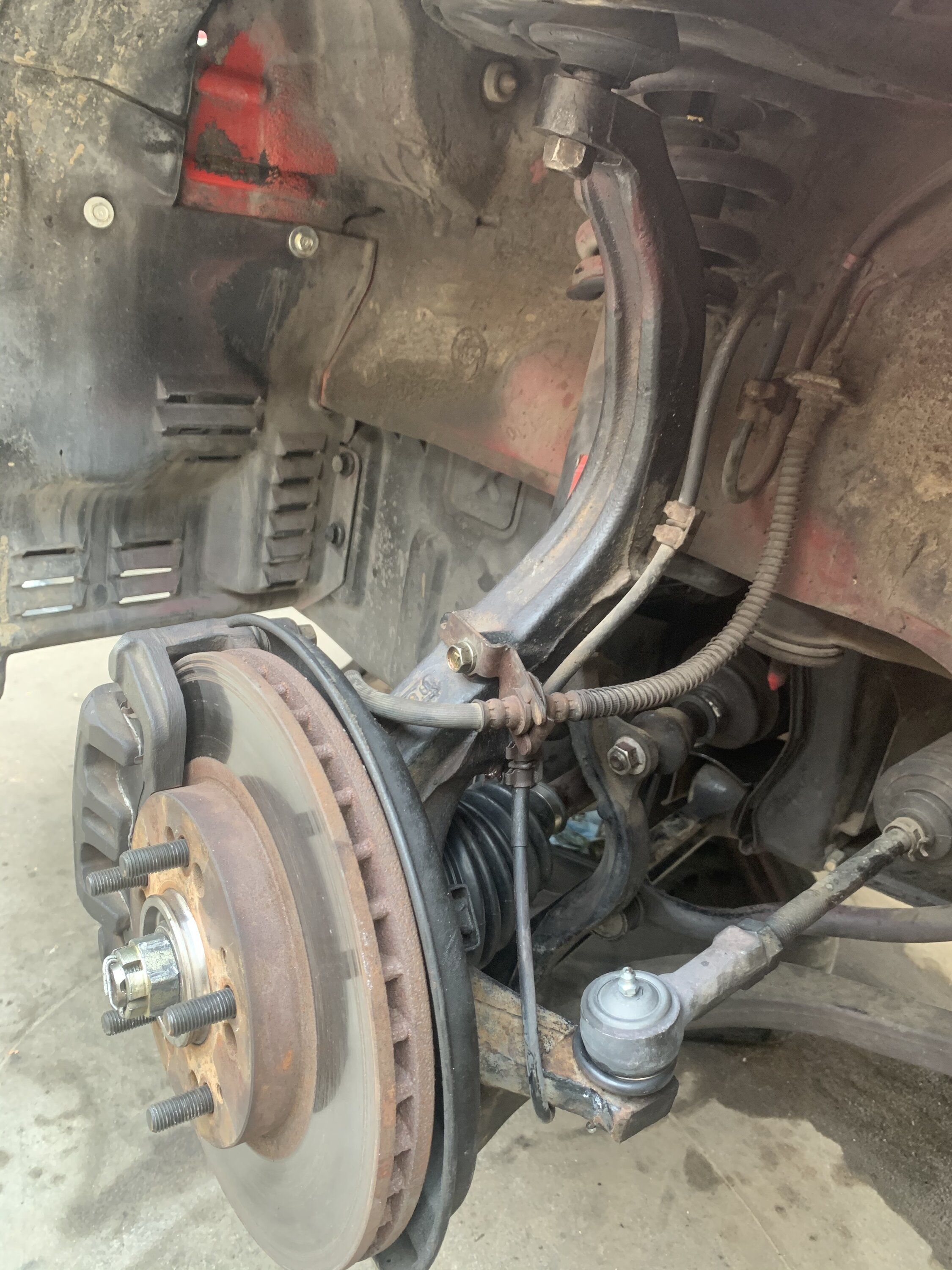

I replaced the from driver side wheel bearing and discovered, the axle boot was pinched, I don’t know how that happened but I will replace the boot next week.
Once I replaced the bearing, I replaced the abs O ring gear, (axle ring), so now I have a functional ABS System, now I have to replace the passenger side wheel bearing which it makes a bit of noise, so next week it will be replaced together with the axle boot.
Here are some pics of the process.
8FA24C9B-4EEB-4B0C-94BC-37FF217632FB.jpeg 8BC54B2C-0A03-4FE2-888C-768D511D160F.jpeg E40DC28E-8F51-4E55-B917-C0EDC9F5AF3E.jpeg A77C9475-D90E-4C30-B8B7-205E8EF81687.jpeg
You can see the wheel bearing when is fully inserted and how it comes out, There was a lot of movement there.

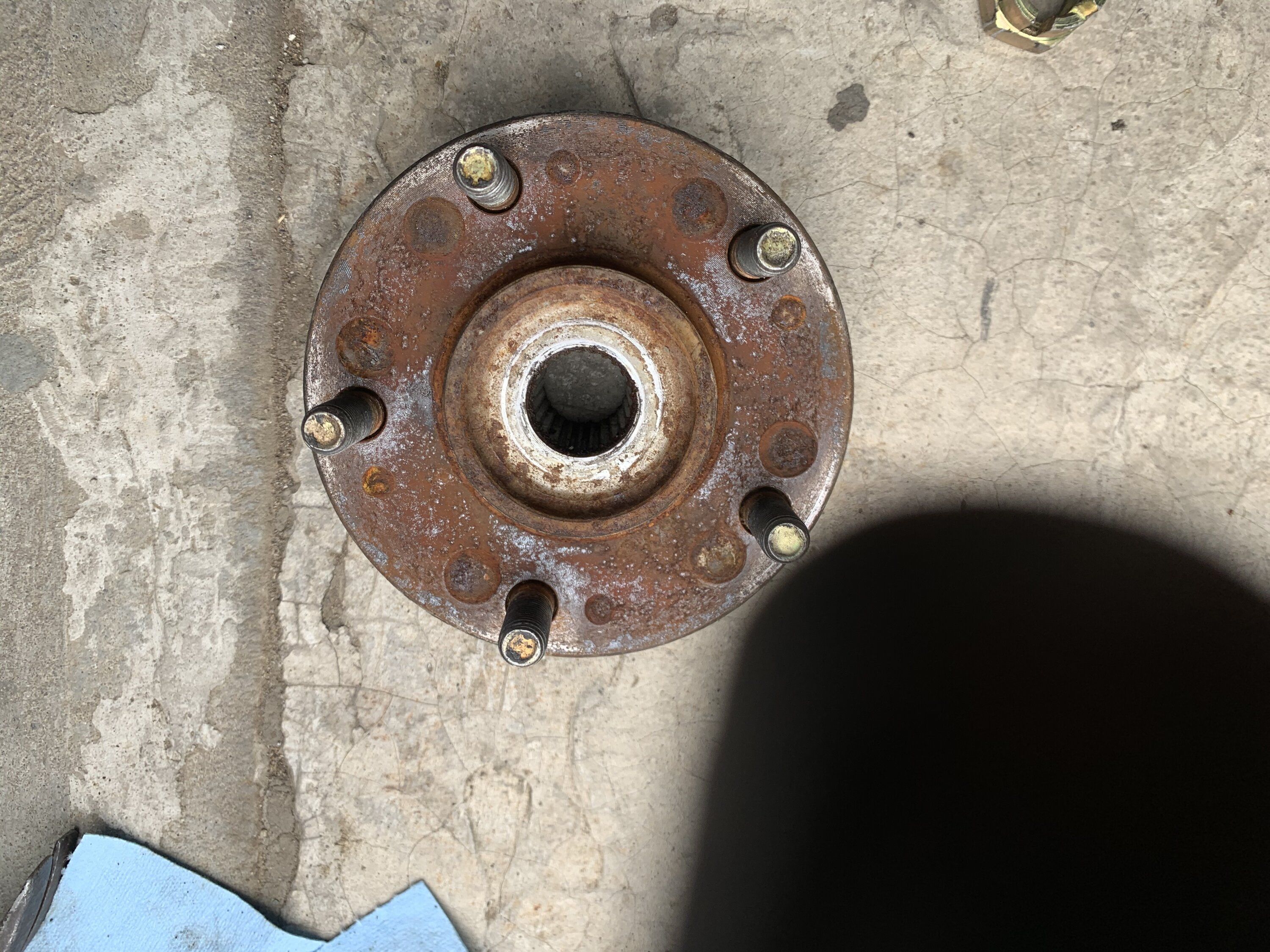

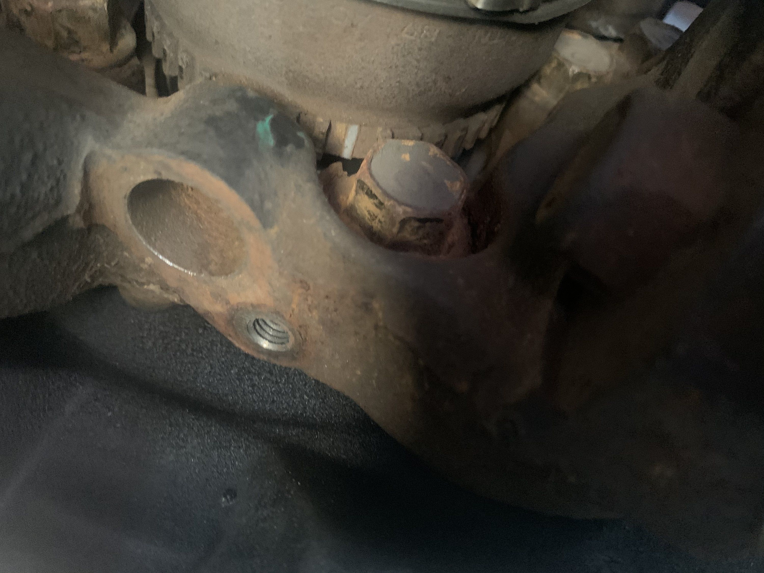

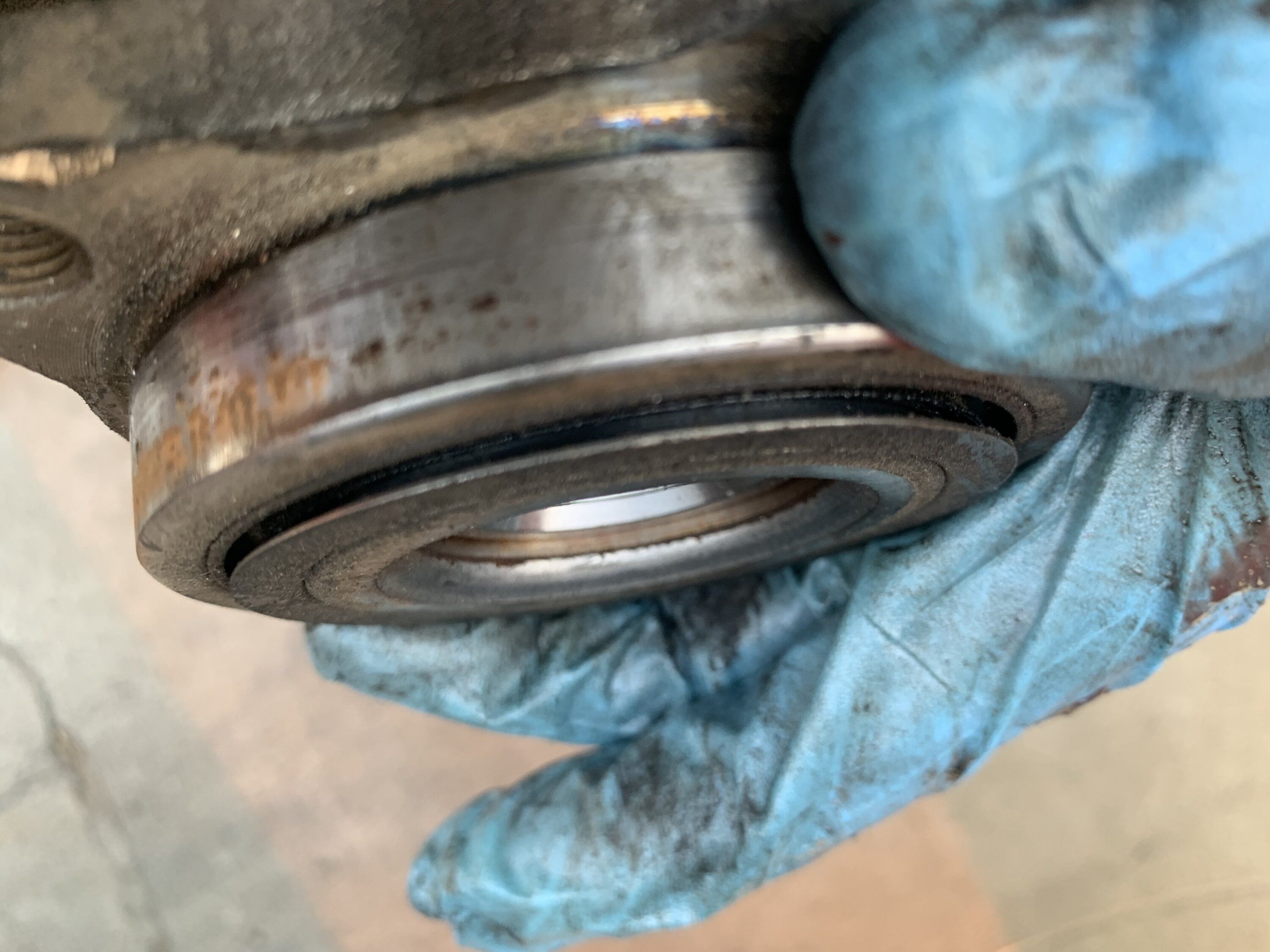

I replaced the passenger side wheel bearing and at the same time replaced the driver side axle boot, I know, I know, I had to do all the hazle just to replace the axle boot.
Here is the driver side bearing.
Here is the passenger side evidence.
Here is the driver side bearing all ready installed and all surrounding cleaned and dry of grease. I degrease all the area to have a dry and clear surface for future evidence of leaks.
And here is the passenger side bearing, it’s tight and makes so much noise when I turn it with my hands.

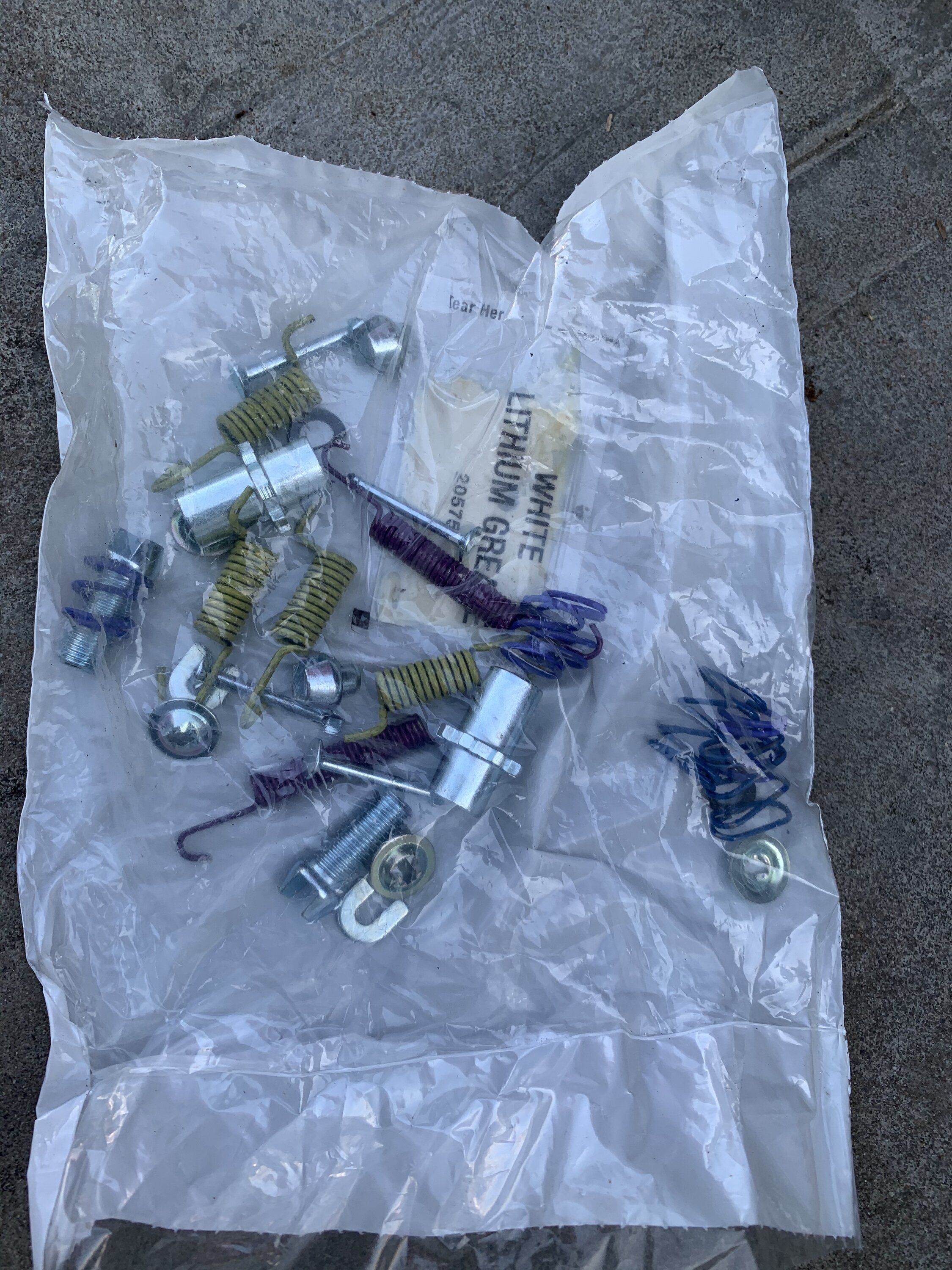

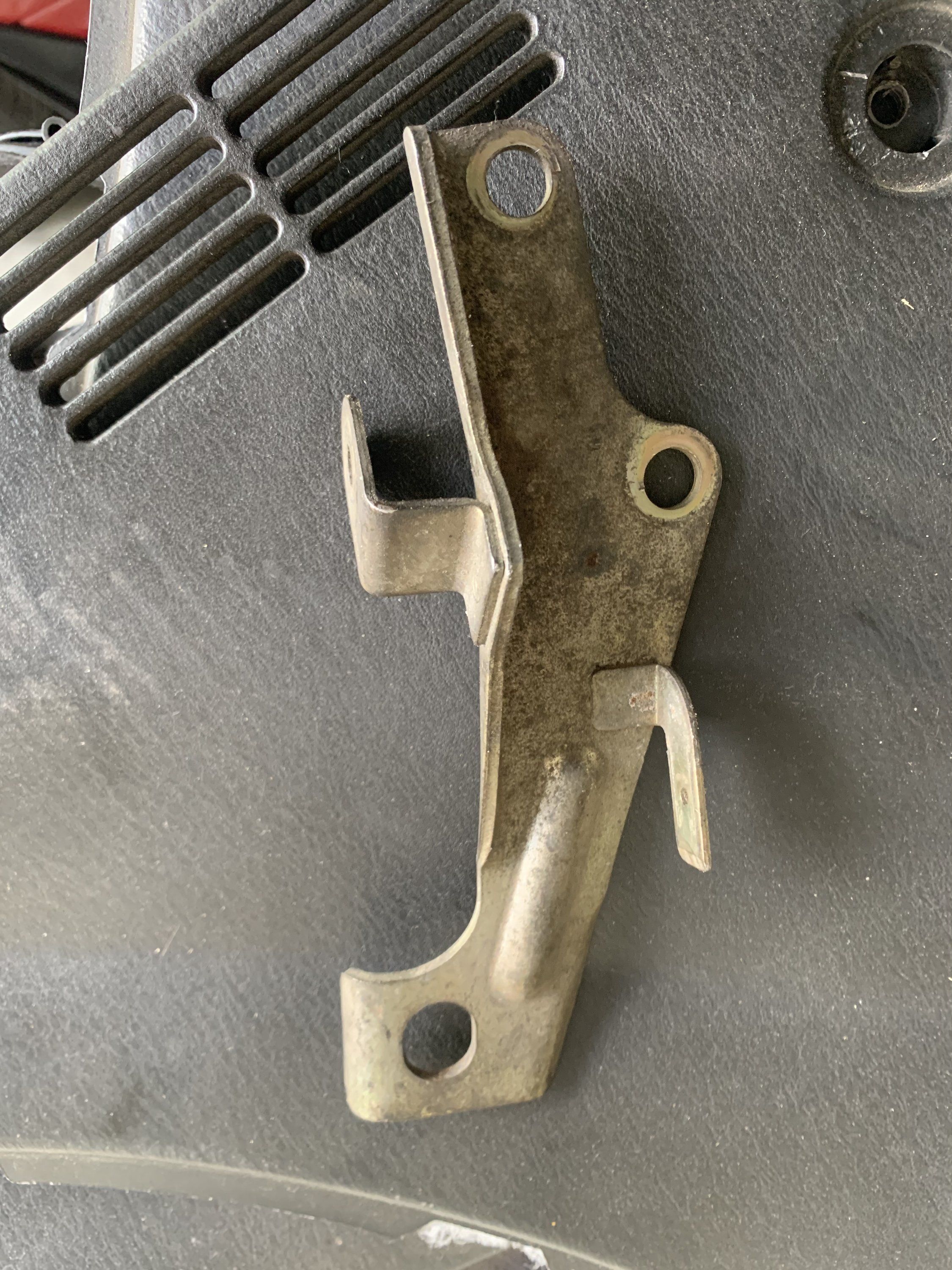

Update.

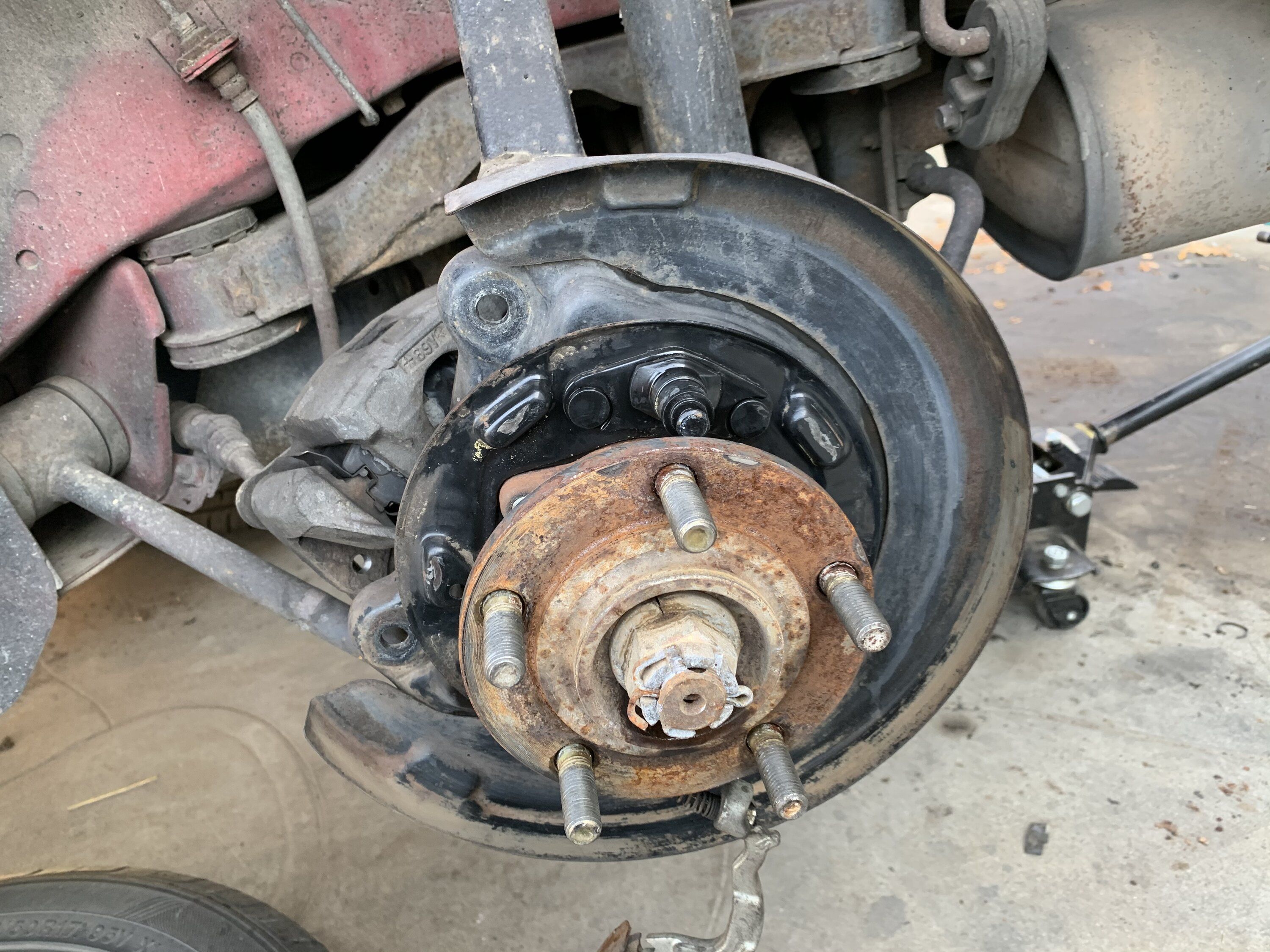

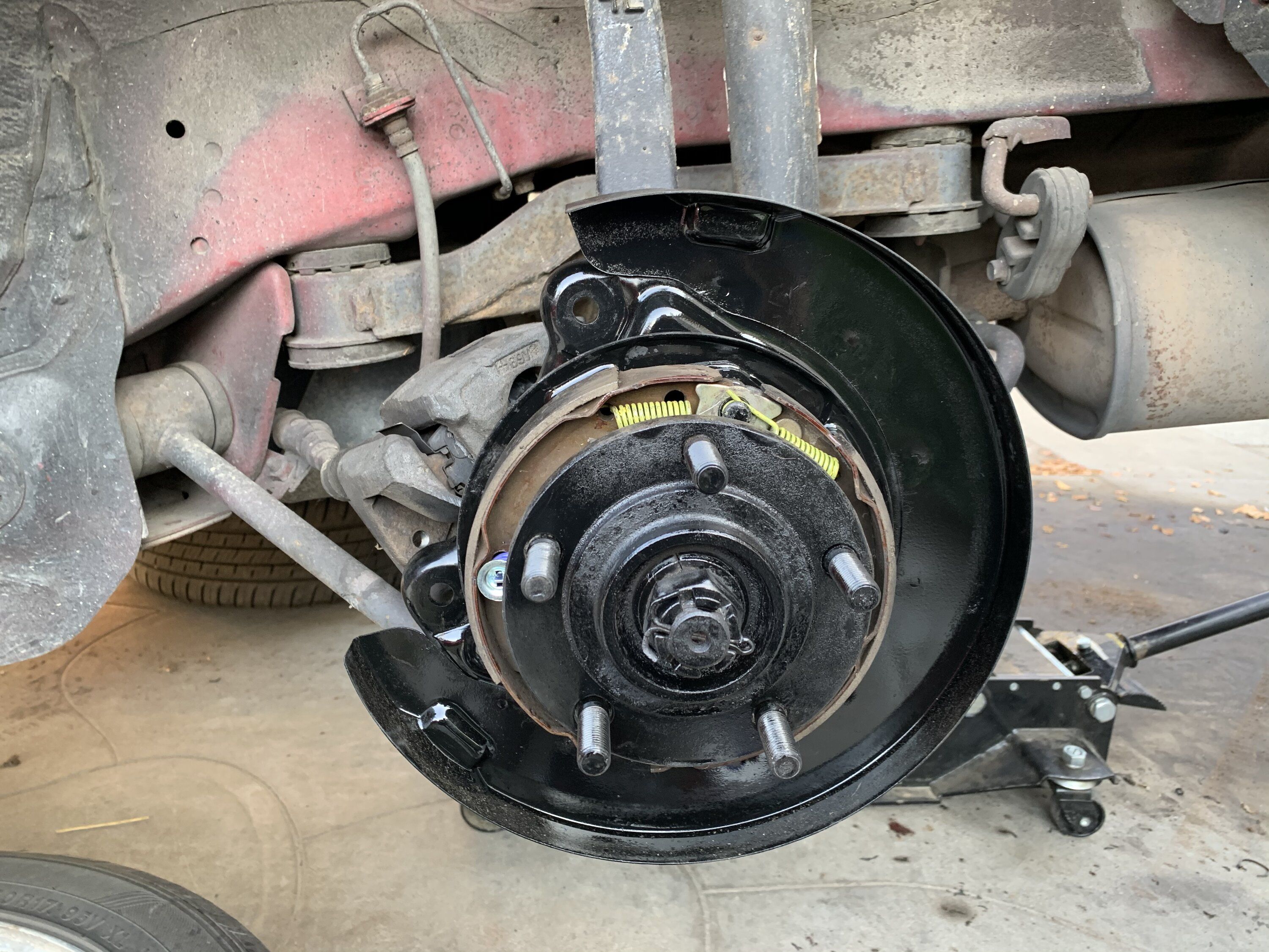

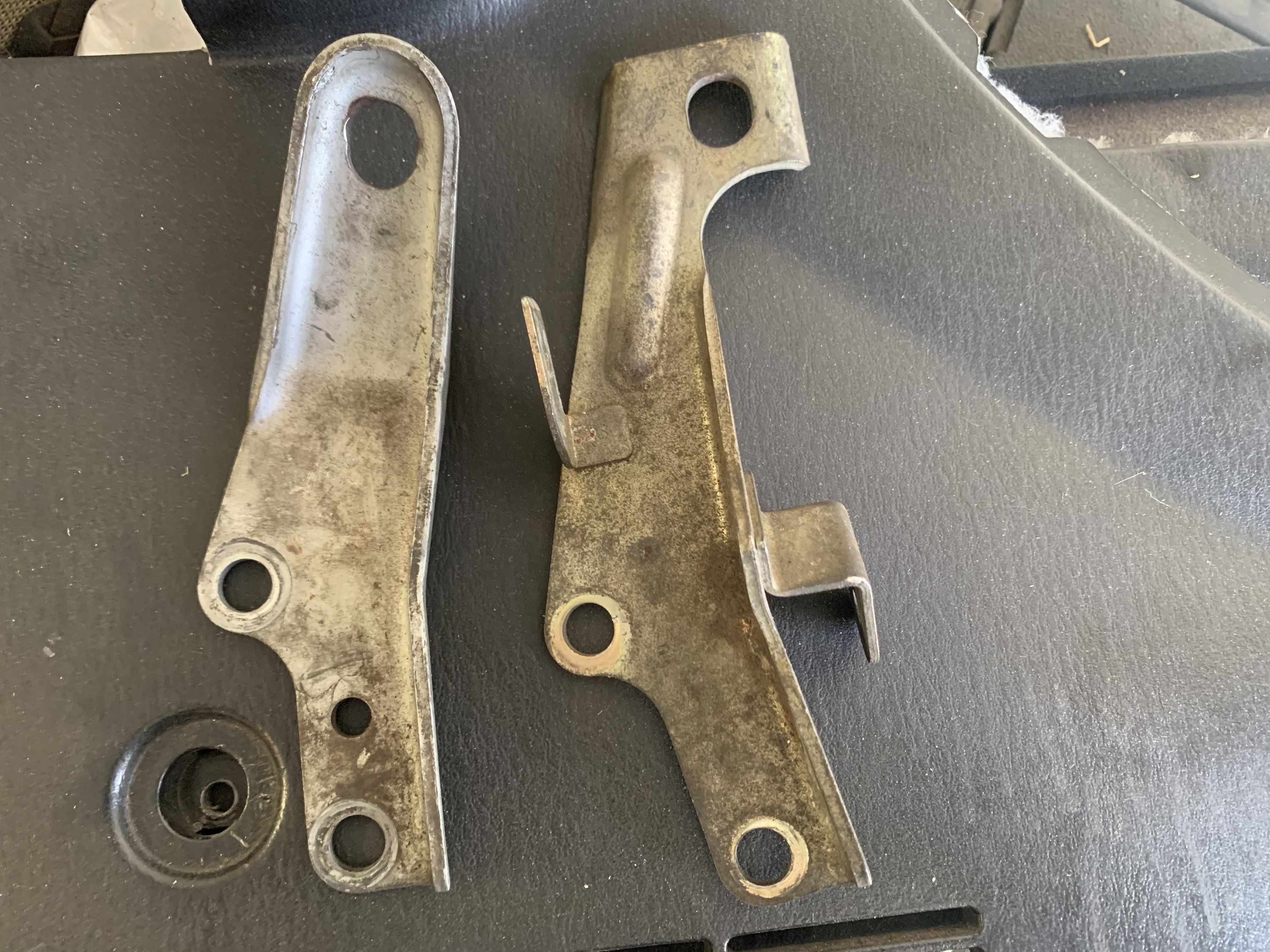

I changed the Ebrake hardware on both sides.
Here are some pics for the viewers.
I clean all the area and I can see there is no rust around the surface so that makes me opt for painting it and prevent future rust.
I hate to just paint all evenly, I like to paint parts separately, but that will be in the future IF I end up replacing the wheel bearing, but it’s ok for now.
Here is the final look and to be serious, I hate how it looks with the axle nut painted, Bur at least rust won’t keep growing.
For the record, I drove the car and the noise was gone, It was a good feeling when all was just perfect, But when I was interning the driveway, I can hear the noise coming back:beatentodeath:
Curious, this time the noise wasn’t as a clunk but more as a spring rubbing the disk and only when going slow and applying quite a bit of pressure to the brake,
I even used the Ebrake at the time the noise was present and it didn’t make the noise to go away or change , so that makes me think is just the brake hardware rubbing the disk only when applying pressure to the brake.
I did inspect everything when I removed the complete system and I didn’t see anything wrong and not even signs of rubbing metal or anything, so now I have no choice but to replace the brake pad hardware.
I know is just ridiculous to just replace stuff without making sure it’s in reality the part being bad, but because they are more like maintenance hardware, I have no problem replacing them which they are cheap and easy to install, however I will post later once I replace the hardware to see if it fixes the problem,

I bought new rear brake pad hardware to replace them, but it end up to be the Wronge parts, because was to late I couldn’t return them, so I took the time and inspect every single part and did notes some shiny spots where the pads were moving, so I bend the taps a bit to produce a tighter fit to the pads and grease the contact areas and put everything back together, so I test drive it and all seems ok, well will se later on when I drive it for a while and see if the noise went away,.

I still ave to fix minimal stuff like the door light switch, some times the light comes on when opening the door but some times it doesn’t and I have to wiggle the switch or at lots fought it to make it work, I. Sure is false contact but will see.
