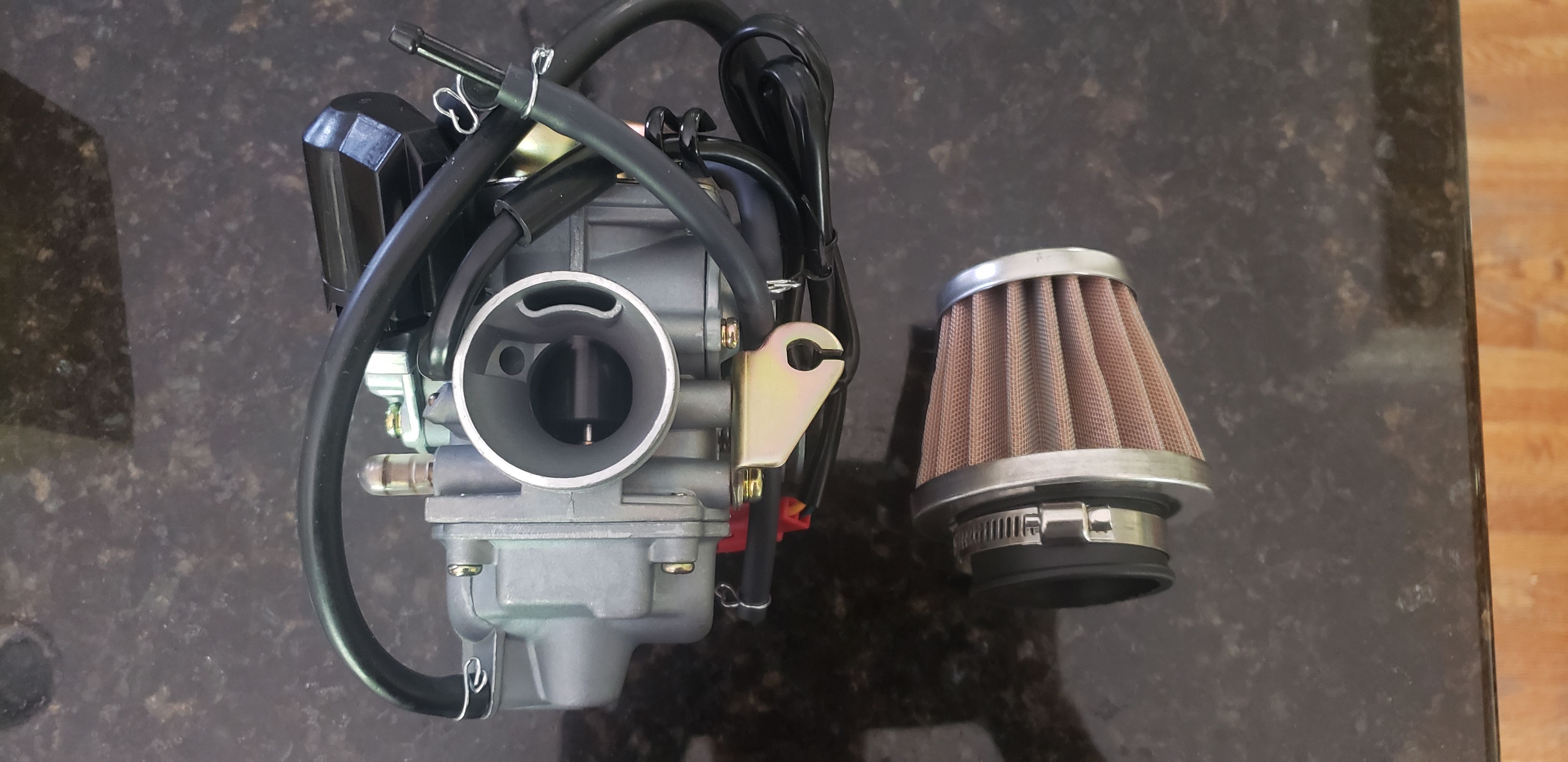

Long story short, I had to make my own wiring harness. Once I got it hooked up, I pulled the plug, and there was spark. Yay. But then I put the plug in and try for a start, nope. Not getting fuel. Cleaned the carburetor, and now we're getting fuel, but we're getting too much fuel. It runs for 10 seconds and then cuts back off blowing a big black fuel smelling cloud.
I'm not even going to mess with the carb anymore. All the rubber hoses are dry-rotted and the electric choke doesn't even work. Plus there's no air filter so it's just sucking in atmospheric junk. I'm ordering a new carburetor and performance air filter with all new hoses and connectors. Then if it doesn't start I'll be tearing it down for a full rebuild. It would be the third engine build this year.

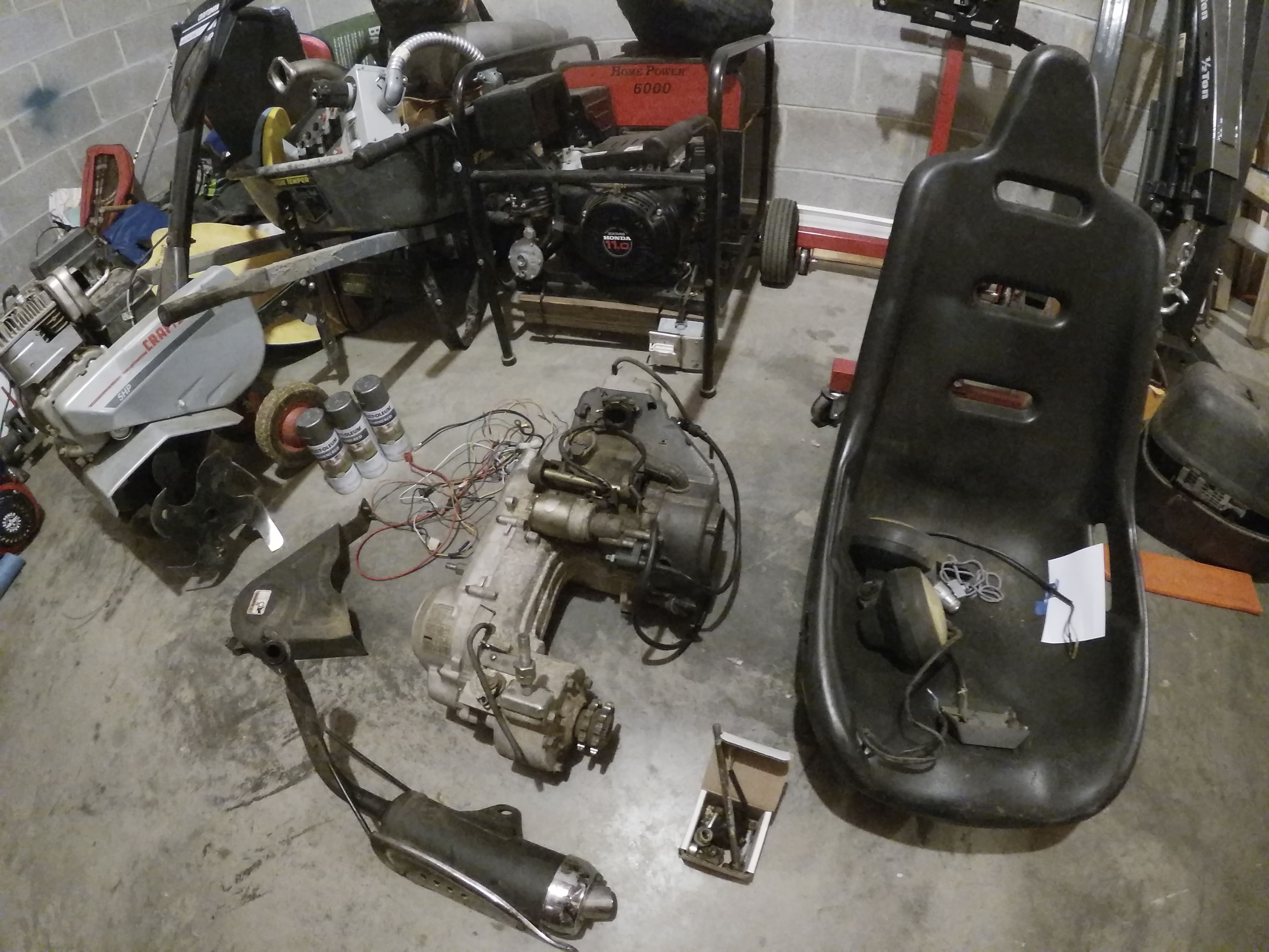

Threw on the performance carburetor and filter. Ran on the first attempt. Took it down the street and it ran strong. But on the way back up the street the torque converter started slipping. It's trashed. Also noticed a decent sized cloud and smelled like oil.
As usual. I'm building another small engine. New piston, new rings, new valve seats, and whatever else is messed up whil I'm in there. I noticed Wiseco makes a high comp piston for this engine (GY6) so we might have some fun with it.
