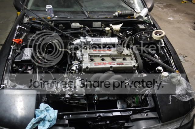

Engine is in, mostly hooked up (only ac lines, ps lines, heater hoses, and some other misc stuff left).
Still have to put CV shafts in, transfer case on, radiator back in, move battery, finish gauge deal, install all crap I bought, fabricate a V-band onto my downpipe (if I run external), fabricate the rest of the exhaust, then should be getting pretty close to done.
Pictures:

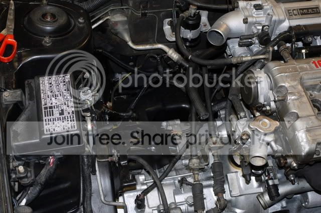

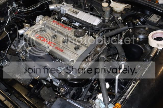

Here is an overview of the engine. Sorry about crappy valve cover, but I always use a nasty one to install, as I am prone to putting my hand on it and tossing tools and junk in there.
more

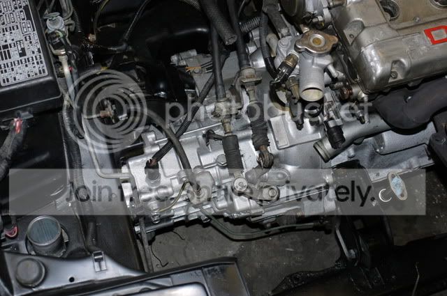

Trans area and wiring crap
more

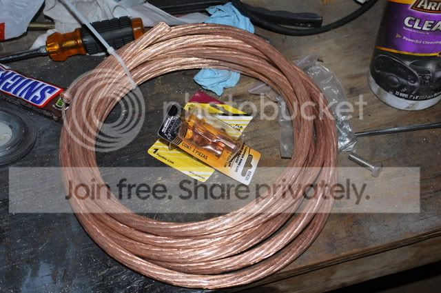

Wiring for battery relocate (ignore the Snickers.... Daddy likey..)

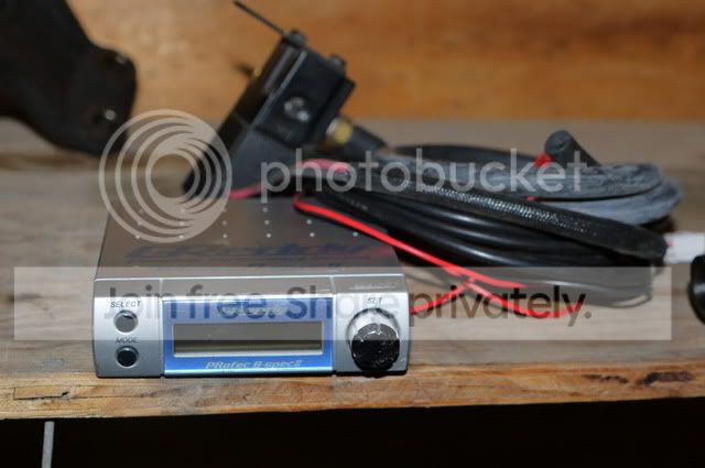

Profec B

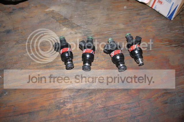

RC 1000s (yes, I know one is missing an isolator)

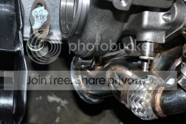

And lastly... the o2 housing and wastegate. I know they are not top-shelp parts, so no commentary on that. The price was too good to pass.

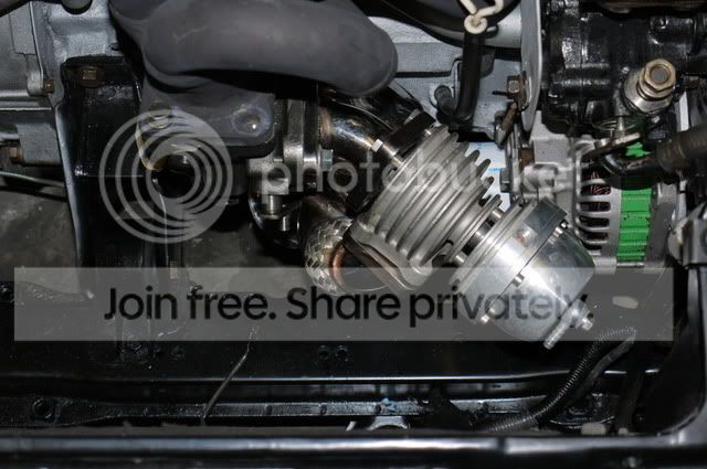

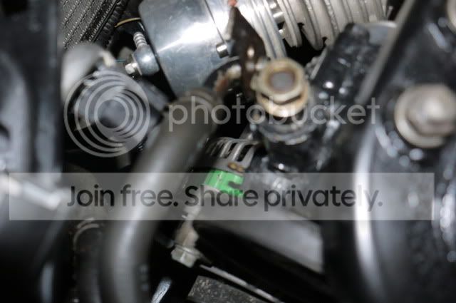

Unsure about running them, as it requires me to put a vband on my DP, and the clearance to the oil drain is close. I think I could run an elbow and miss it (maybe a 45)
Any opinions?
alternator clearance is good.. doesn't look like it, but it is.
Here is the tight spot with the drain... I think I could make it work.

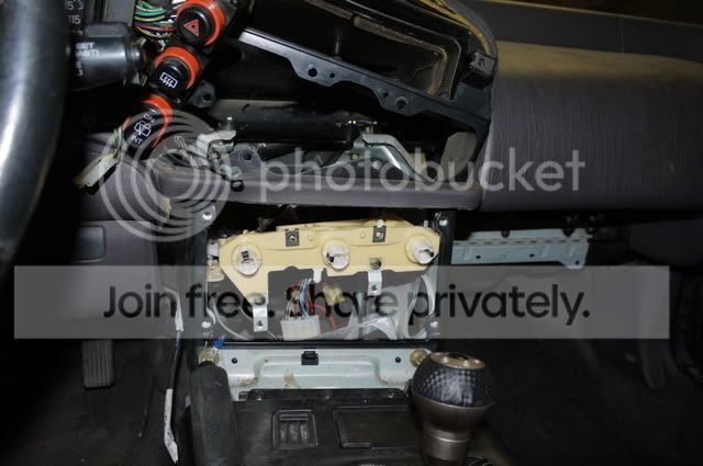

The HVAC control project. I have got to notch a couple places and drill 2 holes. Then mount the controls, and make them look nice.

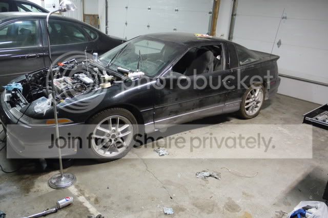

Lastly, it looks better with the weight of the engine... no more 4x4 stance!
