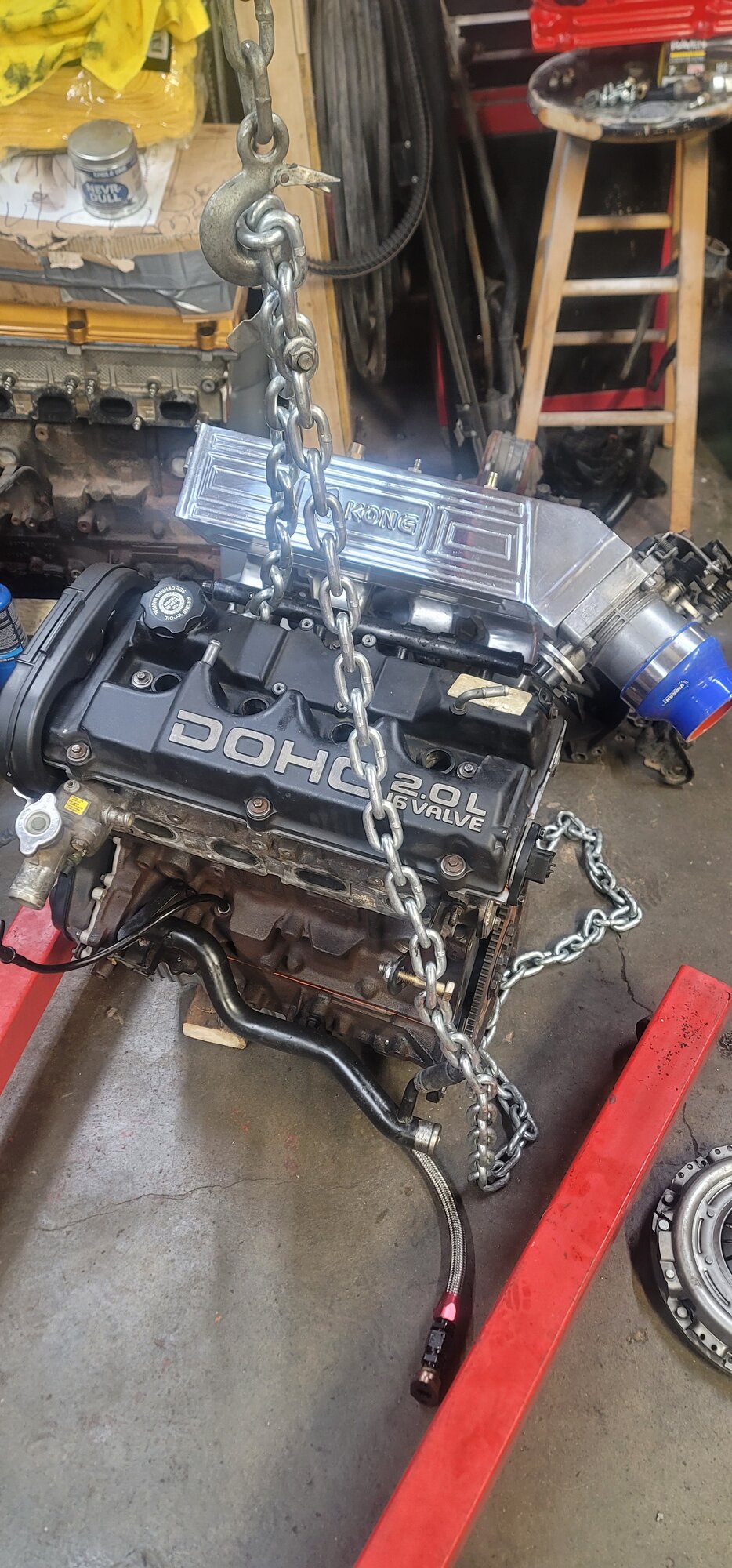

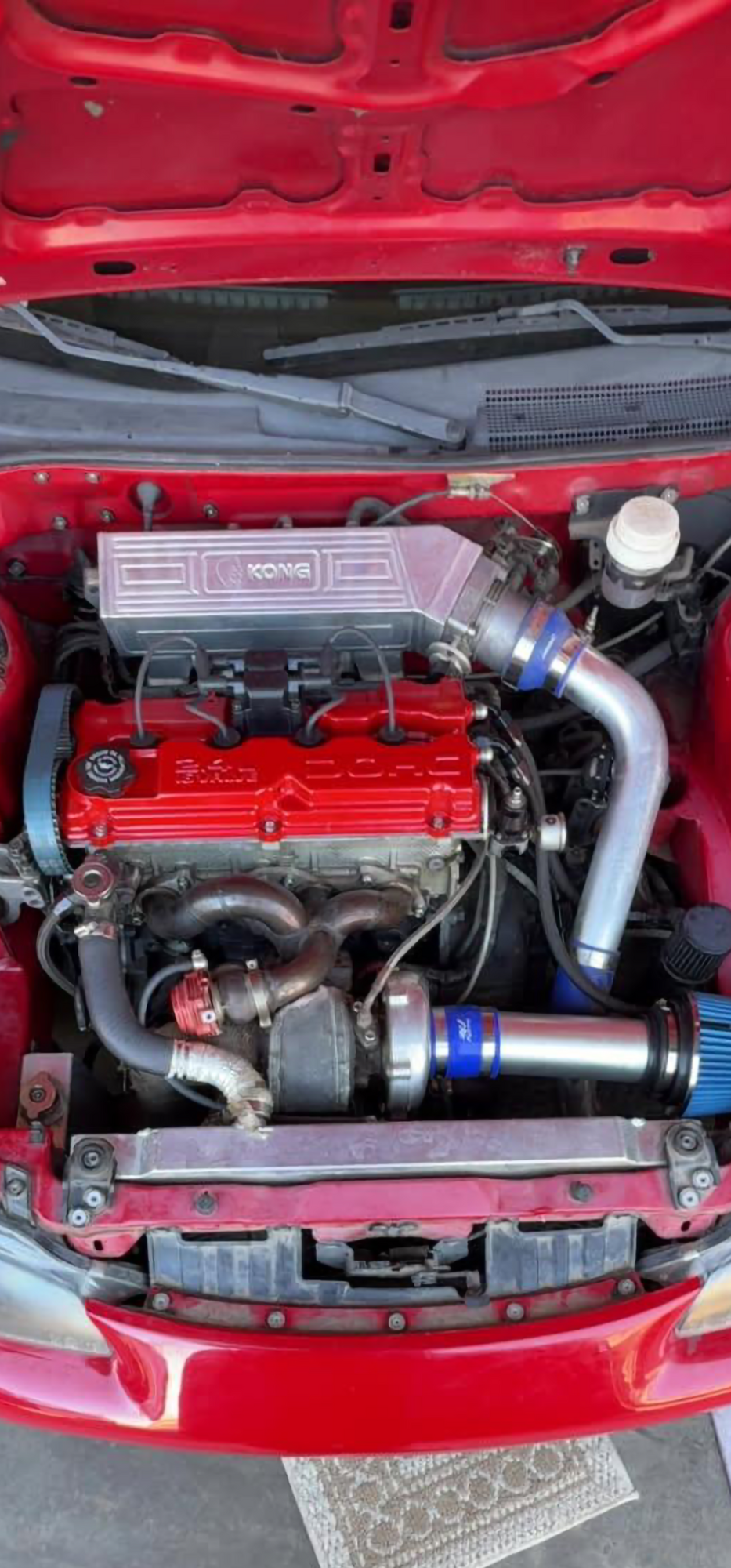

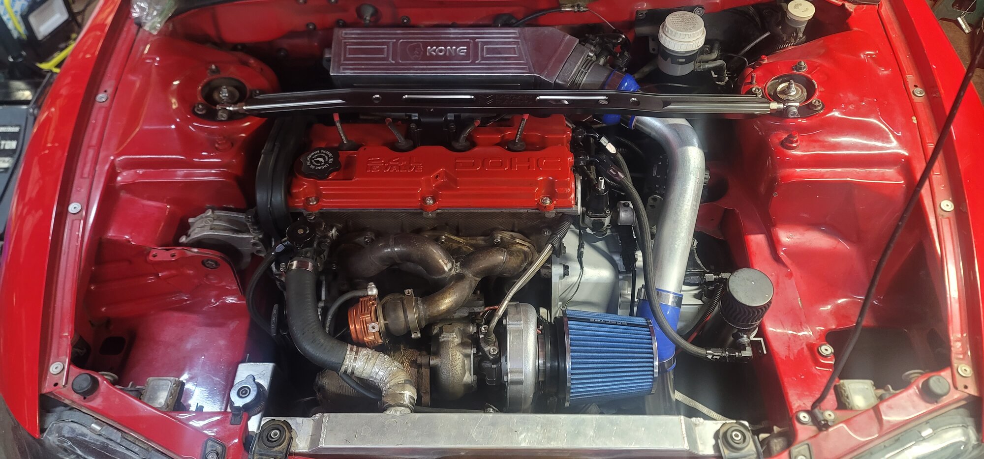

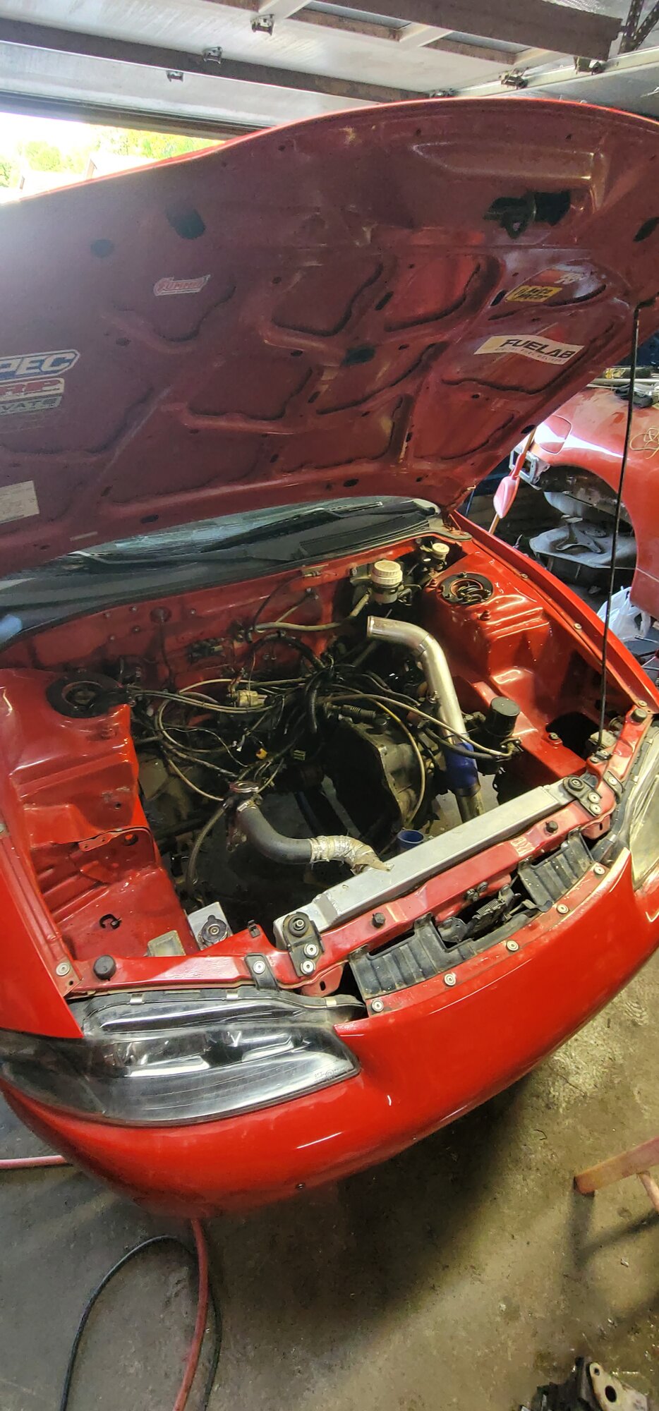

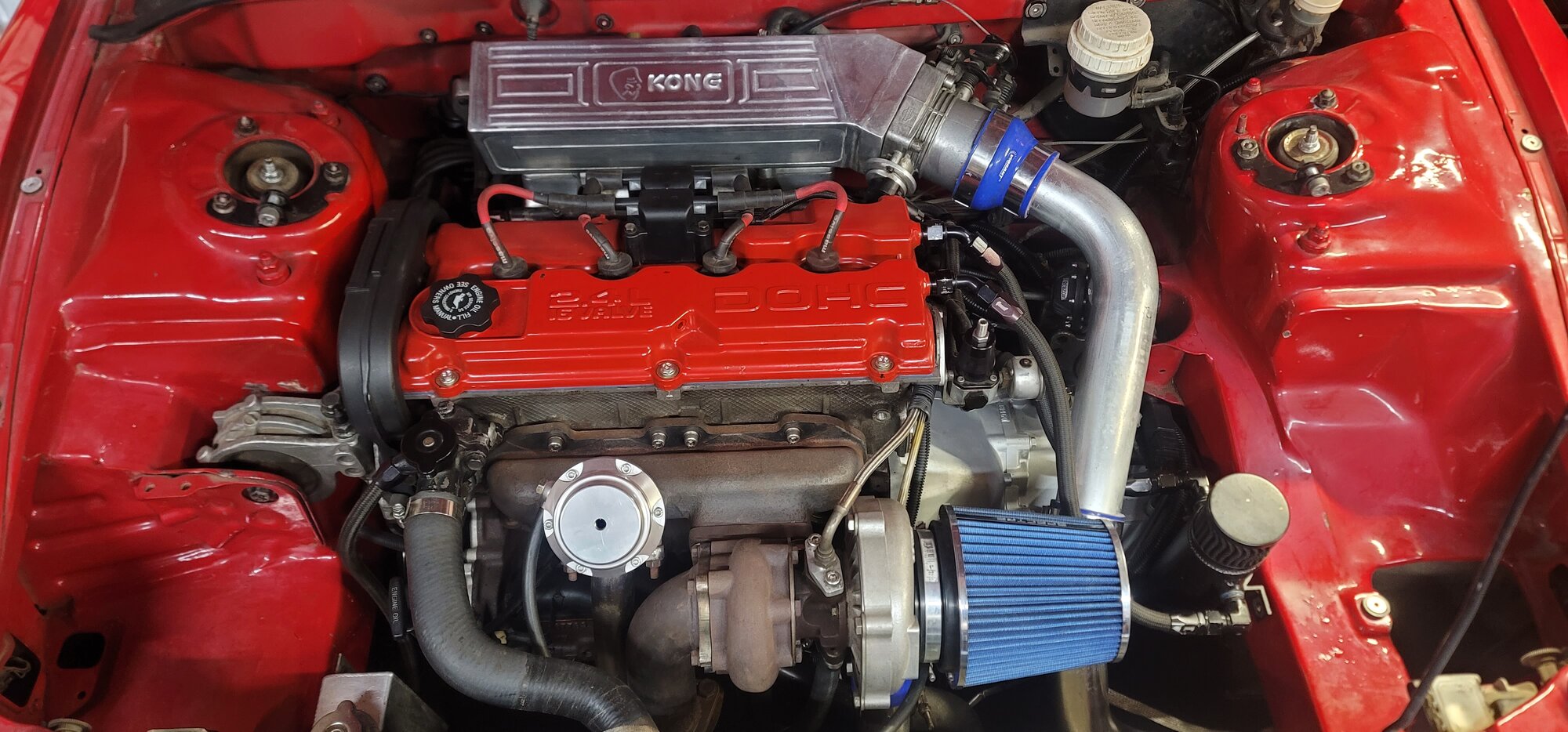

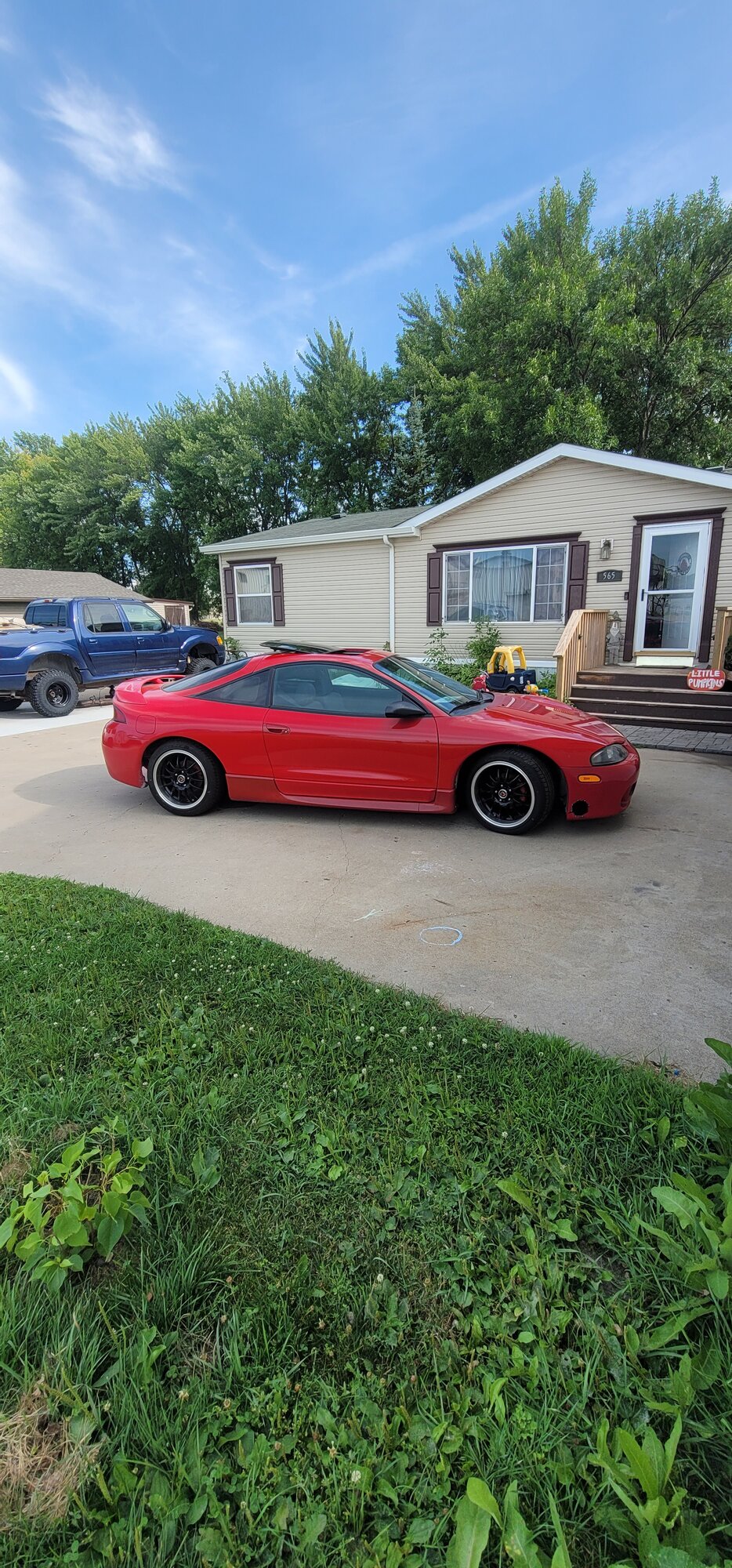

Built 420a Eclipse (early 2k inspired)

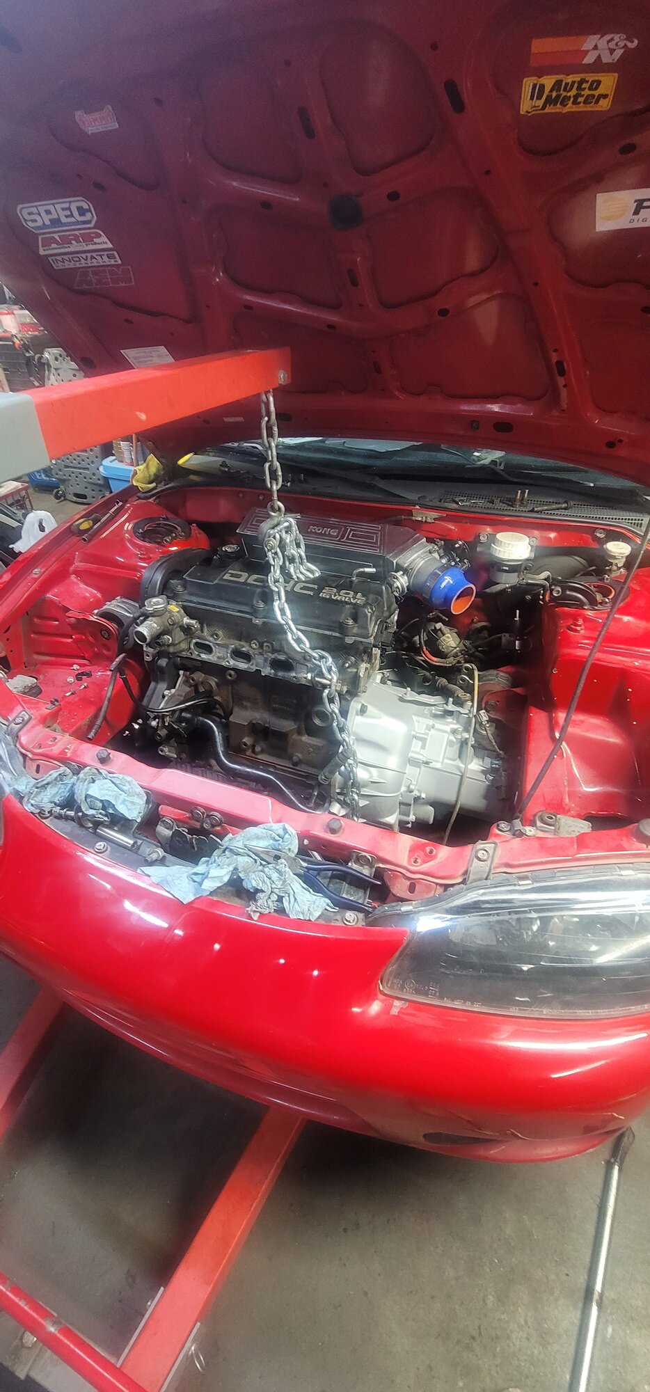

Built 98 eclipse gs with the 420a on e85.

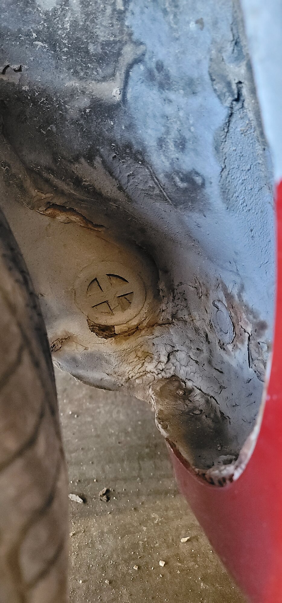

This car is officially mine! That being said I'm trying my hardest to ignore the rot so I can continue to build the engine. I will not let my ocd get the best of me.
My plans are to get it back up and running and see what it'll do on its current tune. After I rip it around on e85, I'll probably tune it on 91 and enjoy a nice solid cruiser. I want to drive it for the summer and worry about certain things later.
I'm going to try and wait till winter to really dig in. I may do some very simple repairs and take everything one step at a time. I don't want it be down like my rs, even though I so badly want to do another full restoration. I don't have a whole lot of free time like I used to so I'll break the build up in pieces.

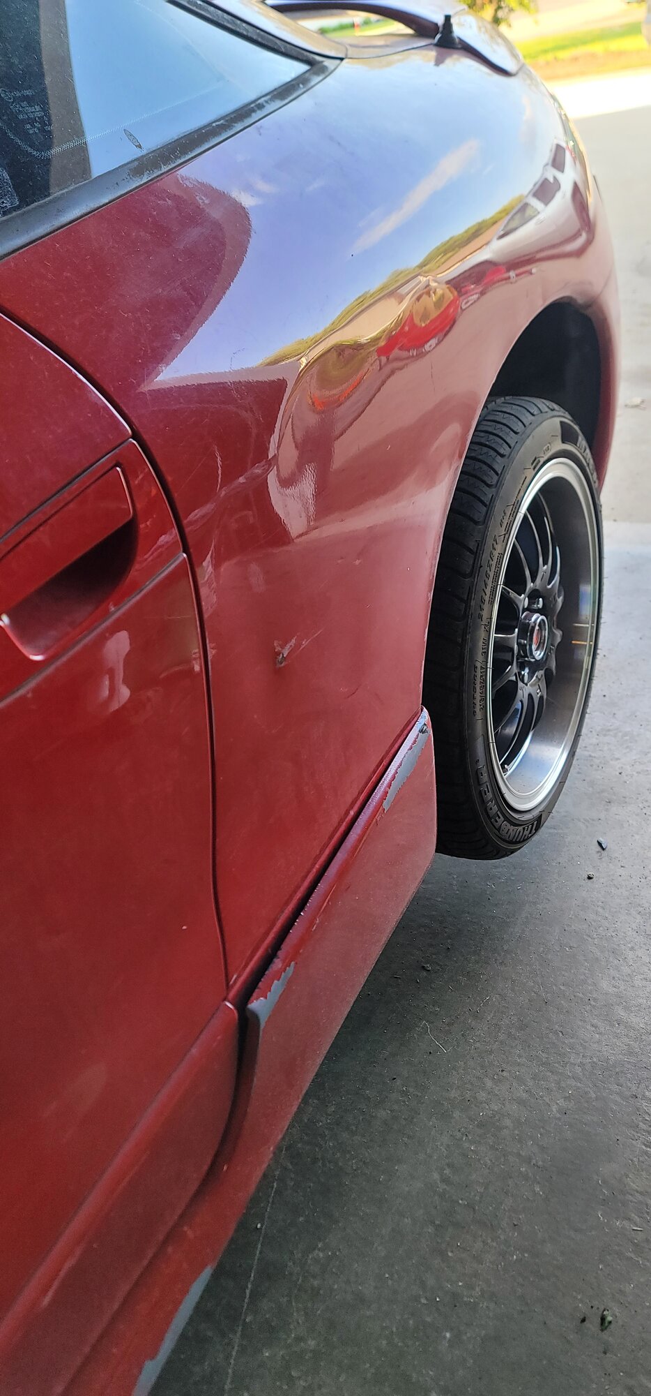

There's a nasty dent I'll have to fit in to fix at some point as well.

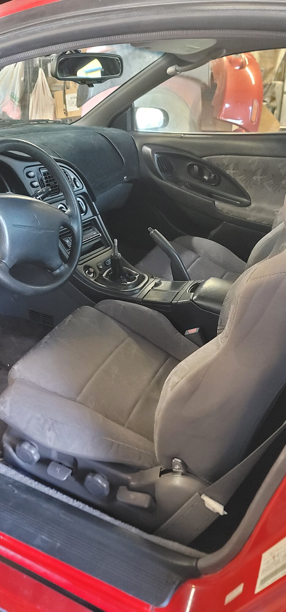

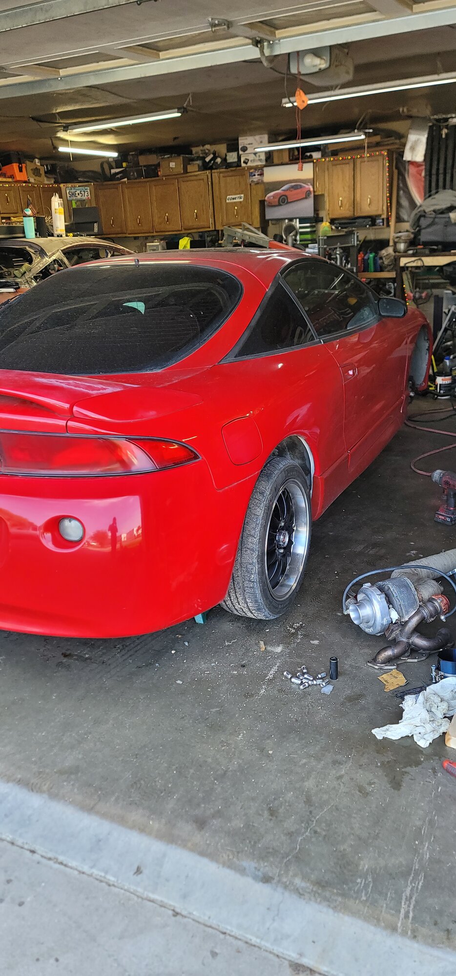

The interior of this thing is truly emaculate. I've never in my life seen an interior this preserved, not even the headliner is sagging at all. It was definitely stored inside, but I think it was stored in a barn somewhere. Things are very crusty in all the wrong places. Alot of areas are fine and I'm hoping I can just build off of the areas that rotted away. We will take everything one step at a time this go round.
I also told my brother that I get to keep my rims and tires. They are probably my favorite ones so far. Here are a bunch of photos of the beginning of an absolute epic build. I've never been so excited.

That R87 radiant fire 🔥 red - looks amazing 🤩 she gorgeous in and out.
That was my original color many shades ago.
I love seeing how you keep the 420s running it’s taken me some time to appreciate them, I’m glad your documenting it.
Breaking things down in sections will be a game changer for sure. I just need to really stick to the plan and not wander off.
I agree with you 100 percent! That red is one of my favorite colors on these cars. I appreciate the compliments on her, it's had one rough ride unfortunately, finally ending up in my hands. There is clear peeling off a little on the hood and on the spoiler, but not real bad.
I would have loved to see your car with the og color. Did you paint it because of bad paint or just wanted it different?
This car is the literal identical twin to my avatar photo. Same year and trim and all. It definitely brings me back.
I'm not going to lie when I got my first turbo eclipse in 2014, I never thought I'd even touch a non turbo again. I've finally learned to love them since I've had both. I just want to preserve as many as I can, fast or slow. Having a non turbo as my first car back in the day, it tugs on the heart strings just a little more.
So when I got mines it had severe gloss fractures so large pieces would come off if you looked at her.
And because men apparently suck at distinguishing between shades of red !
I accidentally picked P88 vs R87 when ordering paint to keep her original. :/
In the first or 2nd page of my build you can see her original color.

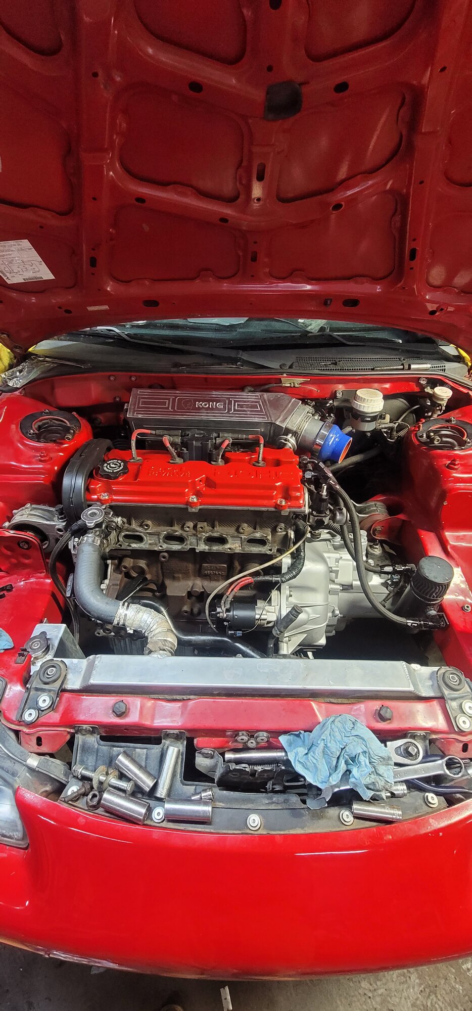

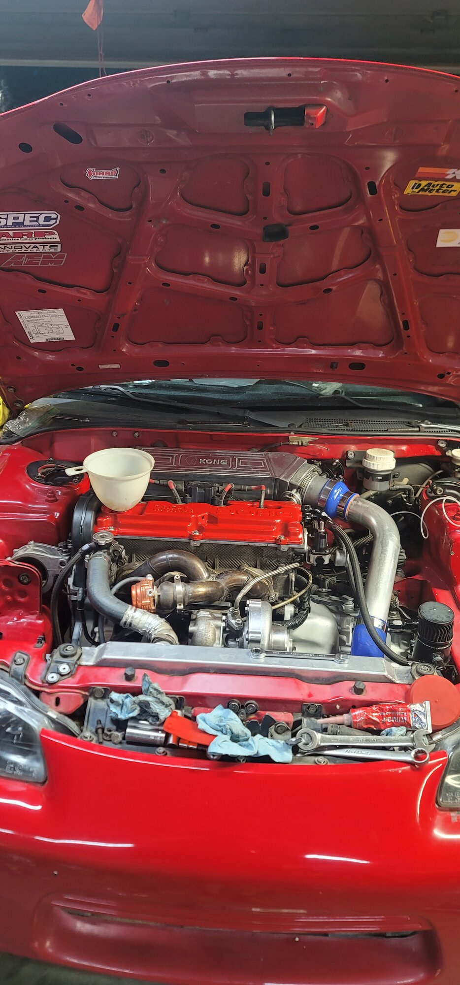

Someone did a killer job on all of it. The fuse box was relocated to the front bumper. The megasquirt is tucked up behind the radio all nice and neat as well. I actually love how everything is set up so I'm going to leave it that way. I'm way to excited to get it going. The engine is almost put back together.

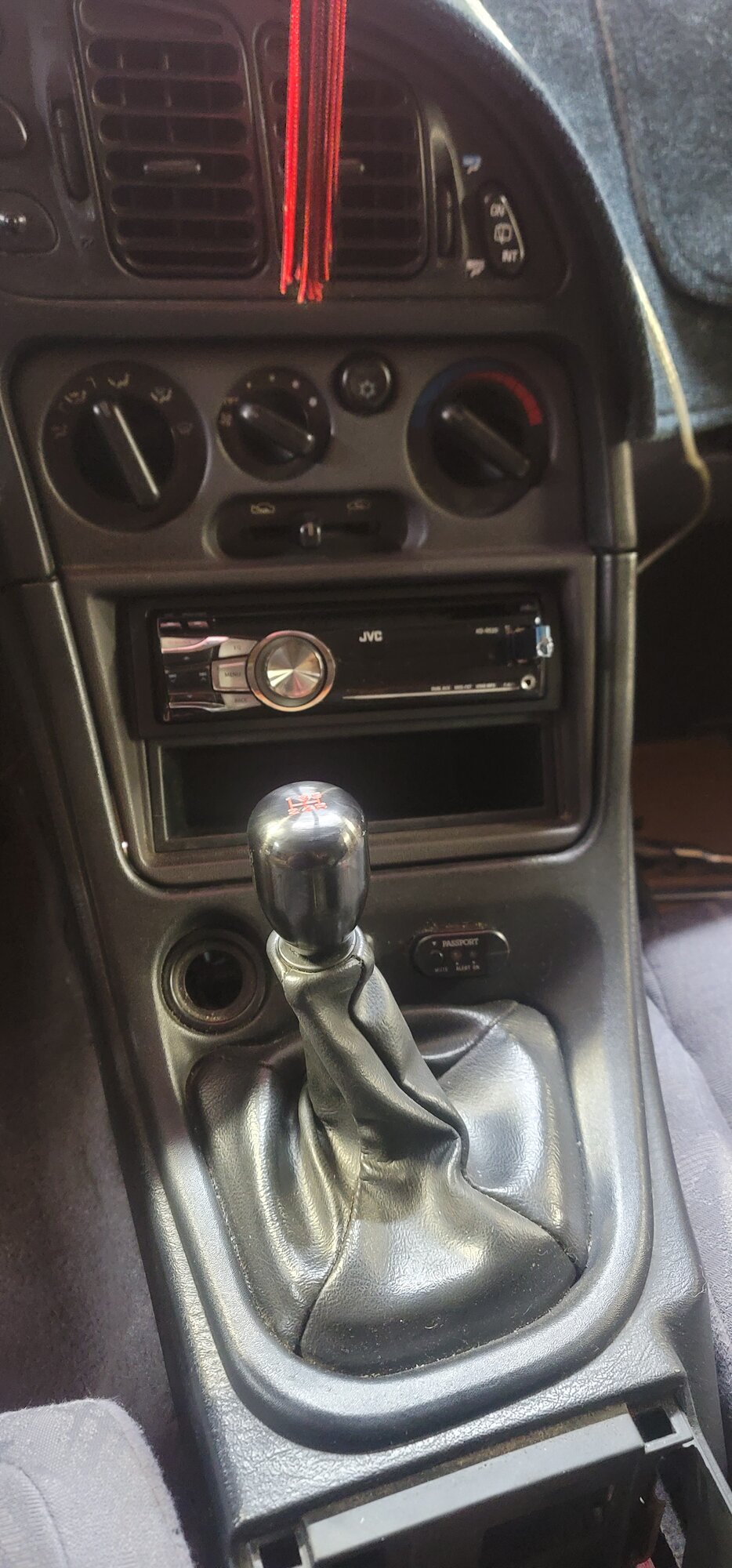

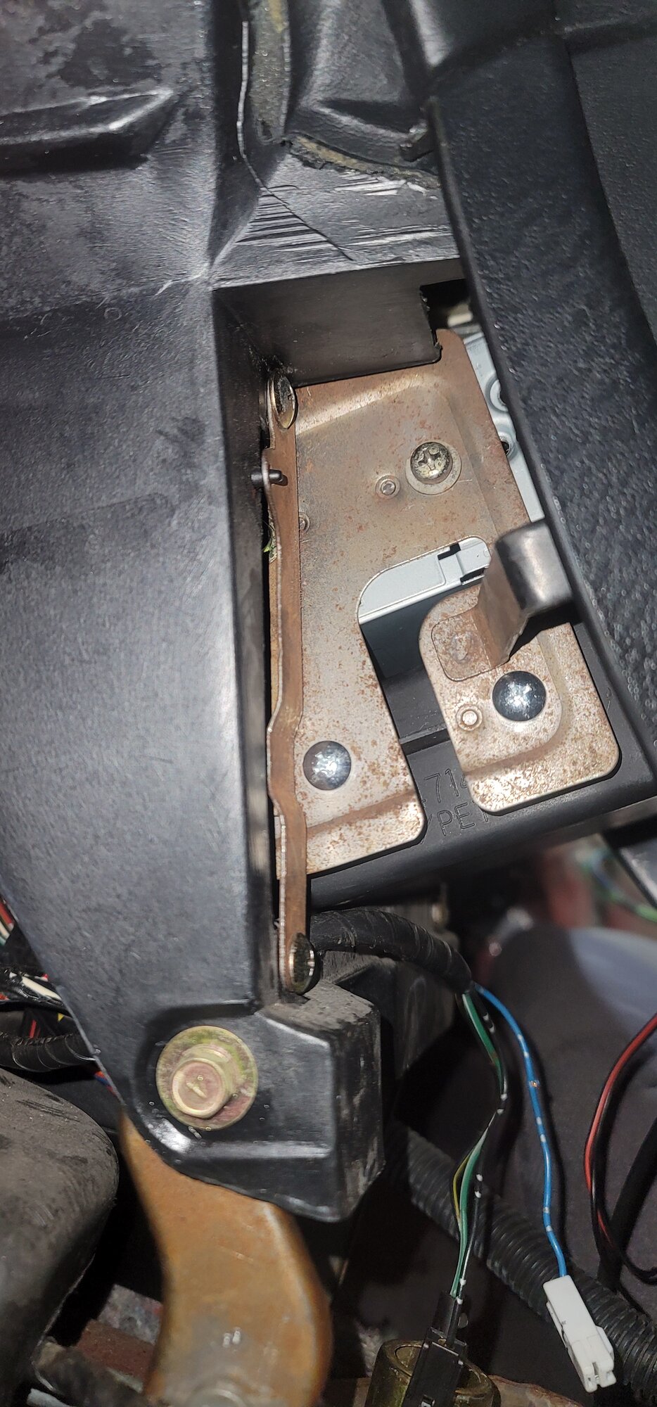

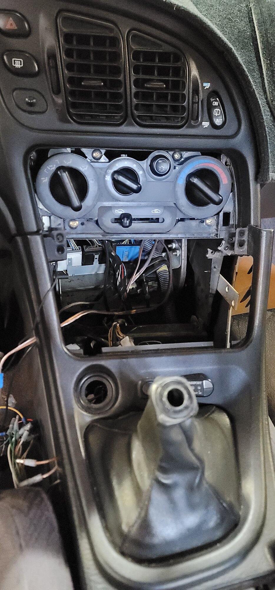

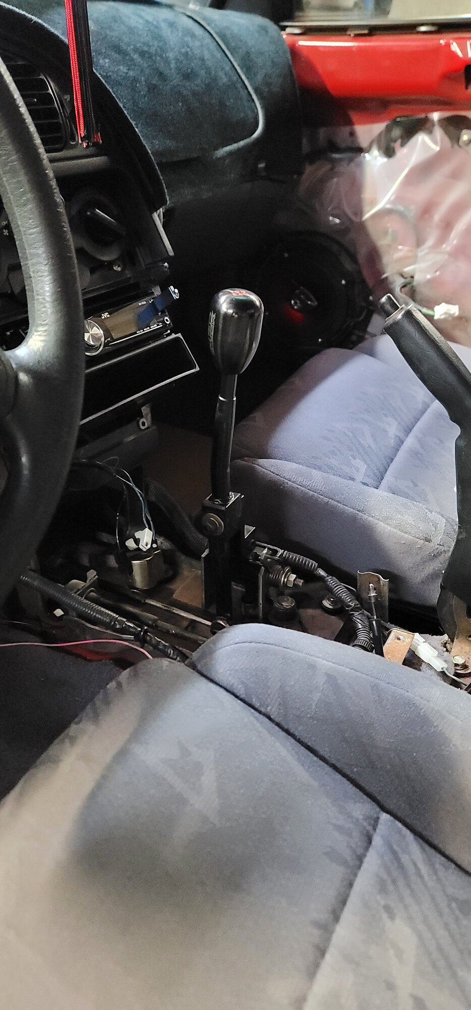

I'm starting to kind of dissect this thing a little more and change certain things on the inside for the better. One big thing I didn't like is the radio sat terrible from the plastic install kit. I also found out all the wires were ran exclusively from the speakers to the radio. I want all that to stay in a factory manor.

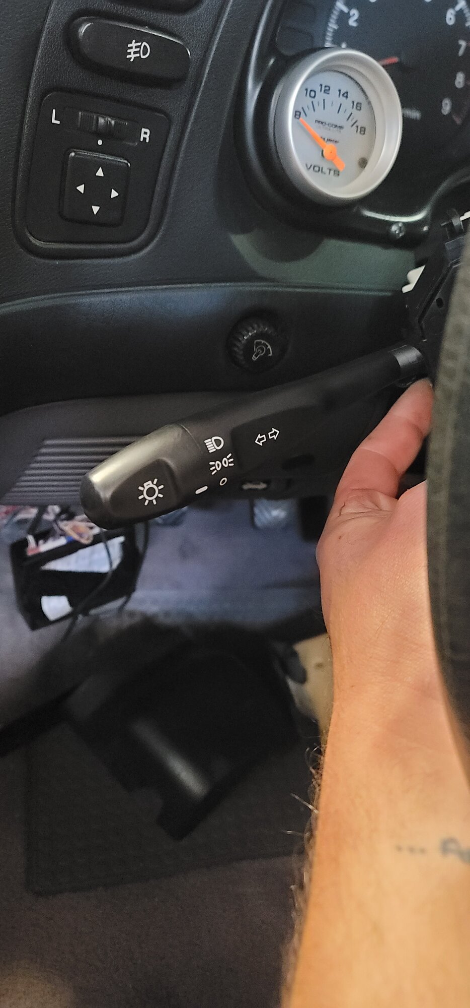

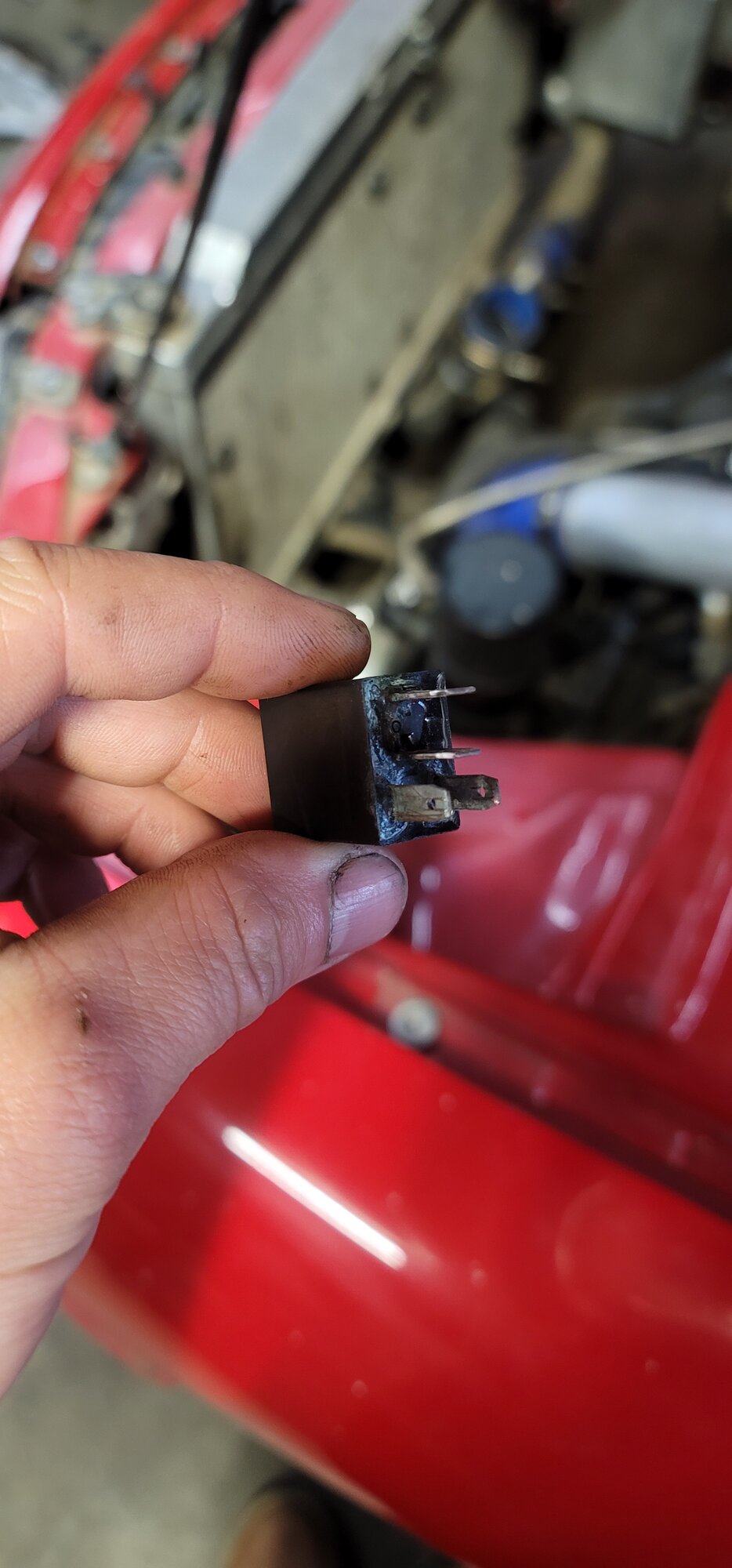

I also noticed it had a new turn signal switch. I tested the lights and come to find out the tail lights and dash lights didn't work. First things I checked were the fuses which were good. The next thing I checked was the relay and what do you know they work again. I'll be looking for a used factory one. It sucks because the 95s that I have are different from the 98.

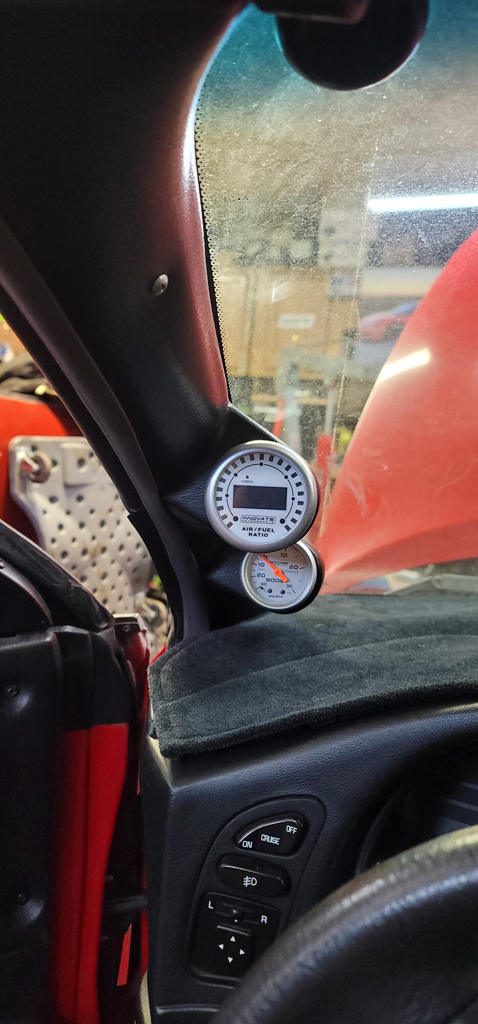

This is ending up turning into the snowball effect. While I have the console out I might as well throw in my solid shifter bushings. While everything is apart I might as well rewire the gauges and instead of using the dual gauge pod ill throw in my triple. Things are moving quite nicely but a hair overwhelming.

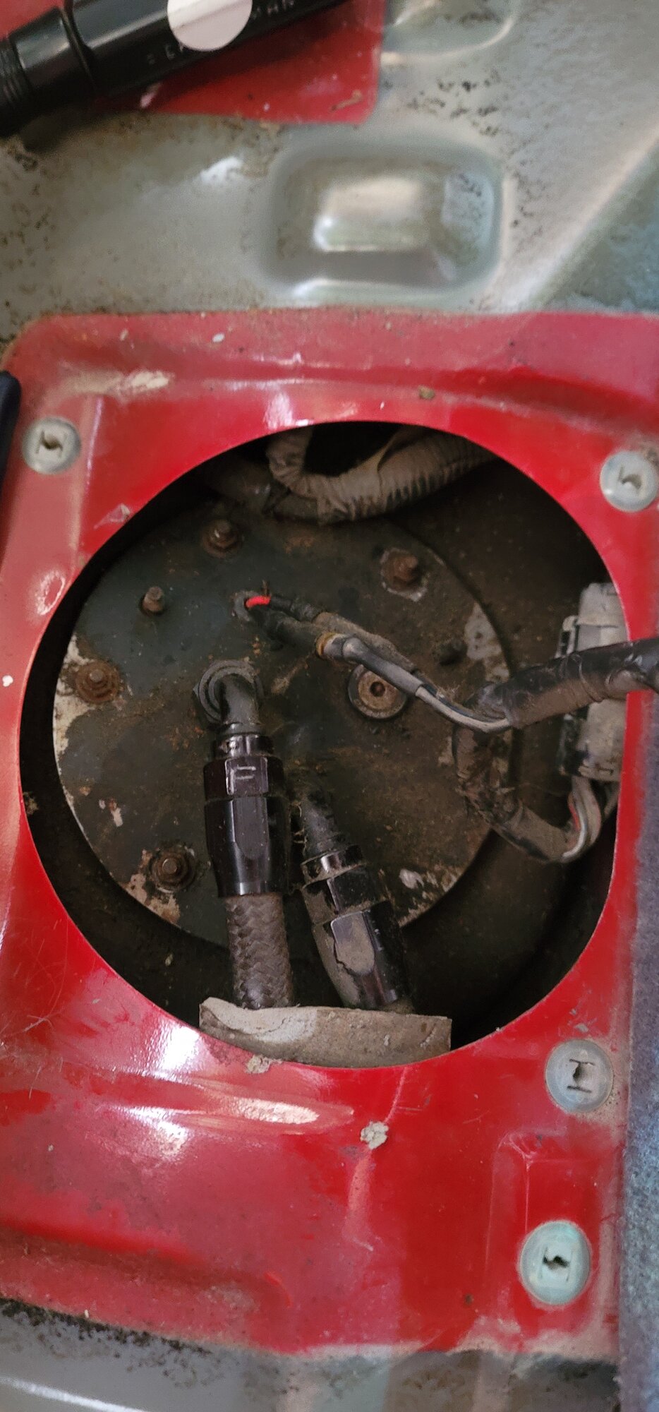

I ended up turning the key on with power and obviously a bucket to catch the fuel, I was like man the pump is stupid loud. Whoever built this thing did not let the 420a slow them down. They loved this car for what it was and no money was spared. Fat lines from front to back and a tank full of e85.

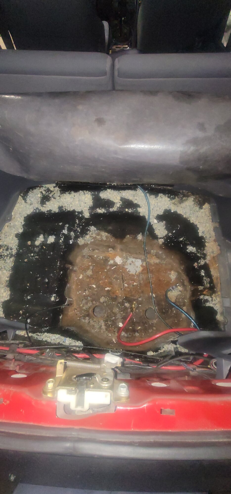

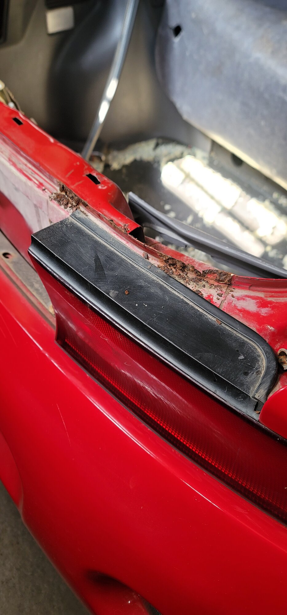

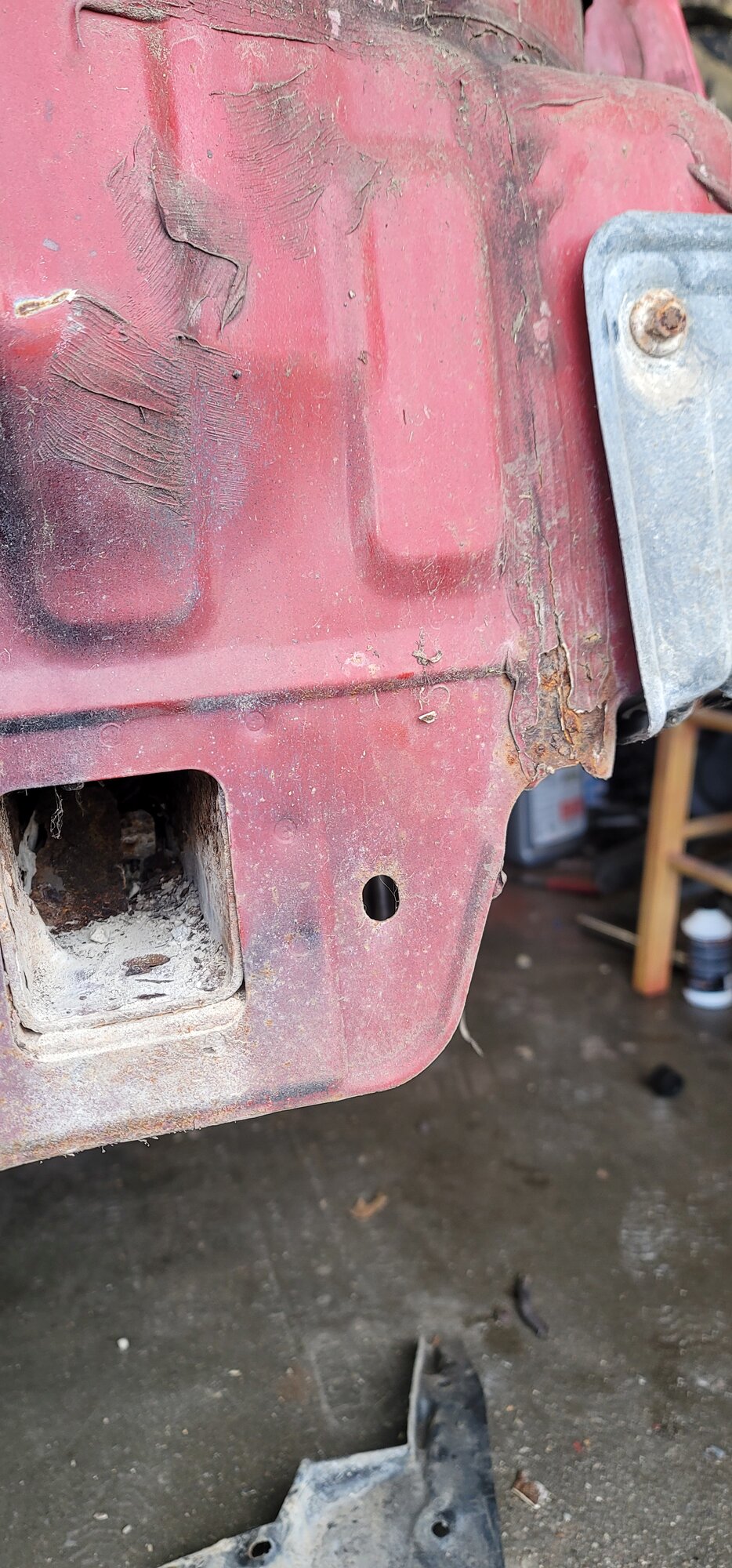

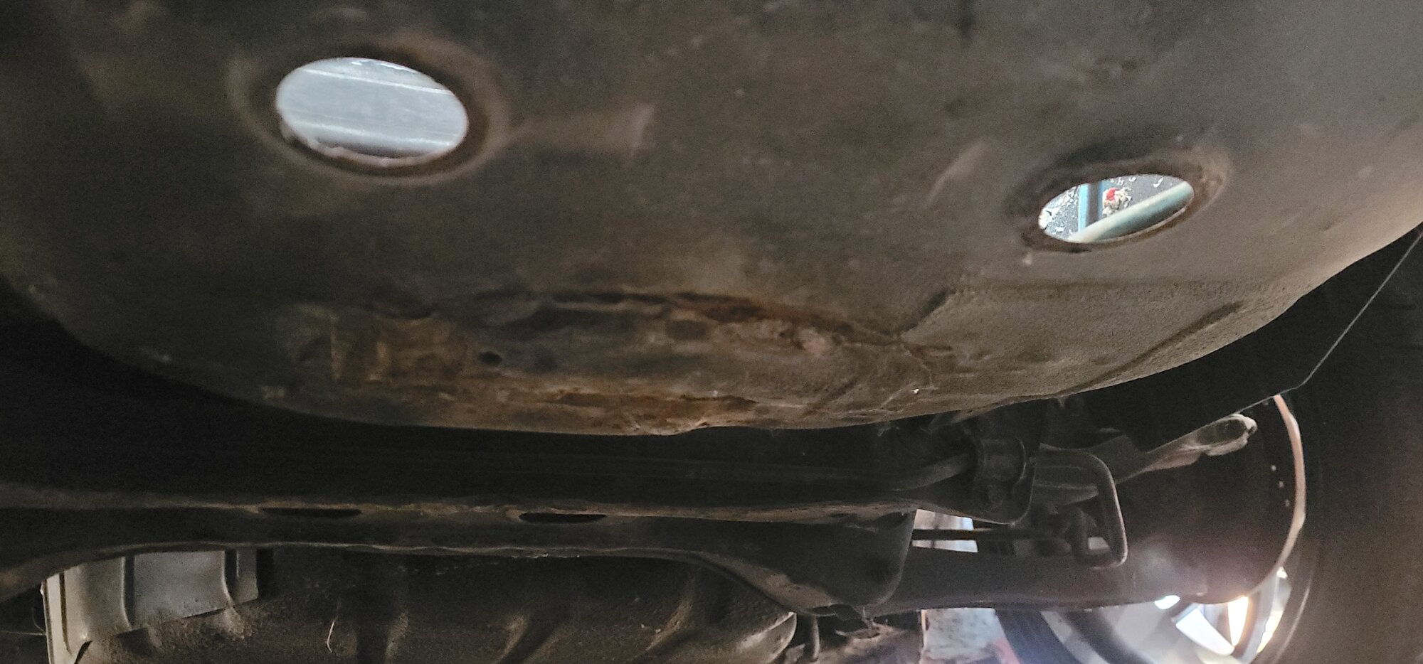

I'm still waiting on some parts for the engine so I decided to start tearing the trunk down. Someone really took there time to rust proof the trunk but the sound deadening didn't help if water hit it. I see no holes so far but once I start grinding I'm sure some will pop up. I'm still taking my time and doing certain things on certain days. I'm eventually going to pull the engine and trans to redo the engine bay since there is rust in some areas.

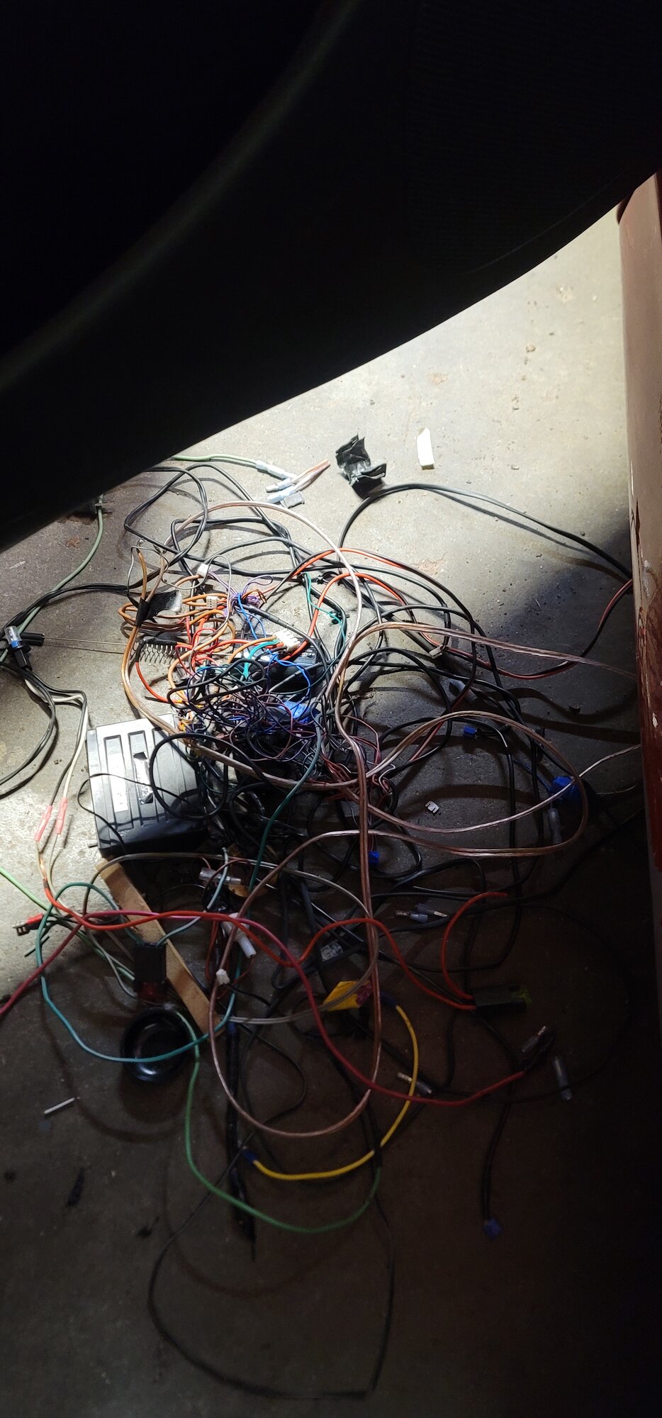

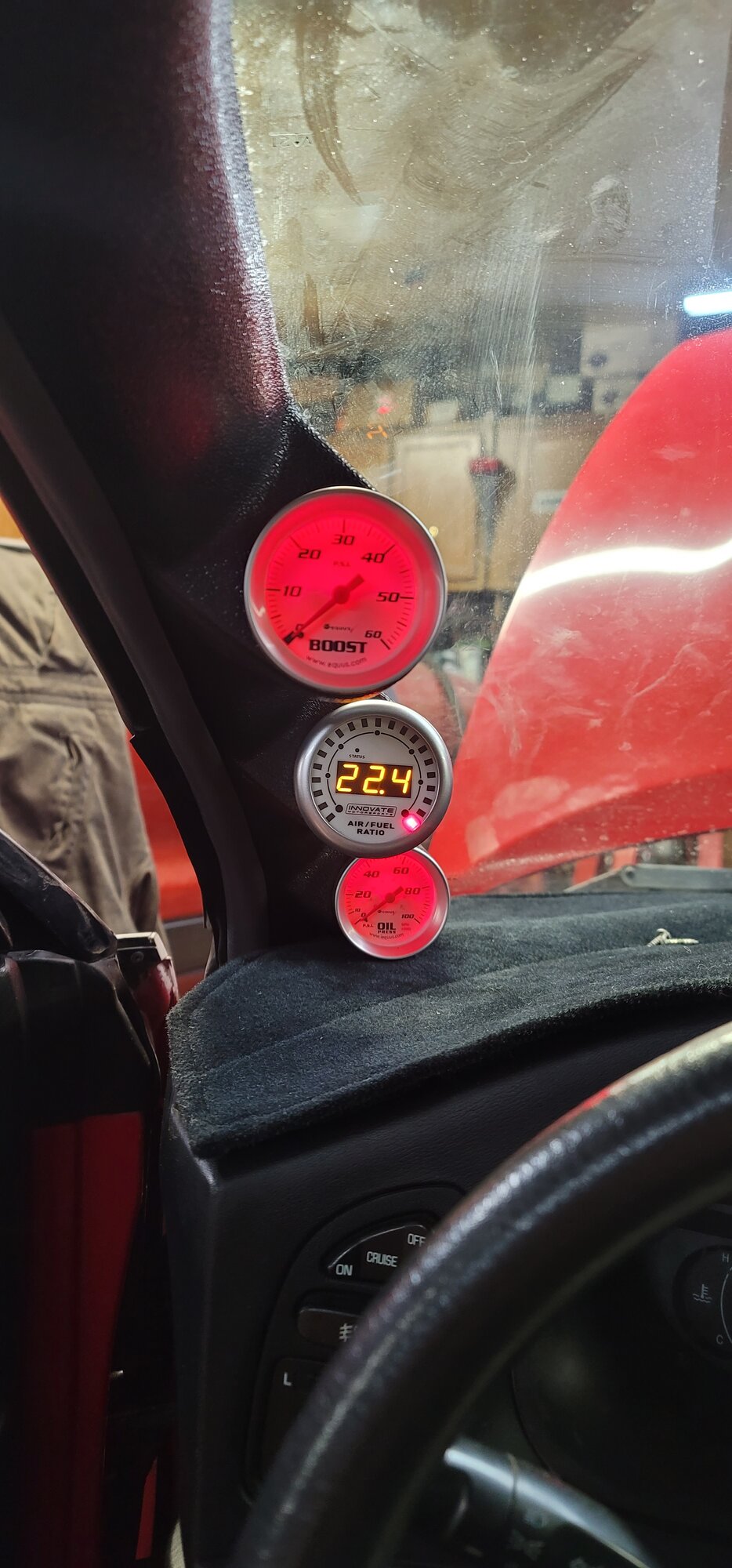

When im not messing with the trunk im working on some interior bits. Ive been ripping the auto start bs out since it was an absolute rats nest. I'm just going to restart on the gauges so I know exactly how everything is ran. I'll keep the wideband but I'm going to get a new boost and oil pressure gauge. Things weren't ran real nice in that department, so ill be making it nice and clean.

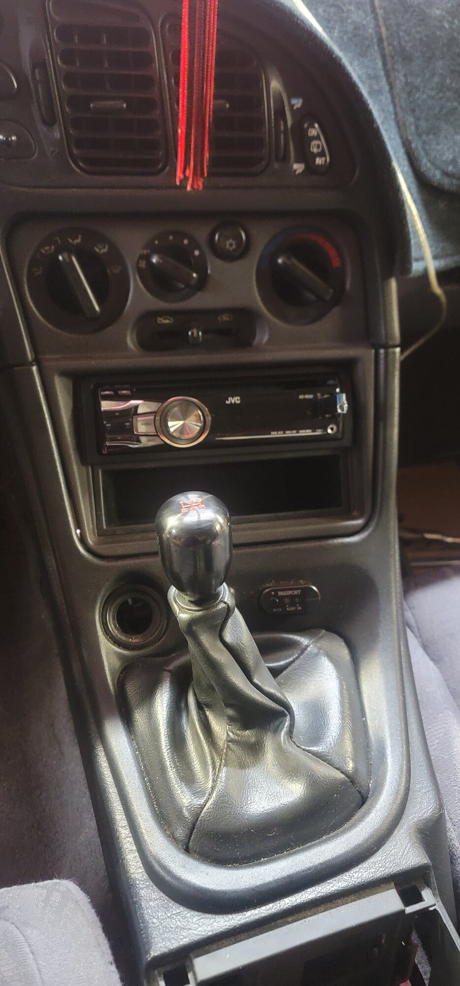

I also tossed in my short throw that was going to go into my rs. I have a feeling this one will be driving long before that one.
You have no idea how badly I want to dig into the rust. It's been eating away at me since I got the thing. I'm trying to ignore and stick to the plan.
That’s neat looking shifter 👀
And wow 😮 that trunk, but from what I have seen, even the best rust free 2G has rust in the trunk!
That’s literally what I have been working on the last few days - making it look ….. better.
Make sure to ID how it started in the first place , for me it was
A) the rear tail light gaskets
and
B) the factory sealant on the hatch where it connects to the rear quarters panels.
That shifter feels really good compared to the other short throw you can get on ebay. I like how this one uses the factory bushings and such.

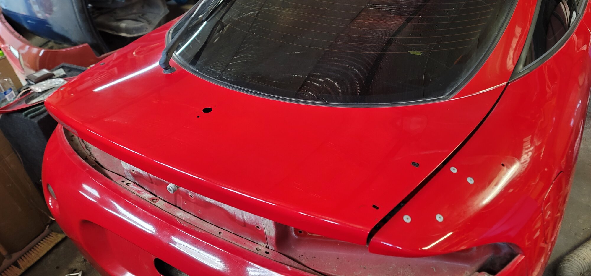

I went ahead and blew through the drain tubes first just to make sure they werent clogged. I do have brand new tail light gaskets I'm going to throw on as well. While I do that I'm going to do the sequential tail light mod that was on my rs.

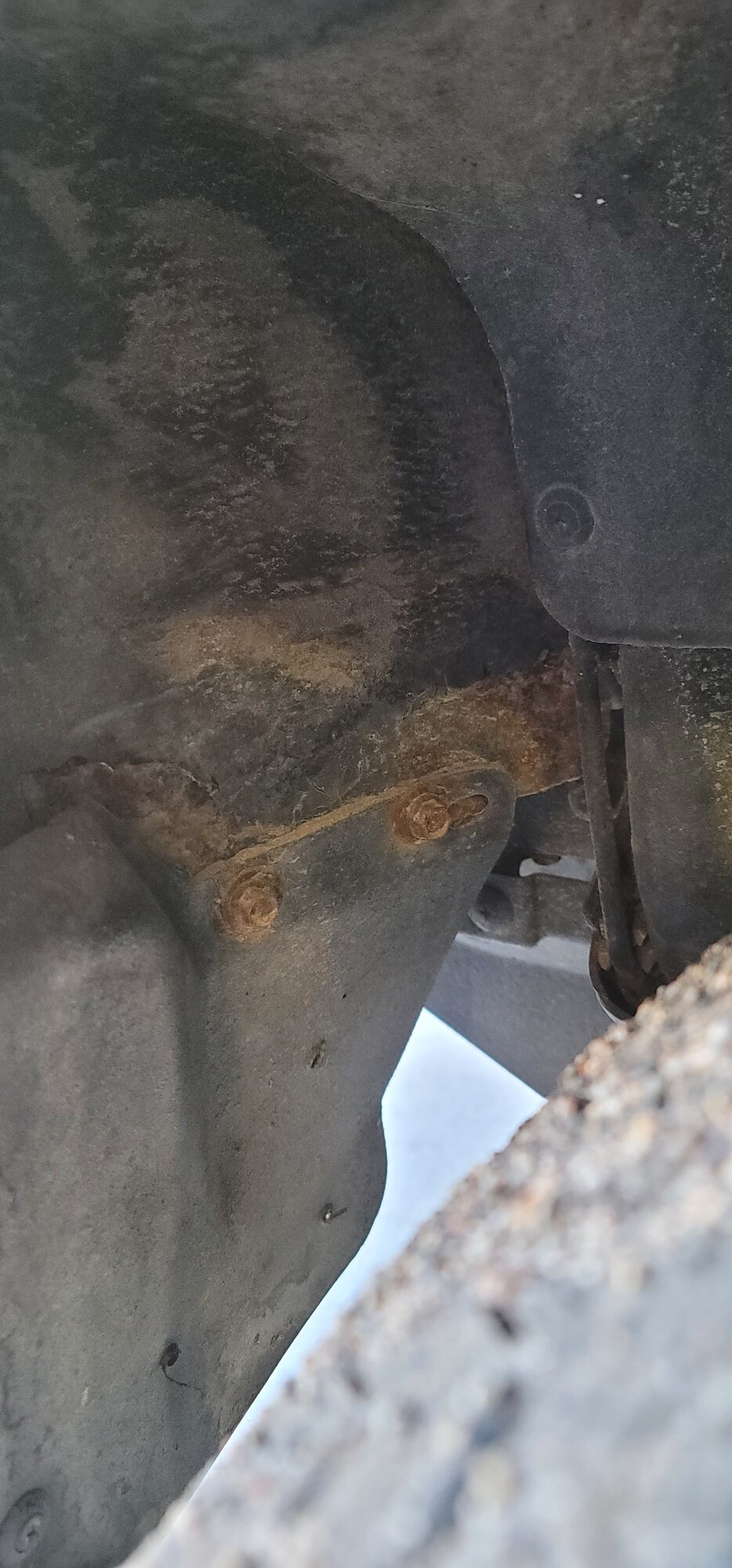

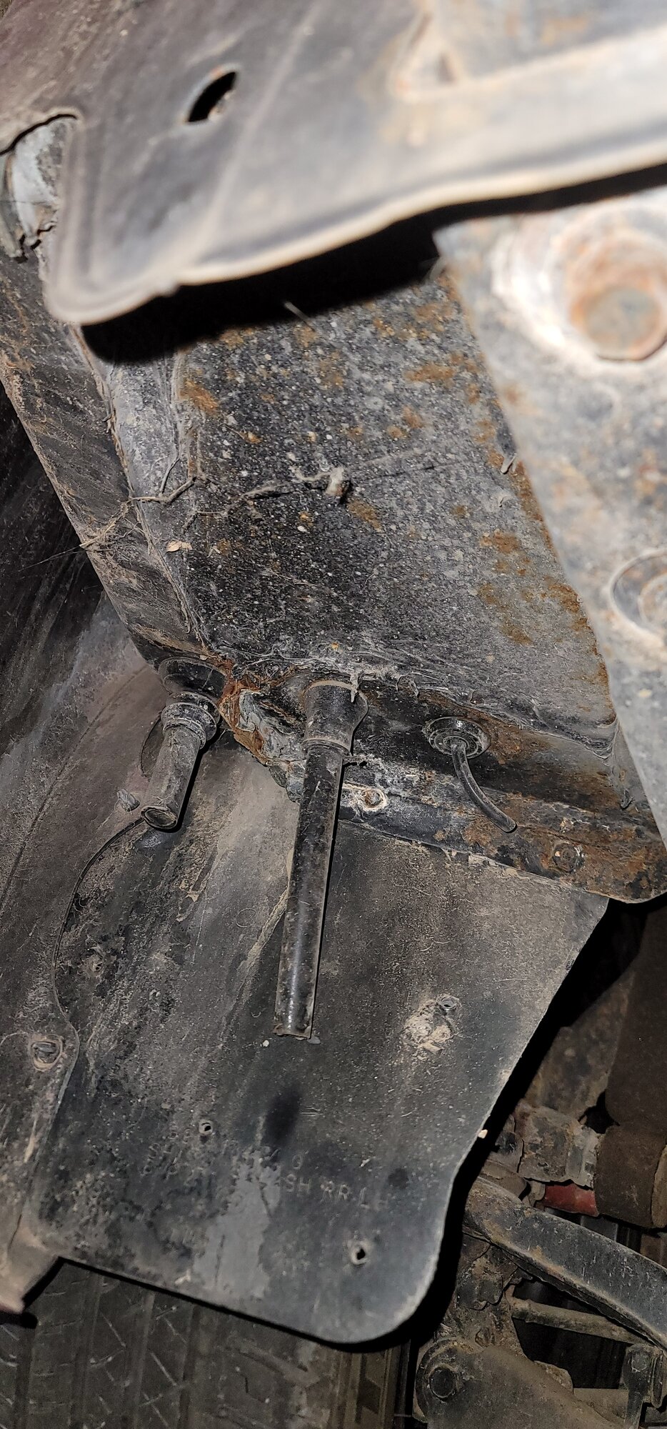

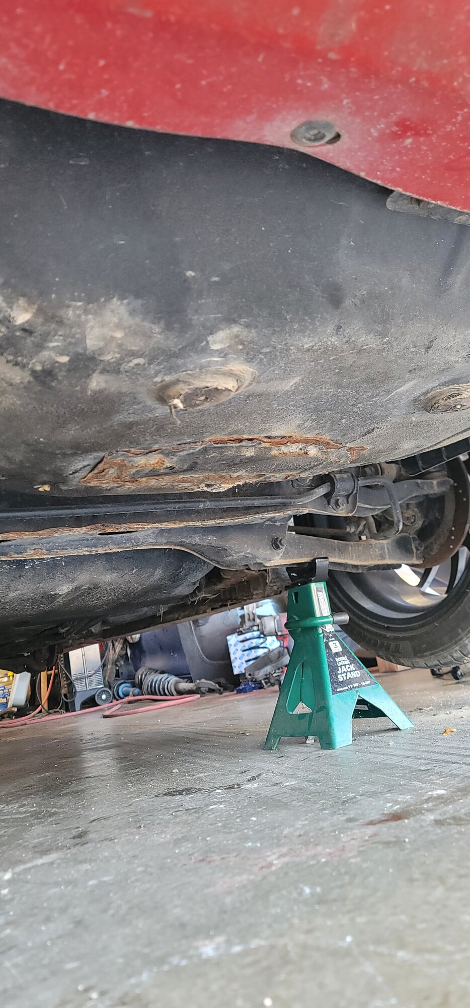

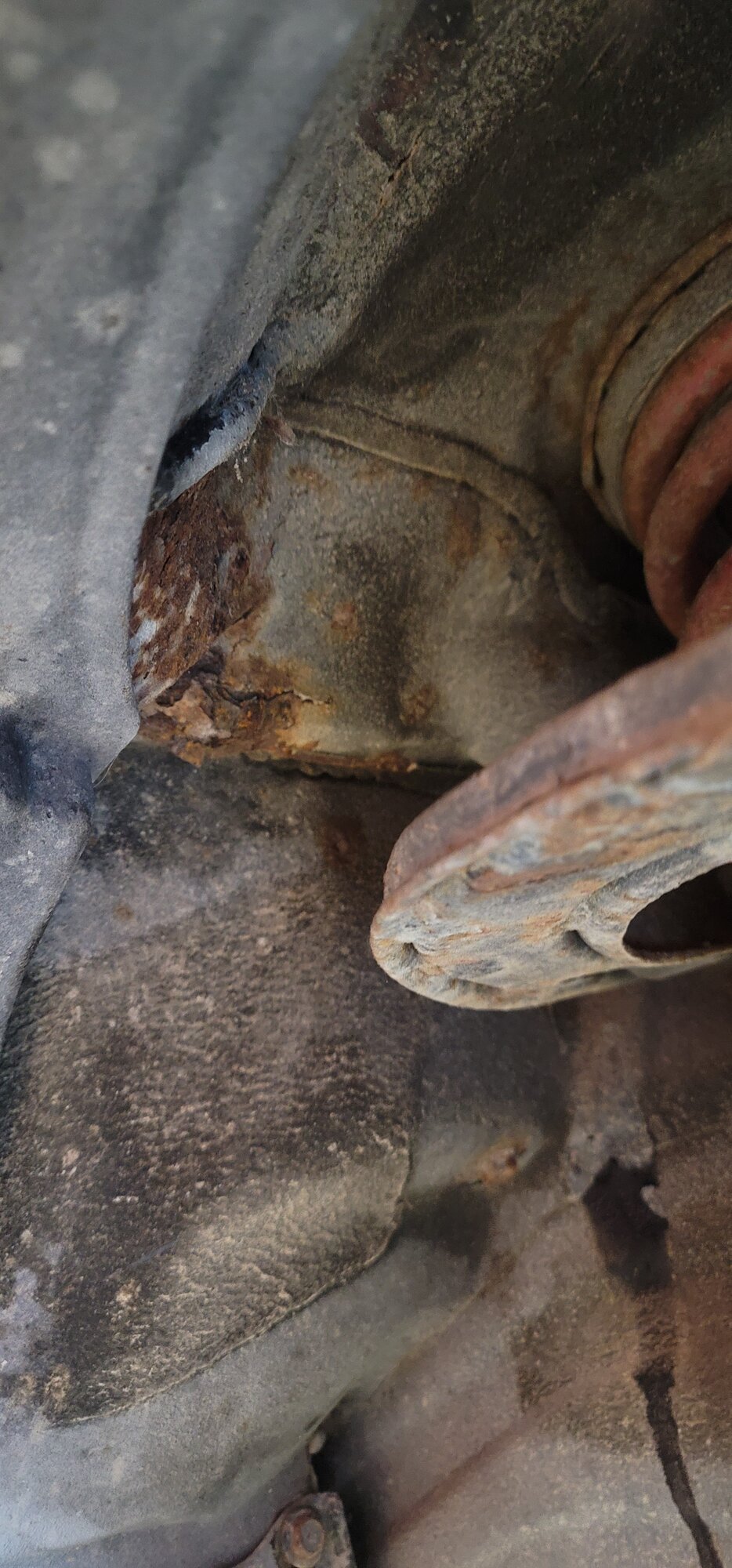

Someone actually put silicone on all the seams underneath the car, so that is really concerning.

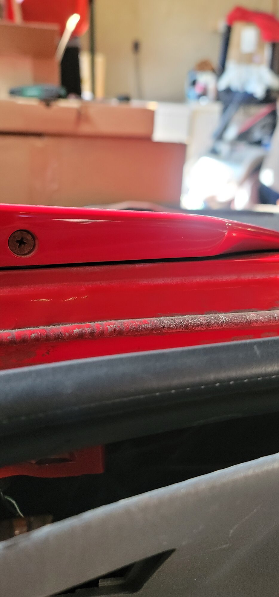

I can almost bet its the spoiler. Since this one is a 3 piece and I can see some gasket not even touching the car anymore.
On a side note the rubber trim cleaned up extremely well. They had dirt and grime built up on them. This is probably the nicest set I've seen aside from my talon.

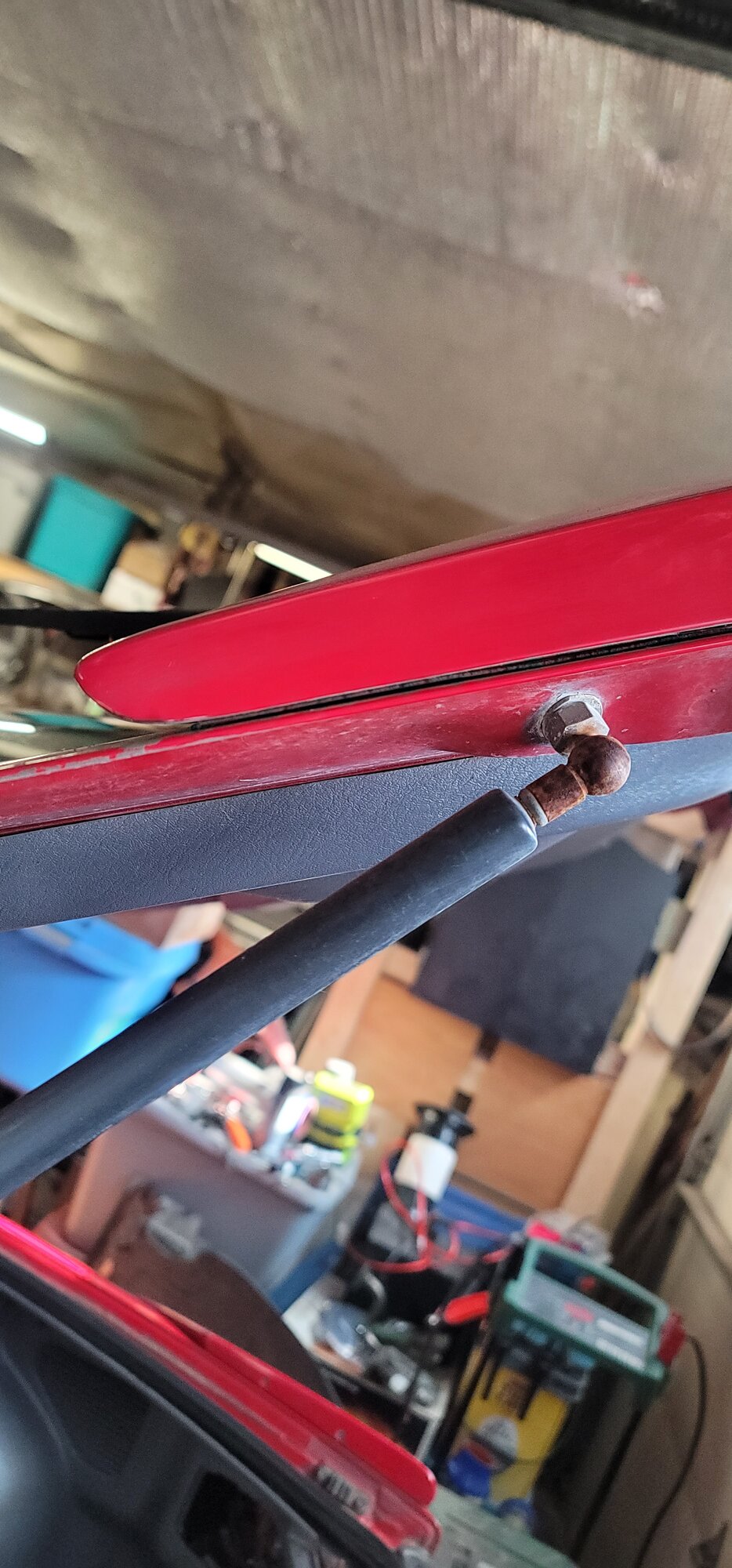

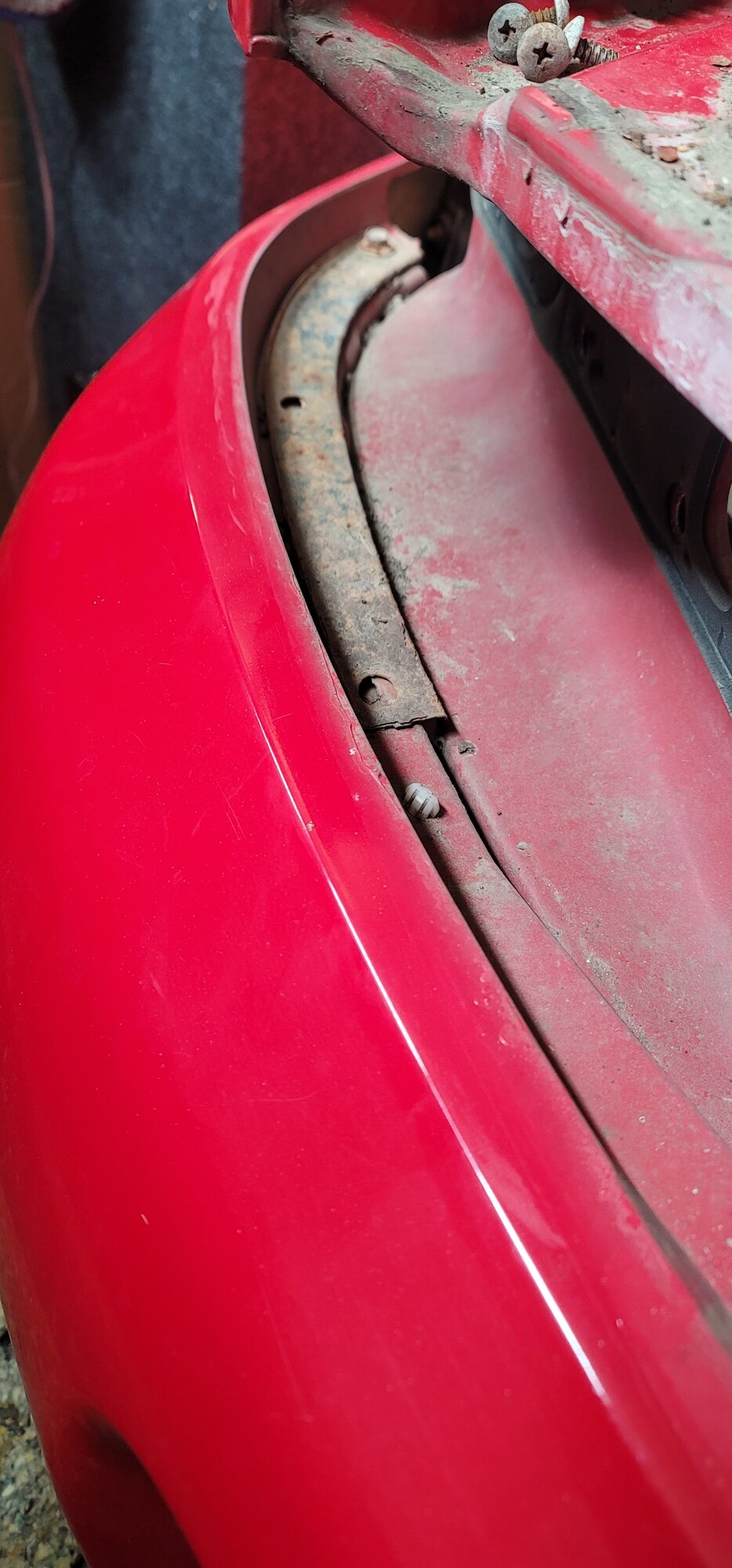

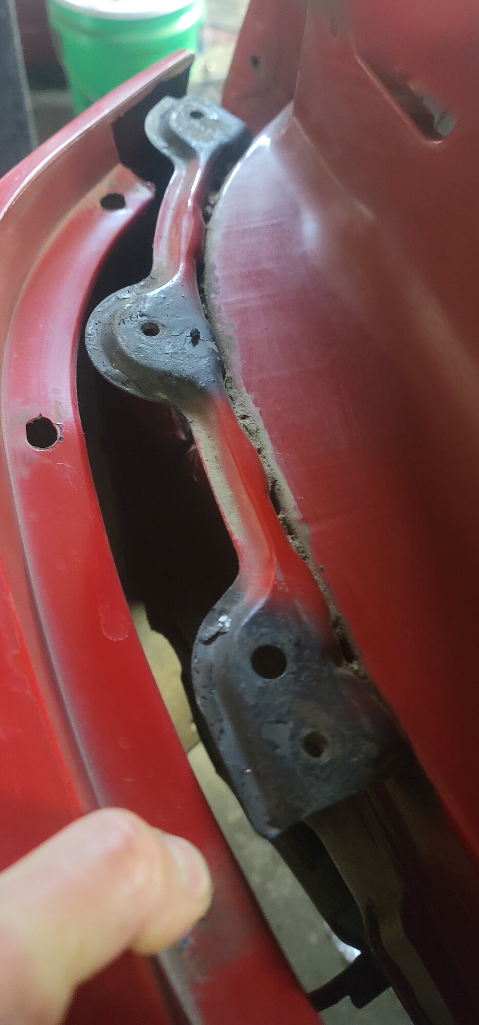

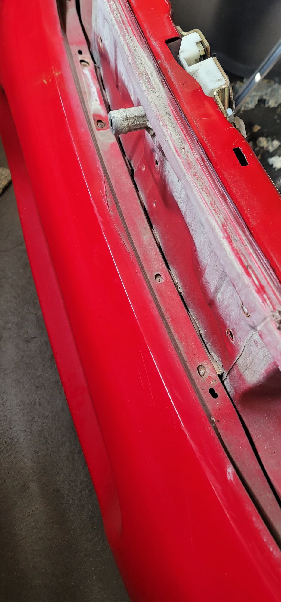

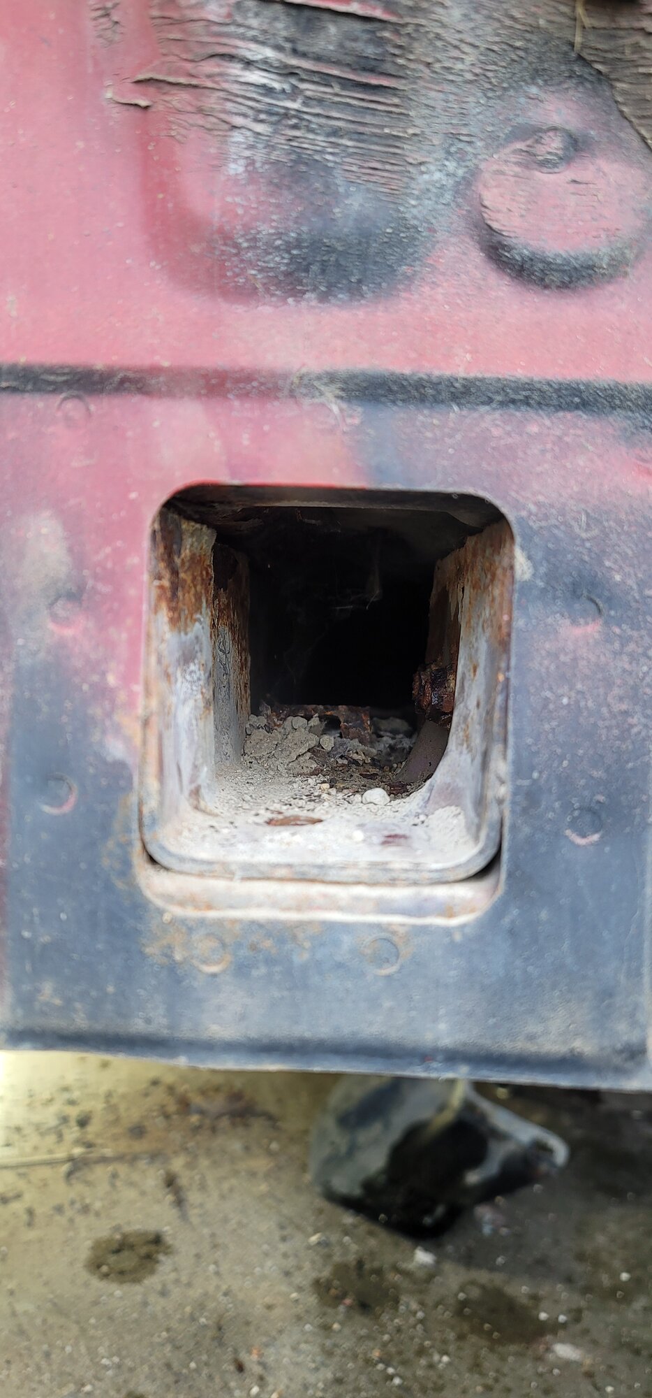

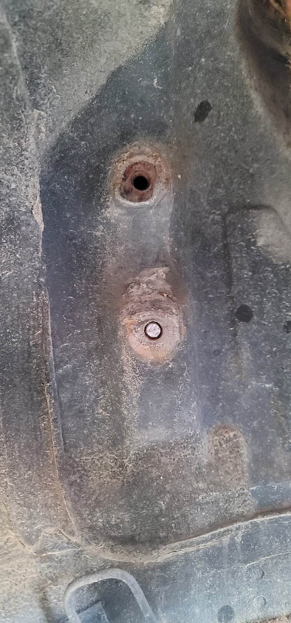

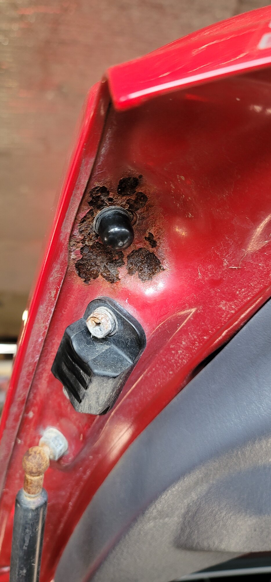

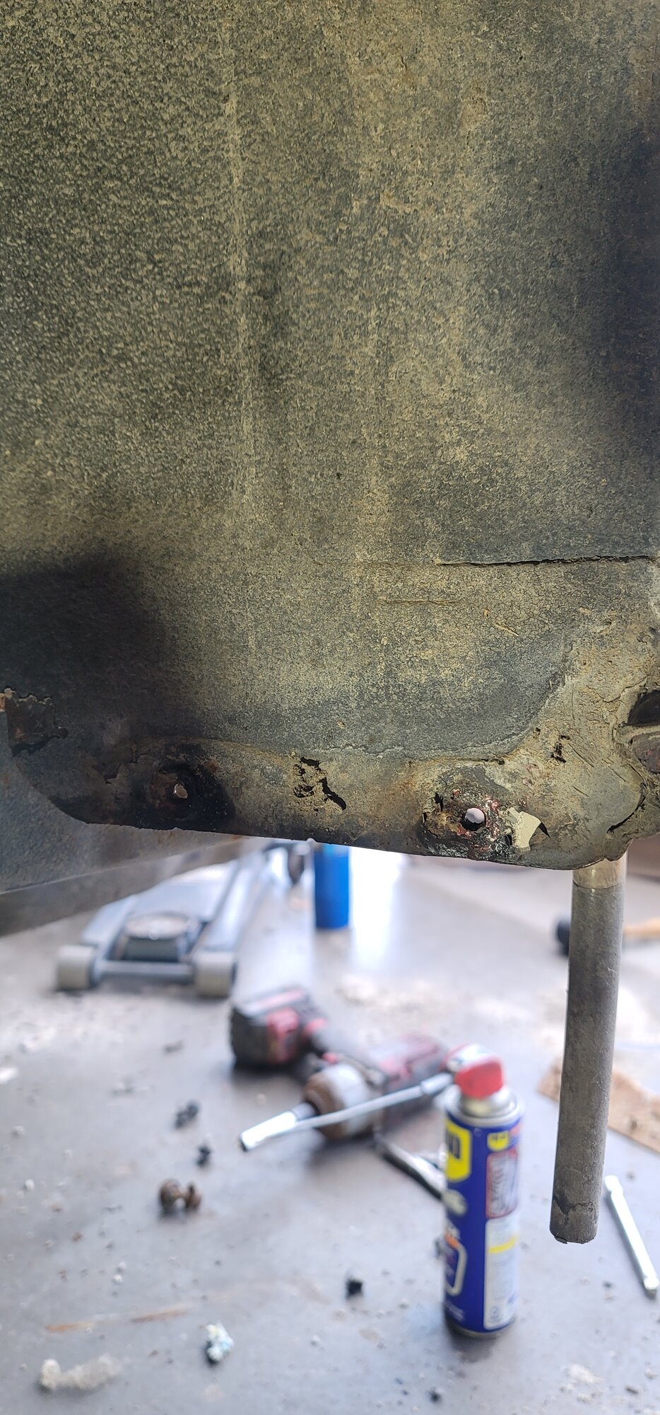

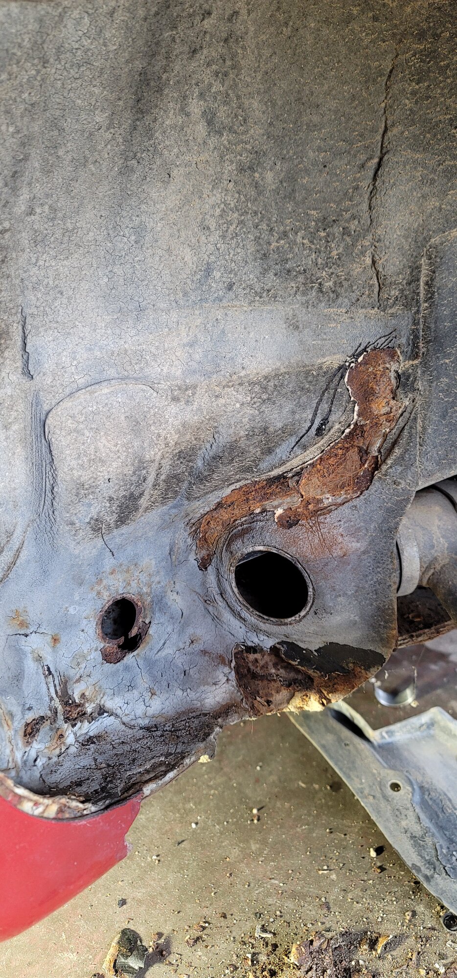

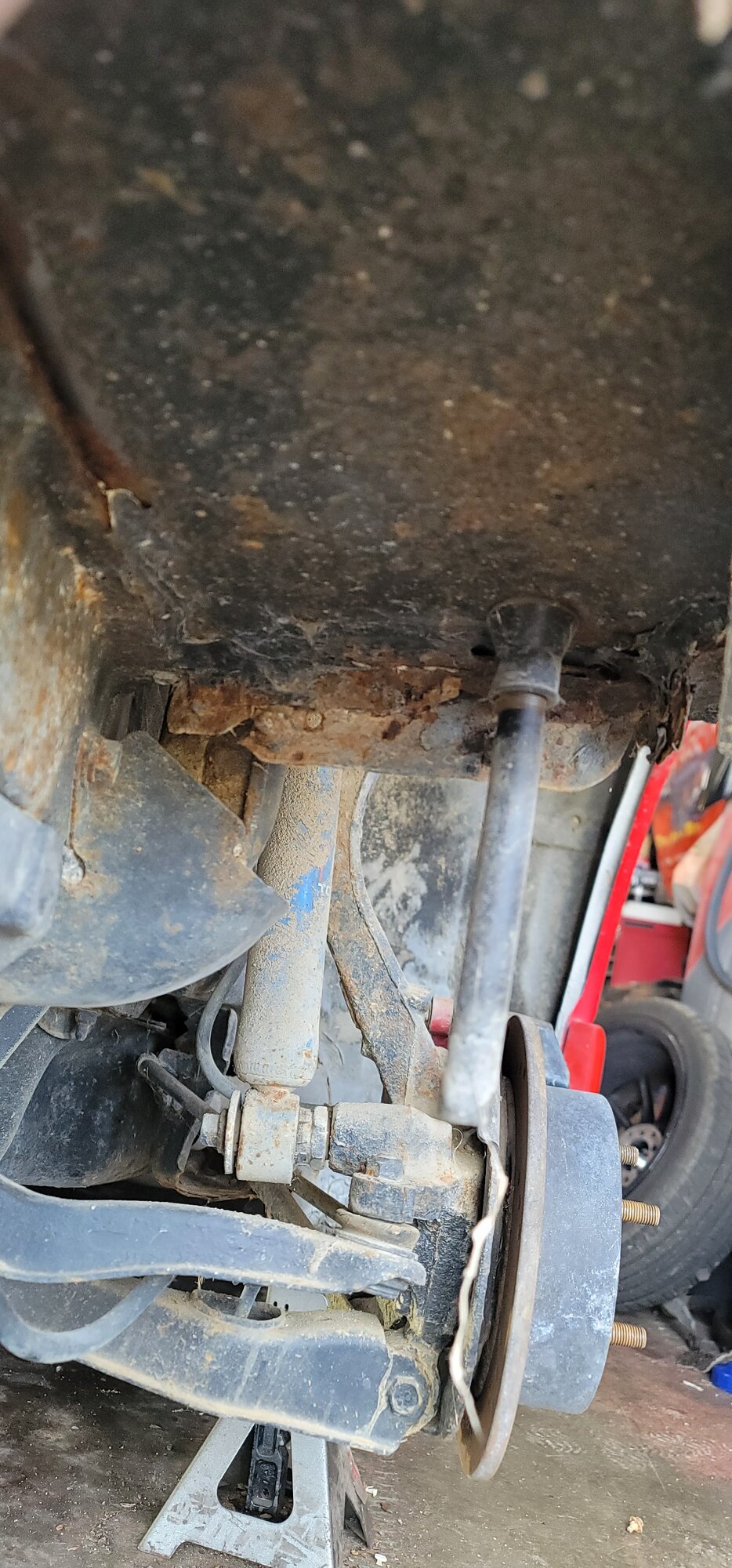

Things seem to be getting worse as I continue. Every single one of the bumper retaining bolts snapped. I know for a fact if I could have cleaned them and then wd40 with heat they would have came out. A guy just can't get to any of this with the bumper on so ill just have to get it off and then use a vise grips with heat and pull them through. I've done this before and it's very simple, just time consuming.

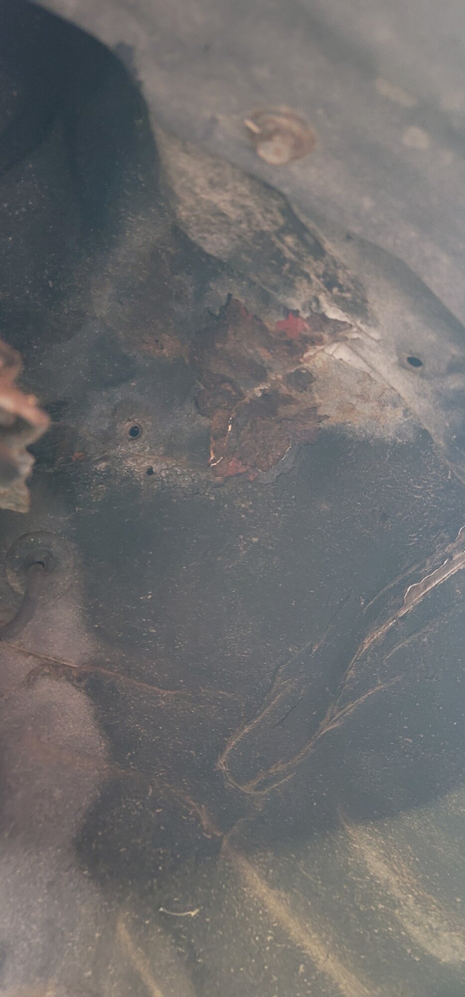

I've also never ever seen rust under the hatch seal. That's a new one for me, luckily pretty easy fix and once it is fixed it'll be covered by the seal. I'll probably just cut off what I need from the parts car.
The spoiler did come off without to many issues and that gasket was gone. I found a thread on here from a few years back and ordered what I needed for that.

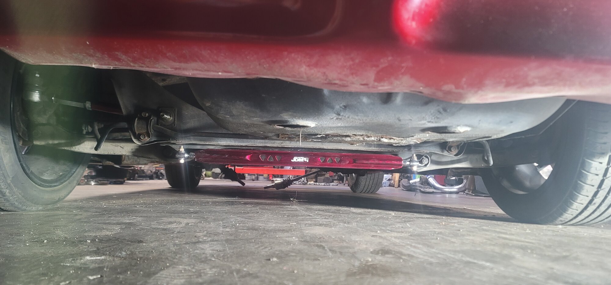

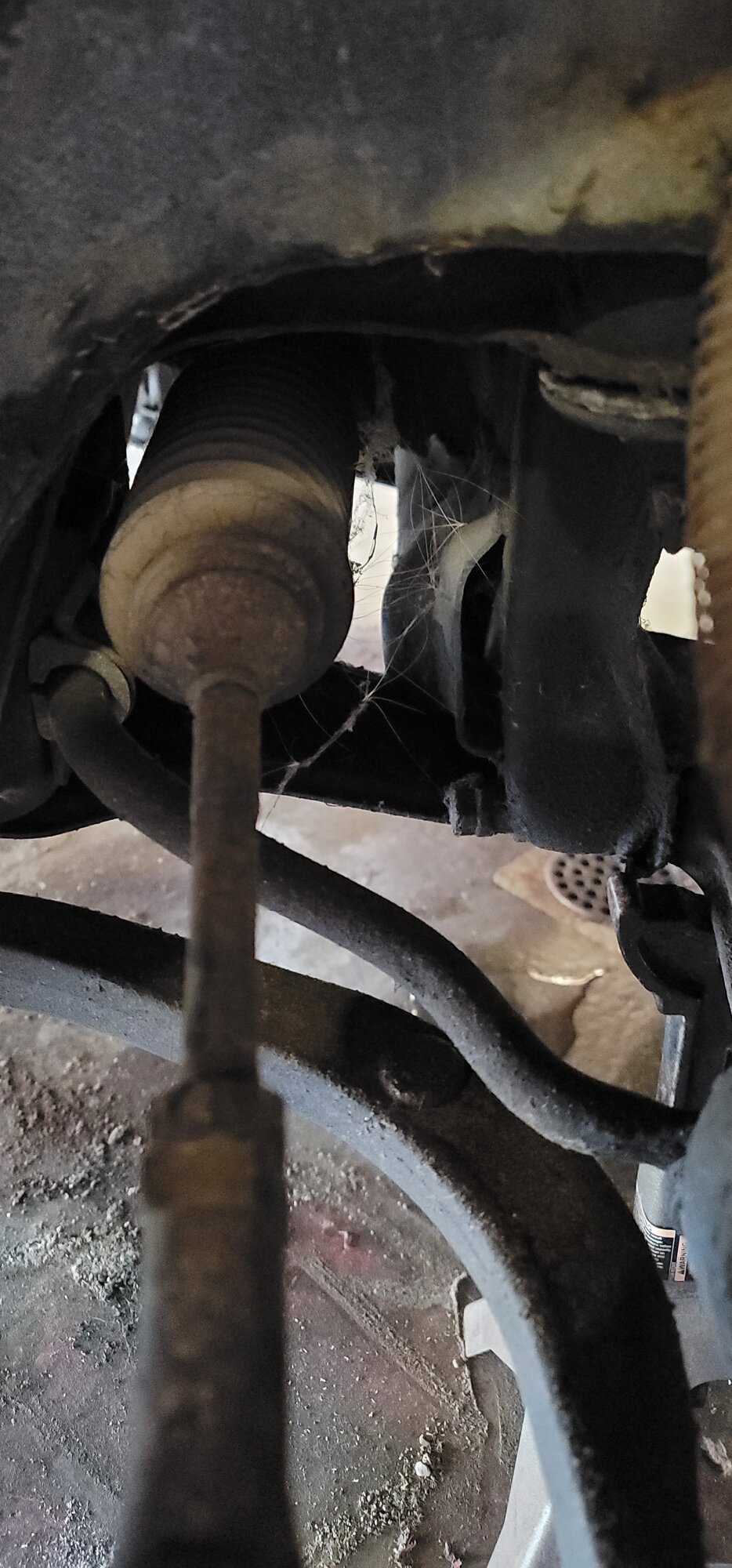

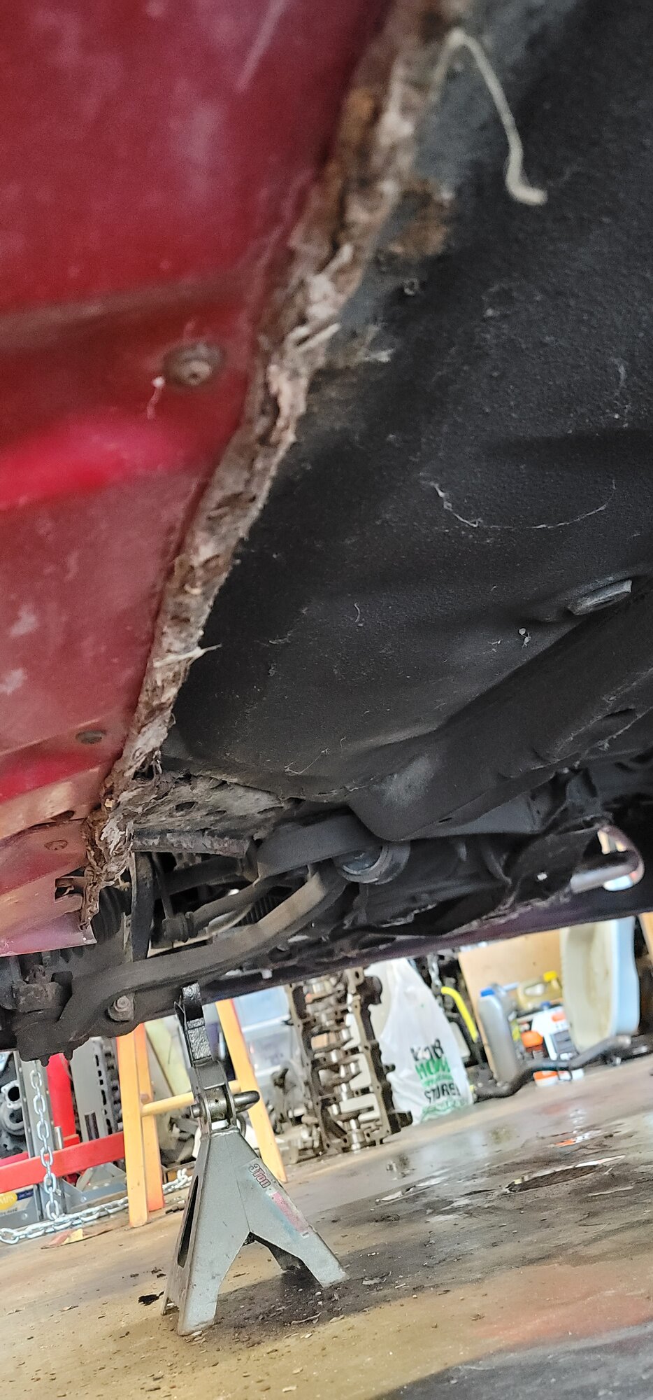

I'm not going to lie this car may be even rustier than my rs. My rs looks like it was drove in the salt but this gs looks like it sat in some tall moist grass. There's areas that I feel shouldn't even be rusty but they are. Someone sprayed some bed liner over everything and I think that's what made it worse. Some how I got some bolts out that I feel shouldn't have even came out.
I've got a long road ahead on this thing.
I was able to snatch up one of those old school radio pockets that screw into the factory brackets. Both the radio and pocket fit like factory and I couldn't be more happy with it.

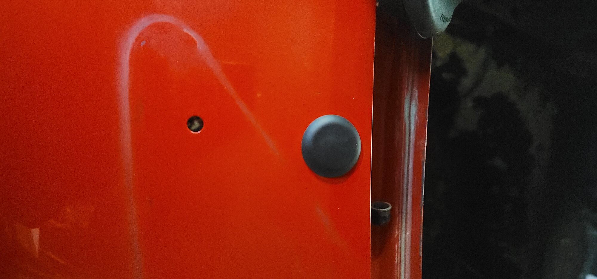

I did get all the busted off bolts for the bumper removed. It was very easy just took a little time. That wasn't my favorite but I'm still grinding. I slapped in a plug for the antenna as well. I'm not ready to repaint the car yet so a plug will do for now.
I didn't get a picture but I cut down my shifter about an inch, which to me wasn't really enough, but an inch is an inch. It's still better than the tall boy.
