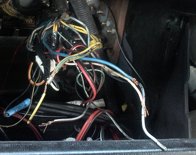

The way it was sold to me was that there was in fact a power wire going directly from the battery into the radio. Actually the way it's set up is that it's fused into a wire (yellow color) that's supposed to come from the ignition switch. That is, if I go into the car and hit the power switch on the head unit without doing anything with the ignition switch, it goes on. There was one day that that power wire burned up from making contact with the metal wall on the passenger side. I replaced that wire in the same way it was configured before.
I'll try and get a decent picture. The right front speaker doesn't work.

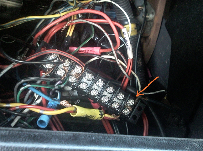

I disconnected the audio after the no-start. Here is some of the loose wiring behind the radio. After that power wire burned up one day, I decided to learn more about automotive sound systems, and set up this terminal block to sort out some of the wiring mess. The power wire comes into the block at the connection marked by the arrow. I'll probably leave the audio disconnected until this problem is resolved. Some part of the problem must be loose wiring as the blinking Battery/brake light was happening especially when going over bumps in the road.
