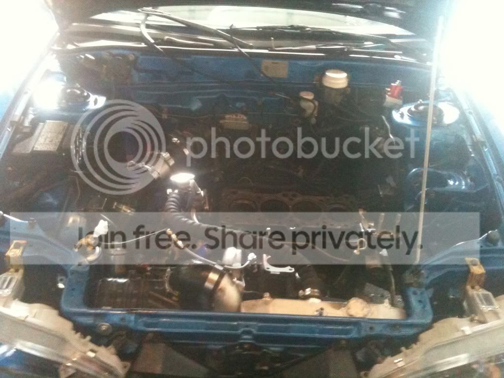

So started to have some smoke issues. After a tuning session. Sitting at idle, the car started to smoke. The smoke was pretty damn bad, and so I thought maybe I blew a ring. Turned out, I lost a roller. Damage could have been worse. Nice groove on the last lobe of the new HKS 272 exhaust cam.
Pulled the head yesterday.
I'm eager to get the Bullie to the track, LOL, it's a minor set back, and will hopefully have some good news to share with you guys on what's going on with the head here in the next few days.
