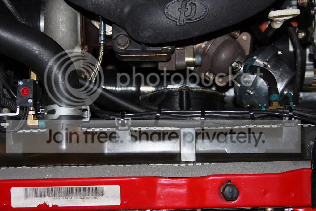

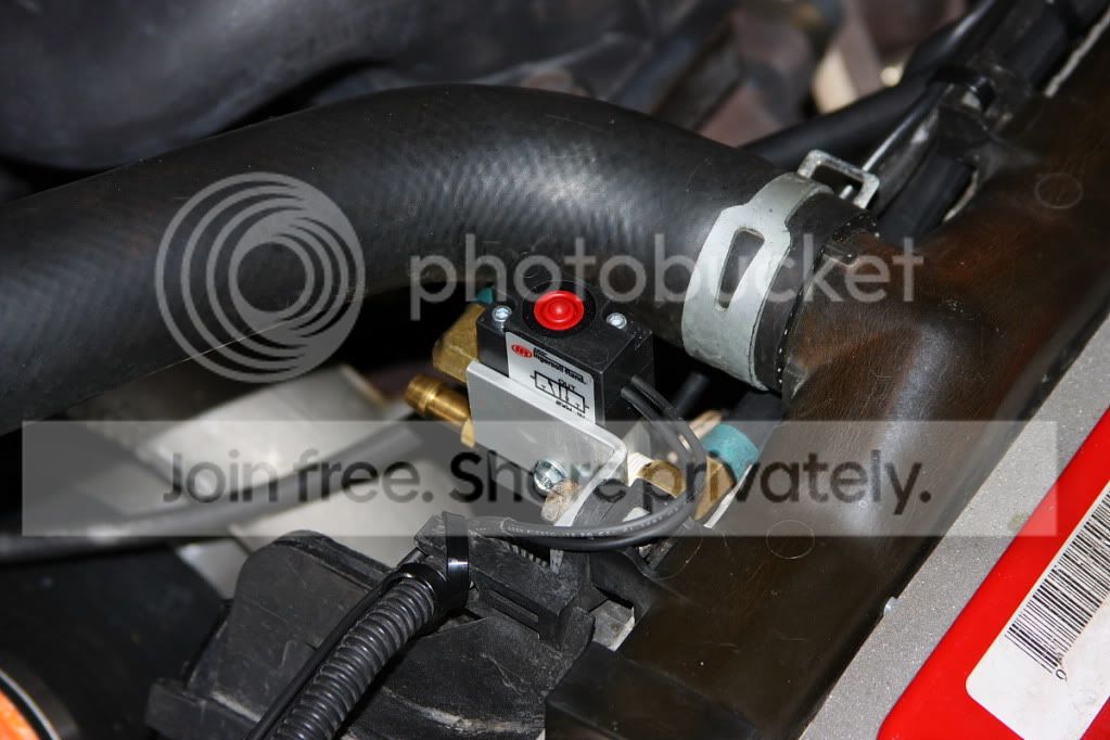

I installed the IR boost control solenoid yesterday and got it set up. I made a small bracket out of aluminum stock to mount it to the radiator. It is working good, and is at about 16psi at 45% duty cycle. It is hooked up using both the top/bottom ports. My only concern is how tolerant these solenoids are to heat. I like where it is mounted to keep the hose lengths down, but it will obviously get heated up by the radiator/hose. It is not physically touching anything other than the fan mount tab where I secured the bracket.
The brass/rubber hoses and clamp setup may be temporary. I will probably switch to the polyehtylene tubing push-to-connect fittings for a cleaner look.
