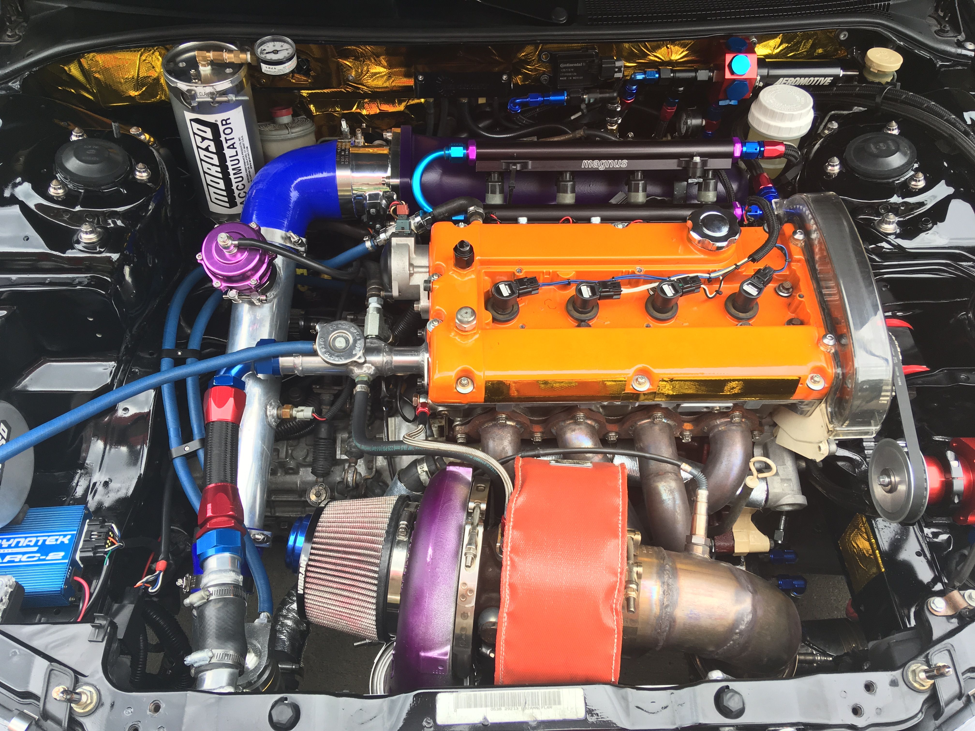

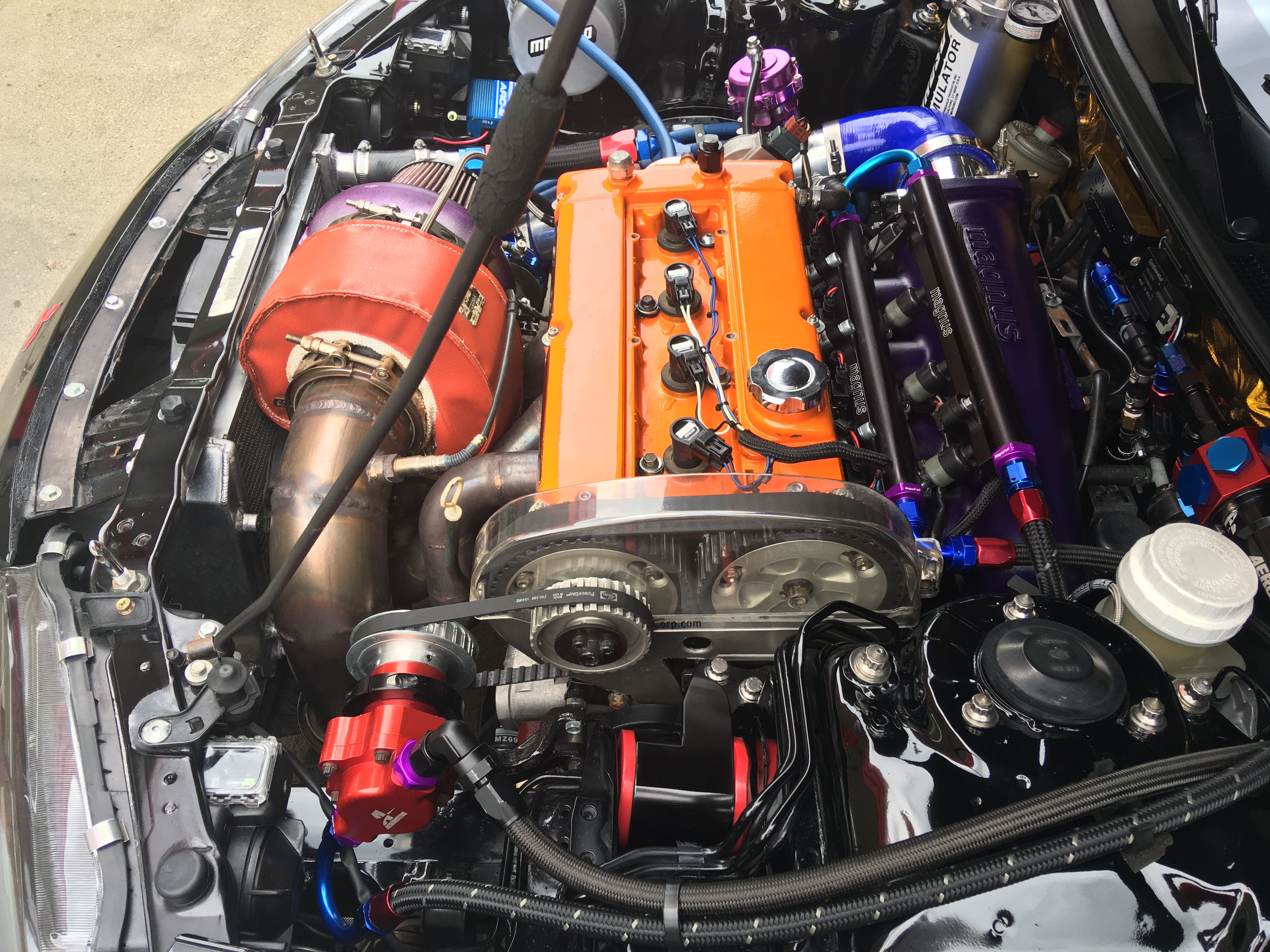

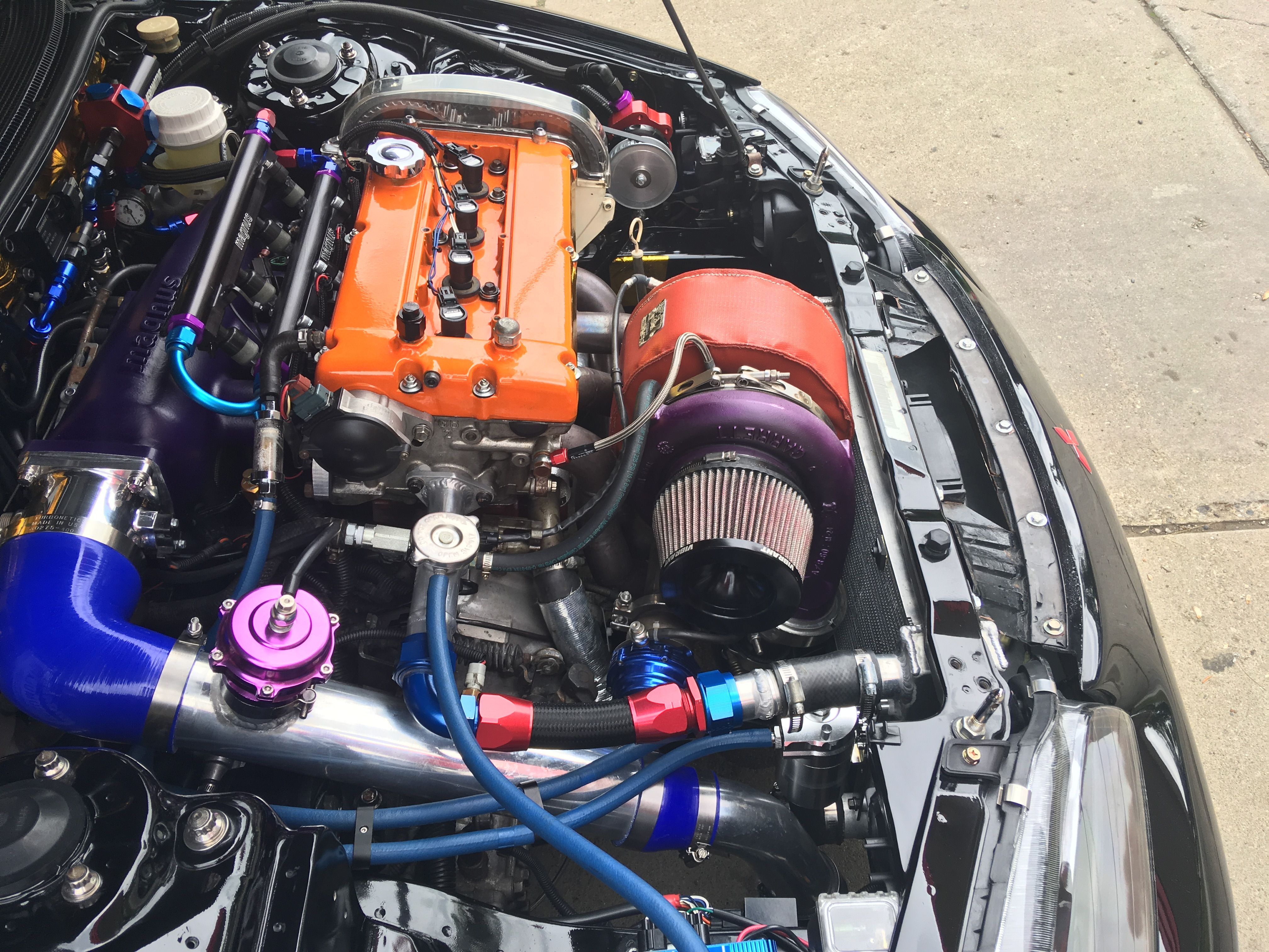

that mechanical fuel pump setup is pretty damn awesome LOL is this something you fabbed up or were these off the shelf parts?
It was something that I fabbed up, if you look closely you will find a 1g engine pull bracket from the throttle body area as my belt adjustment device, as much as I like the direct drive idea, I want to be able to not run the pump at all times if I dont need it and without pulling the pump, plus the idea that if the pump locks up with a direct drive it would likely end up in a jumped timing belt vs this setup which should just sheer the skinny pump belt teeth, of course I should add more recent pictures of it all hooked up and functional, I have had problems with the pump pulley falling off out on the highway if its not in use and no belt on it, so I now pull the pump pulley off when not in use, those things are not cheap at over $100 per replacement.
sounds like a damn good idea behind it. id definitely like to see some more pics of the setup.
