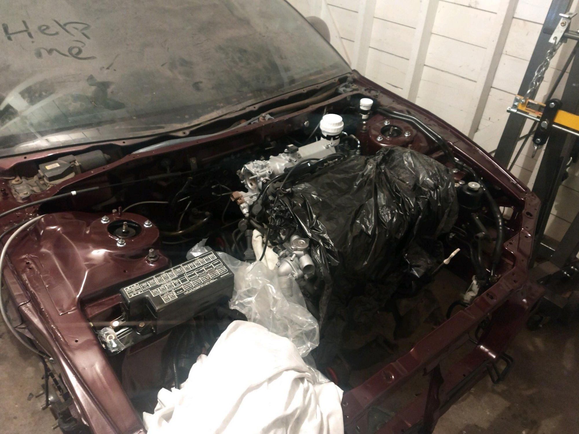

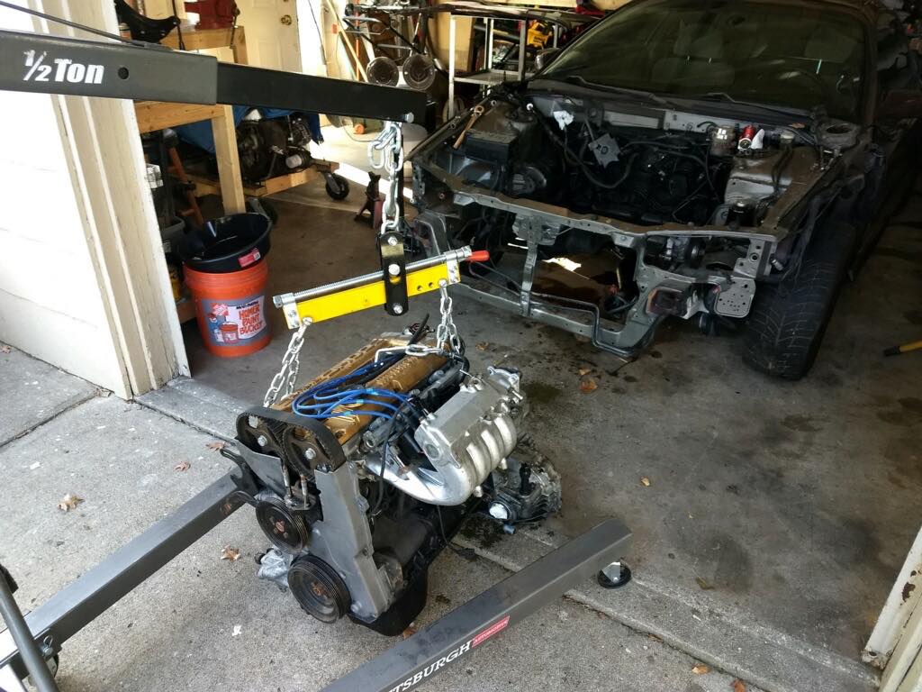

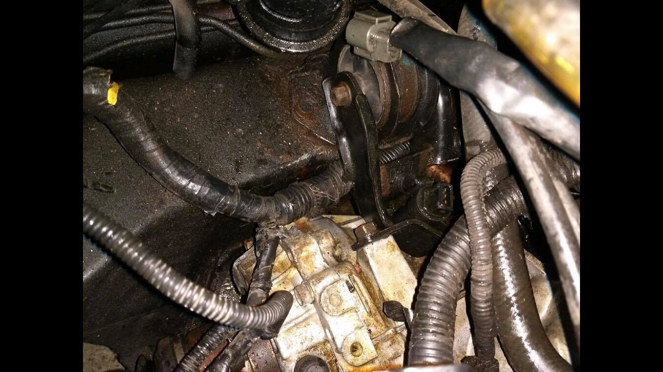

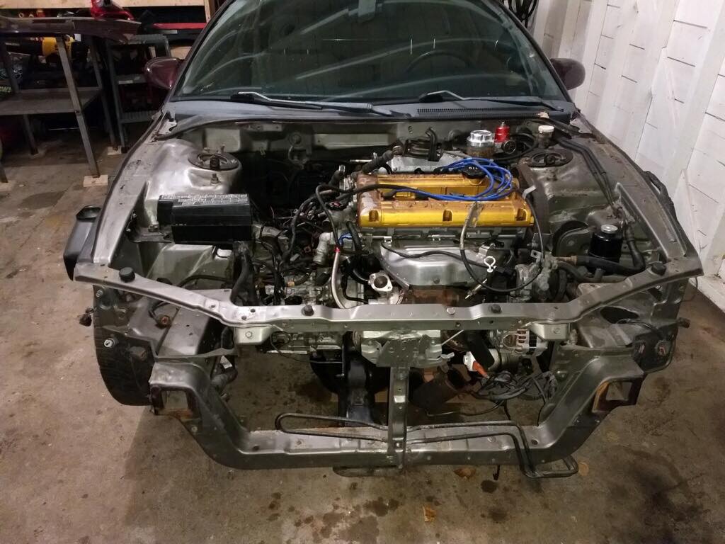

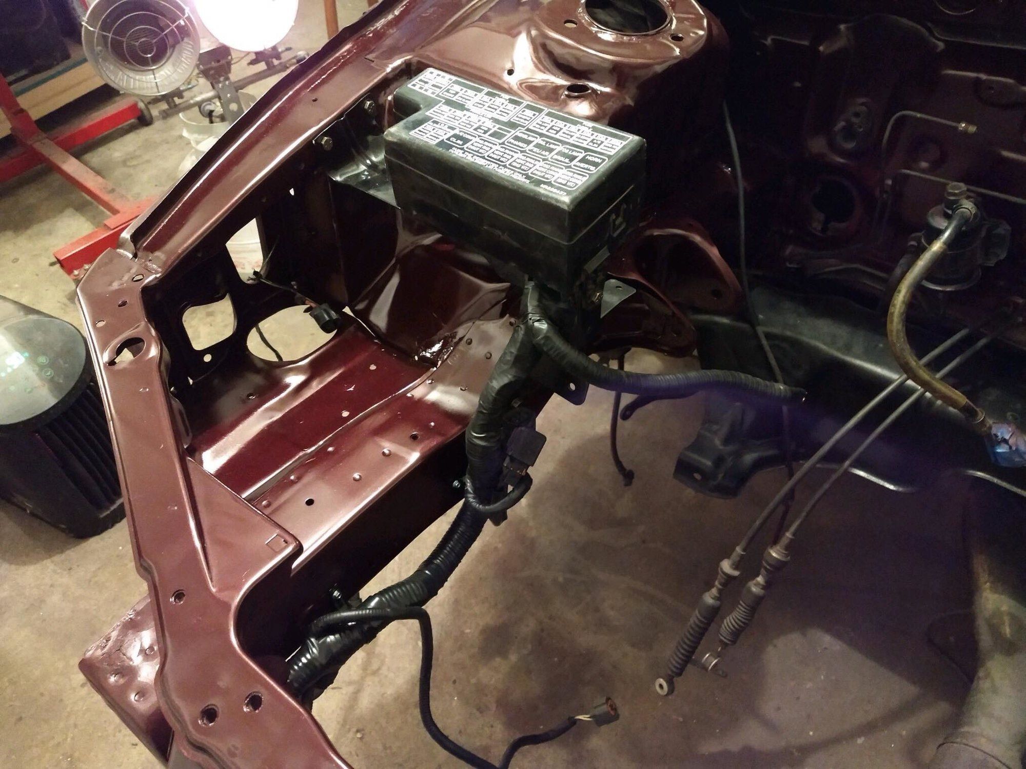

After pulling the motor we noticed the people that had helped me swap the trans caught the wiring harness under a motor mount completely crushed it and was likely the reason it would not start for a month or two.
Super lame, but I had already received a new harness from Miller Import Parts, so that was sorted.

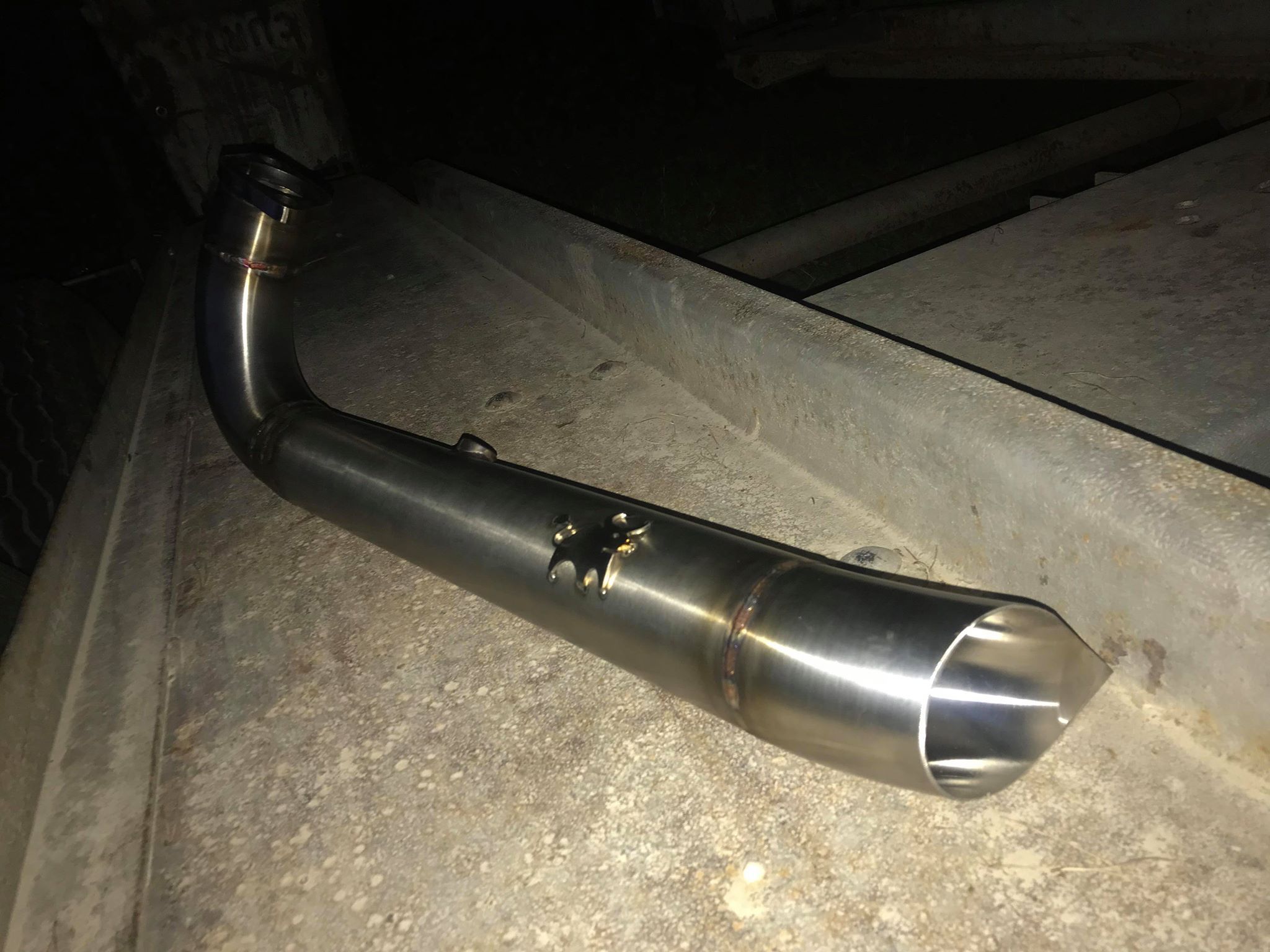

New parts arrived being the following: Poly Motor Mounts, BSFab 3.0" Tear Drop Side Exit, 98,99 Split Thrust Motor, Southbend Flywheel from Tim Zimmer, Untouched Harness, FP Intake, and lots of refreshing of old crusty parts are going to be put in with the overhaul of the car. After finding gremlin after gremlin from previous owners the car is better off receiving new life.

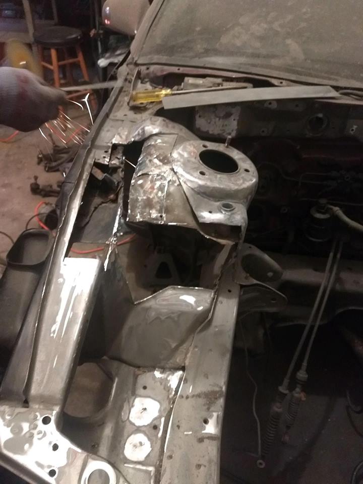

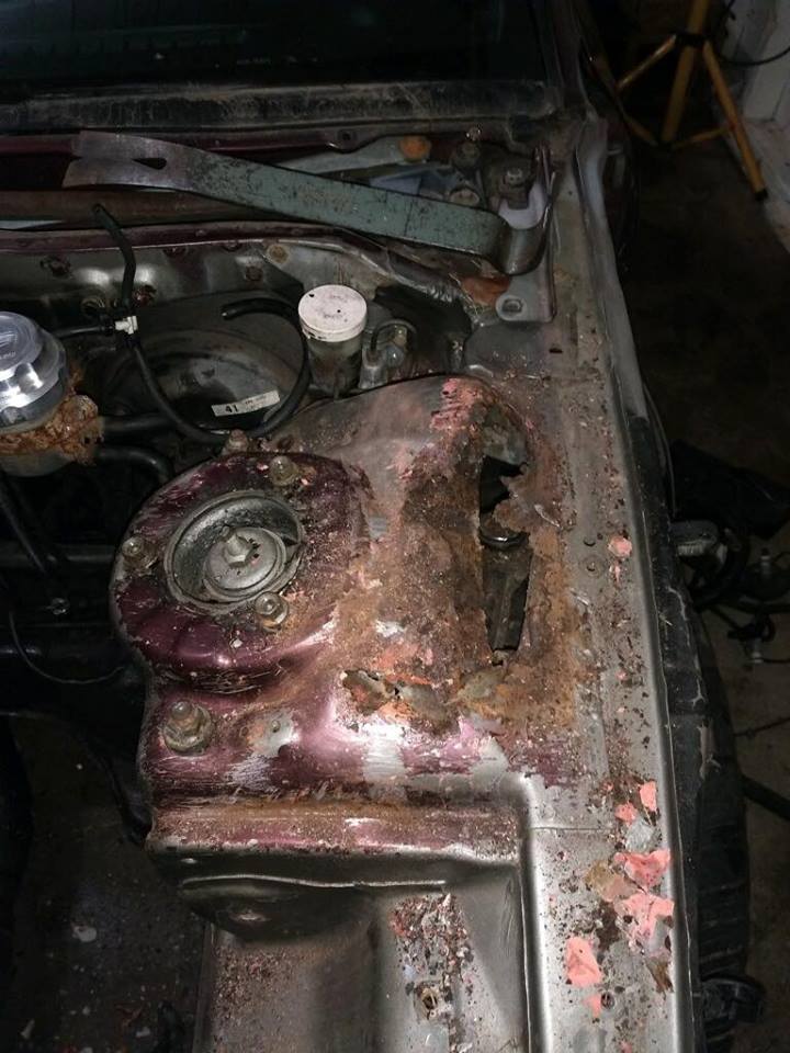

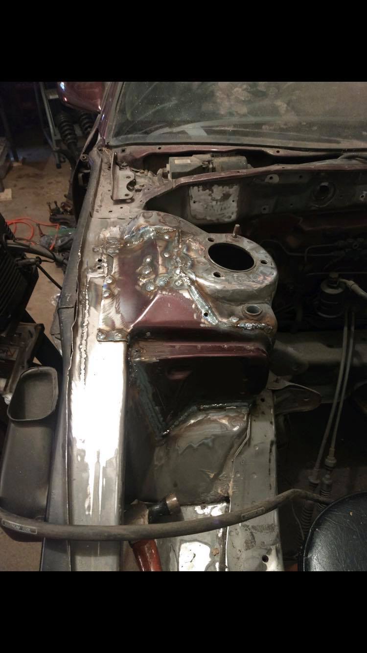

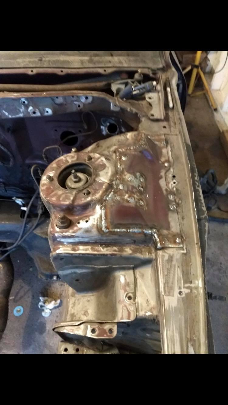

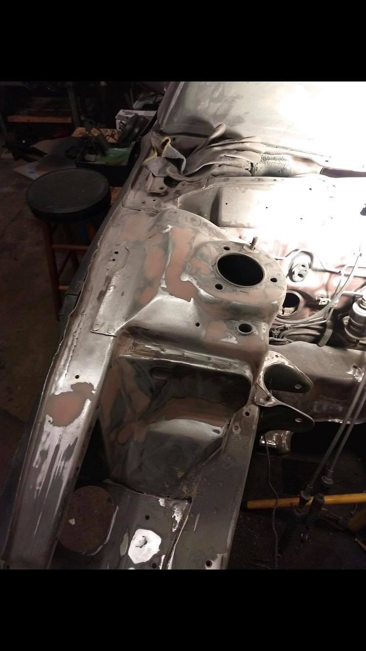

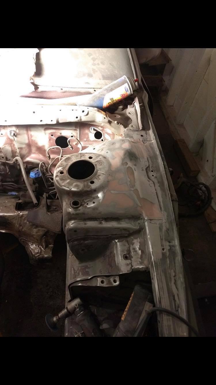

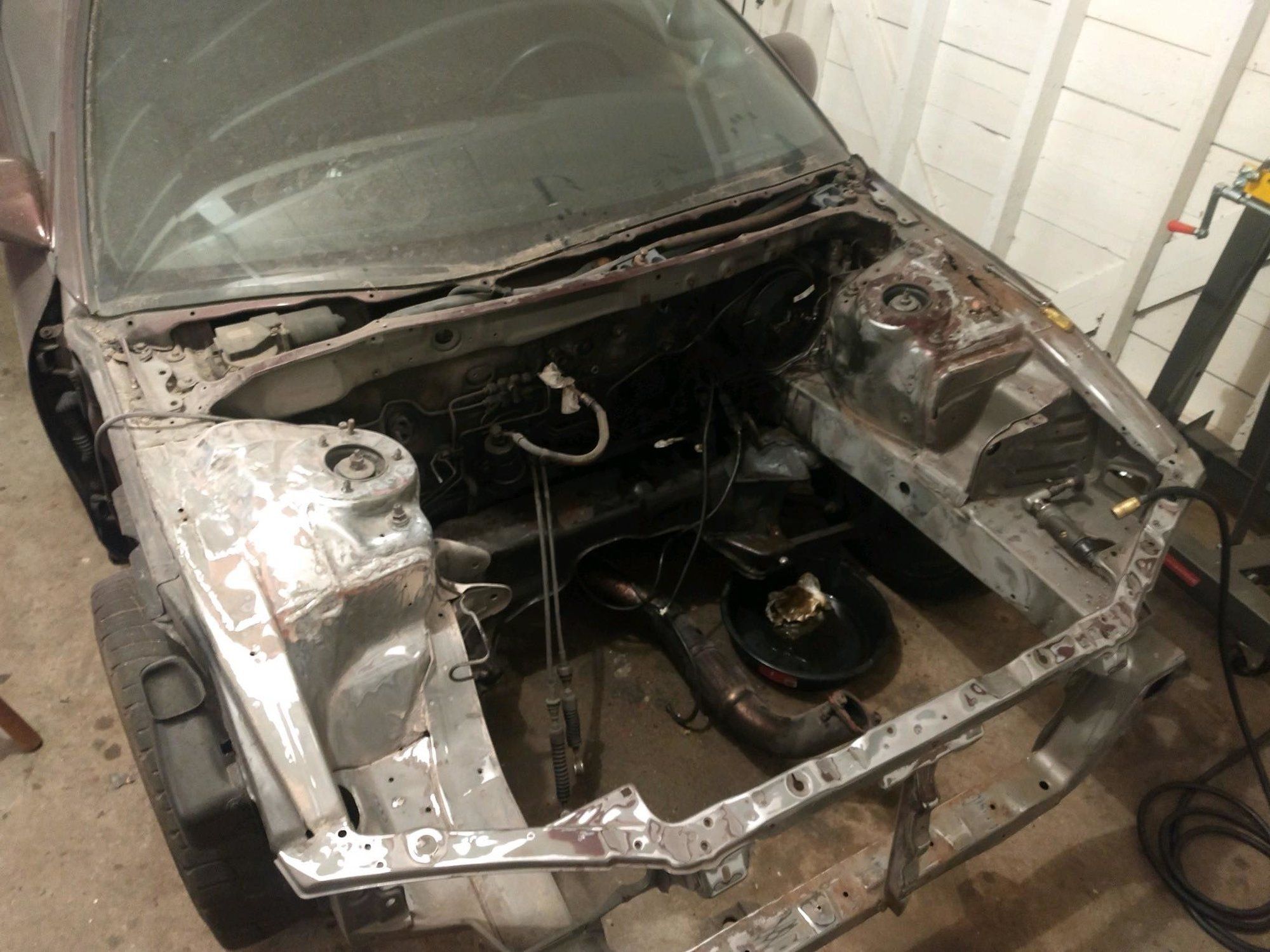

Began tearing down the engine bay after pulling the motor to reveal wonderful bondo hidden rust "repair" from the previous owner, taken with a grain of salt, nothing that can't be fixed.

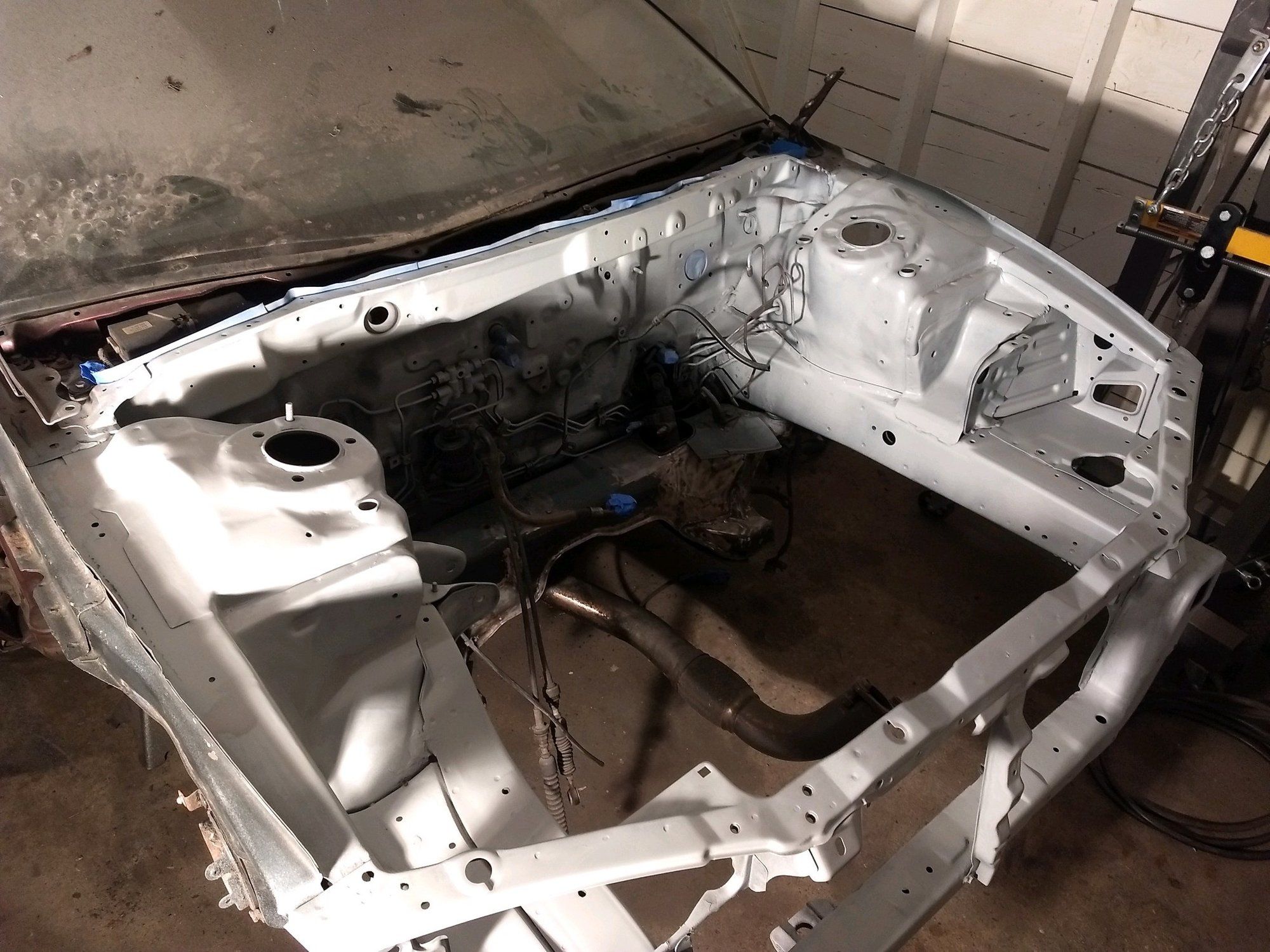

Now that most of the gunk was removed on to the actual process of the car getting the love it deserves.
New front clip with towers, rust free $100, not a bad pickup. Props to PLDSM for that.

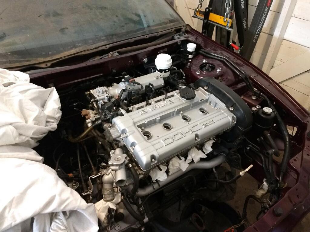

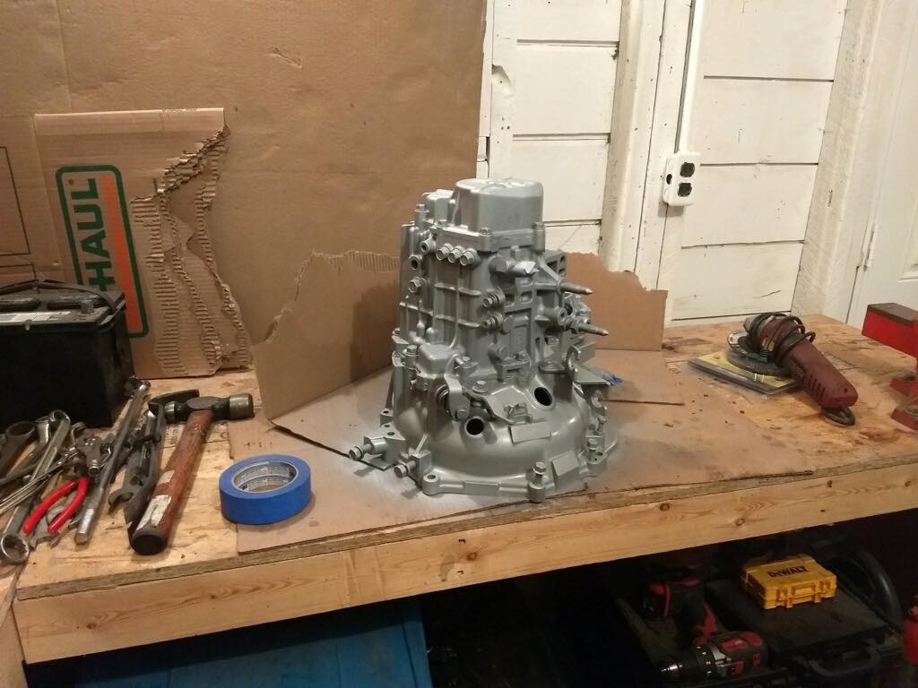

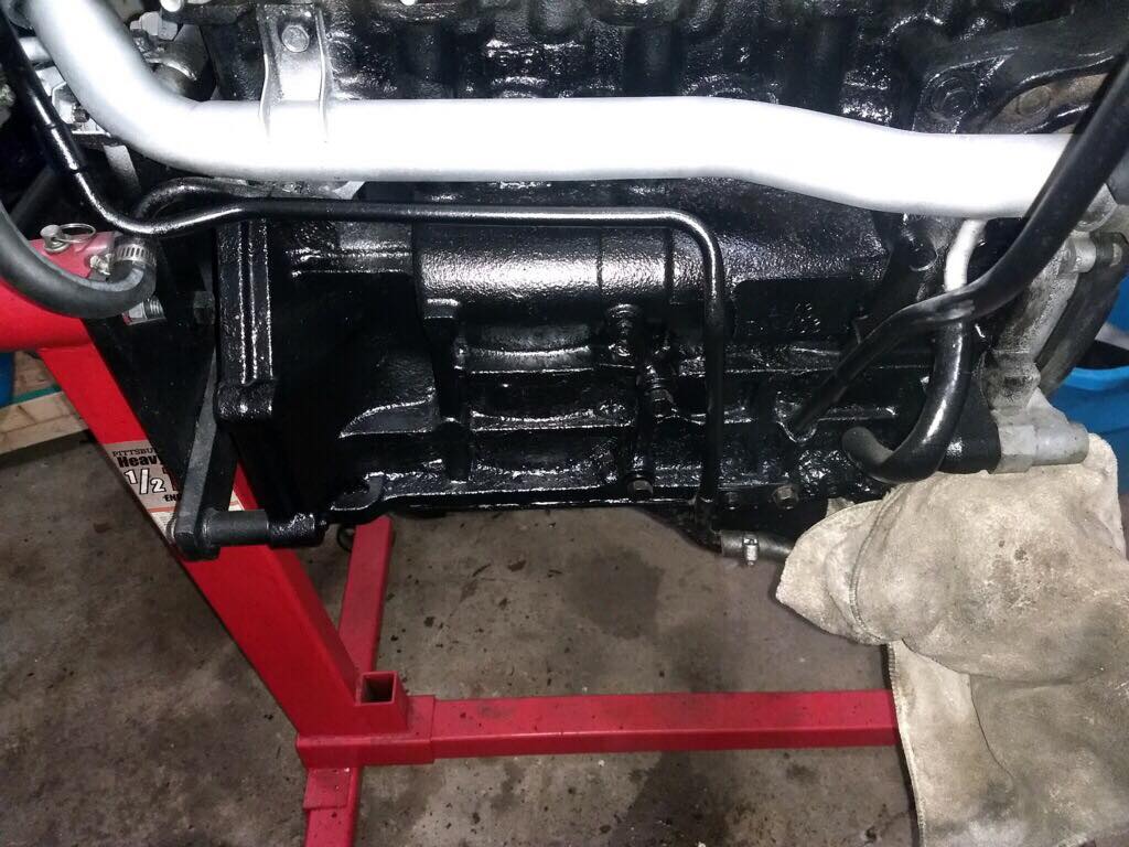

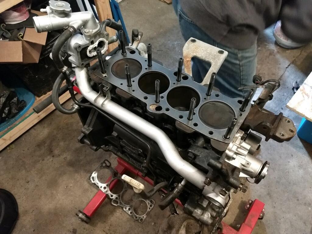

Now that most of the engine bay work has been done in terms of physical shaping, minus small touches that will be addressed onto the donor motor. 98-99 Split Thrust 7 Bolt, Stock Internals, ARP Head Studs, Fresh Timing, only 70,000 miles, will be paired up with a 70,000 mile transmission w/ a Quaife I picked up from a local guy that runs Mustache Motorsports. Super cool dude.

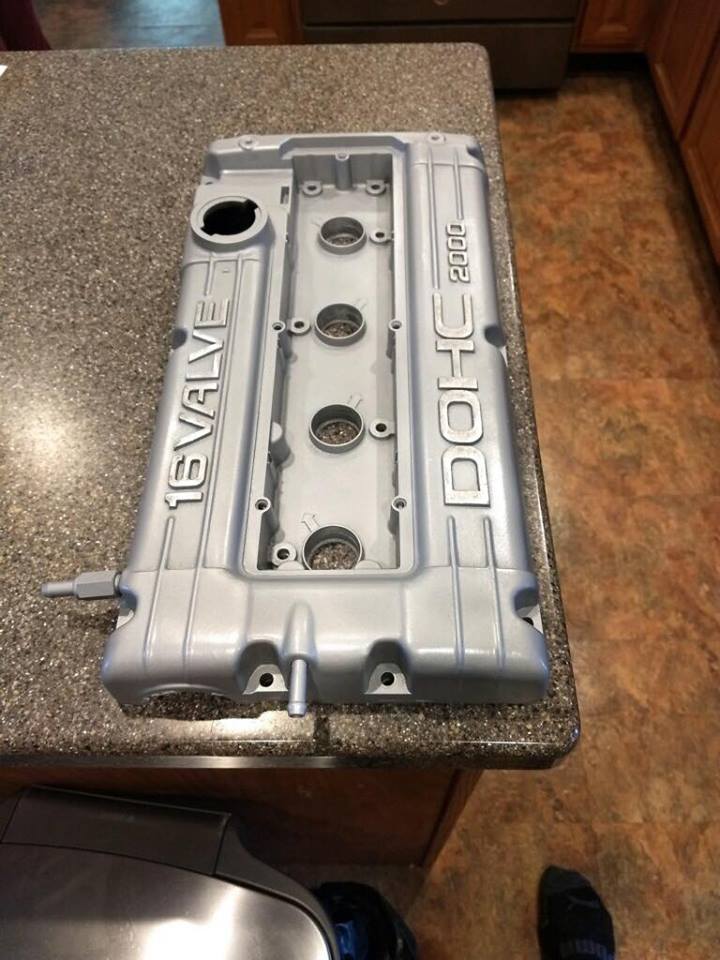

Parts begin undergoing the process from crusty, to not crusty.

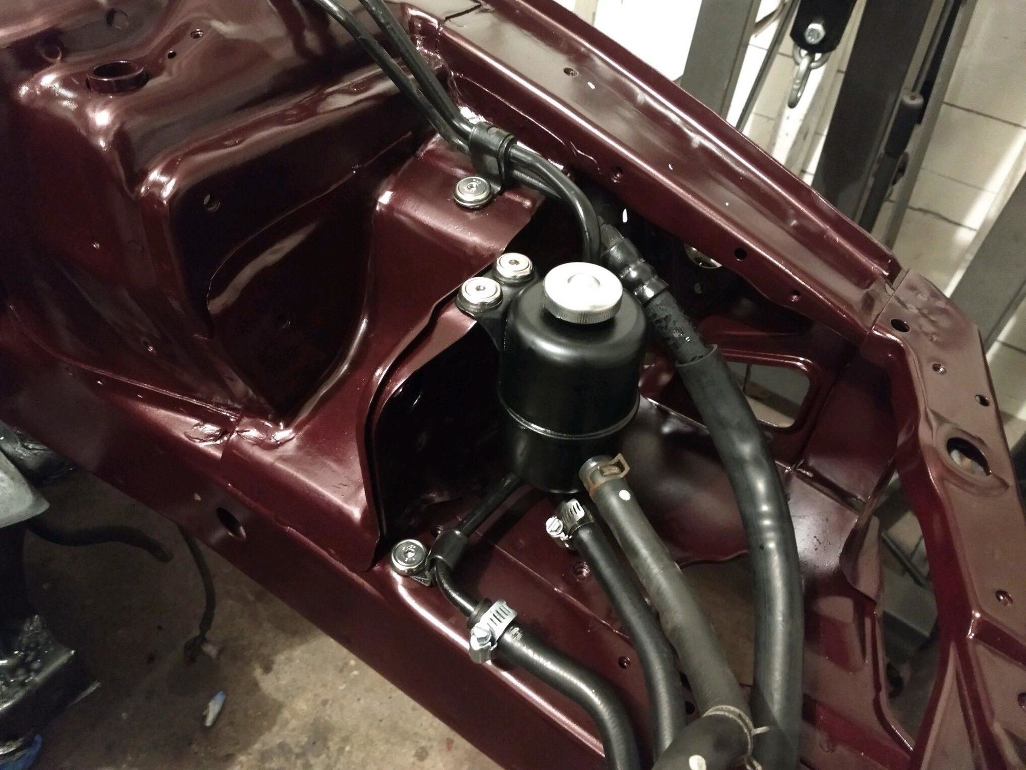

Many hours later, parts are starting to look new, the overhaul is looking pretty sick. Although there is still a ton more to do. The following pictures are currently how the car sits, still deciding on what color he wants to paint the bay can't decide between OEM P75 or Gloss Black, decisions.. decisions..

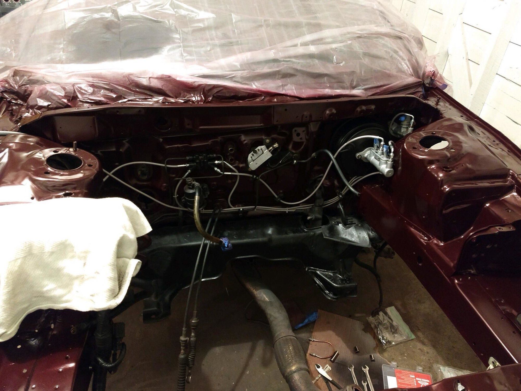

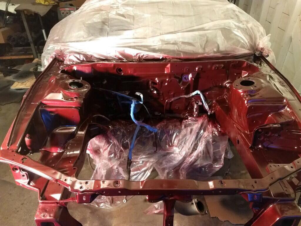

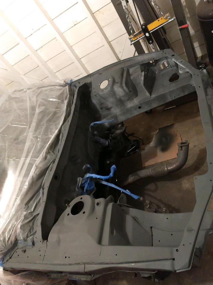

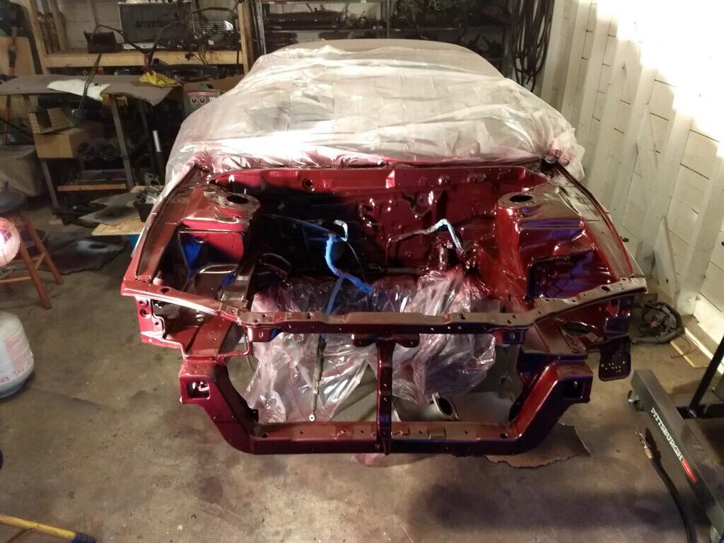

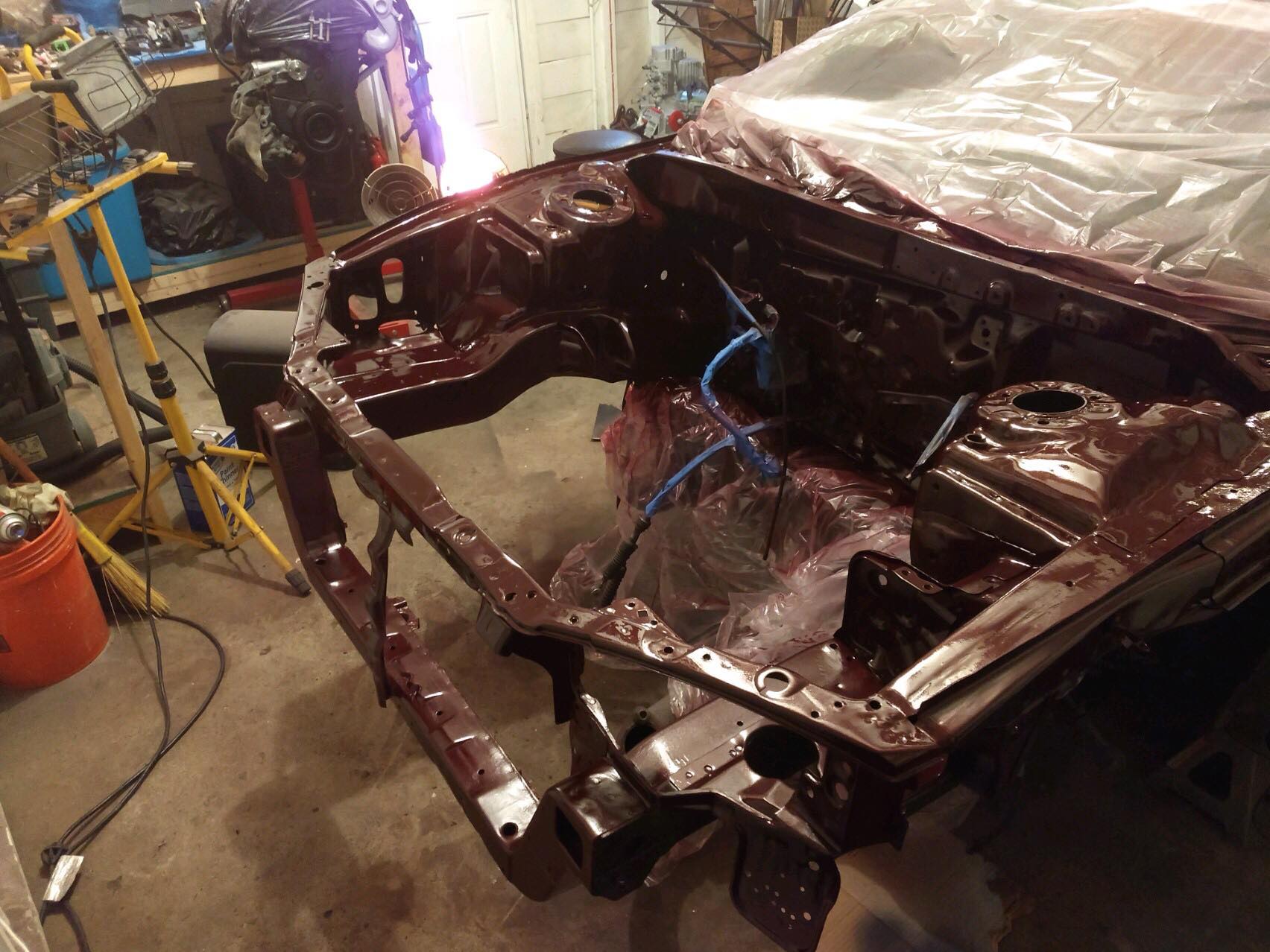

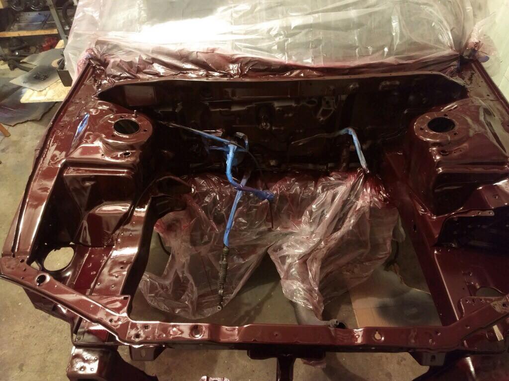

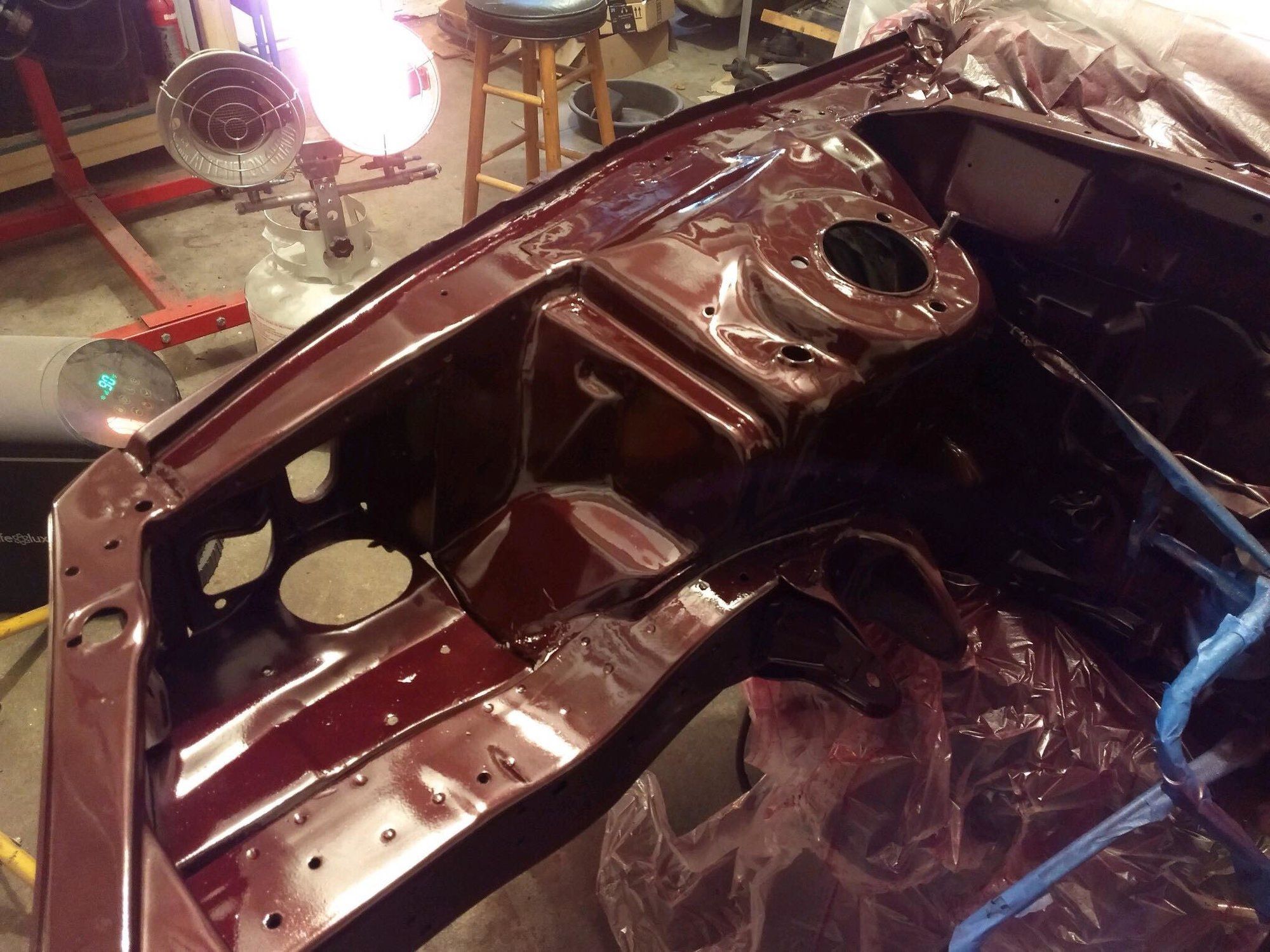

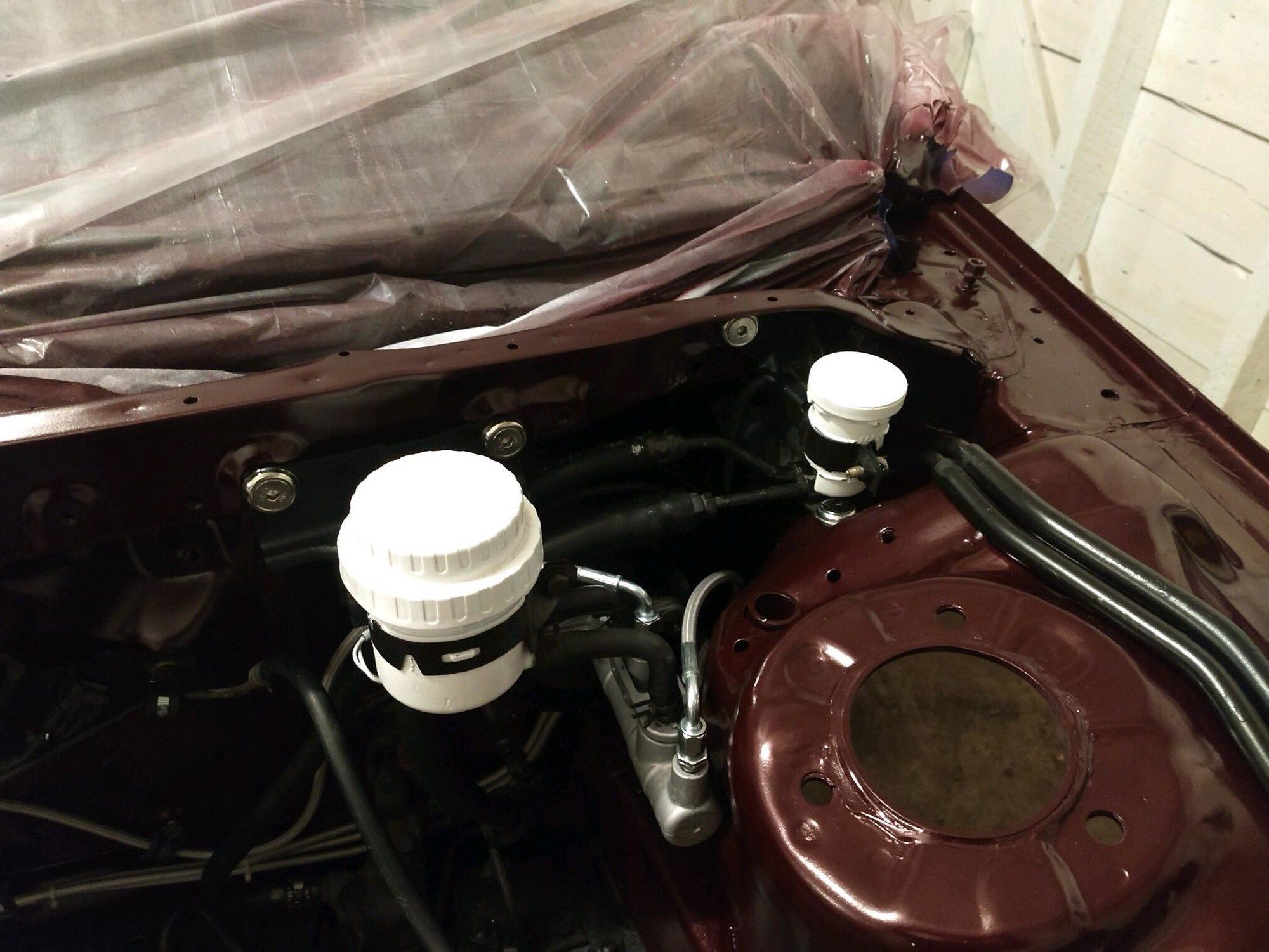

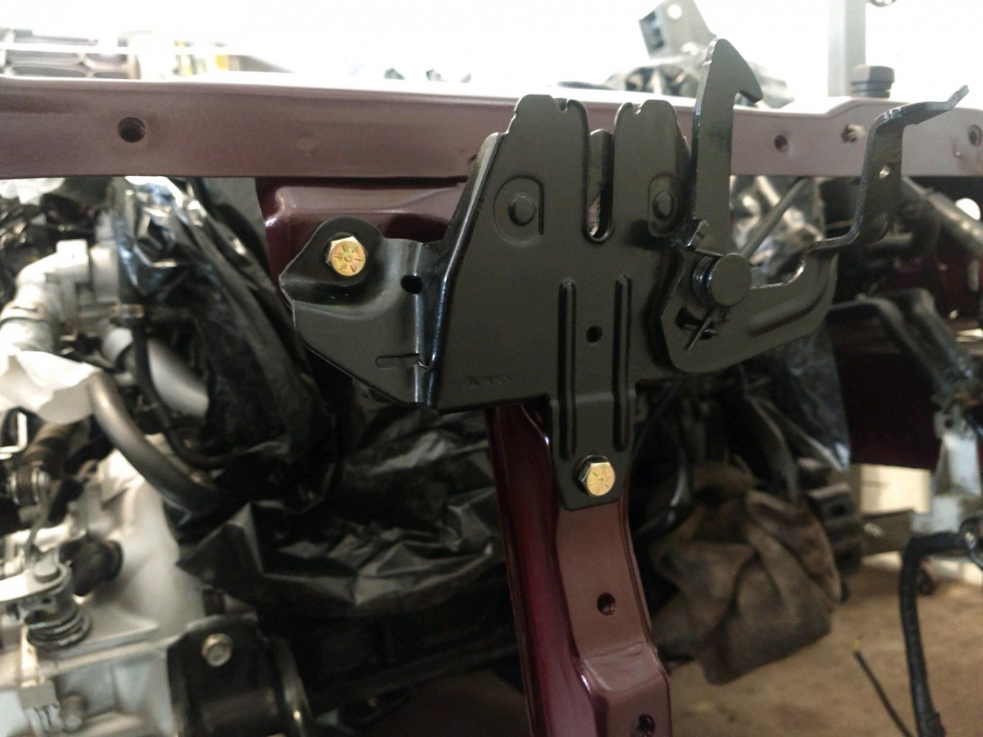

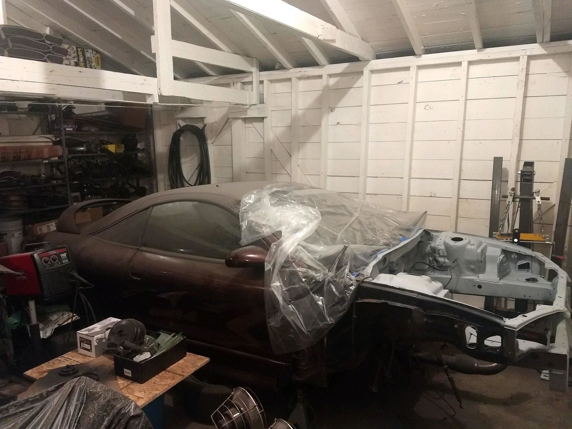

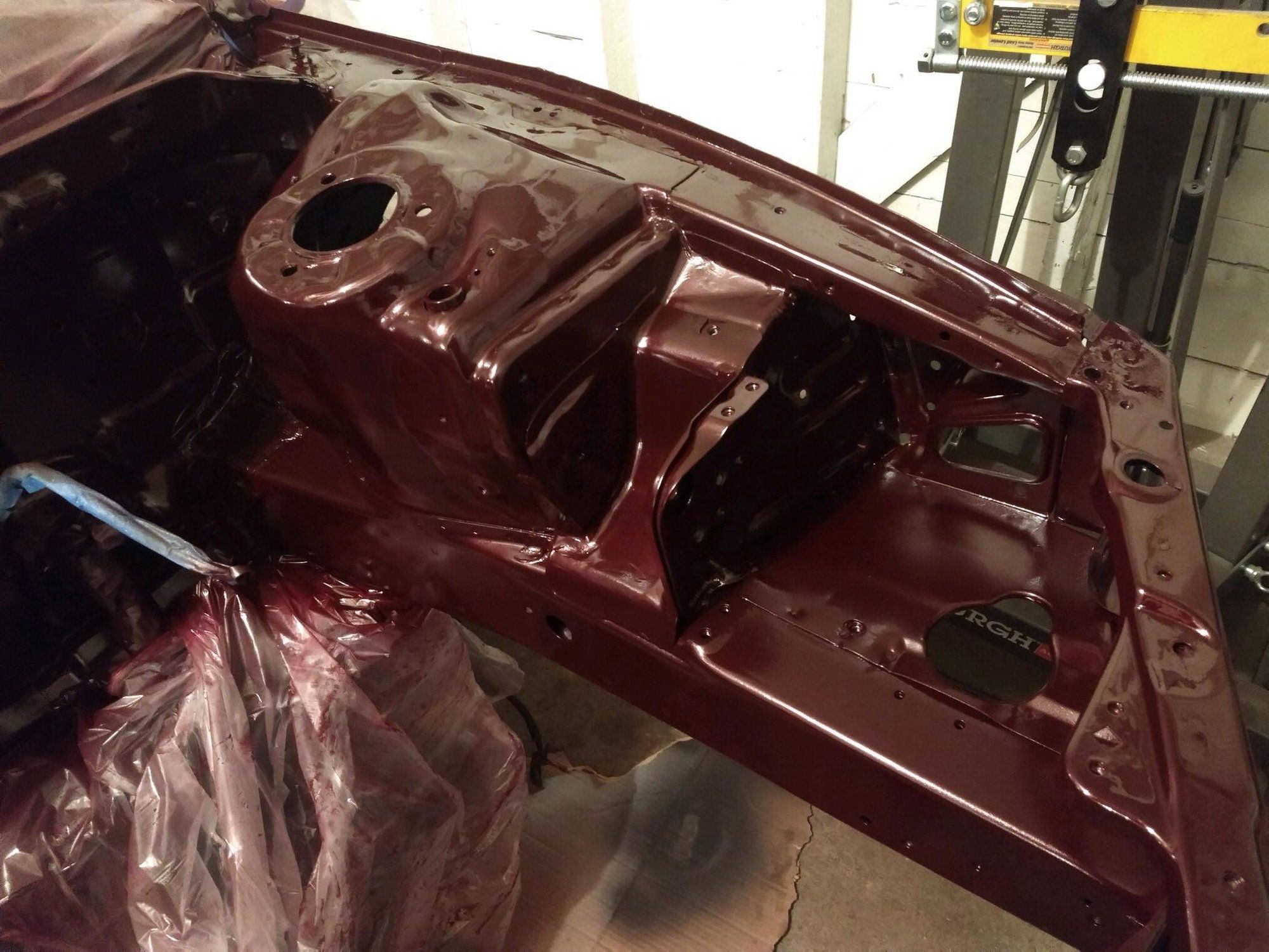

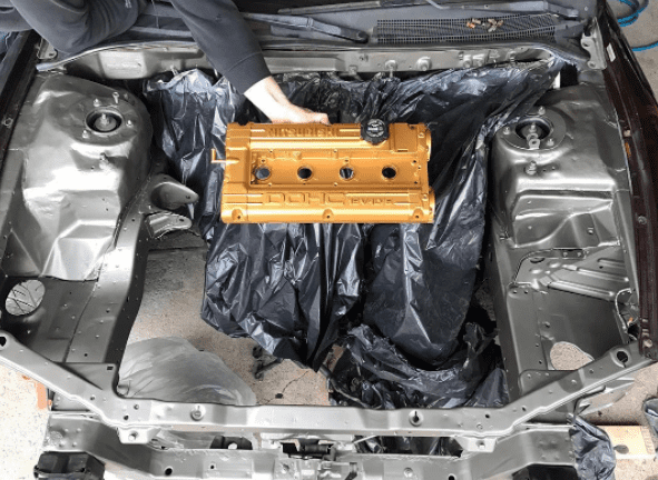

Last coat of primer is on. Some more prep work and the bay gets sprayed.

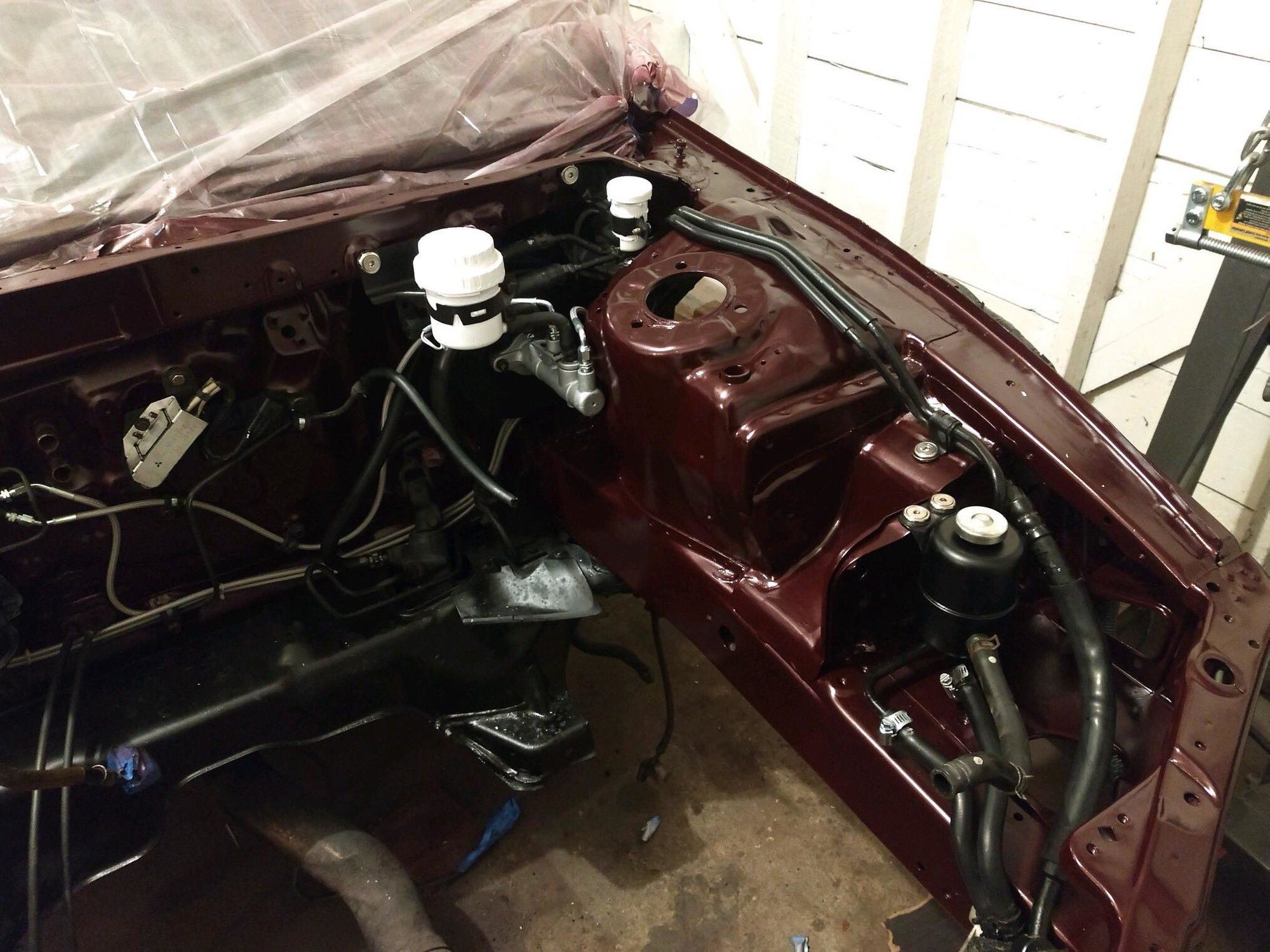

Was a toss up between Gloss Black and a color matched P75 bay, pretty happy based on the results of the match, hoping the quality of the paint transfers over to the bay well. Fingers crossed.

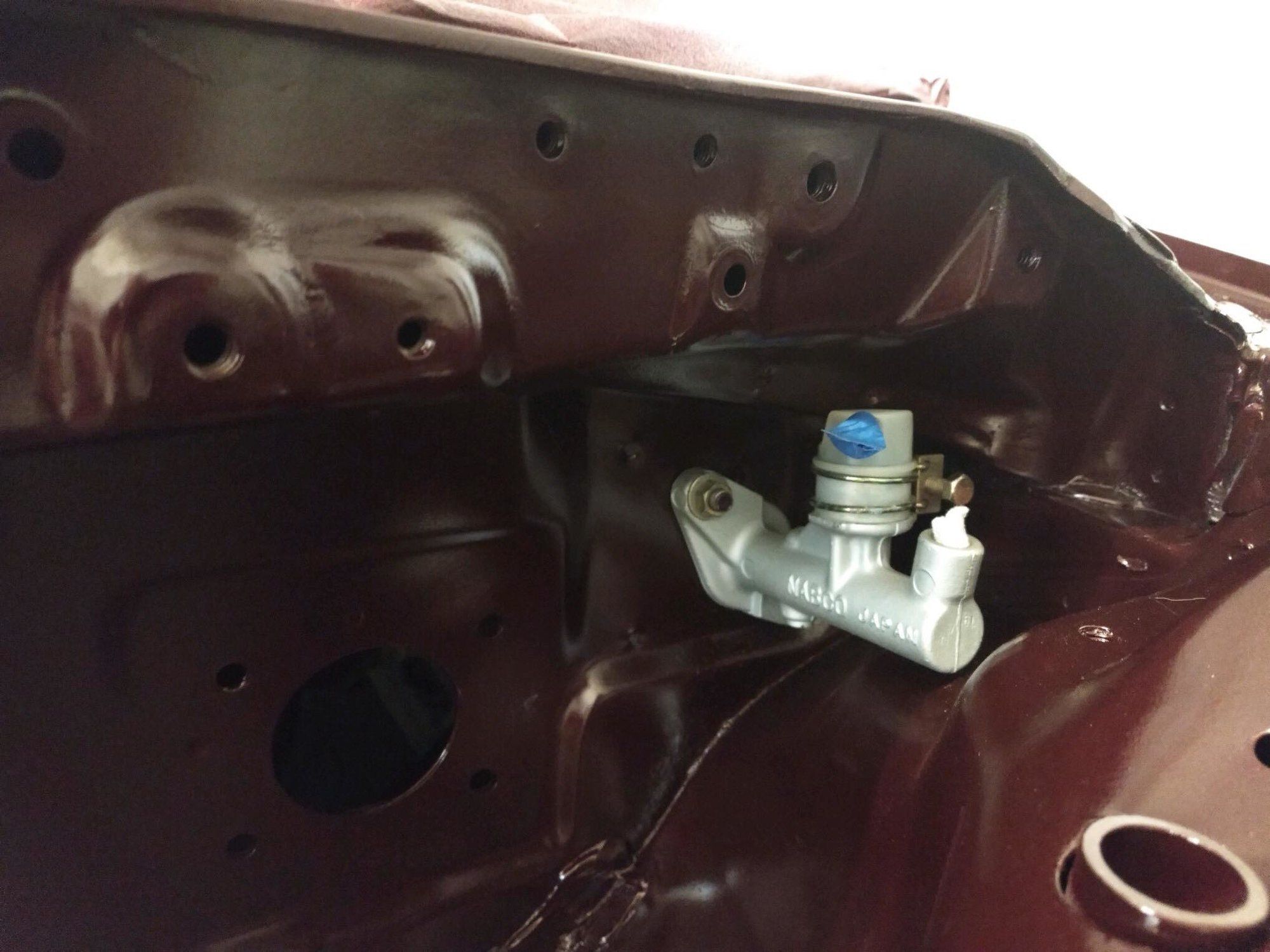

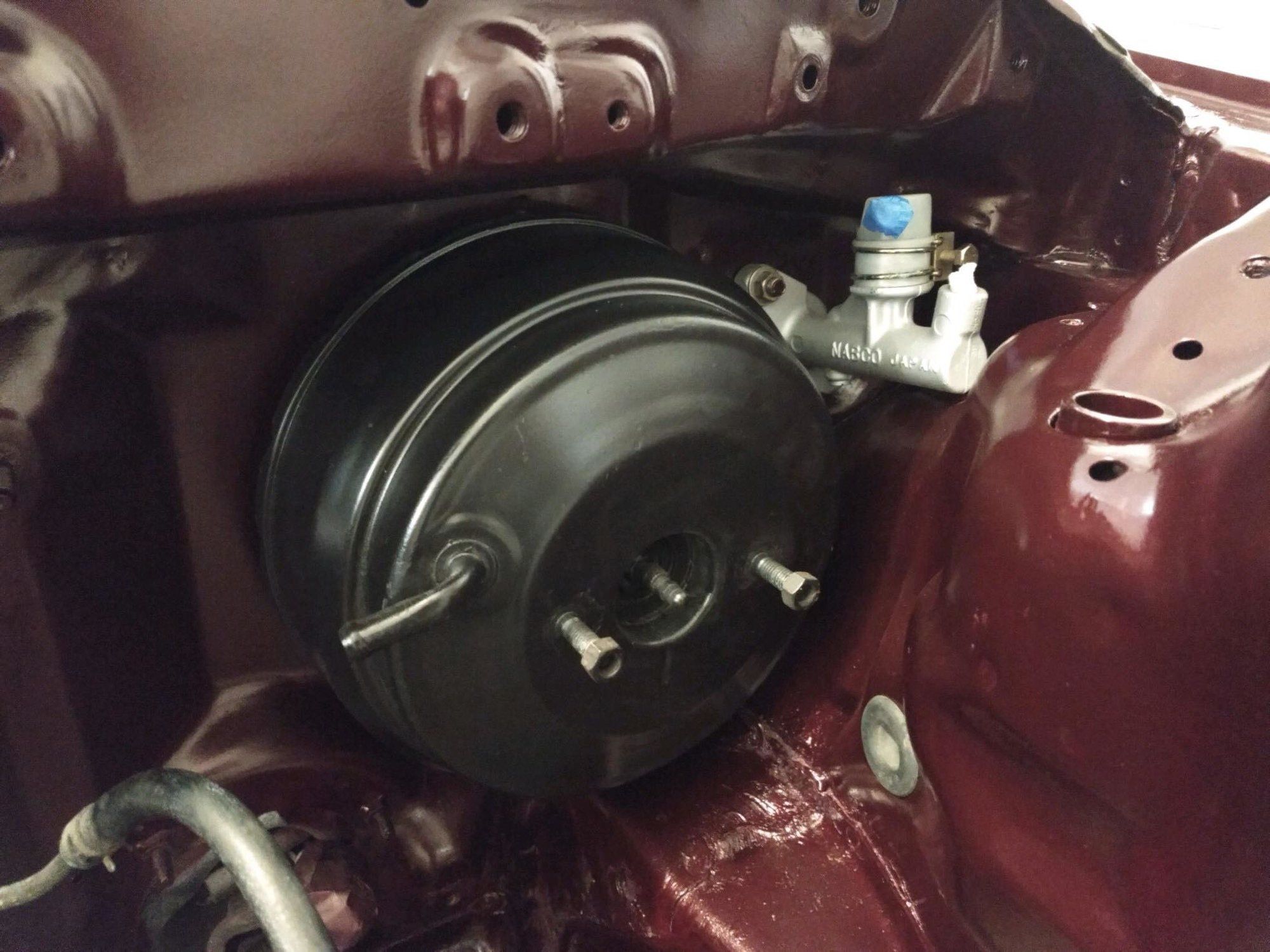

+ Evo 8 Enkeis
+ Brake Booster w/ Slave
+ Fusebox
+Stainless Steel Brake Lines w/ Clutch Line

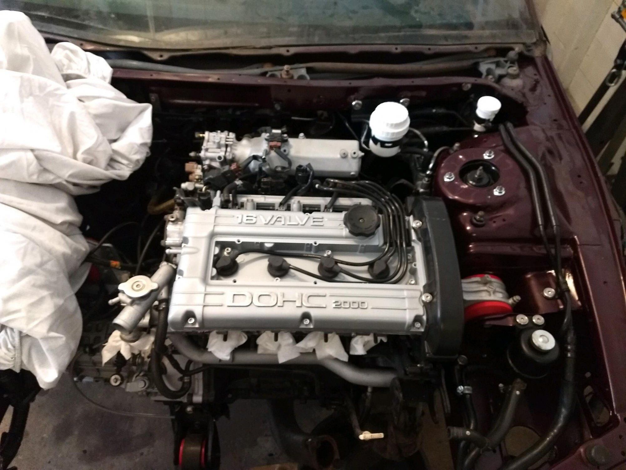

Bit more progress on the car since the last post. Mostly waiting on turbo decisions and warmer weather at this point, nonetheless progress is still being made.
+ Split Thrust 98/99 Motor 70k Miles w/ Timing Studs & Fresh Gasket
+GSX Brakes w/ SS Clutch & Brake Lines

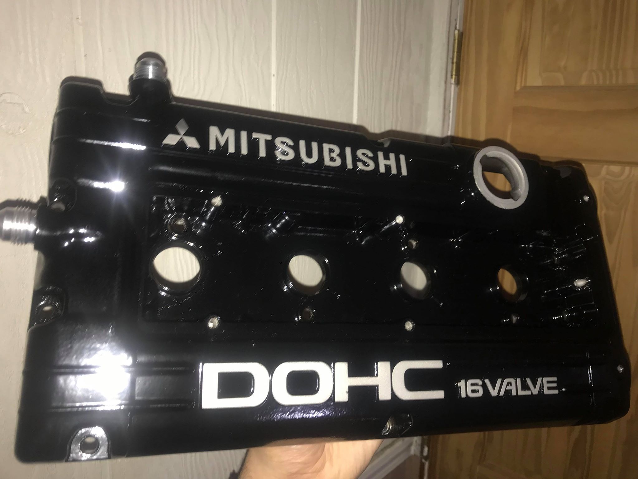

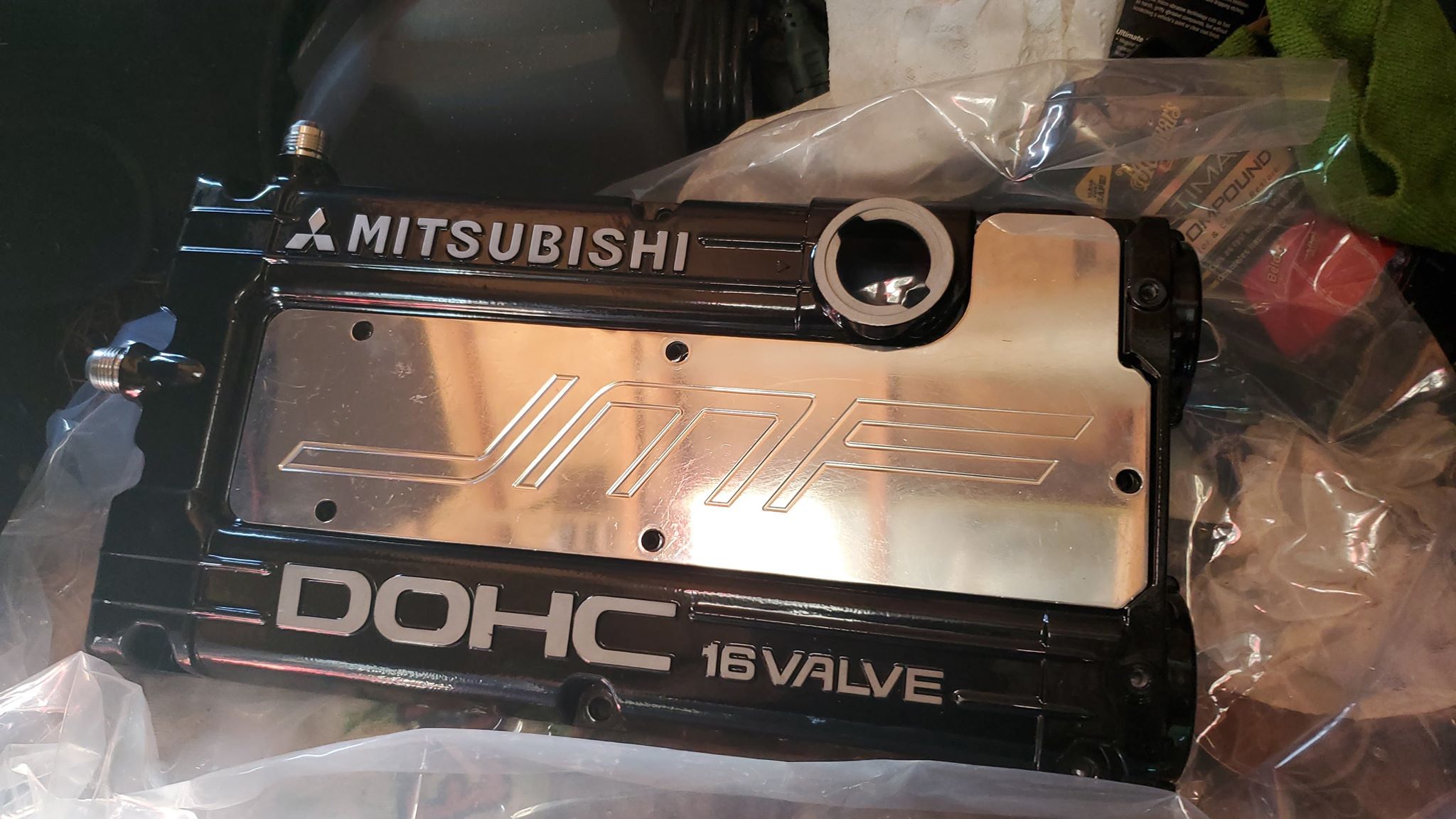

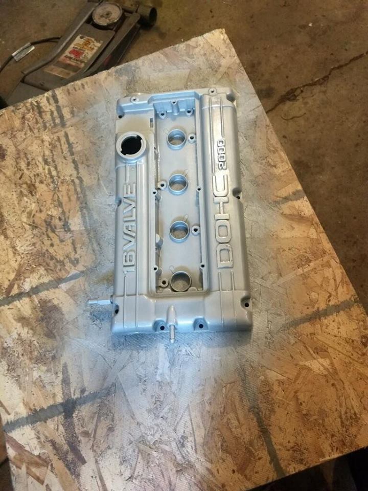

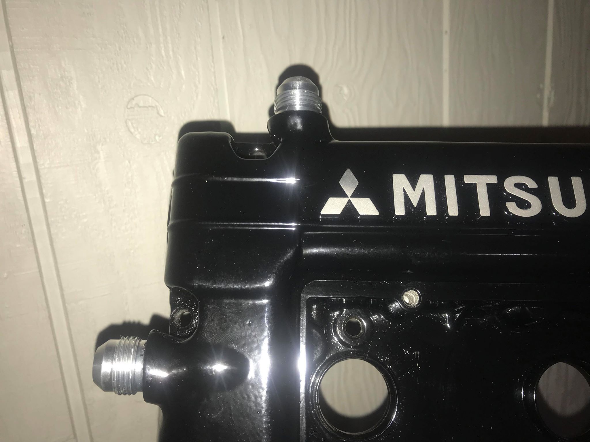

+ Painted Valve Cover w/ Polished Letters
+ Lots of Dress Up Hardware
+ New OEM Suspension Bits
+ Poly Motor Mounts

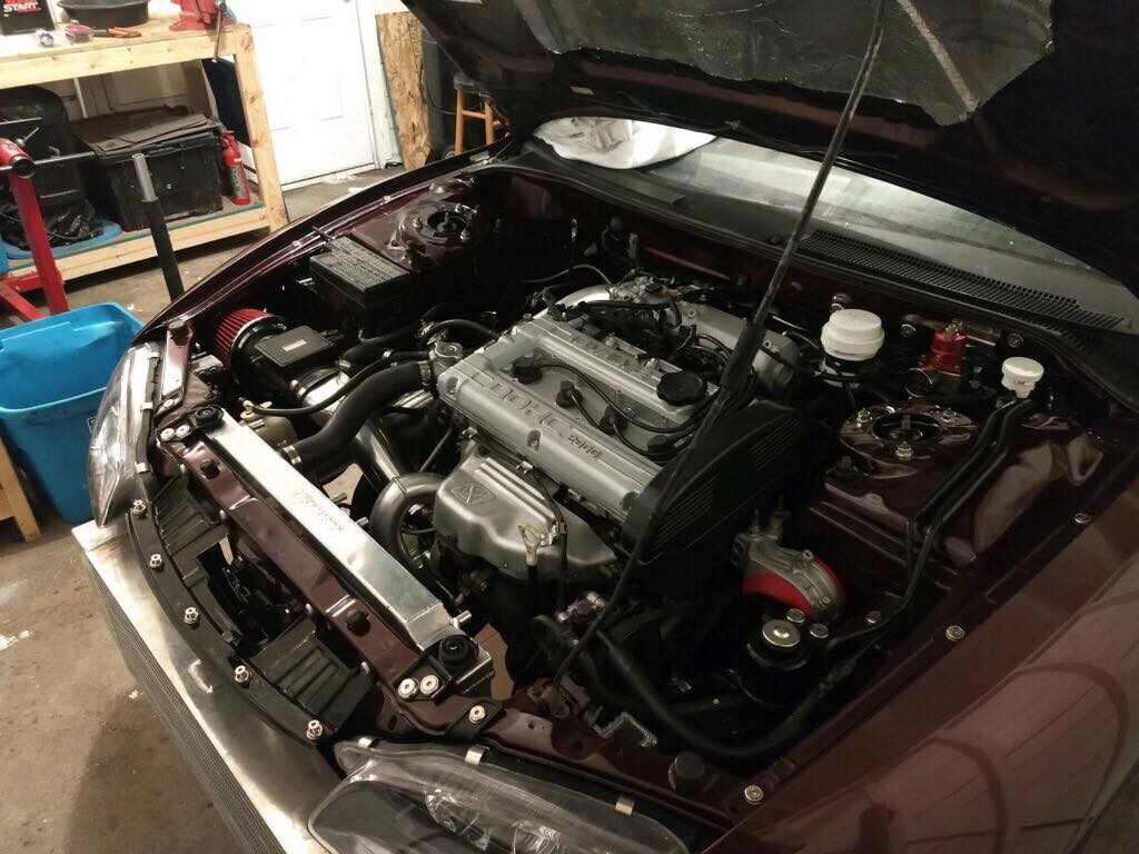

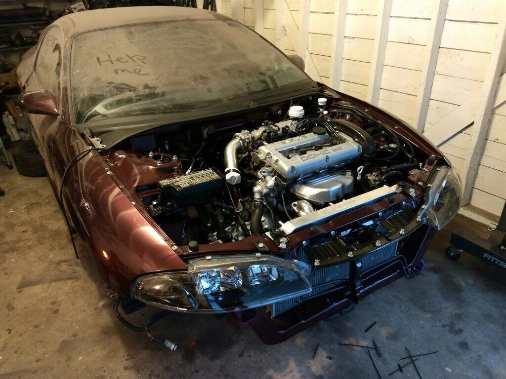

Should be running within a week or so on a small 16g setup. Car may be getting a 68HTA Equivalent or similar, w/ a BSFab 3.0" Tear Drop Side exit, undecided on that matter.
+ VRSF FMIC - Greddy RS BOV flange rotated to fit stock angle.
+Temporary CXRacing 16g
+Radiator, Misc Lines & Hoses
+Other final assembly.

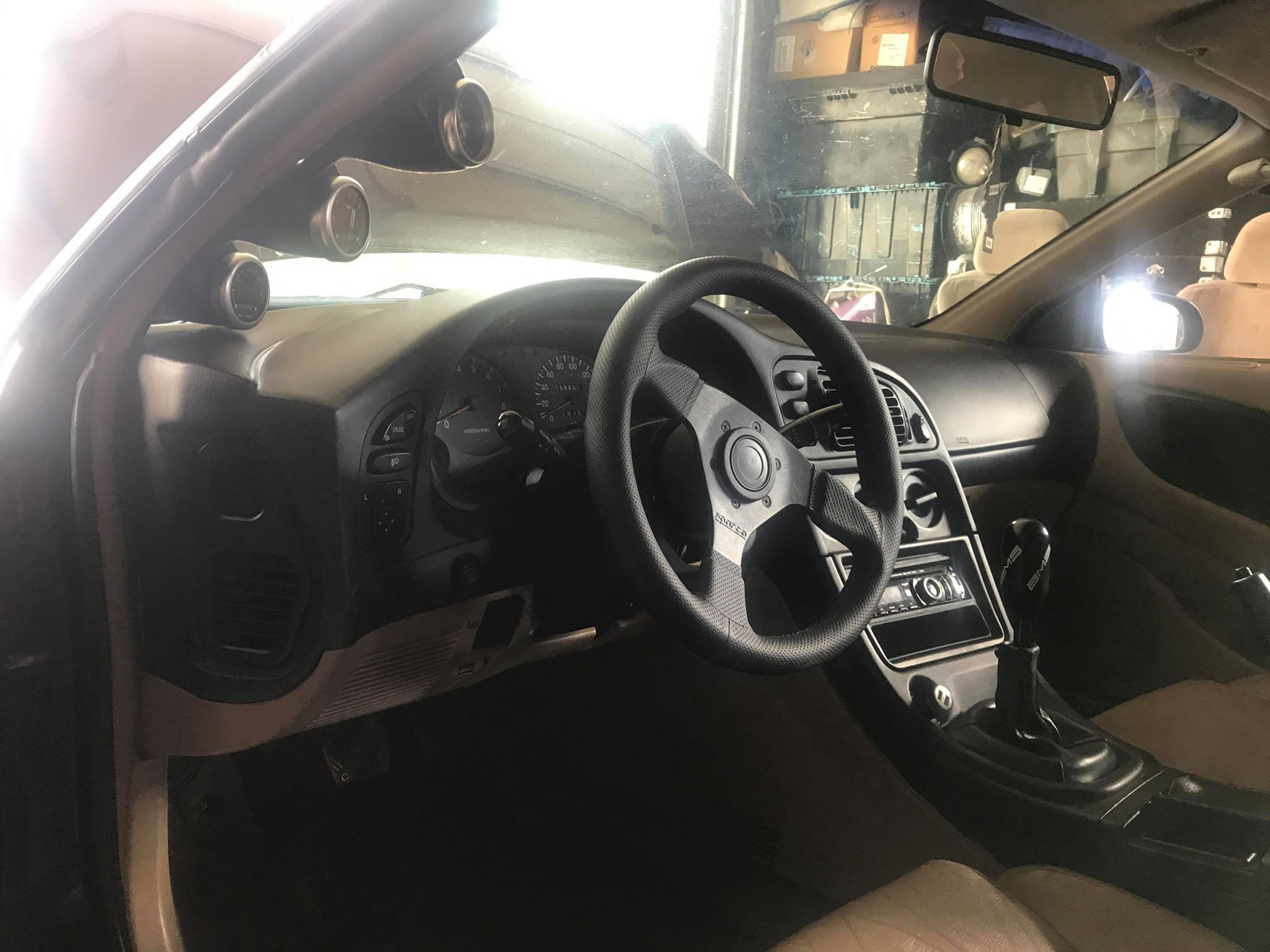

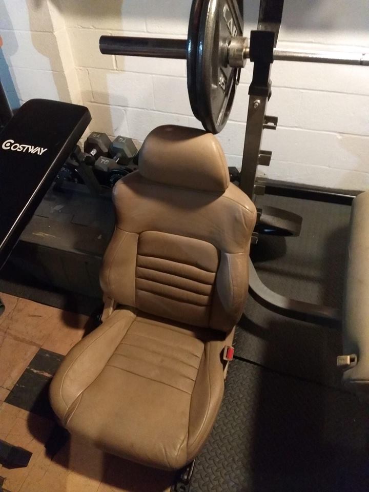

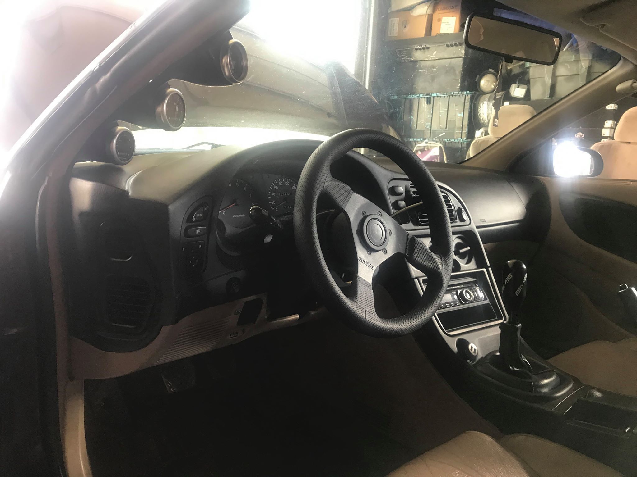

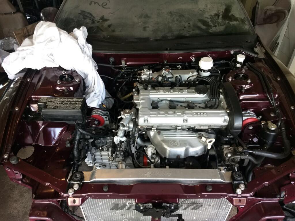

+ Clean Leather Interior & Interior wiring touched up.

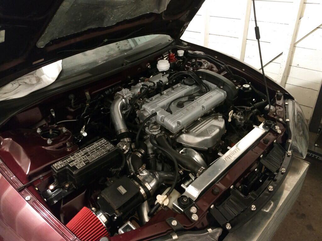

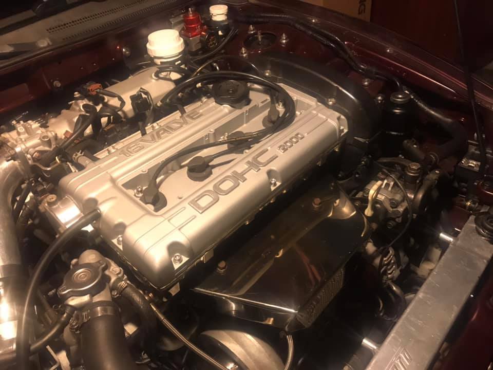

Car is now running! More content to post in the near future as well.
- Swapped 16g for a 20g rebuilt by Justin Whitesell w/ a Holset Actuator
- Speed Density
- FIC 950cc Injectors
- ECMLink V3
- Injen Intake & FP Filter
- Oldschool Buschur Heat Shield
- Sparco Champion Steering Wheel

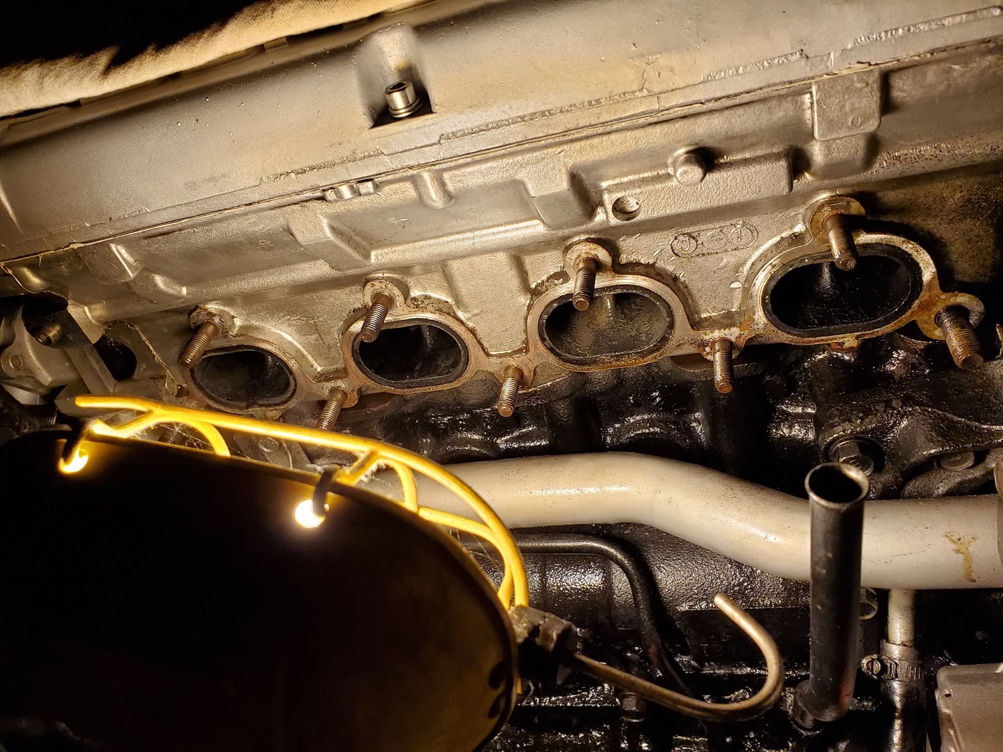

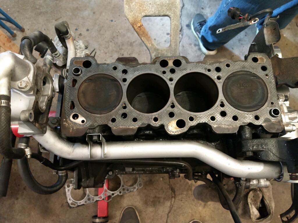

- Fast forward approximately a week or so, Ricky Nichols @ Rix Racing started tuning my car for me, we saw around 22 PSI just fine on the holset actuator, car was pulling strong showing around 40 lbs/ min already. Drove it home, parked it, saw white smoke billowing, pulled the manifold and discovered a ruined turbo and bad stem seals. Sent in the turbo to Justin Whitesell, time to go bigger.

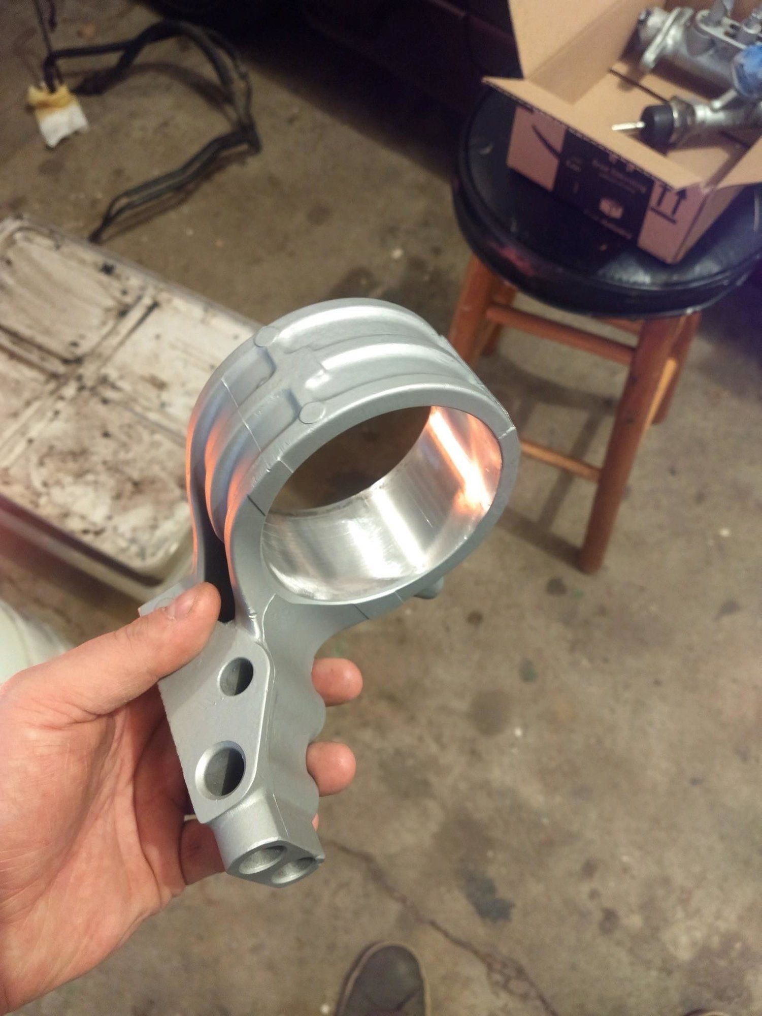

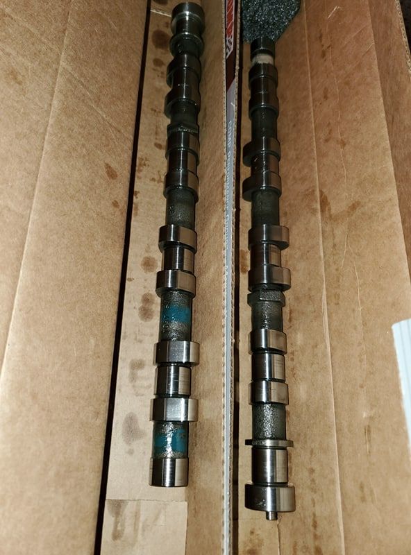

Began picking up loads of parts for the overhaul. Old school FP Green, Ported modified Evo 3 Manifold w/ External Gate provision, Stainless o2 Housing, Turbosmart 38mm gate, 3 Port EBCS, Sparco Steering wheel, BC 272 cams, BC springs & retainers, along with a plethora of other misc items.
