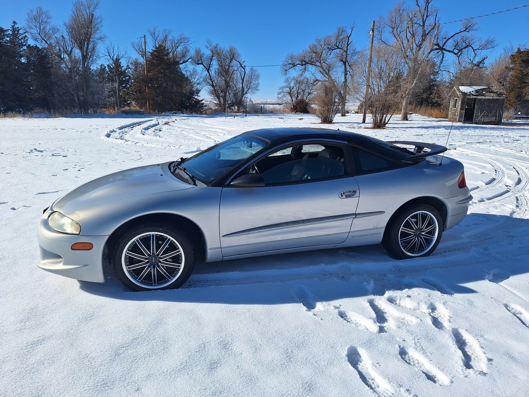

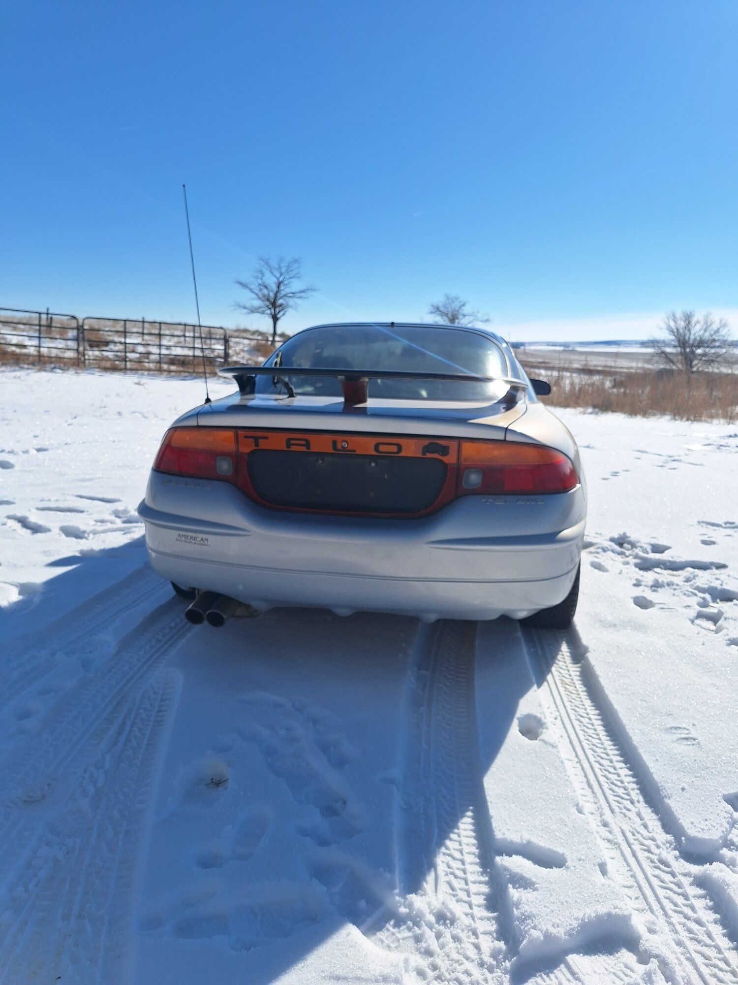

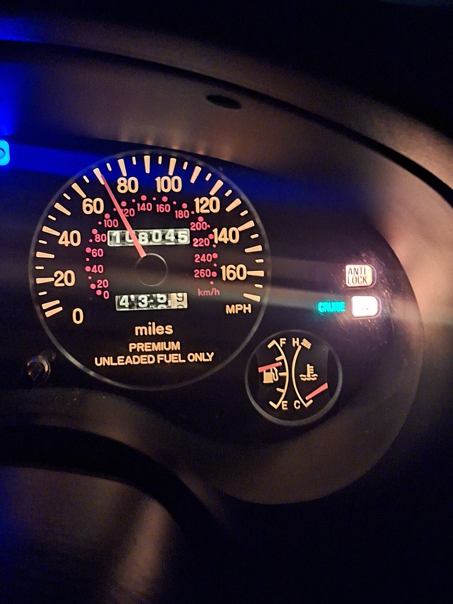

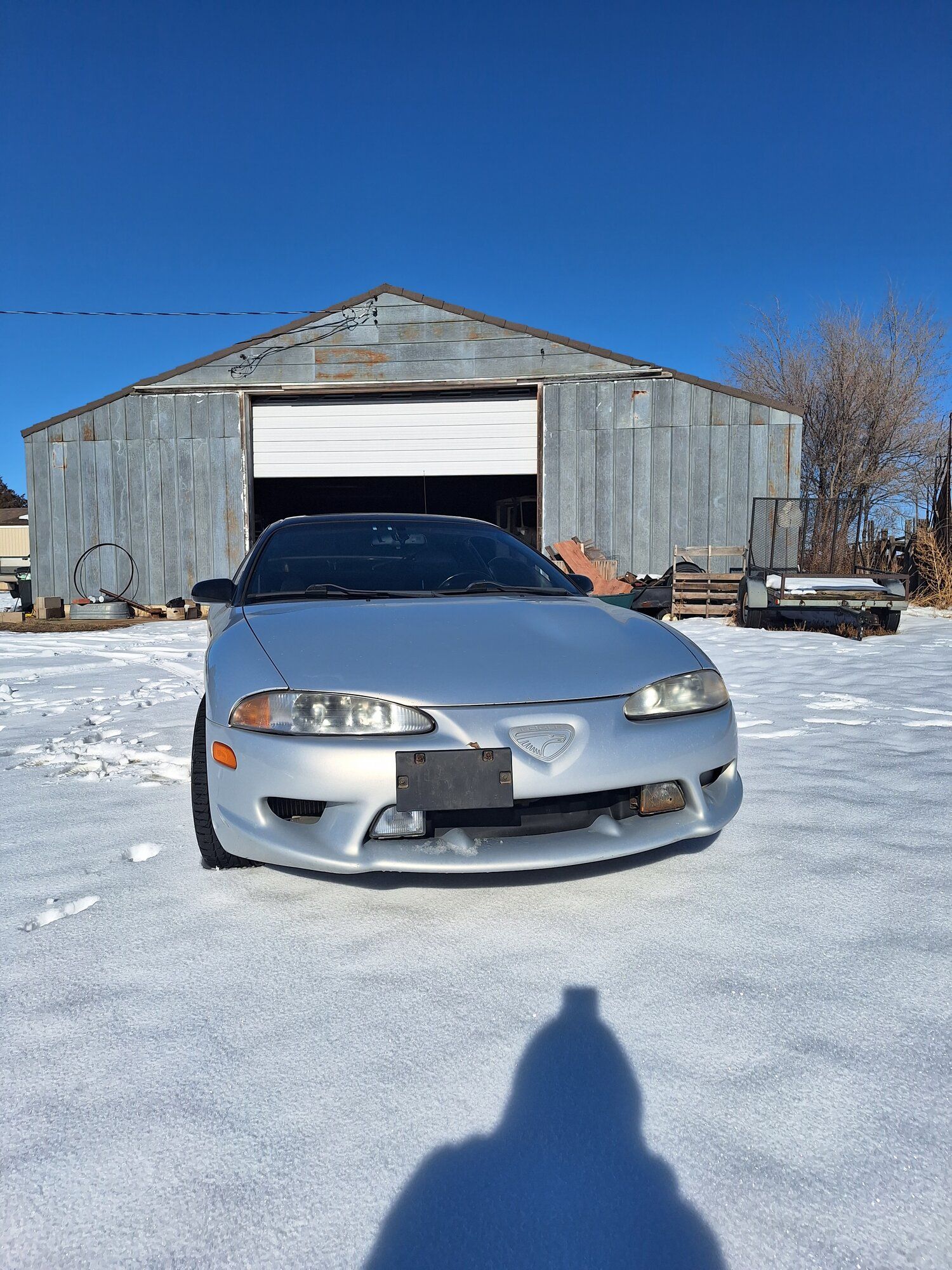

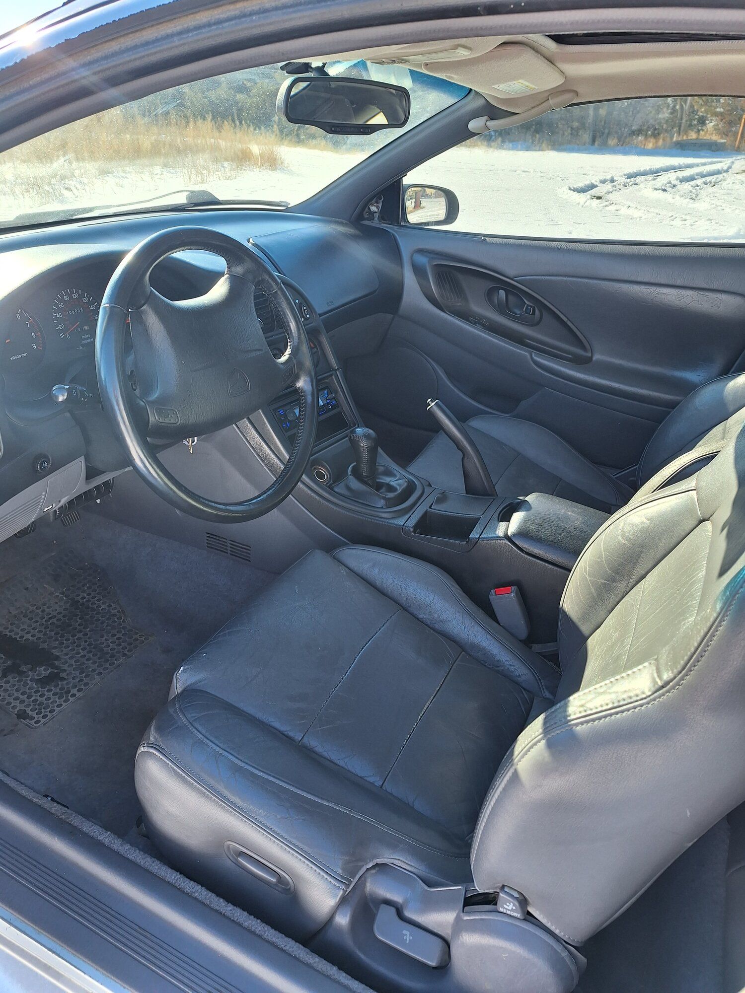

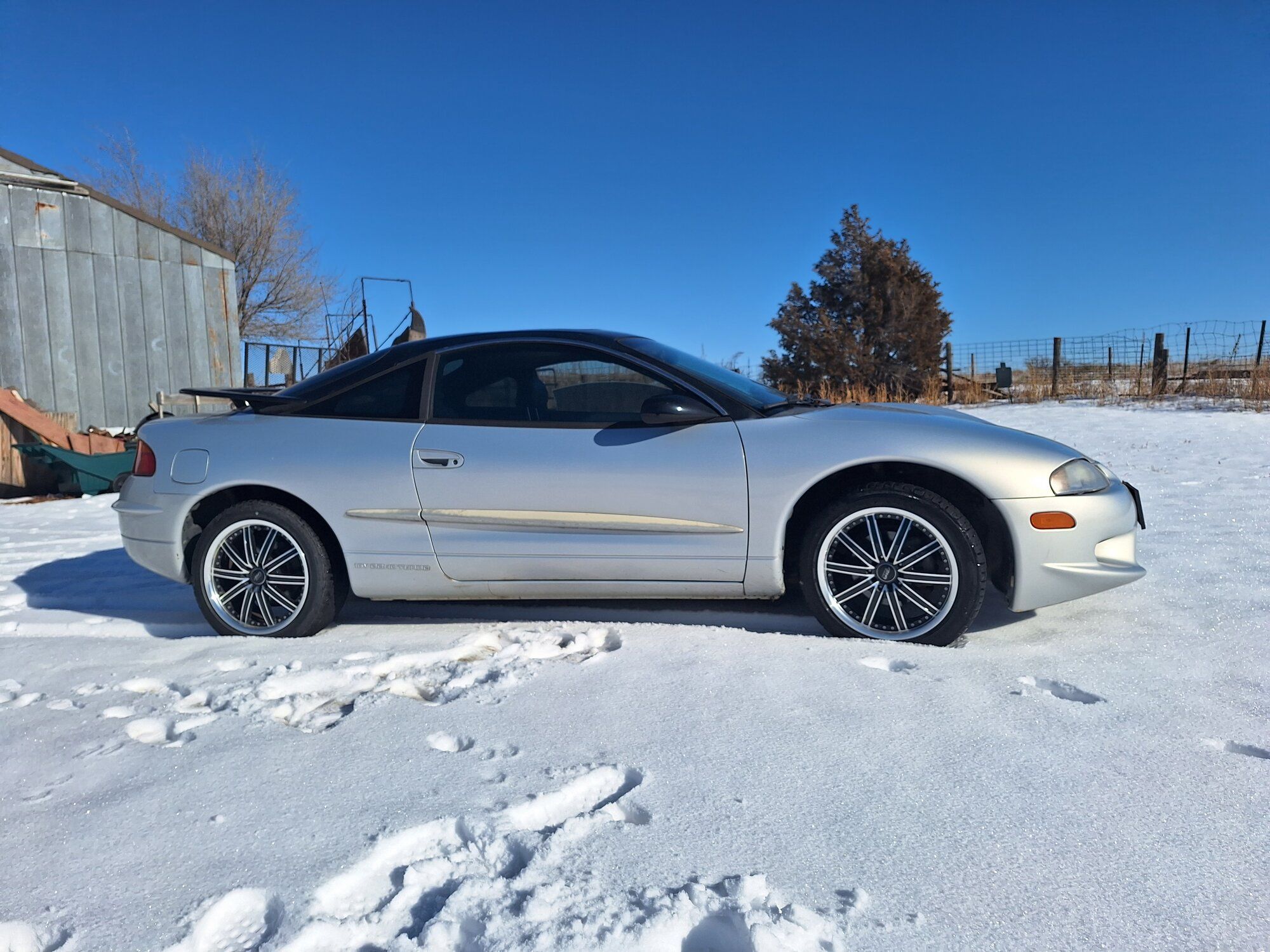

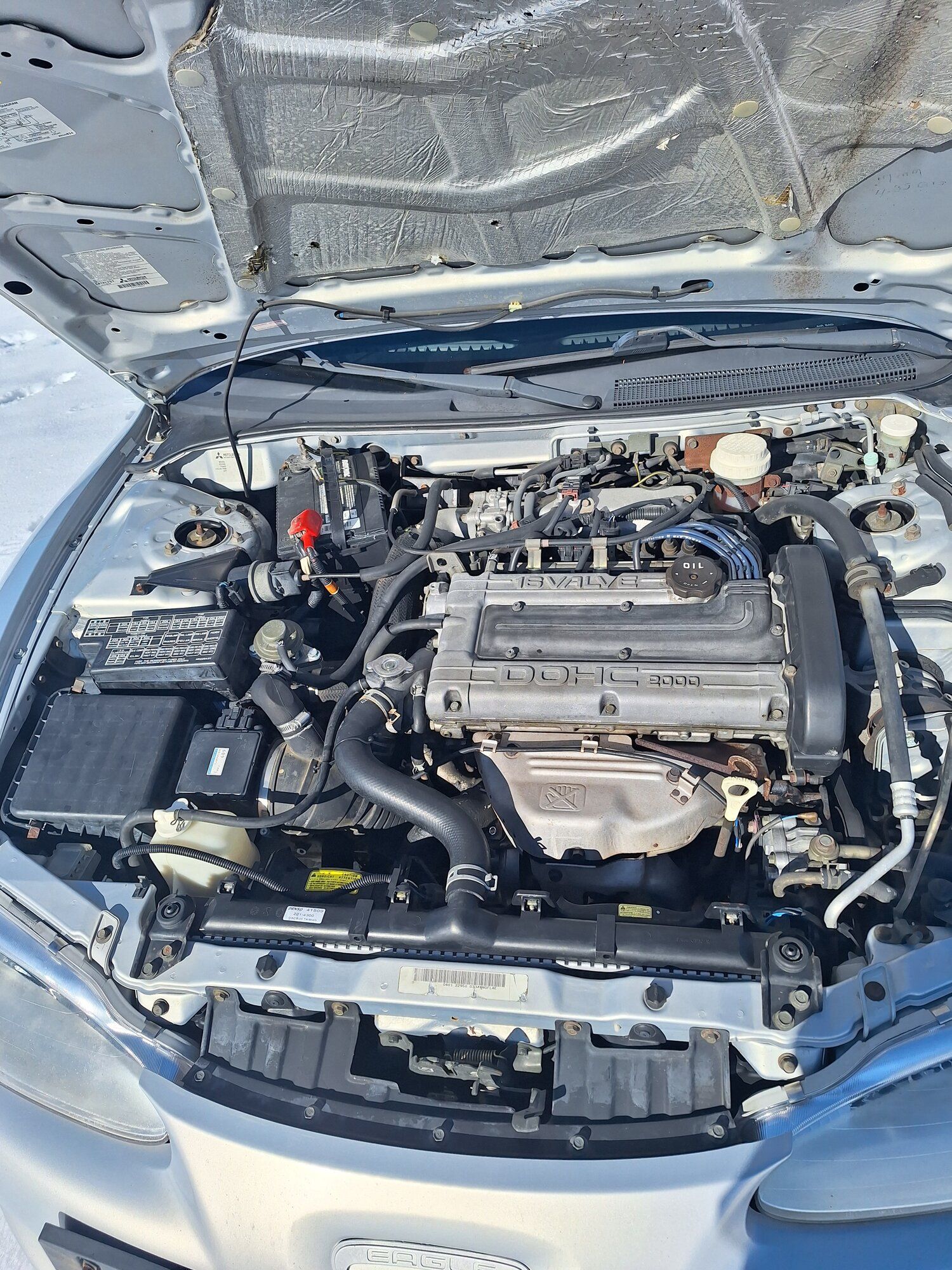

I finally got to get a get look at it today. Here are some pictures from today:
After getting my hands on her and doing some maintenance, I was more and more pleased with my purchase. This car needs a handfull of little things, but it is the cleanest dsm I have personally ever seen. It appears to be taken care of very well.

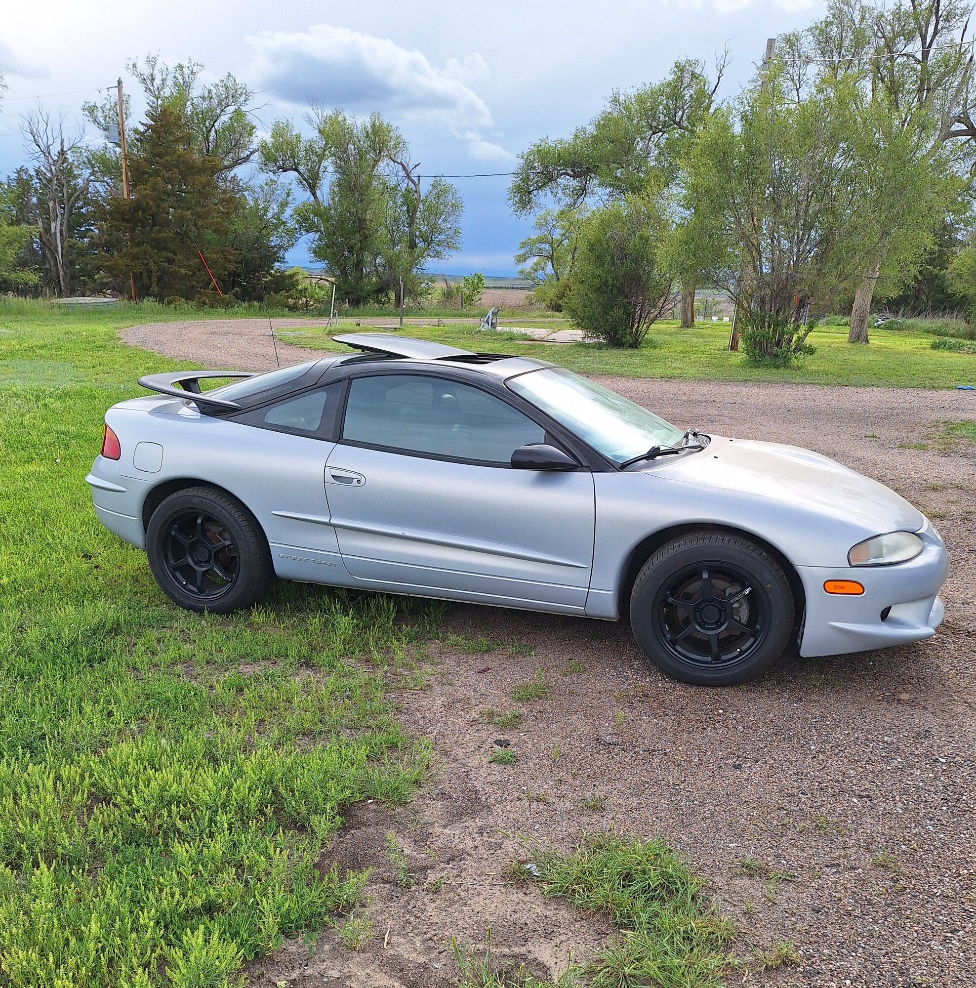

I also picked up a new set of rims and tires. The car looks sooo much better in my opinion. They are 17x8.5 Motegi traklites with 235 50R17. She needs lowered a little but still looks way better.
