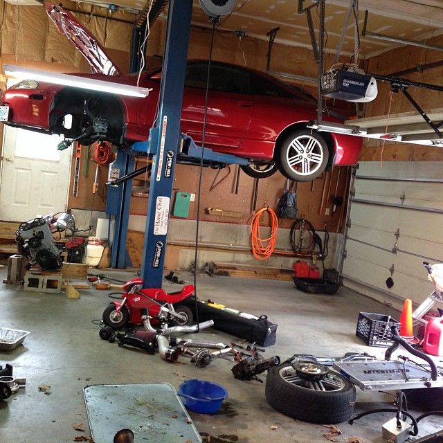

Update. 2014 build has begun. i mentioned a little while before that fourth gear synchro went bad. not sure on the cause. well I sold that trans and will be getting a new and stronger one. looking at TMZ right now.
Got everything dropped on a friday night after work to get the trans ready to be sold

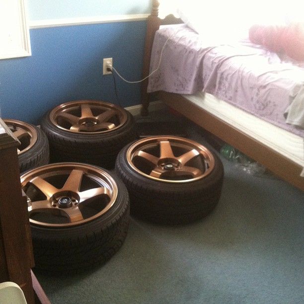

And this is where my wheels end up every winter. right next to my bedside

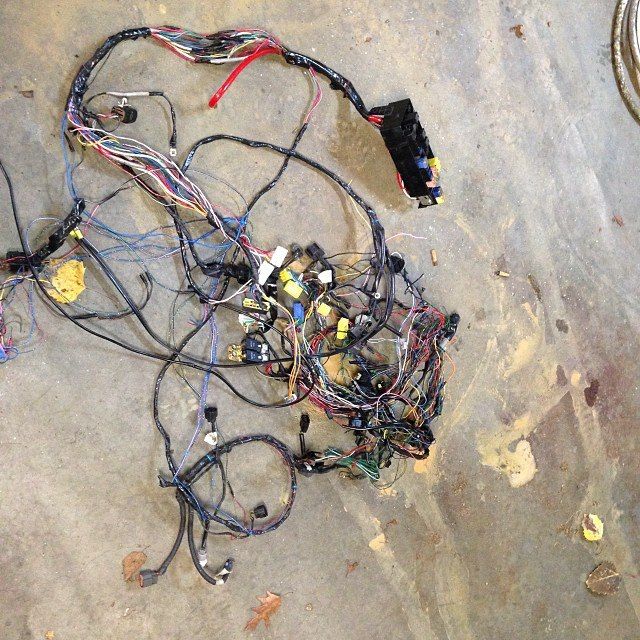

I had previously done a wire tuck. but when i did it, I had almost the entire harness cut up and lengthened/shortened, and i really didn't like how many soldering points there were in that harness. So I decided to redo the harness entirely by getting a hold of an engine and fuse box harness out of a GST at a junkyard nearby
here is what the old harness that was in my car looked like.
I don't have pics of the new harness that i've dropped in, but I will say that instead of cutting and shortening this one, i've just coiled it up and ONLY lengthened the wires that I needed to.

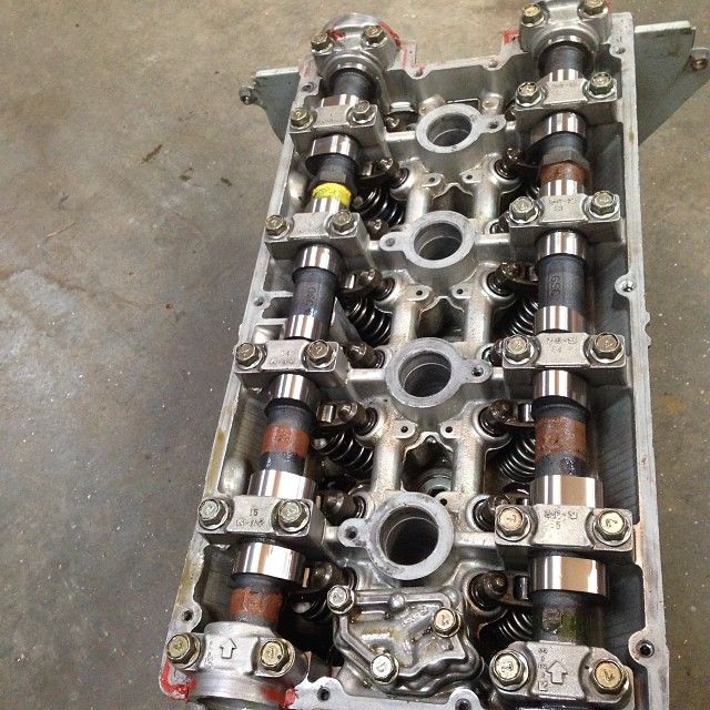

SO. Here we are at the current stages of my next build. the long block is torn apart and I've sold the HKS csam and spring setup that was in there.

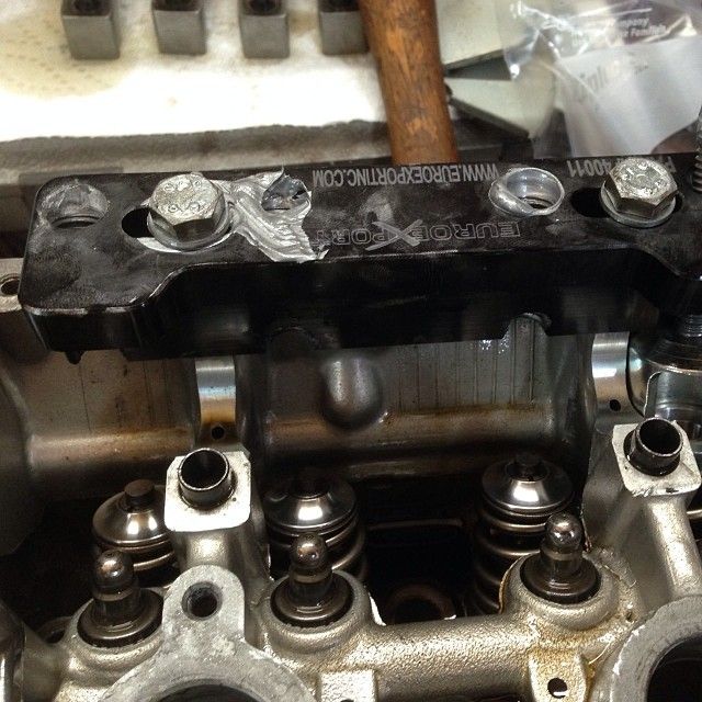

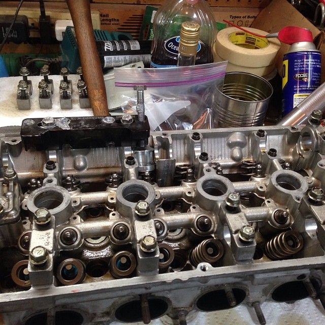

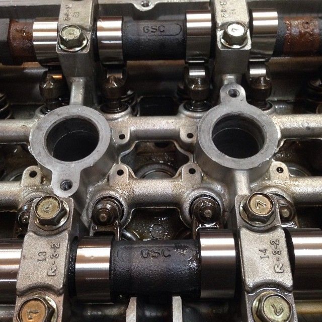

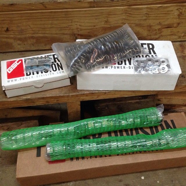

Last night I put the new stuff in which consisted of GSC S2 cams, GSC high rev springs and GSC viton valve stem seals.

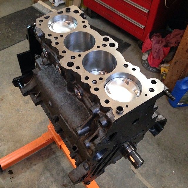

Haven't been updating this thread like I had planned to. But I'll try to get some info in on this update as to what happened this year for 2014. We left off with the tear down of the last setup. Ended up selling the HKS valvetrain in the head, the transmission, turbo and manifold. I found light score marks along the cylinder walls of a couple cylinders. So I decided to disassemble the shortblock to check it out. It was a good thing I did because those marks turned out to show that the piston to wall clearance wasn't right and the pictons ended up grazing the cylinder walls a little bit which in turn also ruined those pistons. Upon further dis-assembly, I found the number one rod bearing was pitted and eaten away. The car still ran fine like this but it probably wouldn't have been long before it started knocking.
Needless to say, the block was sold bare, and so were the rods which were still good. Pistons are in my basement and I actually used the crank in my new block now.
So begins the actual build for 2014. If I haven't already mentioned, my ultimate goal for this car is to get it to 800AWHP.

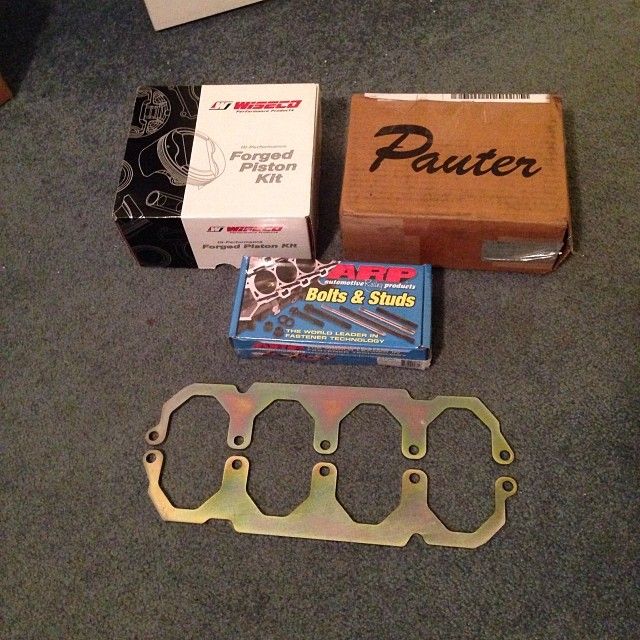

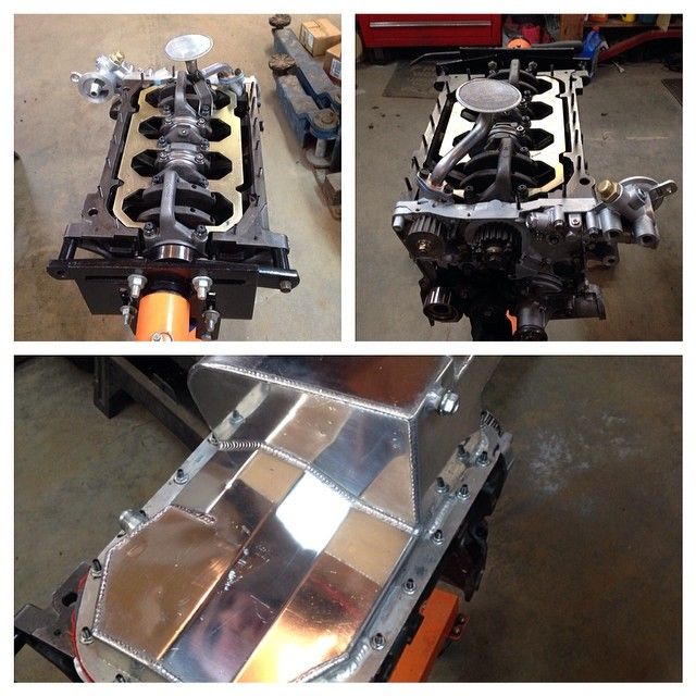

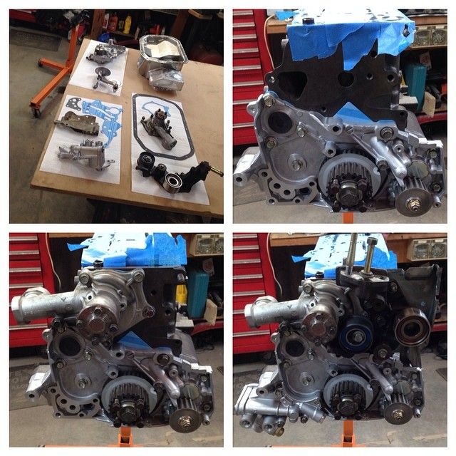

With the old block no good, I had a brand new one machined and assembled. This shortblock consists of pauter x-beam rods, wiseco HD 8.5:1 pistons, stock uncut crank, kiggly girdle, ACL tri-metal bearings, all ARP hardware and a moroso 6.5qt oil pan.

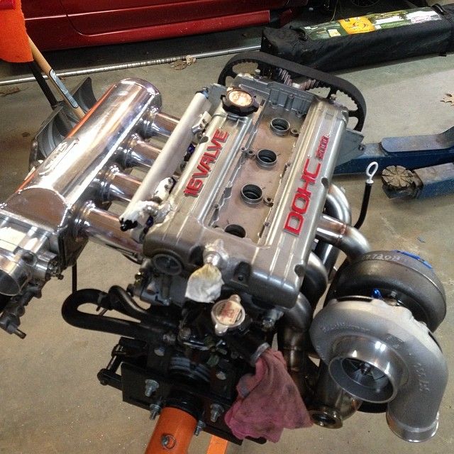

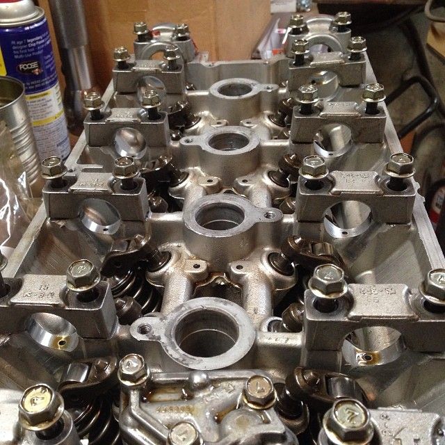

The head now consists of +1mm manley valves, GSC high rev springs/retainers, GSC viton valve stem seals, GSC S2 camshafts and a kiggly HLA pressure regulator. I already have pics up of me installing everything. here's one before i unpacked it all.
The long block is held together with a fel-pro permatorque headgasket and MAP H11 headstuds.

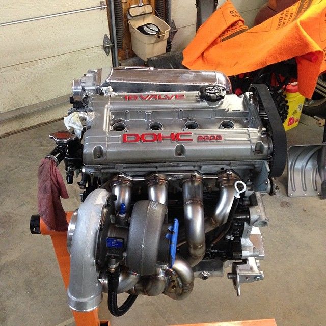

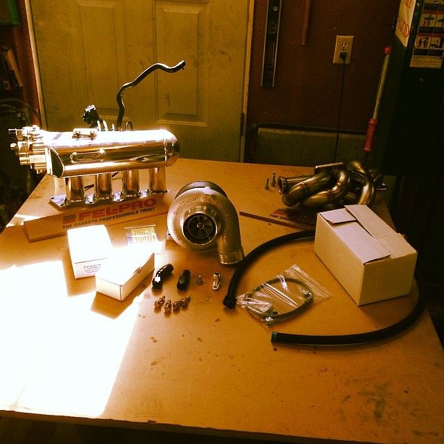

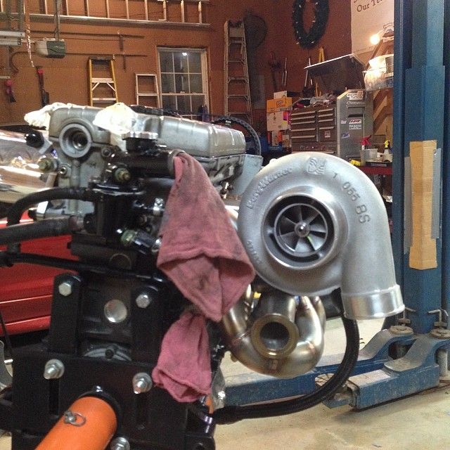

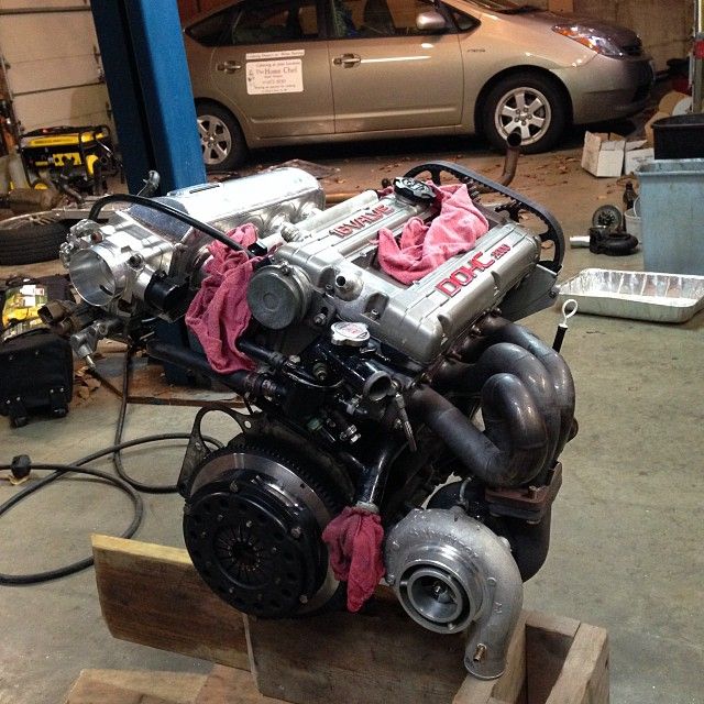

I'm now running a JMF top mount divided T4 manifold. Attached to it is a Borge Warner S366ET.
